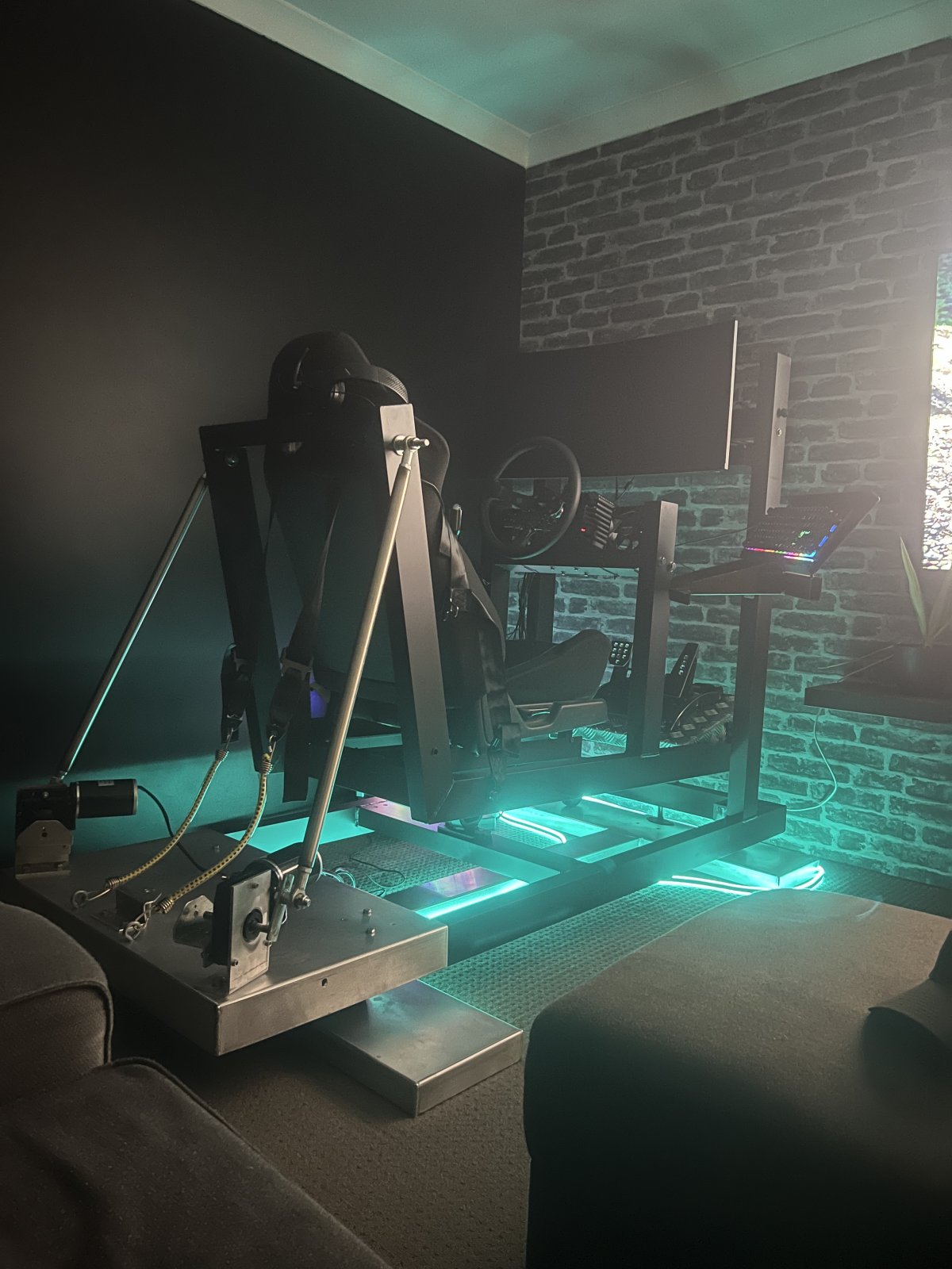

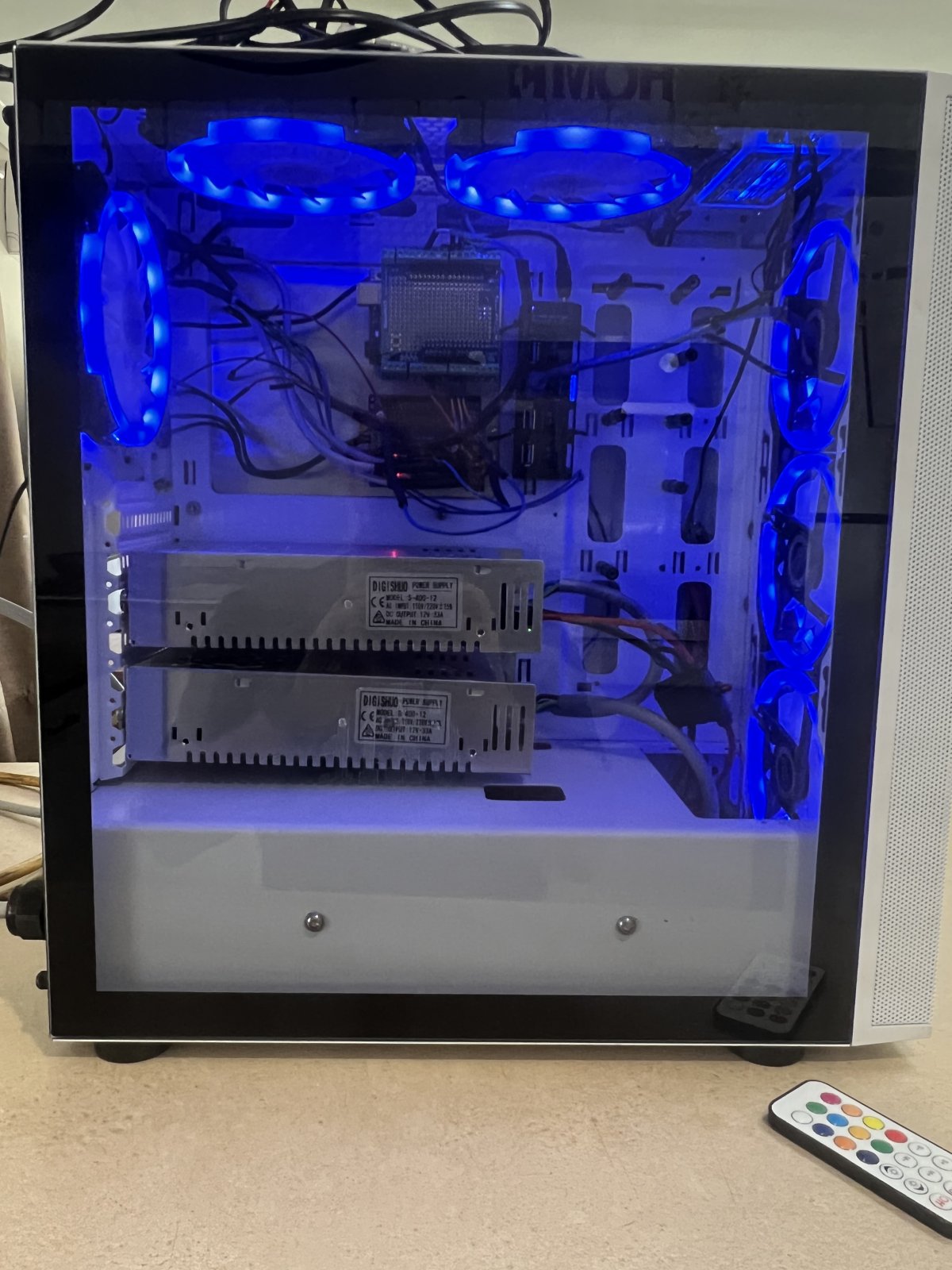

    Hey guys just built this aluminium beast, I thought I’d share and say a big thanks to the community on here! So much info and a lot of fun! Big thanks to @noorbeast and @Halloween2go! The tutorials are outstanding! And its something I never thought I’d attempt but gained confidence from the forums here! Keep doing what your doing✊

    Really excellent craftsmanship @Nikkatai, please do share more details and in particular about the modified computer case.
    If and when you get the chance a video of your rig in action would be great!

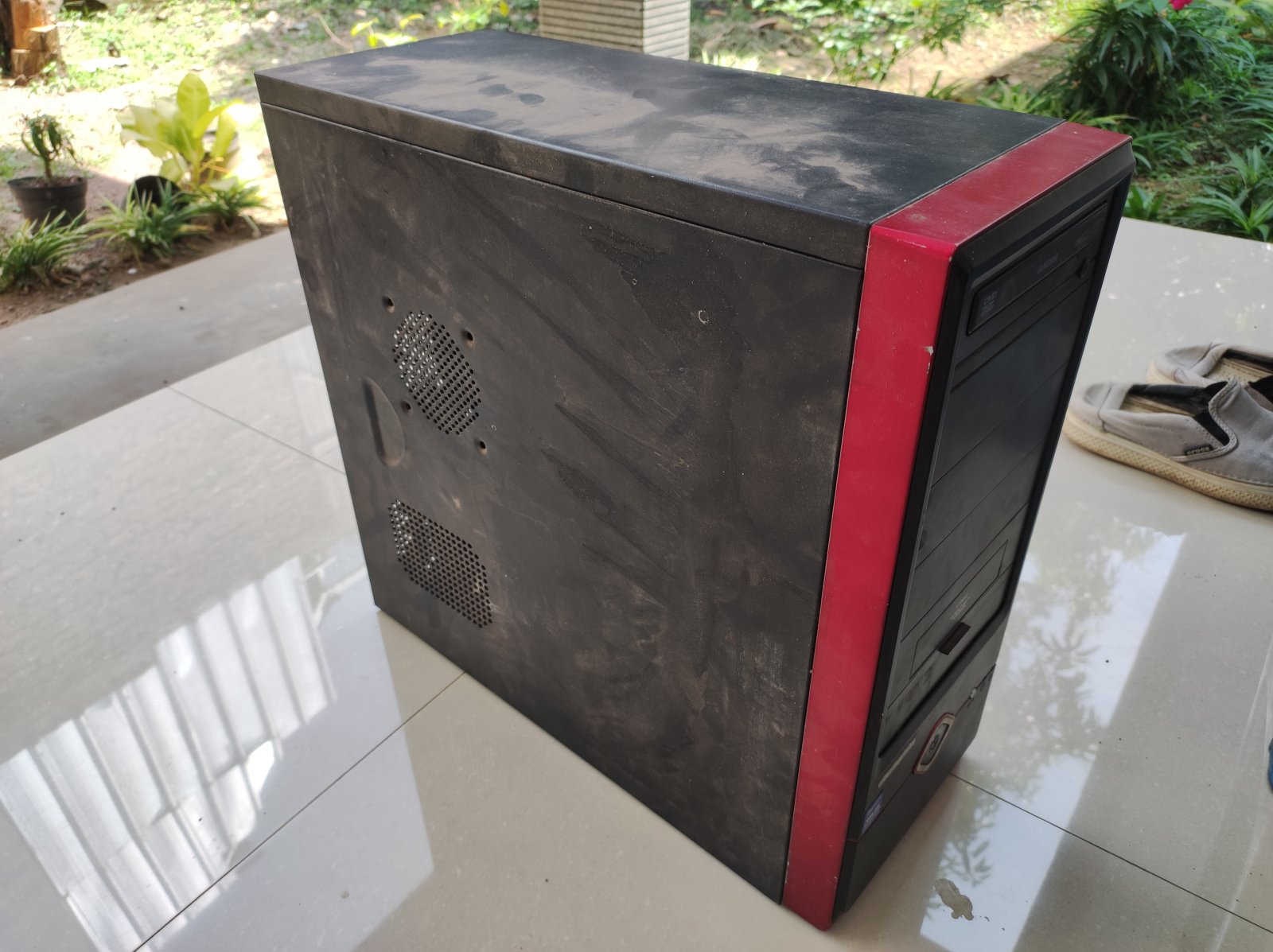

    using a pc case is something I never thought of before. that's brilliant!
    thx for sharing, I got a spare old pc case and I can't wait to modified it.

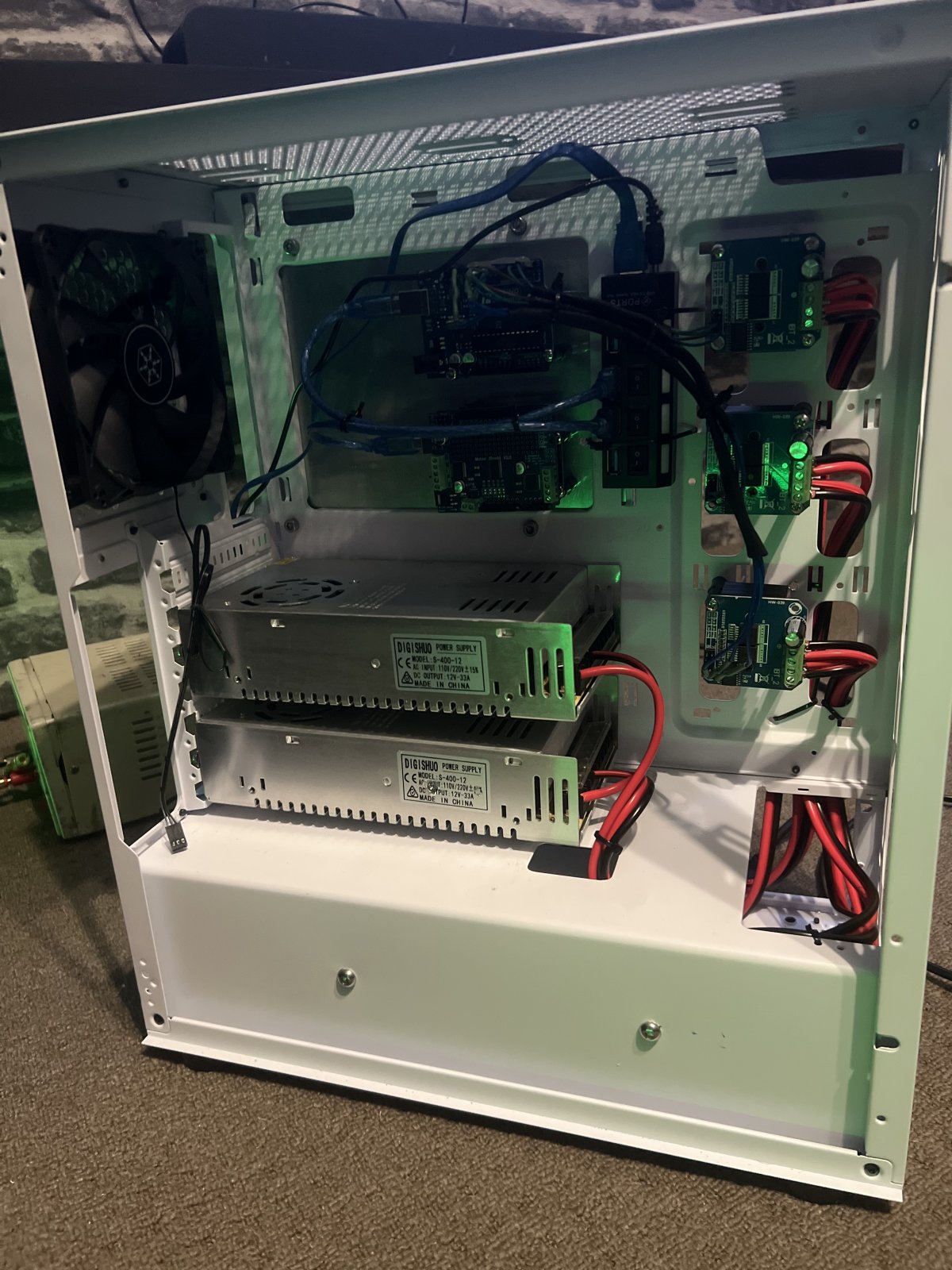

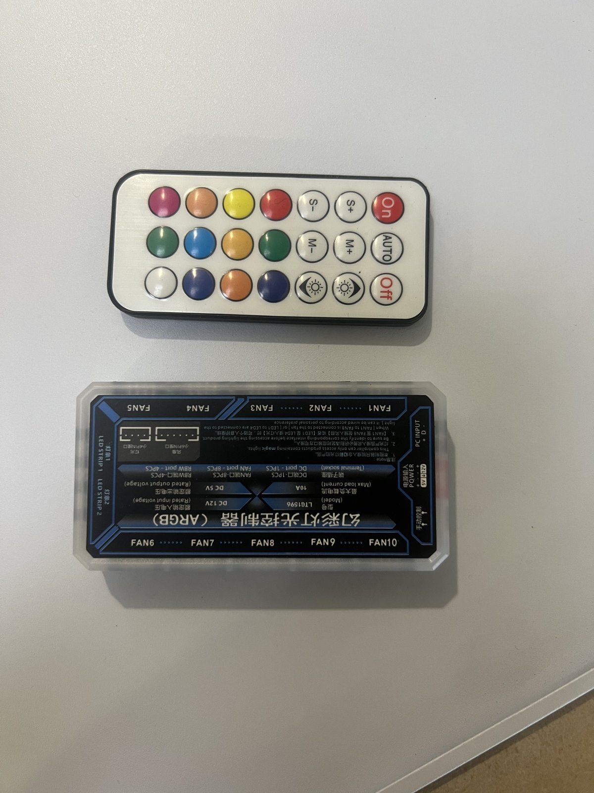

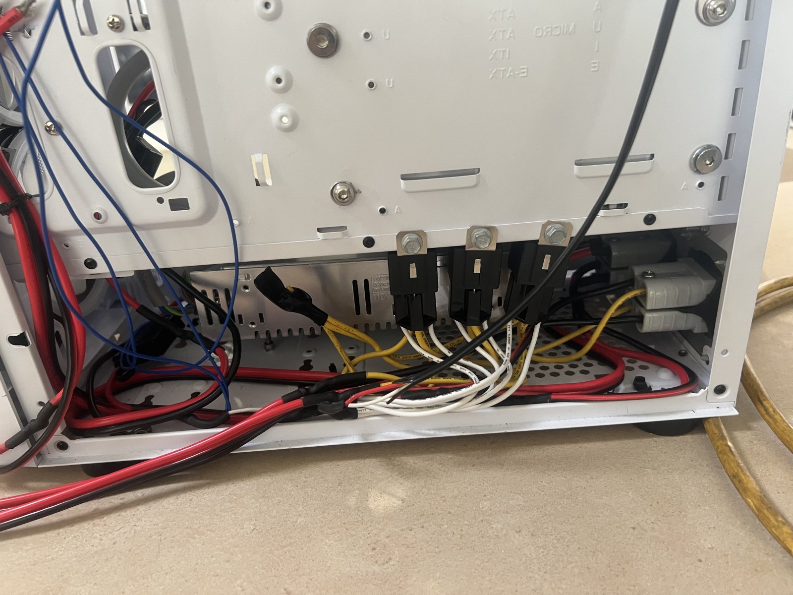

    Cheers man! 100% and I’ve got 6 rgb fans and a cheap eBay controller running off a 5v usb and 12v input, there’s holes everywhere so you can route wiring etc I have 3 power supplies 1 is hidden underneath along with 3 relays for estop, the perfect base really and very cheap to buy! I’ll post a full breakdown just been really busy!

    I just came back from my store room. And get the pc case. Lol

    So here it is powered up! Apologies, I burnt out my motor drivers using a couple of external power supplies so have removed them and are waiting for more

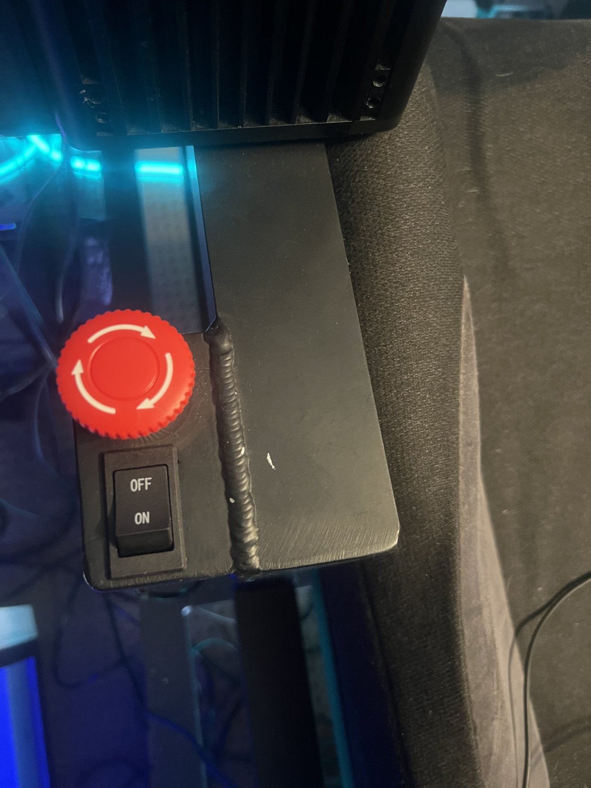

    Internally it has the basic components mentioned in everyone’s build, except I have tried to incorporate, windsim Arduino and motor shield, bass shaker amp and psu’s motor drivers etc in one box, and with 6 rgb fans controlled by a $24 eBay controller that does not require a motherboard to operate, only a 5v input from a snipped usb plug and 12v input from the power supplies. Mine are 33amp so plenty of left over power for light accessories. At the back I have a series of plugs 3x outputs for each pot, and 4x outputs for motors including a spare for an external device later on, I used Anderson plugs as they are rated to 50a and have a very good connection! Also a speaker output push lock plug for each win sim fan so disconnection is easy. Below I have 3 30 amp relays wired to a switch and estop. Very basic but a pc case houses enough space for everything to run and should keep relatively cool due to there designs and fan incorporation.

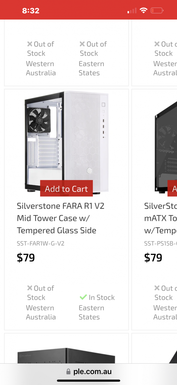

    What was the actual PC case you used?
  9. Nikkatai
    Nikkatai New Member Gold Contributor
    Jun 17, 2022
    21
    97Coins
    +14 / 0 / -0
    Was just a $80 dollar one from ple computers there’s alot to choose from and all offer similar space and wiring spots,
