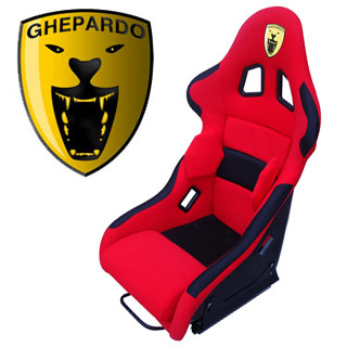

  19. bsft
    yes but you are completely mad. Dont tell @Rastus he has a "girly" seat on his ride. Hes liable to give a good swift kick.
    @simyoulater , find a seat you like.
    I use these, weighs about 9 kg
    And they are padded well enough to be comfortable, but sturdy enough that you feel the vibrations.
    As for motors, 12v 200 watt with 25:1 gearboxes are what I use on the desk racer with 40mm CTC lever.
    And JRKS for control.
    They will move 120kg person no problem

    I got the same style seat, but it reclines, just because I drive quite laid back and these bucket seats put me in a position that feels a little unnatural to me - But that's a personal choice.
    However, as @bsft said, if the seat is firm enough (and mine is) it's all good!
    For Aussie members, This is the recliner I bought. (It's Still a bucket seat, so will fit a harness etc - just reclines)
