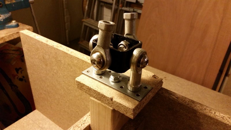

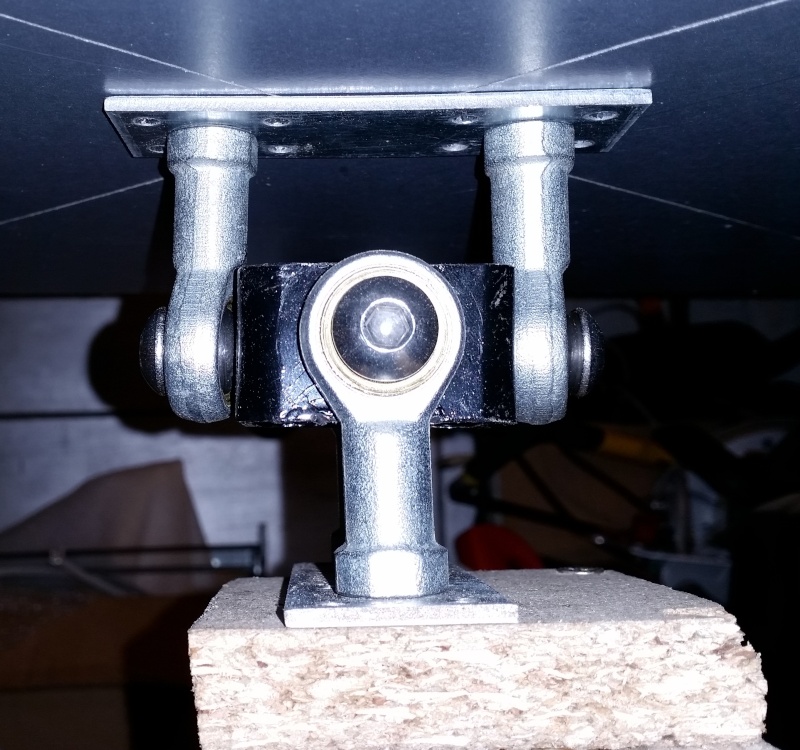

    You can try to build one :

    @Wanegain , fantastic idea! How would you describe the durability, angles of movement, and stability of your idea? It seems to be just the solution I'm looking for. If I may, what are the rod ends attached to in the middle and what size are your rod ends?
  6. Wanegain
    Wanegain Active Member
    Nov 6, 2013
    562
    Bruxelles
    2,019Coins
    +300 / 2 / -0
    The durability depends on what material you use to fix it, but the universal joint itself should not be degraded.. For angles there is no restriction. With this solution, it's possible that there is a small backlash because of the elasticity of wood. I am using 10mm threaded rods.

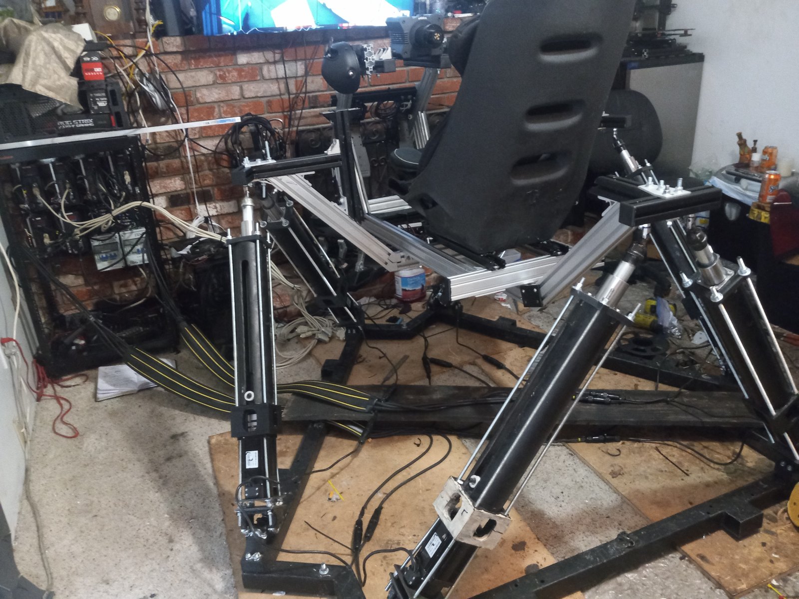

  15. Rodeo5150
    Mar 21, 2019
    222
    Antioch, CA, United States
    1,251Coins
    +55 / 0 / -0
    Arduino, 6DOF

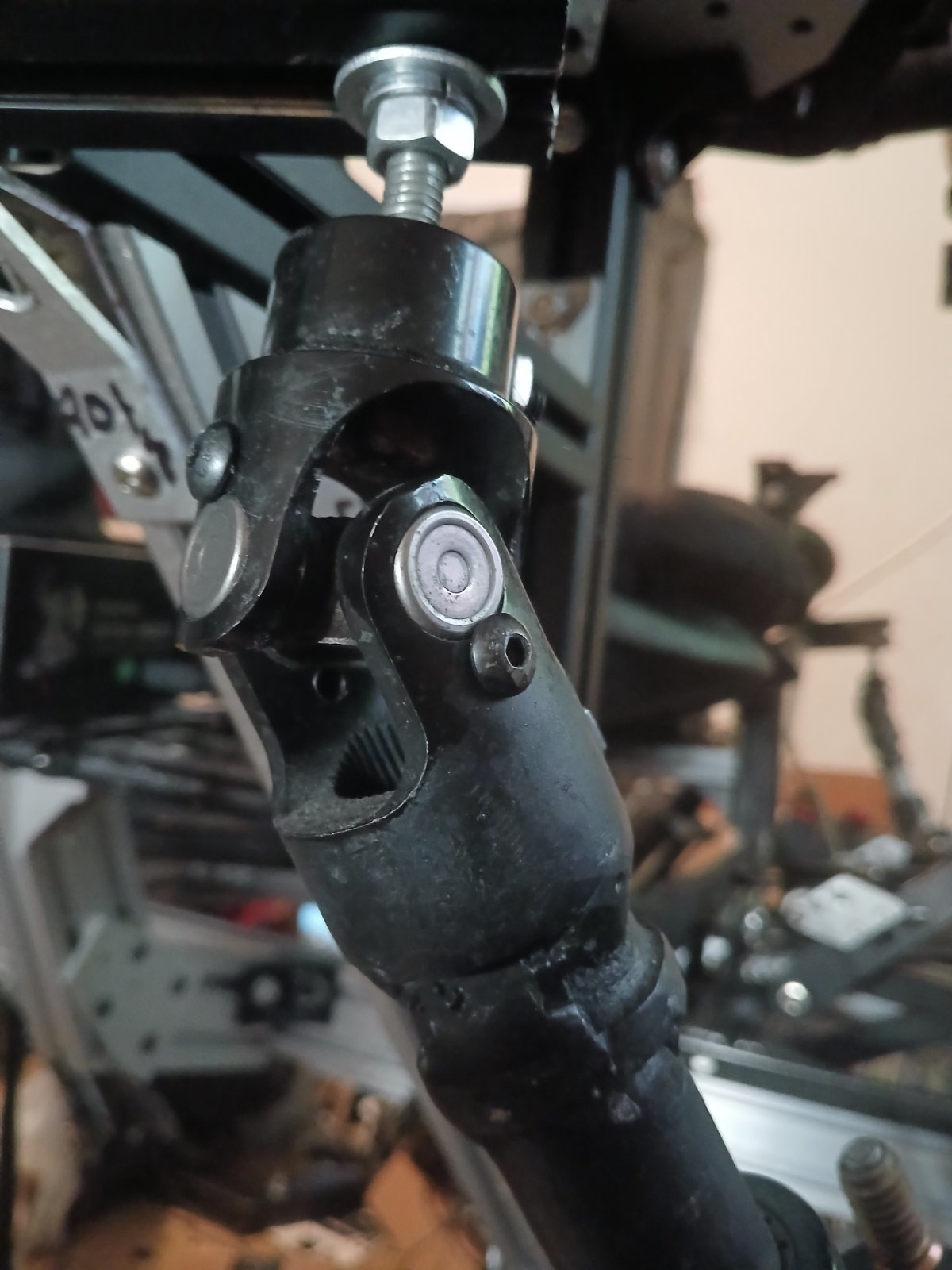

    I got these from eBay I think for maybe around $20 a piece I think maybe a little bit more

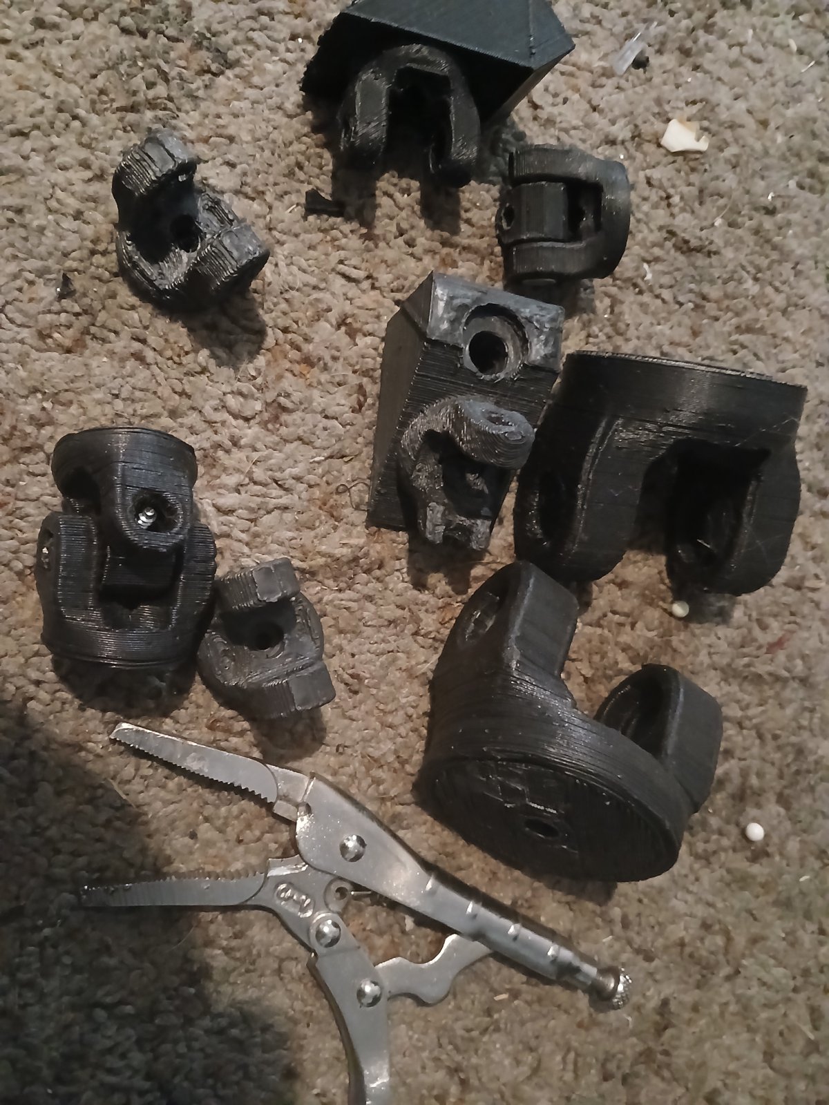

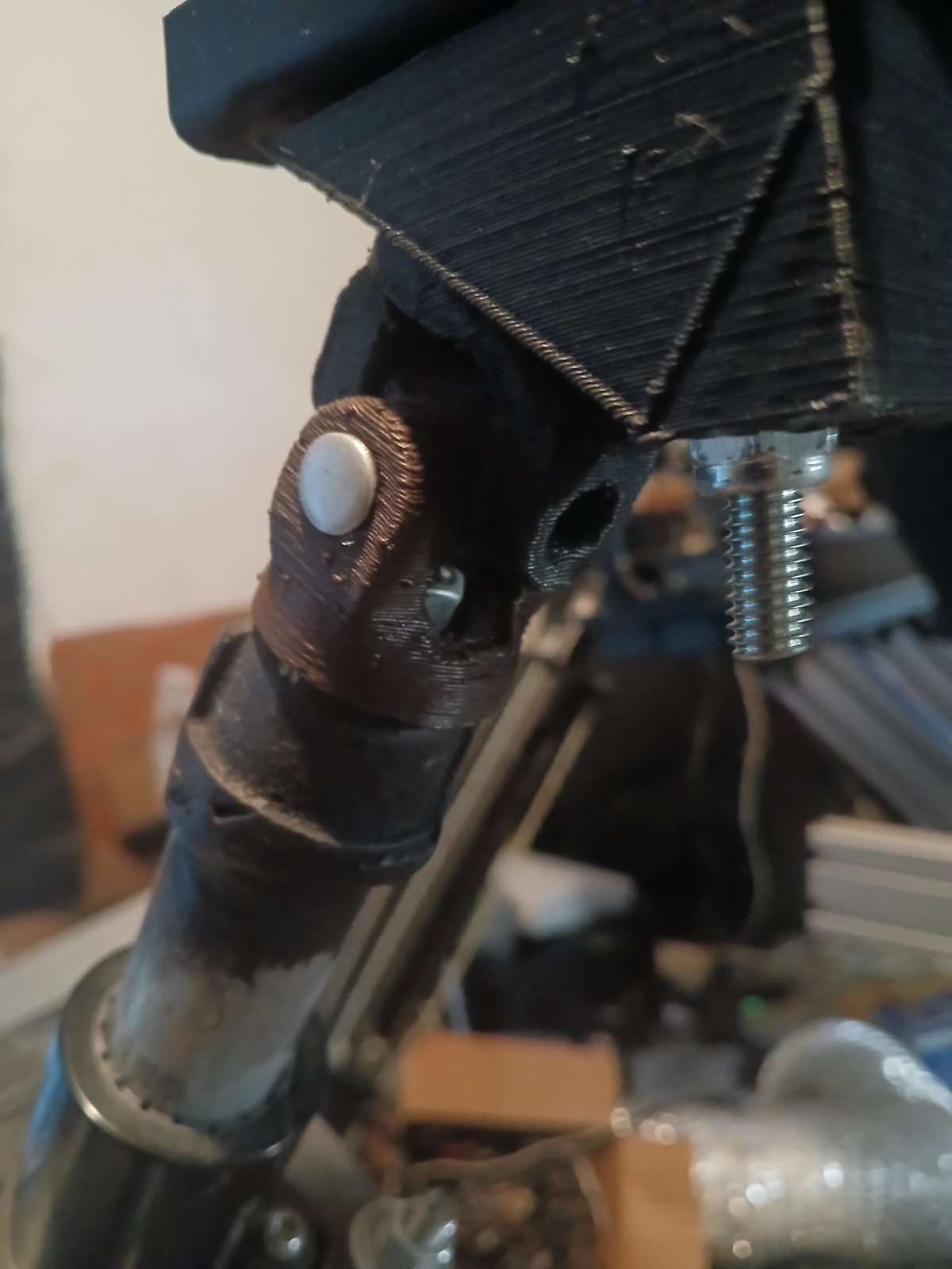

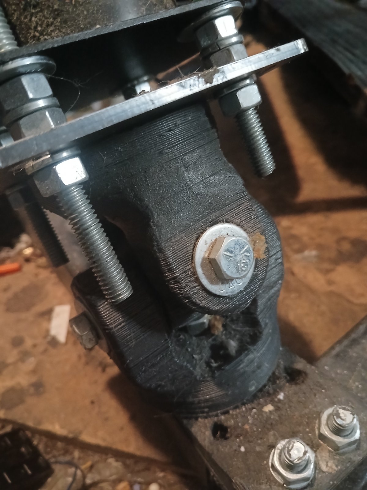

    I've also three printed my own still holding up my full size hexapod
  17. Aerosmith
    Aerosmith Active Member
    May 30, 2024
    500
    self employed
    2,927Coins
    +299 / 1 / -0
    3DOF, AC motor

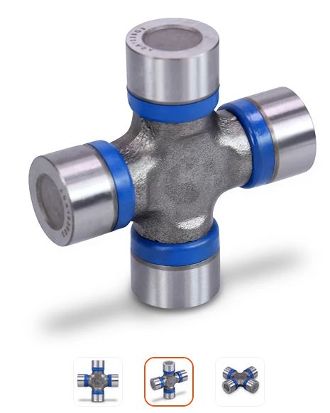

    I've found the center pieces of those U-joints at several online shops. I don't know how they are called but from the shape I'd guess something like X-joints or X-bearings. On AliExpress they are only around $5..10.
    From the picture from Rodeo5150's post above we can guess how the U-joints are assembled. You can't insert the X into the forks directly but with the needle bearing caps removed it might work. Then you can put the caps back on from the outside of the holes in the forks and the allen key screw secures them.
    The 3D-printed parts should be strong enough when pressure loaded, only. But I have some doubts what happens if an actuator accidentally pulls instead of pushing. FDM printed parts can easily de-laminate and are not very strong under tensile load.
    Complete U-joint assemblies are available as spare parts for cars. But all I've found have quite awkward shaft connections that are longer and heavier than needed for motion rigs. You'd have to cut them with the angle grinder and weld them to a base plate or (spline/toothless) shaft coupling.
    How about machining them out of aluminium?

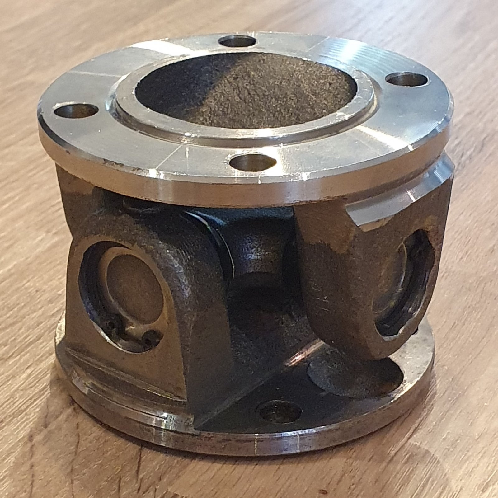

    I just bought a kei car u-joint (6 bucks only) and sent it to a machine shop to add a flange for mounting. It holds pretty well for now :thumbs
