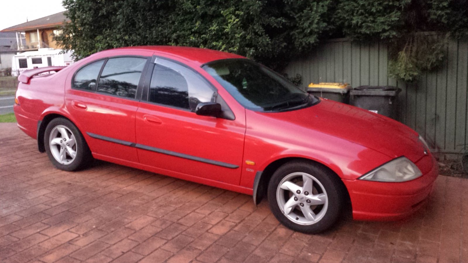

    20150613_170648.jpg Not a BA or BF
    Cost me $1900, with rego till Nov 2015, 1999 AU 4 Ltr 6cyl. 5 speed manual , 332000 kms on him, drives perfect. Id guess it has highway KMs on it. Ive had to get aircon compressor replaced and still sorting a slight rough idle. Probably needs coil pack replaced. The usual rough idle is a manifiold gasket leak. Mine might be a bit off but its not stalling, and idles fine 90% of the time. Runs perfect under power and cruising.
    The "Barra" twin cam 4 ltr is a good motor, but so is the single cam. Its a matter of finding something, preferable stock without the butt thrashed out of it and make sure it has been serviced all its life regular.
    Good thing to do with 2nd hand car, service it full as soon as possible,and take it to a good mechanic (not ultratune) for a good look over.
    But test driving it should indicate whether or not its smooth or needs work.
    overall, and this is 8 years extensive automotive experience talking (jap import, standard automotive, speed shops, drag, rally, circuit race service), generally if its an Australian built car , its designed to handle Au conditions. As for between Ford/Holden, they all have their good points.
    Japaneses cars are very good as they are designed to handle extremes, as in Japan, it can get very cold and very hot. Again, there are lemons everywhere, expect some possible repairs on any car.
