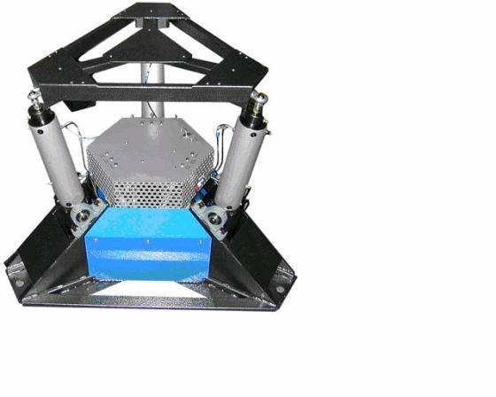

    Got hold of a Darim 3DOF motion base.
    The problem is that it expects axis values between -13311 and 13311.
    Can SimTools handle negative numbers (signed values)?

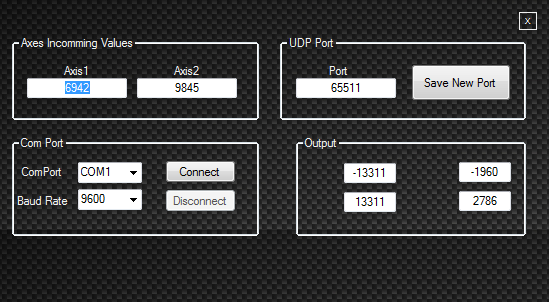

    Example of what I could supply for you.
    This utilizes the UDP fuction and remaps the variable to the needed range.
    Depending on how you need the serial port setup, this could be nearly ready.

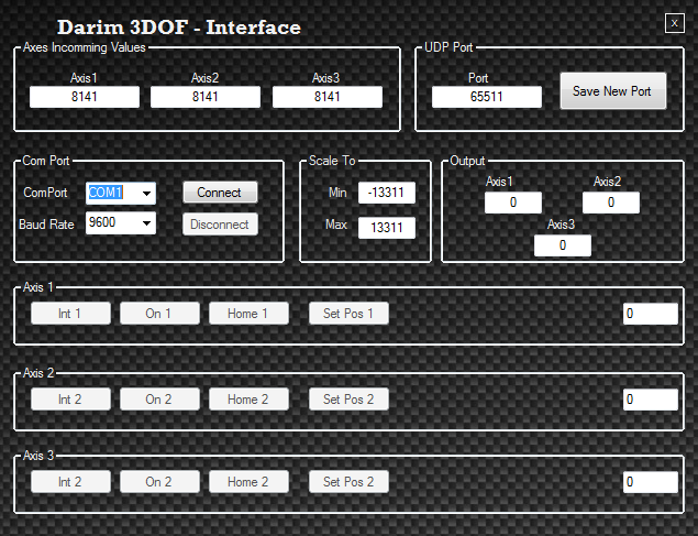

    Ok Good news I manage to complete an app that now controls the Darim 3DOF rig with SimTools.
    A bit more Beta testing with games etc to follow then I will openly release the app so anyone with a Darim 3dof can use SimTools.
    GUI needs a big clean up and simplifying but its all there working for manual testing and running in SimTools.
    Big thanks to @Bleedin we would have this without you asking for it.
