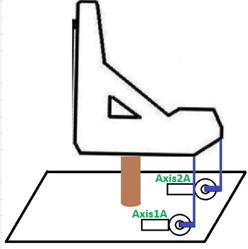

    i need help to understand how to set the direction of the forces on Game Engine "Axis Assigments".
    I have a 2 dof with 2 motors forward the seat.
    I have put the Anti-Rollover to roll and pitch but how can i set the right directions on all the forces?
    Best Regards,
    Simone

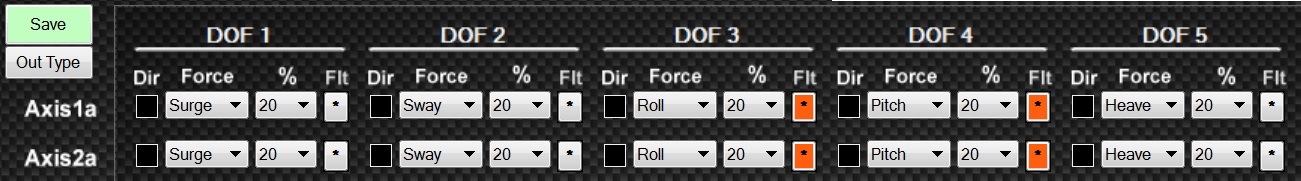

    Hi @siantic,
    The 'Dir' check box in the 'settings 2dof.jpg' pic you posted above controls the Direction of output.
    Take care!

  4. yobuddy
    5,377
    50,324Coins
    +5,149 / 18 / -0
    Setup one dof up at a time, and see if they are working in the right direction.
    For Surge, make sure the sim leans back when you hit gas, and forward when you break.
    For Sway, make sure it leans away from the corner when your turning.
    Hope that helps buddy...

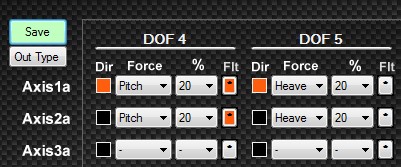

    ok i have tried one dof at a time and i have set the direction:
    I'm not sure if i set up right the direction of output of the "Heave" dof .
    How can I verify it?
    Is the "Heave" dof setup similar to another dof setup (direction of output)?

    Heave should move up when you go over a bump in the game.

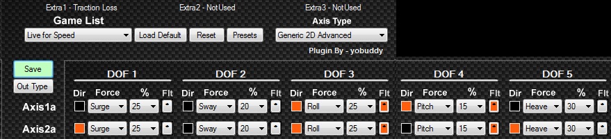

    I try to recap...
    I have 2 situations:
    A) the first installation of SimTools
    B) when i add a new game
    Recap situation "A" (first installation of SimTools):
    1a. install SimTools
    2a. configure SimTools
    3a. install LFS
    4a. patch LFS
    5a. launch LFS
    6a. open "Tuning Center" and capturing the max/min value for LFS
    - the max/min value captured go automatically on the "LFS profile" under "Game Engine - Axis Assignments"?
    7a. open "Game Engine - Axis Assignments" and do a manual adjustment enabling one Axis force at a time on the "LFS profile"
    8a. when satisfied turn on all the Axis force
    9a. save the "LFS profile" and also save as "default profile" so i can use it for new games
    10a. play the game :thumbs

    Apologies for the idiom, 'in the ballpark' means near or close to something: https://idioms.thefreedictionary.com/in+the+ballpark
    Recap situation "B" (add a new game):
    1b. install the new game, for LFS it must be run before patching for motion: https://xsimulator.net/community/faq/live-for-speed-run-in-first-person-mode-before-patching.365/
    2b. install the plugin
    3b. patch the game
    4b. open "Game Engine - Axis Assignments" and copy the "default profile" to the new game profile
    5b. launch the new game
    6b. open "Tuning Center" and capturing the max/min value for the new game?
    7b.Temporarily disable all but one axis in Axis Assignments by setting their value to zero.
    you can fine tune the Tuning Center settings for the one enabled axis by adjusting values manually and saving. Do that for each axis until you are happy each axis responds as you want, then re-enable all axis by re-enabling the original Axis Assignment values.
    For surge you can use a different Max and Min values, to simulate a gear shift: https://xsimulator.net/community/faq/snappy-gear-change-motion.121/
    See the tuning tips in the FAQs: https://xsimulator.net/community/faq/steps-to-create-a-motion-profile.228/

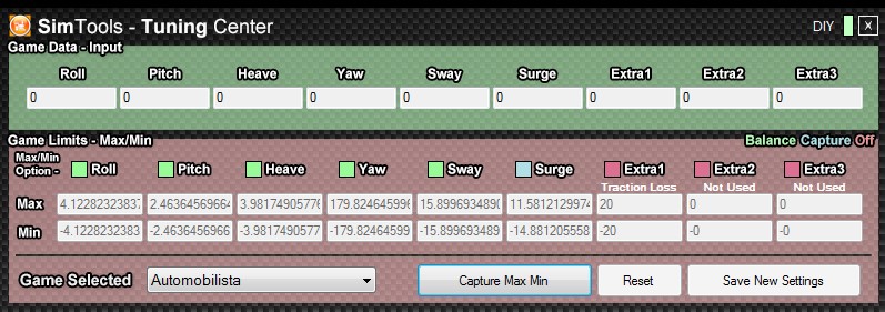

    ok i have did the Tuning Center for the "Automobilista" game:
    do I have to change this data now? and how can I do it?
    For example Roll: max 4.122... and min -4.122...
    if i change to max 6.0 and min -6.0 the rig is a more gentle response?

    Yes changing to 6 will smooth the motion, over a slightly larger range. I am guessing but heave you may want to go smaller in value, depending on your axis assignments, to simulate the finer details, given it is a 2DOF.
  20. yobuddy
    5,377
    50,324Coins
    +5,149 / 18 / -0
    This means that your sim will lean left and right with the roll input, where max roll input is +-4.122.
    So whenever a +-4.122 comes in for roll, the sim will be leaning it's full allowance for roll in the axis assignments.
    I suggest using the degrees that your sim can actually lean, as a good place to start.
    So if your sim can lean +- 20 deg, start with that and see how it goes.
