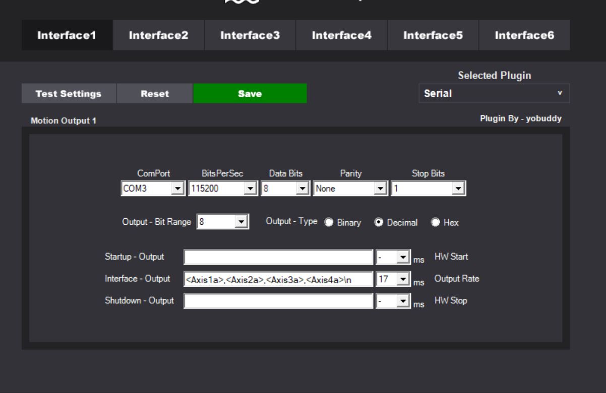

    hi, I’m using an Arduino Uno connected to a CNC shield to control my T3DL motor drivers with SIM tools controlling it, but I can’t get SIM tools to control the motors. I have verified that my wiring is correct by running a test script to turn the motors without SIM tools. so I’m pretty sure it’s an issue on the same tools. and through my research, I’m fairly certain it’s an issue with my code. but I also provided an image of the serial connection settings. I’m using.

    It's a little hard to make out, but are those commas or periods in your 'Interface-Output' in the Simtools settings?

    There commas
