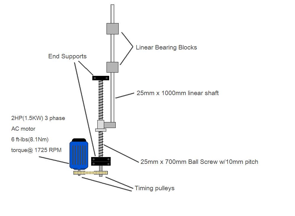

    I don't quite understand how you calculate the continuous stall torque of a motor. I realize that the stall torque is the torque required to stall the motor so that the rpm's are at zero. But given the calculation for torque of a motor, with a known HP or KW value:
    Torque = (5250 x HP) / RPM =
    Torque = (5250 x 2) / 1 ----(can't do zero, because it would equal zero) =
    Torque = 10500/1 =
    Torque = 10500 ft-lbs (14236 Nm)
    It just doesn't make sense to me. That sure is a lot of torque!
    Adgun, you said I need about 2Nm of stall torque for 100Kg(220 lbs), which is basically the same load that my actuators have to support anyway. 2Nm is equal to 1.475 ft-lbs, which is roughly the same amount of required torque that I calculated to move each actuator with a load of 200 lbs(90Kg). From this information, it looks like the torque to move the load and the stall torque are the same thing. :?
    I did calculate the required torque to lift my cockpit (per actuator). Roughly my cockpit with a 250 lb(113Kg) rider will be at max 450 lbs(204Kg). I know you can't just divide the total weight by the number of actuators because it won't give you the true amount of weight that each actuator should be able to handle, so I divided by 2.25 and to give room for error and came up with approximately 200 lbs(90Kg) per actuator. In order to lift 200 lbs(90Kg) with the ball screws I have, the motor needs to be able to supply approximately 1.3 - 1.4 ft-lbs(1.76 - 1.89 Nm) of torque. By this information, all I would need would be a 3/4 HP(.56Kw) motor turning at 3000 rpm's. The slower the motor turns, the more torque it puts out. The 2 HP motor I'll be getting should easily be able to do that.
    So from all of this information, is my motor's stall torque sufficient enough for this application or am I missing something?
    I've also attached a rough drawing of the actuator I plan to build so you guys can understand what I'm trying to do a little better.
    (Edit: Don't know how or it won't let me attach an image file. I guess I'll figure it out later.)

    Here is a rough drawing of the actuator I'm trying to build. Hope this gives you guys a better understanding of what I'm trying to do.

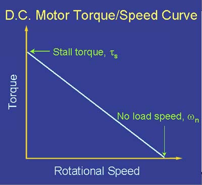

    The needed stall torque is simply the amount of rotational force needed to keep the axis in one place and is exactly the same force as gravitation excerts to the arm e.g. F=m*a (plus some more as some of the force is lost in the system, remember efficiency)
    Torque is quite linear in relation to speed and as the rpm increases torque decreases and vice versa, mostly it can be said that stall torque is higher than the running torque.
    If you get stall torque to be the same as force needed to lift the arm then you might have forgotten to add the force pulling the sim down on your equations, e.g. force needed to lift sim up is F=m*acceleration of gravity + m*wanted acceleration up. On my examples I calculated with wanted acceleration to be 1G or exactly the same amount as acceleration of gravity.
    Summa summarium:
    stall torque > F=mass on one axis * 9,81m/s/s
    maximum force needed to lift F=mass on one axis * 9,81m/s/s PLUS mass on one axis * sims acceleration

    I think I've got it figured out now. I did some calculations last night and here's what I came up with.
    Force on each axis = 90Kg(~200lbs)
    Force of Gravity = 9.81m/s^2
    Lead Size of Screw = 10mm(~0.4in)
    Force on Axis at rest = 90Kg*9.81m/s^2 = 882.9N
    Force on Axis up while accelerating at 1G = 882.9N + (90Kg*9.81m/s^2) = 1765.8N
    Torque to lift axis up at acceleration of 1G = (1765.8N*10mm)/(6280*0.8eff) = 3.51Nm(~2.6Ft-lbs)
    Stall torque = (882.9N*10mm)/(6280*0.8eff) = 1.75Nm(~1.3Ft-lbs)
    Preferred Axial Velocity = 400mm/s (~15.7in/s)
    Required RPM = 400mm*60/10mm = 2400 RPM
    Required motor HP = (2400rpm*2.6Ft-lbs)/5250 = ~1.2HP (895W)
    So a 1.2HP(895W) motor at 2400rpm's should give me 2.6Ft-lbs(3.51Nm) of torque at an axial velocity of 400mm/s. In all reality though, I would go with a bigger motor of course because I wouldn't want to run the motor at max capacity for fear of shortening the lifespan. If I went with a 2HP motor, the true HP would be:
    This is based off a motor I'm looking into purchasing:
    Volts*Amps*Efficiency% = 208v*6.15amps*0.8eff = (1.37 True HP)
    So I might even need to go with a 2.5HP so there won't be as much stress on the motor. What do you guys think?
    Also, based on my calculations (if they're correct), would you think the motor in question would have enough stall torque for my application? I still don't know how to find the stall torque of a given motor other than looking at the data sheets for the motor. And I'm very skeptical of used motors having data sheets still intact.

    Motors need to run at zero speed and produce torque at the same time. While driving along a race track at even speed the actuators would stay put...
    All induction motors are squirrel gage motors and 3000rpm motor will run faster ofcourse than lower rpm motor when driven with the same frequency.
