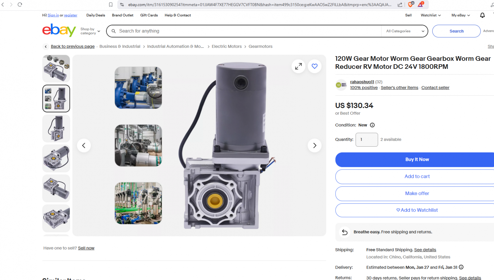

  5. kai
    kai New Member
    Jan 23, 2025
    16
    124Coins
    are these good
    21,487
    150,542Coins
    +11,017 / 55 / -2
    Those are going to be about twice your stated budget of $100 aus dollar, and if outside the USA you need to also consider shipping.
    If you are looking for budget friendly but still powerful options then consider 24v wheelchair motors, which are available new and secondhand.

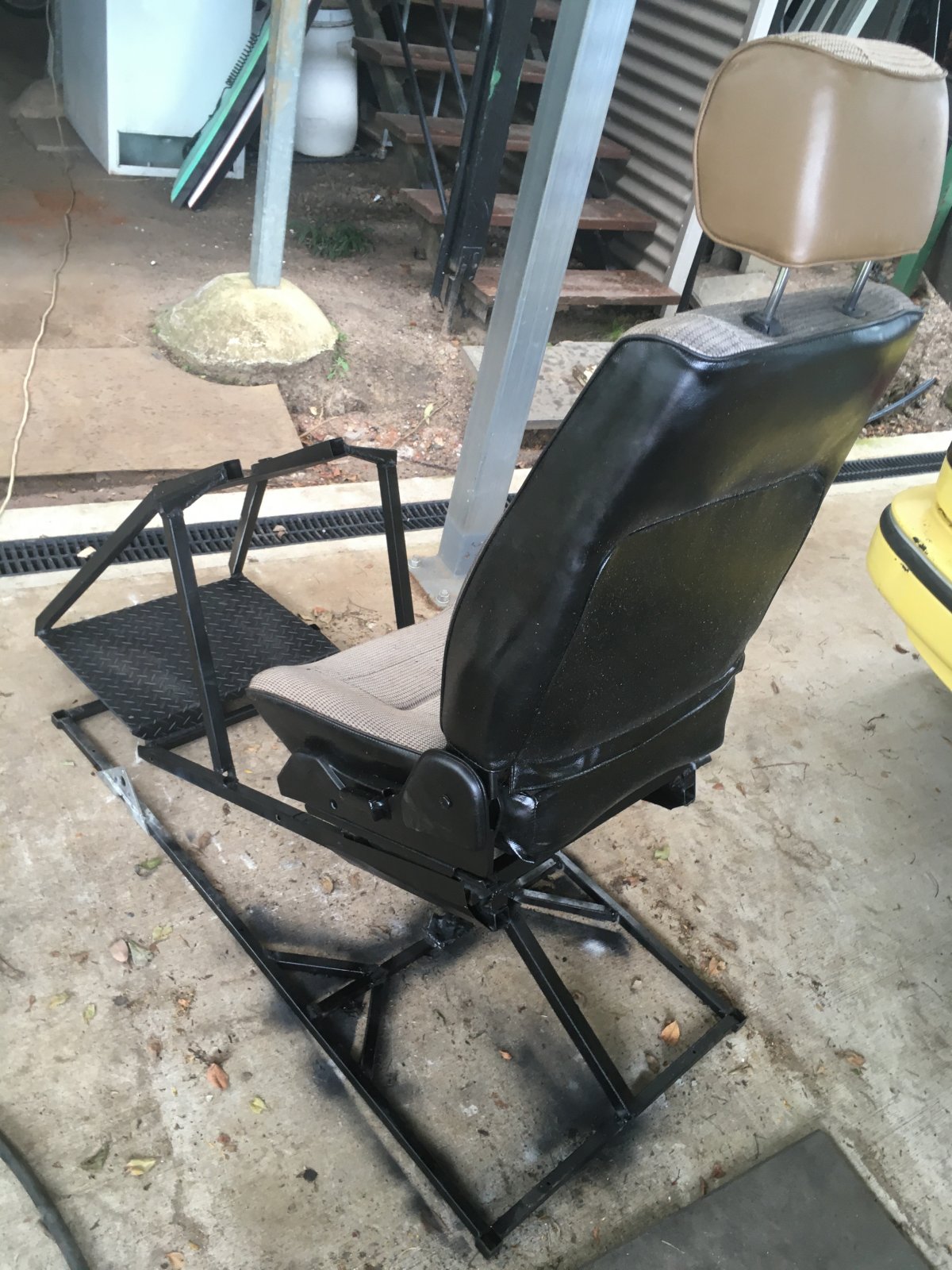

    ive already made the whole thing
    21,487
    150,542Coins
    +11,017 / 55 / -2
    Please post some pictures so we understand what the design is.

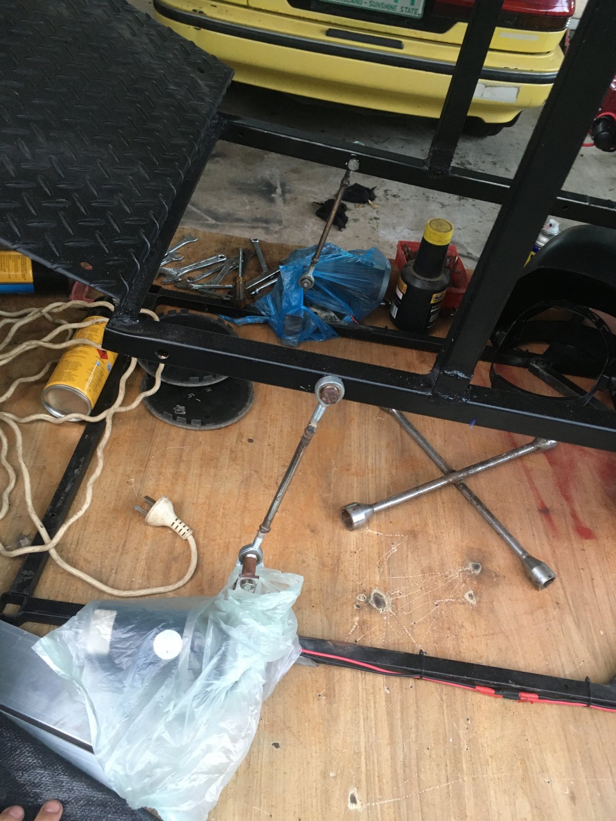

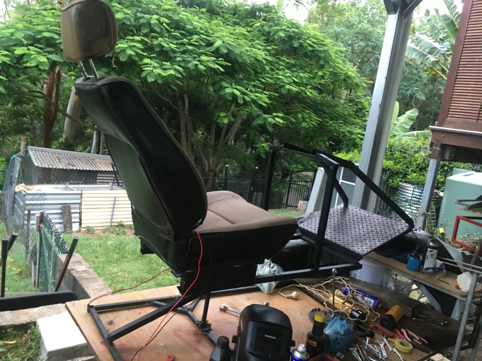

  11. Joe Cortexian
    Sep 8, 2021
    148
    887Coins
    +32 / 0 / -0

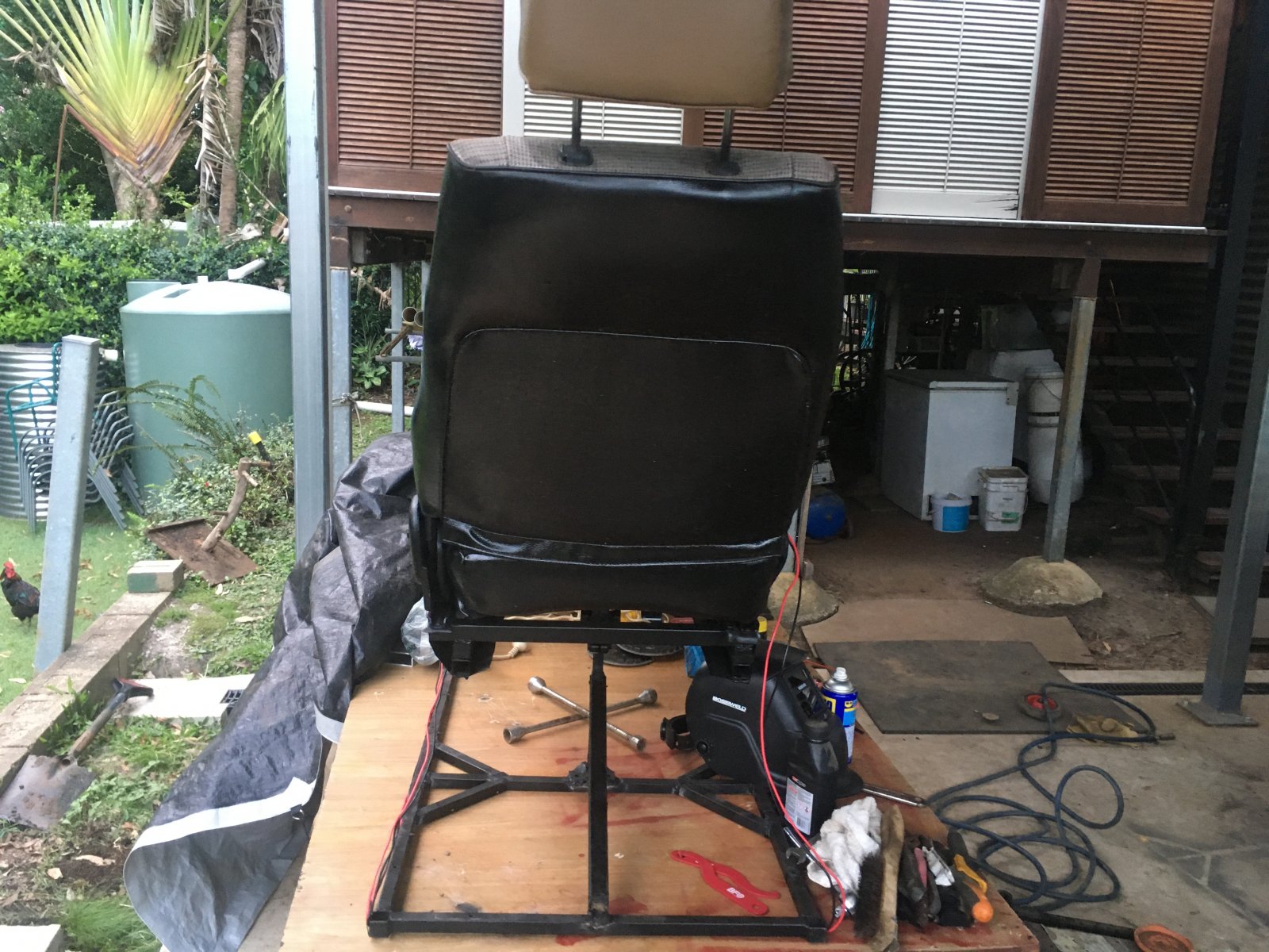

  12. kai
    kai New Member
    Jan 23, 2025
    16
    124Coins
    there you go
  13. noorbeast
    21,487
    150,542Coins
    +11,017 / 55 / -2
    Nice job :thumbs

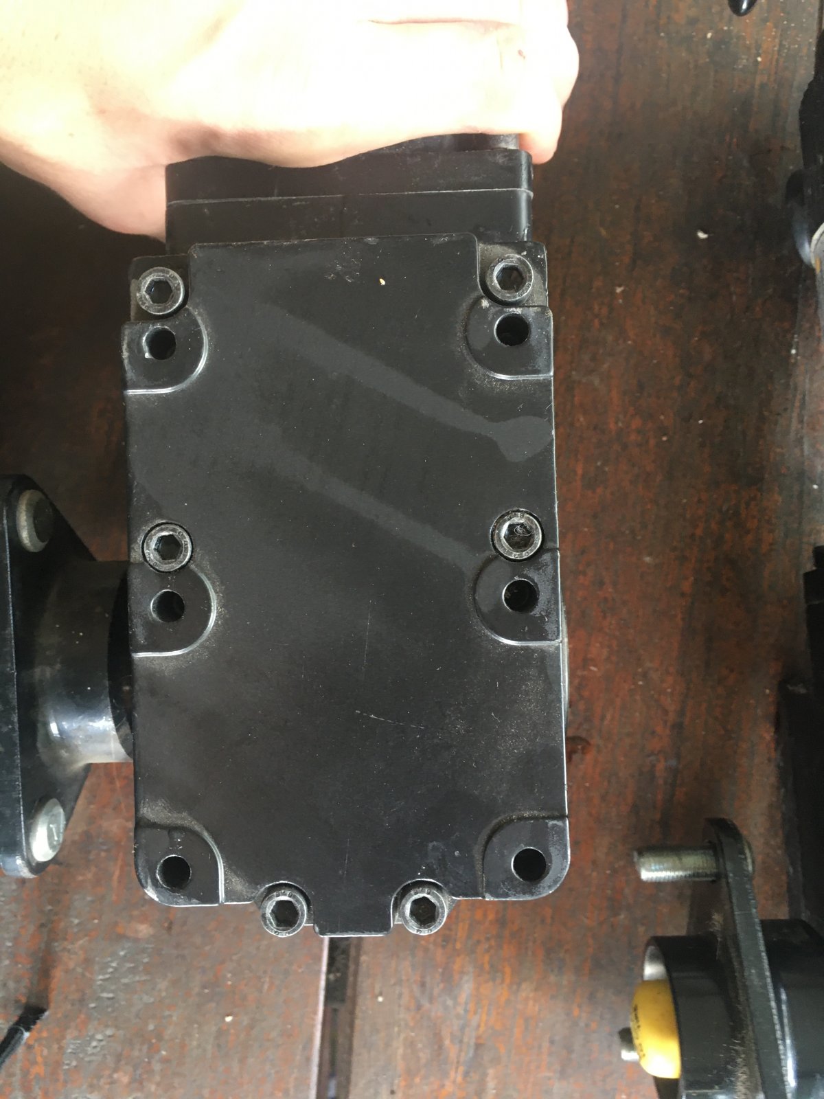

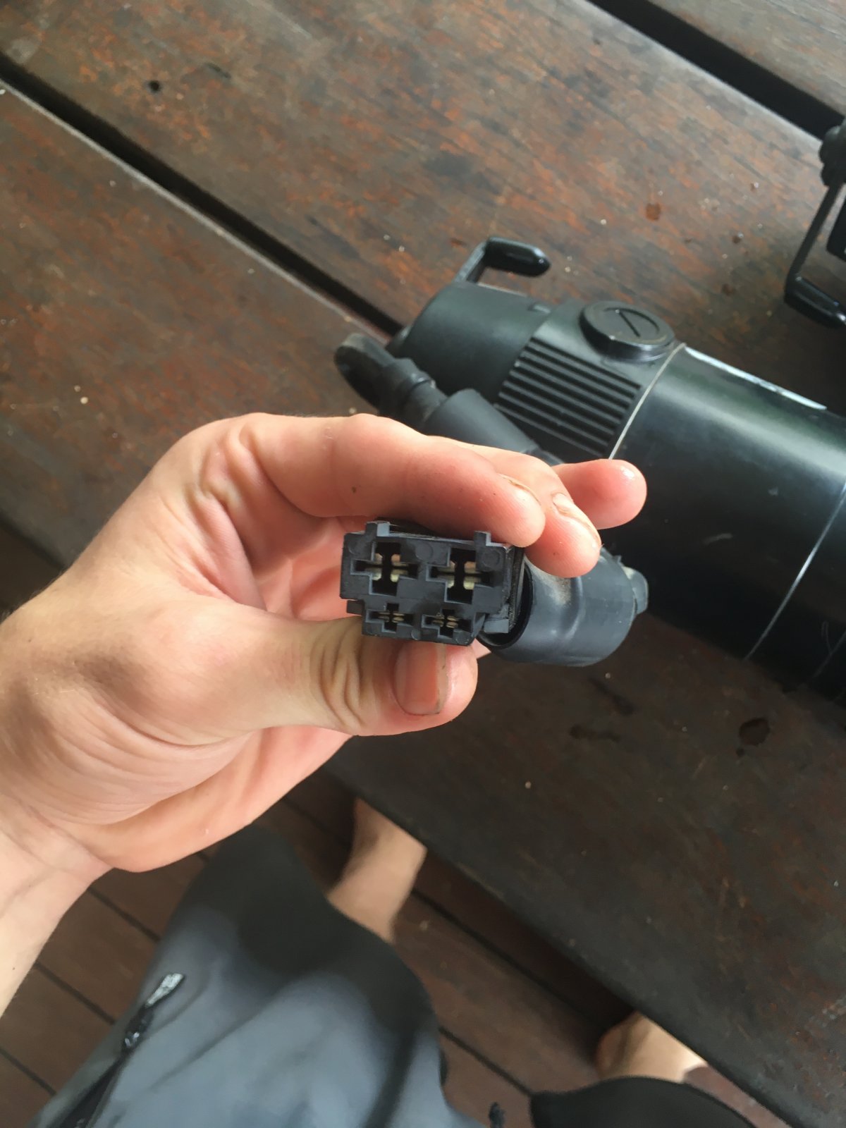

    I am curious about the specs of the motors wrapped in plastic?
  14. kai
    kai New Member
    Jan 23, 2025
    16
    124Coins
    they are the reason im here there not powerful enough they have more torque in one direction than the other and their only 2 a 45 watt 24v

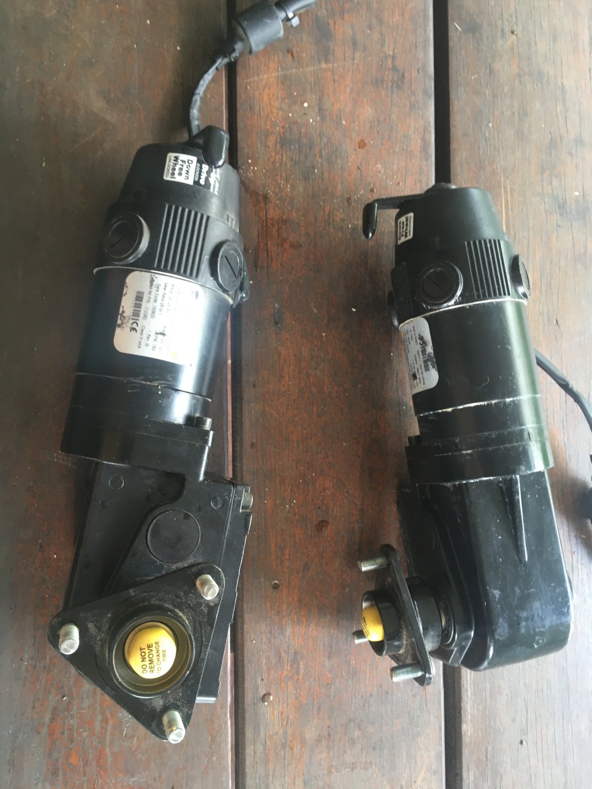

    In that case may I suggest you can at some point in the future perhaps repurpose the use of your existing motors for a telemetry driven race harness: https://xsimulator.net/community/faq/harness-tensioner-simulation.361/
    Depending on where you are in the world I suspect secondhand or new 24v wheelchair motors are likely an economical choice, given your existing foot mount design.
    But given you mentioned $AU, if I presume you are an Aussie, then we have Motion Dynamics as a reputable and convenient local DC motor supplier: https://www.motiondynamics.com.au/

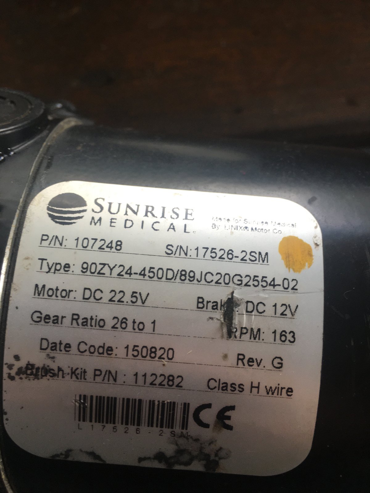

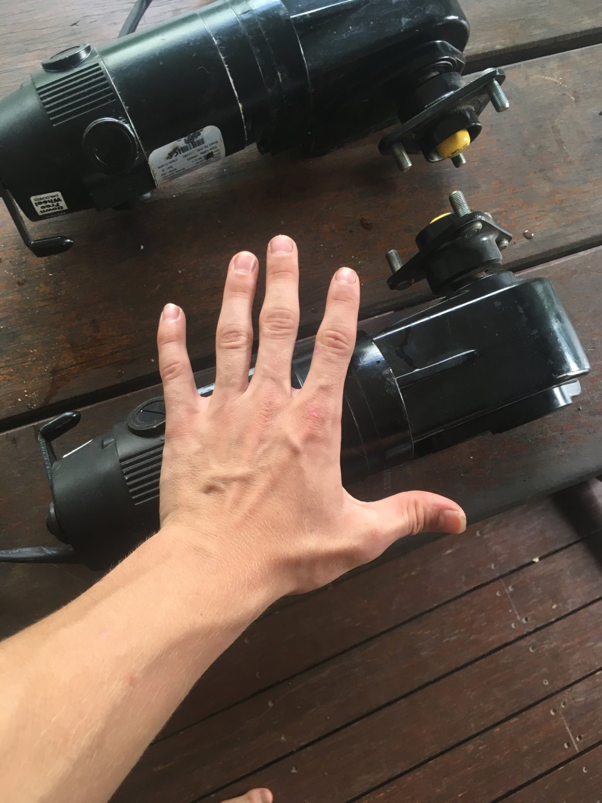

  20. kai
    kai New Member
    Jan 23, 2025
    16
    124Coins
    i got some motors from a mate and he works on electric wheelchairs they are heafty!!!!
