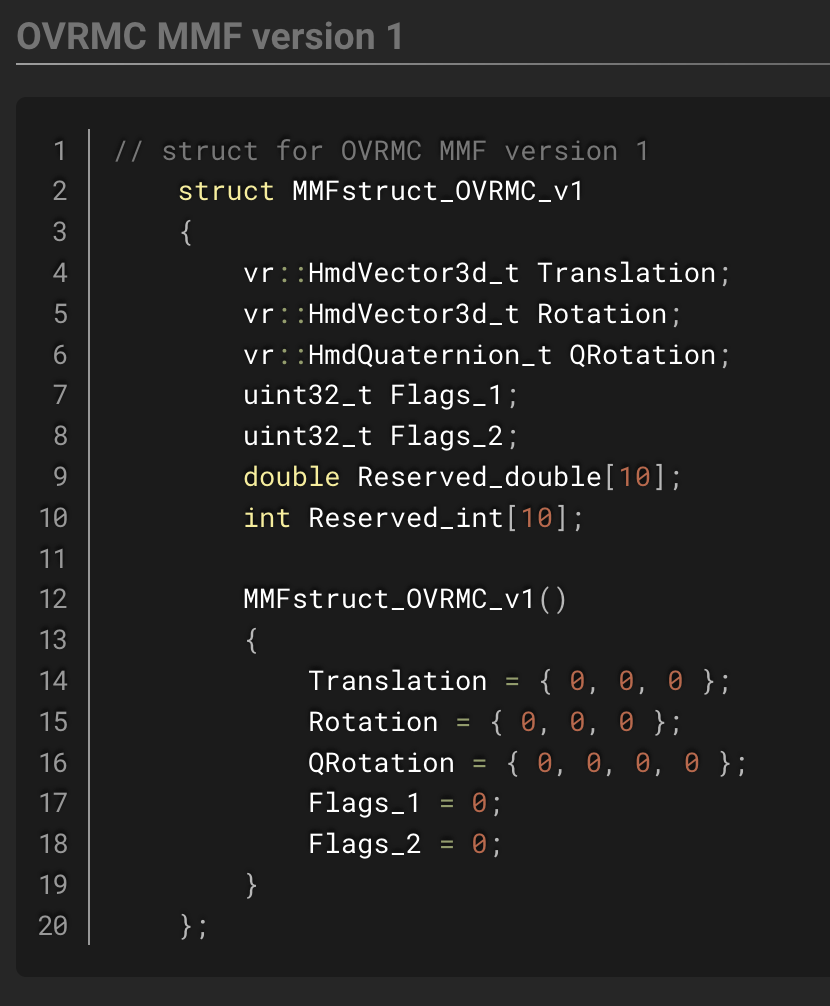

    In my motion cueing software (YAME) I would like to implement a virtual tracker that talks to OVRMC via a MemoryMappedFile. As far as I understood, the MMF only contains a Struct that holds the necessary data:
    I already have all the necessary data to fill this struct, but since my software is written in C# there is no library for it, so "vr::HmdVector3d_t" is an unknown type.
    I was thinking that for the MMF it shouldn't make a difference, as long as the bits & bytes are written in the right places. So my question is: Can I just use a simple Vector3 instead? It's just three doubles, right?
    Can anyone help me with some example code to write to the MMF that does not require an OpenVR Library?

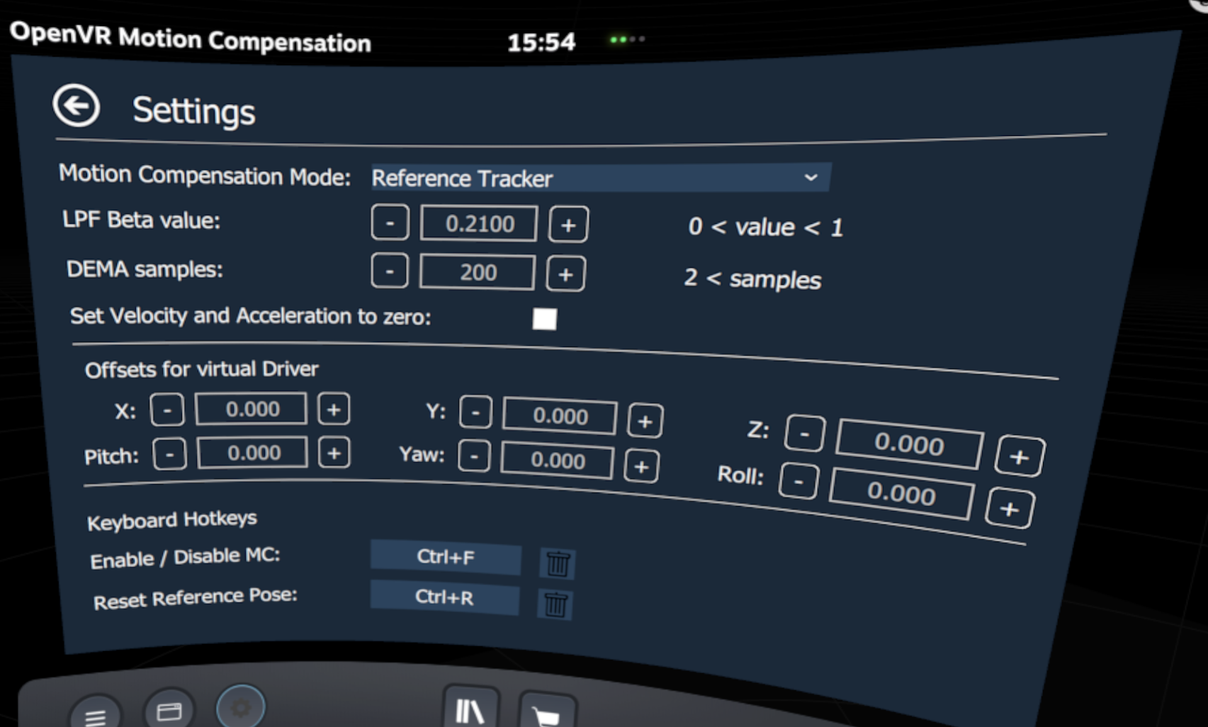

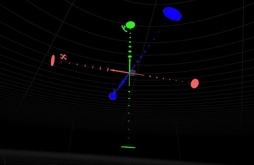

    Oh and re reading your post I see that you think the origin shouldnt matter. It wont matter for translation. But it will for rotations.
    This is what you see in vr. For translations you need to rotate yaw to line up with your rig.
    Here is where you input the origin coordinates and rotations to line up with your rig.
