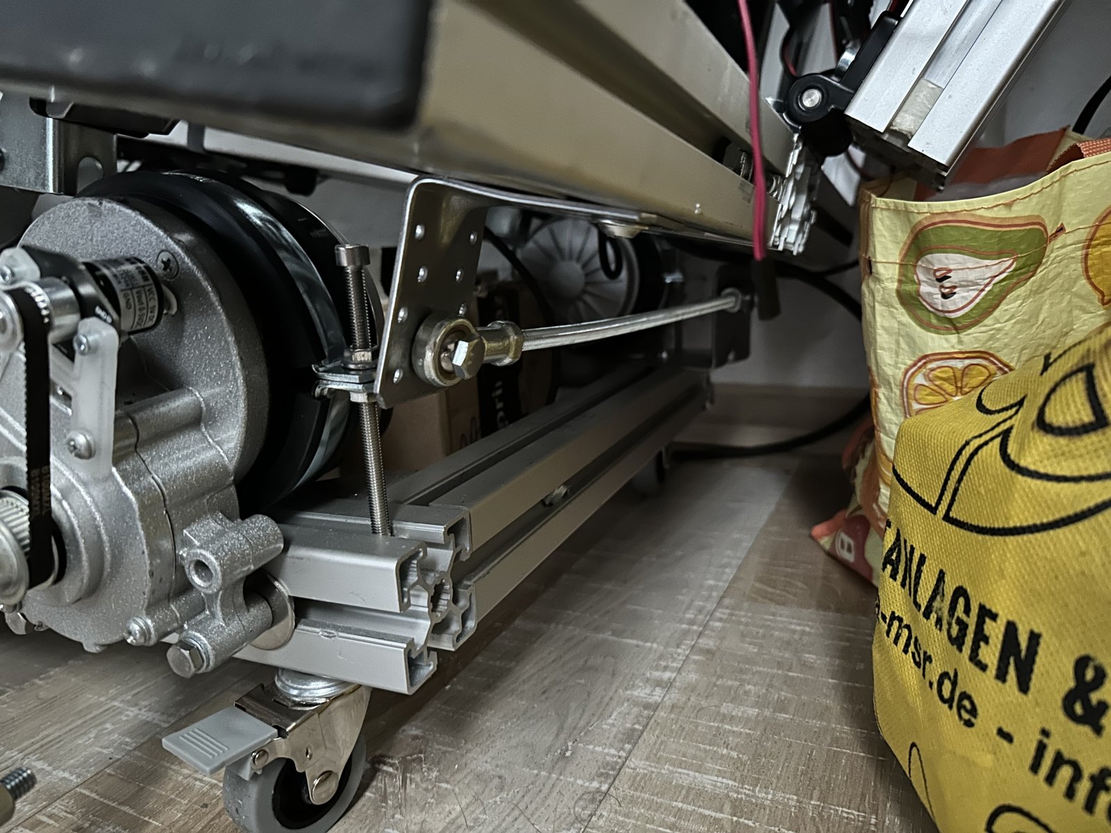

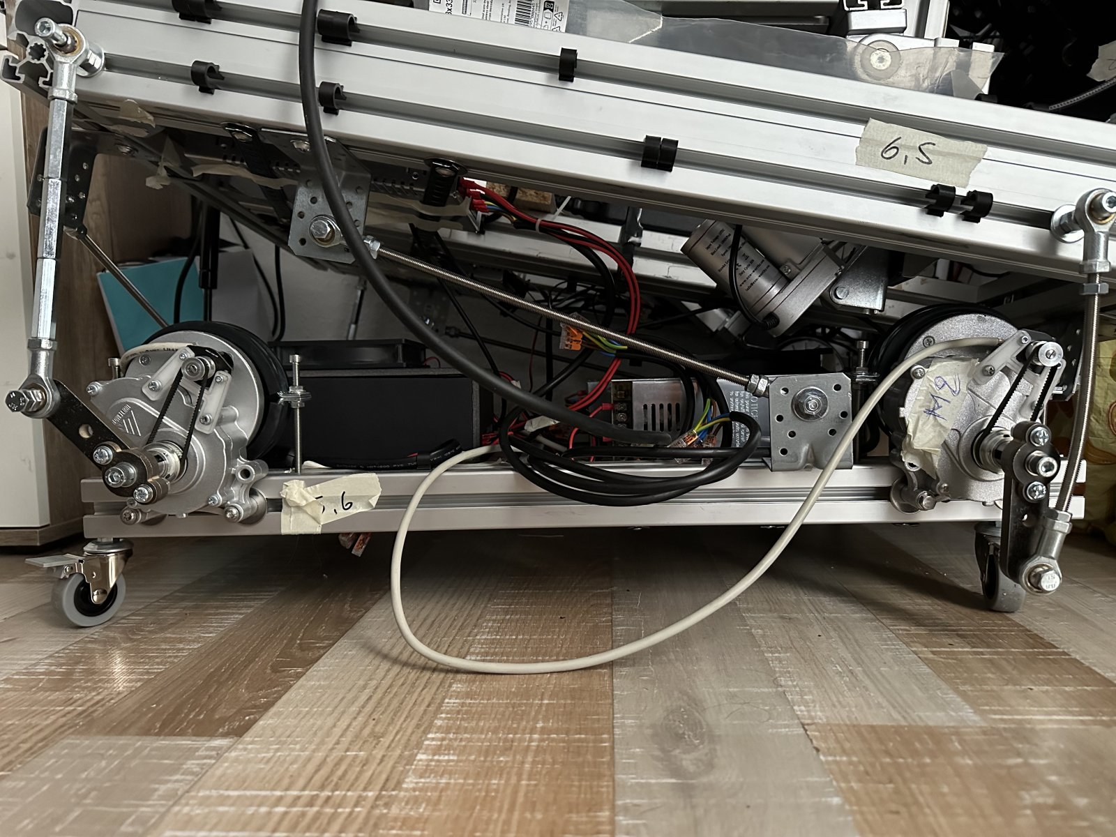

    I’m encountering challenges with the Simujit SK1 design. Currently, I’m utilizing four 250W, 24V wheelchair motors, each providing 75 RPM and 36Nm of torque.
    To stabilize the structure, I’m using four rods. However, I’m experiencing significant creaking noises with the motion.

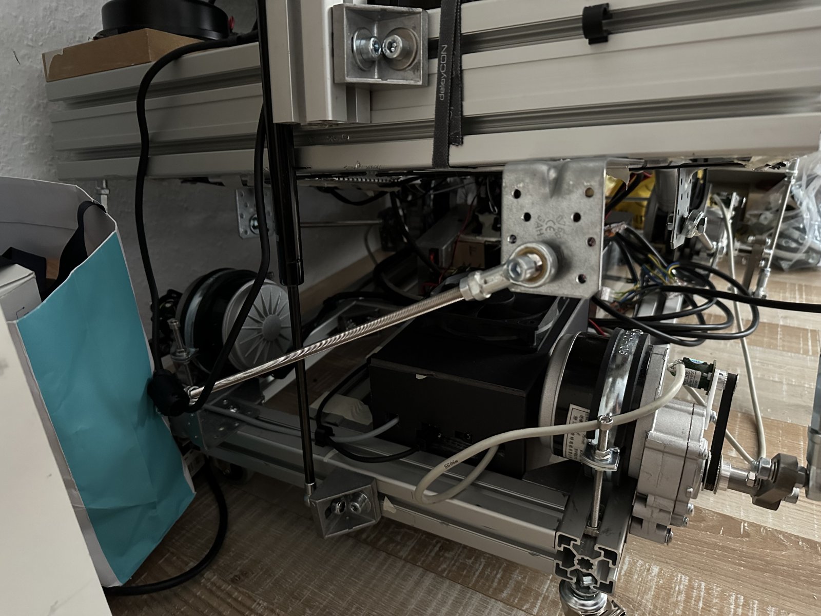

    Could anyone advise on how to calculate the optimal length and positioning of these stabilizing rods?

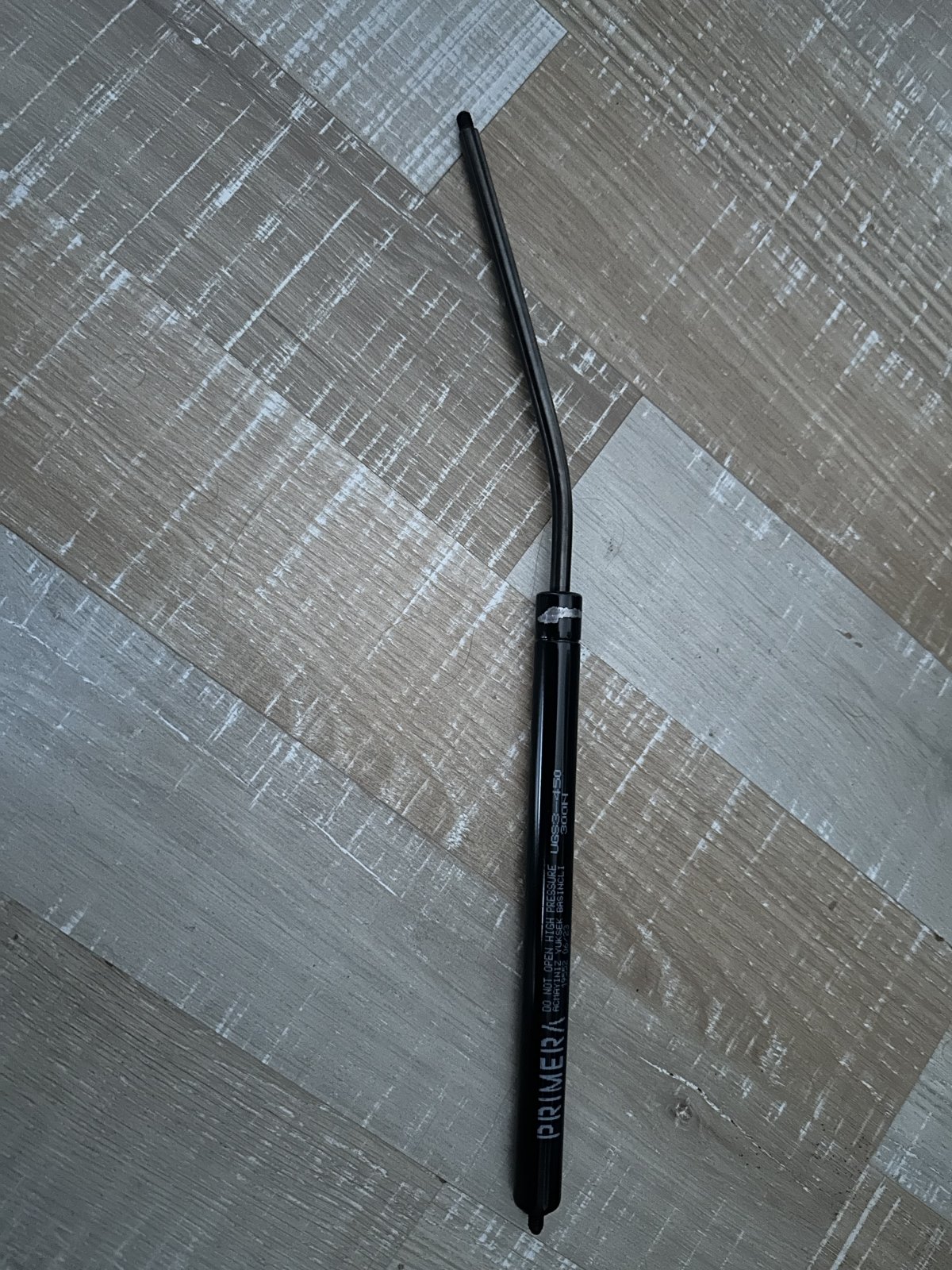

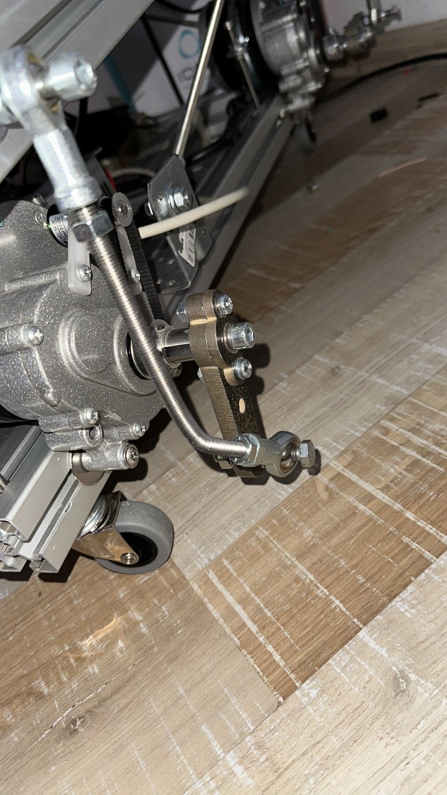

    Additionally, I enhanced the setup with gas dampers, which significantly improved the 3 DOF (degrees of freedom) experience. However, issues arose when the front stabilizing rod became loose and subsequently bent, affecting both the gas damper and the left front rod, as illustrated in the attached pictures.
    All stabilizing rods are made of stainless steel, size M8, and measure 330mm in length.
    Thank you in advance for your assistance!

    As you have found threaded rod needs to be reinforced with tubing.
    My guess with the stabilisation rods creaking is that they operate longitudinally as a pair, which may be an issue of geometry, as both the front and rear levers travel through an arc, effectively lengthening and shorting the space between them when doing so.

    I can't imagine how a single stabilizing rod for the transverse direction in the middle can prevent the front from drifting.
    The original design includes three rods: two for longitudinal stability and one in the center for transverse stability.
    However, I believe this solution will be effective.

    Know the front rods are reinforced with tubing and additional add 2 Gas damper, so in OFF position the lever not going beyond the 0 or 360 of the hall sensor.. since I am using 2:1 ratio. I wanted to change it to 3:4 ratio so it has a range 270 degree intead of 180...
