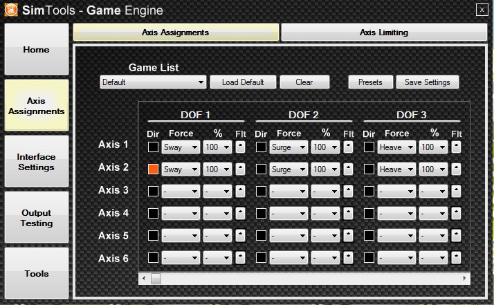

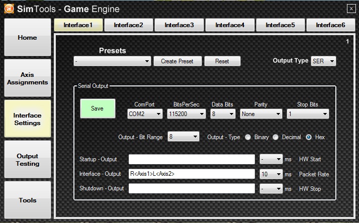

    @RacingMat , this is my wiring and simtools screens..

  12. abah_masha
    abah_masha New Member
    Sep 13, 2015
    29
    Indonesia
    130Coins
    +18 / 0 / -0
    Hi @noorbeast ,
    I have done it before, 60% in simtools, but my wiper motor only rotate 40 degree, sway when stop still hapend and i don't know why? :( then I do 100%, and i get about 90 degree rotation. "sorry for my english" :grin
    Thank's for link.. I will do like it soon.

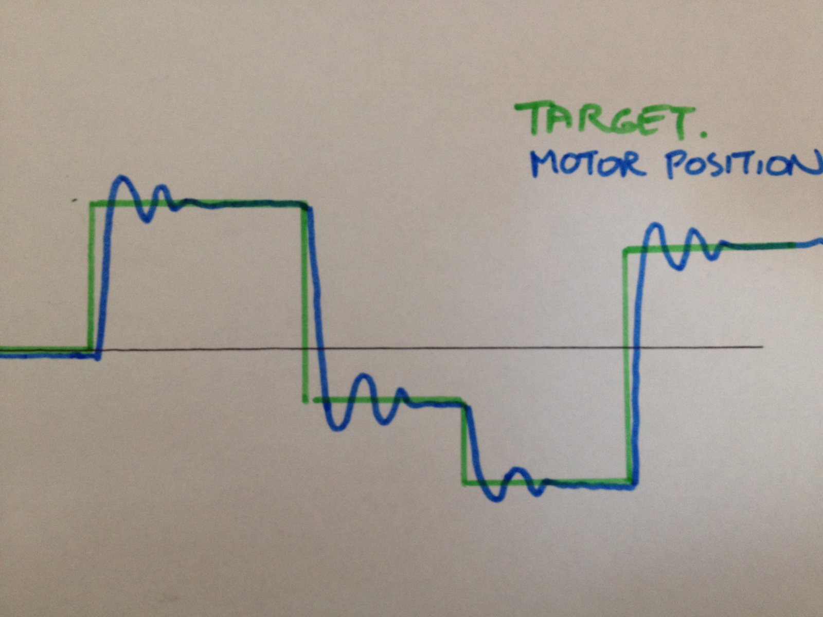

    @abah_masha if the behaviour is still the same as the first video you posted then your system is really working as expected. What you are seeing is overshoot from the motor positioning (technically referred to as an underdamped feedback system). This is corrected with the gain parameters in your software. The diagram below hopefully shows what I am referring to...
    As far as I can see in the video the motor moves to the position you request, therefore mechanically, electronically, software, is all working, just needs some fine tuning.
    If there is something else happening that isn't shown in the video let us know.
