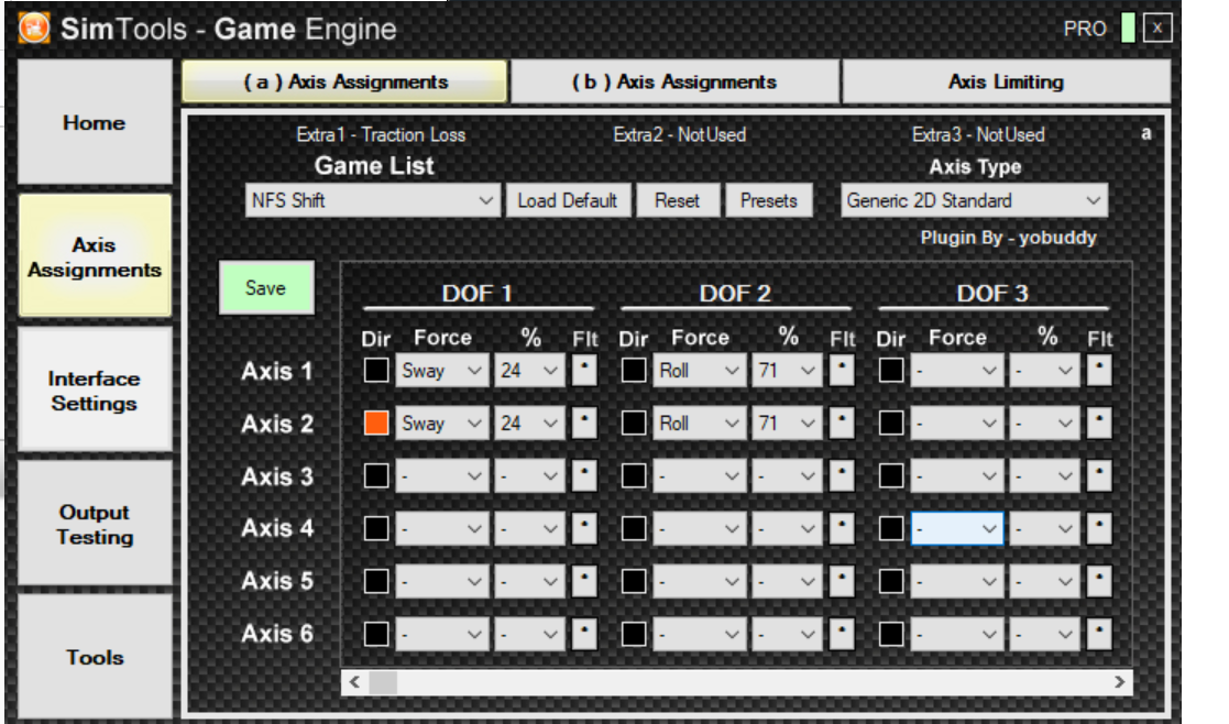

    I was looking for a Need For Speed Shift 2 Plugin, but can't seem to find one. Does anyone have a link to a plugin for the game thankyou.
  2. yobuddy
    5,166
    48,210Coins
    +5,038 / 16 / -0
    @Travis
    I believe you use the Need for Speed shift plugin for both games buddy.
    (Shift 1 and Shift 2)

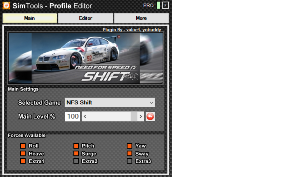

    I have tried the plugin for Need For Speed Shift. But it does not detect in Shift 2. Any ideas?

    I just had a look. Sorry my mistake it was a old link in the downloads section that has that file (don't download). But yeah that is the file I am using you listed. It works on Shift 1. But Shift 2 there is no movement in-game.

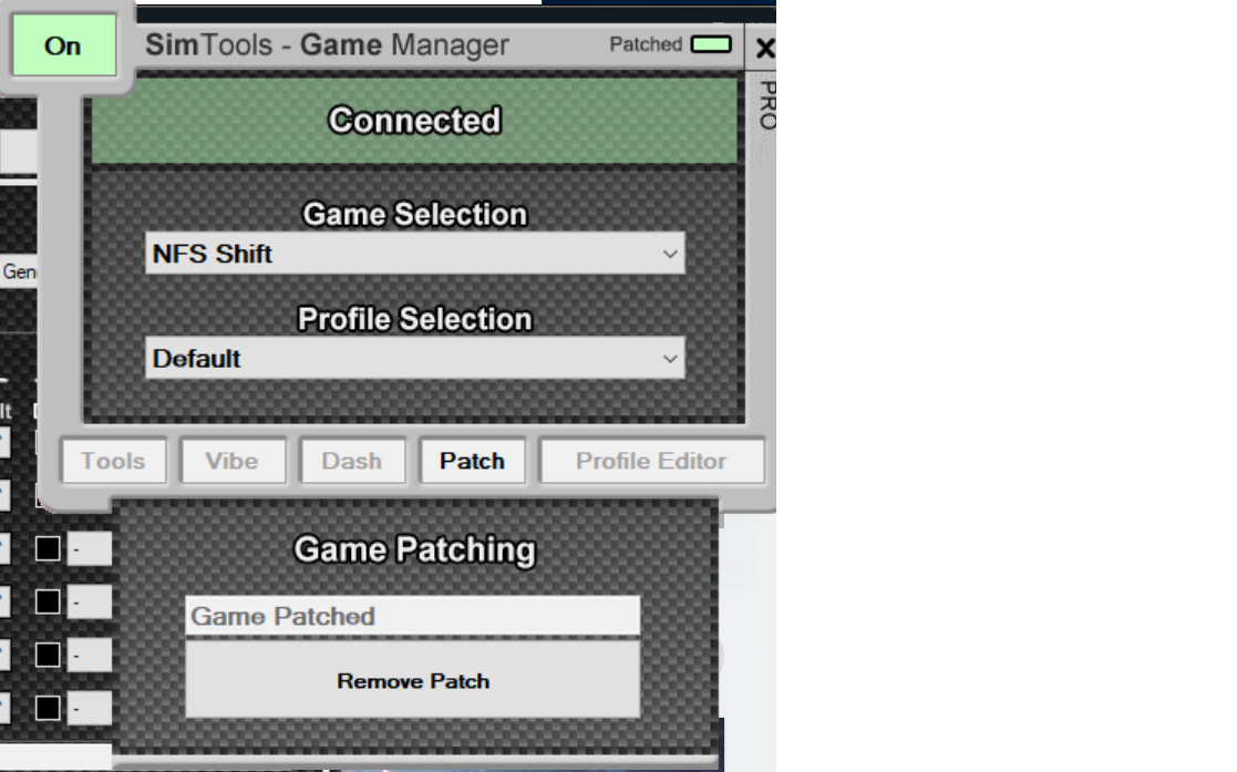

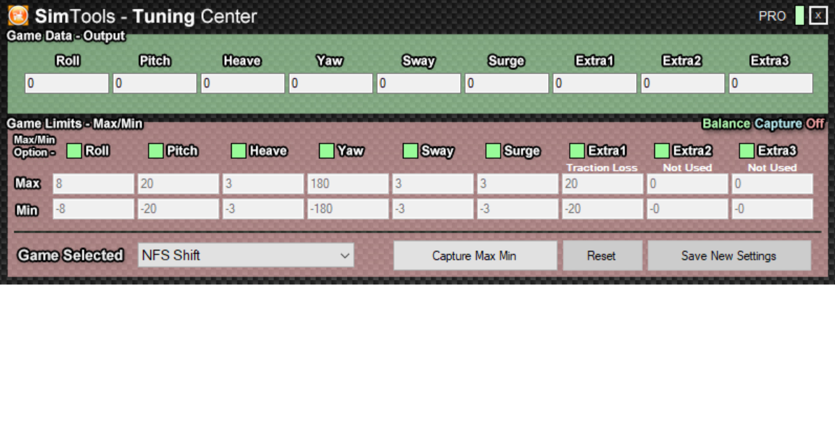

    What patch path are you using for Shift 2 and did you recapture Tuning Center values once patched?

    I just hit patch game and that is all I have done. How do I change the patch path to Shift 2 directory?

    Game manager doesn't say Game running when opening Shift 2. But it does for Shift 1

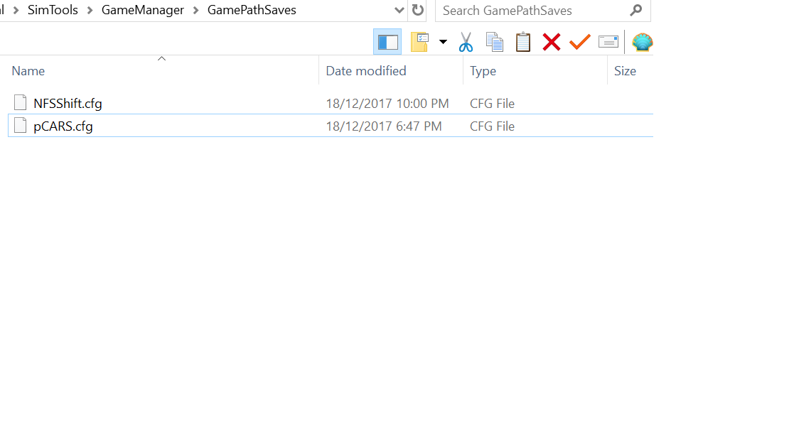

    If it does not give you the option to select the patch path then try doing it manually by editing the relevant file here: C:\Users\YourUserName\AppData\Local\SimTools\GameManager\GamePathSaves

    What do I have to do to the files? If I open them with notepad. It just says Game Patched.

    Perhaps @value1 can advise if adding the Shift 2 path manually works or not.
