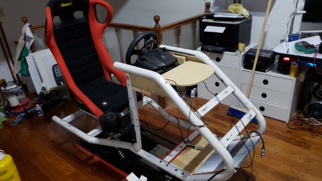

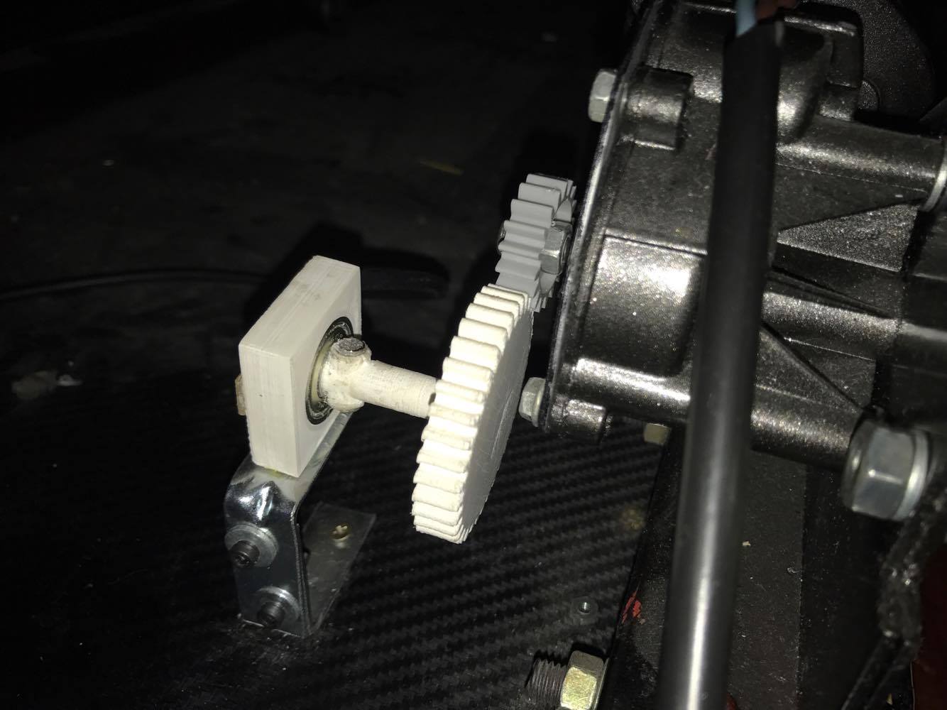

    Hello, I'm back again after 9 years it's time to say...
    IT WORKS!!!!
    Arduino uno + Moto Moster Shield + Wiper Motors +DIY Hall Effects Pots.
    Tomorrow I'll upload more Info.
    Wiper motor with new look!!
    3d printed gearboxes for Hall Effect DIY pot.
    Where the magic comes true... arduino...

    Thanks for sharing your rig, it is great to see it in action :thumbs
    Can you please adds some more detail about the hardware, particularly the DIY Hall Effects Pots, and also your peripherals.

    3d print gears and magnet places
    DIY Hall effect 3d Printed Gear. Allegro 1302.
    90º to 180º gears (more resolution) full range simulator arm

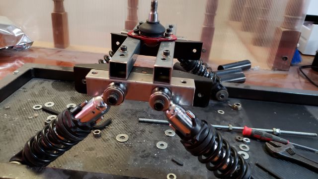

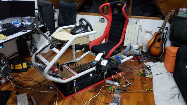

    Nice rig - What is the origin of the frame?
  9. ne02005
    ne02005 Member
    Sep 19, 2009
    124
    Argentina
    105Coins
    +29 / 1 / -0
    Thanks it's Tailpipe. Mounted on 4 motorcycle monoshocks. They give height and shock absortion on seat. And looks very nice. :)

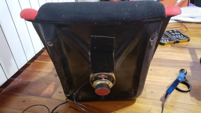

    I've added a 5.1 surround system (cheap)... and the subwoofer is on back of the seat.
    [​IMG] e
    Bass shaker..or Ass Shaker...

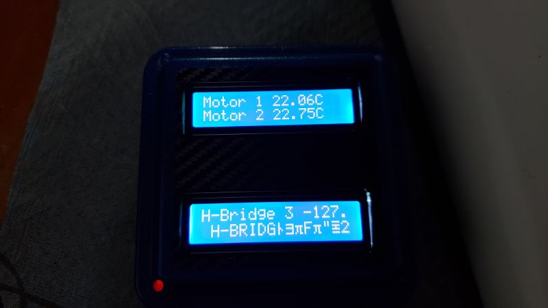

    New Temperature monitor (Hbridges and Motors)

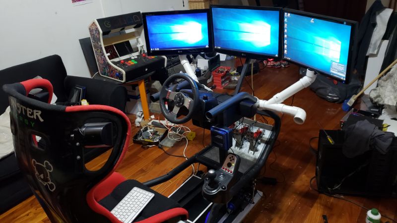

    Triple screen setup

    Monitors are different sizes... but it looks enough good.
    And the best thing... the screens moves with the frame!!!.
    That is a picture from Asetto Corsa

    New pc case wood box All in a box! Into simulator...

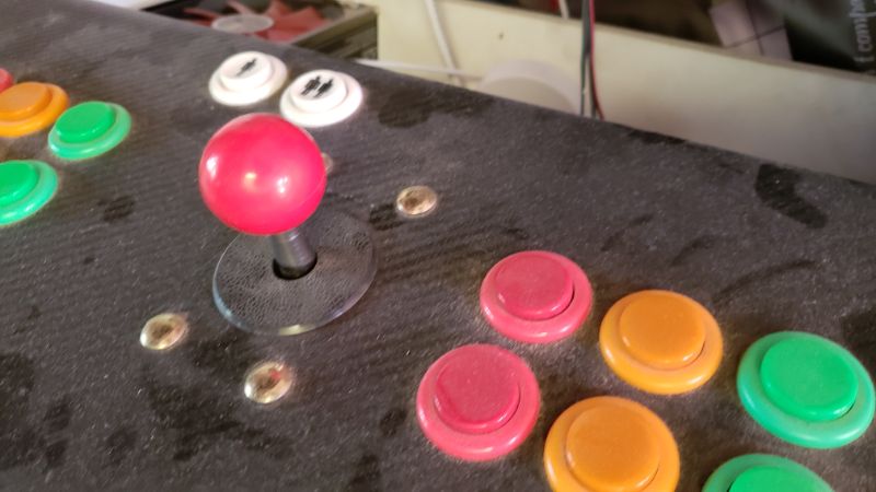

    New secuential shifter... made from a arcade joystick
  20. ne02005
    ne02005 Member
    Sep 19, 2009
    124
    Argentina
    105Coins
    +29 / 1 / -0
    just need solder the cables to the g27 wheel!. I'm not want to use an arduino for only two contacts
