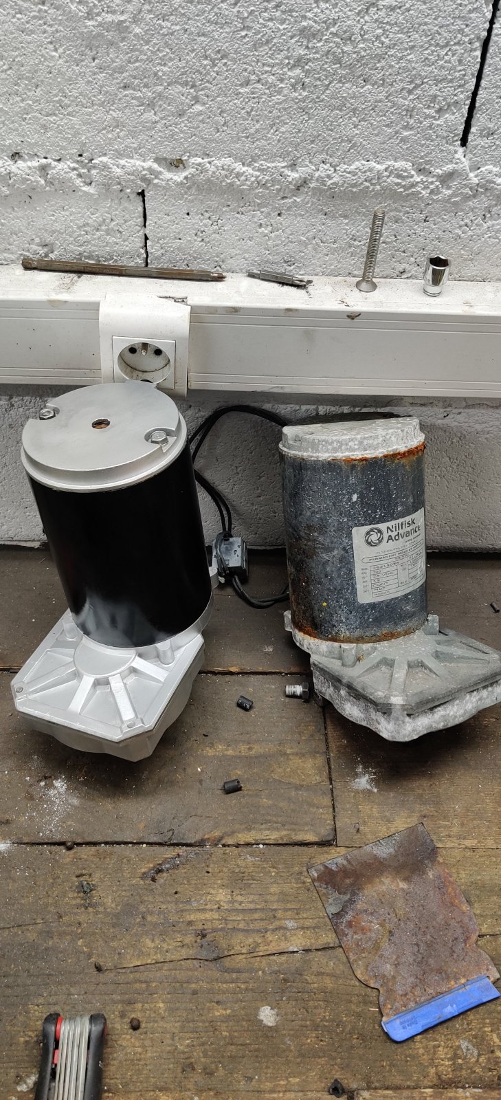

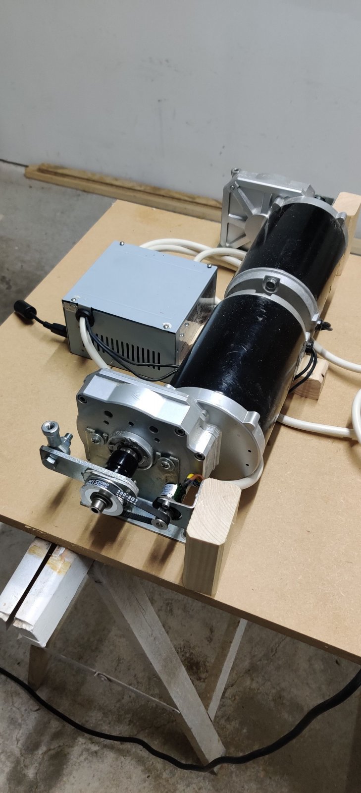

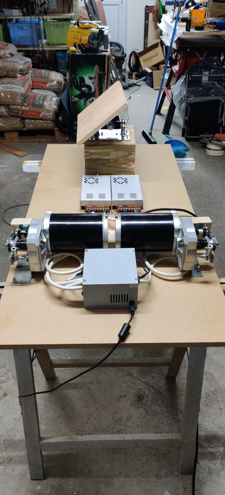

    I recovered at my work two 24V/350W motors with integrated reducer, these are brush motors for floor washers.
    Here is the result after renovating them, bearings, seals...

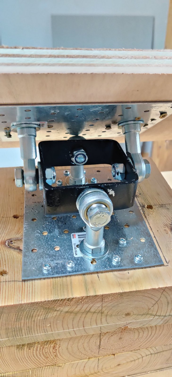

    Making a homemade gimbal... Inspired on the forums.
    3cm steel plate bent, welded, four holes, a little paint and here is a gimbal!!!
    I had looked for gimbals like the one used by @raté but couldn't find on Amazon, aliexpress... or too expensive at tractor parts sellers.

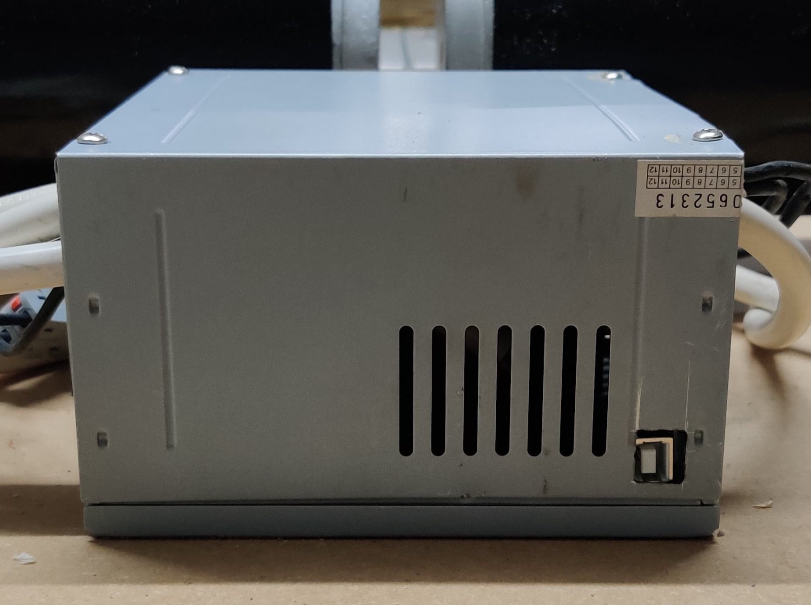

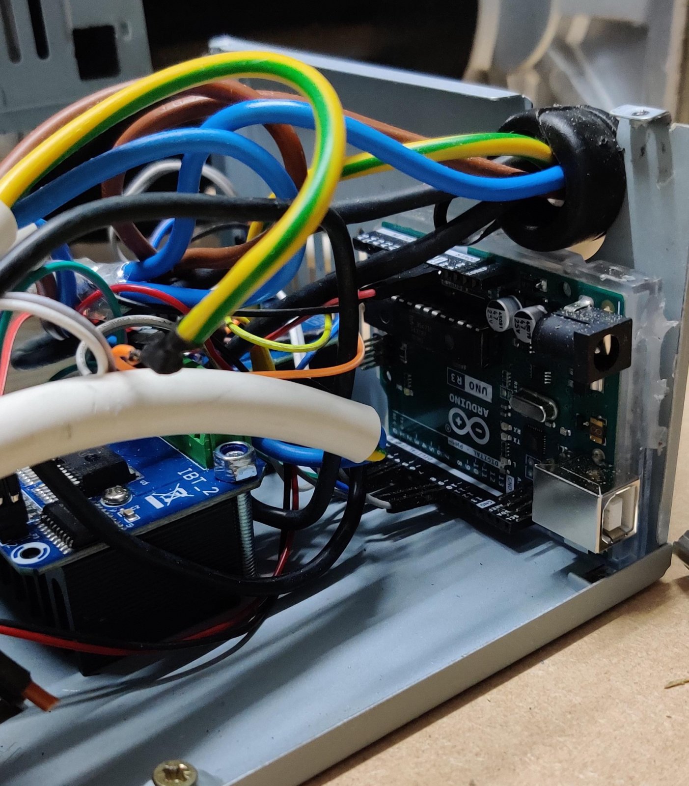

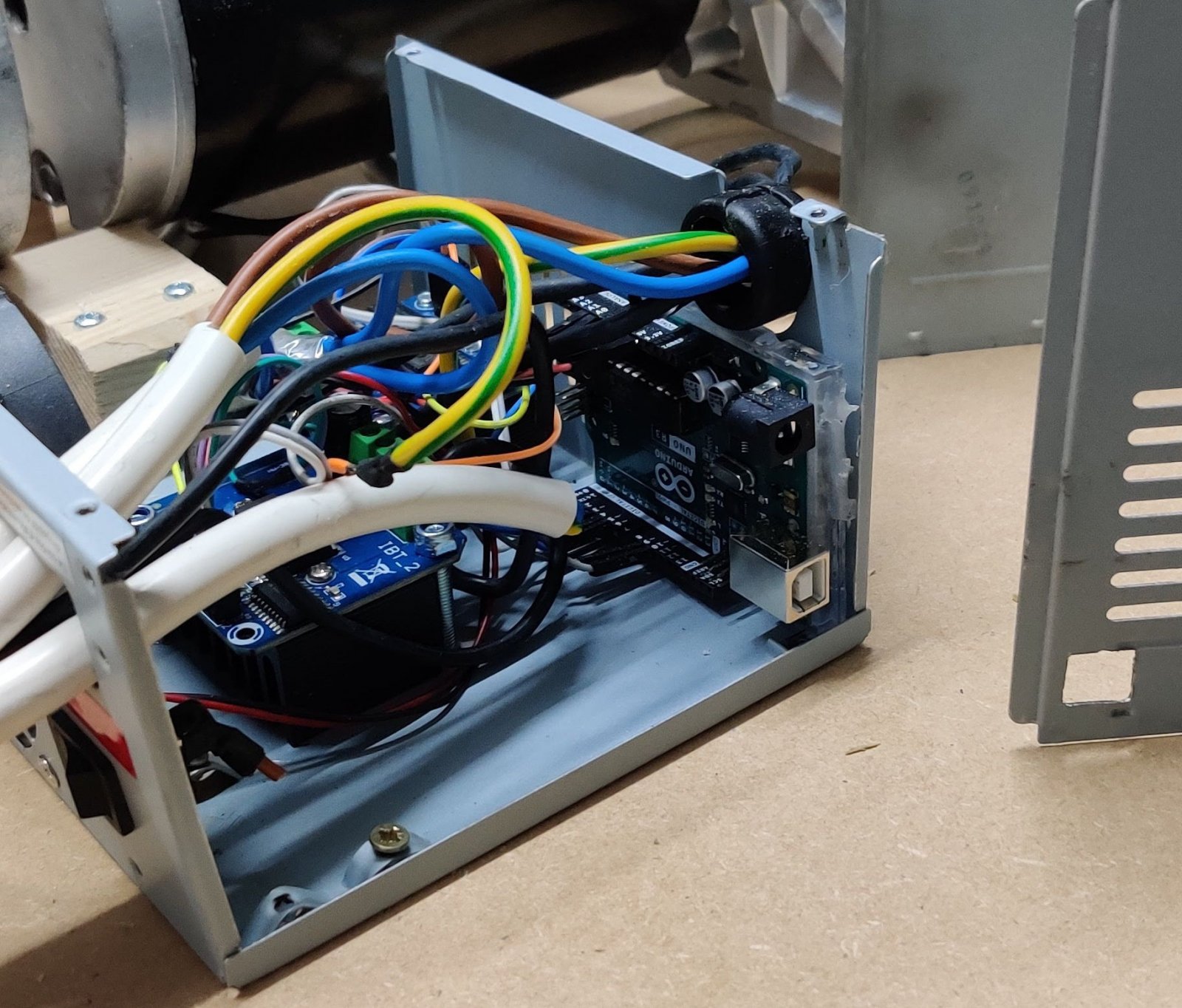

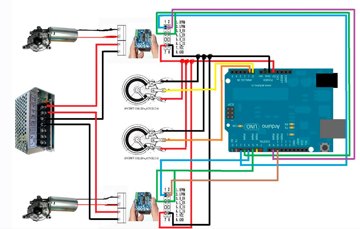

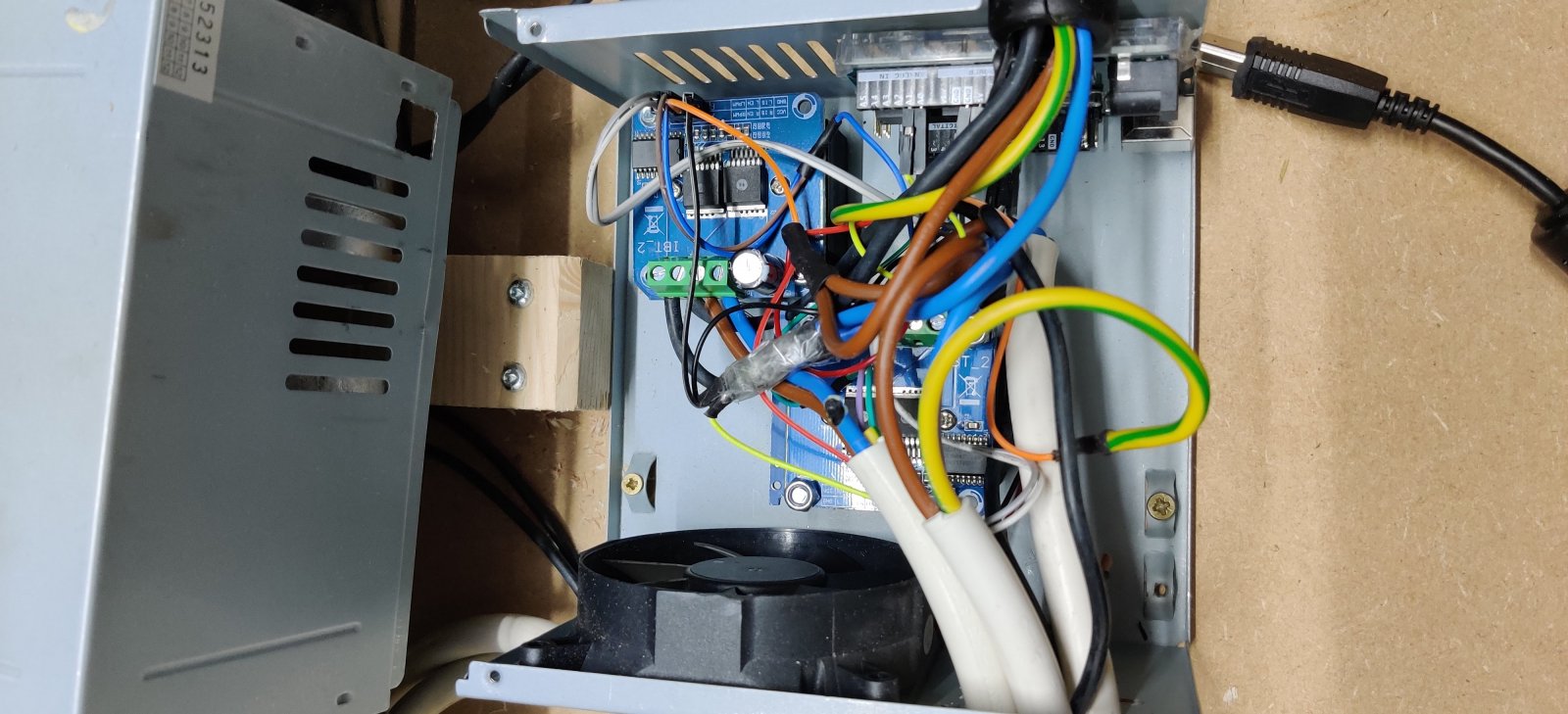

    Box for electronics with an old PC power supply.
    1 Arduino Uno:
    2 driver modules for motors:
    I kept the power supply fan to connect it to the 5V of the arduino and oriented the heatsinks of the cards for better cooling.
    The problem is that the fan is having trouble turning.
    Any ideas? Where to connect to have a permanent current of 5V?

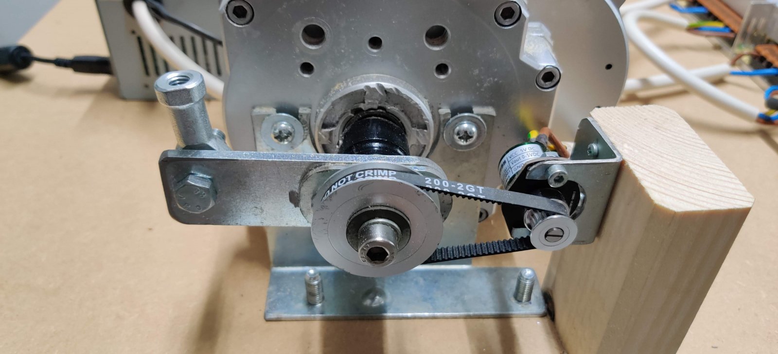

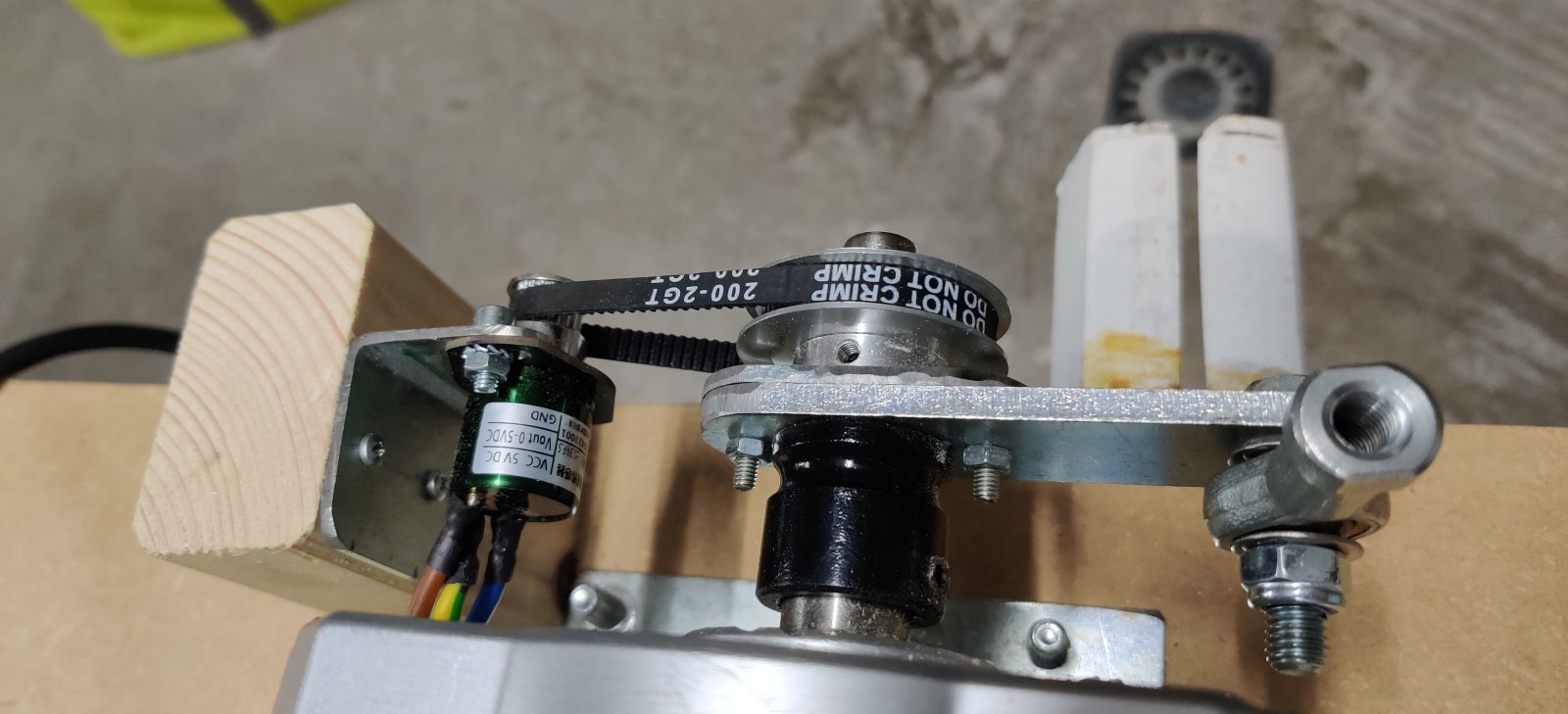

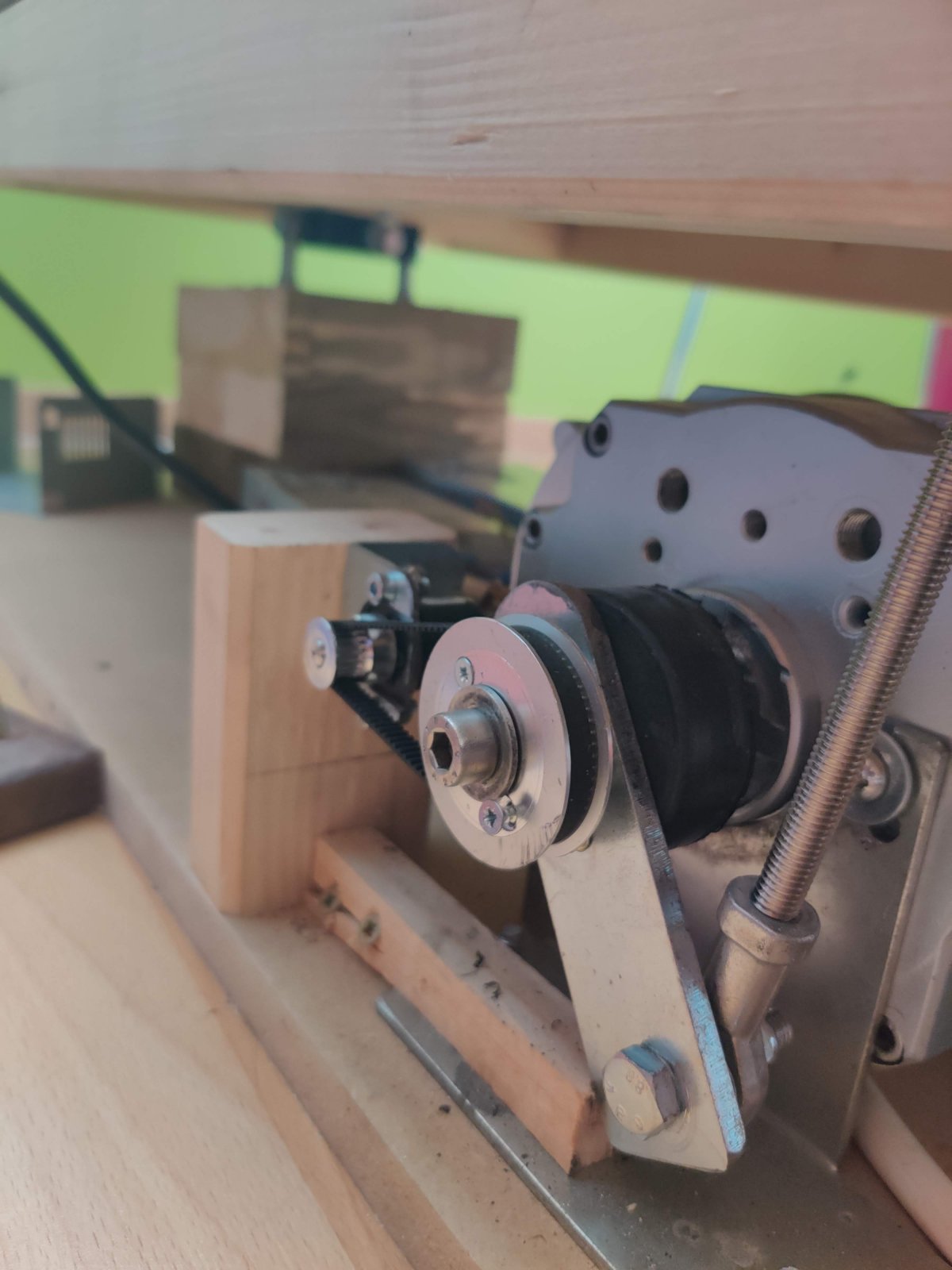

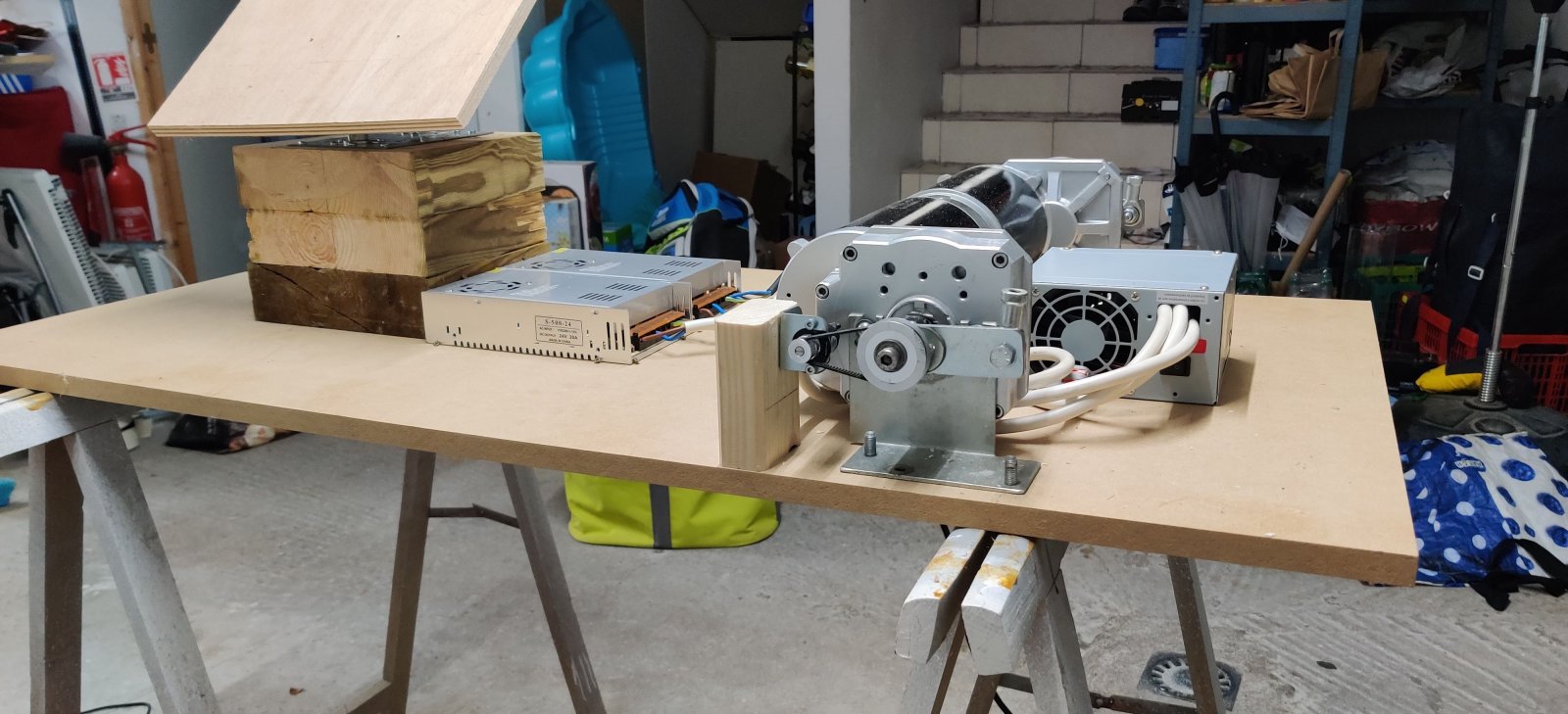

    Simulator base: 18mm MDF wood fiber plate 1220x610mm.
    For the playseat, steering wheel... I also used MDF but I reinforced it with 34x44mm cleats.
    Arm for the motors: 3mm thick steel, 10cm long, drilled to the diameter of the shaft and the shape of the motor key.
    The black tube is to stiffen everything, it is fixed by 2 needle screws.
    Motor pulley: Aluminium: 60 teeth, diameter 42mm, belt thickness 7mm, held by grub screws.
    Potentiometer pulley: 20 teeth, diameter 16mm
    Belt reference 2GT-200
    5V DC potentiometer without stopper, for the tension of the belt I ovalized the fixing holes.

    Installation of 24V/20A power supplies
    15Ah would have been a bit tight (the motor consumes 14.59Ah), no regrets they are the same price as the 20A!
    Small reminder for power calculations:
    P=UI => Watt=Volt X Intensity
    => 350 (motor) = 24 X I
    => 350/24=I
    I= 14.59A

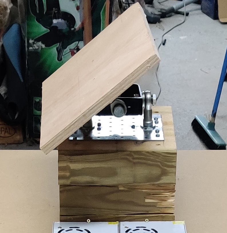

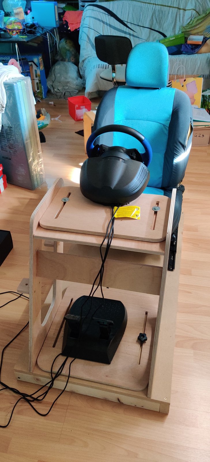

    Placement of the gimbal on a post about 30 cm high, i.e. a total of 40cm for a good clearance.
    I added steel plates to increase the grip surface, I'm afraid the wood will tear off!
    I also put a plywood plate (I only had that :)) to facilitate the assembly of the playseat.
    The pole is not aesthetic, but it is only provisional, when the simulator will work correctly and durably we will see for the beauty.

    Finished assembly!

    I put the wiring back.
    Pay attention to the quality of the connections (crimping), I had problems afterwards
    For the wires of the potentiometers, H-bridge... don't do like me, I took what I found (1.5mm). They are too big, too rigid, it quickly becomes complicated to work with them in small spaces. I have since changed following a problem with 0.75mm.

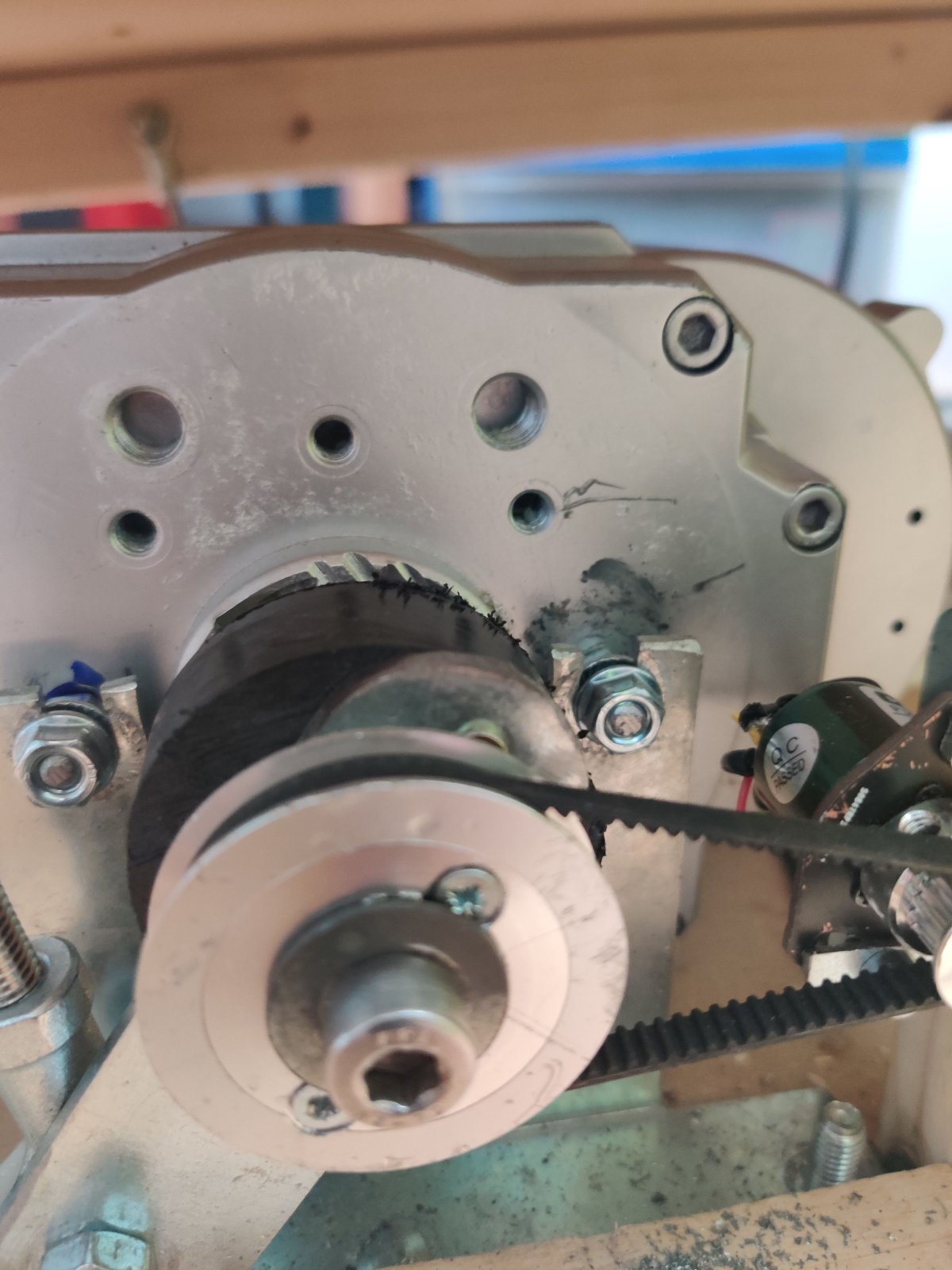

    After assembly, I immediately managed to make it work on LFP, but problems with poorly adjusted parts on the outputs of the motor gears slowed me down: too much travel, the potentiometers went out of adjustment...
    I always make modifications to recovery parts (from my job).
    The black piece is a nylon motor end that connects the motor to the brush of a floor scrubber (perfectly adjusted and very solid)!!!
    I assembled everything with screws: pulley, simulator lifting plate and nylon ring.
    Result, more play, more noise, movement and linear.

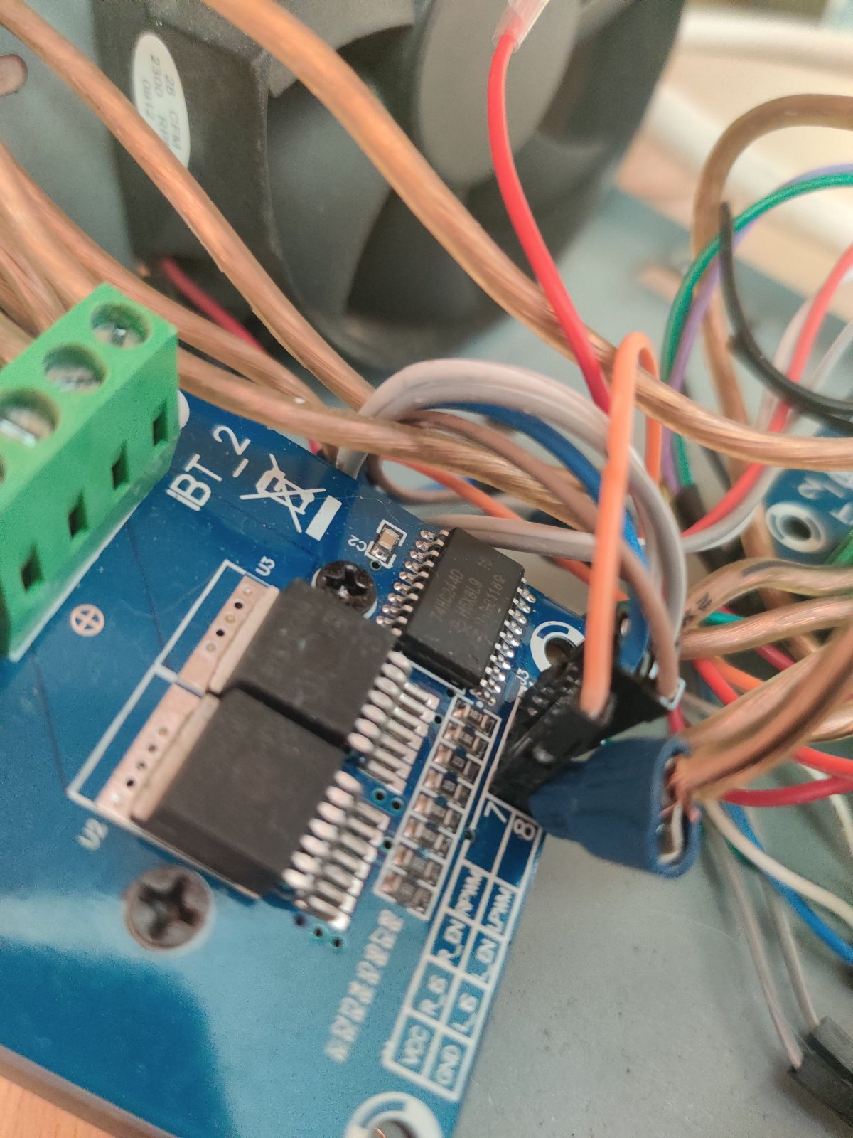

    After his modifications, I played a few races and all of a sudden the engines started shaking!
    I unplugged the simulator, checked the connections of the potentiometers, of the cards... Nothing!
    I restarted the simulator which got up and then turned off!
    Result dead!:(
    After expertise, the 2 H-bridges and the Arduino: BRUNT!!!
    The cause: GND connections on an H-bridge were badly crimped.
    I'm not drawing you a picture! Increase in amps...
    Result: 3 cards burned.
    If anyone has a link for 6-pin connections, I'm all ears!!!
    The "dupont" connectors are really of very poor quality! (to be polite)
    I replaced them with electrician connections!
    I am ashamed!:(
    I promise I will modify as soon as possible:thumbs

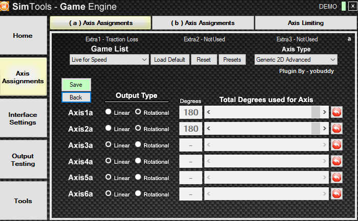

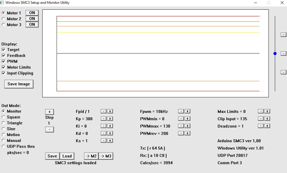

    Since the beginning of the week, the motivation has finally returned! I'm back!!!
    Thoroughly! Lots of goals...
    As you can see on the video, the silumator works perfectly or almost!
    The sensations are good, but not enough travel, on smc3 the MAX limits are at Maximum!
    I find that the motors do not peak.:(
    For me the pulley at the motor output is not big enough.
    Tell me if I'm on the right track?:sos
