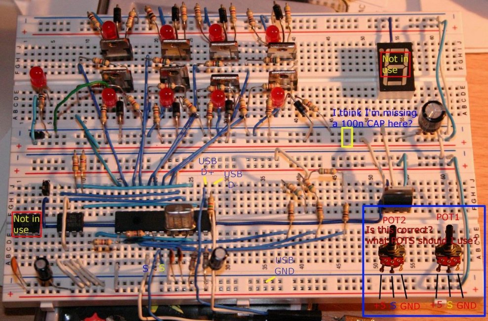

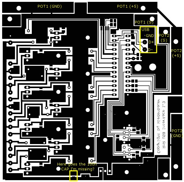

  14. anselmo
    anselmo New Member
    Jun 13, 2008
    0Coins
    Hi sirnoname and egoexpress,
    My name is guillermo and I'm from Argentina.
    I'm building the RNR Interface 1.3 and testing it with leds (to emulate the valves).
    I didn't build the board yet, I wanted to test it before in a protoboard.
    My proto is half working now and here I found some things I was missing (THE POTS!!!!).
    My questions are
    - What pots do I need here, cause in the parts list they are missing.
    - Is there an R=1,5K between PIN14 and PIN15 of the PIC ? (I'm talking about R19)
    I uploaded some images to check if what I'm going to do is OK.
    Thanks in advanced,
    Guillermo.
  15. anselmo
    anselmo New Member
    Jun 13, 2008
    0Coins
    Thanks for the answer.
    I used a programmer for PIc I have with WinPic800.
    I tested it with the RNR13Tester, and the Transistors work; but when I click on calibrate button, it seems to hang.
    As soon I move the pots from one end to the other, the app work again.
    Another question....
    As I read here http://www.x-simulator.de/forum/post348.html#p348
    The pots are used not only for calibration, but also to know where the chair is positioned.
    I wonder, how you attach the pots to the chair, so that, as the chair moves, the pots change values.
    Another, I test with the pots connected, and now is doing some more stuff!!.
    As I move the joystick, the leds turn on, as the valves in the future, I hope jeje.
    Thanks again!!.
