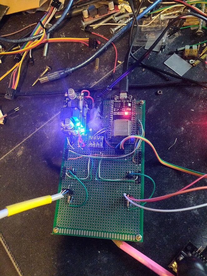

    Hello I wanted to share my project with you guys. it's a 2dof solution based of an esp32 programmed with the arduino environment, and processing for the software interface (tuning pid etc..). It's semi functional but there is always room for improvement and adding functions or safety off course. I however can't find the time at the moment to push this project further. I'm sure I will pick it up again in the future but for now it isn't really possible to put the time in.
    I'm not by any means an expert in programming or electrical engineering, however I am someone who is heavily interested and invested these topics.

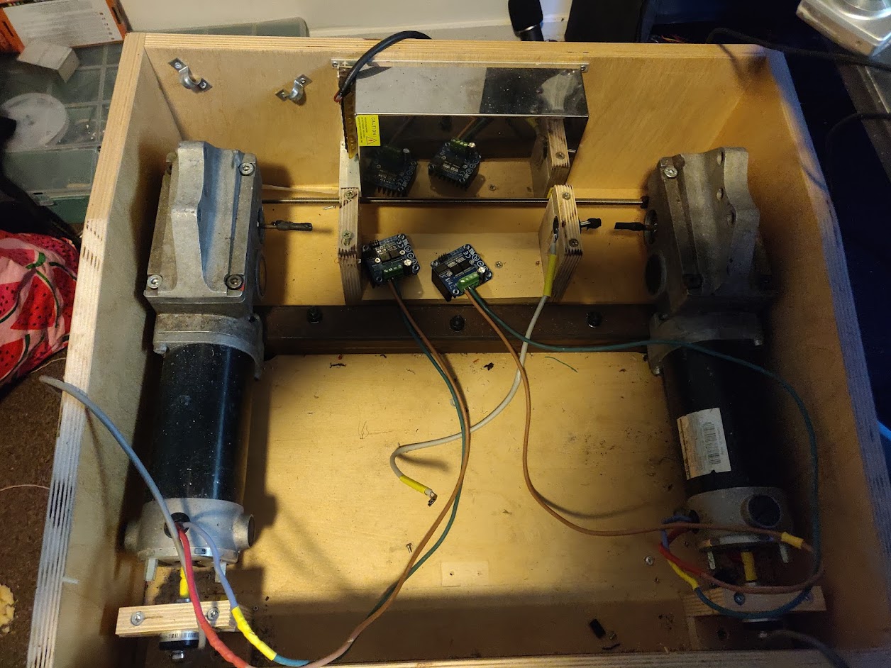

    For the hardware side of things I used an esp32 dualcore. The serial communication is done on core 1 so that it doesn't interfere with the pid calculations etc which run on core 0. For feedback I use 2 continuous potentiometers, but I will be using incremental encoders when I find the time for continuing this project. The motor drivers I use are ibt-2's.
    I cant provide schematics at the time due to not having enough time for it.
    for testing/debugging purposes i'm using 2 serial connections. but it will work with one off course. Wifi/udp is possible but i havent tried this myself yet.

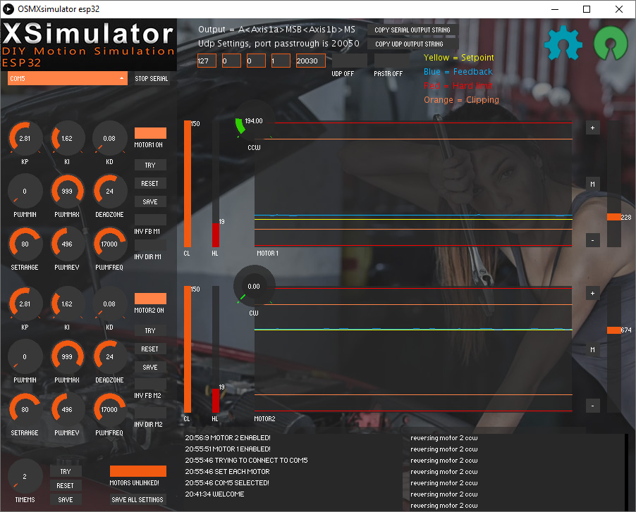

    For the software side of things I've used processing language an ide for the gui. I tried to copy as much functions from smc3 as possible for obvious reasons.
    Stuff that's working:
    Selecting com port and stopping serial connection. baud speed is set "fixed" to 500000.
    Udp connection for communication between simtools and osmxsimulator.
    Motor on/off toggles.
    Try mode for tuning.
    In try mode:
    Setting up pid.
    Setting pwm minimum and pwm maximum output.
    Setup a deadzone.
    Setup range for the potentiometer.
    Setup pwm reverse.
    and setup pwm frequency.
    Reset for resetting to previous settings.
    Save function for saving settings.
    Inverse feedback from potentiometer.
    Inverse direction for motor.
    Setting ms for time between pid calculations.
    link toggle for settings for both motors.
    Save all setting which include all settings.
    Clipping slider which sets a limit for the input and when the feedback overshoots will reverse the motors until it's within limits.
    A hard limit slider which when the motor crosses this line will stop the motors.
    A output and direction indicator.
    A continuous graph for each motor.
