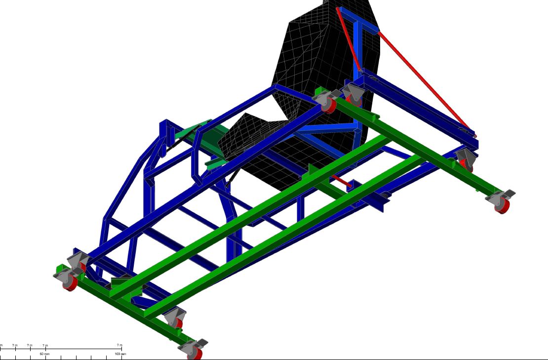

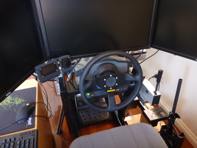

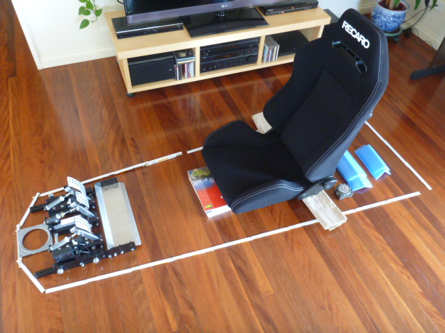

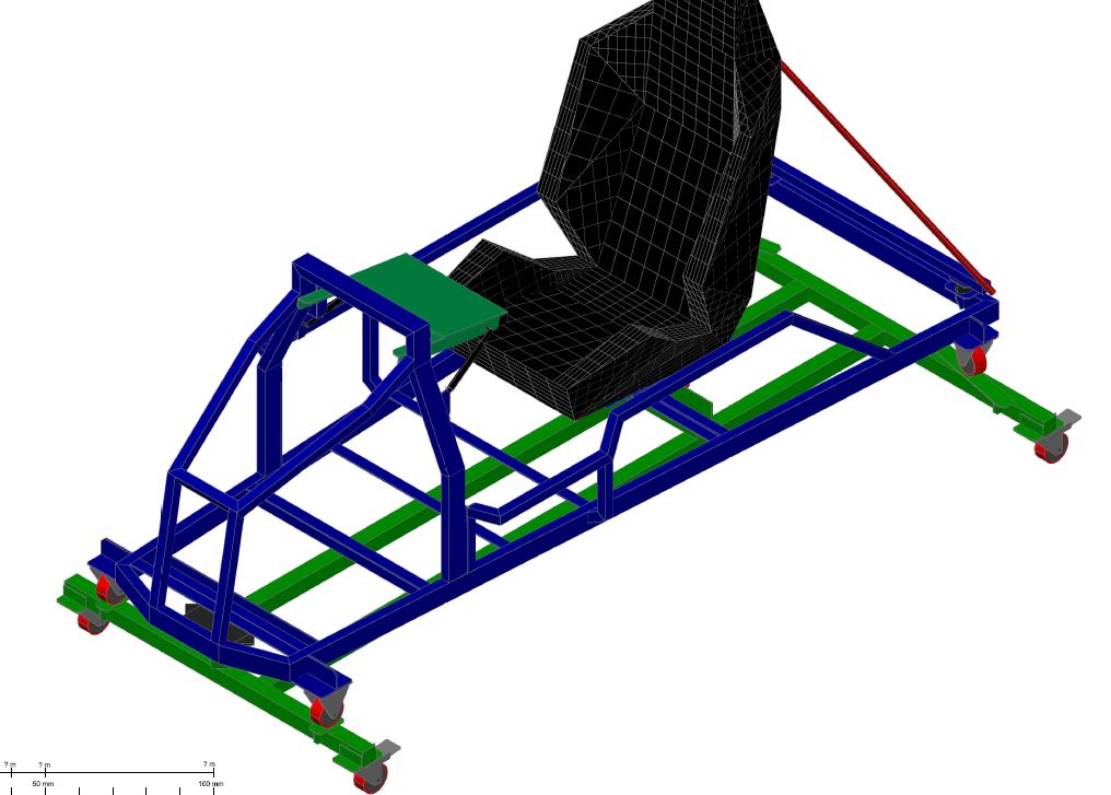

    I've pretty much finished my plans for my motion rig and want to show it off and see if I get your approval :)
    Here's my current rig - it's diy as well:
    Yeah, I did put lots of thought in my new rig, but it's possible I've missed something of course and changing an ACAD model is easier than cutting a steel tube longer;-)

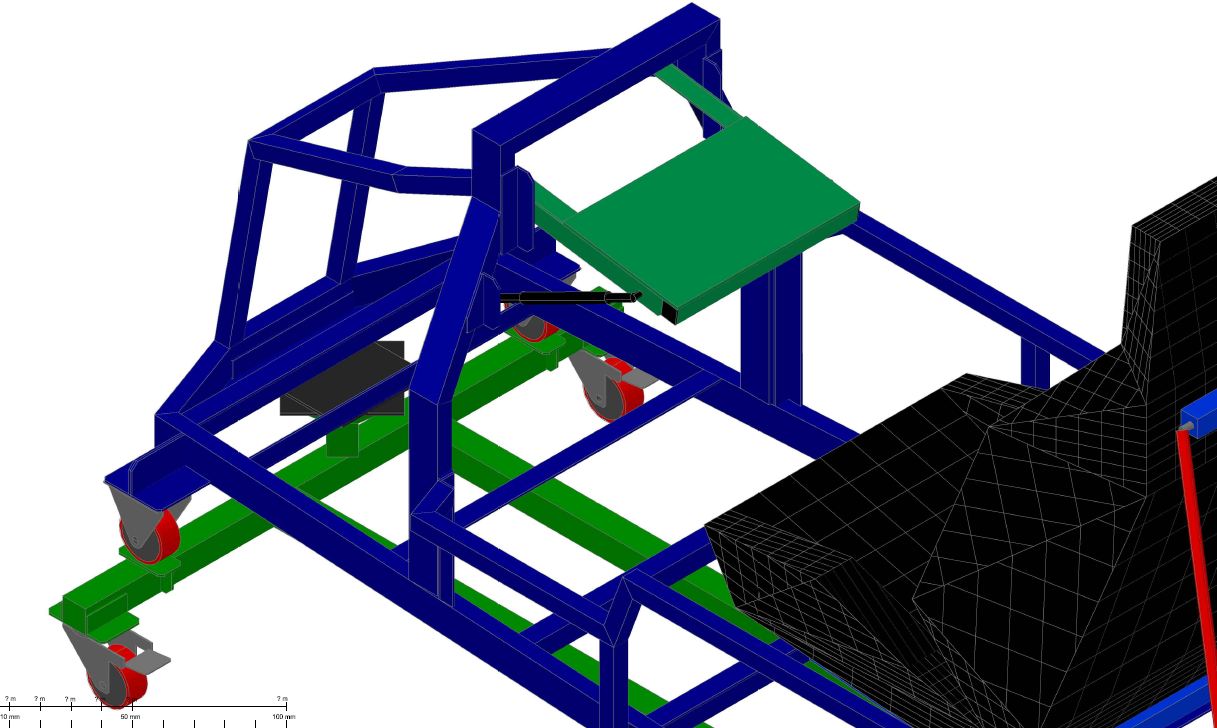

    That's what it is gonna be made of anyway. It will be welded up and only the frame which takes the steering wheel is bolted on. I wouldn't get it into my sim room if it was one piece. The monitor stand which takes my 3 24'' BenQ XL2420T's is separated. The centre screen will be just about 60mm behind the steering wheel rim (so it's gonna be a bit closer than it is now on my current rig).
    The pedals are gonna be mounted on seat rails. I'm using SimX SCN5 actuators for the seat and the rear traction loss module.

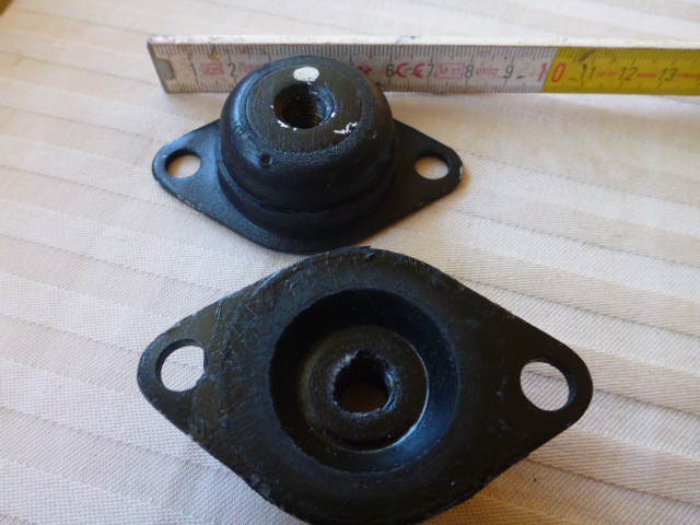

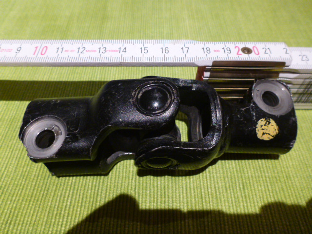

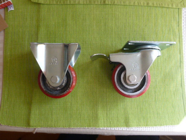

    Here some pics of the bits and pieces:
    P1000363.JPG P1000343.JPG shear compression mounts.JPG P1000364.JPG Kart tie rods.JPG

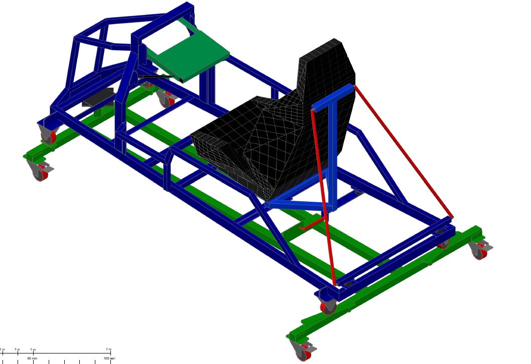

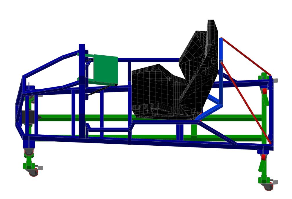

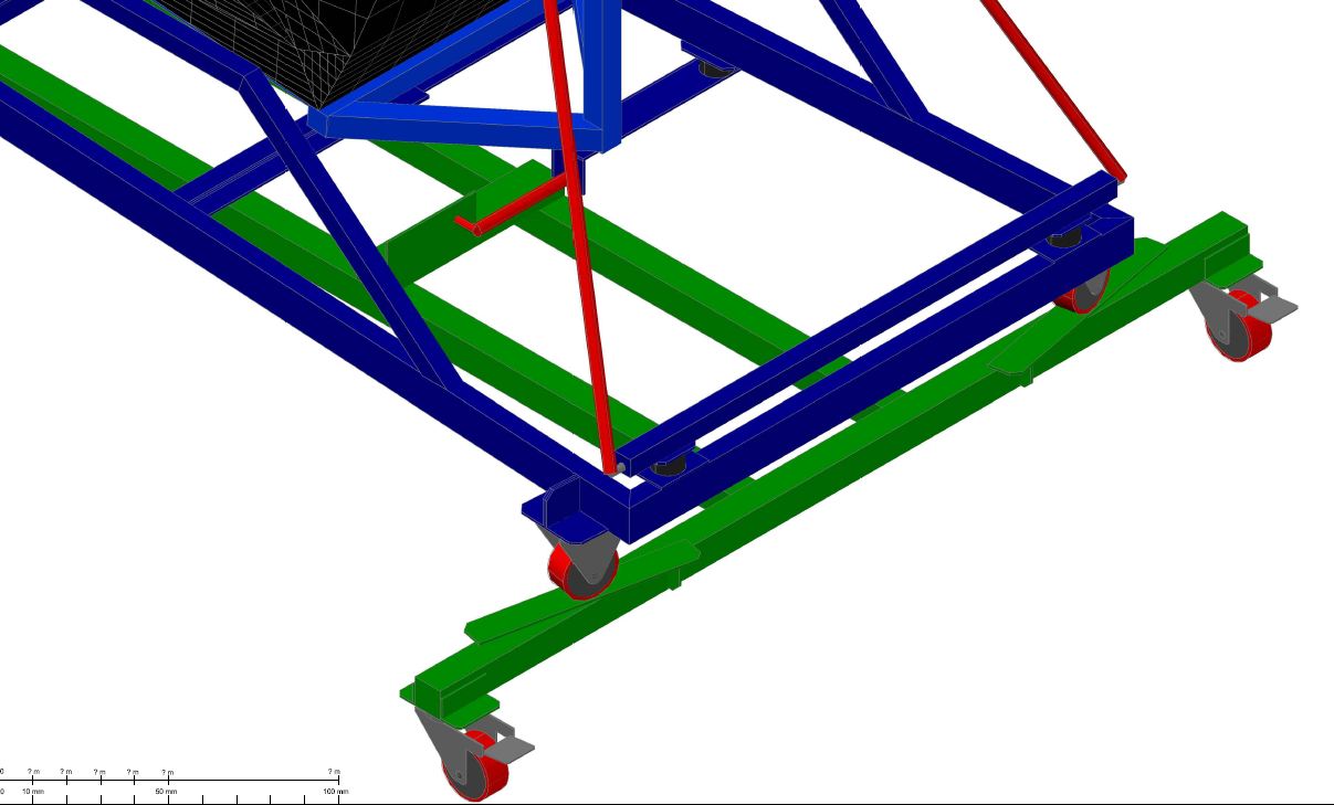

    So here some isometrics of my new rig:
    This is how it started:) rig design3.JPG
    Hope you think it's ok...and if there are issues please let me know
    (pics updated 9/8/2013)

    Hello Thirsty ! :)
    So, it will be a 3DOF seat mover !
    Nice drawings ! Nothing wrong for me at the moment
    but it will depend on
    - how much Yaw angle do you intend to get
    - where will you actuate the yaw effort
    I'm eager to see the next steps !
    Mat

    Hi Thirsty, great build ideas. As a matter of fact it is very similar to what I built, my first trial was today; worked fantastic.
    Good luck and keep us posted.
  4. bsft
    Design looks good except for rear swing arm arrangement, they are usually an arc, not straight , where the rollers sit on the back for the yaw.

    Hi Mat
    Cheers for your feedback.
    I've done some work on my file and modeled the rear traction loss actuator bracket (all isometrics have been swopped). The actuators are on their way and should be delivered next week sometime. Depending on the exact size of the actuator I might have to revise the design slightly, but the location will remain the same.
    I'd think it's pretty close to where SimX is having their actuator located as well.
    You think it's ok?

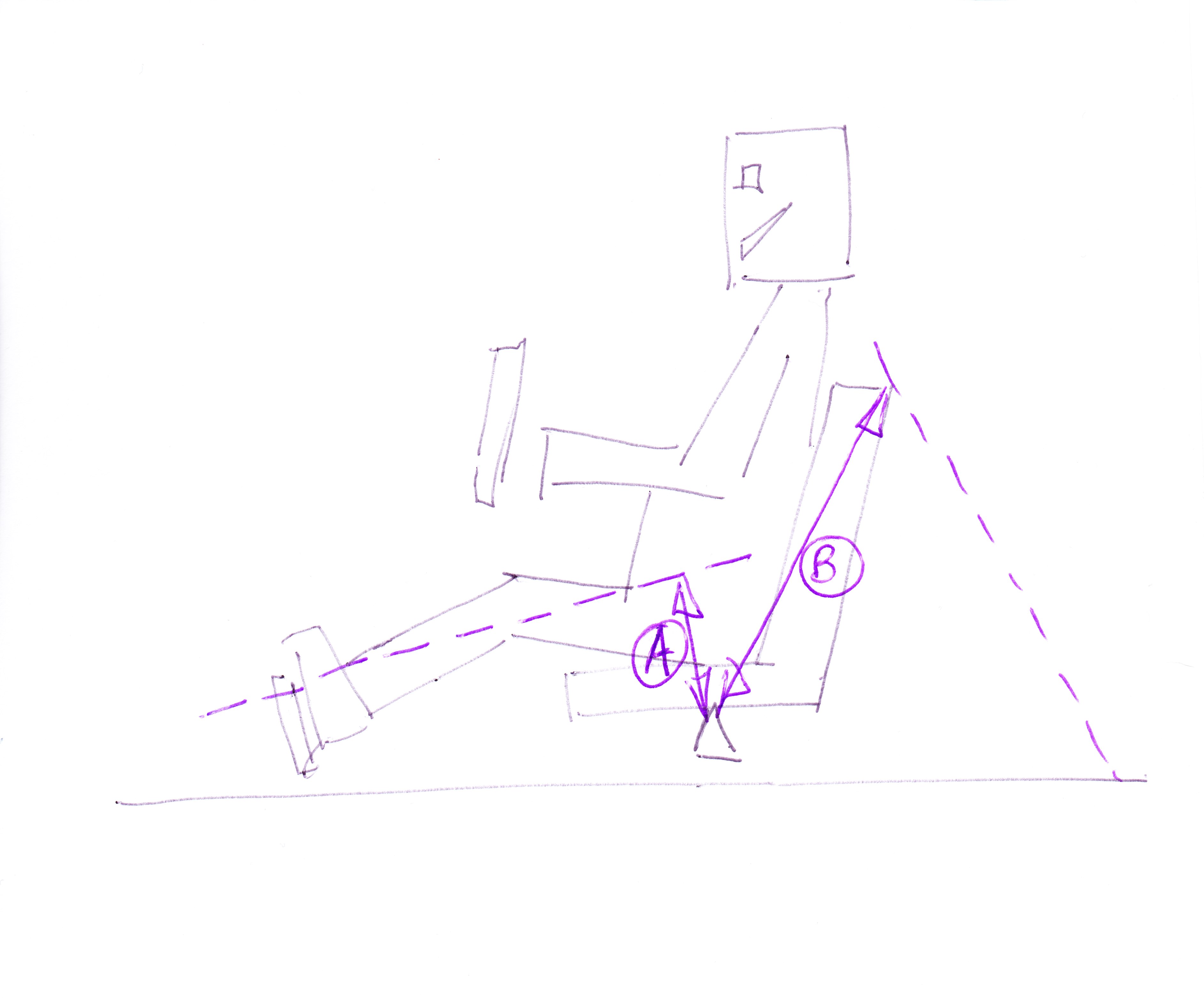

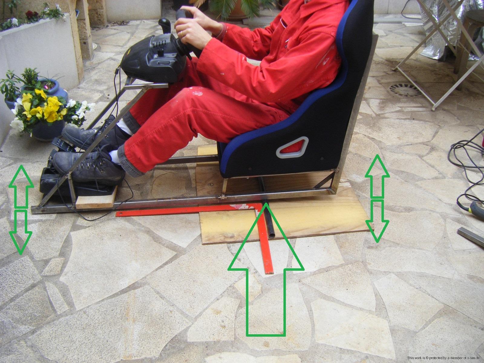

    Hi Thirsty, if I understand your question... you want to know (for a seatmover) how much pushing on the brakes effects the seat movement because you are effectively pushing the seat backwards?
    If you think about the tangential distance (A in diagram below) that this force is being applied it will probably be pretty short in relation to the actuator tangential distance (B) therefore you are getting a greater lever force from the actuators than from your leg braking pressure. So theoretically yes you are correct, however in practice I can't imagine it would be that important to worry about.
    (Sorry for the crude drawing - I didn't do a good job at drawing the line B at a tangent but I hope it explains what I mean)
    I have a seatmover and can't adjust the seat position but it seems to work fine no matter what size or weight person is in it. I would suggest your approach to test with someone seeing how easy it is to move the seat while pushing on the brake is a good approach!
  11. bsft
    Centre of gravity for a 2 DOF needs to be almost spot on. Even for seat mover. I have attached a pic of best way to find balance, use this for seat mover and full frame. ( Thanks Matt for pic).
    If you find the motors are having trouble lifting the frame from a big braking motion and its balanced, you may need to look at mounting the motors at more of an angle. Or try increasing power to the motors and reduce the percentage of the force for braking.

    Cheers for the feedback. You got it exactly right - that's what I mean...and the sketch certainly does the job :thbup:
    You're right: better check it properly. I will have to modify my balancing tool a bit and let my missus do the braking to see what's happening. I understand there's not much leverage on the break force's side - I've got about 100mm - and that makes it less critical.
    See how we go with that anyway.
