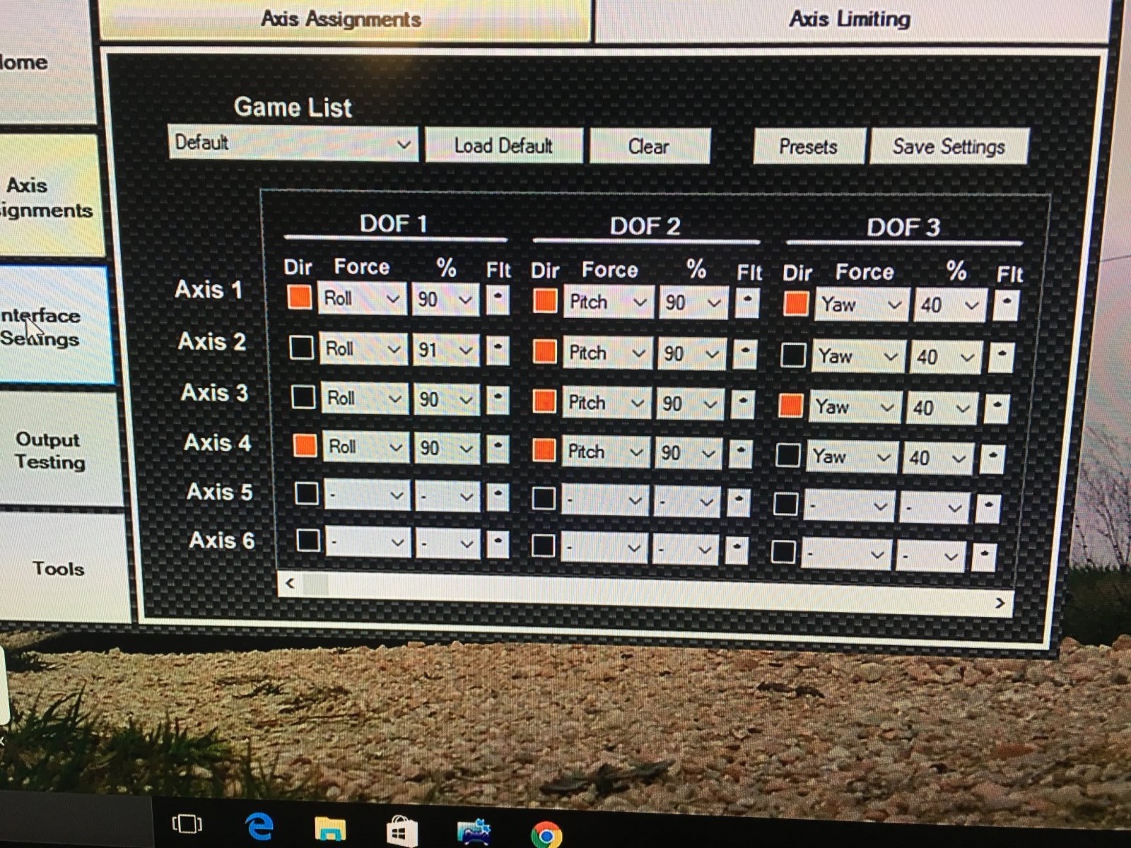

    Hello guys I put the links of two videos made on my simulator miniature , use it with simtool one is a video with two motors and the other with four engines but I have a problem just before the game , the video shows someone can help me ? just go into the game with the machine in the pit simulator tilts to one side and if lap if bent in the opposite direction to the inclination sim you put flat on the straight but the curve after remains tilted in the direction of the curve even on the straight !!

    Please post pictures of your interface and axis settings.

    You place the photo of the setting of the axes, in the afternoon I did some tests; if in the yaw motion setting gate I have no problem when I post yaw me from that mistake, I did these tests because I thought I had done something wrong in the Arduino code.
    What can create me that problem?

    You have way too much Axis % allocated, it should be around 100% adding the allocation rows: http://www.xsimulator.net/community/faq/axis-assignment-percentage-totals.120/
    Do the allocations one at a time, starting at 20%: http://www.xsimulator.net/community/faq/steps-to-create-a-motion-profile.228/
    Also Startup and Shutdown output in the Interface settings affects the starting and finishing position of the simulator: http://www.xsimulator.net/community/faq/startup-and-shutdown-positional-controls.234/
    I am presuming from the use of Roll, Pitch and Yaw you plan on doing a flight motion profile. However, even if your aim is flight simulation I would suggest you practice with doing a motion profile for Live For Spreed first, using surge, sway and heave, just to get the hang of it. Generally with flight sims you need to learn about using filters in addition to Axis allocations to get the most out of a flight sim motion profile.

    Today I deleted the yaw and set the loss of traction, how come there are two types of loss of traction on the race set- plugin ?
    because even the loss of traction gives me problems ? I servo motors that move also in the straight at the slightest hint of turning even the slightest !! I just set the 10 % strength on the axis
    21,504
    150,644Coins
    +11,018 / 55 / -2
    There are not two types of traction loss, yaw is a different axis from traction loss and they behave very differently.
    If traction loss is over sensitive you can raise the number for it in the tuning center.

    Today I did the tests and with the post of settings is much better just do not see that the machine slips cornering but the engines realign before the end , as if they have little excursion !!
