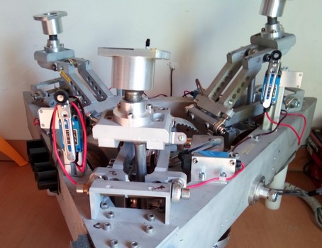

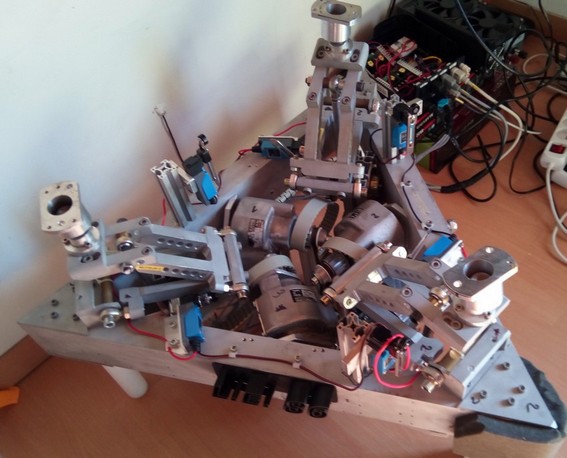

    I began the simulator in 2015

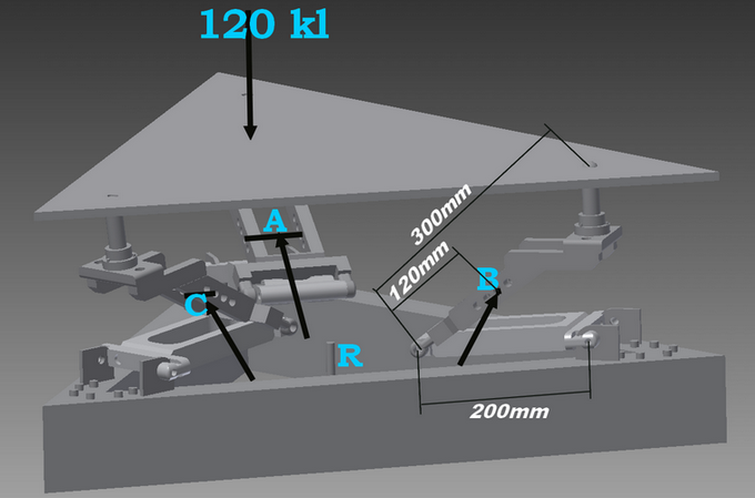

    The maximun weight is 120 kl centered on the triangle,
    Effects:
    • Pitch with 15 °
    • Roll with 10 °
    • heave
    On the photo appears the mechanical already realized part
    In the ABC we have the points of inking of actuators
    Advantages of this mechanics:

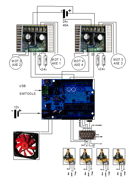

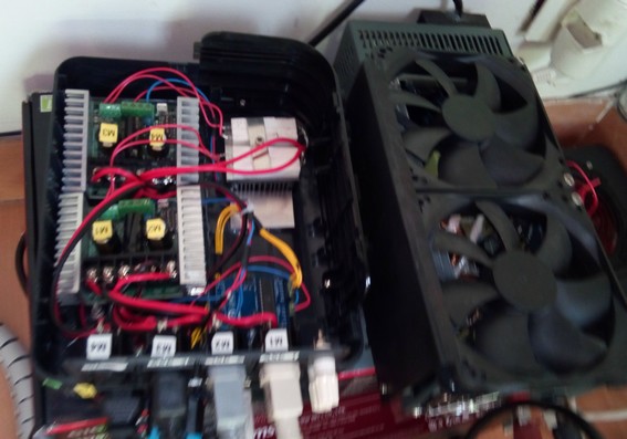

    électric part:
    arduino uno/ 2x Sabertooth 2x32
    I am available for any wanted information

    What are the specifications of the motors you are using and how do the toothed belts go with sustained use, I am guessing there is some sort of tensioner?
  5. lysa elec
    lysa elec LYSA ELEC
    Dec 22, 2009
    246
    - 26Coins
    +16 / 0 / -0
    Engine 24v 150W
    reduction of 1/25
    marque : swedrive
    serie 91894343...
