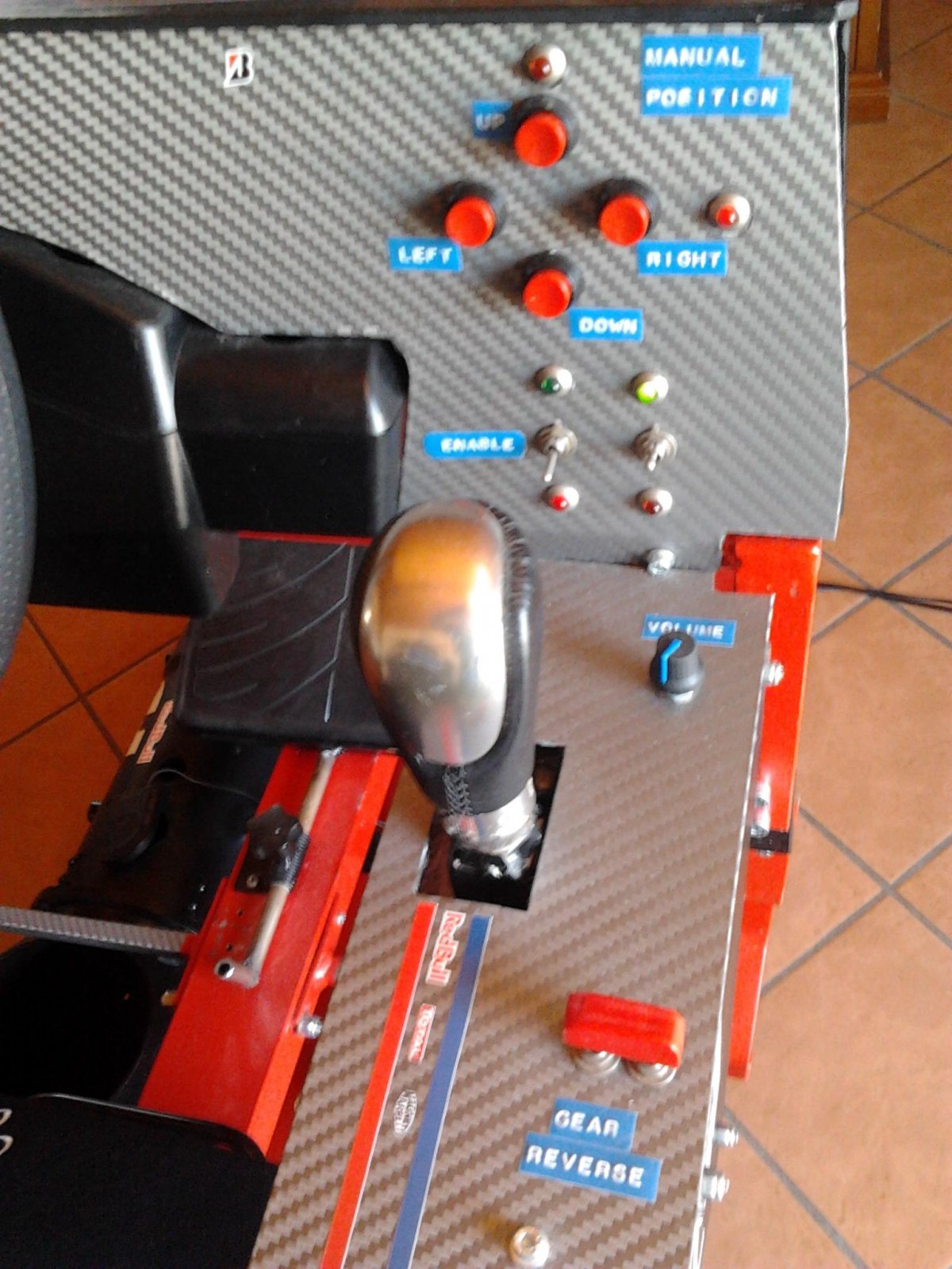

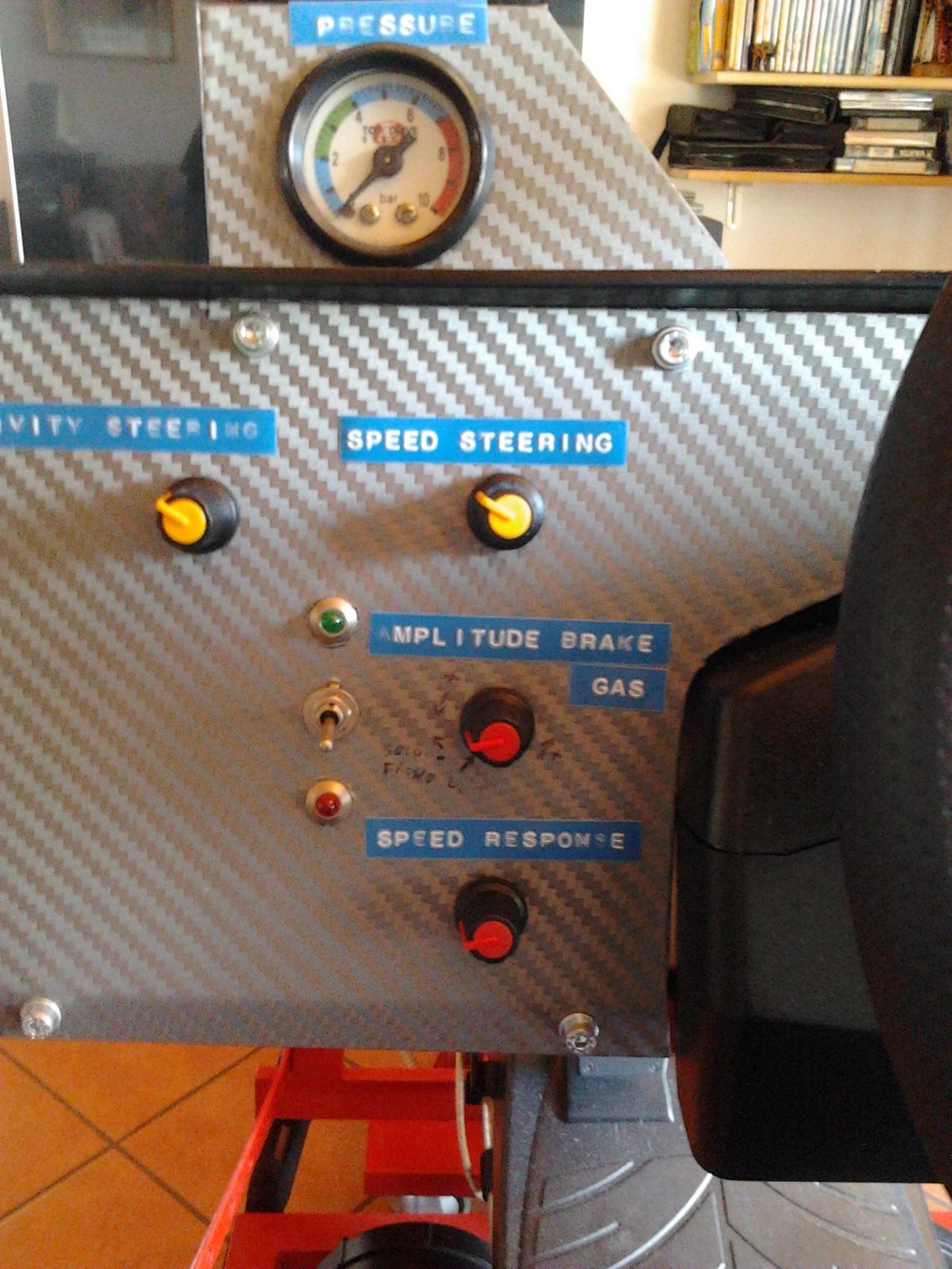

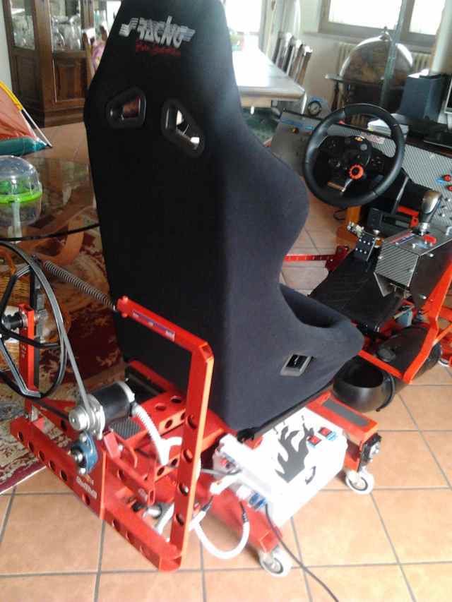

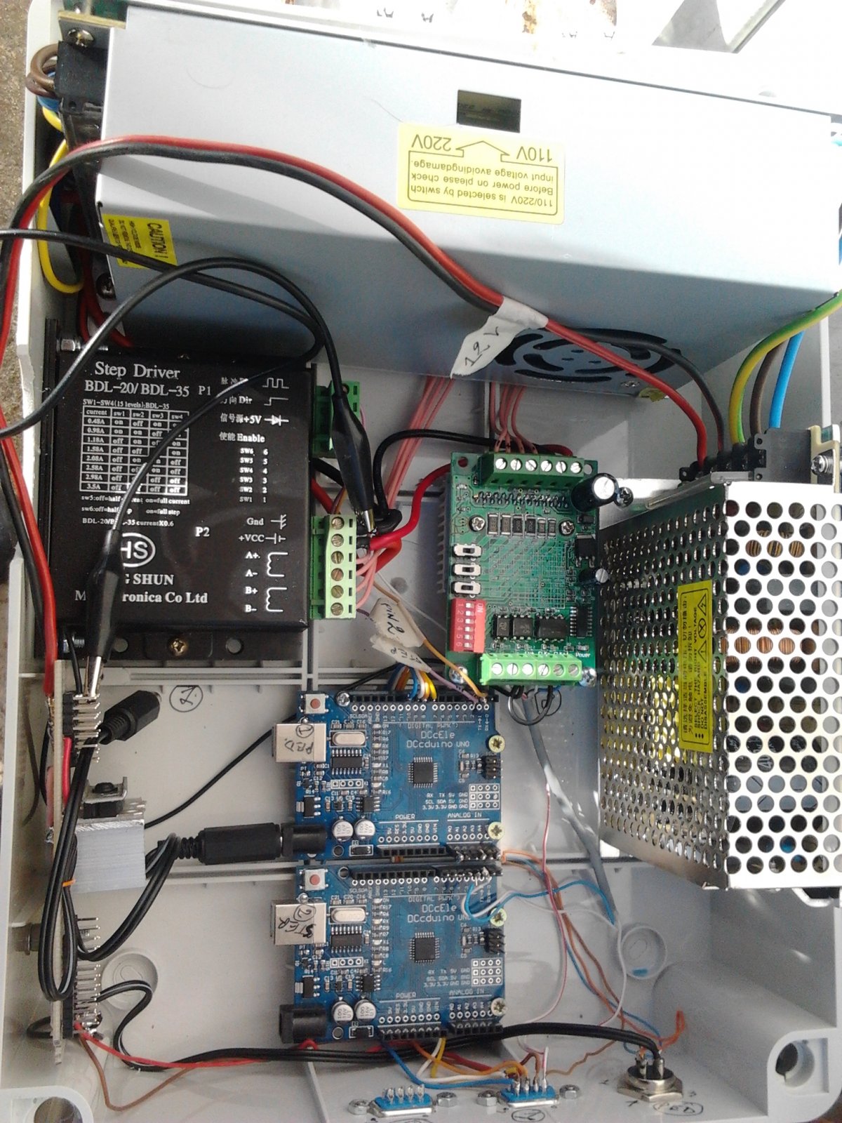

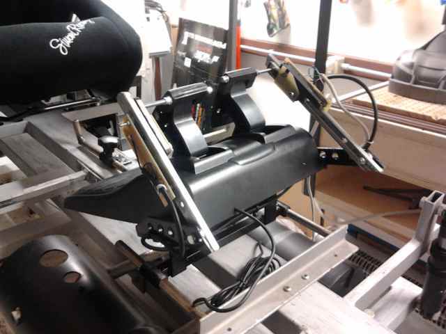

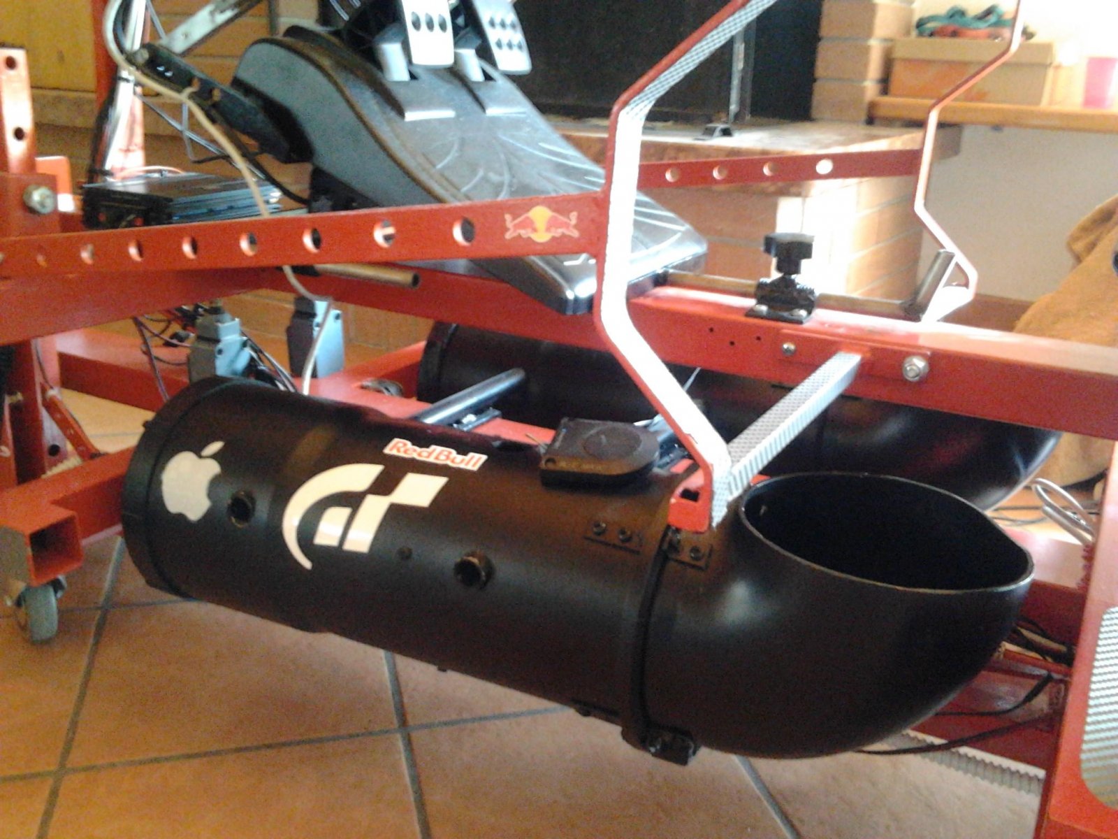

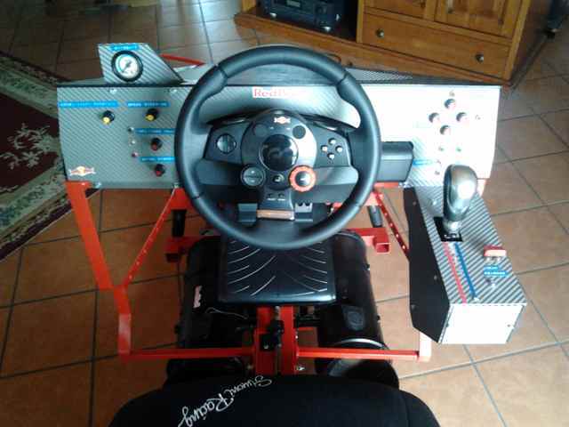

    ecco il mio simulatore a due assi compatibile con tutti i giochi ps3 e pc.
    i dati vengono presi direttamente dalla periferica volante e pedaliera.
    motori passopasso 24v 6A
    hardware due schede arduino
    due stepper drive 5-6A
    Non posso postare video perche' sono nuovo ma presto lo faro'.
    intanto allego qualche foto.
    here's my two-axis simulator compatible with all PC and PS3 games .
    the data is taken directly from the device steering wheel and pedals .
    stepper motors 24v 6A
    two boards Arduino hardware
    two stepper drive 5-6A
    I can not post video 'cause I'm new but soon I will ' .
    Meanwhile I enclose a few photos

    It certainly works but it can't be realistic...
    I tried this method when no plugin was available and sometimes the movements were very strange compared to what you see on screen.

  5. Andrea 1968
    Andrea 1968 Member
    Jul 1, 2015
    65
    italia
    193Coins
    +40 / 0 / -0

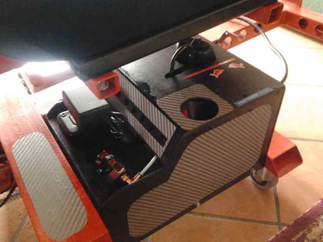

    It includes photos and control commands
    the pressure gauge is used to the pressure of the compressor under the seat to replicate the breath valve turbo when changing gears.
    Within the two tubes blacks reside two woofer 50 watts and two tweeters for audio and concrete ballast to balance the weight of the rider to lighten the engine work.
    the audio amplifier and 'placed before the pedal.
    I can assure you that calls for a lot especially when changing gear or scale (after 20 minutes of back pain !!! :(
