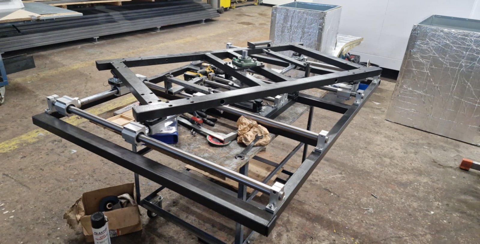

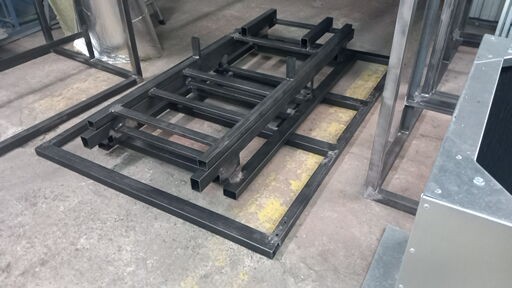

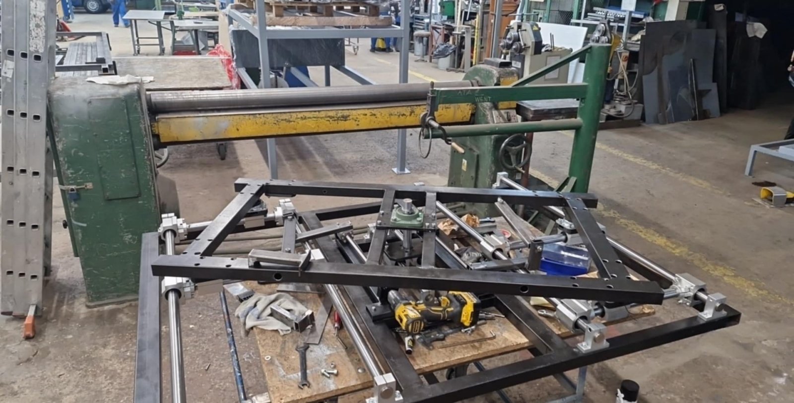

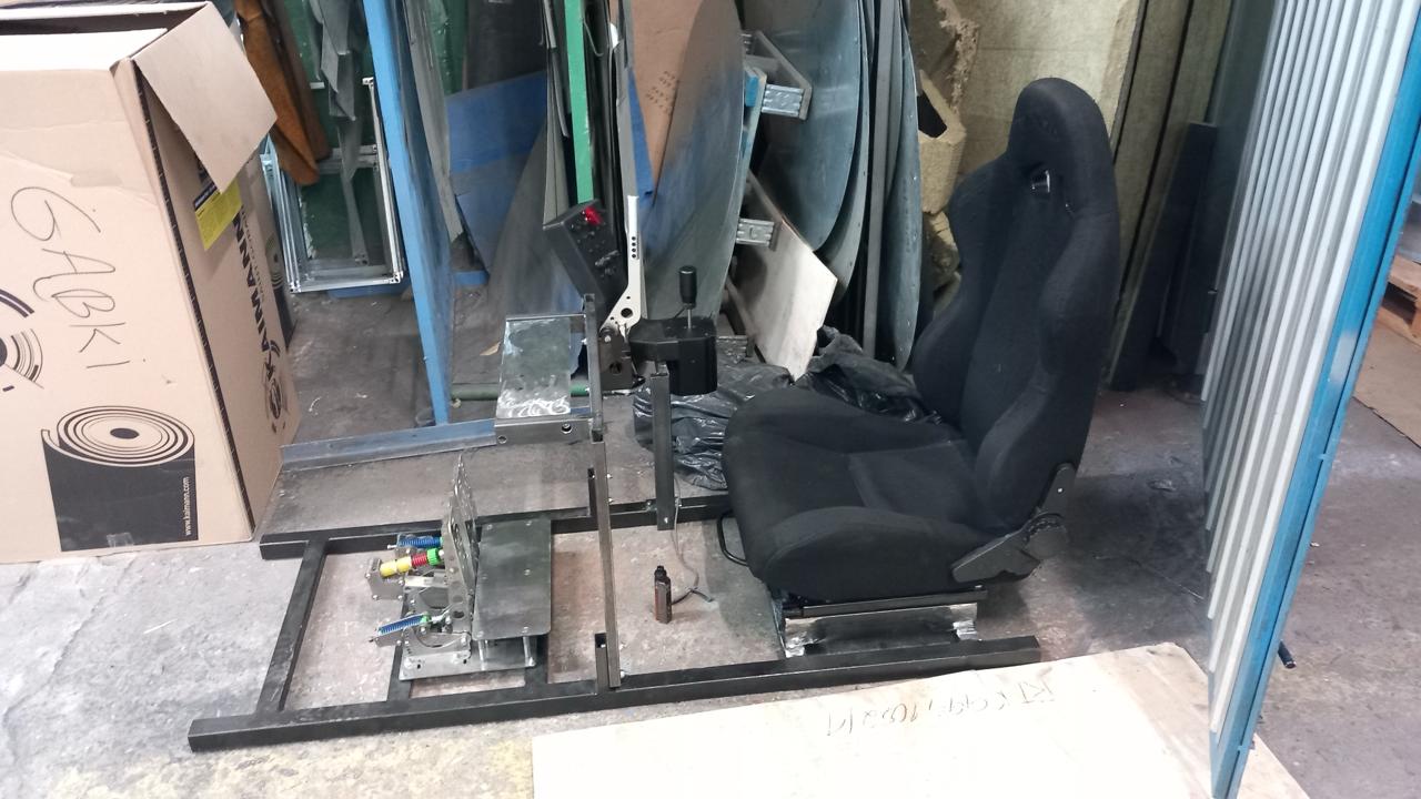

    Hello
    The time has come for another project. This time a 6Dof 2xTL plus surge. The premise is simple. 4 sfx80 actuators with 220mm stroke, put on a moving frame. I decided to use linear rollers. For now the bearings are standard ball bearings but will probably replace them with some composite quieter ones. The project is currently in the parts picking stage. Some I have, some are on the way. The controller will be a VNM based on stm32 with a very cool ui to configure the whole thing. The seat will move on two linear slides and carriages. Standard 1605 screws and 80st motors will be used as the TL and surge drive.

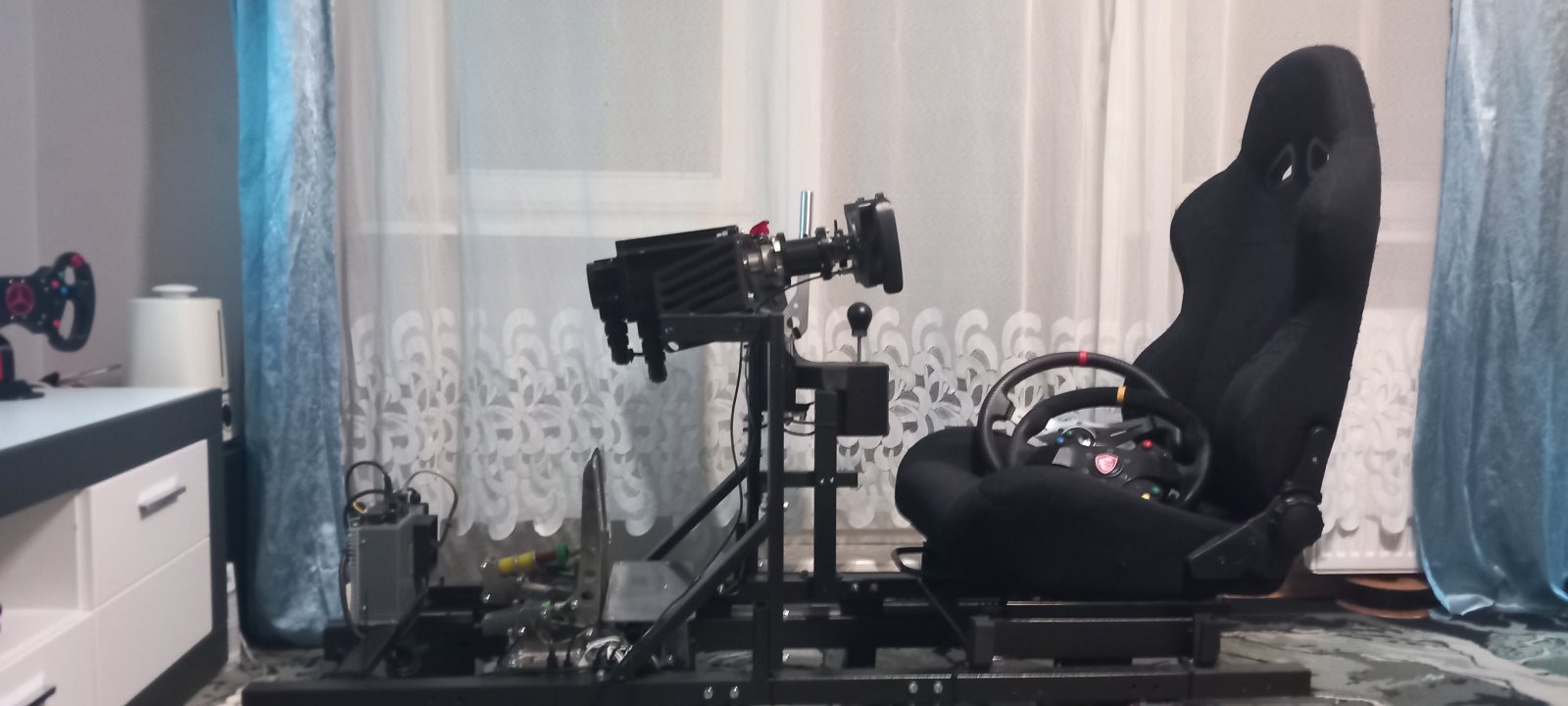

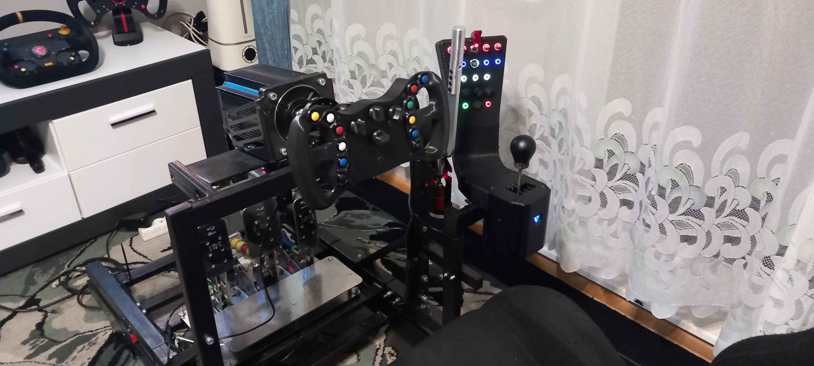

    First run, only TL and surge now.

    Its ready, now make tunning
