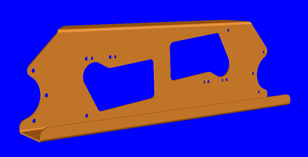

    The first post was mainly to help you think of solutions on the subject. I am not very good at drawing, specially with CAD, it is not even basic. I am designing most parts and brackets with emachineshop software.
    http://www.emachineshop.com/
    This bracket was designed using their software and they can fabricate parts I design with it. This bracket still needs refinement.

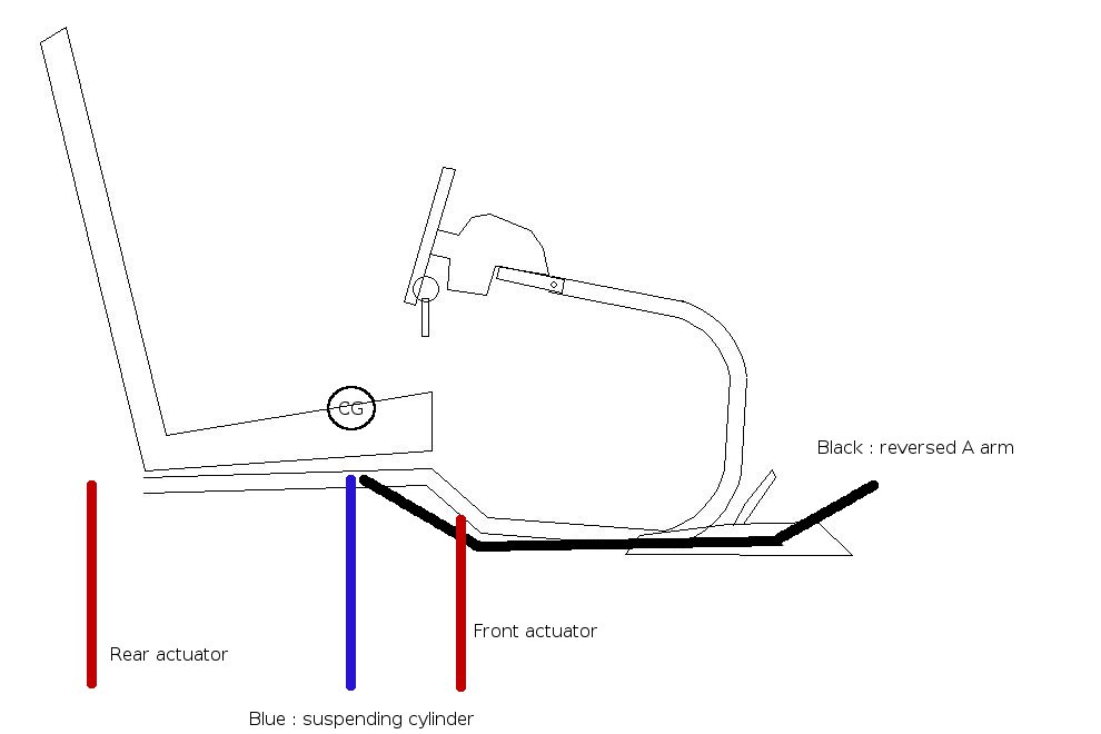

    Here is the best drawing I could draw.
    The location arm will be attached to each side of the seat to prevent spinning and to a single point in front at about this height to have less than 1 mm of fore/aft movement on total up/down travel. This will allow roll of course and also side movement to simulate traction loss .
    In the rear the 2 actuators will be attached close to the roll axis to the seat and at the base they will spread about 18. They will provide the side to side and the up/down movement.
    The place of the CG was calculated with the test seat and will be close to there with the final setup. The air cylinder will support everything right under the CG. Once pressurized, it will just ease the work of the actuators. Nothing else. Two stabilizer bars will also help when the seat rolls and pitches.
    The front actuators will be located straight up on each side of the seat to be the least affected by the side movement.
    As you can see, the seat is positionned by the reversed A-arm and the 2 rear actuators. If only the rear actuators move up, the pivot point is the location of the front actuators upper attach points. But if at the same time the front actuators retract the roll center will be somewhere between the attach points.
    Fern

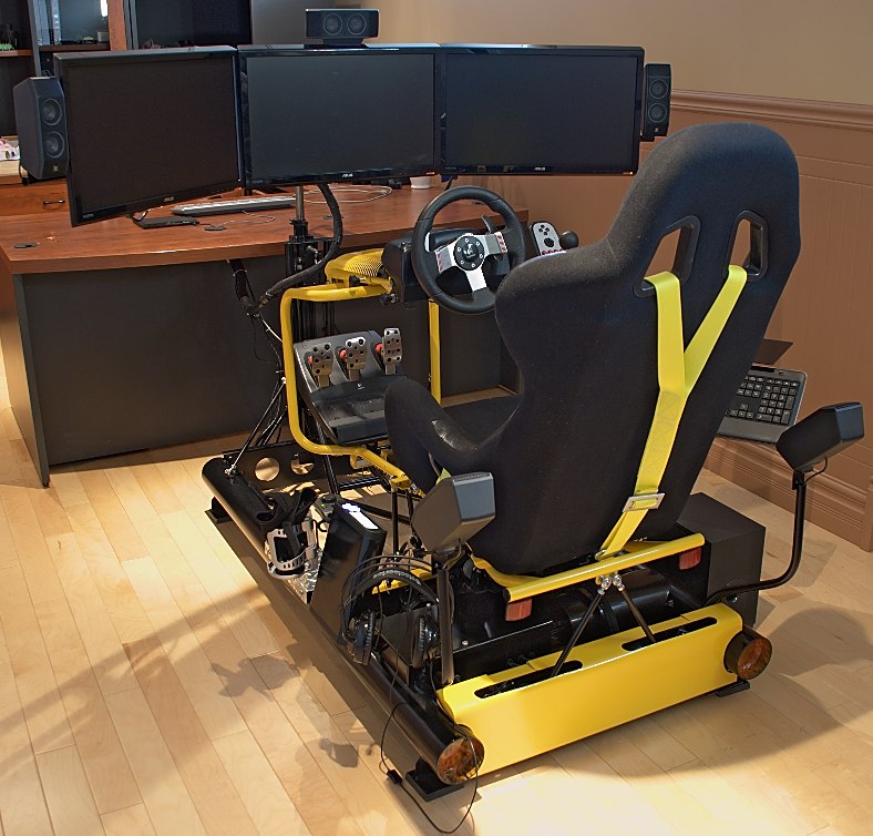

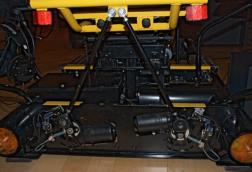

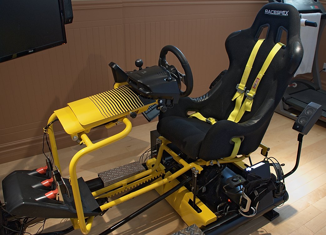

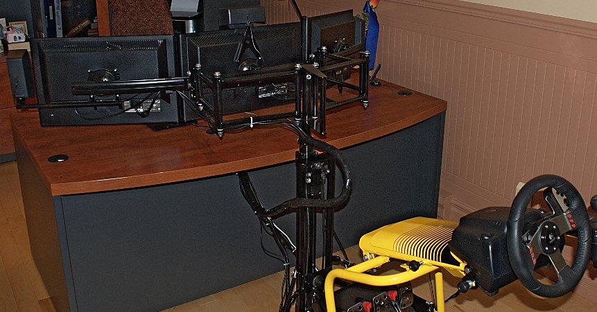

    Project completed and racing
    Hi, it's been some time,
    I was busy building but now I am happy to announce that the project is operational and I am very :) :yes: :) satisfied with it.

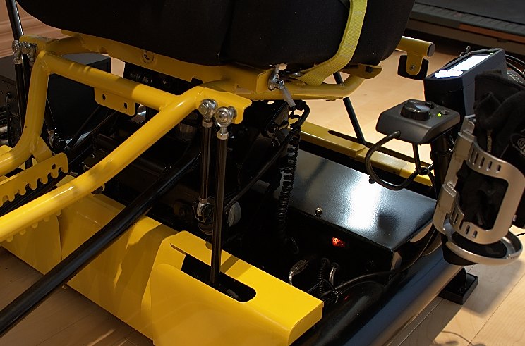

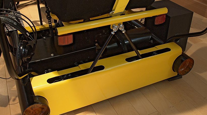

    The front motors attachment and the stabilizer bar (20 in/lb) that ease the work of the motors.
    Rear motors in the low positions
    A view of the way they are positionned and the Softpot Rotary Potentiometer that I find very convenient. Also note the self made polyurethane bushings.

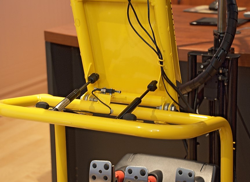

    The steering tilt to ease boarding and is held up with gas struts. A micro-switch reports the status to the microcontroler and the seat is automatically set to a boarding position with nose partially down.

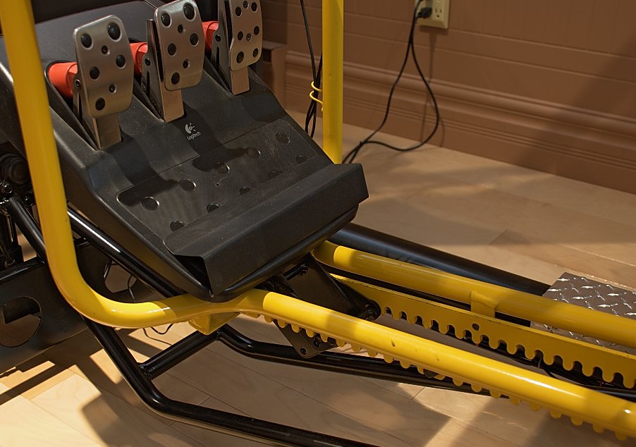

    Simply lift the front of the pedals and slide it on the track to adjust in a snap. This way my grandchildren can race easily when they come home.
    When not racing the monitors can be rotated and lowered easily since their support is an old air cylinder. I do not need 6 monitors in that room.
    Everything has been hand made except the pedals track and most have been done twice or more.
    It was a very exciting learning experience and it is not completely over yet. A 4.3 touch screen will take place as a console for the system and communicate with the Arduino Mega which runs without a PID but a much simpler formula that was very easy to create and quickly calculated. The compiled sketch is less than 12K and the delay from the Profiler is 8ms. I use Sabertooth motor drivers.
    Some might ask about motor temperature when racing and my answer would be that after 2 hours the highest reading was 41.2°C
    The micro-controler also monitor the air pressure of the supporting system and adjust even while racing. All I notice is a click from the solenoid valve.
    A video is being edited and will be posted to YouTube asap. The link will be shown here.
