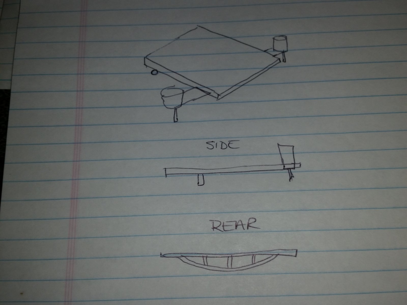

    First of all, I'm sorry for the crude drawing.
    I'm gonna make a flat platform with a solid floor, a rocker and the motors.
    Secondly, this is gonna get real simple, real fast.
    I'm so new to the motion stuff that I don't know what most of the language in this field is. PSU, multi turn pot,and JRK?
    I've gotten from the context of reading posts that a JRK is a control board? and PSU is a power supply unit for the motors?. what motors are pictured in the add for the T1000 static? worm drive?
    So all I should need is the 2 motors, a couple FSU's capable of running them (cooly) and a couple of JKRs to get my computer to talk to them right?
    What are pots for?
    Oh...and the blood, sweat and tears too. LOL
    Thanx all, GREAT forum!!!!!!

    Hey @Kyle Bright - The basic setup is like this:
    The JRK is the brains of the operation. You will connect the POT to the JRK and also connect the +/- of your motors to the JRK.
    You also connect the 12V supply to the JRK.
    The JRK then in turn plugs into the USB of your PC, and reads the game data from SimTools.
    Based on the POT position, the JRK then knows which way to send the motor to get the desired motion.
    The pot is connected to the motor shaft so it can detected (and feedback) the position of the motor (Heaps of pictures on here detailing this)
    Your PSU will need to handle upwards of 25AMP, so most people use Server Power Supplies like the HP DPS-600 / 700 or DELL variant.
    In basic terms:
    (USB)
    PC <------------> JRK <--------- MOTOR
    ............................ | |________> FEEDBACK POT
    ............................ |_____________> 12V supply.
    (Ignore the fullstops, they are fillers for the diagram :) )
    The T1000 uses actuators I think. Most builders on here use the Wormdrive 200W motors with either a 25:1 or 50 / 60:1 gearbox. Again, the motor you end up choosing will go a long way to determine which Sim you build. This is a personal choice, but most prefer the 200W motor paired with a 60:1 box.
    Going down the JRK path for me was a no brainer. The boards are rock solid, and while I have played with Arduino for other projects, having a proven robotic grade board doing all the logic for me was an obvious choice.
    As always, everyone here is awesome and happy to help. Ask questions and don't be shy!

    Sorry for the spam... I just checked your diagram. Your drawing is more an actuator based model. Others can speak to the best way to achieve that. Most of us use simple levers and motors to get the movement.

    What you have in mind design wise is what Playseat have used for their commercial sim: http://www.xsimulator.net/community/threads/playseat-compact-2dof-motion-simulator-2014.5788/
    Be warned Dbox actuators are very expensive compared to DC motors, some have durability issues and much cheaper DC motors can exceed them in performance. @SeatTime is currently developing his own DC powered carbon fiber actuators but that is not something for a newbie.

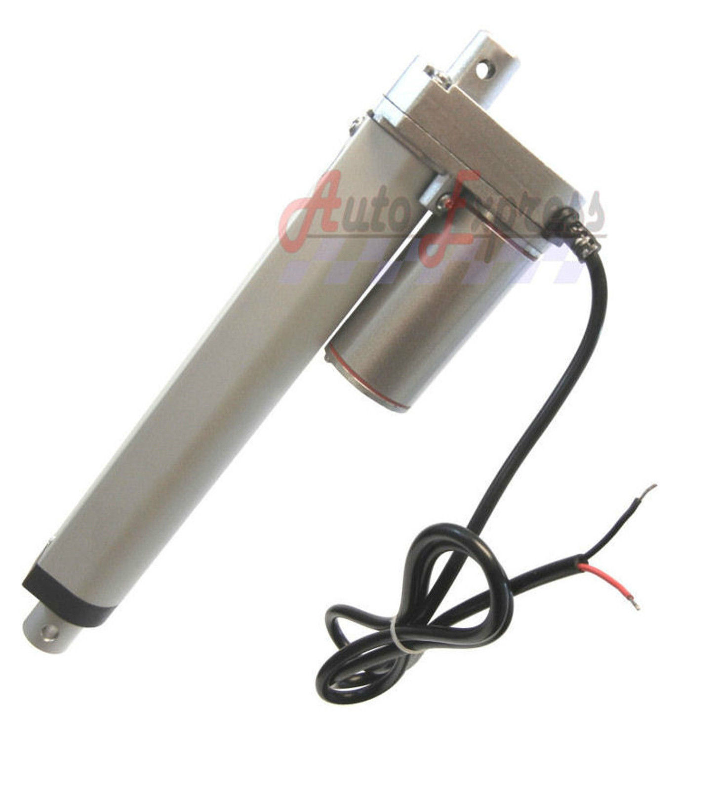

    ok guys, I have my plan in mind, but that just creates more worries and questions ehh?
    I am going with the 2 DOF platform idea that is in my drawing, however, I am going to use linear actuators at the rear with the COG "rocker" towards the front. I have found many dc linear actuators at $80.00 (U.S.) or less, even as low as $40.00. They are available with pots built in.
    I'm thinking this would create a lot less work. Most of the info around here is for motors and not so much for linears like this. I'm curious what speed and strength I'm looking for? The specs in the descriptions are foreign to me (for now)
    I also am assuming that JRKs will still work with something like this right?
    Lastly, I'm thinking this setup is gonna require a second PC to run it correct?

  12. noorbeast
    21,506
    150,656Coins
    +11,018 / 55 / -2
    You have not listed the specifications for this but these cheap actuators are way too slow for motion simulation , often as much as 100 time too slow.
