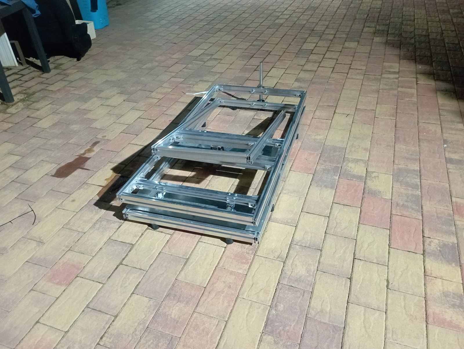

    First I want to share the images of my work 2 dof

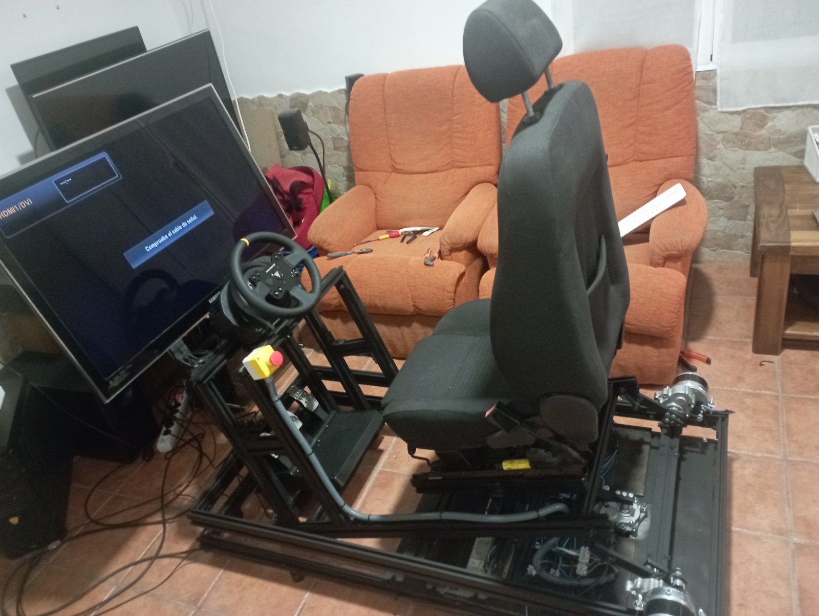

    now start with the 3 dof, I'm with the structure, that's how I carry it...

    We continue with the structure and anchorage of motors

    third engine anchored

    a little more paint and ready to start with the electronics

    hello, after solving the problem I had, I mounted the seat on the structure and began to do the first movement tests, then I find that it is very unstable, it has a lot of play and I think it is because the motors are too far forward. Do you recommend putting the motors as close to the cardan as possible?
    21,517
    150,722Coins
    +11,018 / 55 / -2
    What are you using for the universal joint?
    If there is play best to work out where it is from.
    Moving motors closer to the pivot point also means they have to be able to produce enough torque, as the closer you get the more torque required.

    that's what i'm using, i think the motors are strong enough to be in a wheelchair, what do you think? a lot of separation and exerting little force near the cardan.
