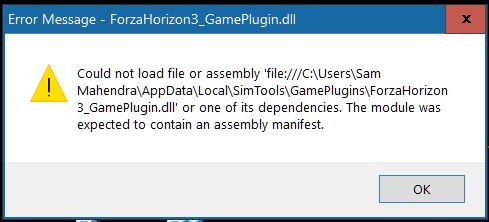

    Help me please.
    I developed a Plugin for FH3 by following this tutorial.
    https://www.xsimulator.net/communit...ugin-for-simtools-2-0-api-documentation.9107/
    Used the Plugin updater and it was successful.

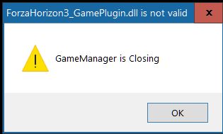

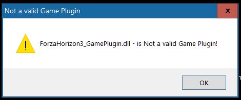

    When I launched the Game Manager, I got this message.
    When I clicked OK, this was the message.

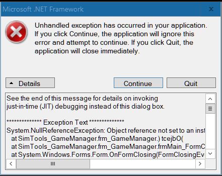

    Followed by,
    This is the full text of the Exception Text.
    System.NullReferenceException: Object reference not set to an instance of an object.

    Was there an error during compiling? Your dll generates all kinds of irregular moans when checking it with the PluginValidator.exe
    Can you try to compile it again?

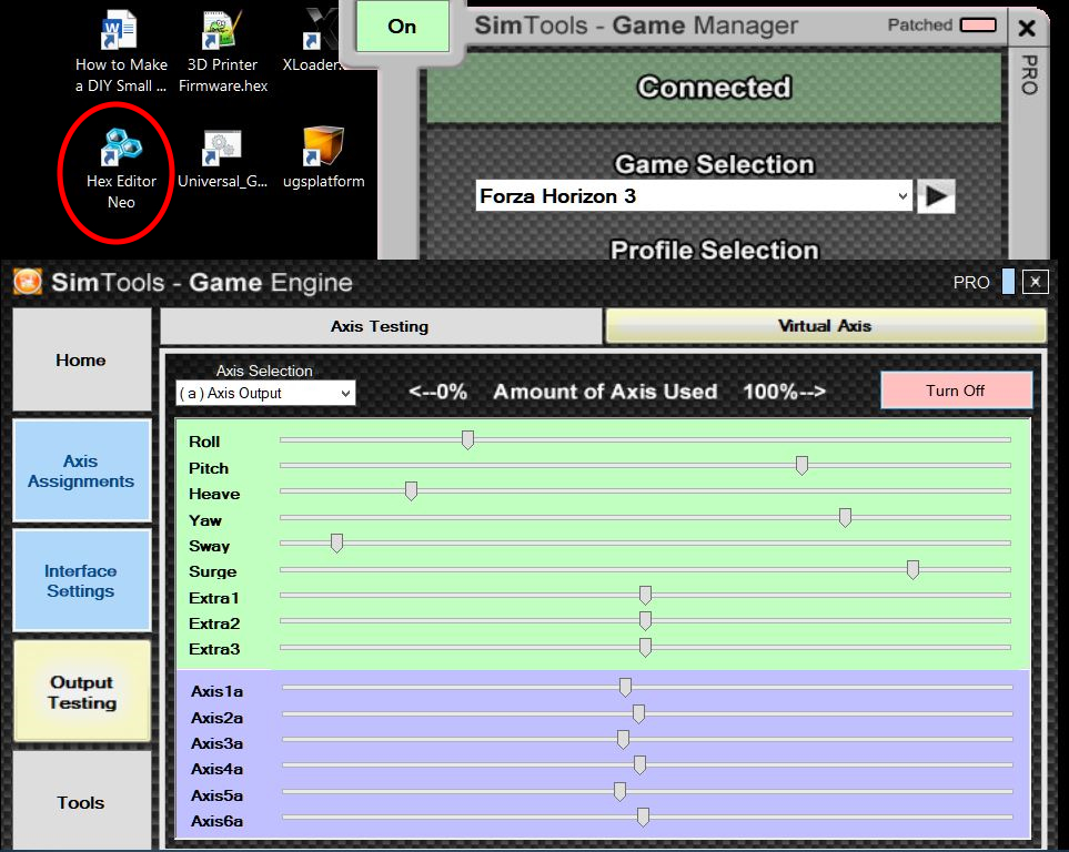

    Well, as suggested by @noobeast, I tried the memory hook. It was tiresome. So, I looked for a DLL editor and came across this one,
    'Hex Editor Neo'.
    I unzipped the "ForzaHorizon4_GamePluginV2.0.0.2", and edited the ForzaHorizon4_GamePlugin.dll by simply replacing the letter 4 in the ForzaHorizon4_GamePlugin.dll, with the letter 3, saved it as ForzaHorizon3_GamePlugin.dll; then edited the other two files, ForzaHorizon4_Banner.jpg, by erasing the letter 4 and typing 3, saved as ForzaHorizon3.jpg, and also edited the ForzaHorizon4.cfg to change the ForzaHorizon4, to ForzaHorizon3 with a text editor, saved it as ForzaHorizon3.cfg. Zipped up all the three files as ForzaHorizon3_GamePluginV1.0.0.1.zip
    Launched the "SimTools_PluginUpdater"; it updated well, no problem.
    Launched the SimTools, selected ForzaHorizon3 and was able to test my hacked ForzaHorizon3 plugin.
    I was able to simulate the motions on the virtual axis. Here it is.
    But ALAS, belatedly I discovered that, FH3 does not send Data Out.
    Ha ha, all that effort wasted, but it was fun.
