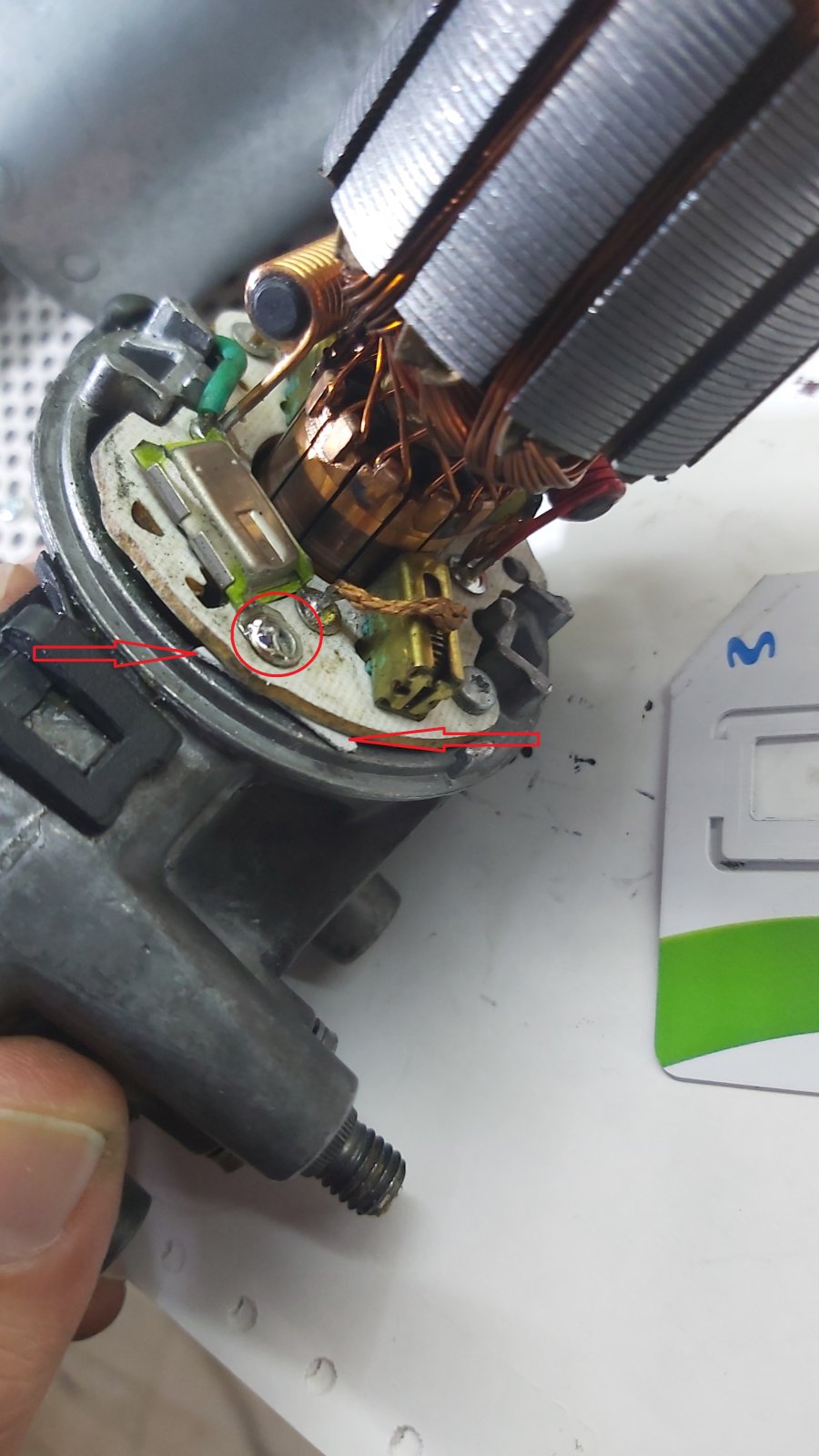

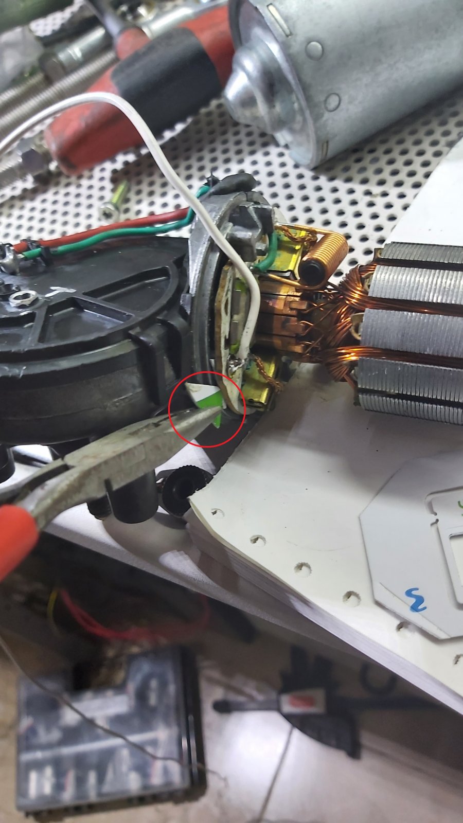

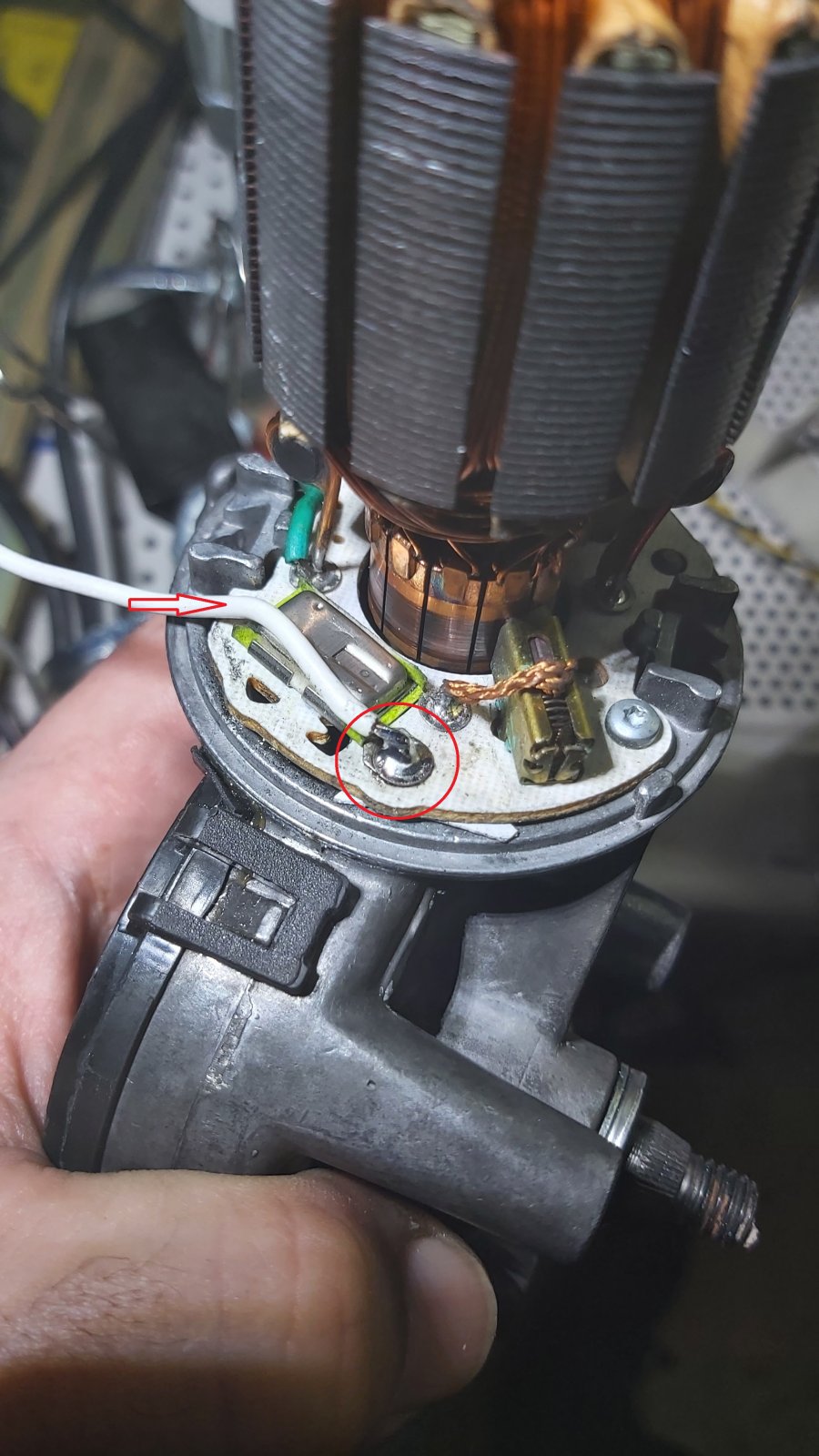

    First step I bought some windshield wiper motors, the first challenge was to disassemble them to isolate them from the ground. I leave you some photos as I did it, maybe it can help a beginner like me to see some images as I did.

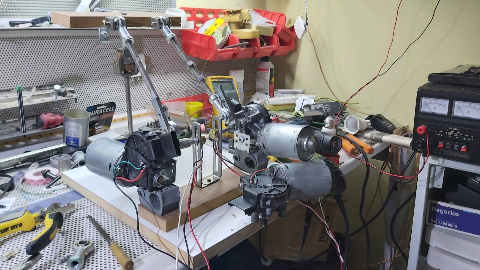

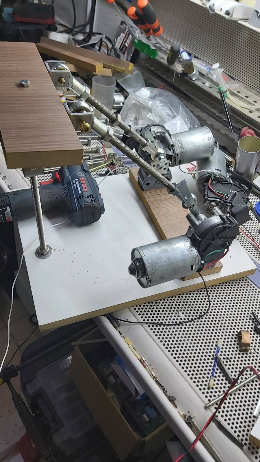

    Then, before mounting the motors, I decided to make a small model to do the first tests with Sim Tools and SMC3. This weekend I will advance a little in this, I leave you some photos.
