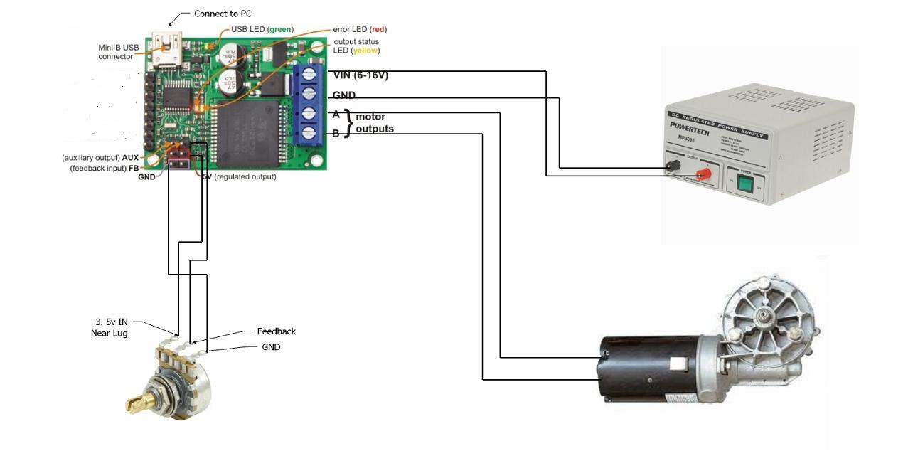

    @rundmg covered it well. JRKS are the simplest to set up, no coding whatsoever, just some PID and motors commands and you are off. They will run 14v at 30 amps continuous with heat sink and fan cooling, and spikes of 45 amps easy . One per motor.
    Heres a wiring diagram

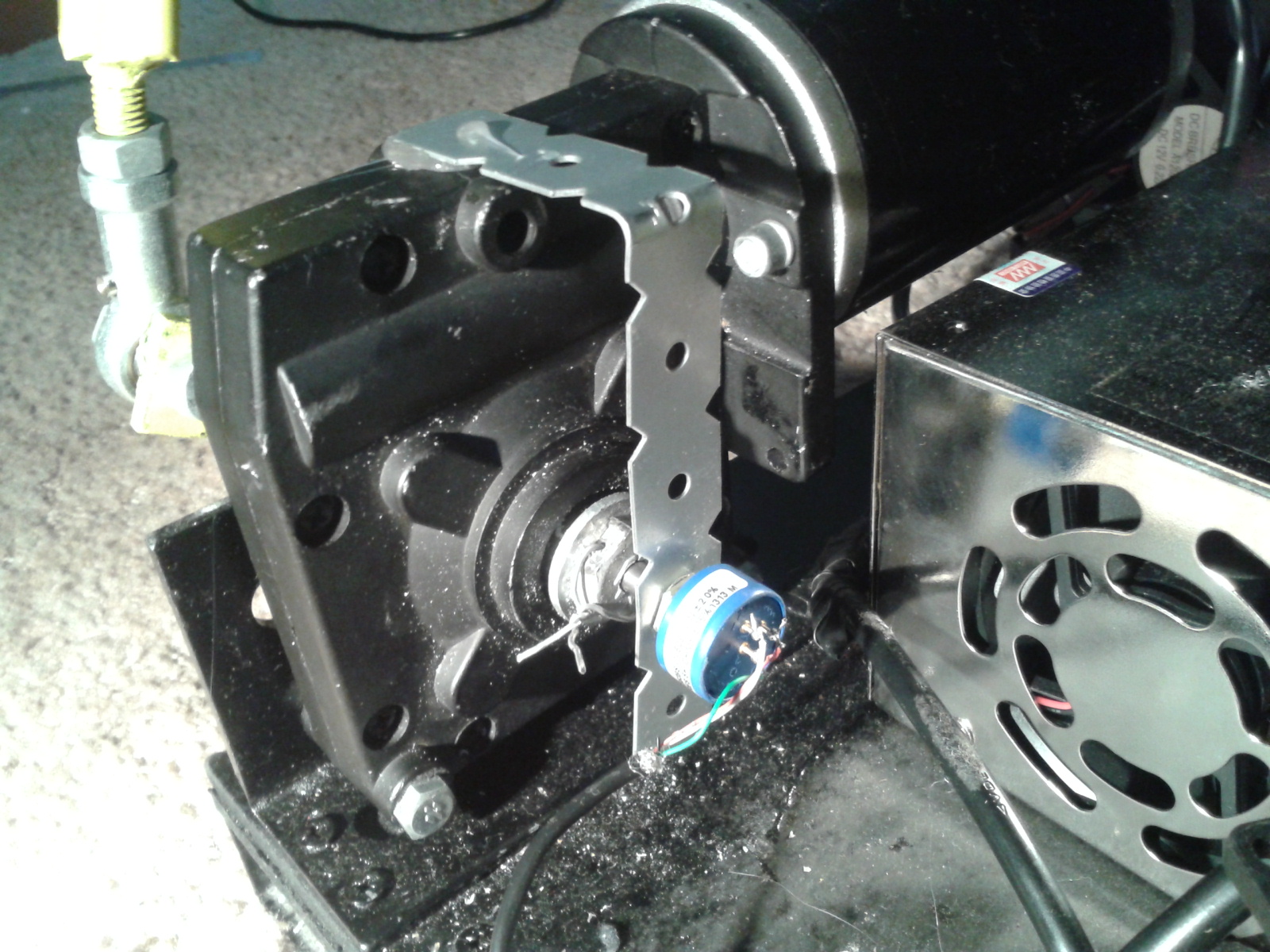

    and attach the pot to the back of the motor shaft something like this

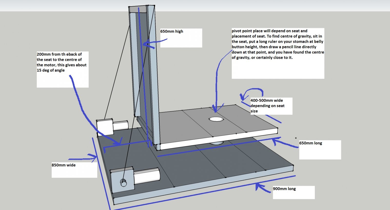

  9. bsft
    @Ben Selph , look up @eaorobbie seat mover from static frame thread for info.

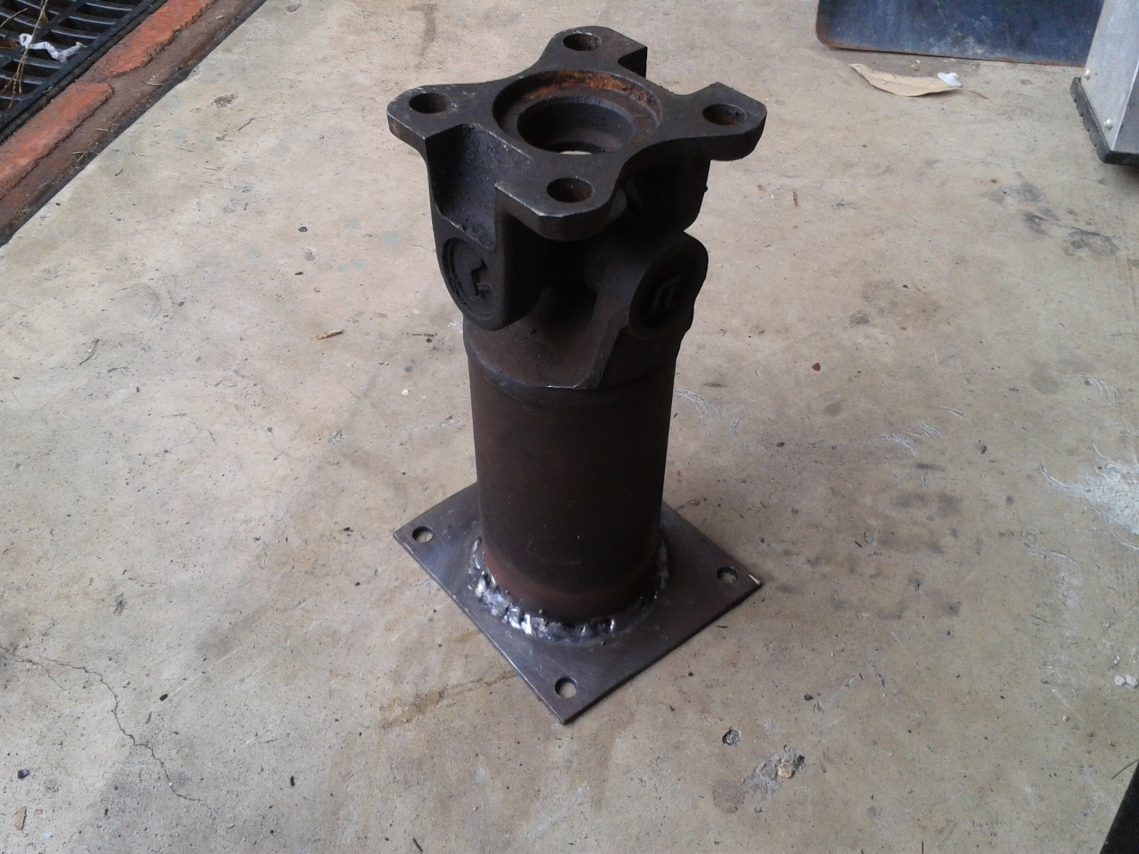

    oh hang on, heres a sketch of a seat mover
    use a cut down tailshaft as the pivot or a steering knuckle from a truck

  15. bsft
    I did attach a photo of wiring the JRK akready in an earlier thread

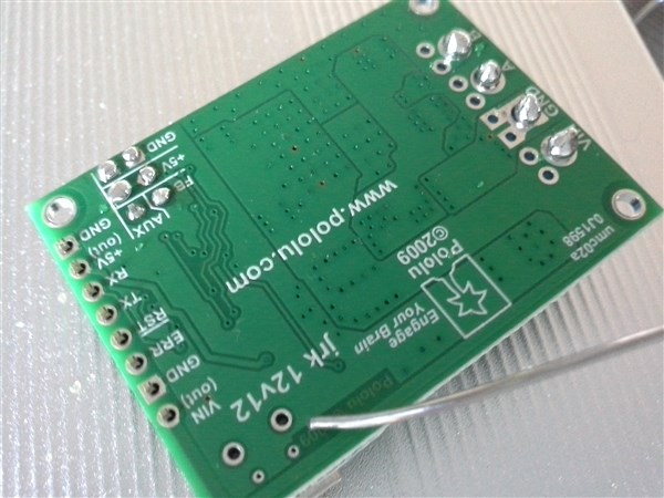

  18. noorbeast
    21,506
    150,656Coins
    +11,018 / 55 / -2
    @bsft mentioned he had already attached this here: http://www.xsimulator.net/community/attachments/jrk-to-wiper-wireup-fixed-jpg.16743/
    For my build I used @Slider's HP PSU guide: http://www.xsimulator.net/community...-server-power-supply-for-12v.5774/#post-60617

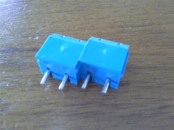

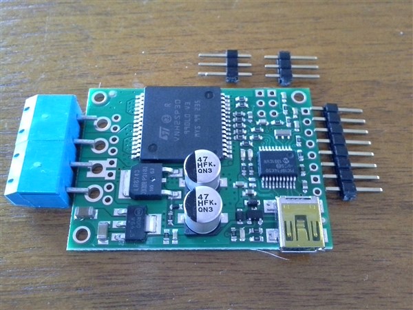

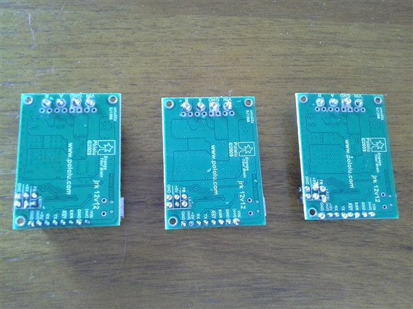

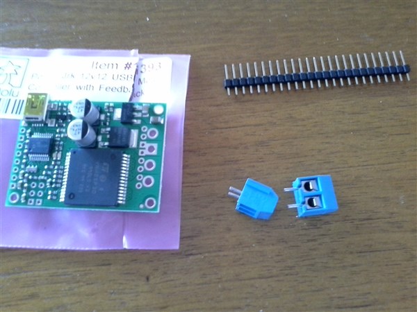

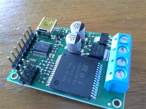

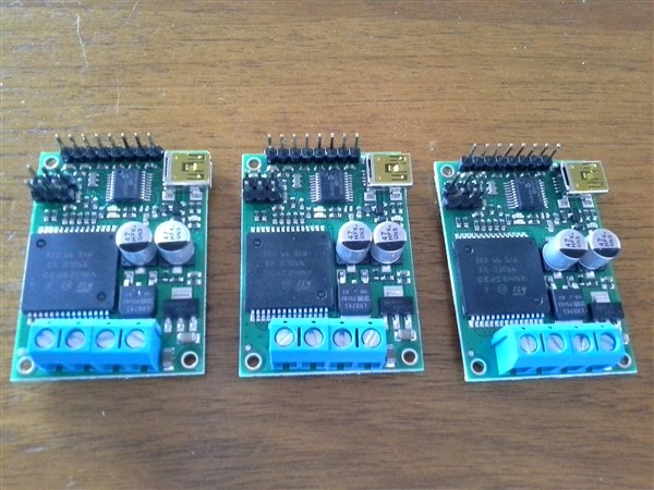

    This is how a JRK is put together:

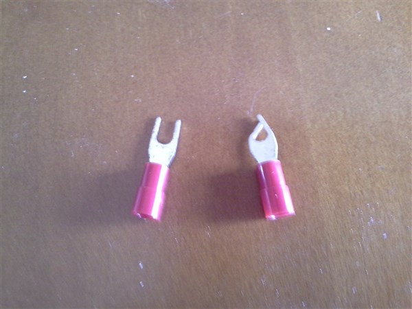

    20141028_180258.jpg 20141028_180351.jpg 20141028_180546.jpg 20141028_180722.jpg 20141028_181358.jpg 20141028_182029.jpg 20141028_182048.jpg

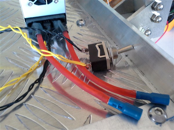

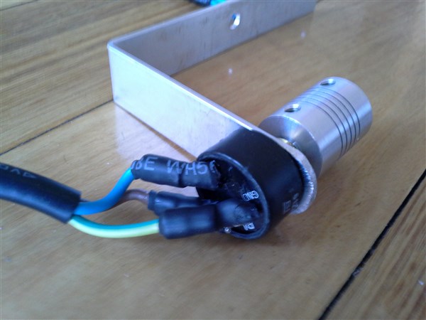

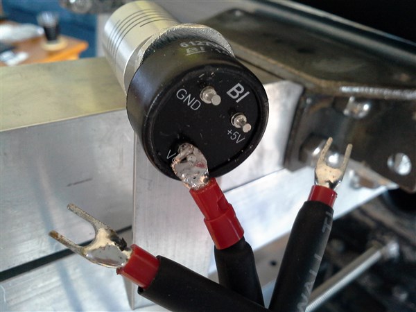

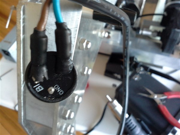

    This is how I connected the pots:
