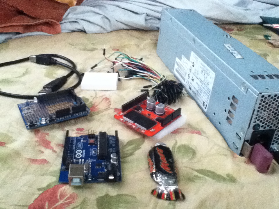

    I have chosen to use the Arduino UNO board, Moto Monster and the HP DSP-600pb power supply. As I currently don't have a consistent job right now I'm going to use 2 wiper motors 12v, and when more monies come my way I will purchase a set of worm gear beasts recommend by (Eaorobbie). I have to get 2 potentiometers, some wires and maybe some other little things nuts and bolts etc.

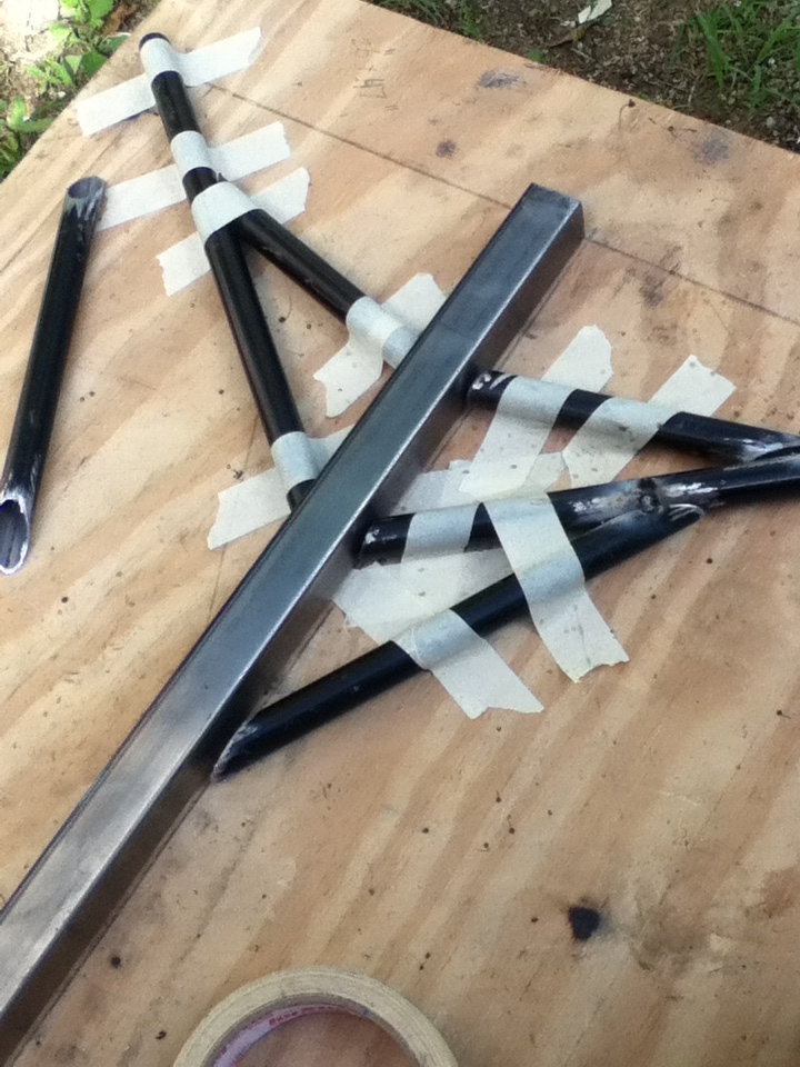

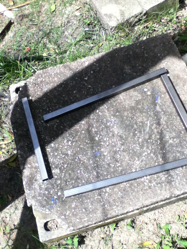

    Finally bought me (1) length of 1" tube for the rear section of the motion chassis, going to do some cutting and welding today :)

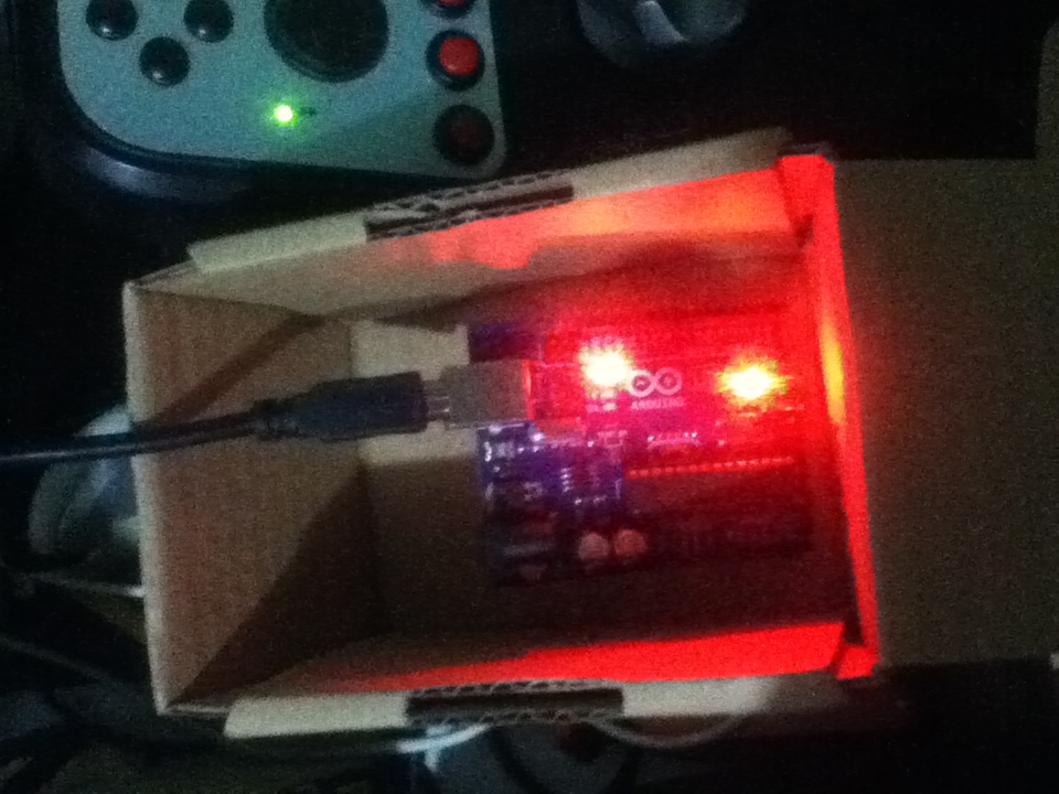

    In the picture I see that you have three circuit boards, can you tell me name of boards.
    Thank you
    Greetings
  10. eaorobbie
    20,487Coins
    +1,687 / 23 / -2
    @Ramok His using a Arduino R3 and Monster Moto Driver to control 2 wipers. All in his first post.

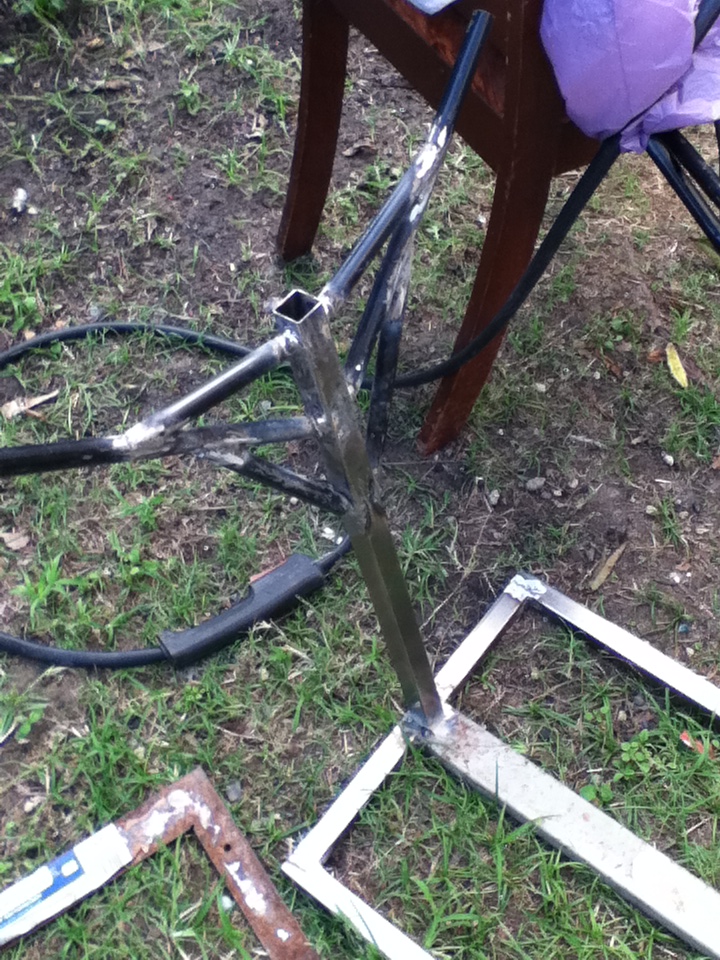

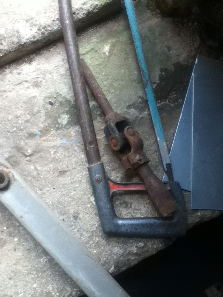

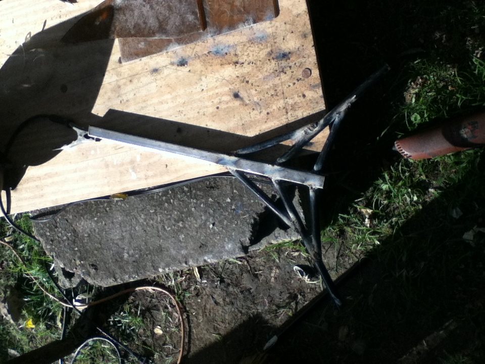

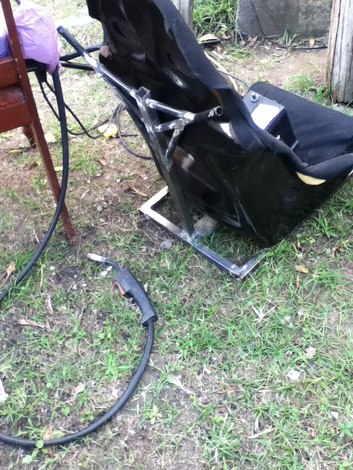

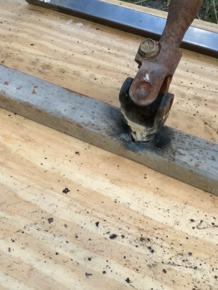

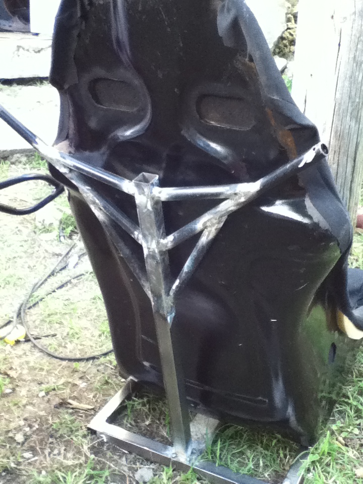

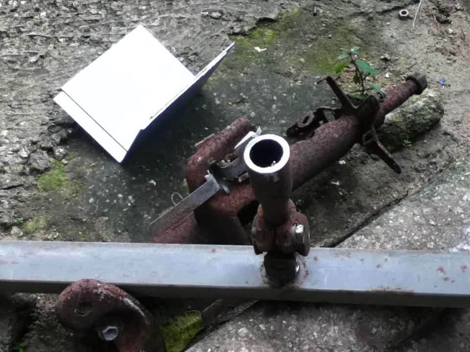

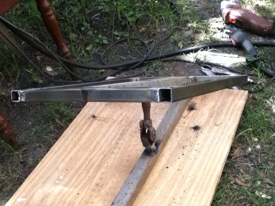

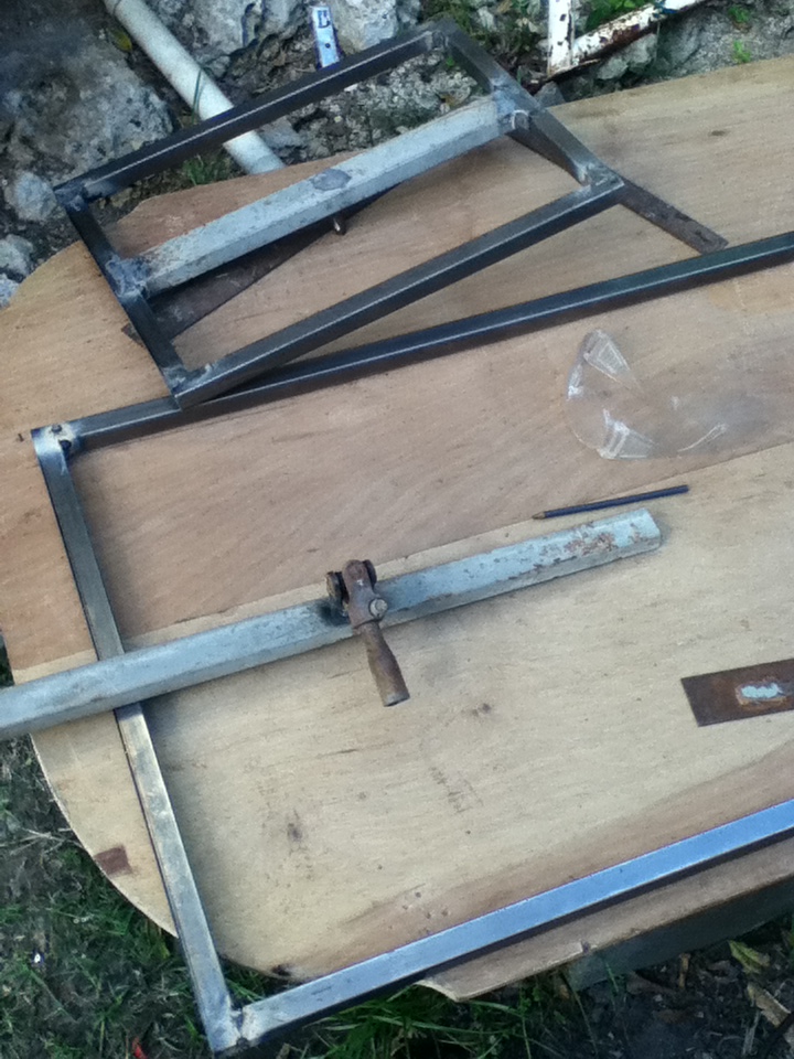

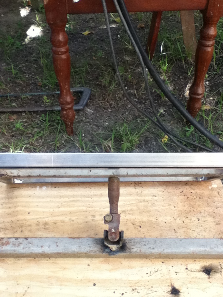

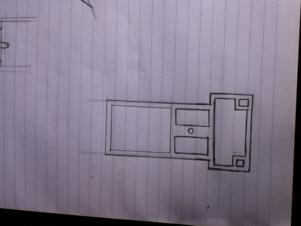

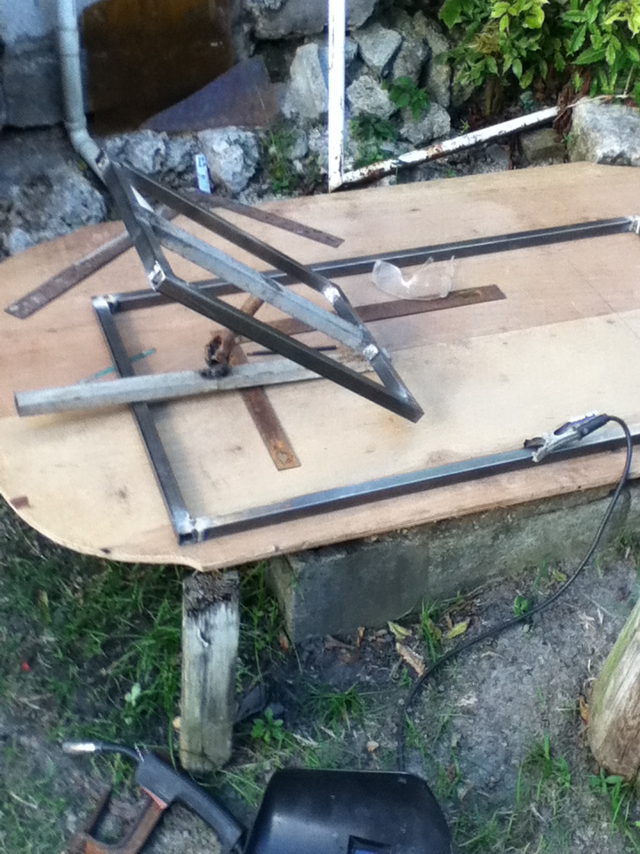

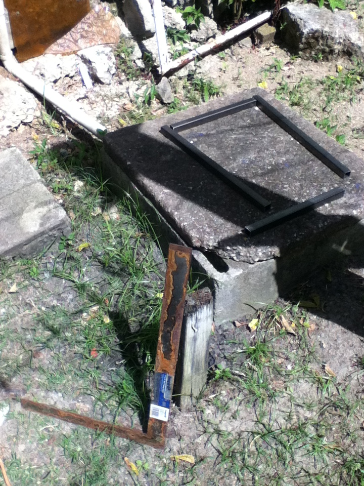

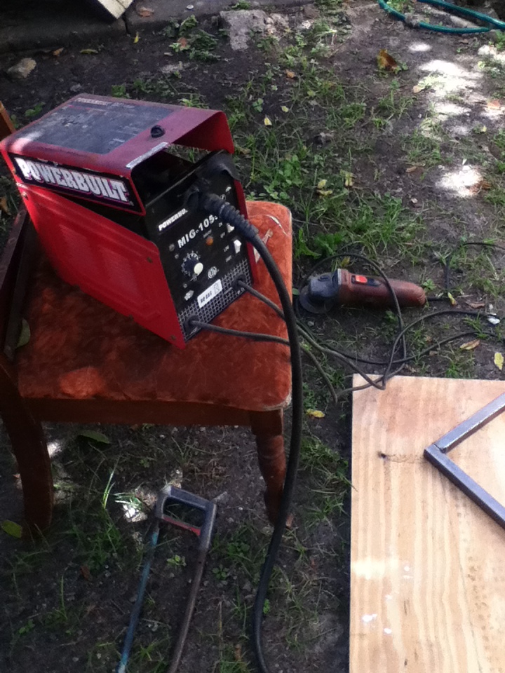

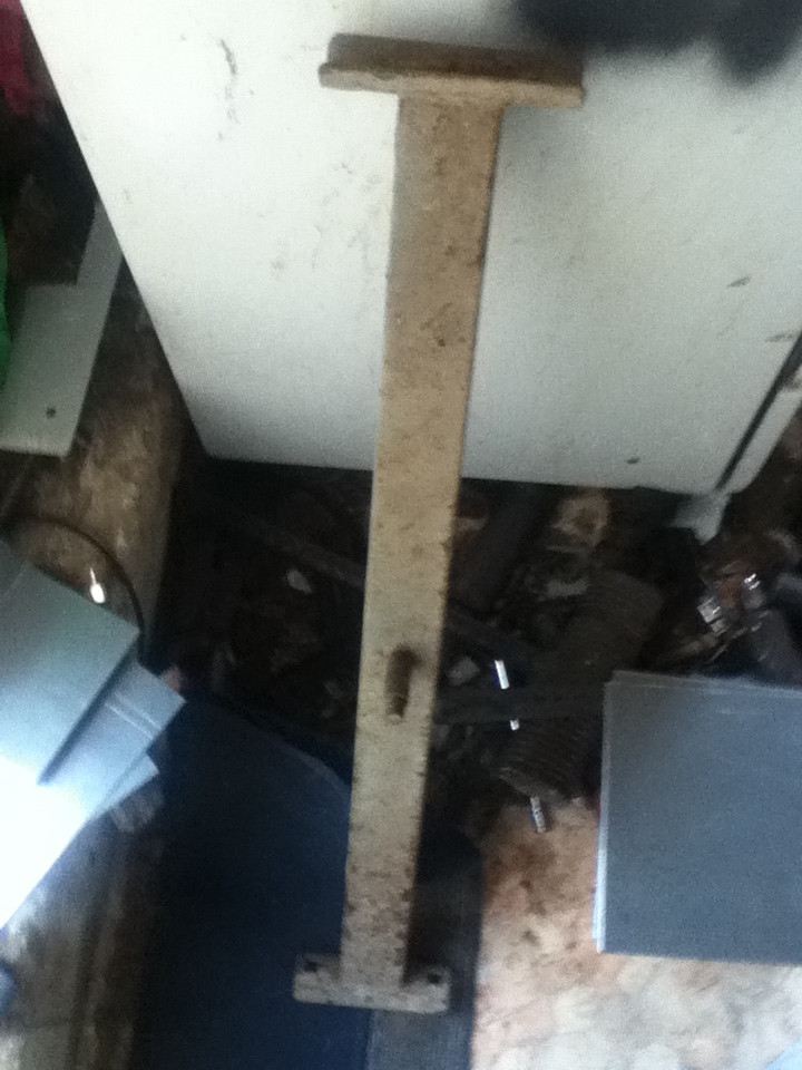

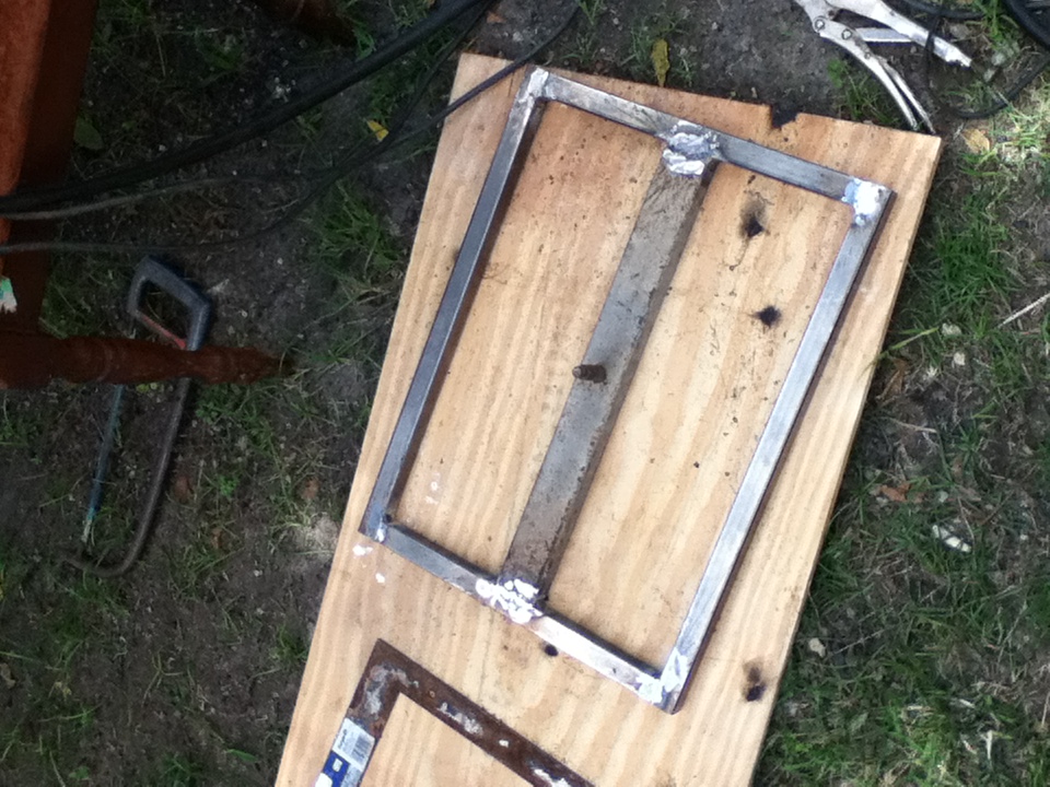

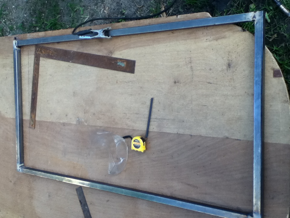

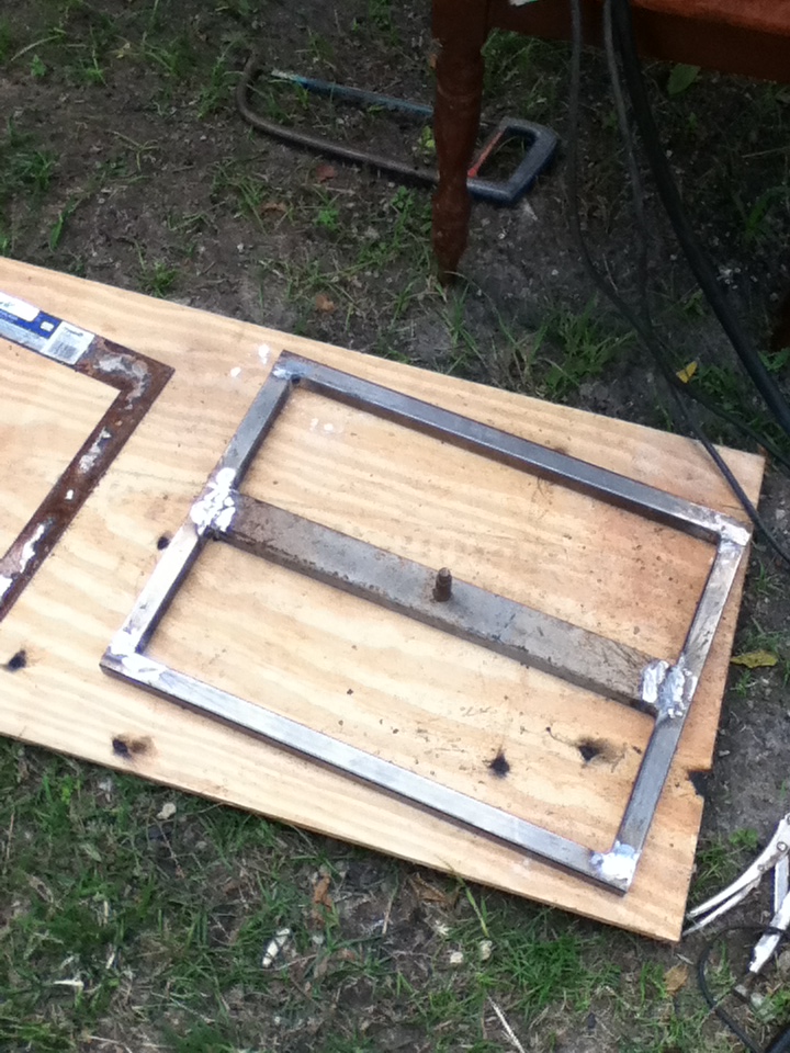

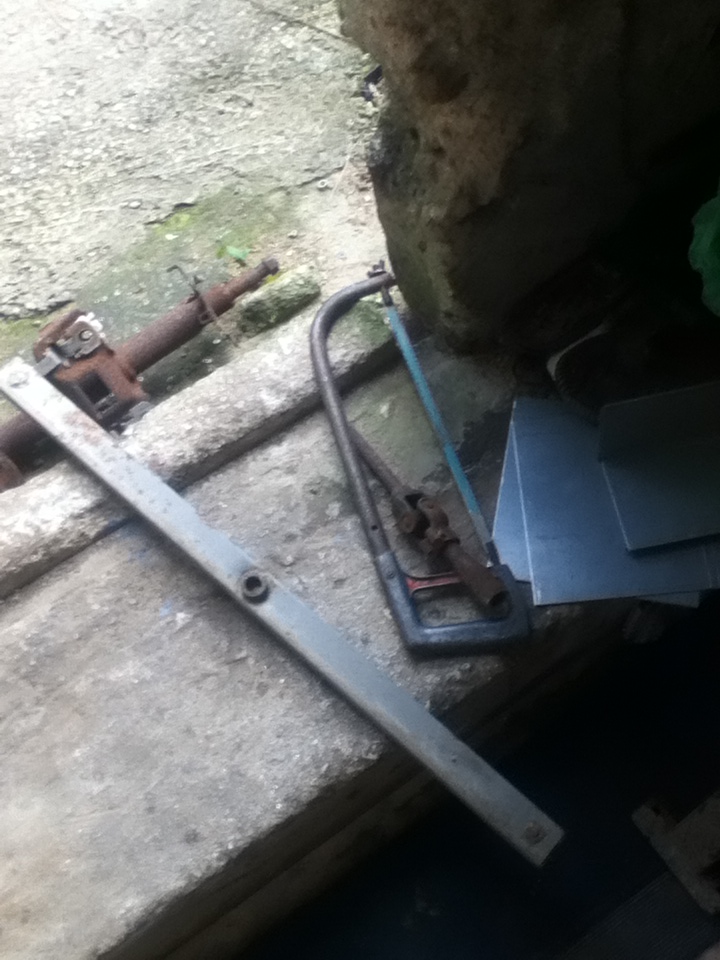

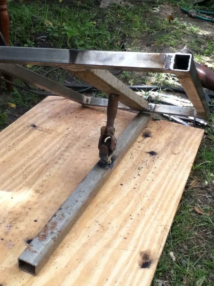

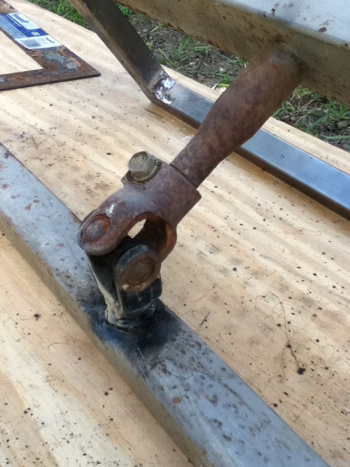

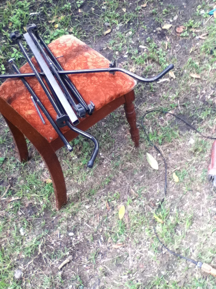

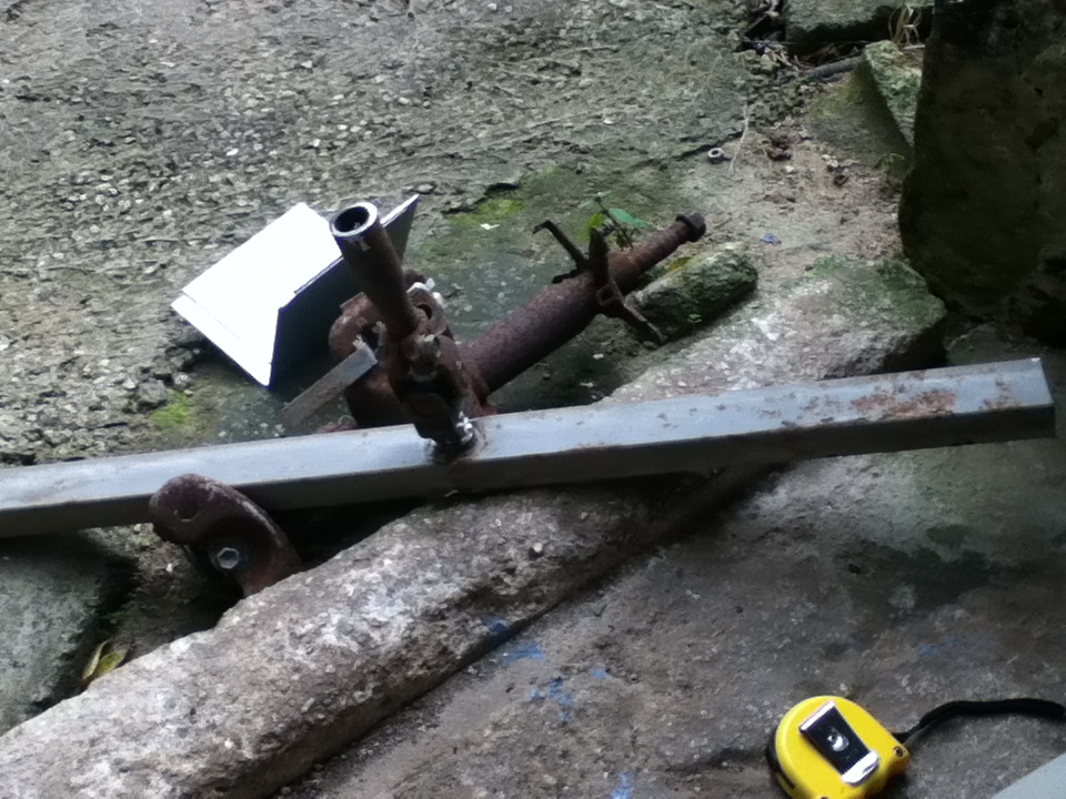

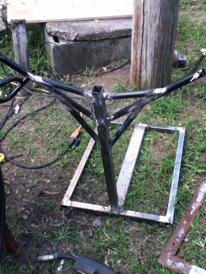

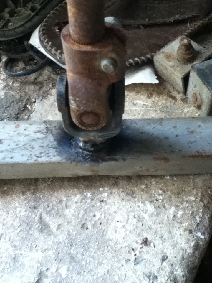

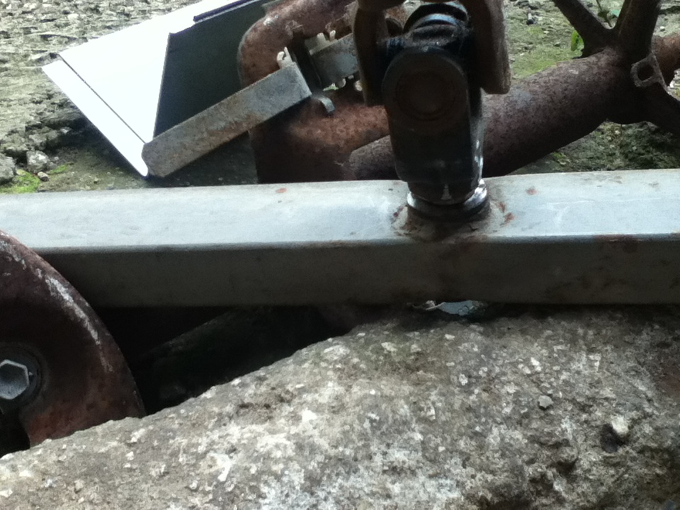

    Here are a couple of photos of the project 246
    Items

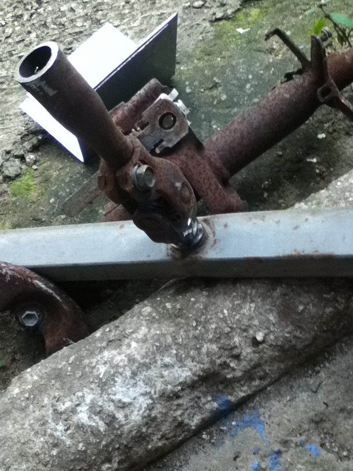

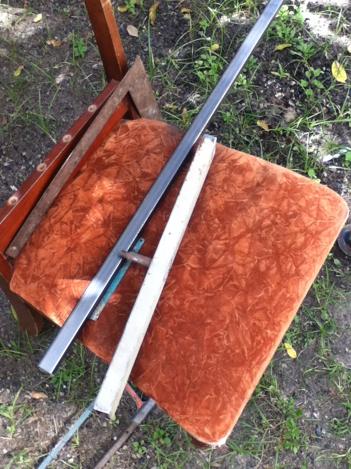

    Old exercise device, 20' of 1" tube, steering swivel .....
    IMG_3143.JPG IMG_3144.JPG IMG_3146.JPG IMG_3148.JPG IMG_3149.JPG IMG_3151.JPG IMG_3152.JPG IMG_3155.JPG IMG_3157.JPG IMG_3160.JPG IMG_3162.JPG IMG_3168.JPG IMG_3176.JPG IMG_3177.JPG IMG_3178.JPG IMG_3181.JPG IMG_3182.JPG IMG_3184.JPG IMG_3185.JPG IMG_3188.JPG IMG_3190.JPG IMG_3191.JPG IMG_3194.JPG IMG_3198.JPG IMG_3201.JPG IMG_3202.JPG IMG_3206.JPG IMG_3208.JPG IMG_3209.JPG IMG_3210.JPG IMG_3211.JPG IMG_3223.JPG IMG_3224.JPG IMG_3225.JPG IMG_3227.JPG IMG_3230.JPG IMG_3231.JPG IMG_3234.JPG IMG_3235.JPG IMG_3236.JPG IMG_3238.JPG IMG_3240.JPG IMG_3241.JPG
    Due to not owning a rig before I decided to build a complete unit :)

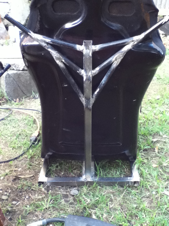

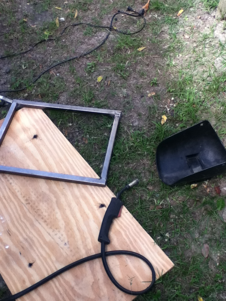

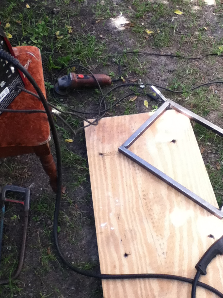

  12. Kevin thee Bajan
    Kevin thee Bajan New Member
    Nov 18, 2013
    17
    929Coins
    +12 / 0 / -0

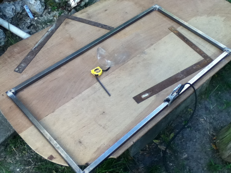

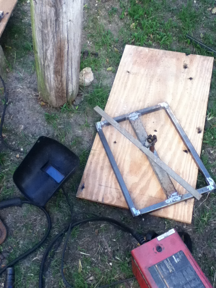

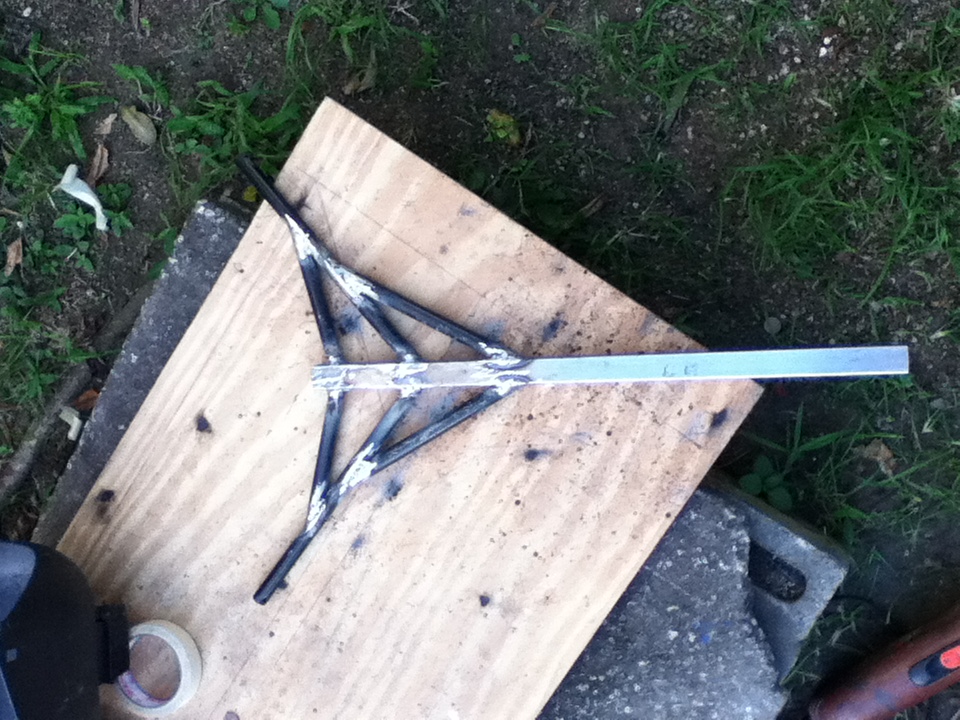

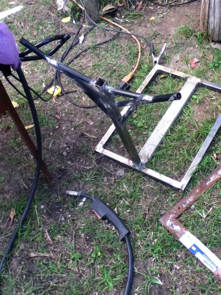

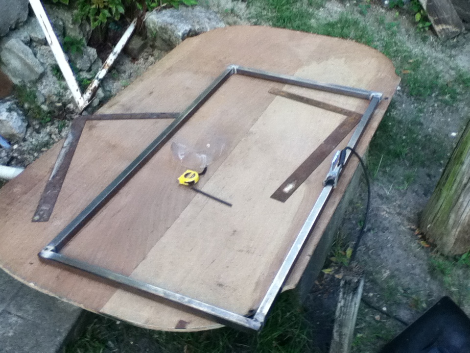

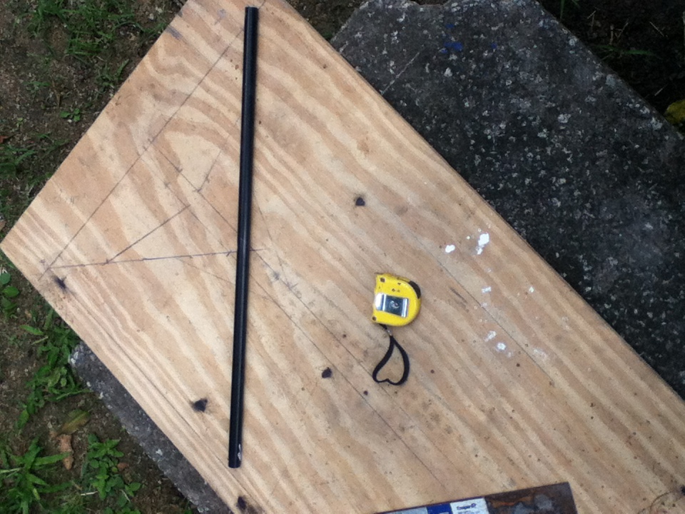

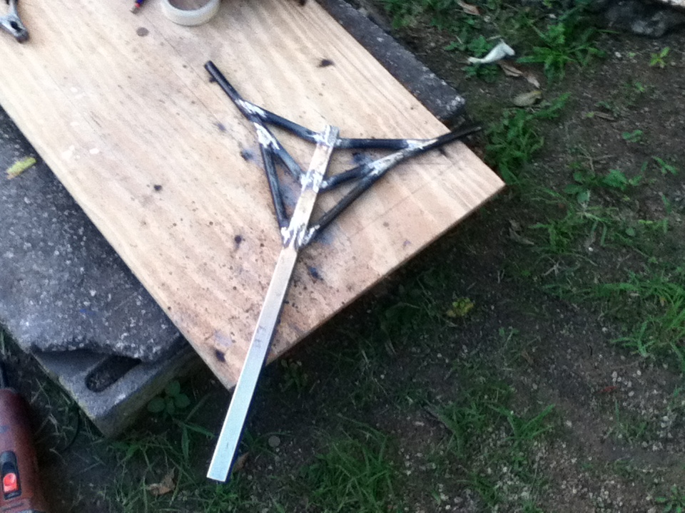

    Cutting by hand is not fun at all :( but it makes the finish job worth cherishing more:cheers
  13. speedy
    speedy Well-Known Member
    Feb 1, 2012
    1,193
    Alexandria , Egypt
    7,943Coins
    +1,287 / 10 / -0
    Wow I love that back support style ... Great progress indeed :thumbs...
    If I may suggest, give it a little backward bend to make more room for the chair if not well seated ...
    And you have more followers now :popcorn... you may have some and get back to work .:grin
  14. Historiker
    2,161
    9,208Coins
    +2,168 / 19 / -1
    I agree, having and angle behind the seat lets you make the sleds overall size smaller. I did the same thing. I made mine at a right angle, found that it does not work well like that and then cut it apart and made it at an angle to fit the chair.
    Overall well done!

  16. eaorobbie
    20,487Coins
    +1,687 / 23 / -2
    @Kevin thee Bajan one quick thing , I might be seeing wrong thou, the pivot point is close to the base of the chair because if it is not the weight and resulting motion will be an issue later. The further away the centre of the pivot is from the cg of the rig will cause your motors to work very hard. Pivot needs to be as close as possible to the base of the chair.
    How did you work the balance point out, I would suggest building the top part completely and placing everything on the top part, as in wheel, pedals, keyboard, etc and placing a round object under the the rig with you sitting in it to find the exact place the rig will balance at, this point is where the centre of you uni needs to be and as close to the bottom of the seat. All done to get the best out of your motors and H Bridge. The more balanced it is the better the resulting motion will be.
