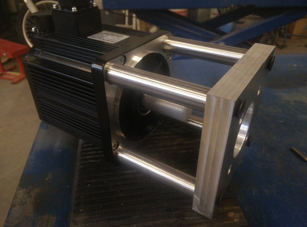

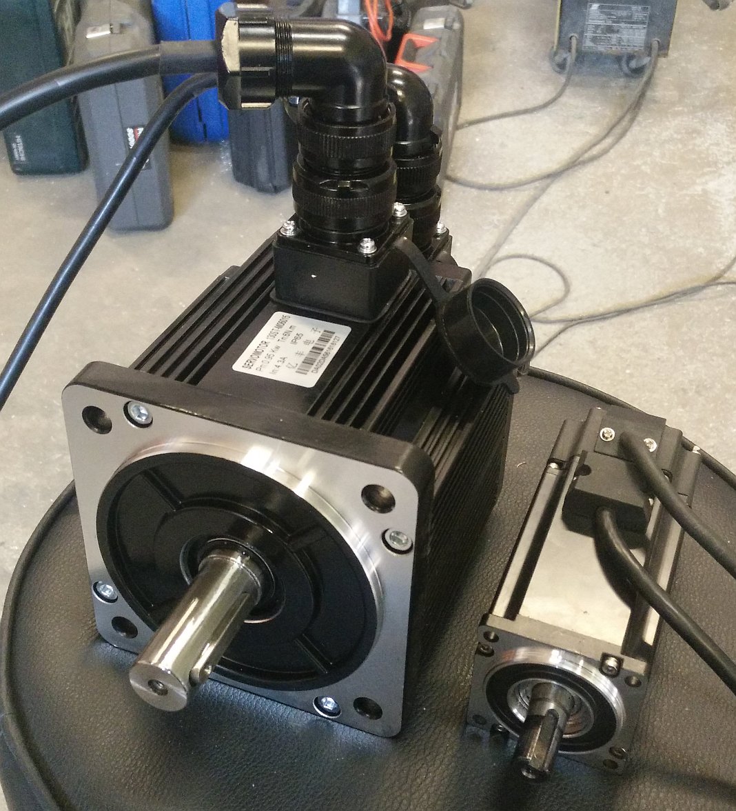

    This is something i have been doing couple months now and it is nearly finished. It all started when i found these quite beefy AC servos online with a reasonable price tag. I was about to start building pneumatic motion sim, but ditched that idea when i found these puppies:
    Specs: 1kW/6Nm continuous / 3kW/18Nm peak (3 seconds). 400W servo from my bf20l cnc machine for comparison.

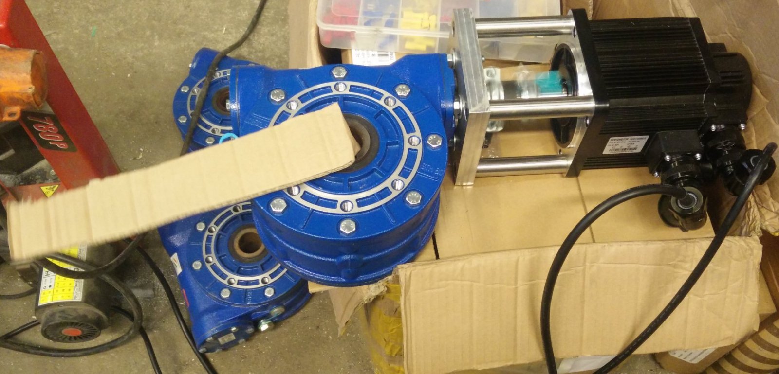

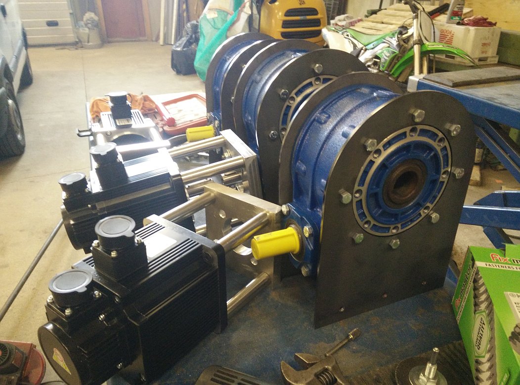

    After i got my servos i needed some gearboxes... ...aaaaand then i found they are ridiculously expensive. I tried sourcing 1:50 ratio planetary or conventional reduction gearboxes that meet the torque requirements and every single one was way beyond my payroll... Luckily i managed to find a private guy who apparently bought bankruptcy estate that had hundreds of worm gearboxes! Visited him and managed to find 3 identical worm reducers that had spec sheets and everything, but not with 1:50 reduction. In the end i had to settle with 1:100 reduction and have lower top speed for my sim.
    Specs: 1:100 reduction. Output shaft diameter 35mm and torque rating way beyond what i needed.
    Next task was to make these fit together. These worm gearboxes didn't really have any attachment points for input flange so i had to use four bolts that keep input shaft cover in its place. This was pretty straight forward task with a cnc milling machine and small manual lathe:
    After i bolted everything together i tried jogging it with a piece of cardboard. Shafts are connected with a piece of thick rubber tubing and beefy clamps:

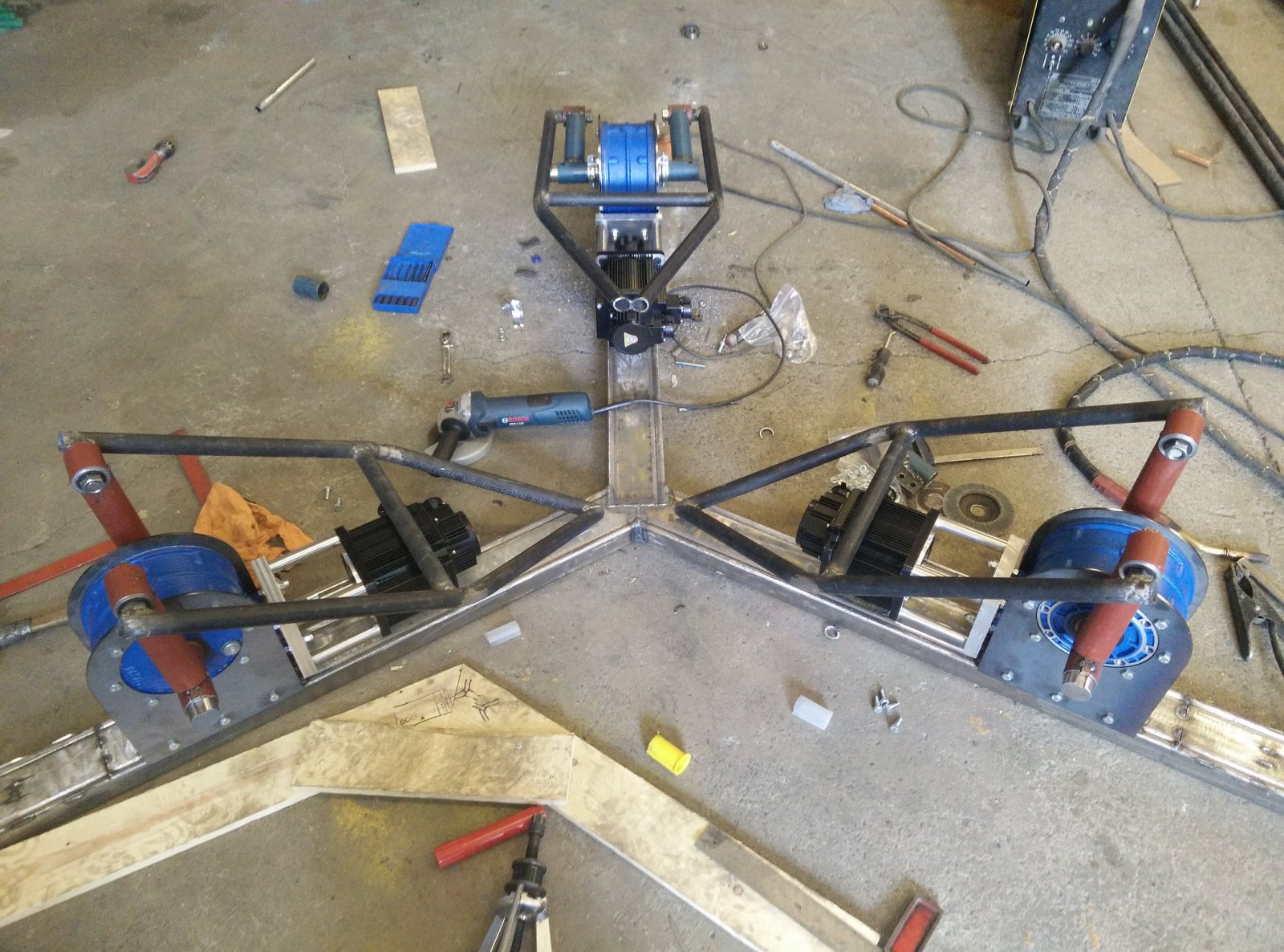

    Now i needed a way to hold worm gearboxes upright and took the ez-mode solution. There is a laser cutter company near me who can cut up to 20mm thick steel sheet. Drew designs in cad and had them made really cheap after i told them where i was going to use them. :)
    At this point i took some measurements and drew some cad simulations in Fusion 360 to see how everything aligns and moves around.

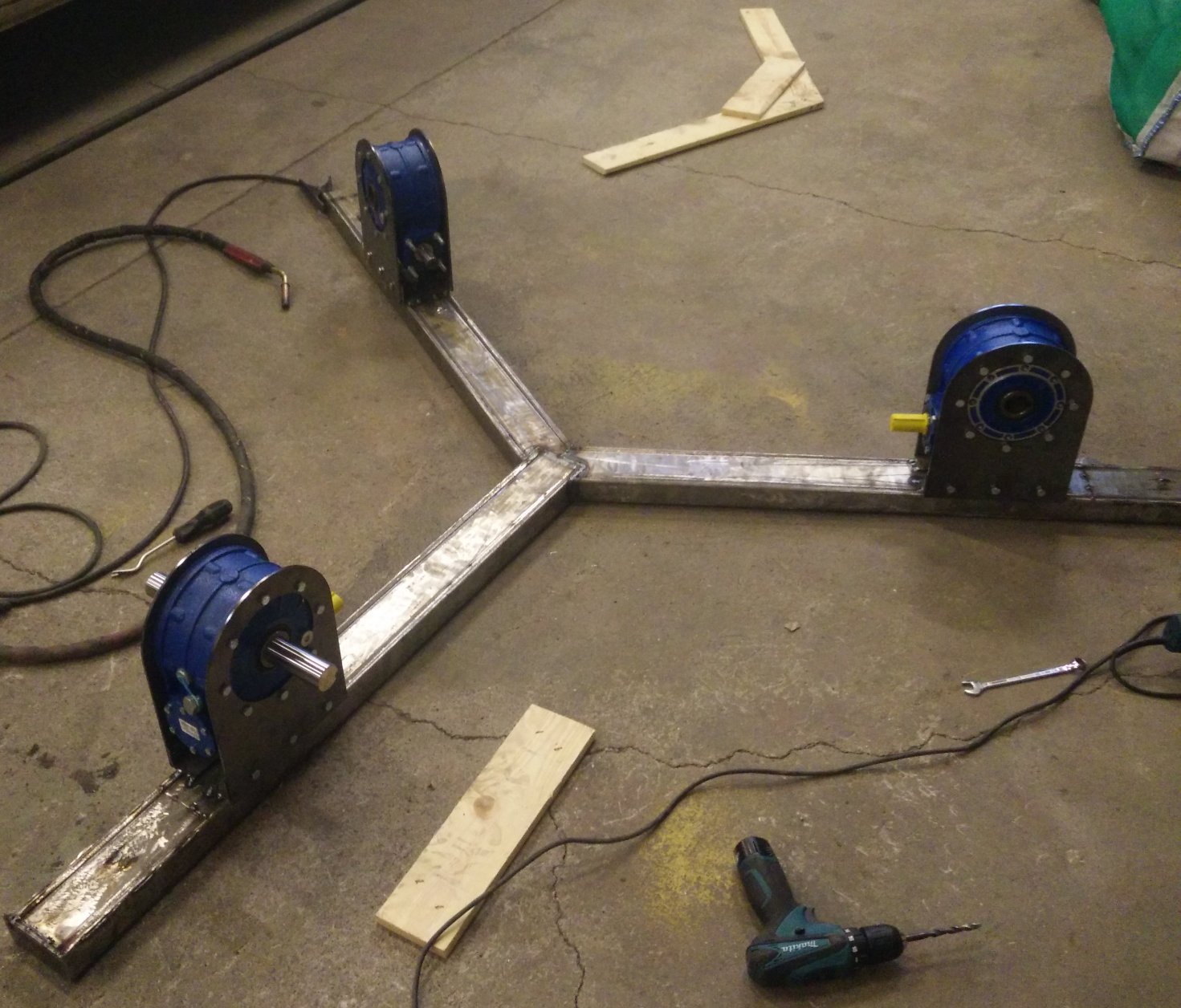

    Lower chassis was also pretty straight forward to make. I used 120 degree wooden jig to roughly get everything aligned and double checked cross lenghts with a tape measure. Reinforcements will be added later:

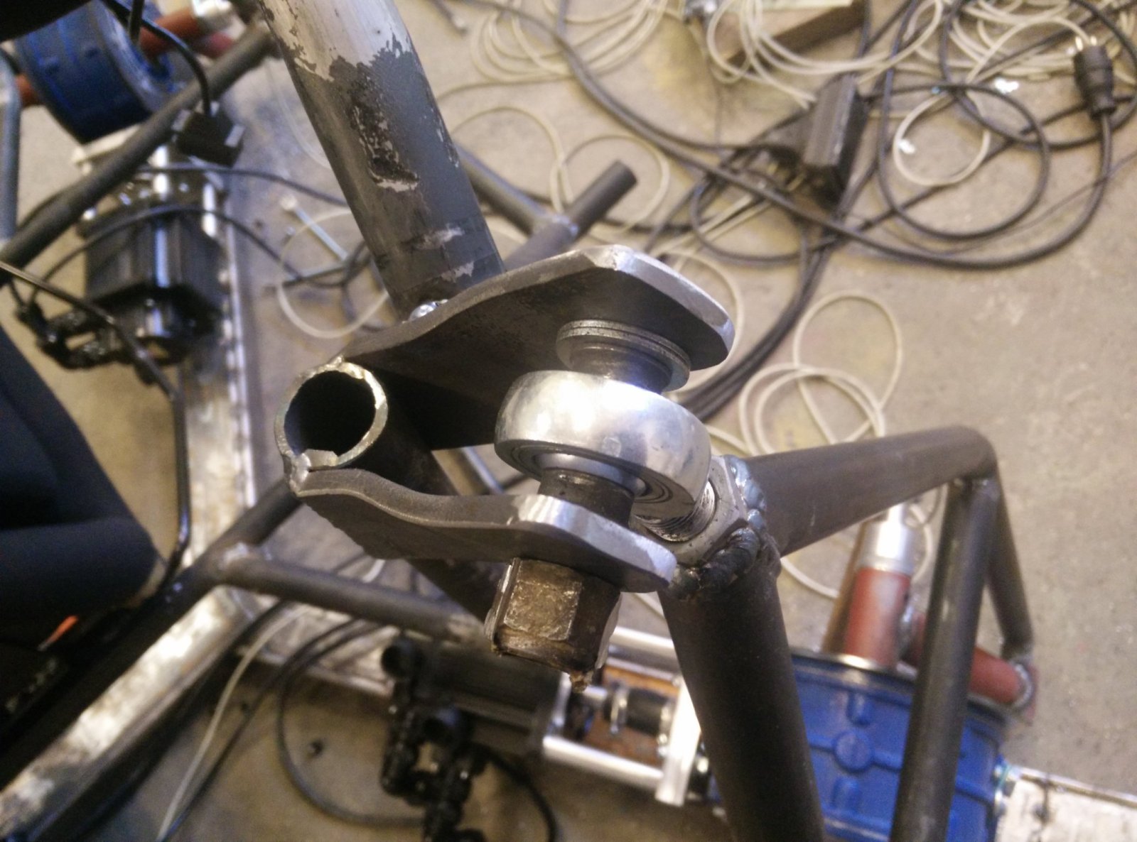

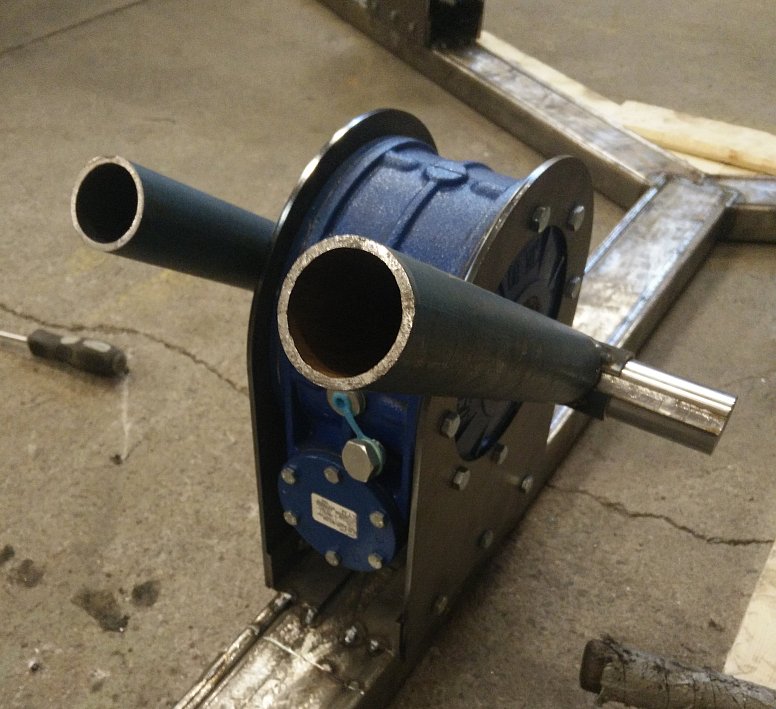

    Output lever arms was next up. Had some troubles to get everything aligned as welding always pulls parts tighter when it cools off. Don't know how to describe it better in english, but you know the deal if you ever done welding work. In the end i managed to get everything acceptable on all 3 axis:

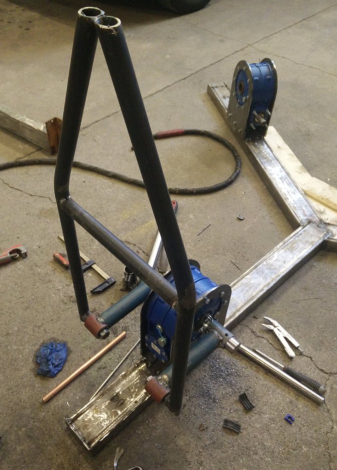

    Next up was bearing mounts and rest of the actuator arms. Please excuse me for saying... FFFffff... ok i'm not gonna say it, but i absolutely hate living in a world(country(or city...)) where there is only Metric bearings and Imperial tubing available. Absolutely nothing fits together and even if you wanna do some lathe work to make them fit it still doesn't work as pipe either gets too thin or its already loose. I ended up cutting slice out of larger piping, welding it back together and then rounding inside of it on a lathe. Sadly don't have pictures of this process, but it took a loooong time..
    All done:

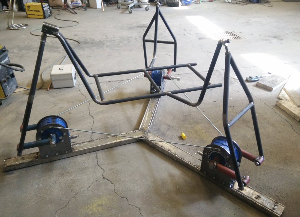

    Upper rig was also nothing but bending some pipes by hand and welding it all together. Added some slightly tensioned temporary rods to keep everything aligned. Some ball joints later it ended up looking like this:
    Next up wanted to do some electronics. Again it was pain in the butt to source information how to drive +-10V analog servos with a microcontroller. After banging my head on a wall for couple weeks i finally managed to make arduino -> 0-5V i2c DAC -> -10V - +10V converter circuit. Main problem here was that the information that i actually wanted to find was hidden somewhere between millions of radio controlled servo results on google... Anyway after i had a working circuit i wanted to design a pcb so that i could easily replace arduinos or any critical components if needed. I use 1pcs Arduino mega 2560 as a master and 3pcs Arduino nanos as a slave cpu. Everything talks together with serial and plenty of cpu overhead if i want to add more stuff later on. Some cnc machining later i had a pcb on my hands:
    I will go a bit deeper with the arduino code, electronics and wiring them if that is something people are interested.
    Now there is bit of a leap in progress as i was a bit lazy taking pics. But this is where i'm today with this project. Everything is wired up and working. PID tuning needs more work and obviously i need to clean up wiring to make i all safe, clean and nice. Seat has a quick release/lock rails from citroen c5 to be able to move it back and forth. Made some changes to ball joints to get more clearance while moving around. Still working on steering wheel mount etc so it might change place later on. I also have 6 point seatbelt harness to keep driver inside the chair. :)
    Hopefully i didn't bore everyone to death with my babble... What do you guys think? :)

    Lever length is 22,5cm measured from axis center to center giving out total of 45cm travel. Maximum speed of output shaft with these worms and servos is 90 degrees per second or in another words averages 22,5cm/second. As it circles around, actual linear movement is fastest when it's in middle position and slows down further it gets either way.
    I'll make schematic of one channel, explain how it works and post pics of populated pcb later when i get home.
    If anyone wants close up photos of something just let me know and i'll post them. :)

    Great achievement so far! You're skilled in many subjects :thumbs
    - The motors and levers can turn full 360°, that's a good design... in case of bug, no mechanical crash!
    - About welding, if you first tack the pieces together on both sides and after this you weld them continuously, the pieces won't move that much ;)

    Motors can't actually turn full 360. Position sensors are on the way preventing that. I'm still in the progress of trying to decrypt servo drives chinglish manual to see if i can get digital position information of motors. If i find a way to do that i can remove external position sensors completely and just add proximity sensors to zero positions on power up.
    Cheers for the for the welding tip, but knew that already. In the end i used it for my advantage and tacked a ball after ball to the side i wanted to move it.
    Motors are 130ST-M06015
    I'll make a video as soon as i get all PIDs tuned and chassis reinforcements done. :)

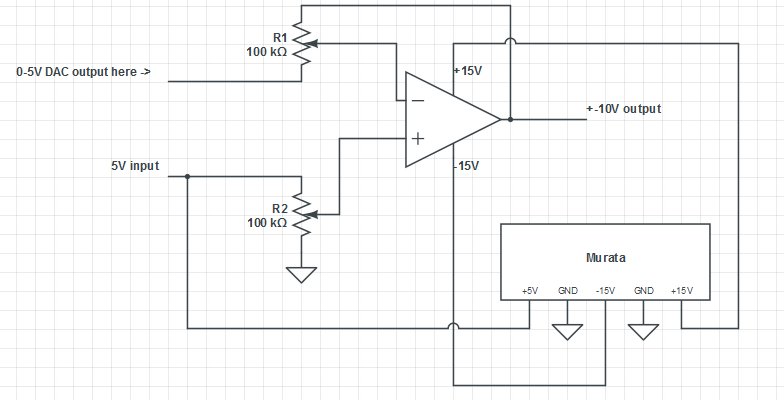

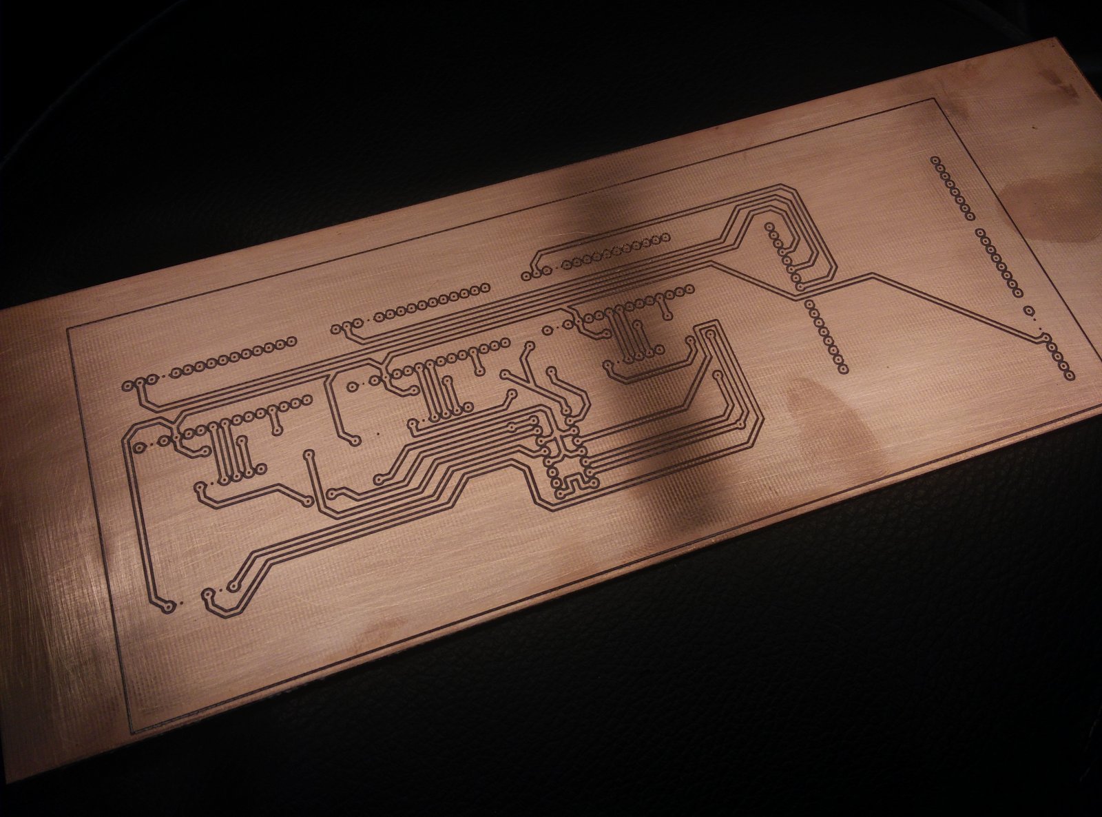

    Here is how i made arduino talk to +-10V analog servo drive:
    First of all here is parts i used:
    Arduino Nano
    Murata NMA0515DC | Dc/Dc converter/power supply
    LM324 | Operational amplifier
    MCP4725 | I2C Digital to analog converter
    47k trimmer potentiometers (doesn't really matter what value as long as it's more than 10k)
    Next up load this online calculator:
    http://www.daycounter.com/Calculators/Op-Amp/Op-Amp-Voltage-Calculator.phtml
    Secret sauce to enter there is:
    R1 10(KOhms)
    R2 100(KOhms)
    R3 100(KOhms)
    R4 100(KOhms)
    V1 2.5(V)
    V2 5(V)
    Vp 15(V)
    Vn -15(V)
    Now if you change V1 (input your DAC output here) to either 0V, 5V or anything between what our DAC outputs the output voltage of op-amp changes between -15V to +15V. Reason why i used trimpots instead of resistors is that i can fine tune circuit to my exact need. R1 and R2 is one single trimmer (R3 and R4 is another single one). Now if you have oscilloscope it helps a lot to trim circuit, but it can also be done with a decent multimeter. In this case i trimmed amplification so that the output voltage of op-amp is maximum of 10.5Volts. This increases resolution of the output between +-10V as we don't have to drive it up to +-15V. Another trimpot is to adjust centerpoint of our output. Easiest way is to output 2.5V from DAC and measure 0Volts output on op-amp. Always cross check again if one pot is adjusted.

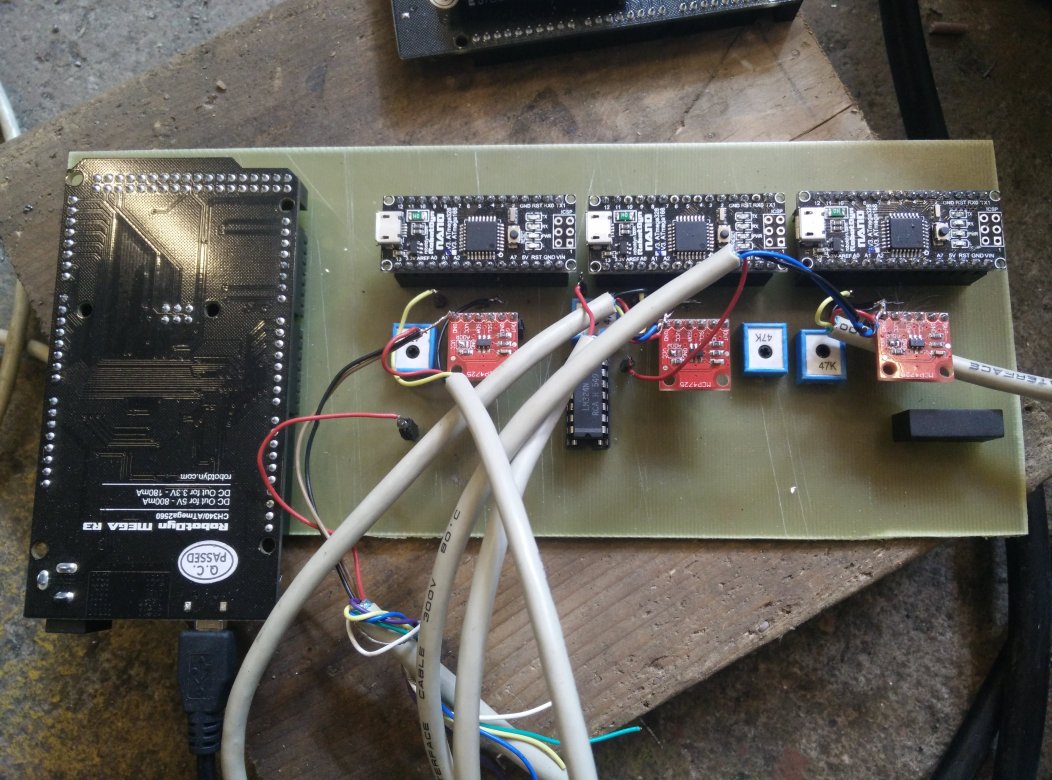

    Quick and messy circuit:
    Completed 3 channel circuit with test wiring:
    You could use just one arduino to drive the whole thing, but as said before i wanted a lot of cpu overhead for future purposes. If anyone has any questions i'm happy to help with this. :)
    Bonus pic how i ended up doing ball joints:

    The Anolog Digital Converter behind the analog pins of the Arduino is optimized for 10Kohm pots
    Other values will be worse.
  11. Cartti
    Cartti Member
    Aug 8, 2016
    19
    Finland
    158Coins
    +63 / 0 / -0
    3DOF, AC motor, Arduino
    Not sure what you mean by this as this circuit has nothing to do with Arduinos ADC?

    Today did some scope probing and yes there is ABZ encoder output on my servo drives, but as i was expecting it is so high resolution Arduino can't keep up counting two ~65kHz lines at full rpm.
    Now i'm not sure if i will make a dedicated encoder circuit and interface it to arduino or order some contactless pots, machine casing and gearing for those or something else. Hmm...
  20. DEADBEEF
    DEADBEEF New Member
    Sep 1, 2013
    23
    N/A
    UK
    370Coins
    +12 / 0 / -0
    I'd buy some decoder chips, stick them on a breadboard and interface that with the Arduino. One arduino will be able to handle the lot that way.
    Or maybe consider a Rasberry Pi. That should just about manage to keep up with 65kHz digital signals.
    Do you have some specs for the motors? and/or a link to the manufacturer?
    It might be possible for someone else following in your footsteps to order them and specify lower resolution encoder wheels be fitted.
