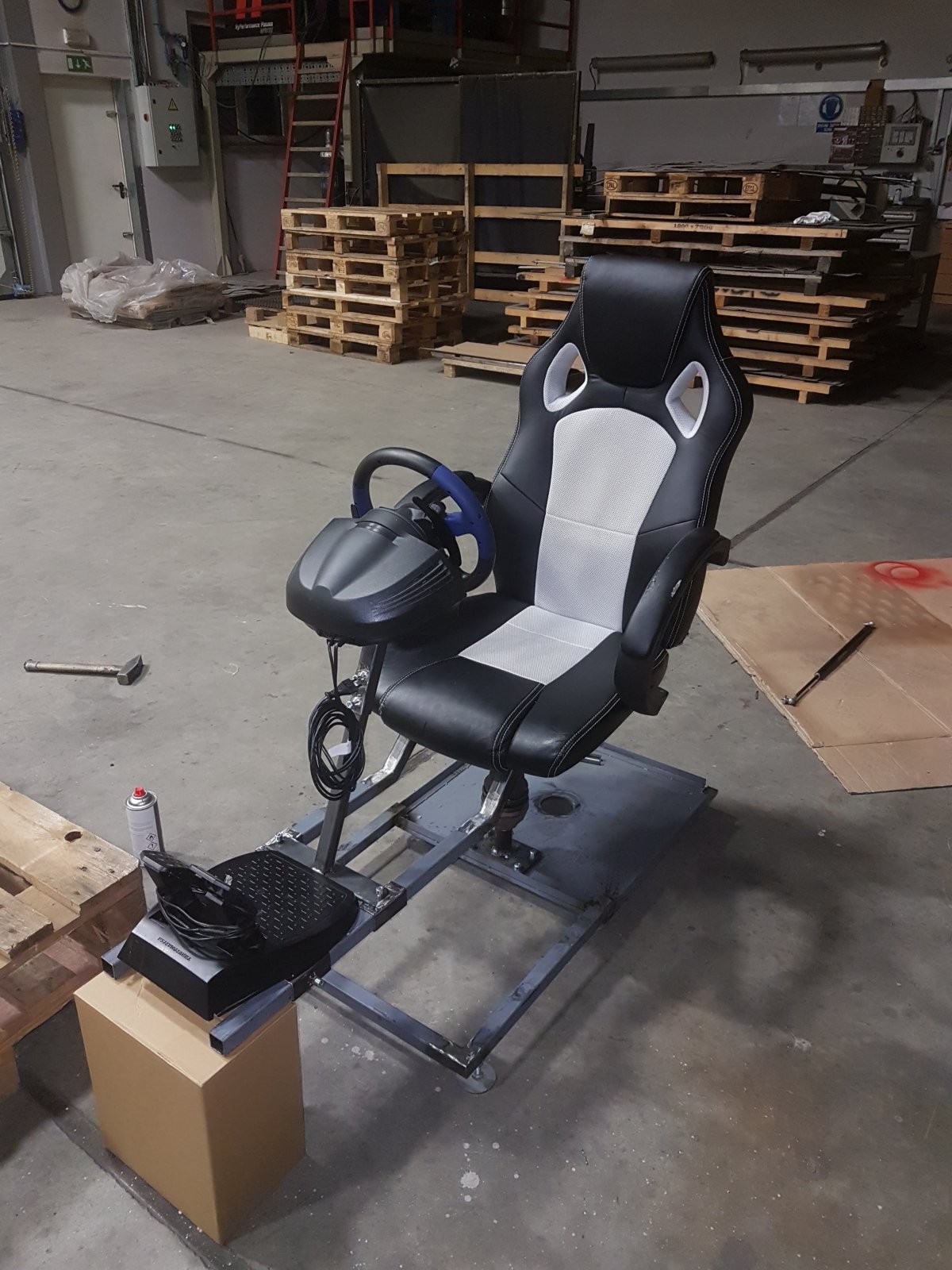

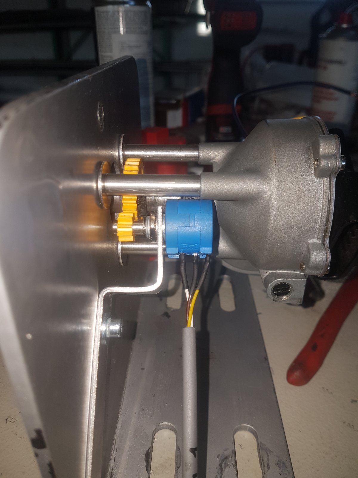

    Starting my First 2dof Simulator with China Arduino, China Moto Monster, 60W Wiper Motors :)

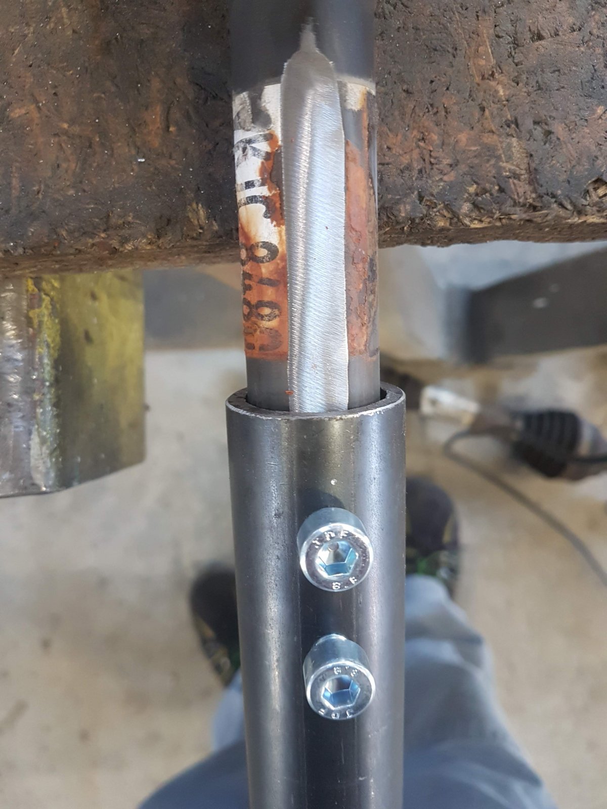

  2. TheBaucek
    TheBaucek Only one Lost in Space Soul

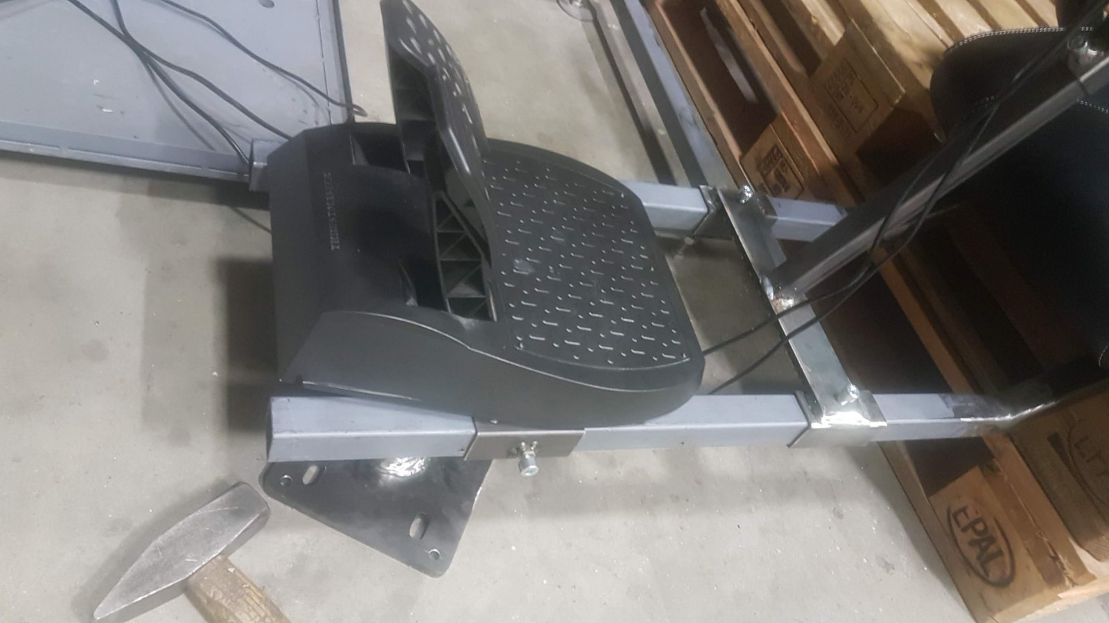

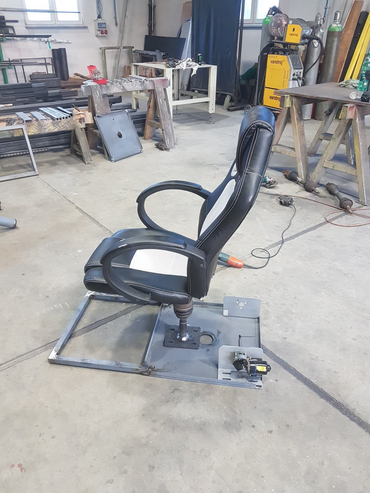

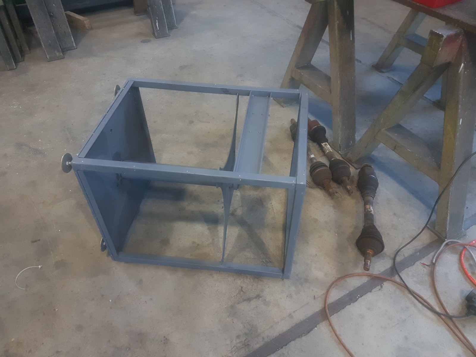

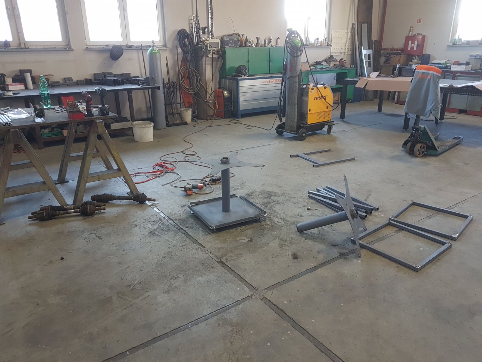

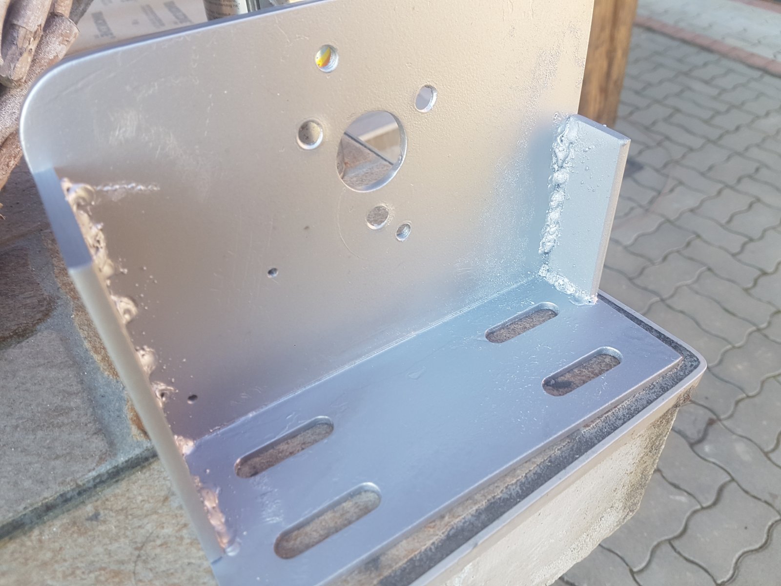

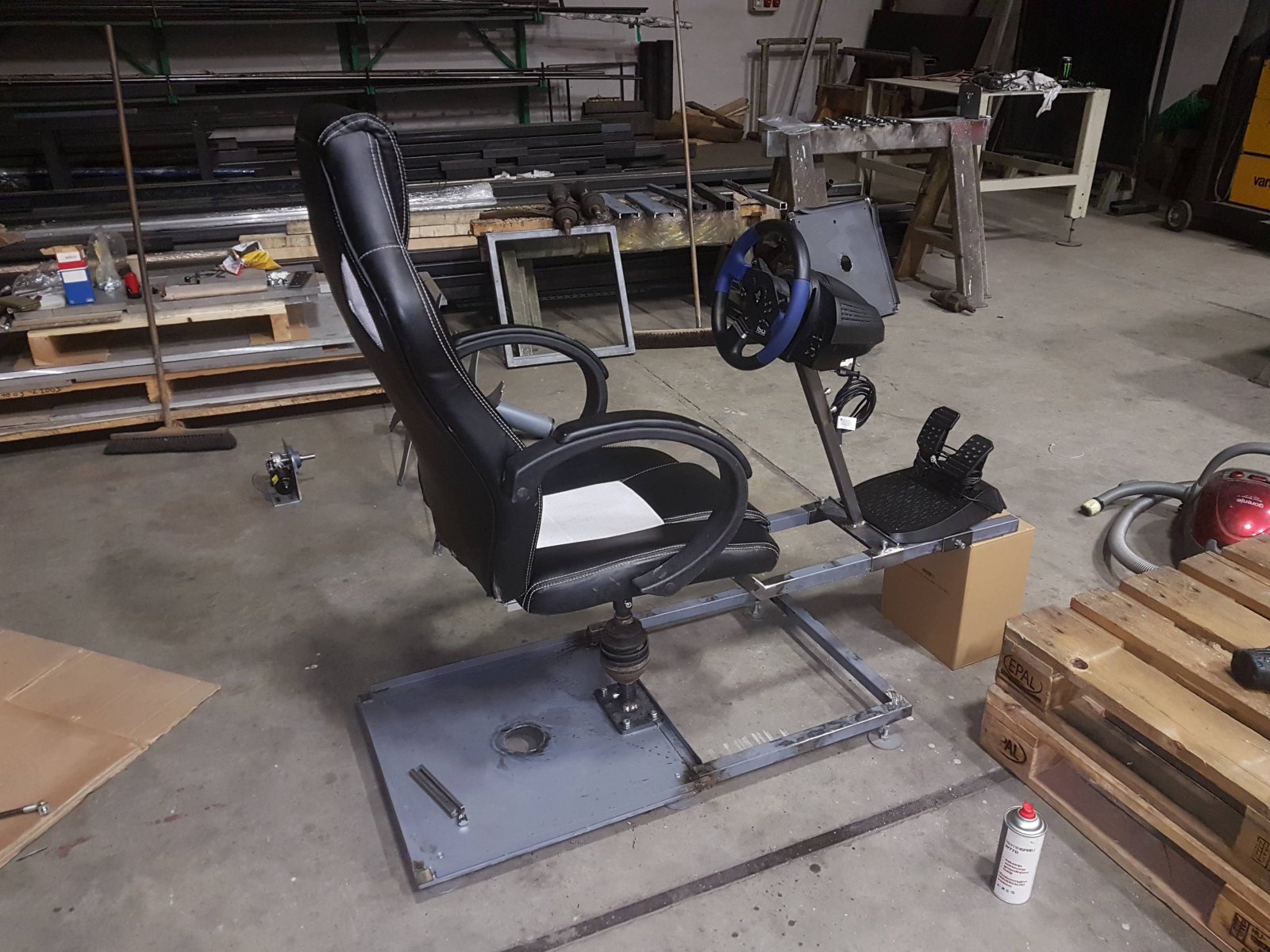

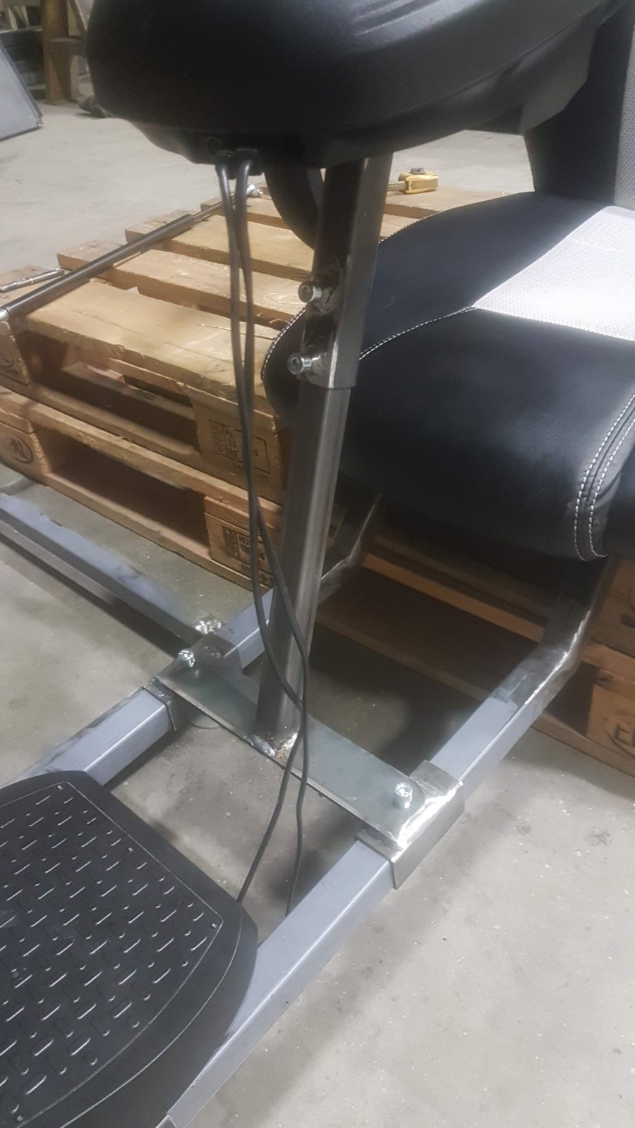

    First i had to cut the frame in to pieces for my needs.
  5. TheBaucek
    Nov 8, 2019
    16
    Mehatronic
    Slovenija
    55Coins
    +11 / 0 / -0

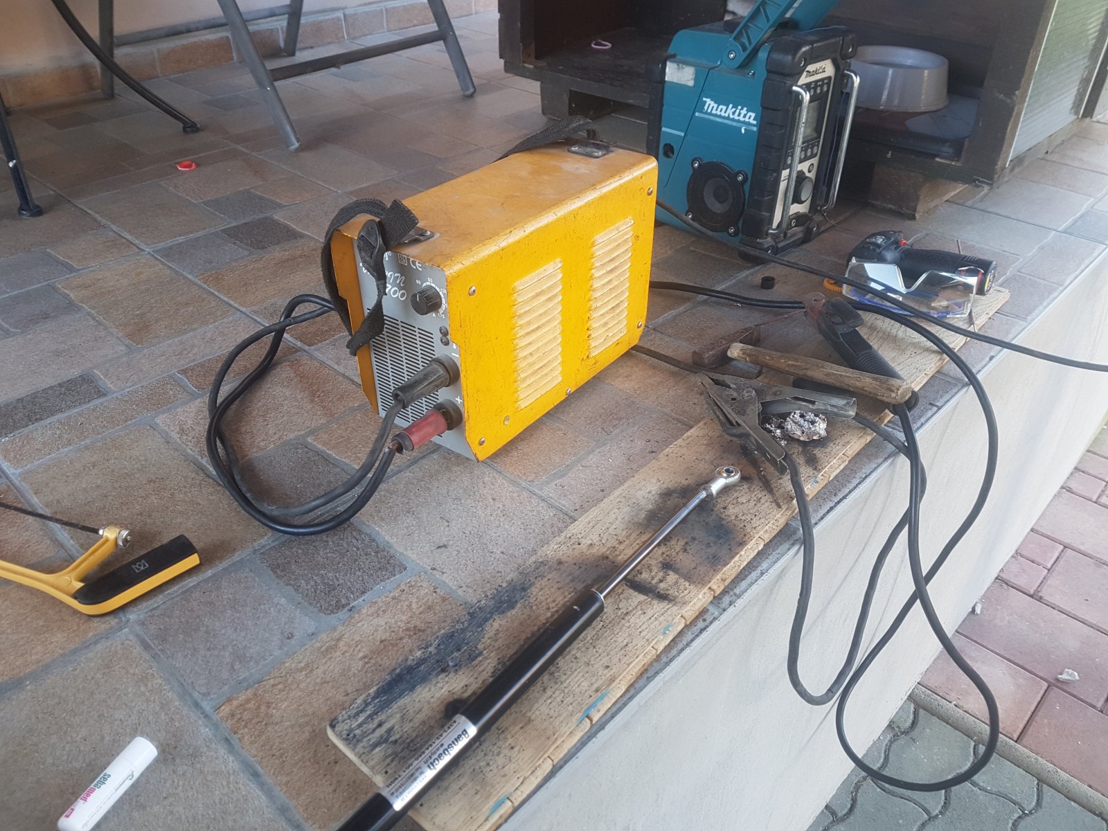

    Next was the time for my first time Welding 0.o ,this was a pain in to my Eyes.. That night i didn't sleep almost. My eyes was full of beach sand :)
  6. TheBaucek
    Nov 8, 2019
    16
    Mehatronic
    Slovenija
    55Coins
    +11 / 0 / -0

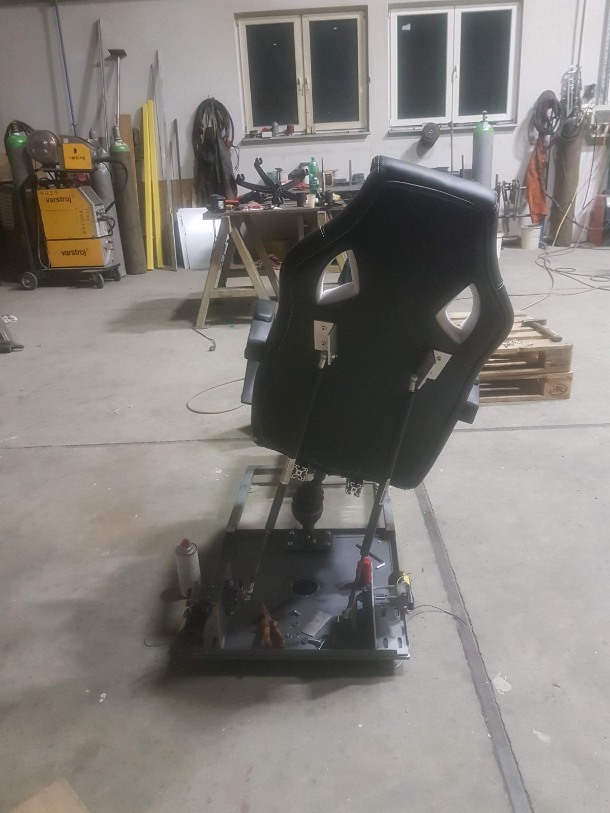

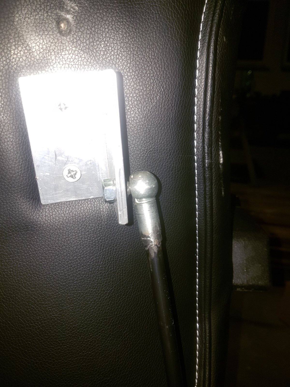

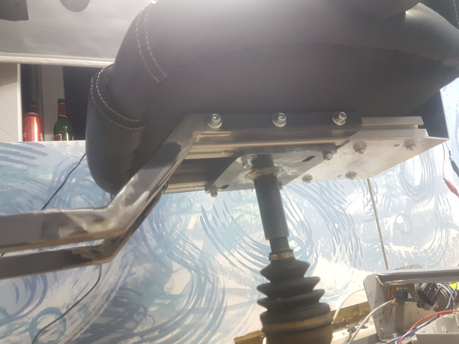

    For the holding and moving main part i have taken from a car and cut it to pieces so it fits in the holes.

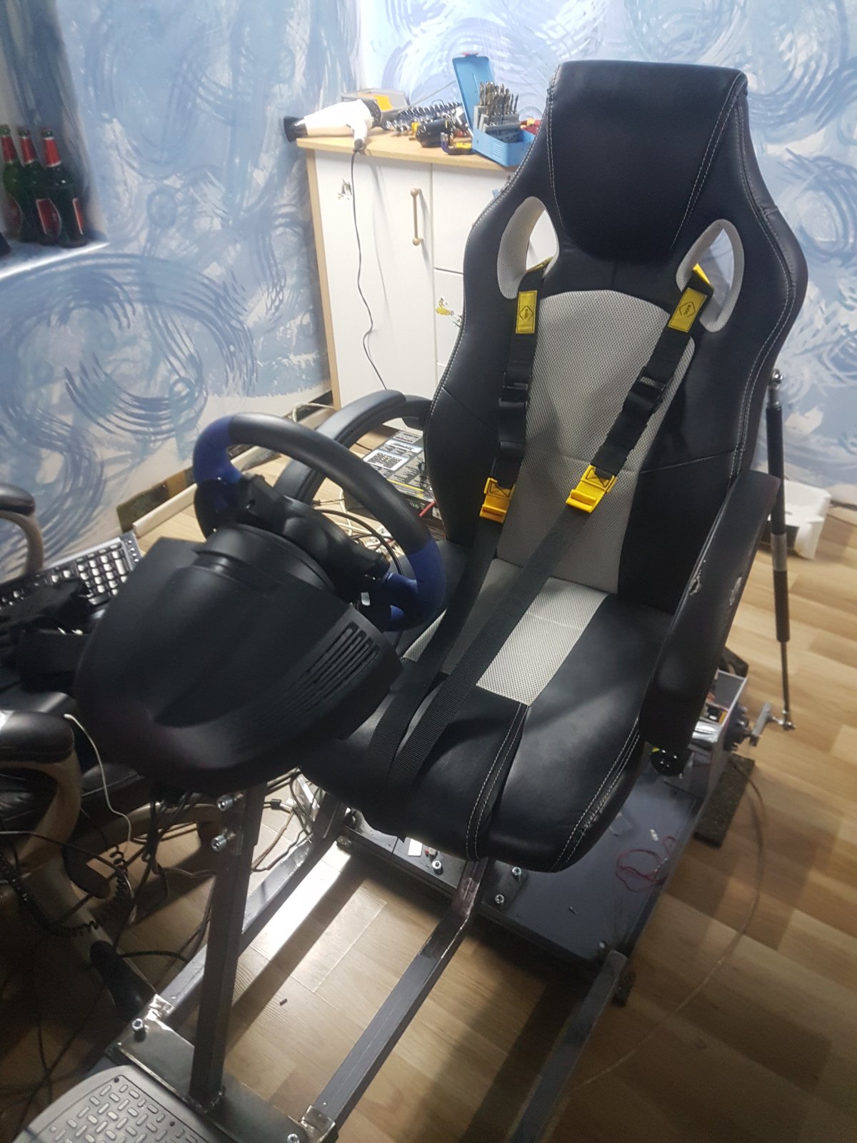

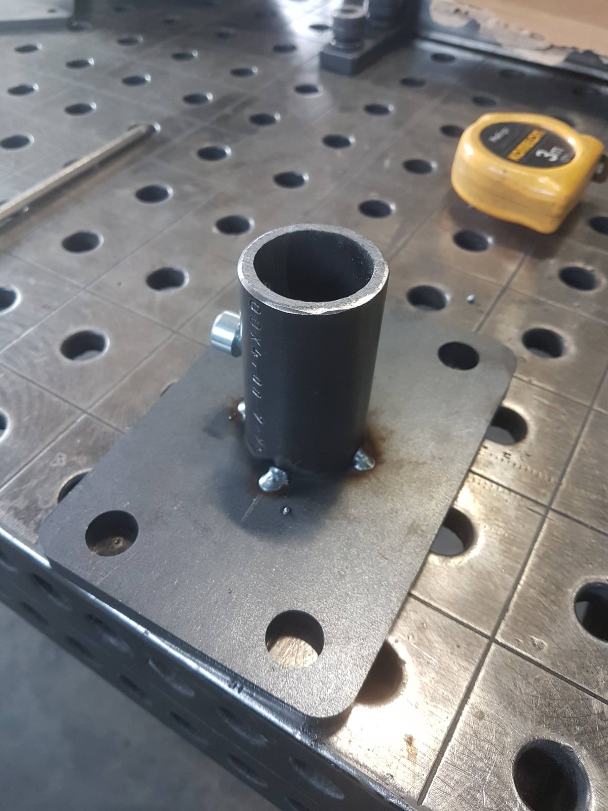

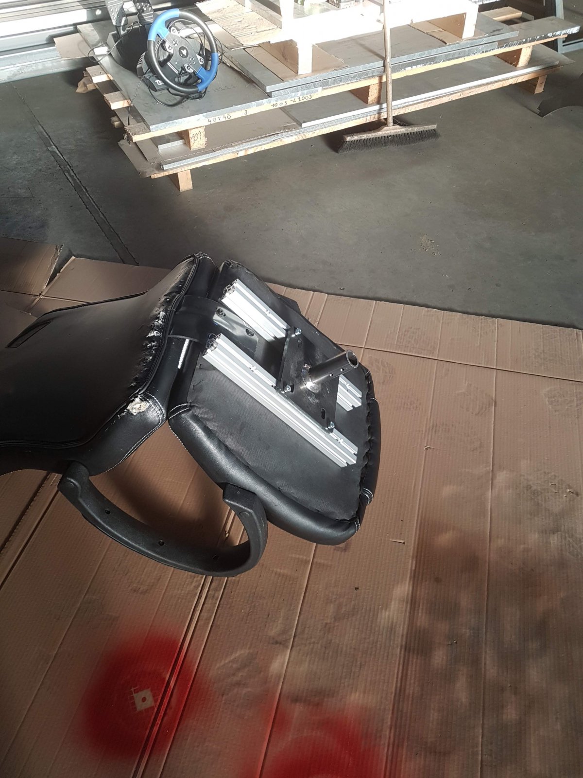

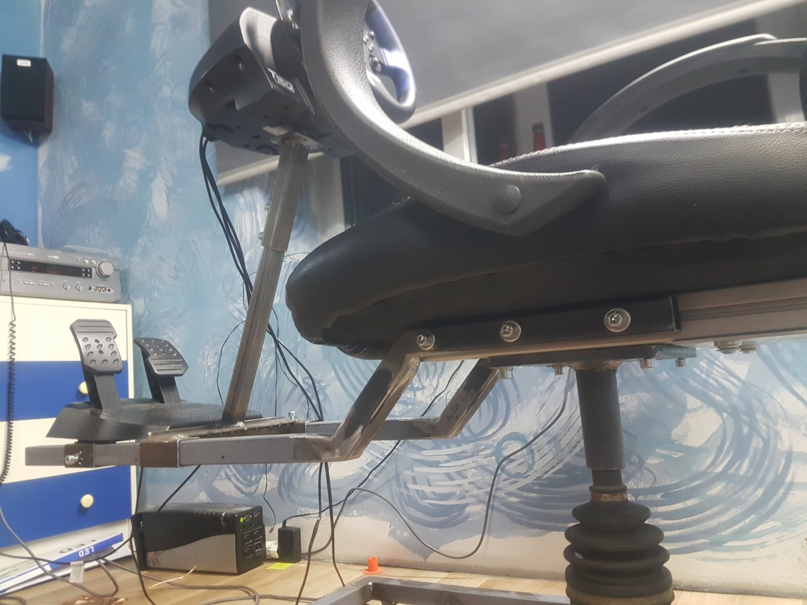

    And it was time to make the seat. I have taken a Aluminum profile to it is adjustable. (so i don't bother to find the middle point)
  8. TheBaucek
    Nov 8, 2019
    16
    Mehatronic
    Slovenija
    55Coins
    +11 / 0 / -0
    Next was the Seat, Thrustmaster Force-feedback Whell holding and moving part but sadly i forgot to take a picture, too deep in the making and working :)
    I try to make as much possible all adjustable, so Thad all can drive on.

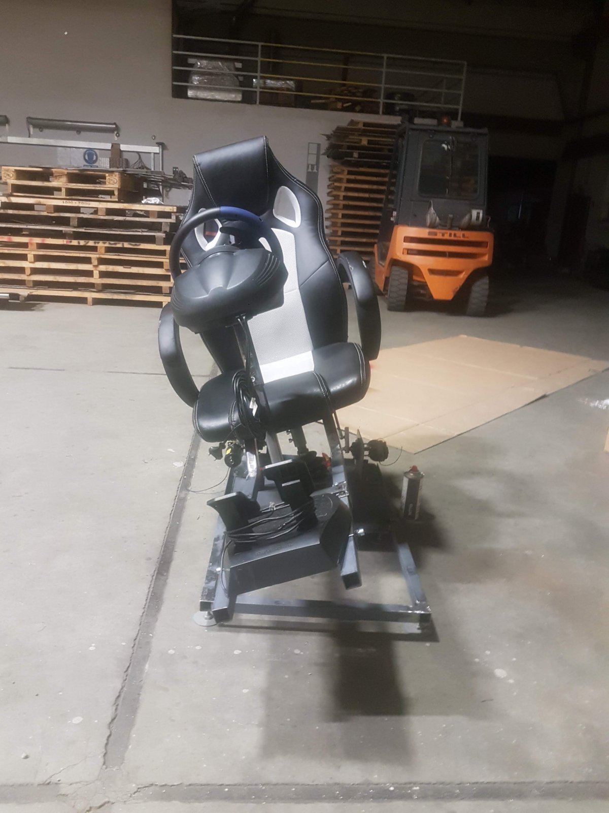

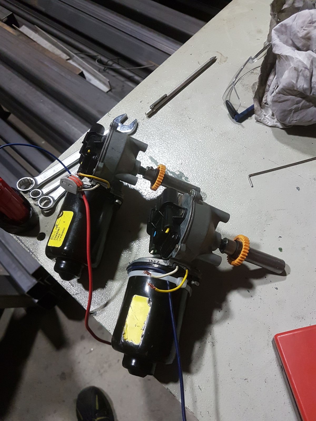

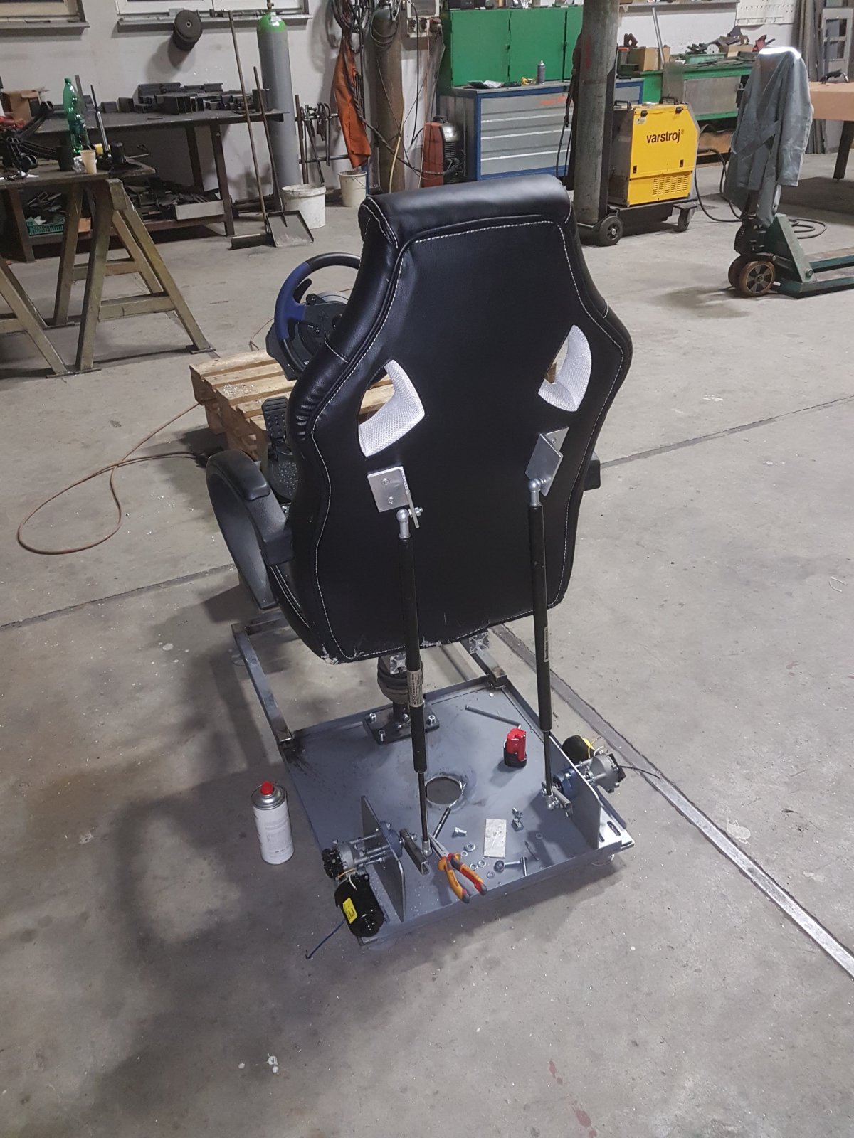

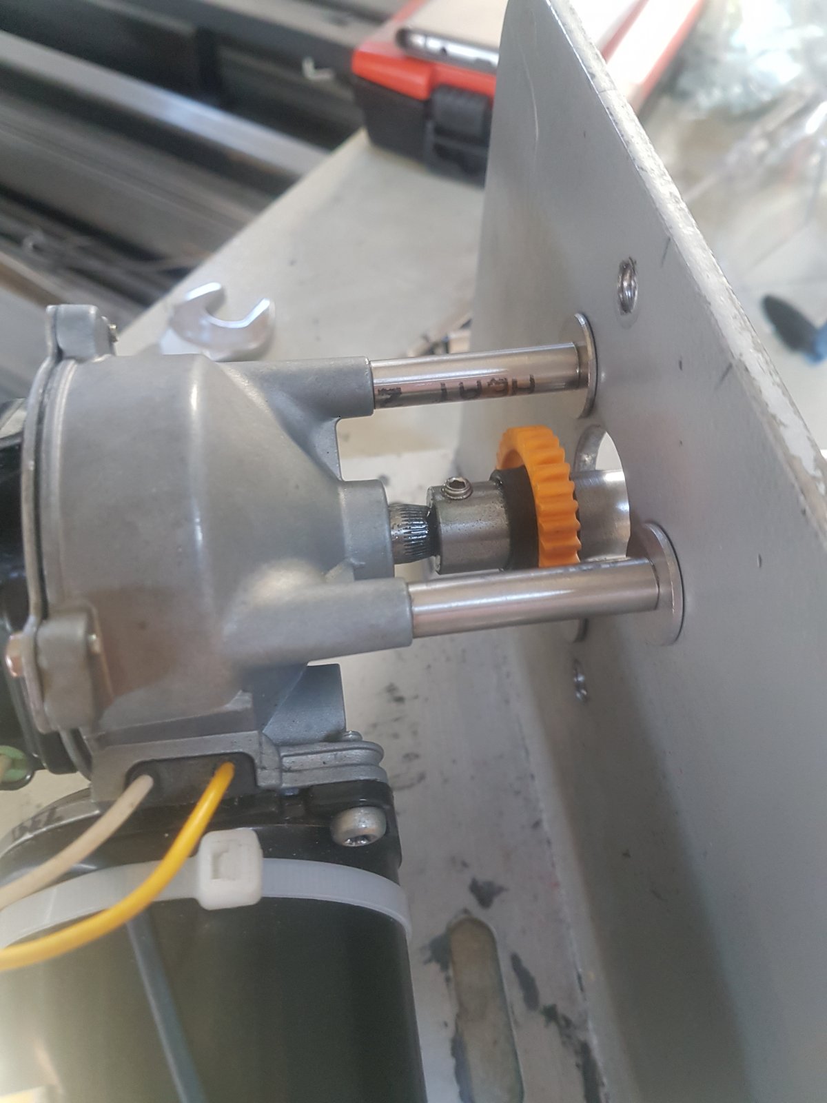

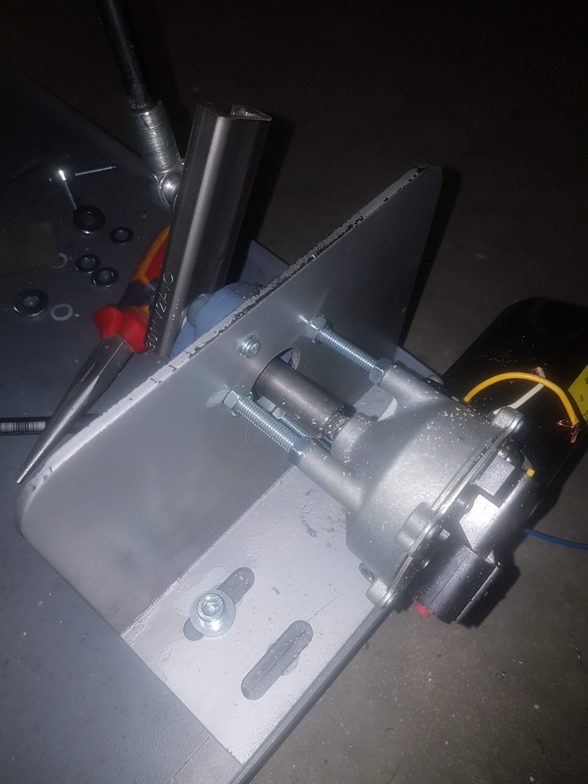

    So i try to mount the motors, and give a try how it moves, direct with 12V DC power.
  10. TheBaucek
    Nov 8, 2019
    16
    Mehatronic
    Slovenija
    55Coins
    +11 / 0 / -0
    Movement was nice but tu mutch difference with motor speeds :(

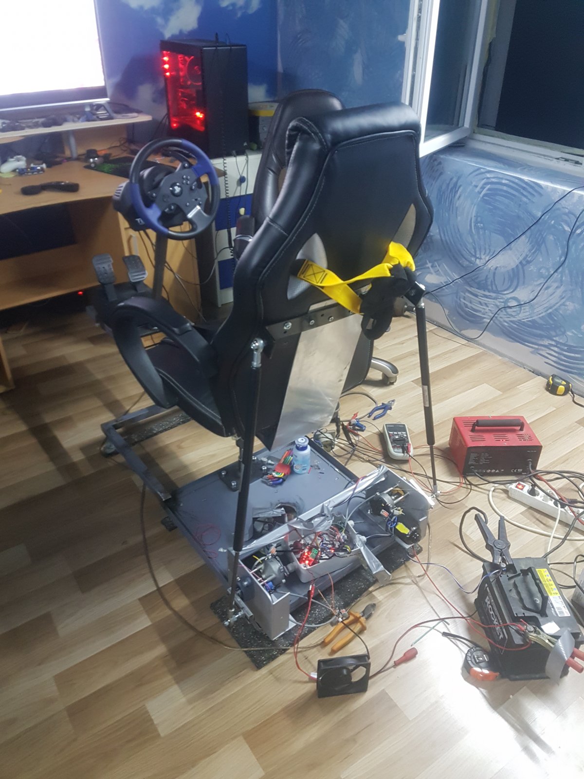

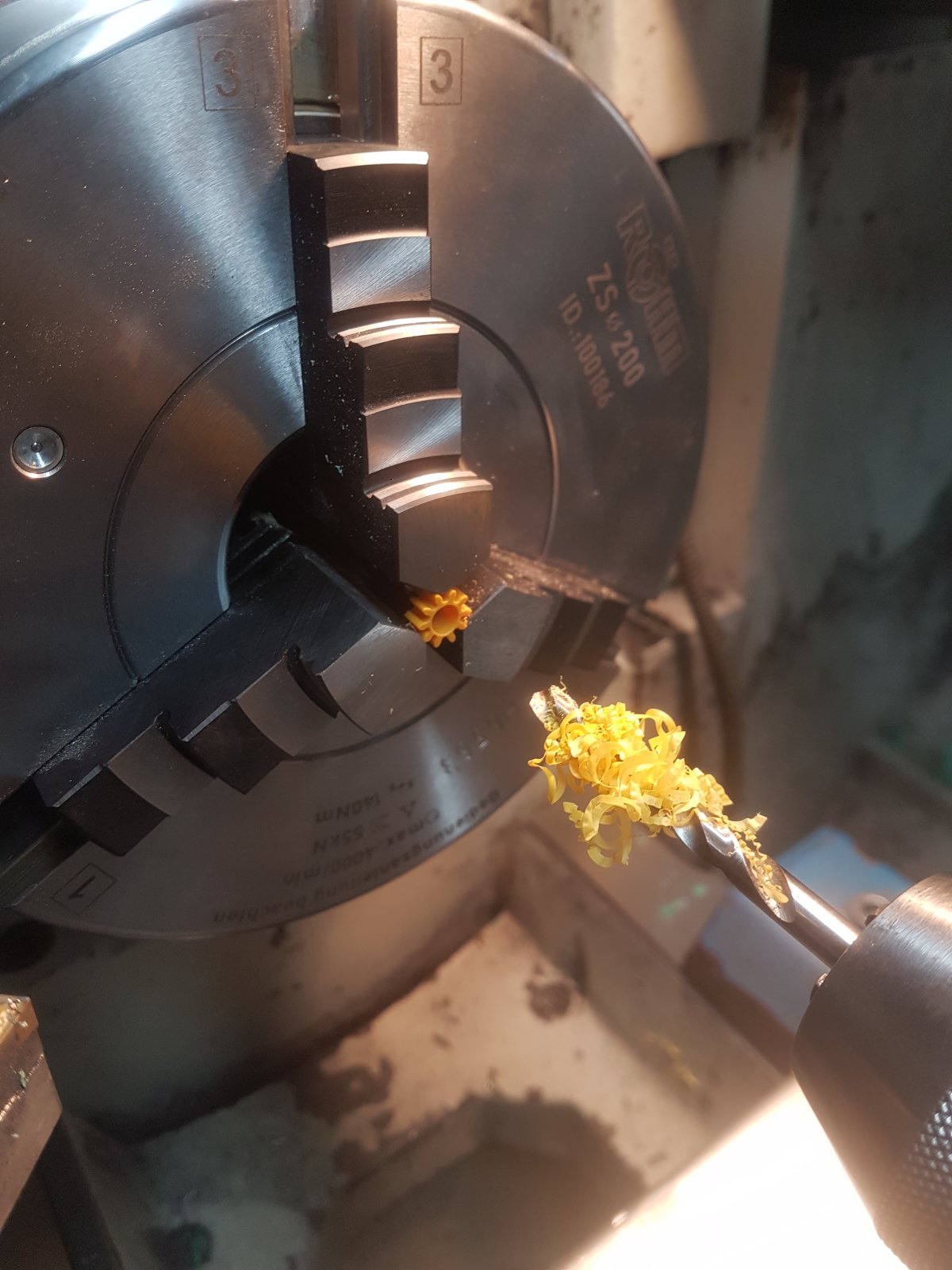

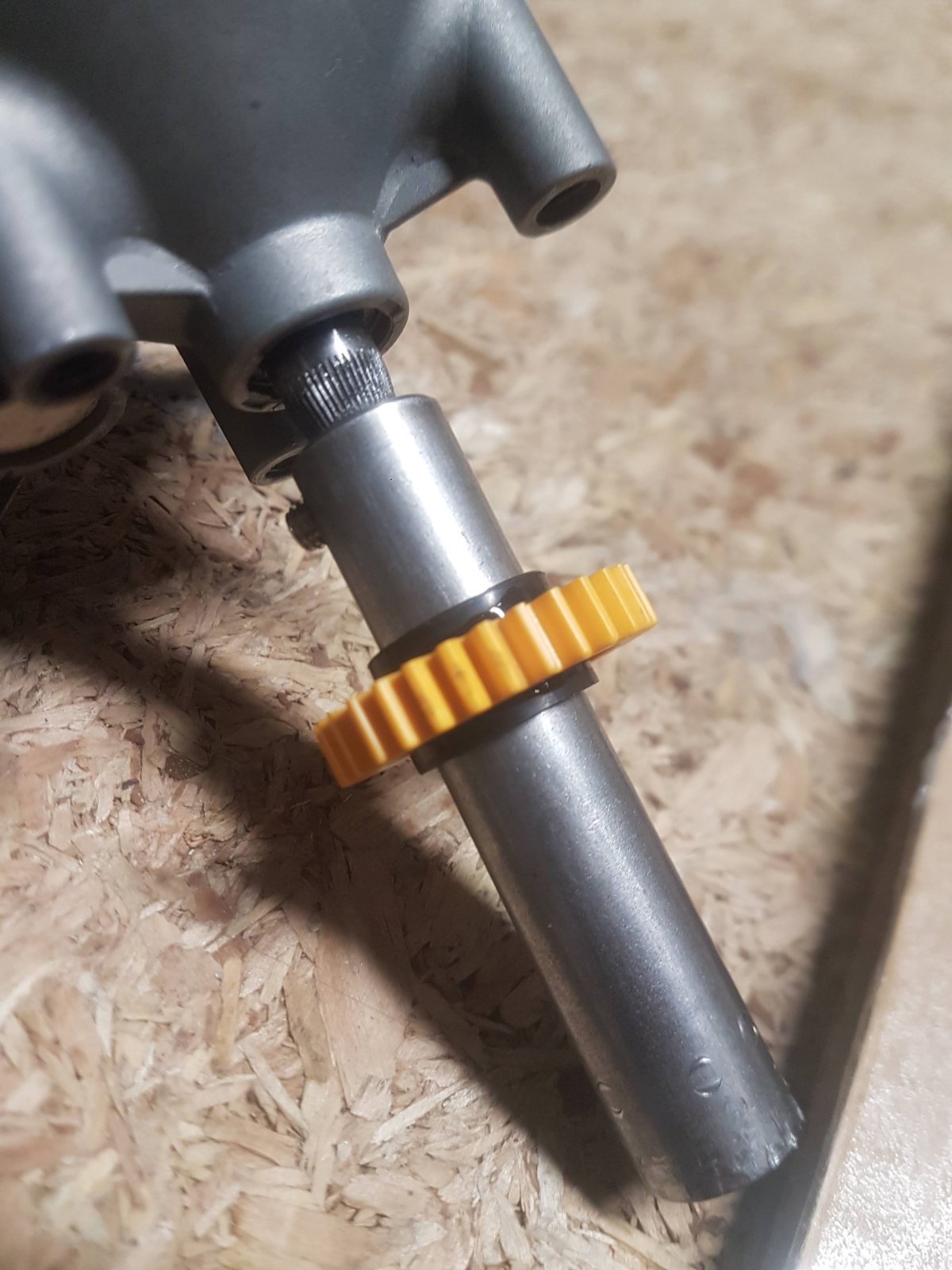

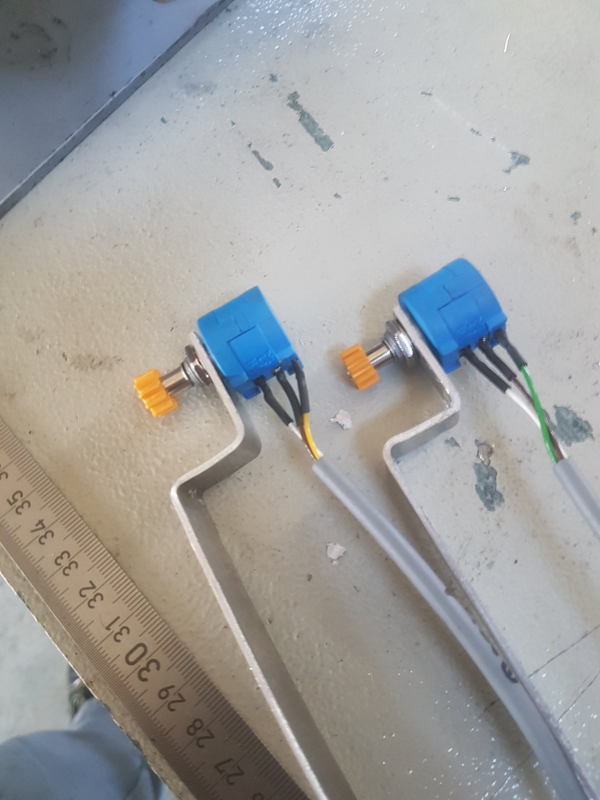

    So first big work was done, next was time for the Arduino, Moto Monster shield, Poti feedback,... This has taken more time as the build :)
  12. TheBaucek
    Nov 8, 2019
    16
    Mehatronic
    Slovenija
    55Coins
    +11 / 0 / -0
    After days of learning the Arduino stuff and how to wire the Arduino and shield i finally get to the point Thad i almost give up, so i buy another Moto Monster Shield and indeed, the first one was defect... So much head pain and sleepless nights... (China Moto Monster Shields are mostly BAD!) 0.O

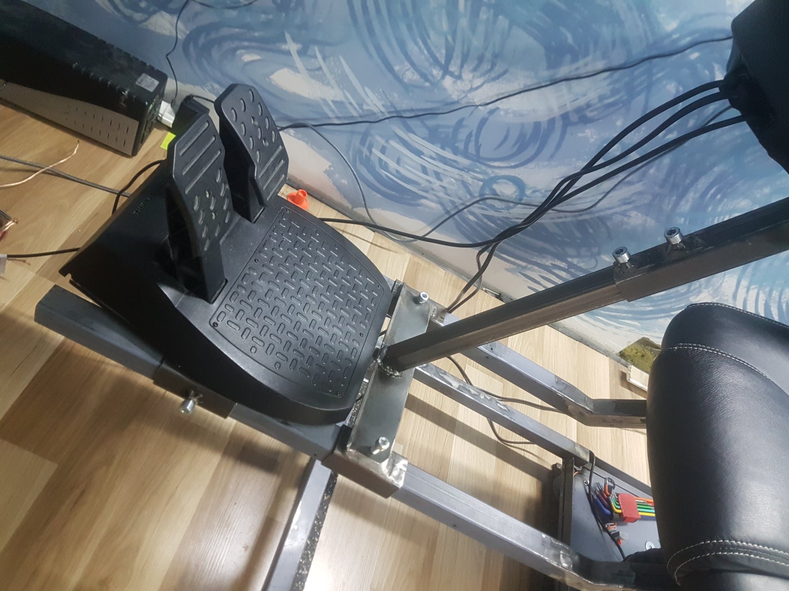

    It was TIME TO ---> Take my Baby @ HOME ---> REAL TESTING ----> YEA BABY :)

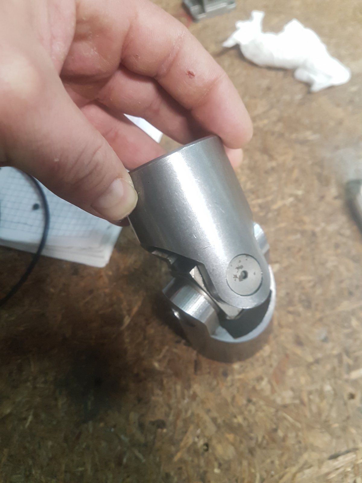

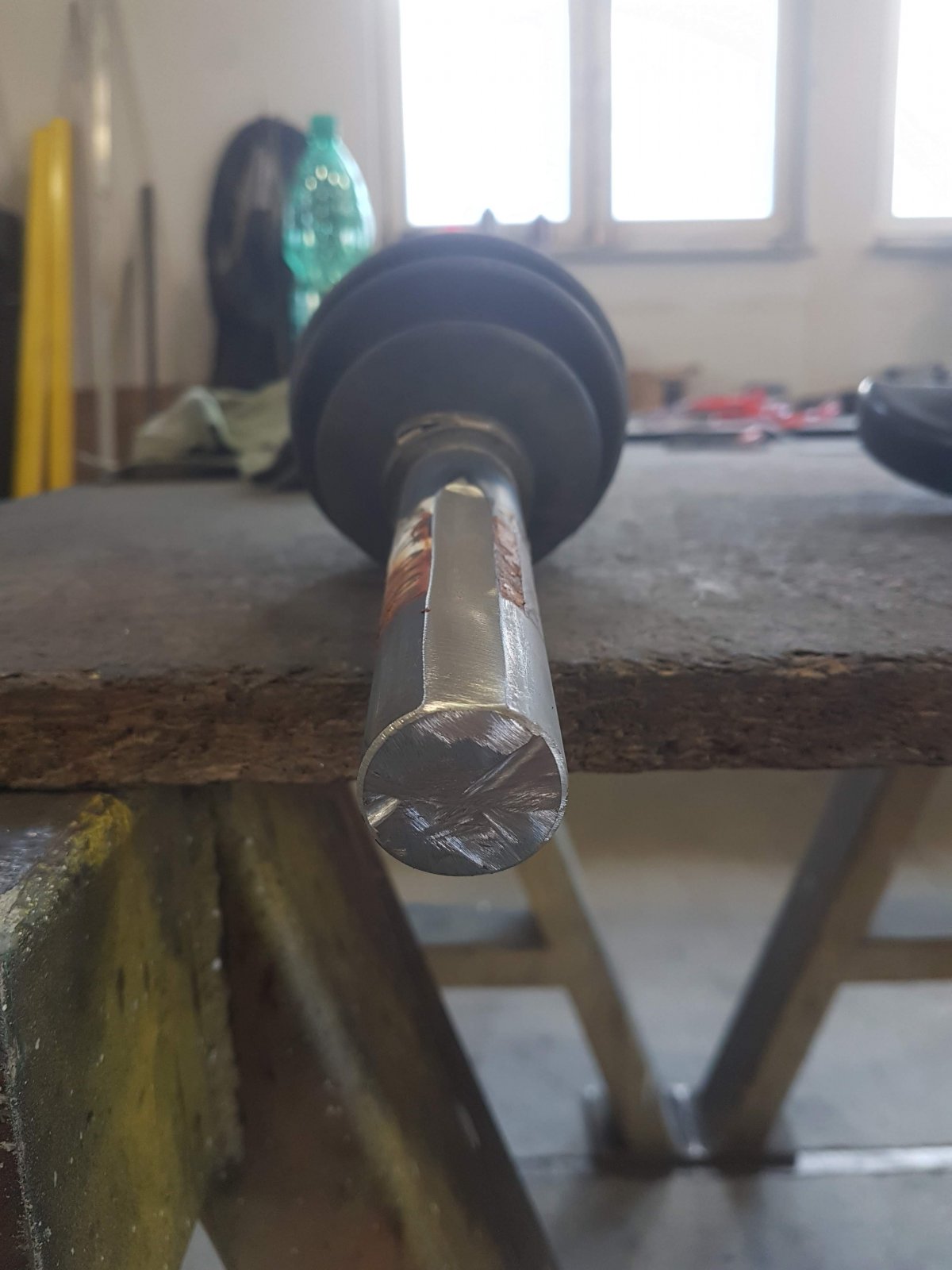

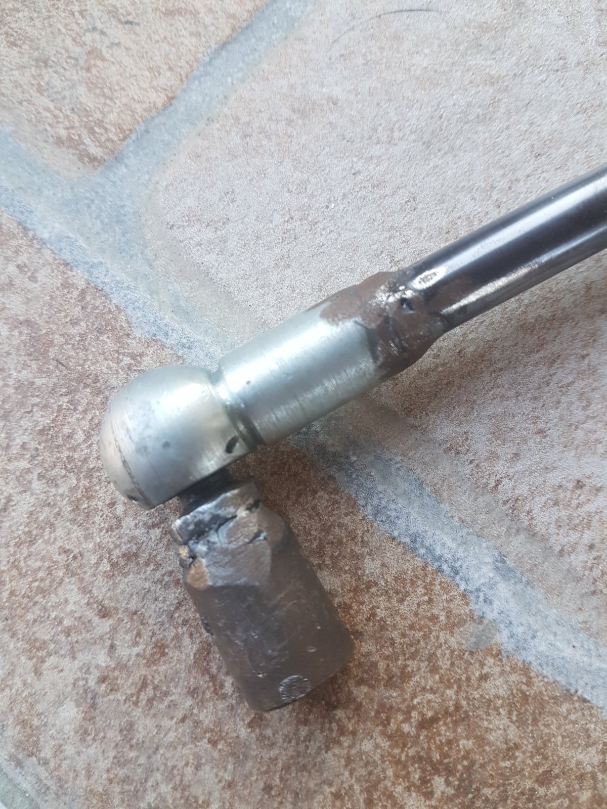

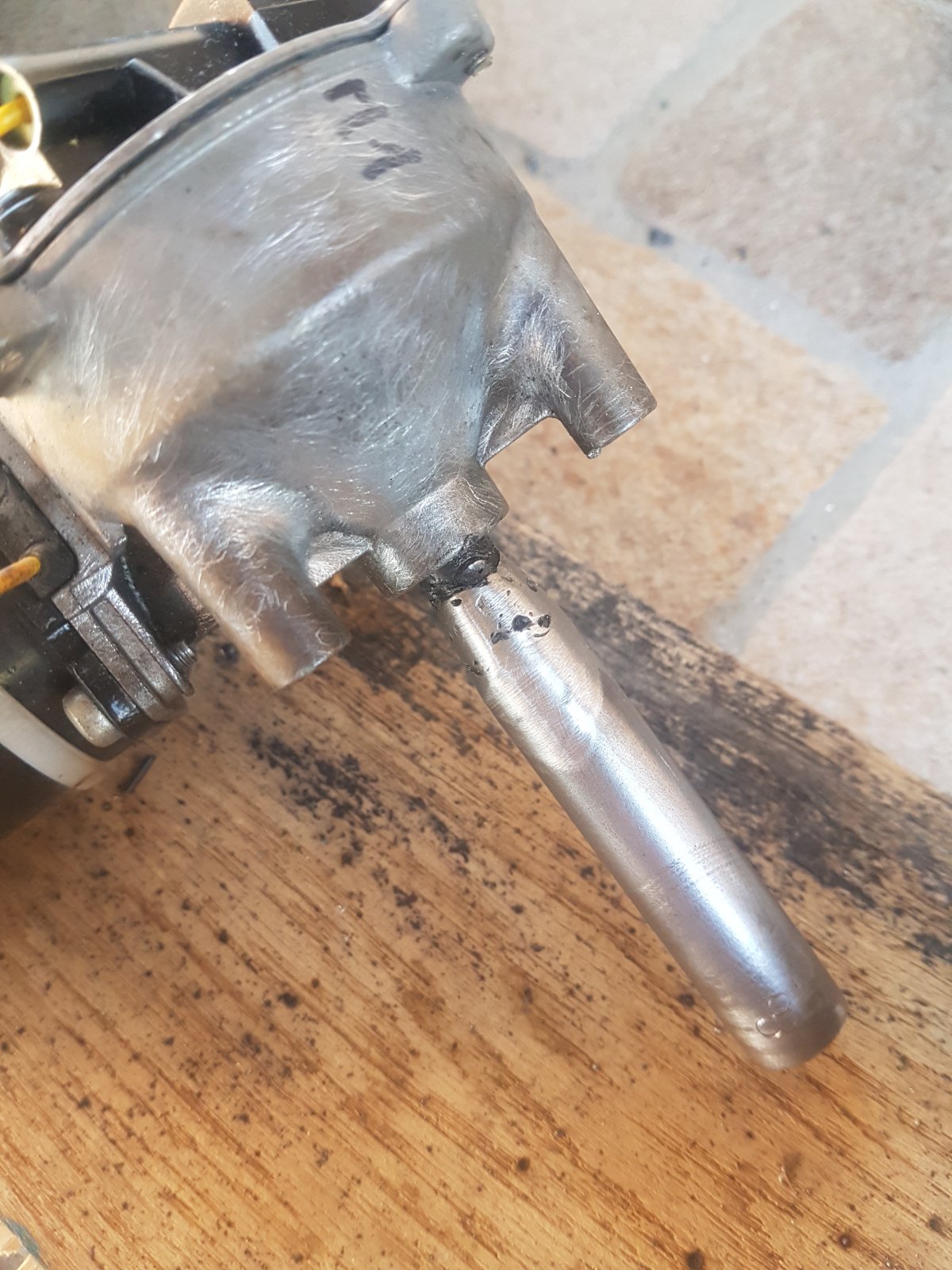

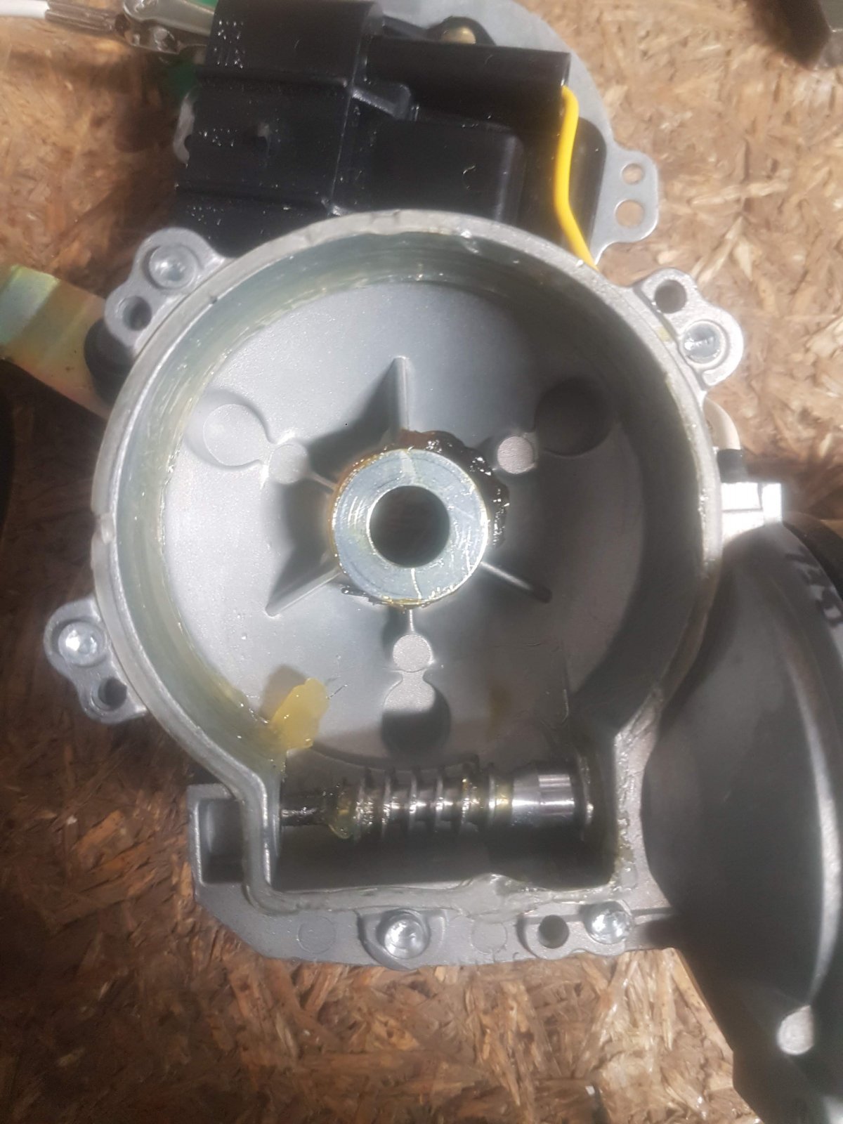

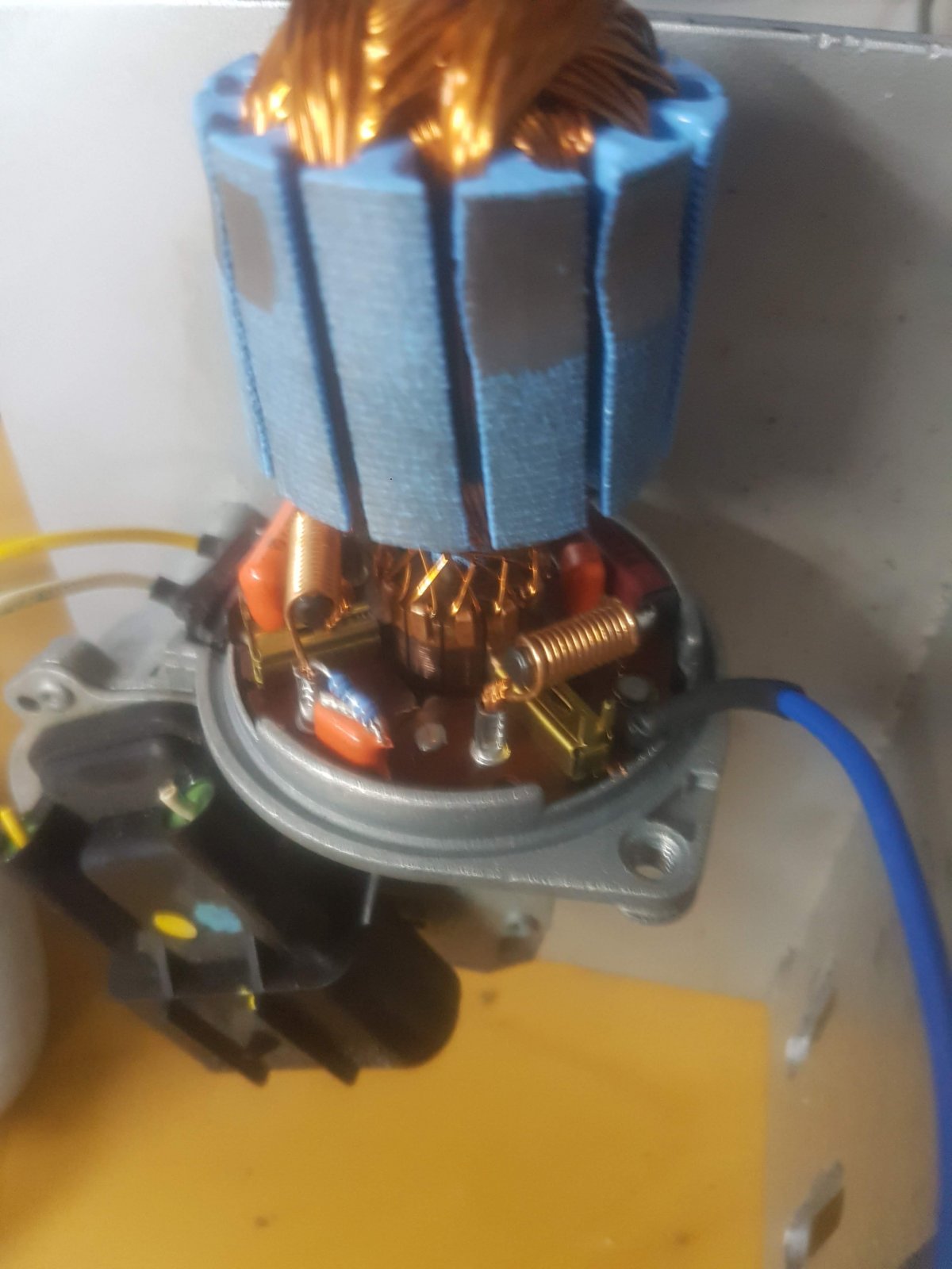

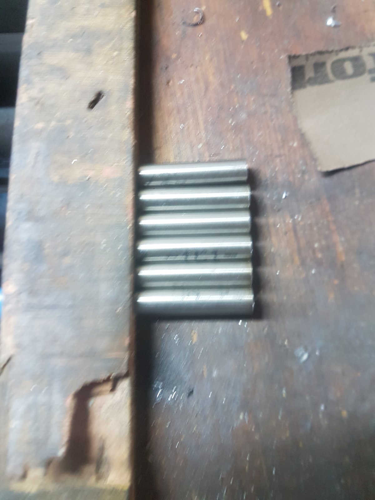

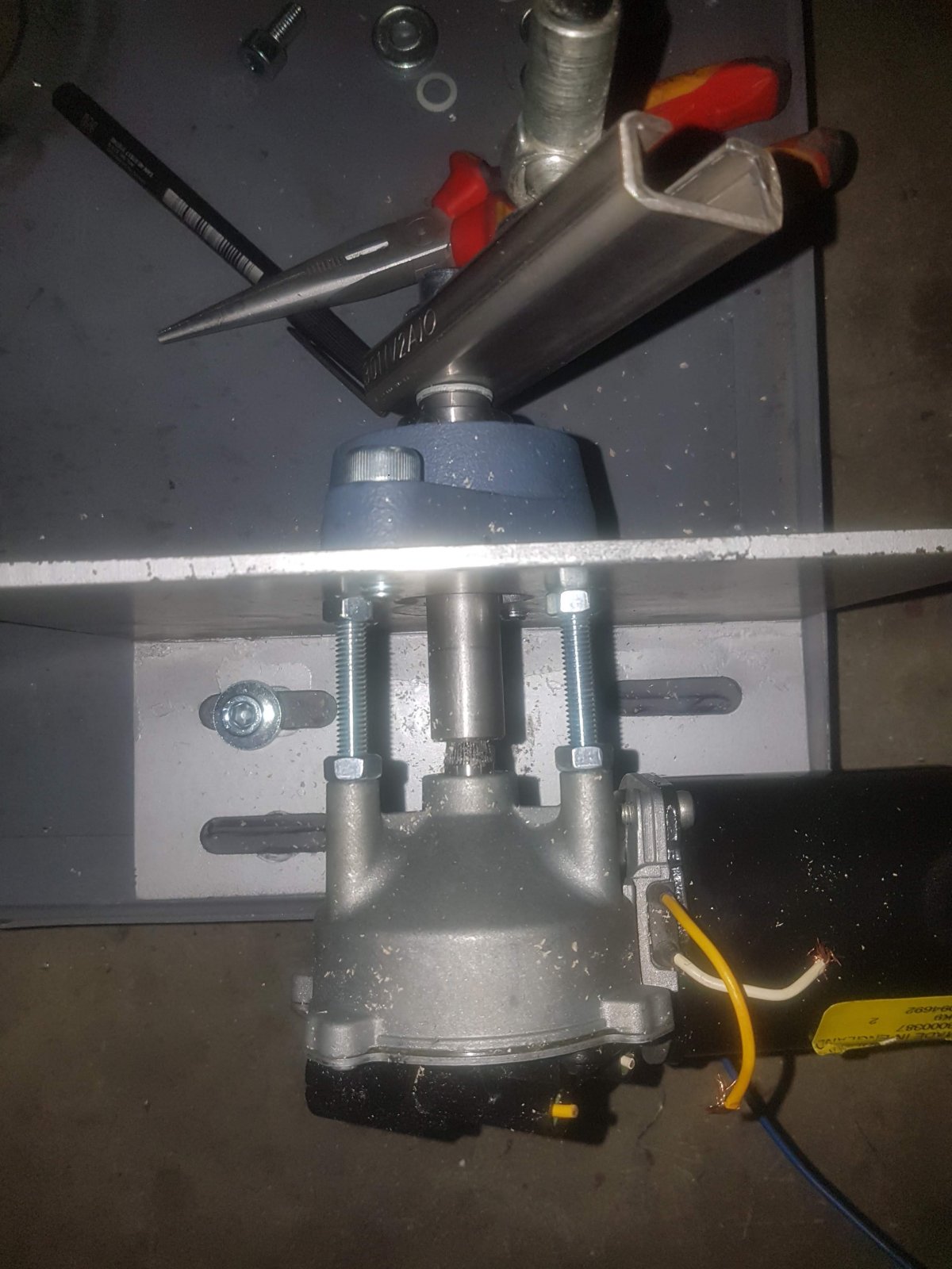

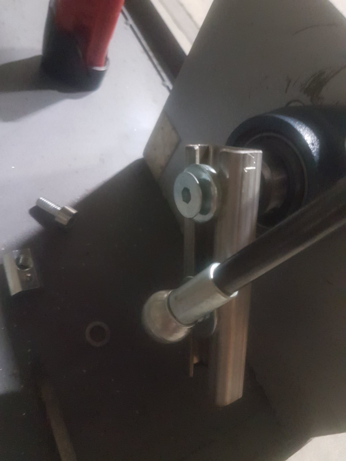

    After few days of testing and setting it up, first Defects, Faults, Errors...
    20191228_200814.jpg 20200112_132410.jpg 20200112_135455.jpg 20200112_135711.jpg
    Broke Always get Lose Broke 2x Welding Not GOOD :(

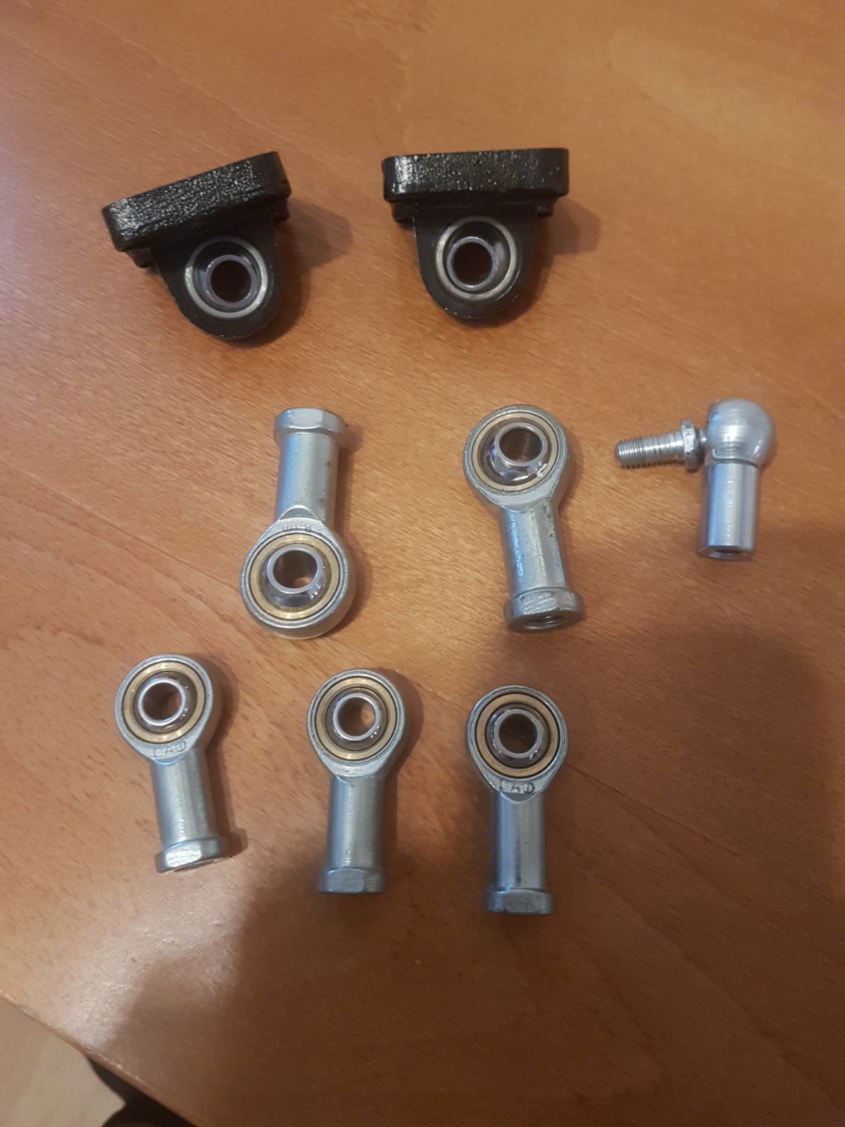

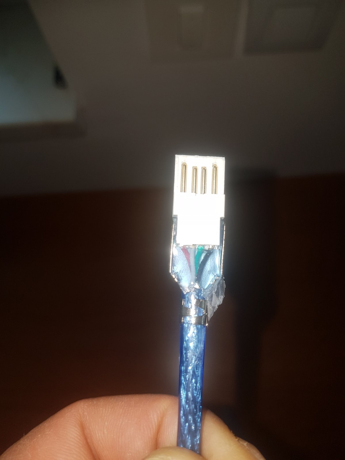

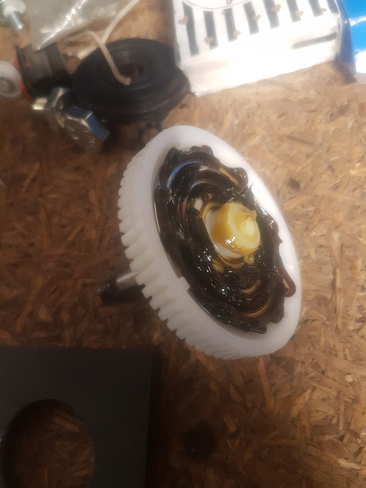

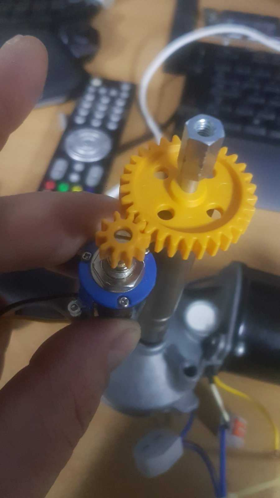

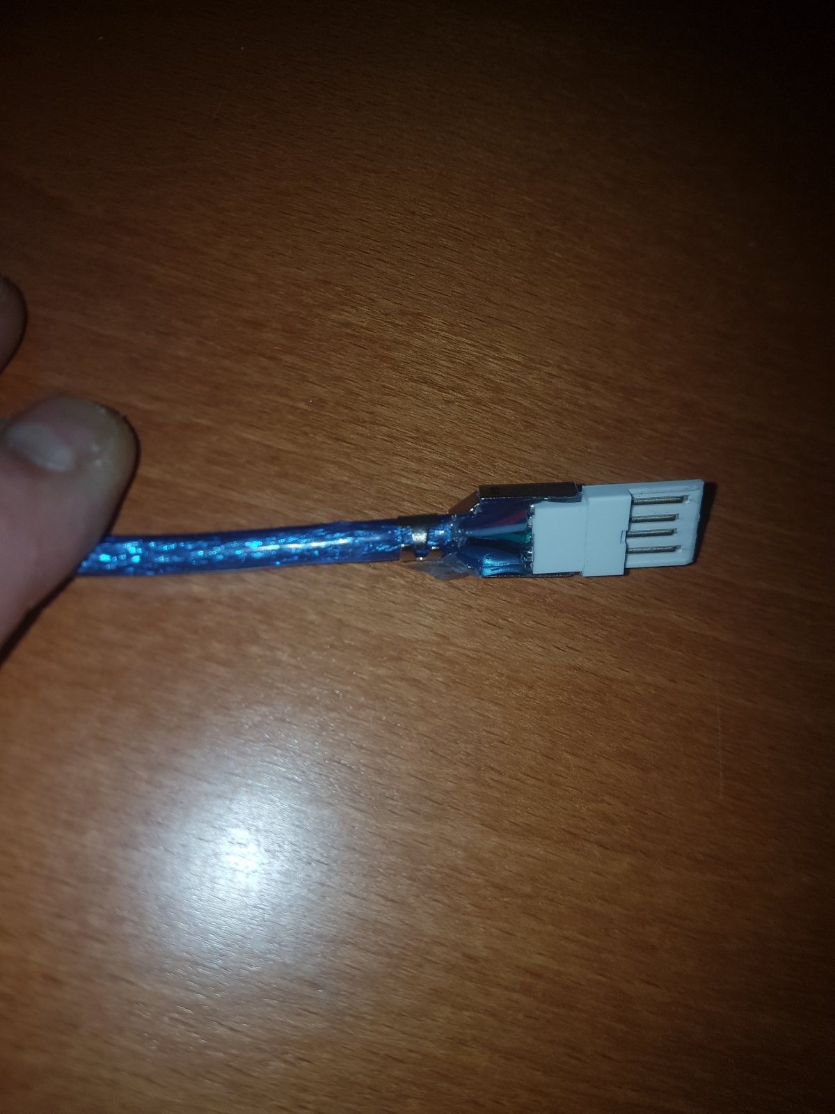

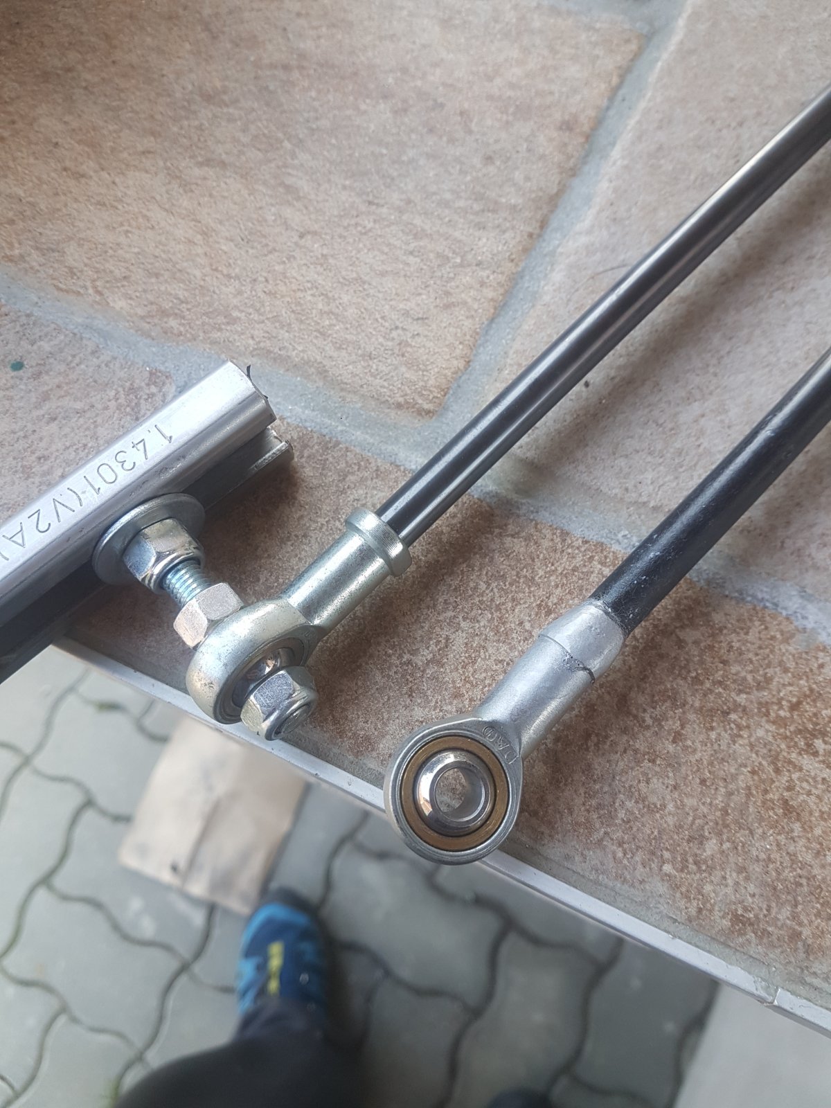

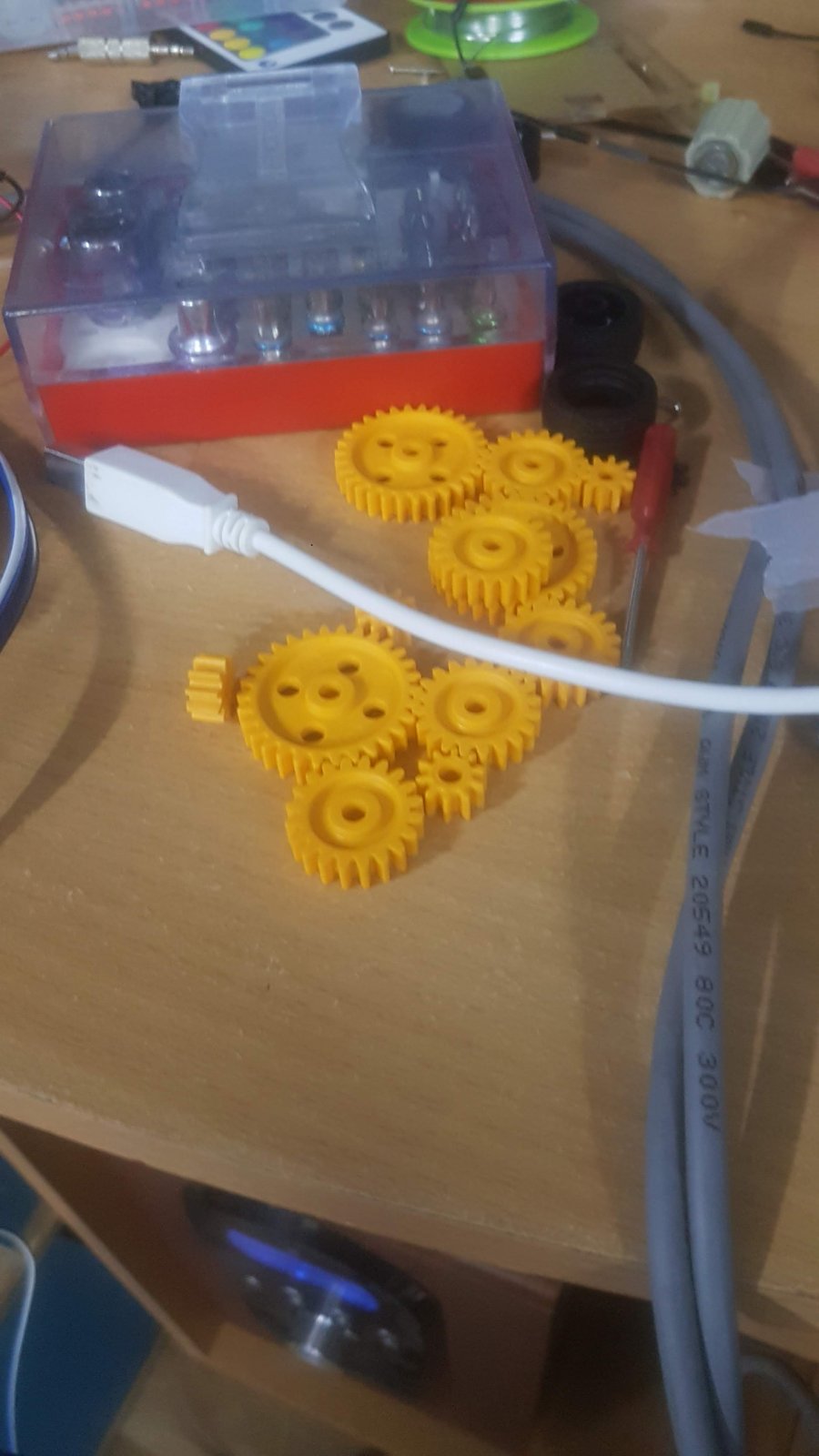

    Ok. Bad Thinks Are there to make it Better, So lets do this...
    20200104_122544.jpg 20200104_122458.jpg 20200112_132425.jpg 20200115_094817.jpg 20200110_155809.jpg 20200112_140626.jpg
    China Cable (Shield connected to PLASTIC!!!) EMI Problems when i connected my Wheel to the SIM, Lost connection and the Motors begun to run like MAD, broke my Potis :(
