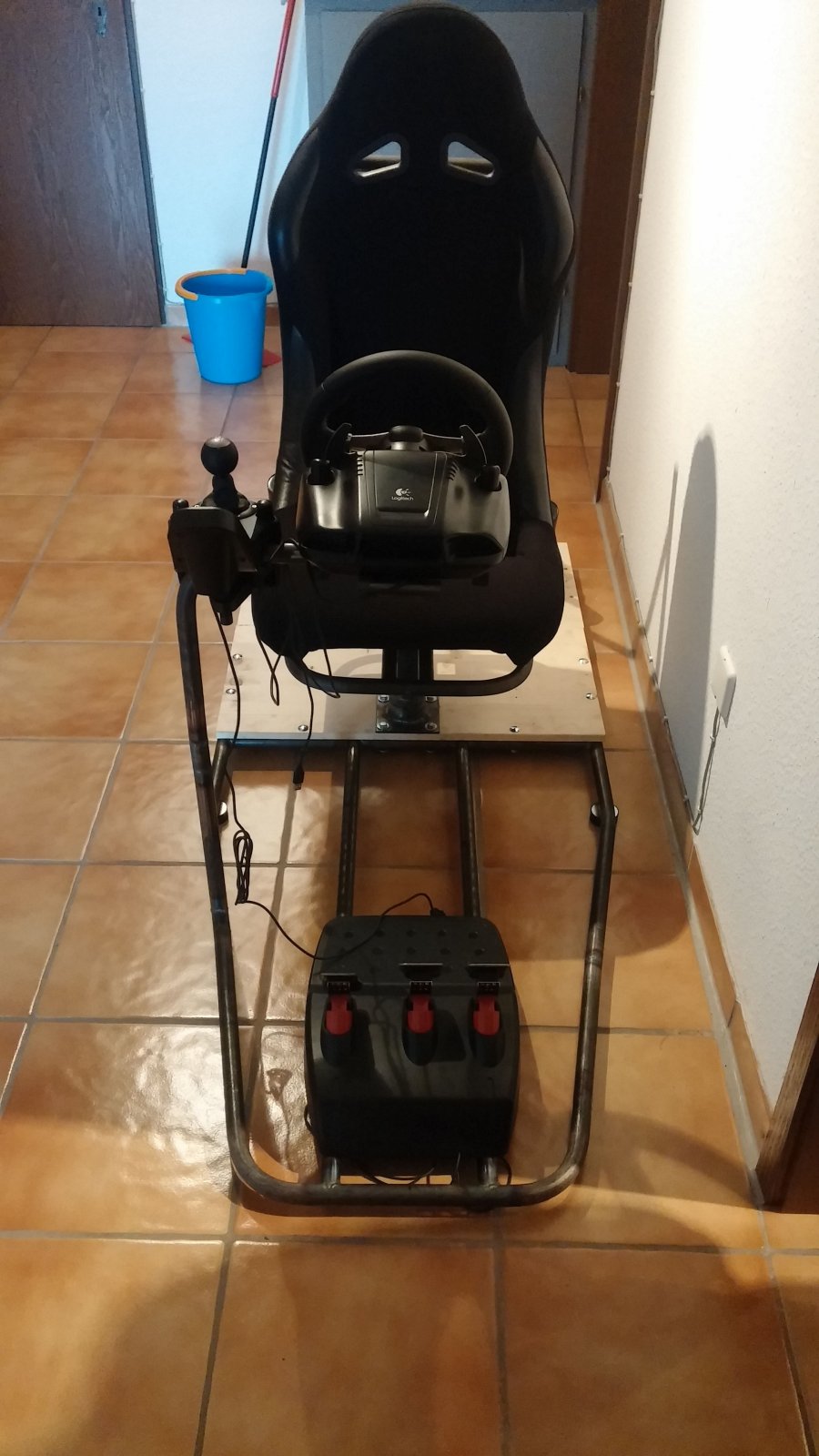

    Hey guys,
    so I finally start my buildthread, even if the major part of the build is almost done, there's still a lot of small things to do.
    Stuff like building a nice box for the electrical parts, adding bodyshakers, fitting some seatbelts to the seat and so on, but you'll see soon how far I've come until now.
    Then let's start with some pictures:

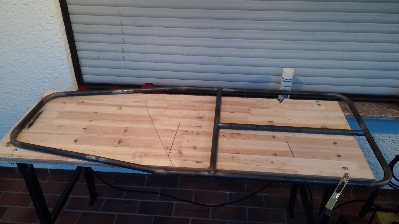

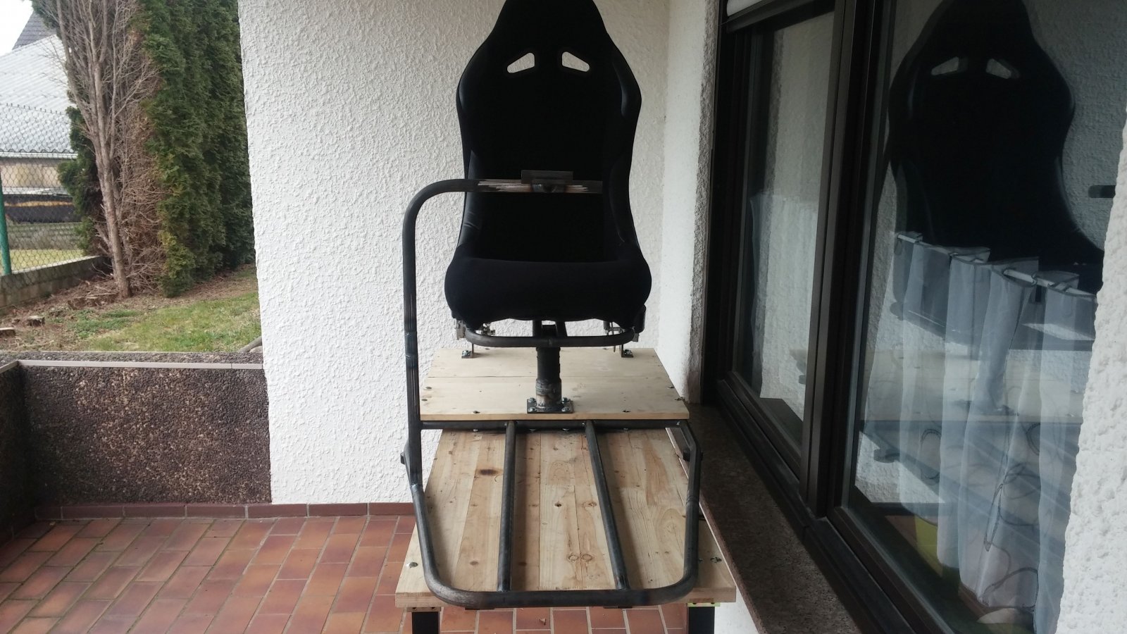

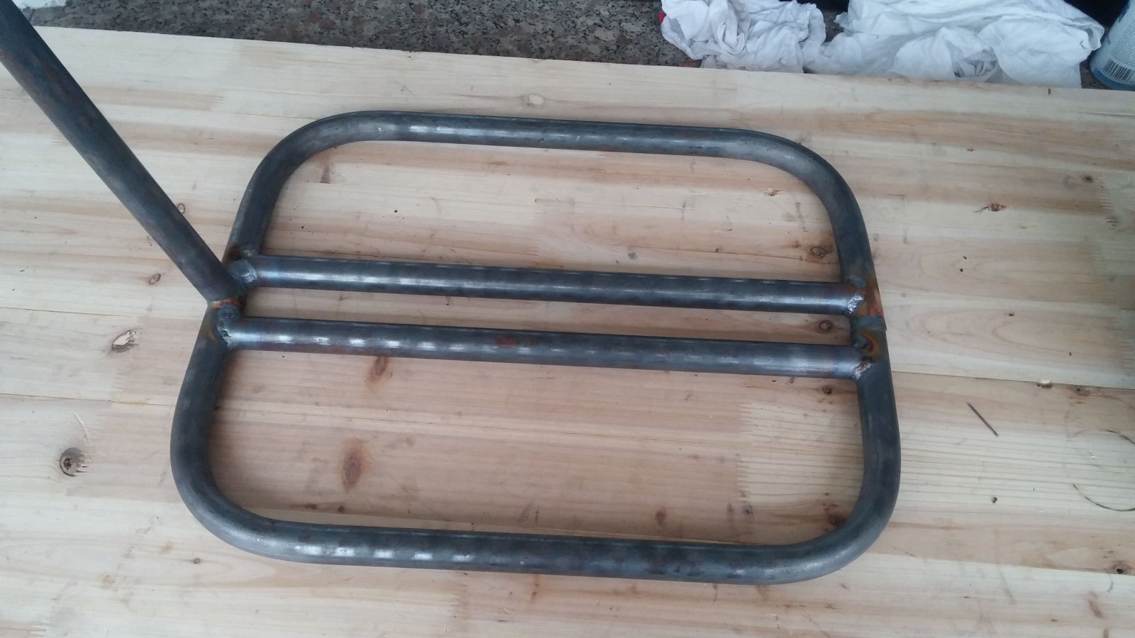

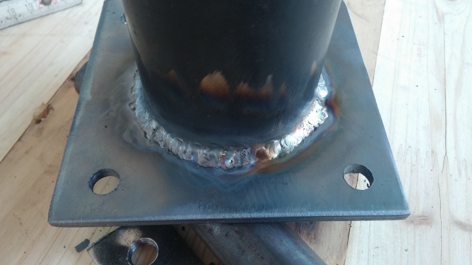

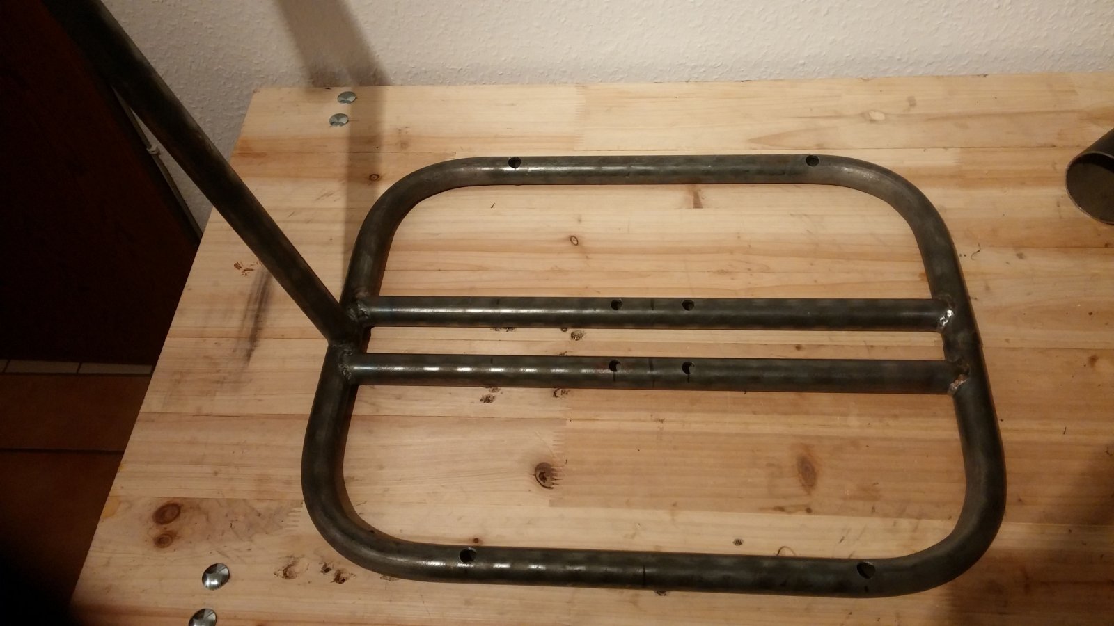

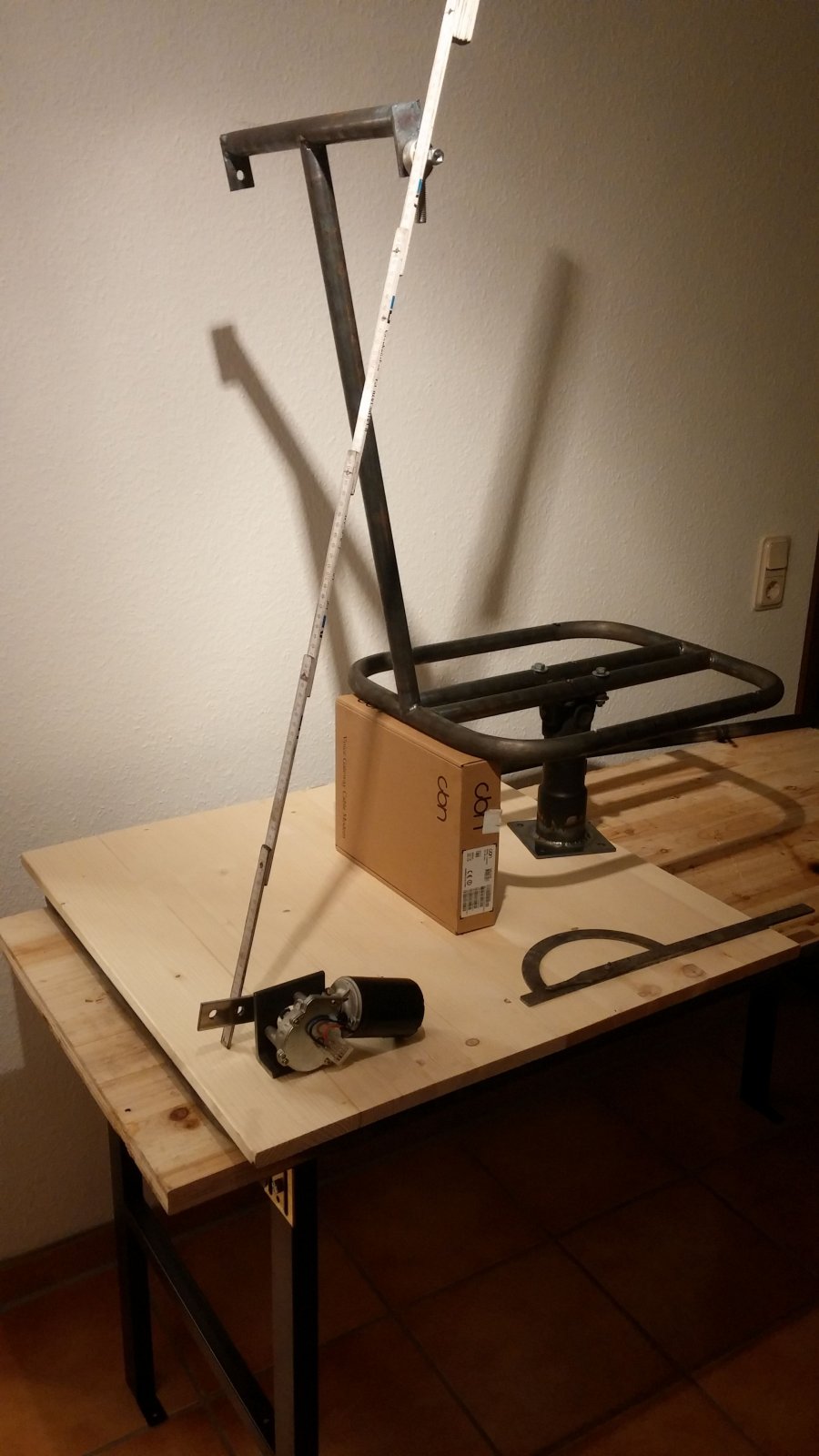

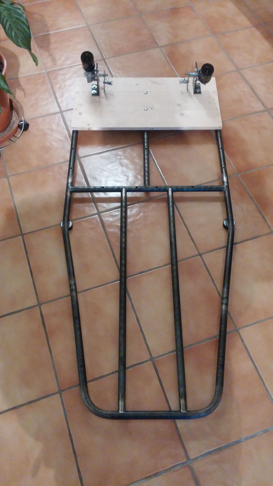

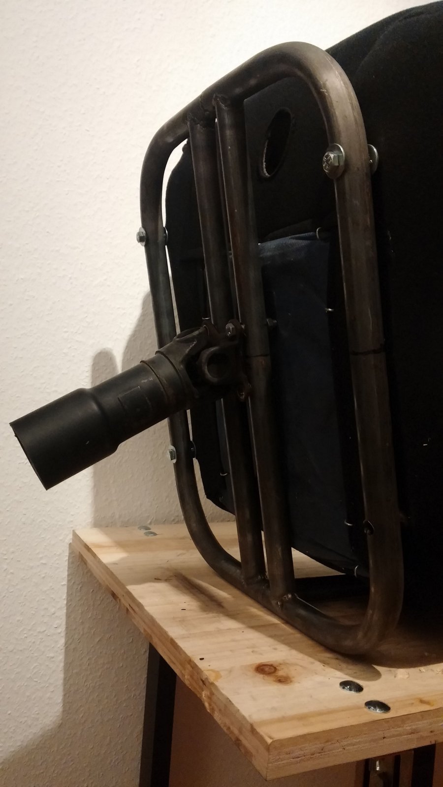

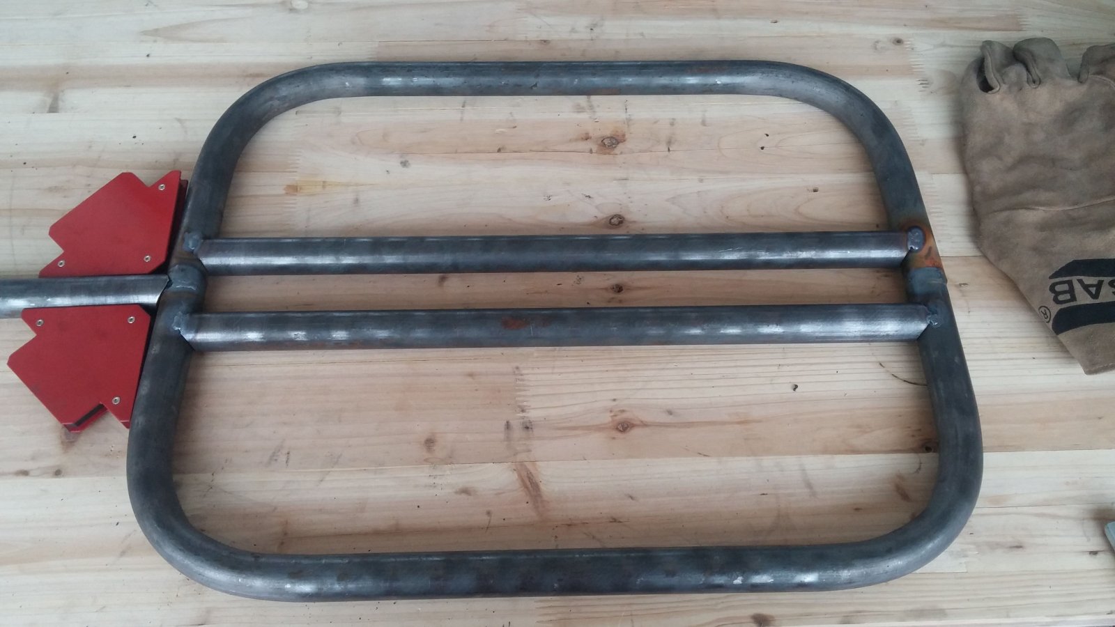

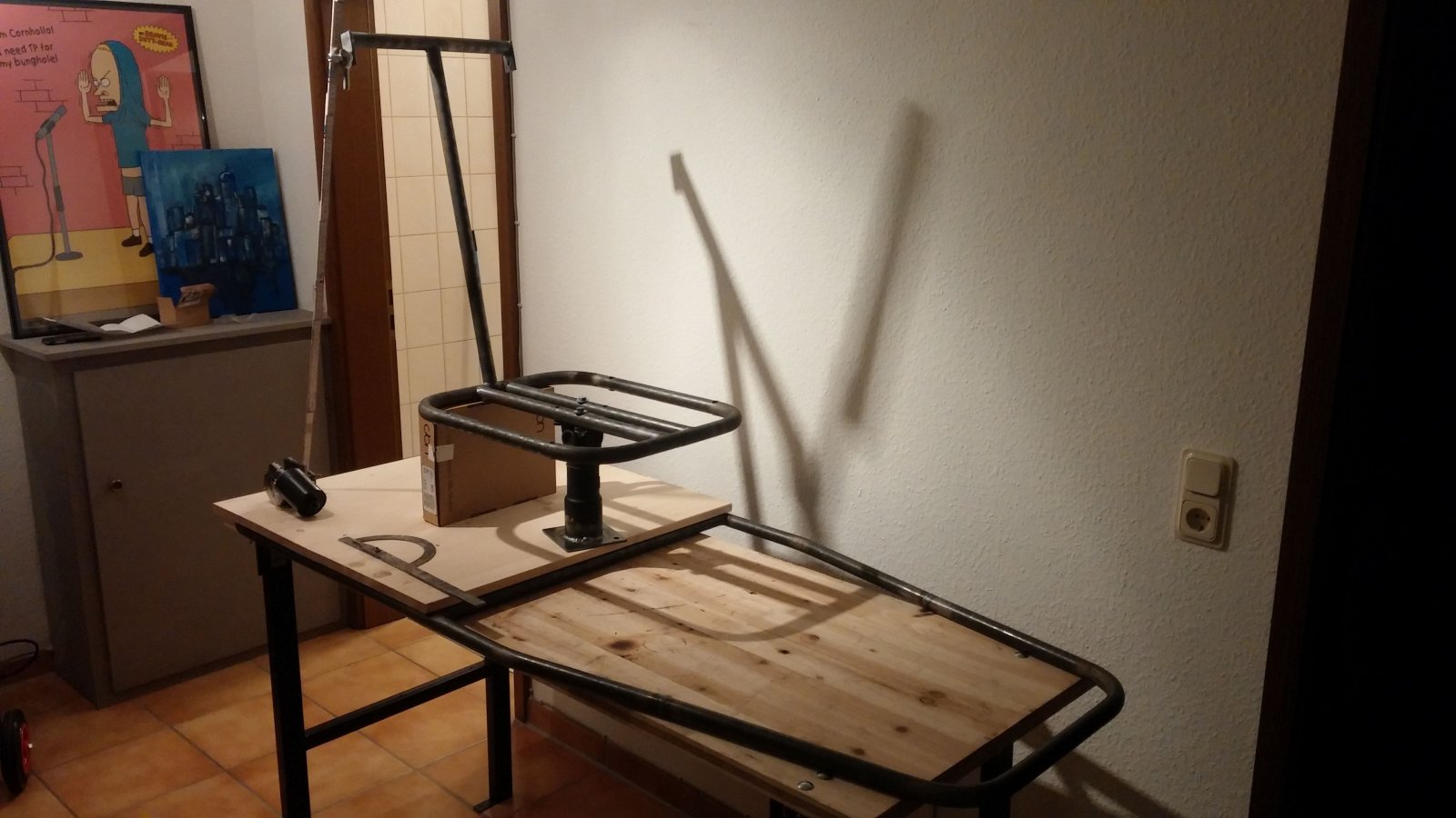

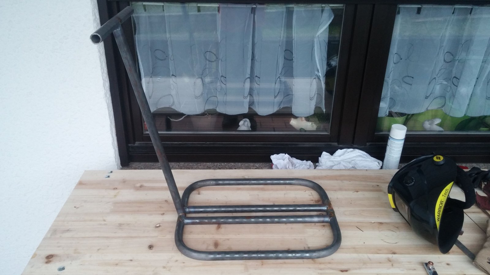

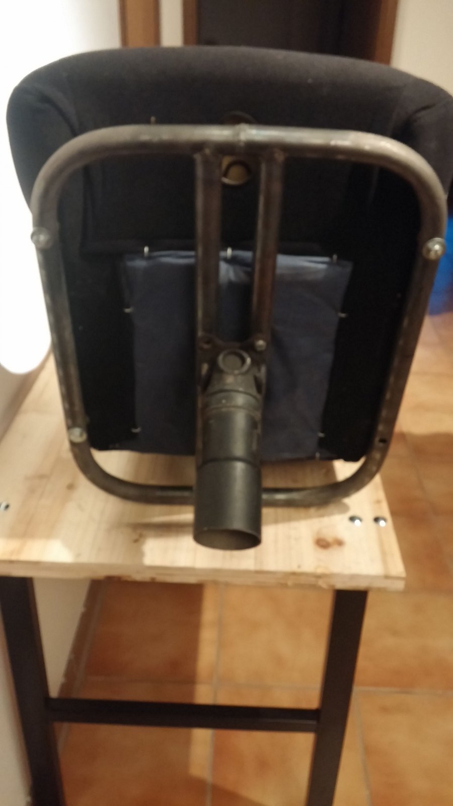

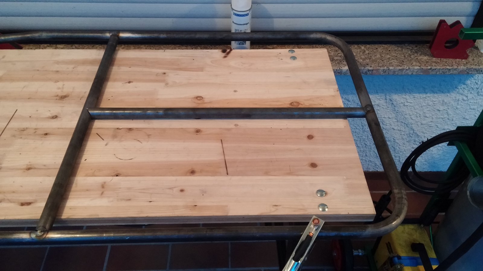

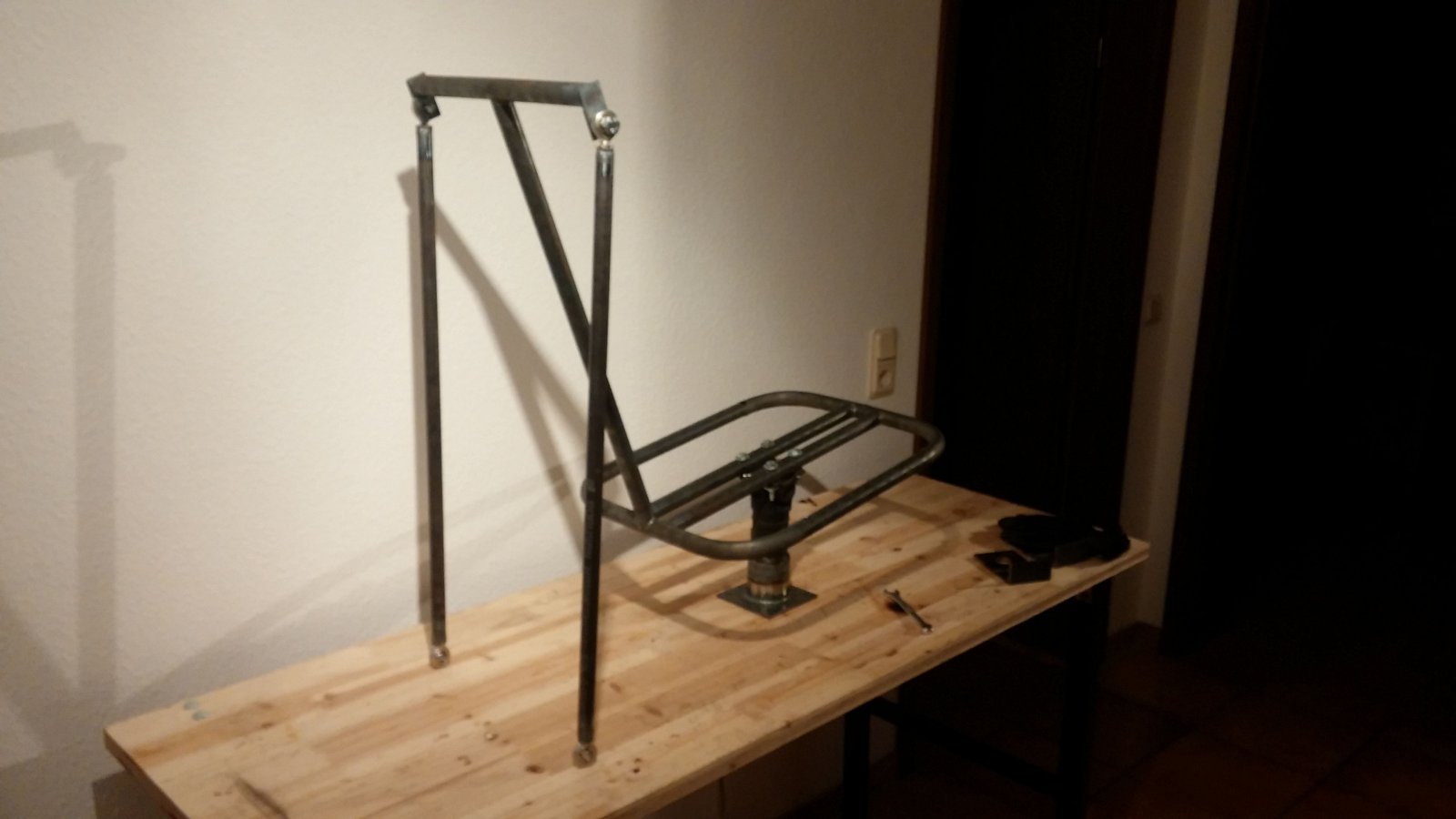

    Here's where I started to build the seat and base frame:
    20150310_163947.jpg 20150310_163956.jpg 20150310_174605.jpg 20150310_174613.jpg 20150310_183624.jpg 20150310_183633.jpg 20150311_184100.jpg

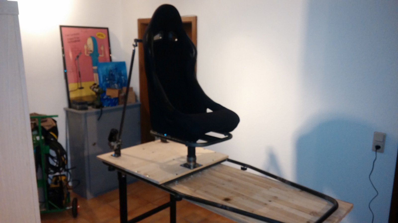

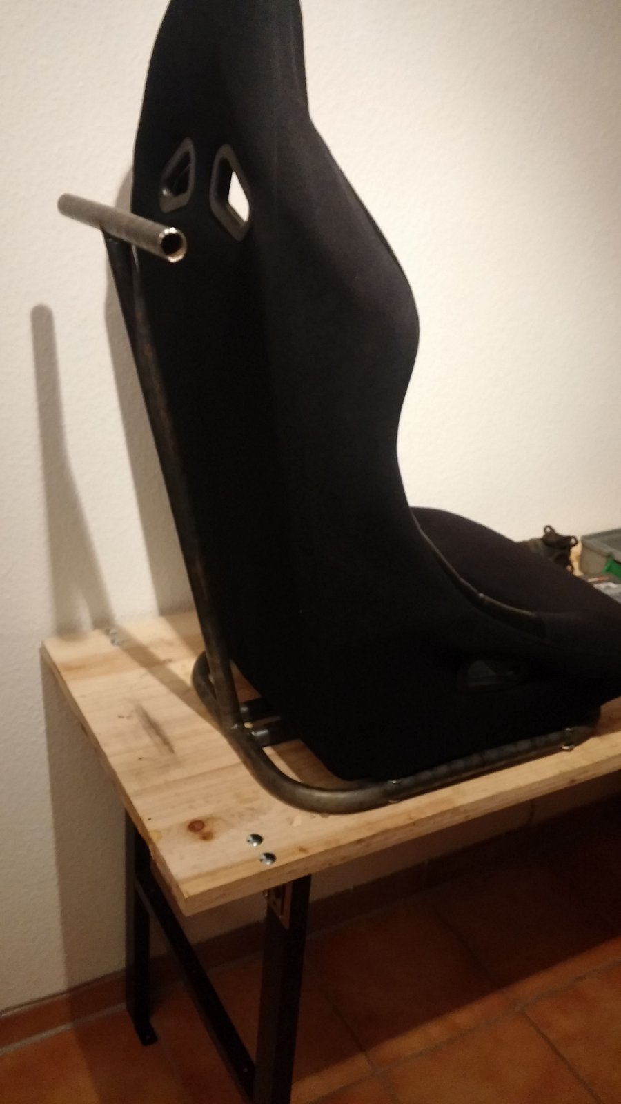

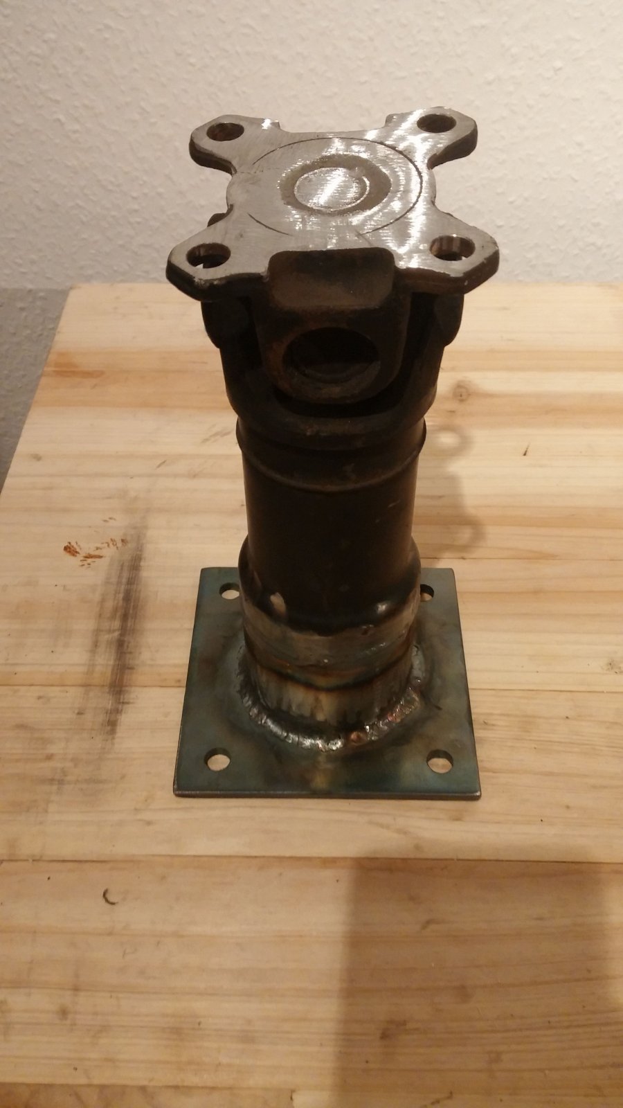

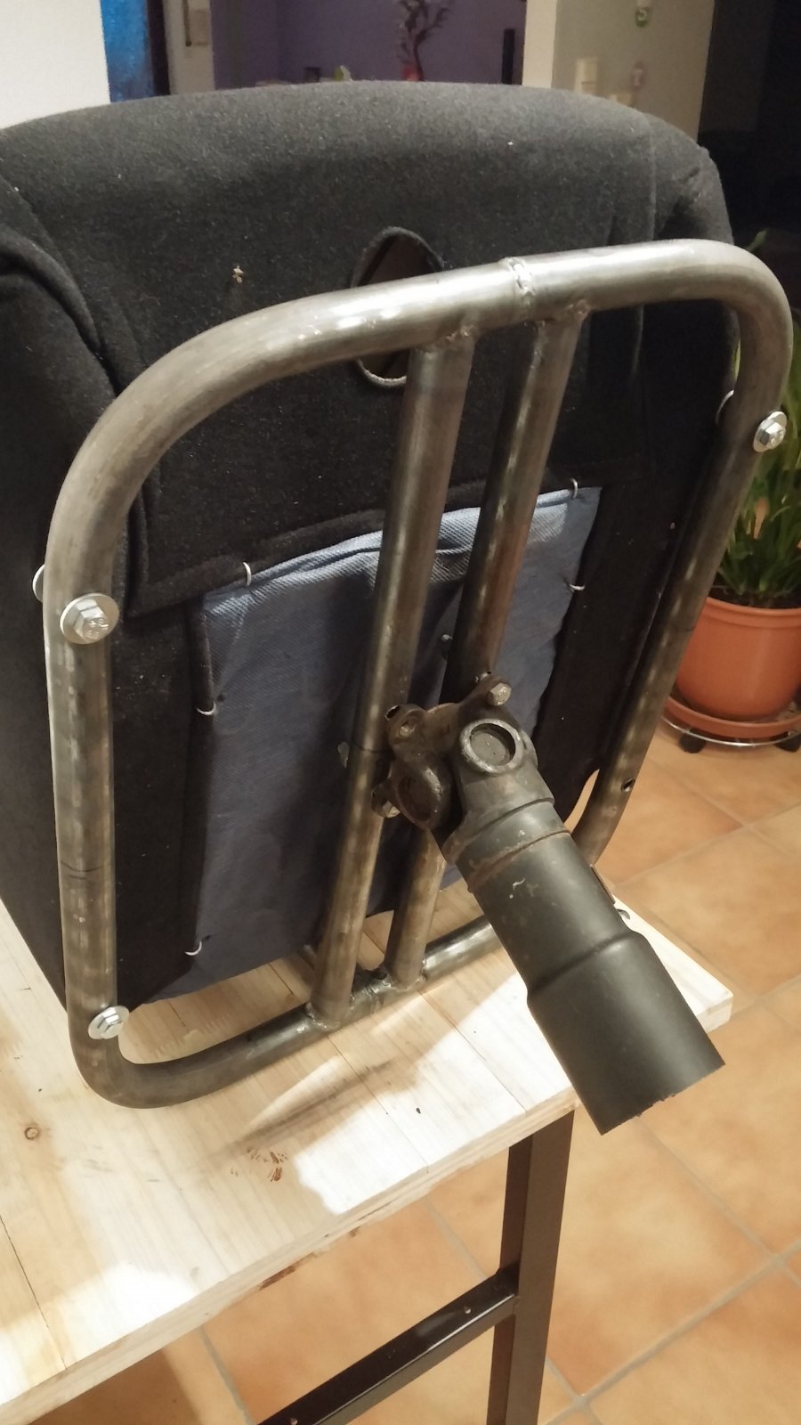

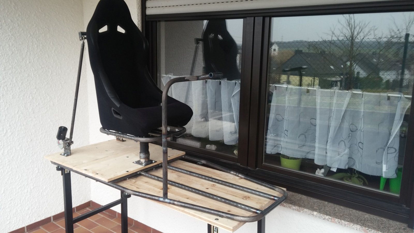

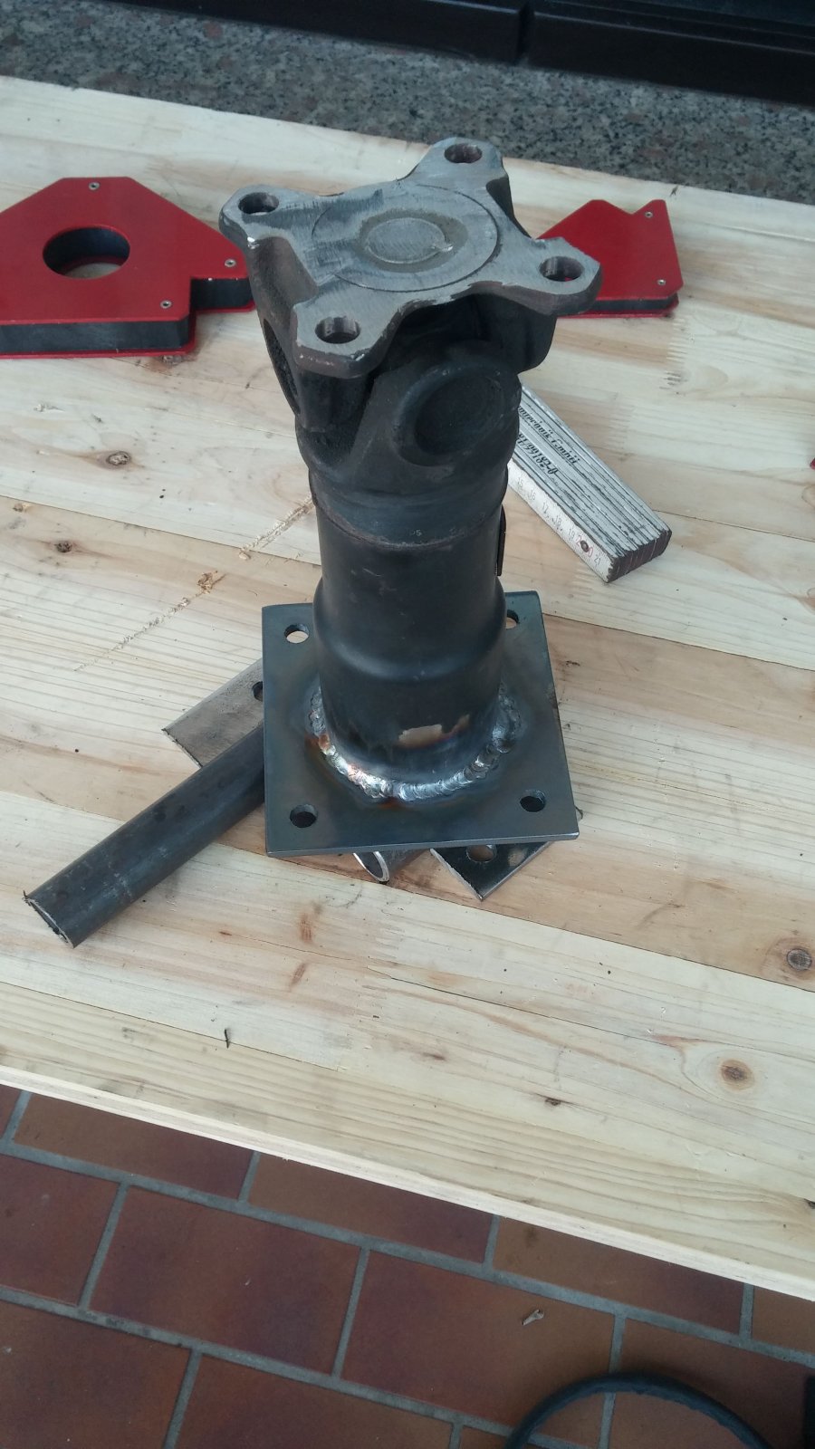

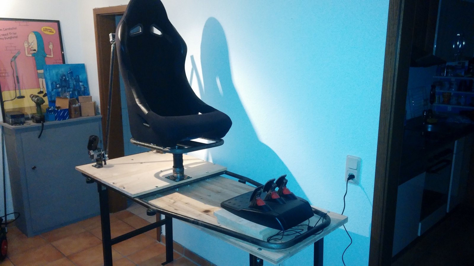

    Here's some pictures of the shortened driveshaft I used and the firt testfit for the seat:
    20150311_184651.jpg 20150311_184727.jpg 20150311_184712.jpg 20150311_184945.jpg

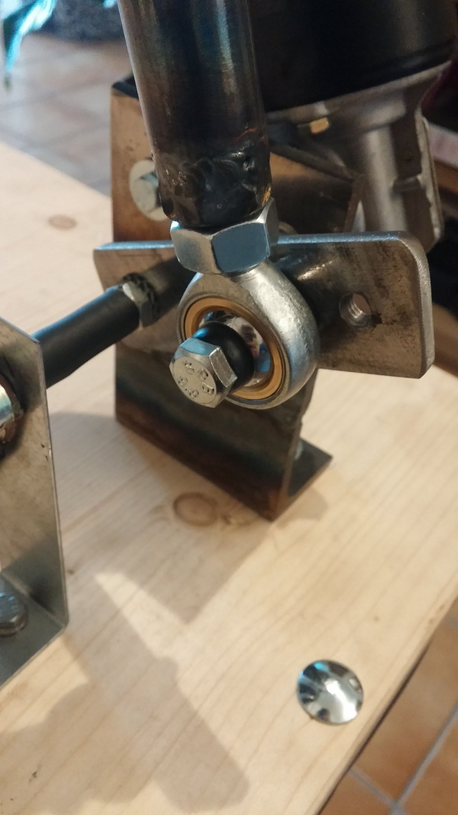

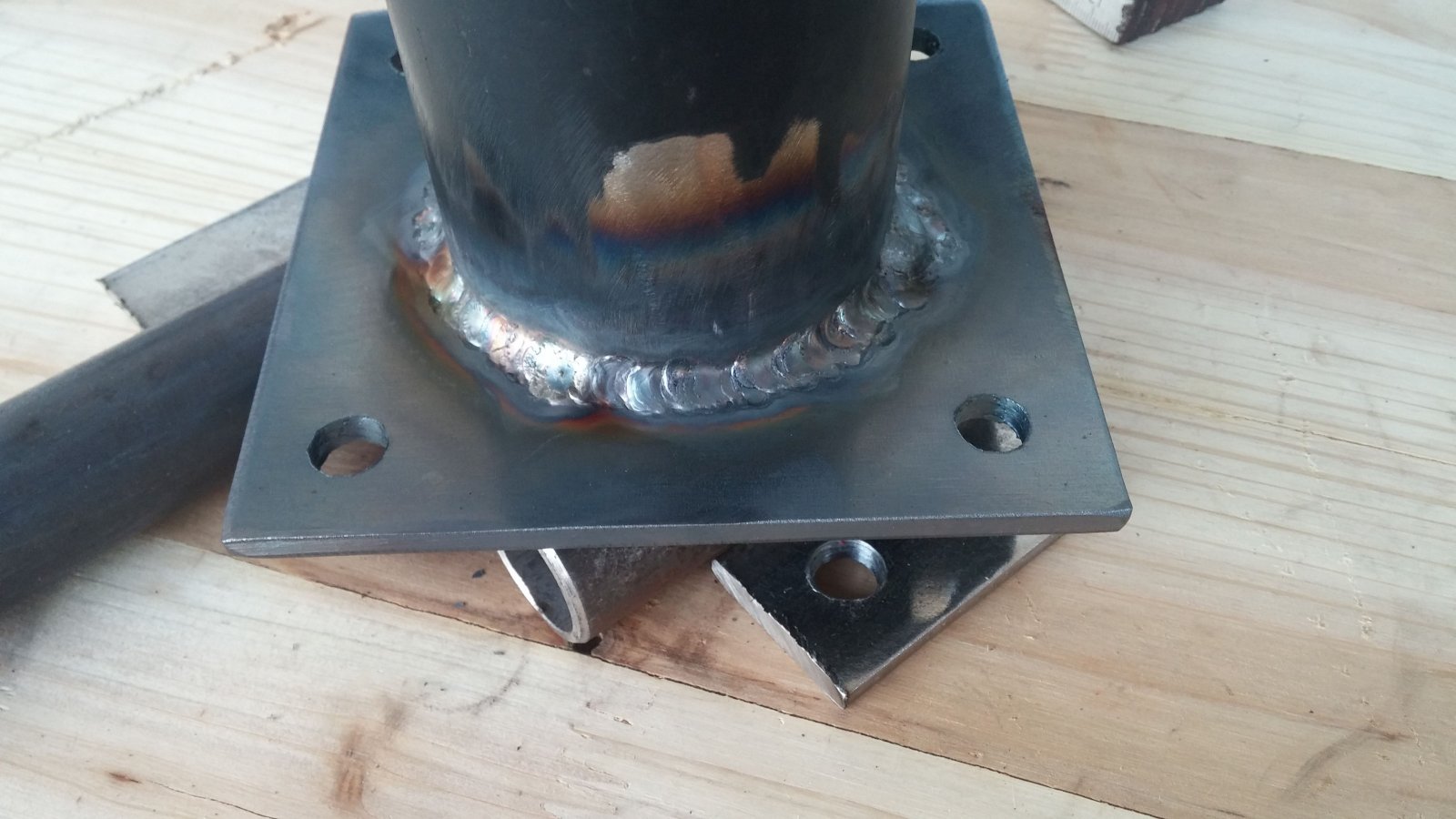

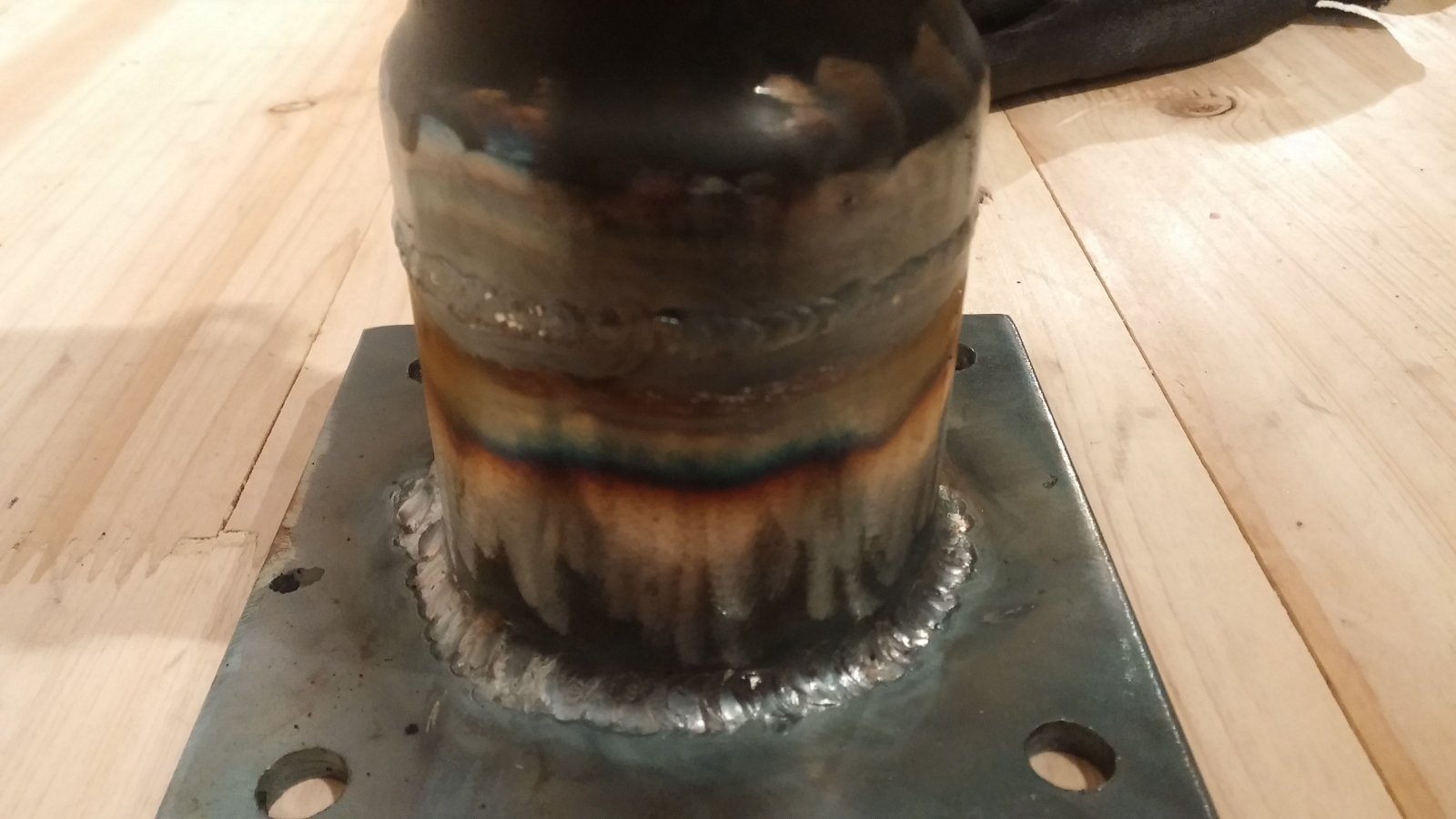

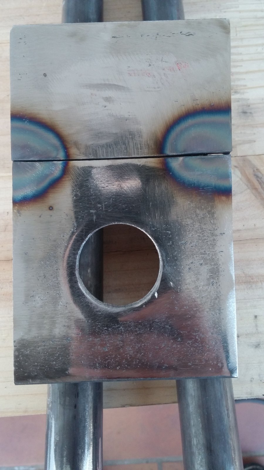

    Next I wanted to finish the pivot part, but did a big mistake, maybe someone can find it ;):
    20150312_174400.jpg 20150312_174409.jpg 20150312_174417.jpg 20150312_174423.jpg
    I focused too much on having the shaft centered on the plate that I forgot to watch out for the holes to line up correctly :roll
    So here's the corrected part:

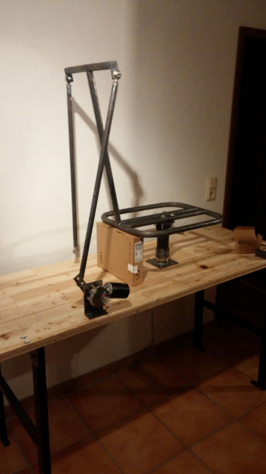

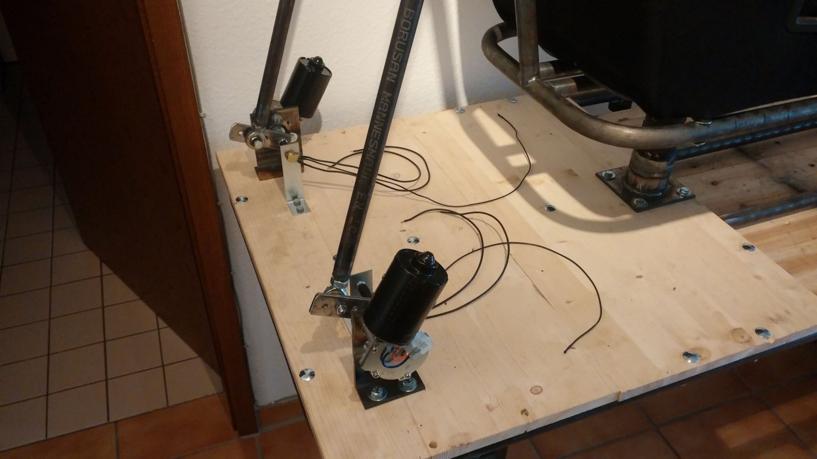

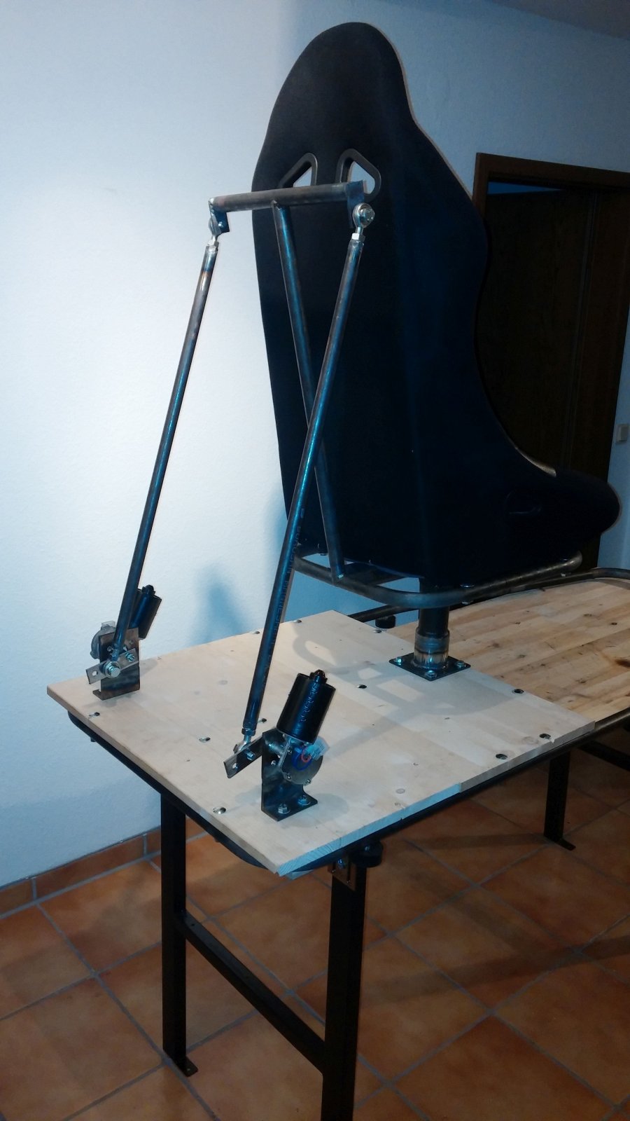

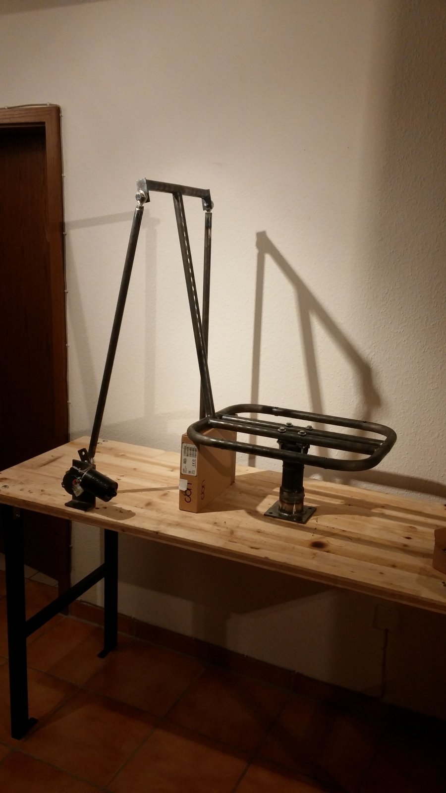

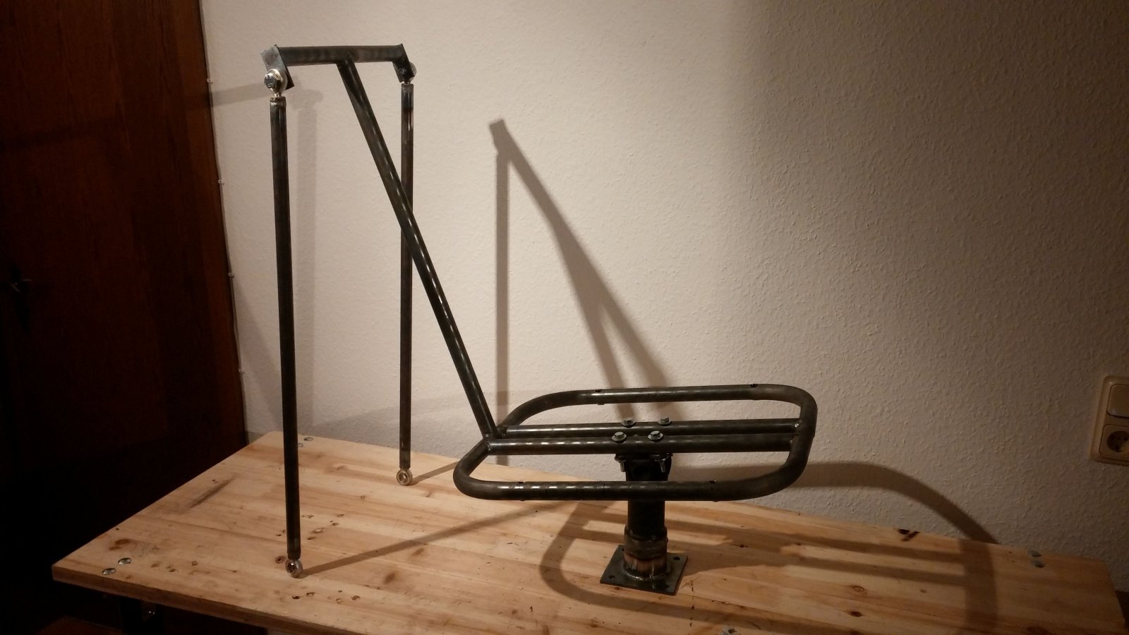

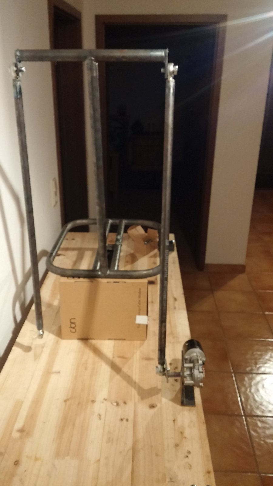

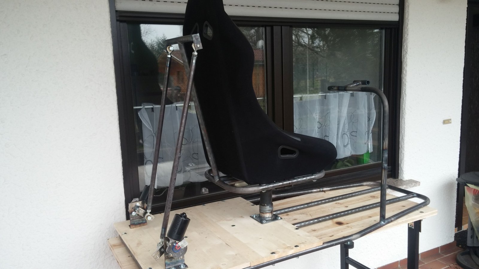

    After that, I assembled this part of the rig to measure the length for the connecting rods and build them:
    20150312_192131.jpg 20150312_192148.jpg 20150313_190711.jpg 20150313_190720.jpg

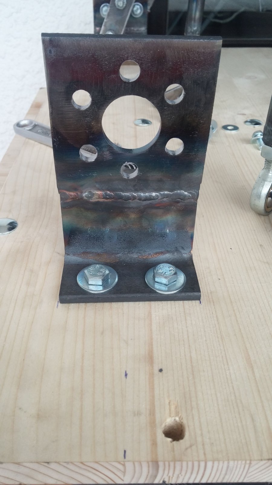

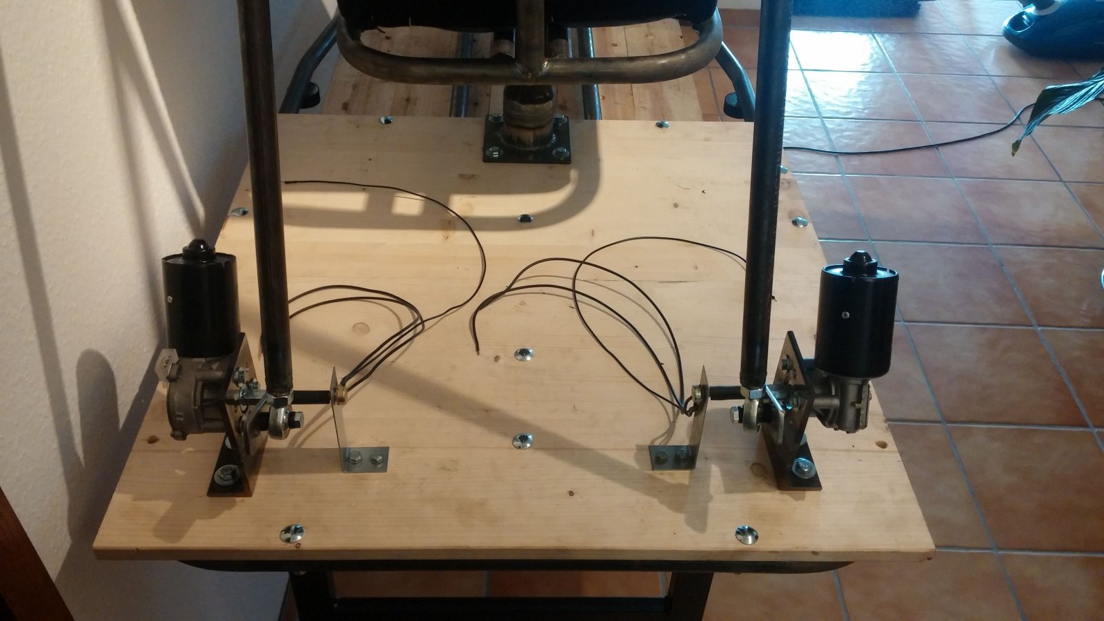

    Another problem arised, the first version of the motor holders was too short, so I had to extent them:
    After that there was a whole lot of fitting and refitting the motion parts:
    20150313_192601.jpg 20150313_192755.jpg 20150314_195201.jpg 20150314_195221.jpg 20150314_212648.jpg 20150314_212712.jpg IMG-20150318-WA0006.jpg

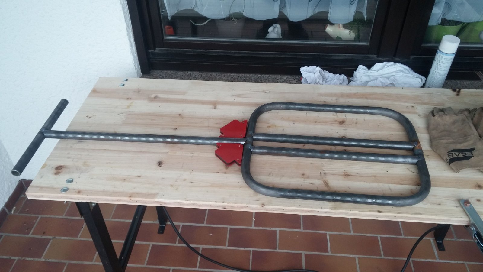

    Then I needed to build something like a mast for my racing wheel to be clamped to:
    20150321_140415.jpg 20150321_140423.jpg 20150321_140434.jpg 20150321_142339.jpg 20150321_142350.jpg 20150321_142410.jpg

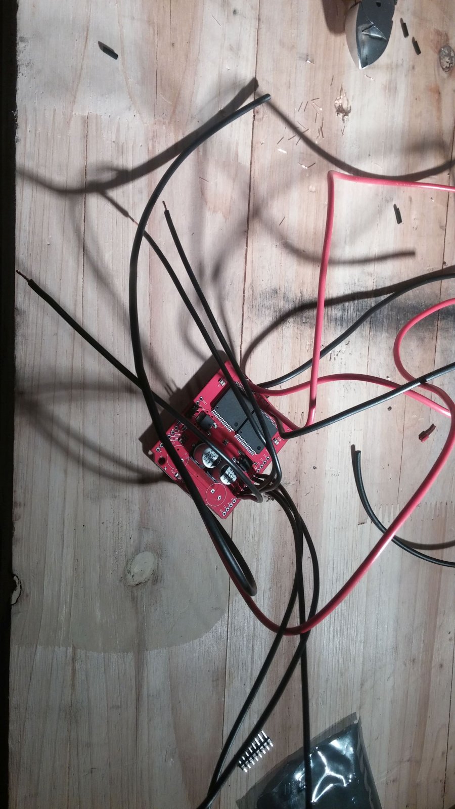

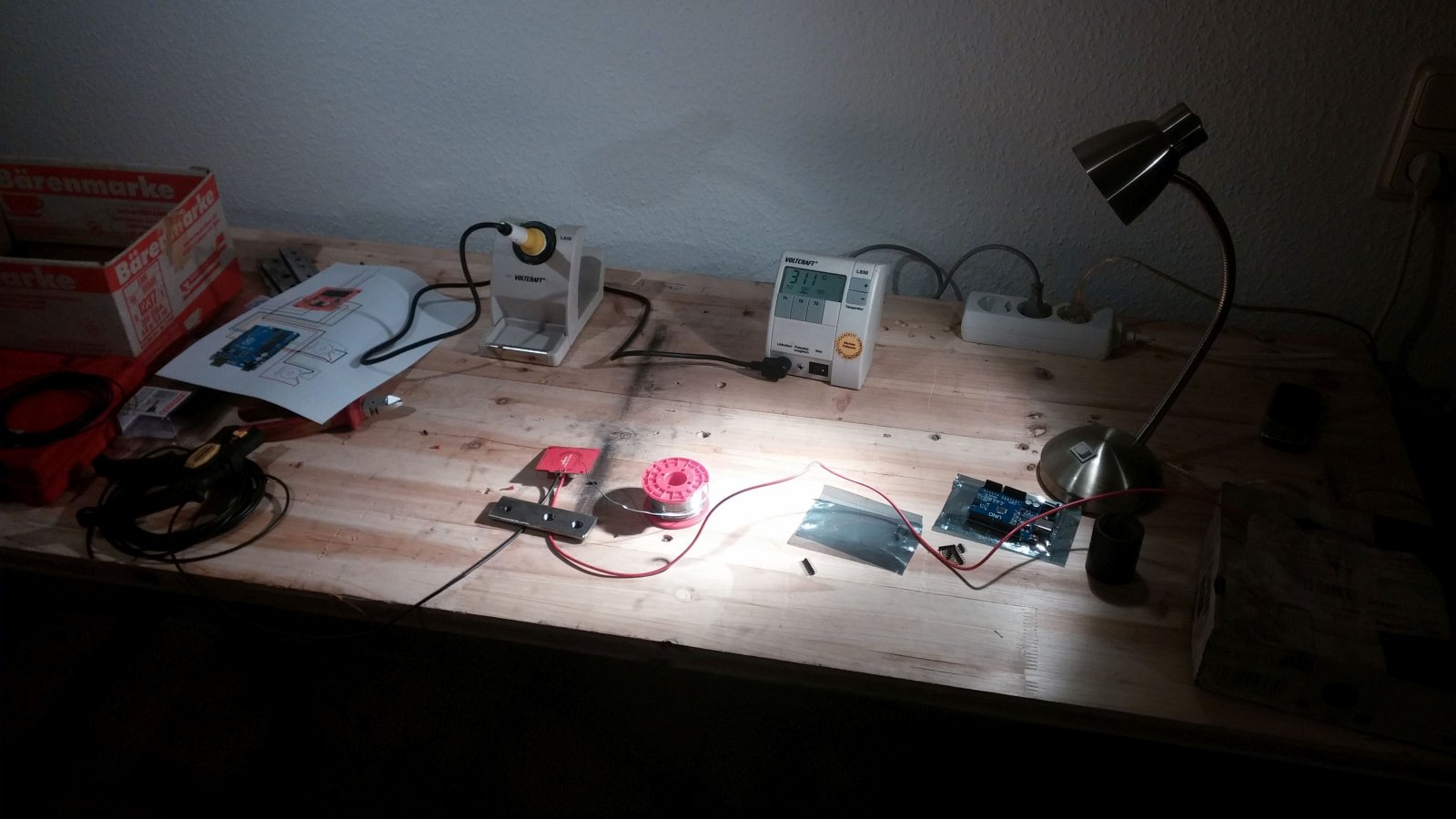

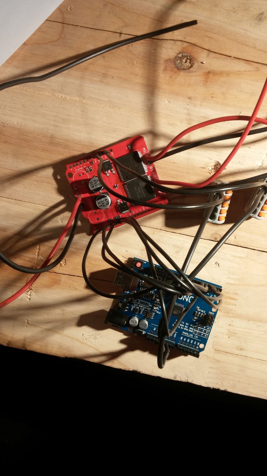

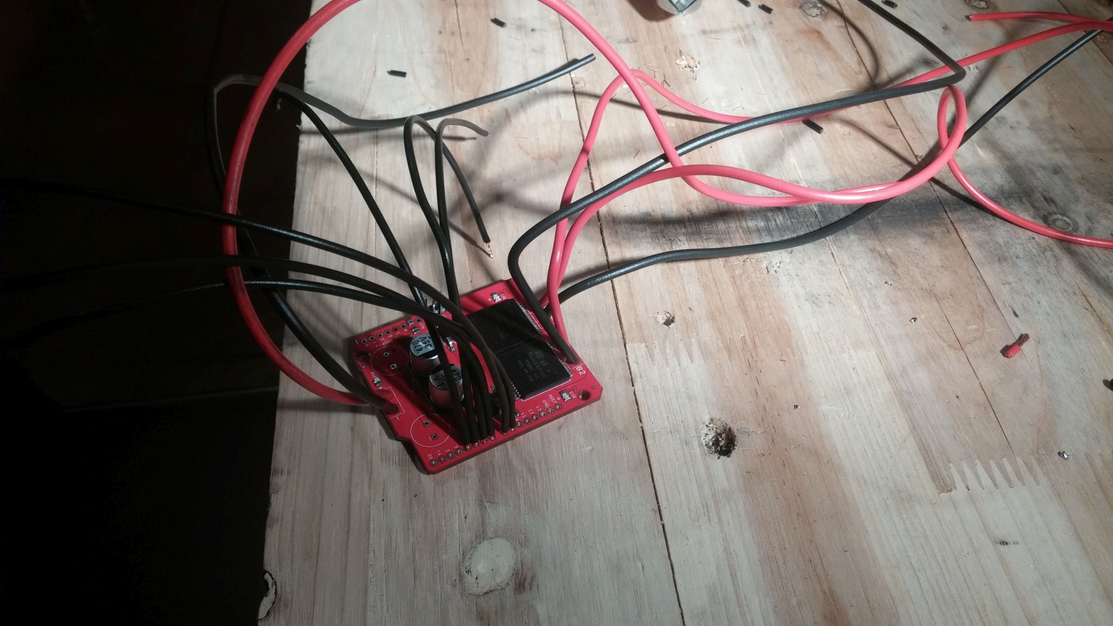

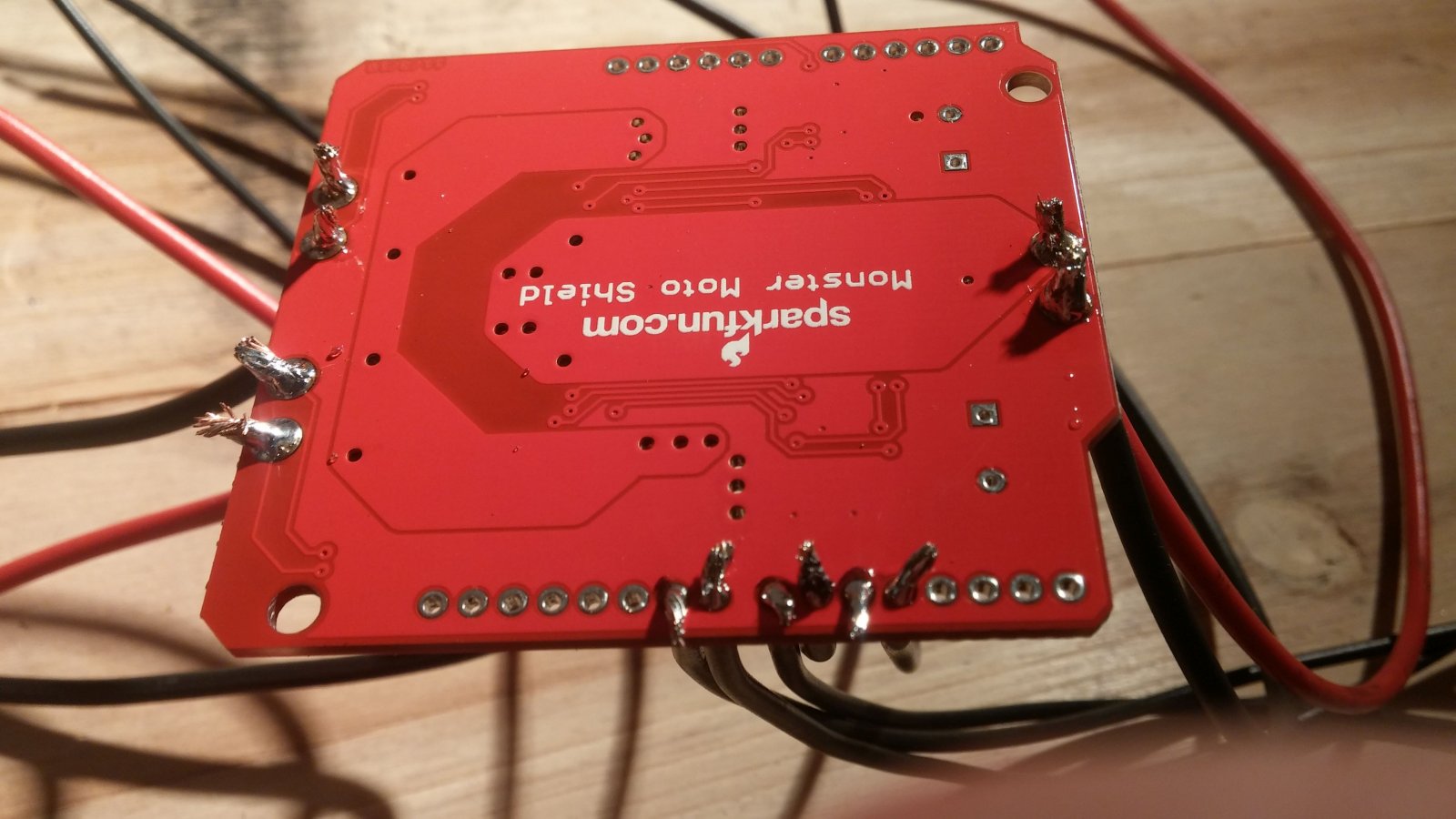

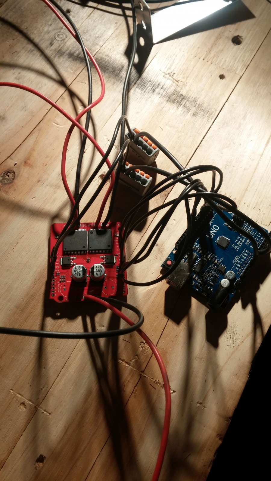

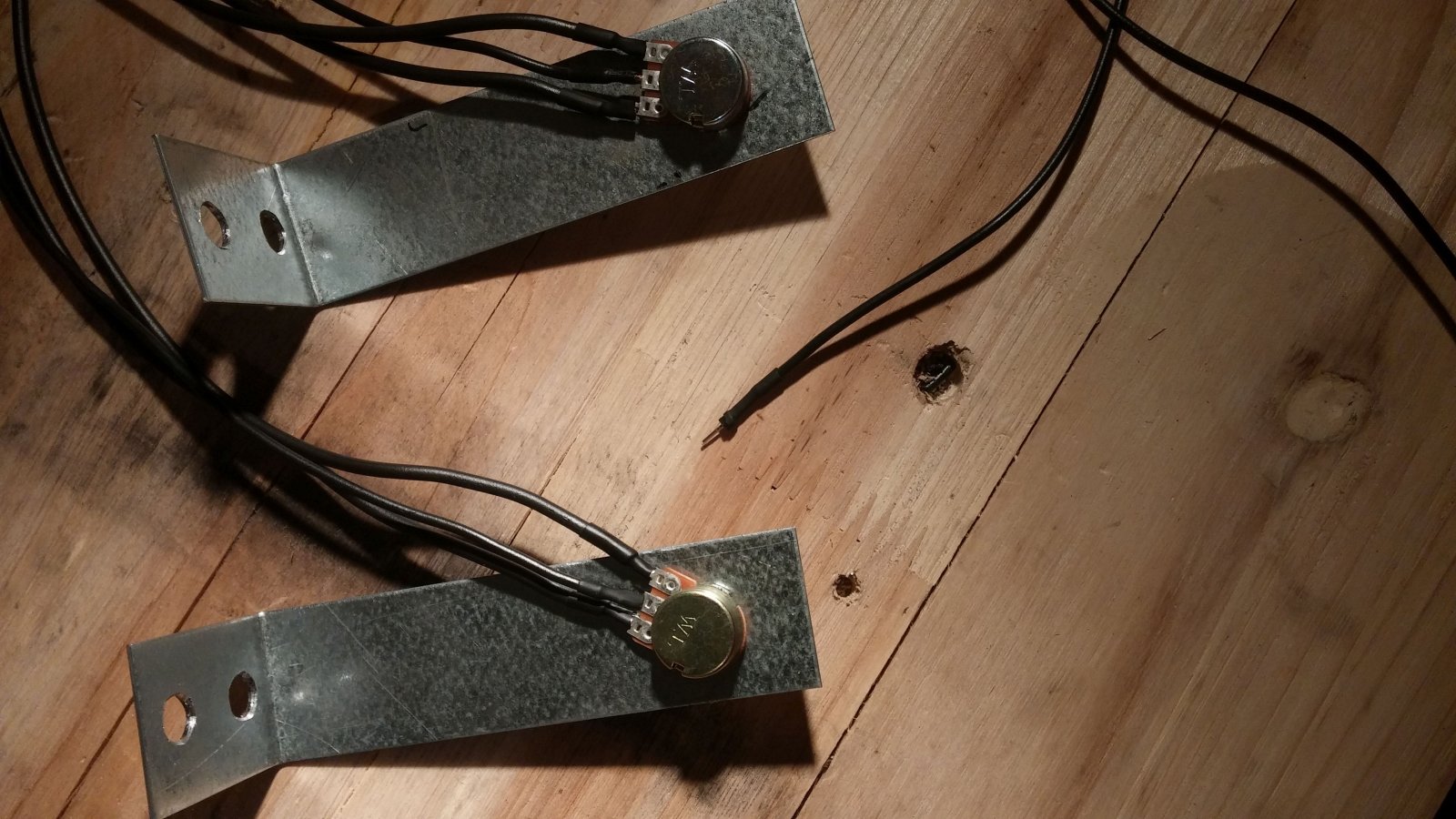

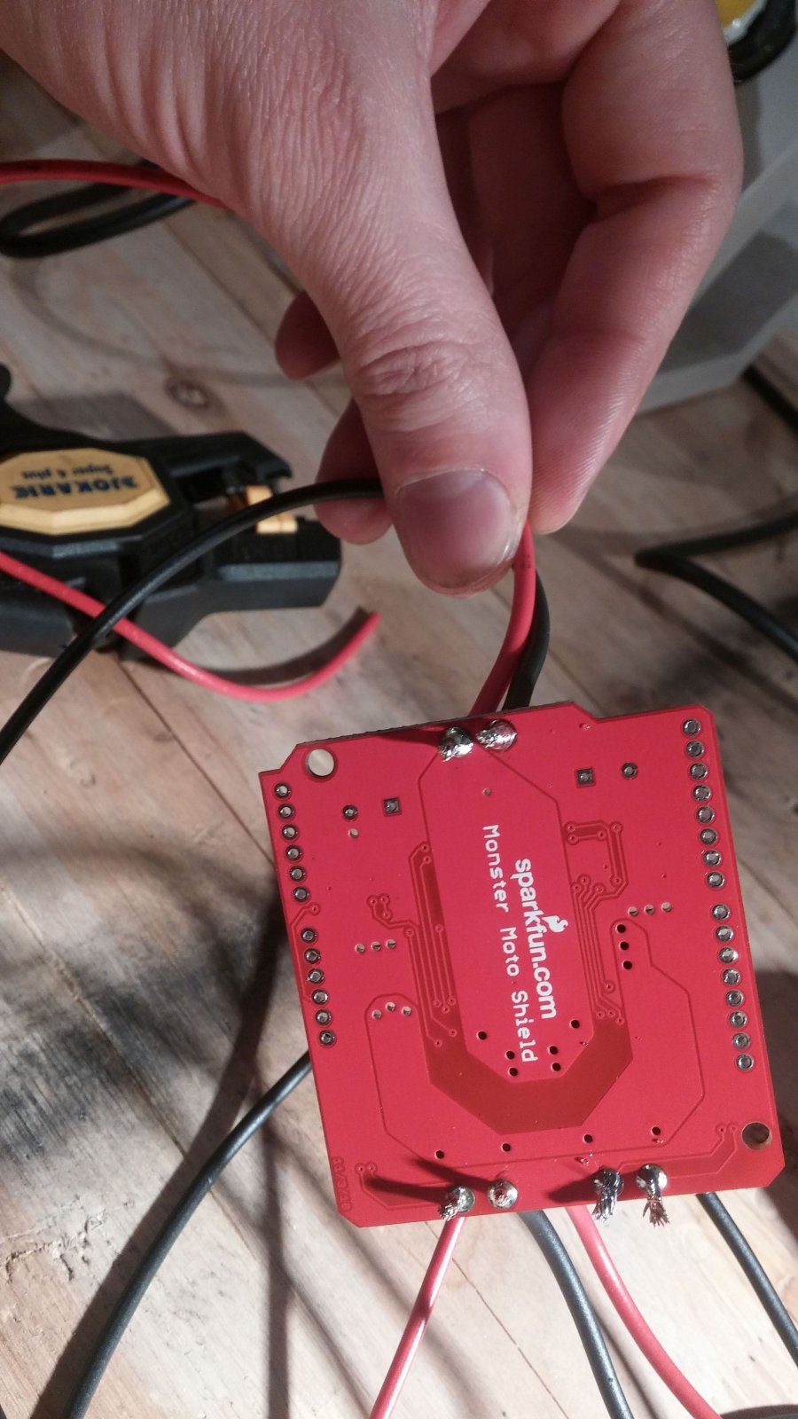

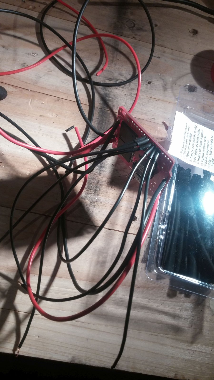

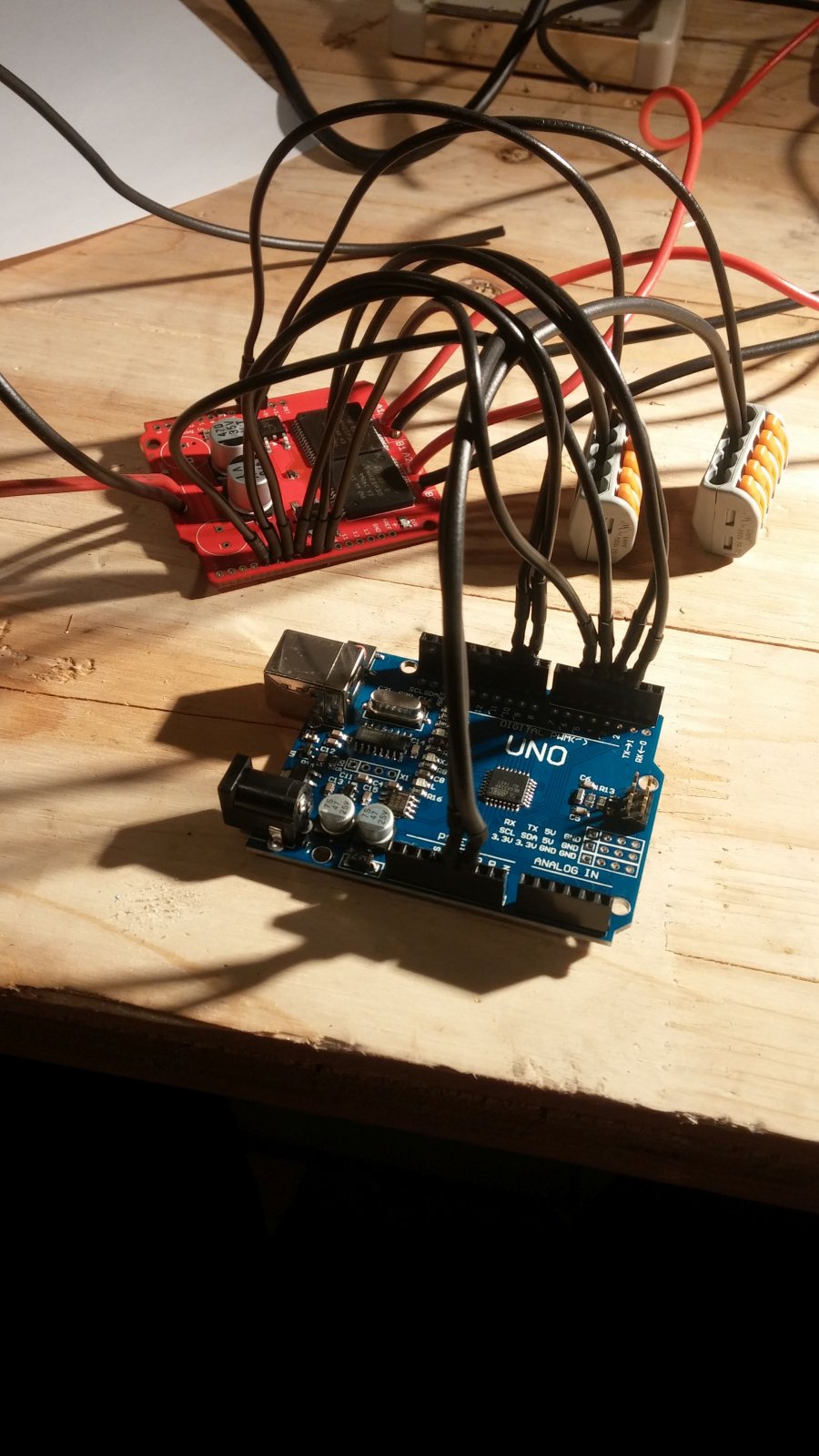

    Finally started to solder up the electrical parts (I know, it doesn't look perfect, but it was my first time soldering something this small ;)):
    20150327_211151.jpg 20150328_002123.jpg 20150328_002128.jpg 20150328_002135.jpg 20150328_115254.jpg 20150328_115300.jpg IMG-20150327-WA0017.jpg IMG-20150327-WA0019.jpg IMG-20150327-WA0021.jpg IMG-20150327-WA0023.jpg IMG-20150327-WA0023.jpg IMG-20150327-WA0025.jpg IMG-20150327-WA0031.jpg IMG-20150328-WA0000.jpg
    It went smoother than I expected and after all the bigger software setups, I did a small testrun in Assetto Corsa only with my keyboard, but i just found out that i can't upload the video to this thread :eek:

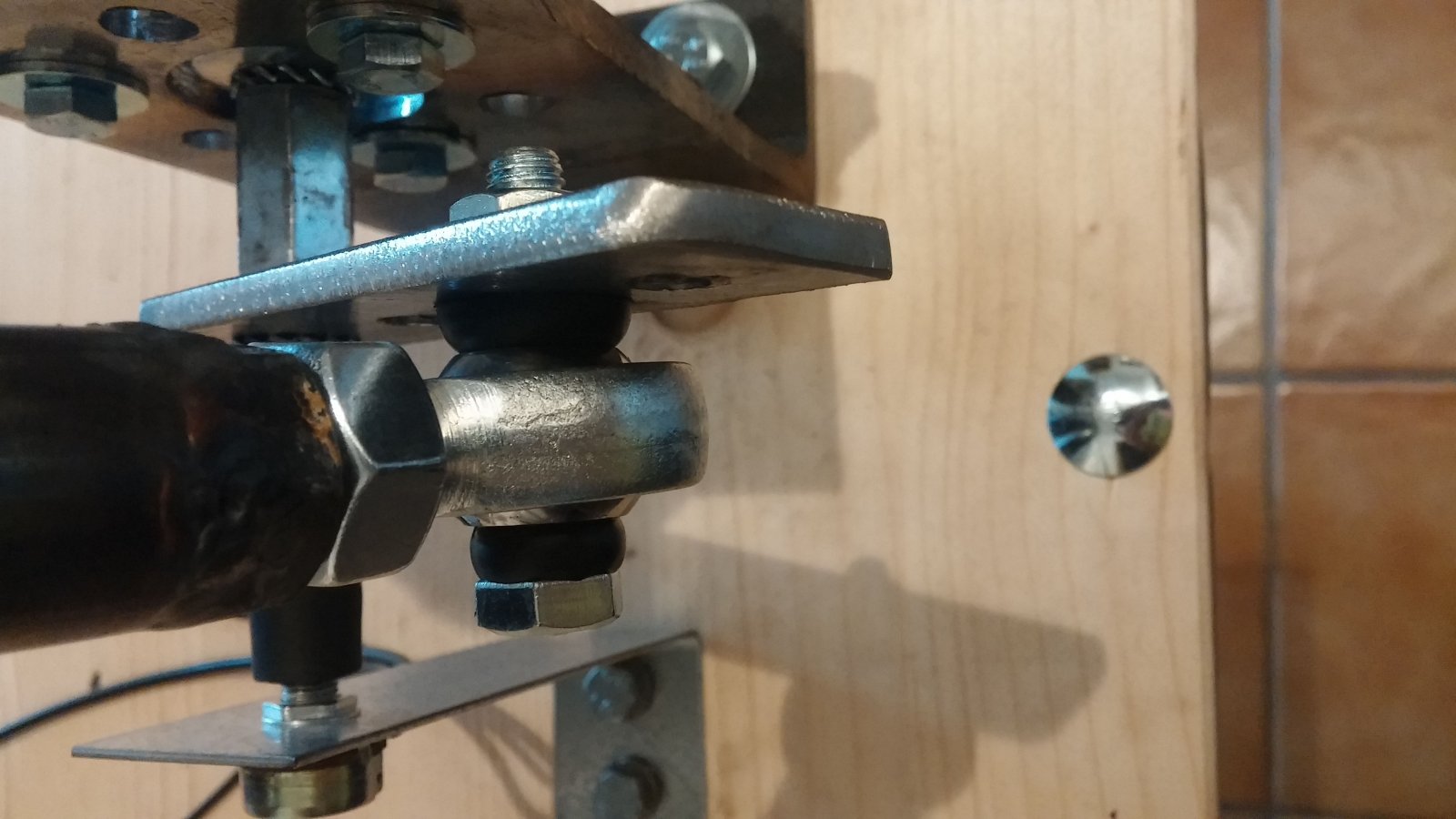

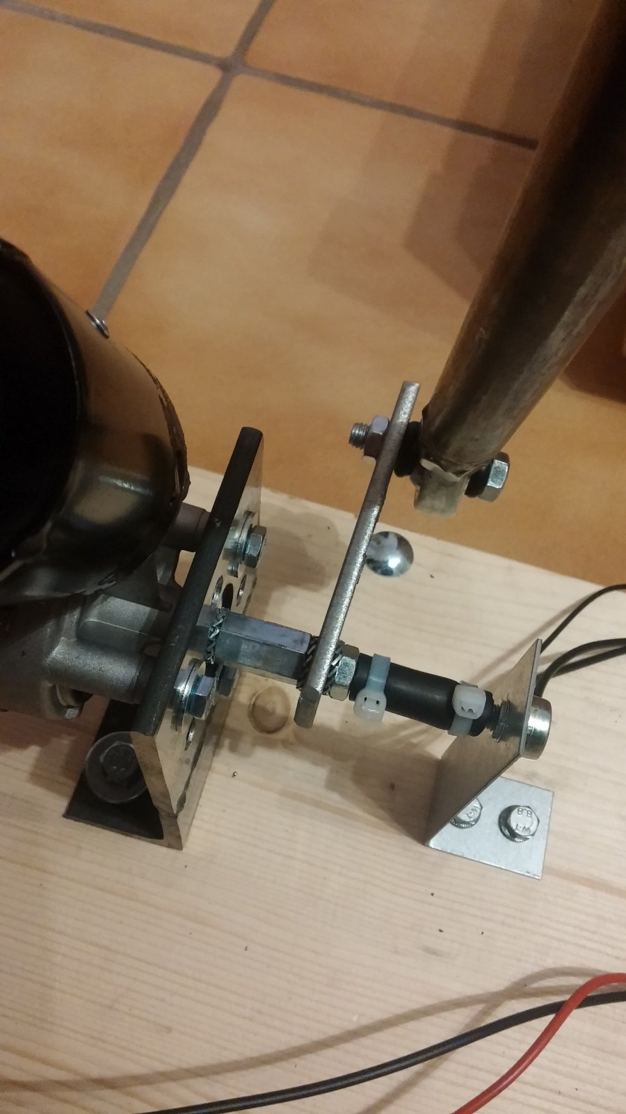

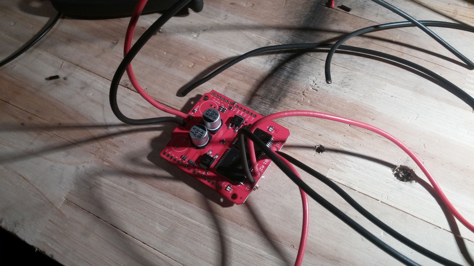

    Then let's go on with some pictures. For those who read my "new guys"-thread, here's the reason why my racing wheel was malfunctioning and how I fixed it:
    As an explanation: I was too lazy to isolate the wipermotors the way it has been mentioned somewhere in this forum and thought that it should be enough to just use a piece of rubber hose to isolate them.
    Wrong :nerd
    As you can already guess, it didn't work, not every kind of rubber is a good isolator, so I did it just like it was mentioned and this is what you see in the third picture.

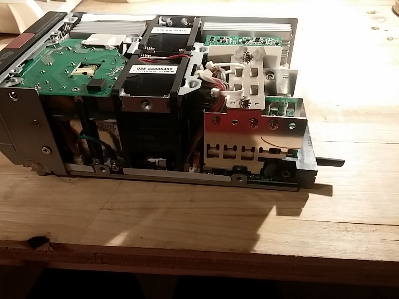

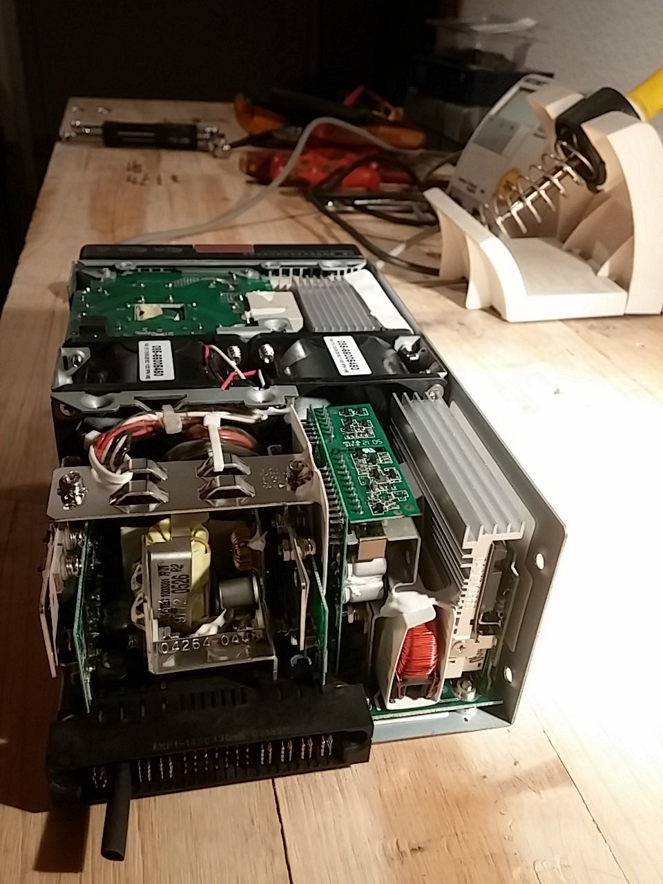

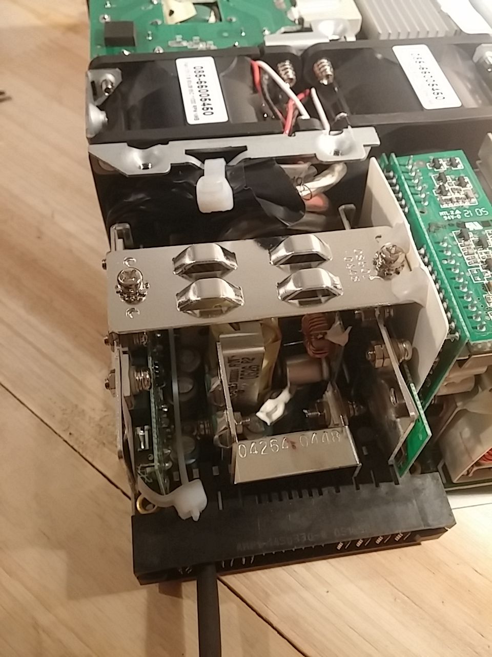

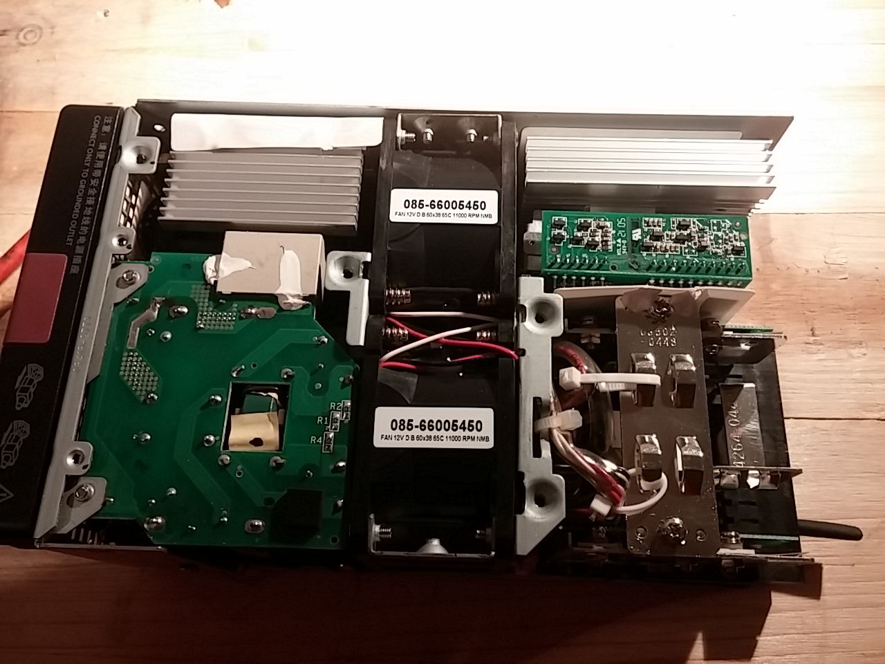

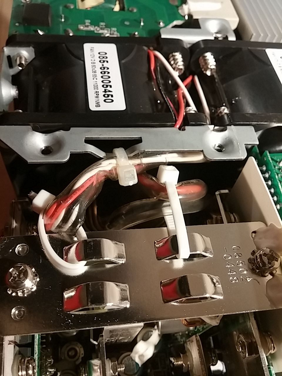

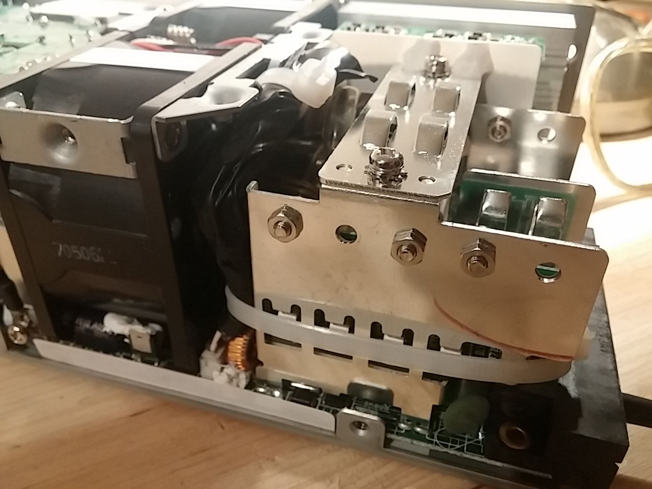

    Okay, now to a very personal part. You guys know how hard it can be to have your wife/girlfriend accept something like building this kind of stuff and I#m really happy that my girlfriend was cool with it, but after the first testruns she almost hit me in the back of my head because the psu I used was way too loud :D
    So here's how I got around it:

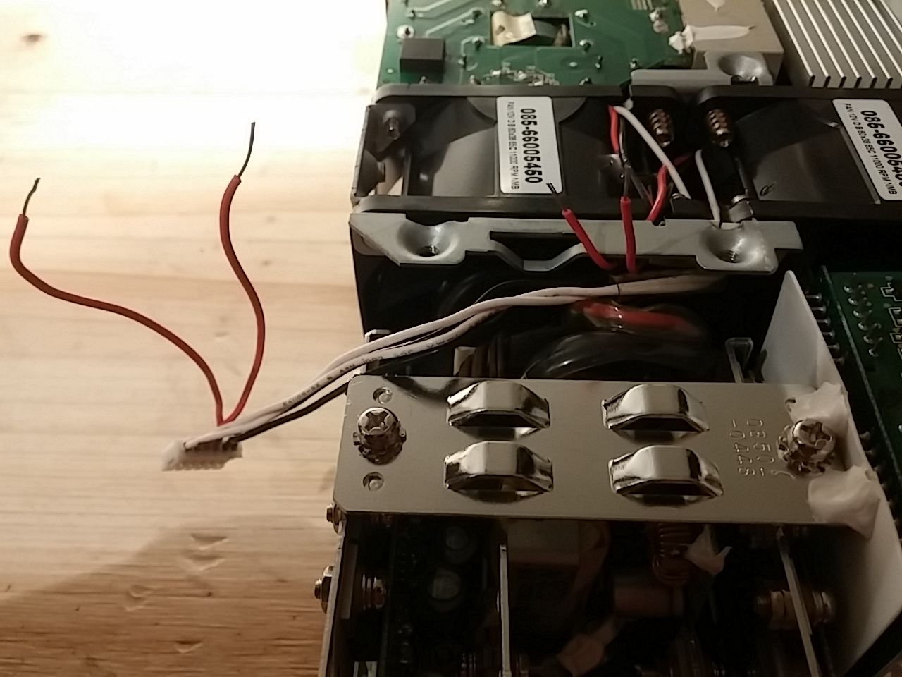

    20150331_203210.jpg 20150331_203220.jpg 20150331_203225.jpg 20150331_204231.jpg 20150331_211246.jpg 20150331_211255.jpg
    2 small resistors with 10 ohm soldered in the supply lines for the fans makes girlfriends much more happy :thumbs

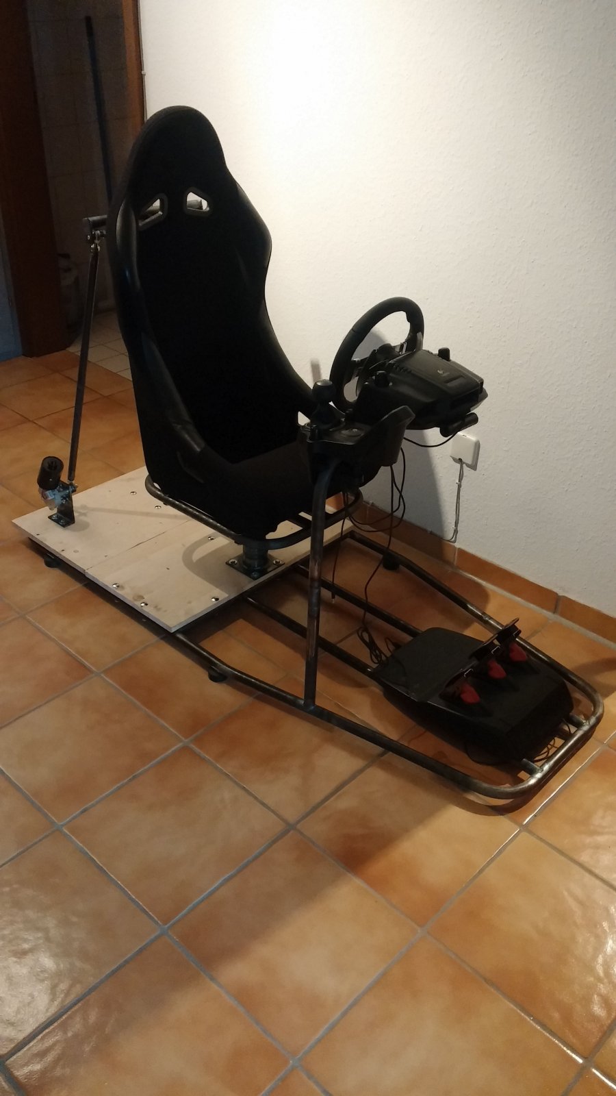

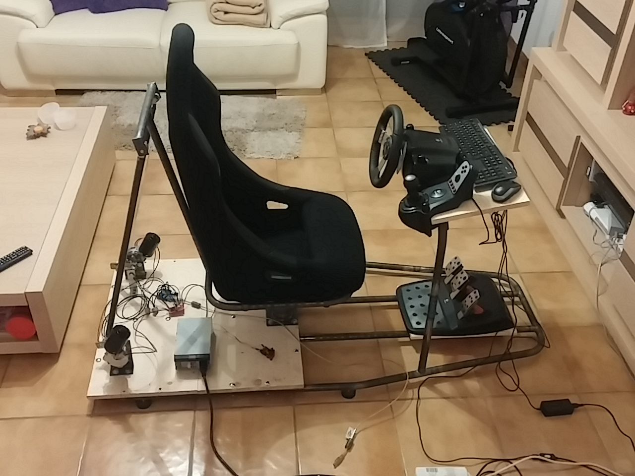

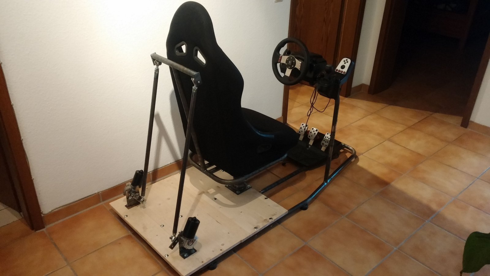

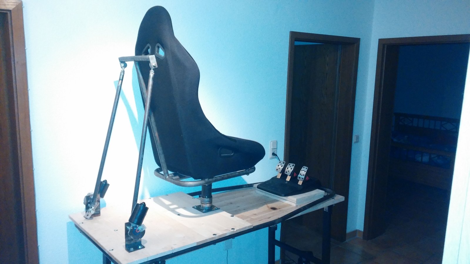

    One last picture of how it looks right now (as i said, still a work in progress):
    Okay, I guess that should be more than enough for now, took me a lot of time to write everything and I hope my translations make sense enough for you guys to understand what I'm talking about :grin
    So, feel free to share your opinions about my build :thumbs

    As you can see in the pictures, there isn't much room for other fans in the PSU, so this should do for now (the PSU throws out 1300w on 230v and on the forum where I found the needed information for the changes on the PSU to make it work for this purpose, someone tested it with 1000w on 110v and the low-rev fans without any issues)
    Maybe I pull the stock fans out and switch to a double-120mm-fan-setup (one frontside and one backside with reducers) for noise reasons, but first I need to find a box where everything fits into.

    Placement-wise I would put it somewhere between the back of the seat and the backend of the frame with something like a 7cm lever and a pushrod for movement.
    But before that happens, there's still some work and some settings to do, until sunday, as an example, I was wondering why I didn't get any feel for braking/accelerating, until I found out that there's more to set up in axis profiles than just pitch and roll :oops:
    So yeah, now it's a much greater pleasure with this added movement :)

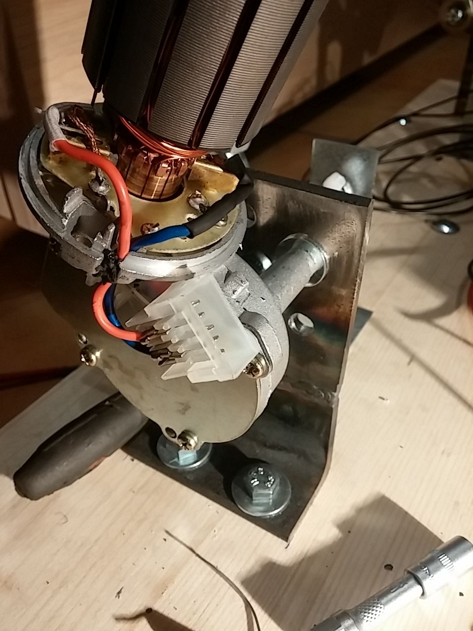

    Another thing I added was a 5-point-harness, but after a couple of testminutes, the left wiper motor "gave out", more specifically it turned while the lever wasn't moving until it fell apart... so loctite 270 wasn't enough to hold it together. Bought some cotter pins today, that should fix it... :thumbs
  14. Nick Moxley
    17,056Coins
    +2,506 / 30 / -2
    What exactly were you holding together with Loctite ?
  15. Godslayer
    Godslayer New Member
    Mar 8, 2015
    25
    483Coins
    +21 / 0 / -0
    2DOF, DC motor

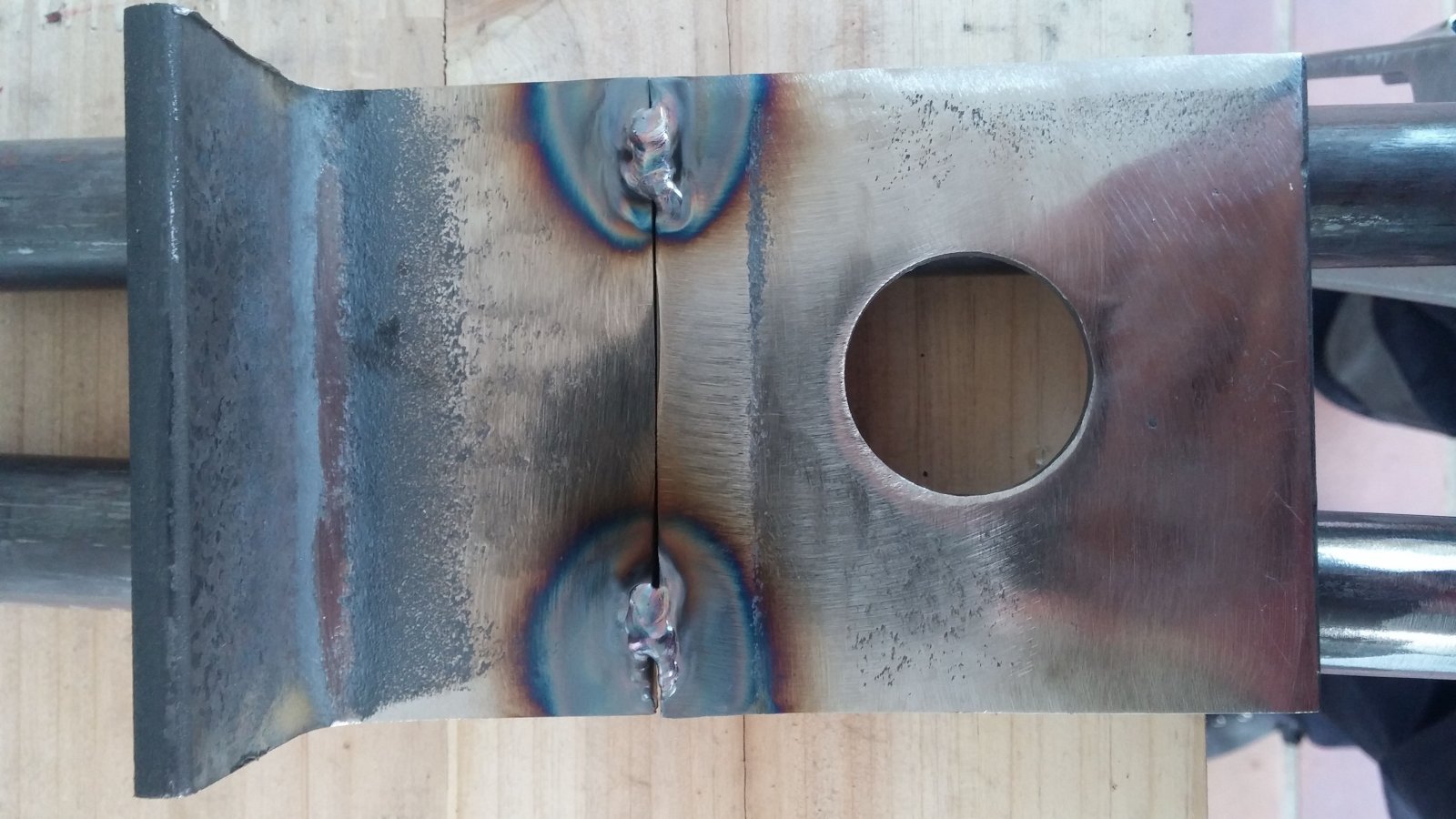

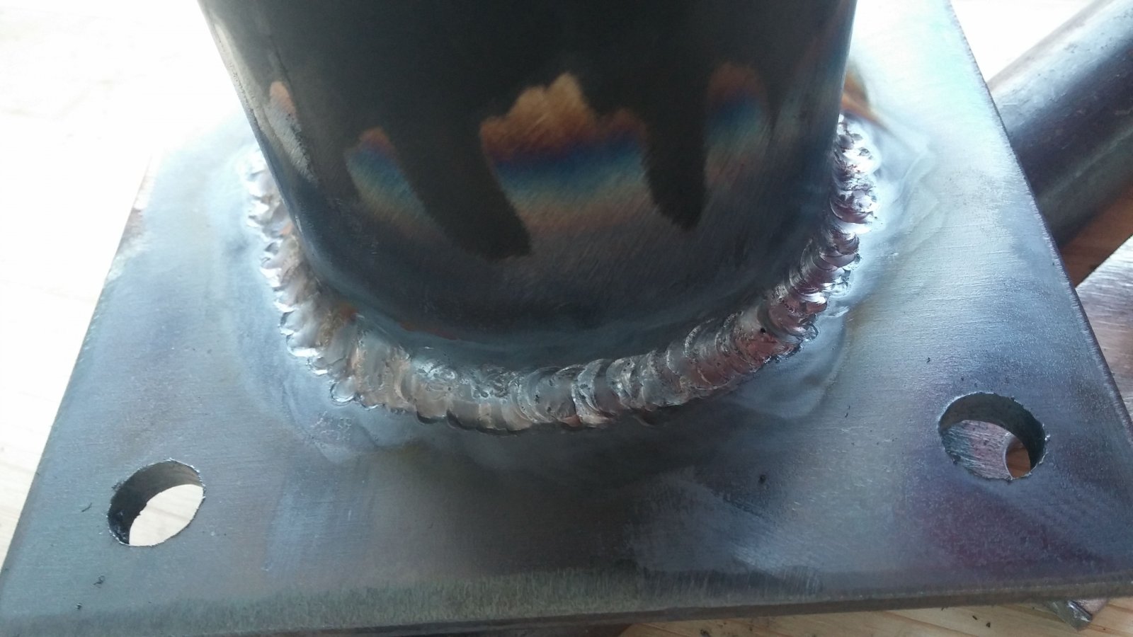

    This is what I was talking about:
    The connection between the lever and the motor got loose, so the motor was turning nonstop until the connector fell off

    Why not have it welded ? then you'll never have to worry about it.

    2DOF, DC motor
    A nice weld would be the best, but I worry about the heat in this area, especially around the gear rings/grease/sealing inside that wiper gearbox
  18. Nick Moxley
    17,056Coins
    +2,506 / 30 / -2
    Shouldn't be a problem at all actually. seals are Far more durable than you think they are.

    As a qualified welder my suggestion, if your concerned about heat transfer.
    Take some thick very wet cloth towel wrap it around gearbox and up to about 1" from the welding point. The cloth will not set alight because it's wet.
    This will dramatically reduce any chance of seals being damaged.
