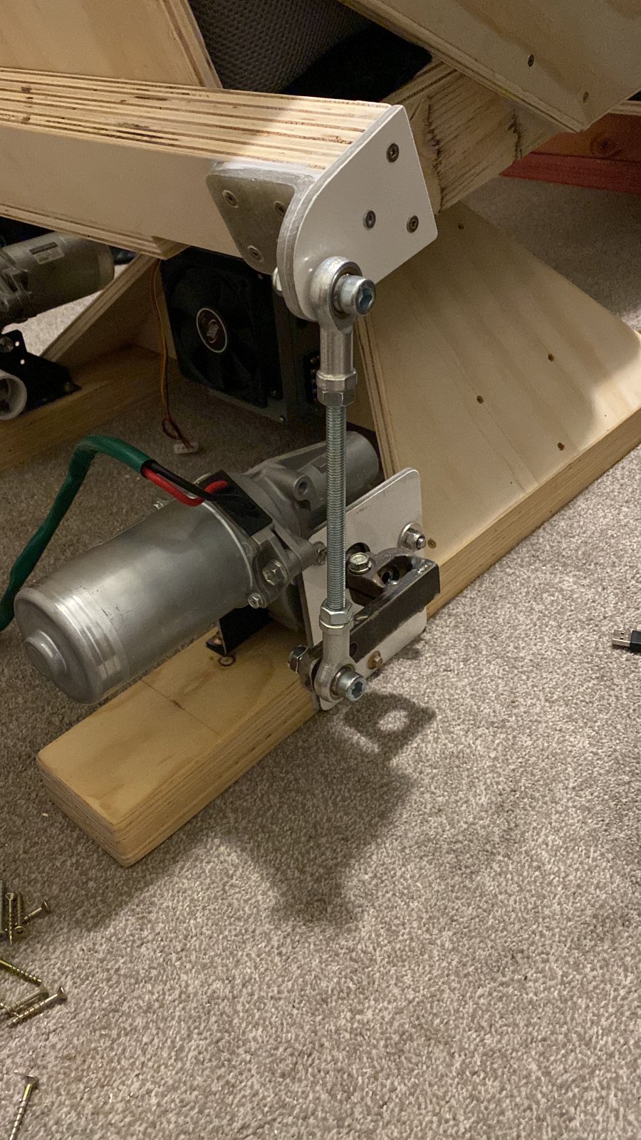

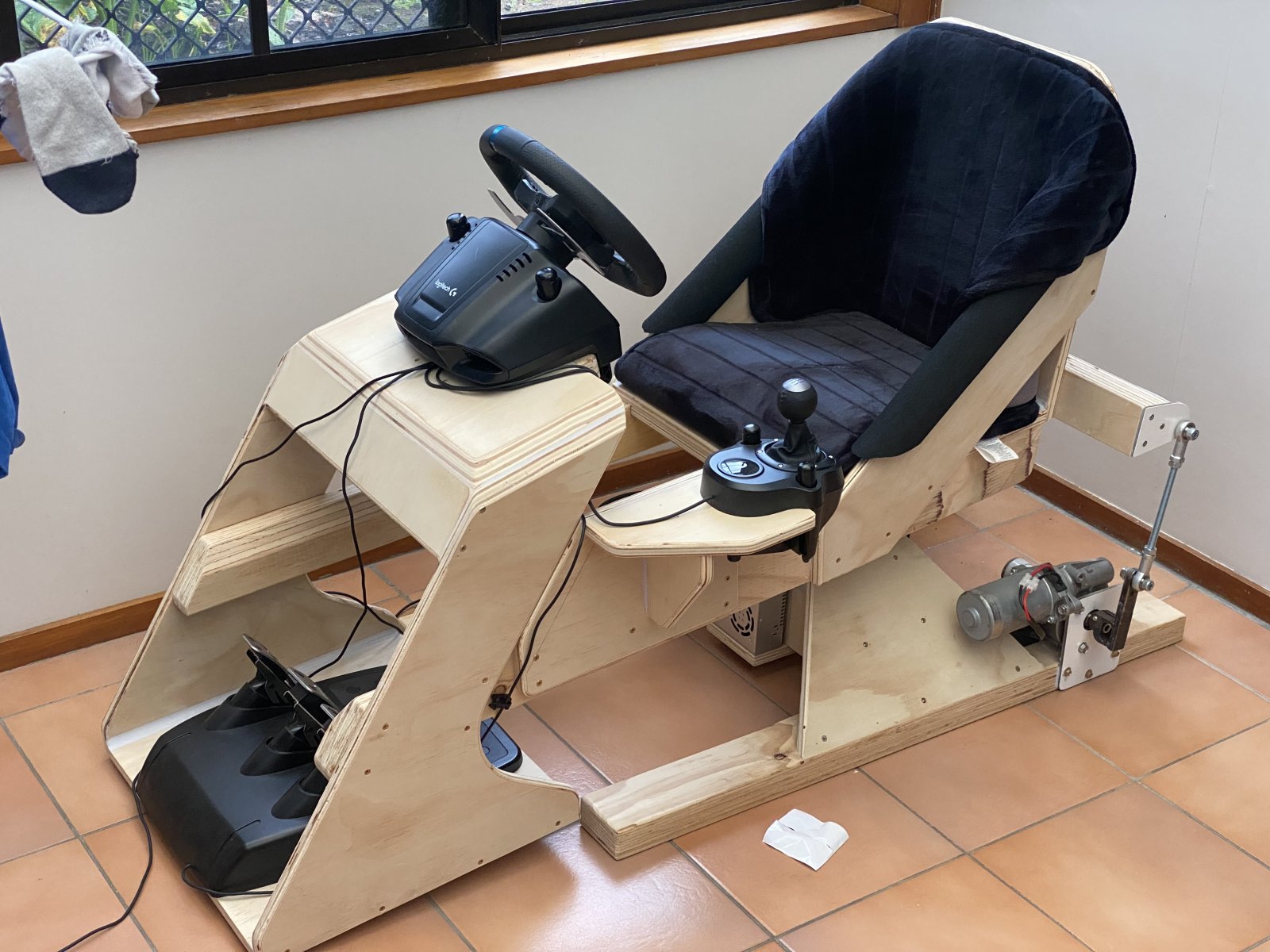

    I discovered the world of vr racing and motion simulation only 3-4 months ago after receiving a YouTube link with someone racing in vr the shutoko revival project. Wow mind blown
    I build my rig from 18mm plywood.
    Motors are Prius power steering units

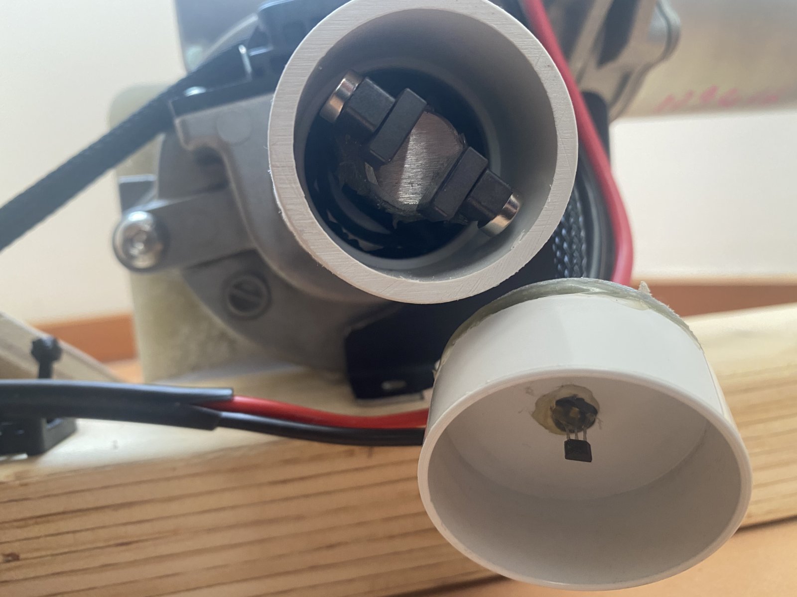

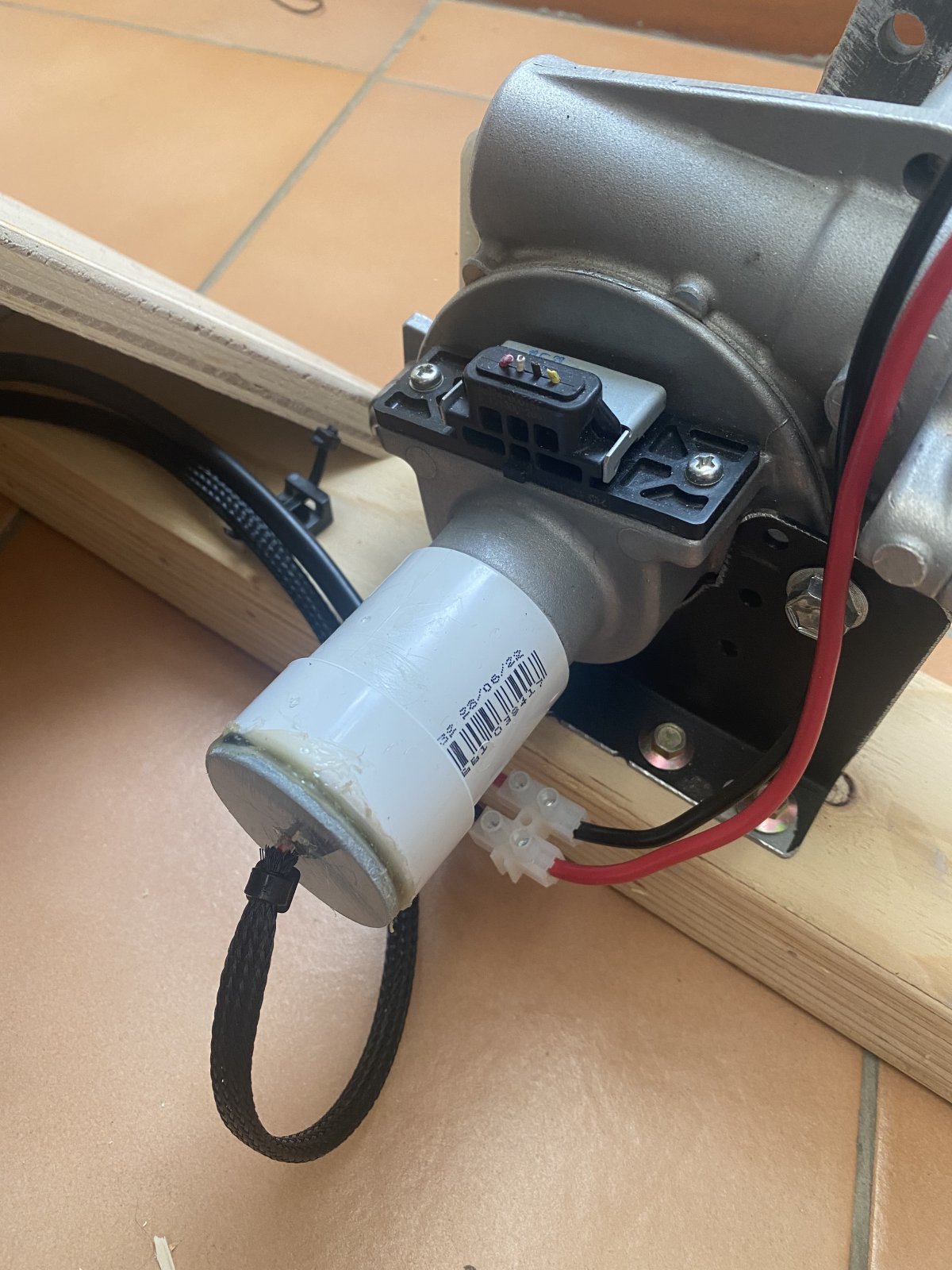

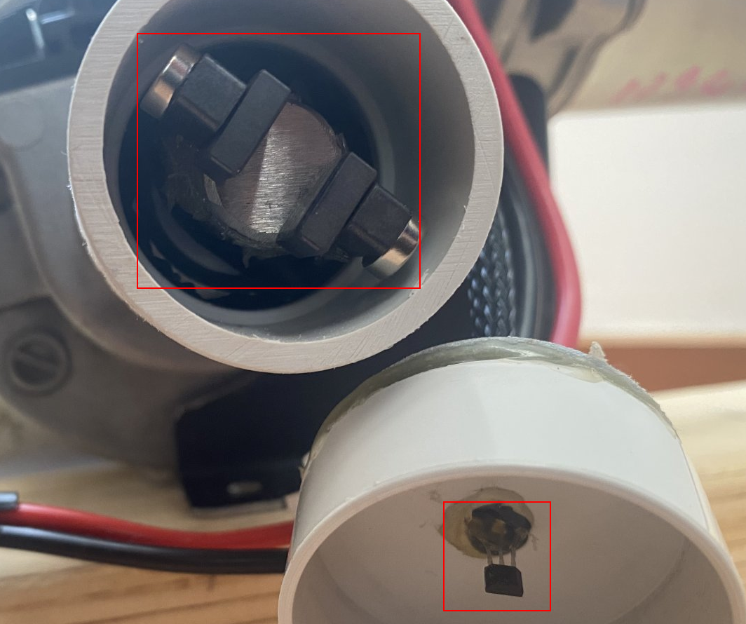

    Potentiometer are 2$ diy linear hall A49E and Neodymium magnets attached to shaft.
    I upholstered the bomber seat with 2 memory foam shower mats :grin and pool noodles
    Next mods are tmc blower fan for wind and 3rd axis via Corolla power steering unit. 7ECDD338-1472-401B-BA9C-FAC23DEC8280.jpeg FEC9369B-CB04-4823-9F52-3818F6D4EFA0.jpeg 1E905148-AF07-4269-B0A7-D5A86886A89C.jpeg

    Nice approach, how do the motors go with the mas of the rig?

    Great build Frantik,
    I love how clean it is and also that its 99% wood :)
    Have you already used it? Can you post a video showing the range of movement you are able to have?
    Will you build any sort of monitor stand or is it built for VR?

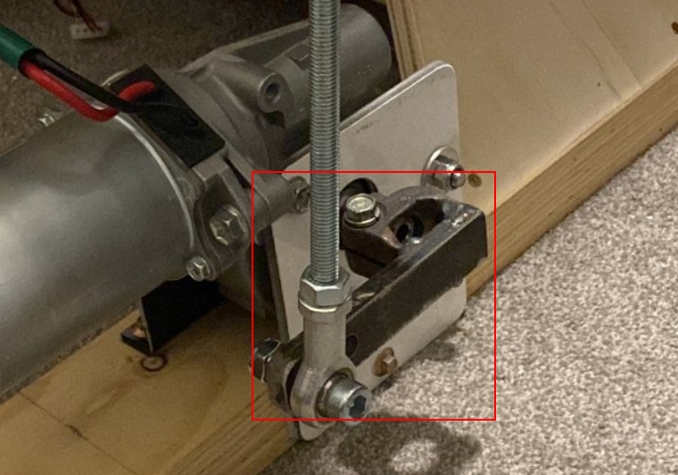

    Did you repurpose a piece of metal from something? Or you did you soldered this piece a metal from scratch?

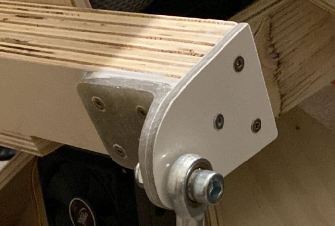

    What material are you using here (everything seems to be so perfectly align and centered, really professional):
    Again, great build (love the seat detail, really nice).

    They're powerful, violent in crashes.
    Although I’ve quickly discovered less is more in terms of motion, Im positive they could drive a much larger lever arm or much more mass. Toyota recommends 60amp fuse so i guess that puts them at 720watts peak each?
    Worth mentioning is my diy pots aren’t perfect. They’re peaking out 1-4v and only paired accuracy with about 90deg sweep. So I’ve clipped them at that. Once I get a solution for 180deg I’ll need to further reduce settings.
    Currently I have simtools at 12% pitch and roll and 25% surge and yaw in ac.
    In CM shutoko revival it’s to violent and had to reduce 8% and 15% respectively
    It works awesome so far in asserto corsa but I suspect utilizing full stroke will be advantageous in flightsim. I haven’t yet tried flightsim though. A5931B0A-4474-4C40-B735-AABADC140533.jpeg 1AE24430-84DE-44C5-9571-2F379D65C84F.jpeg

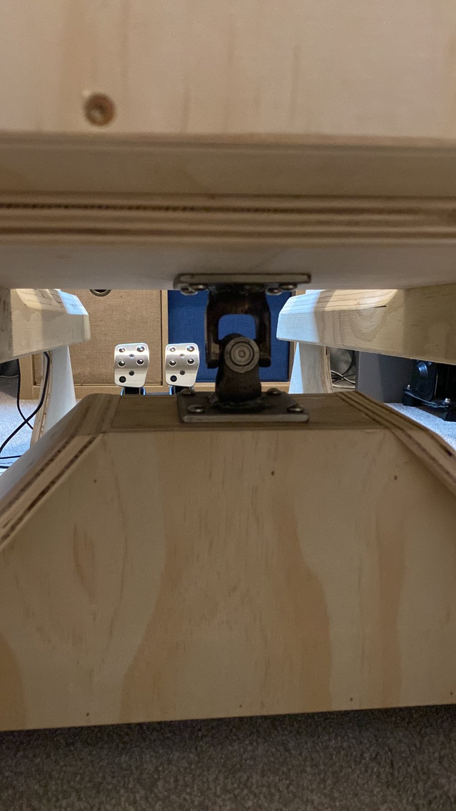

    Yes they’re repurposed UV joints, Depending on how the wrecker removed from car you’ll get 1-2 uv joints with motor assembly.

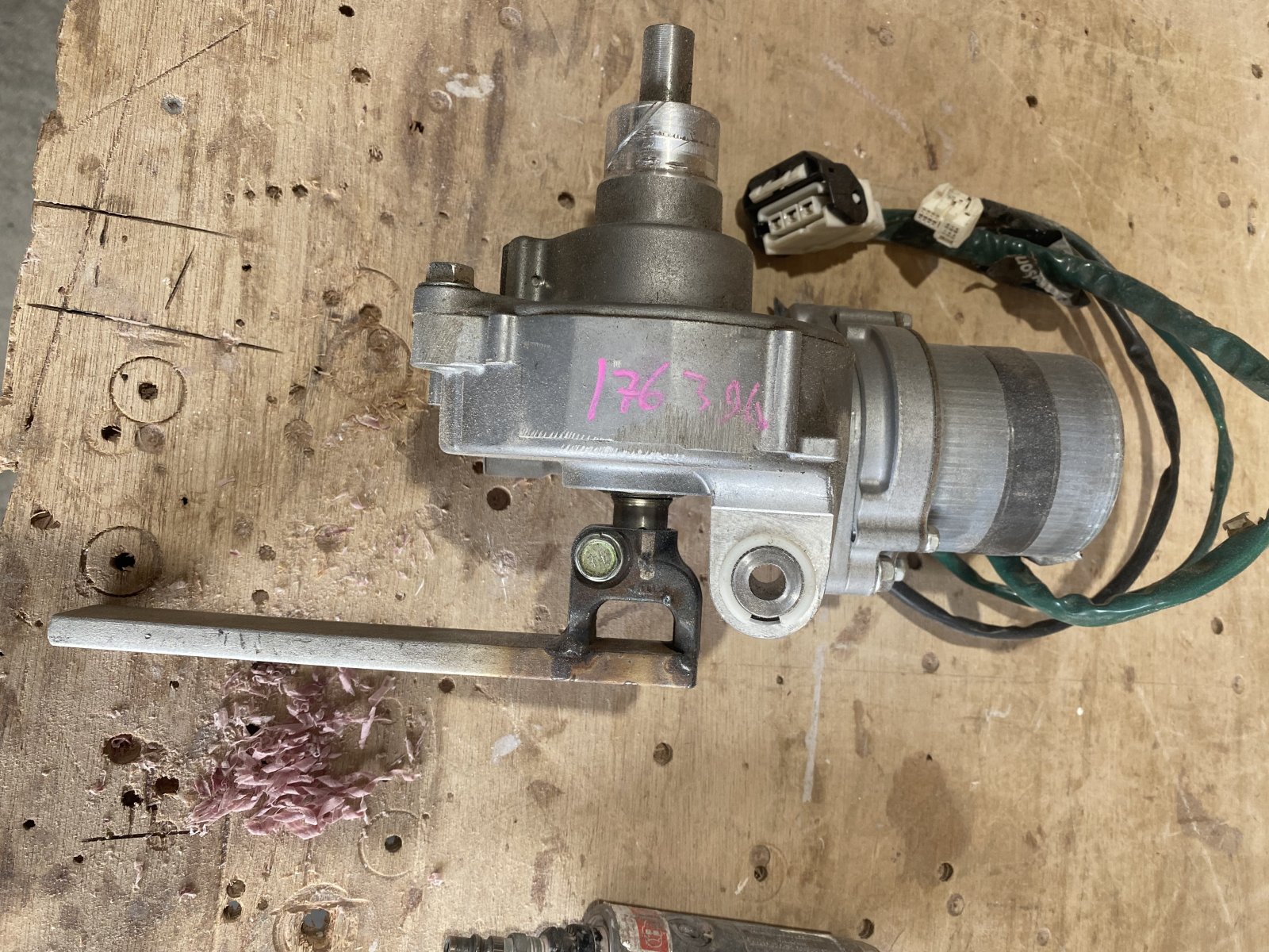

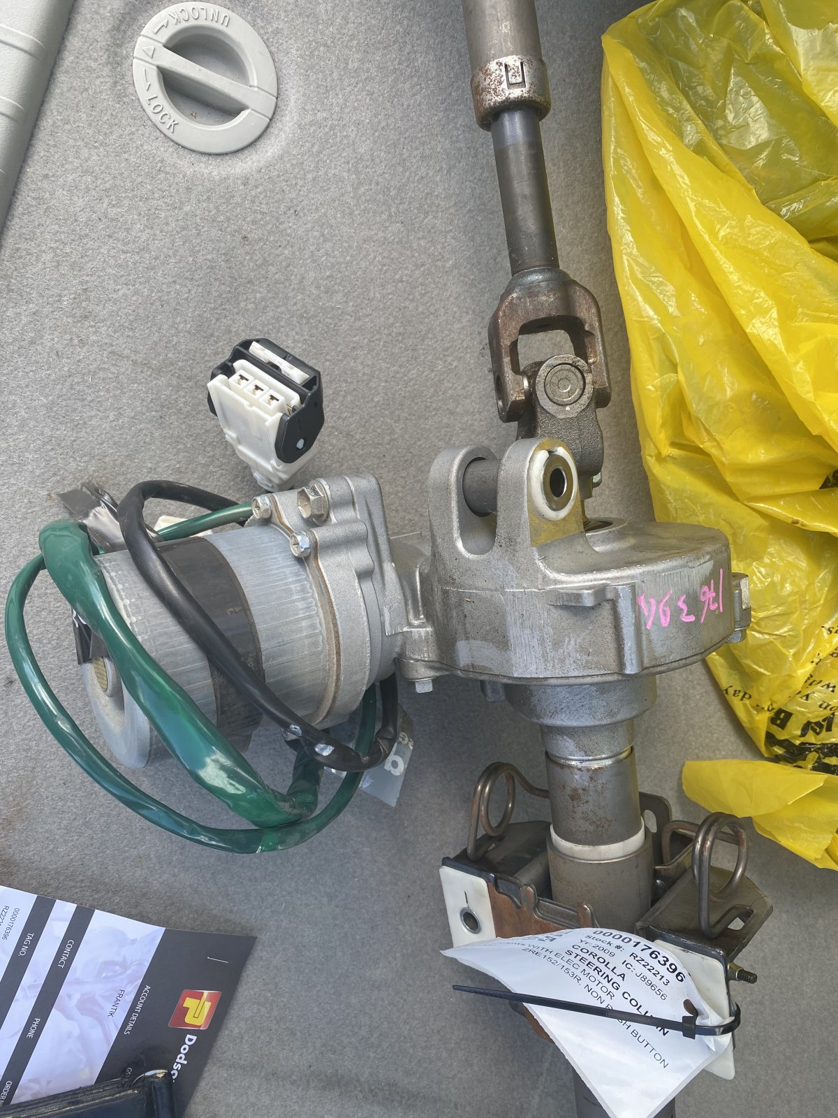

    Here’s the un modified Corolla example that I’m going to use for 3rd axis
    And after mod
    The modified uv are perfect for lever because they’re spline fit on motor shaft. The other uv joint was used as seat pivot with flanges welded on.
    The flange material is fibreglass. I’m a boat builder by trade. We had off cuts around. Otherwise I would have used aluminium flange I guess.

    Here you have a set of magnets to read the position of the motor axis with a hall sensor. Can I ask you why you didn't use a more traditional potentiometer? You saw a lot of advantages of using the hall sensor?

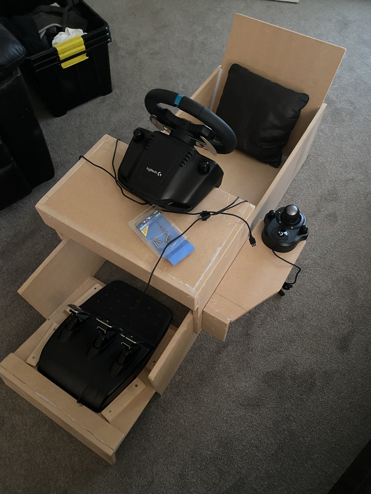

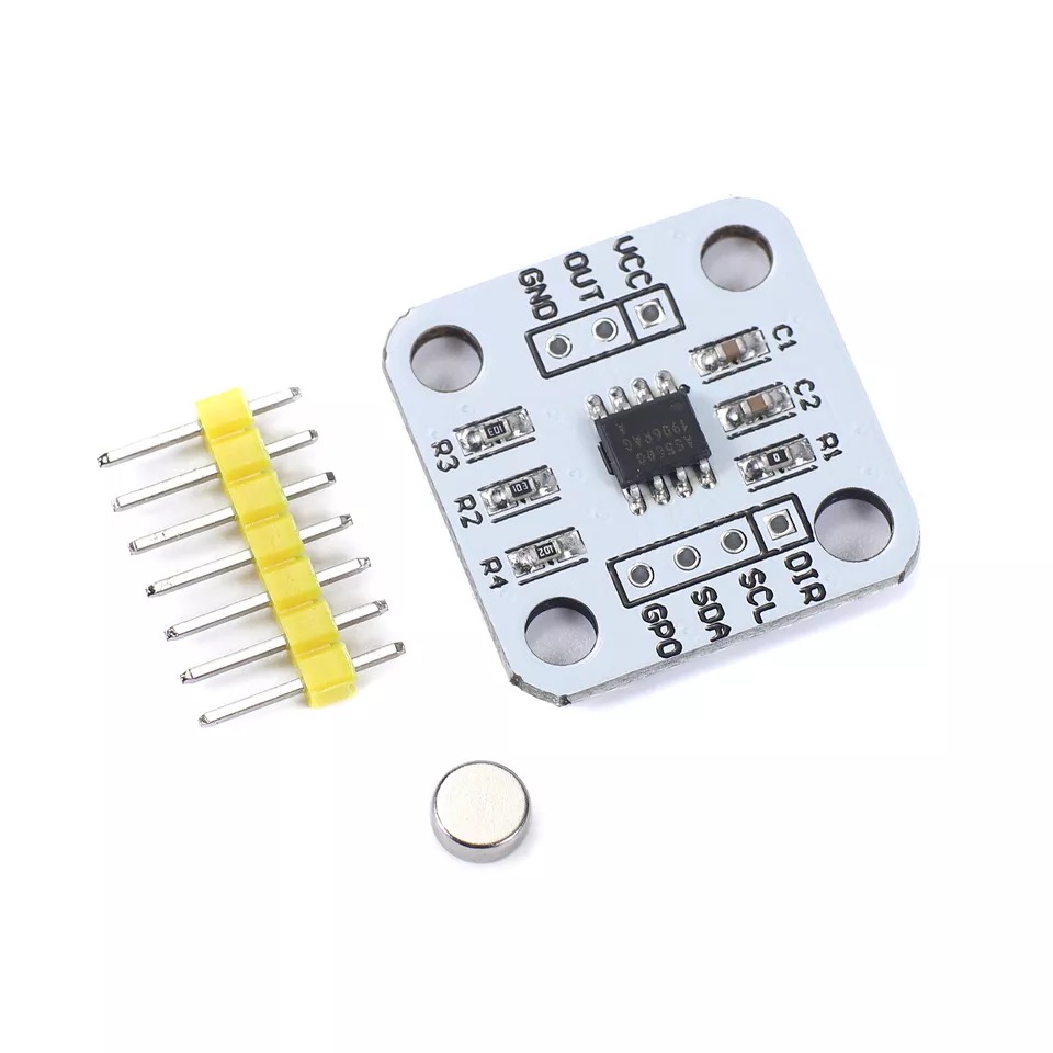

    Most of the parts I chose were based on cost and local availability. The motors were available from local wrecker and @ 1/3 grab pot motor price. And the diy hall pots were 1/50 the price of traditional 180deg hall pots. There’s no advantage on the diy hall pots apart from the price. I think the poles have magnetic interference directly contact with shaft. I should have attached them to plastic posts glued to shaft perhaps? But they still work ok with smaller angular range. In my defence there weren’t any traditional hall pots available in my country when I needed them. I did ordered some from aliexpress but delivery took so long they only arrived yesterday. I’ve since also discovered and ordered another sensor called AS5600 chip. This looks better. AS5600 Is degree programable contactless rotary encoder that can output analog 0-5v
    At 2$ each I ordered a dozen and excited to try them.
    Yes the rig I designed was based of a static one I built first out of mdf . The first one was rough and ready with the intention to adjust dimensions until it felt right.
    I then built the current one based of first dimensions with minimalist approach on material so I could accomplish with just one sheet of ply.
    I guess it looks like it’s tilted up because the angle of the two longitudinal bearers. But that’s flat in it’s original design position. Steering wheel platform is level for example at the position. And it feels very comfortable at the resting angle.

    AS5600 seems great, 30 years ago, I did my 1st wheel and pedals because I could not afford to buy them, and I would have to use normal potentiometer for the wheel and after some weeks of usage they would die out and I would have to buy some again or keep some in storage, your way is a much cleaner way to do the same.
    I looked up examples of usage for the AS5600 and it seems that the easiest way for your build would be to use diametrically magnetized magnet.
    Instead of the standard magnets (the poles are at the top and bottom)
    You will have this (poles are right and left):
    Thanks for teaching new things.

    The AS5600 I bought on aliexpress come complete with the diametrically neyodium magnets. I could just attach them to the centers/ends of the shaft and space the chip 2mm away.
