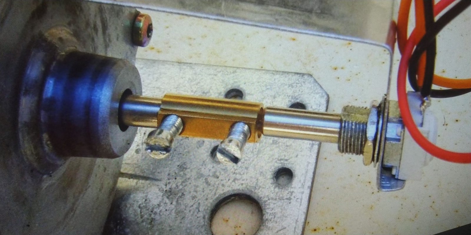

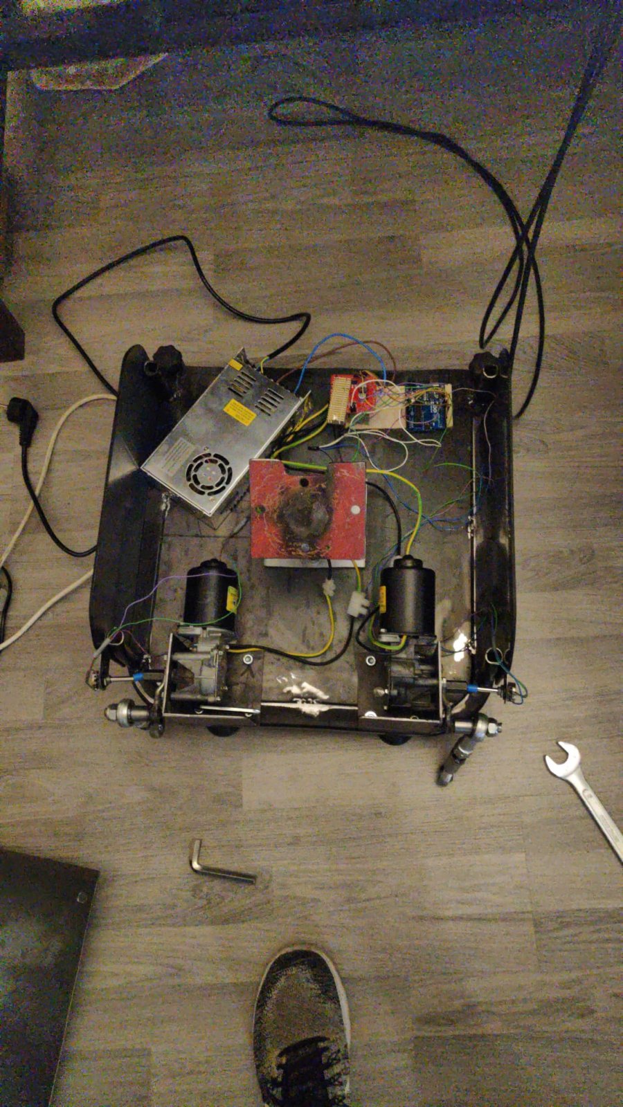

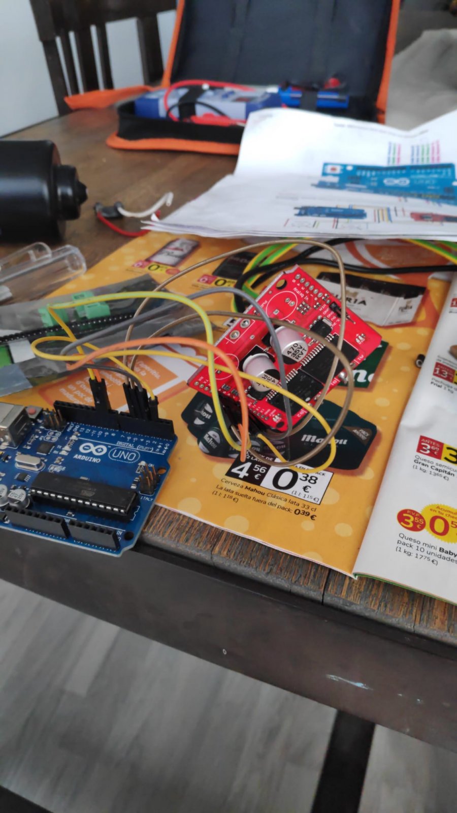

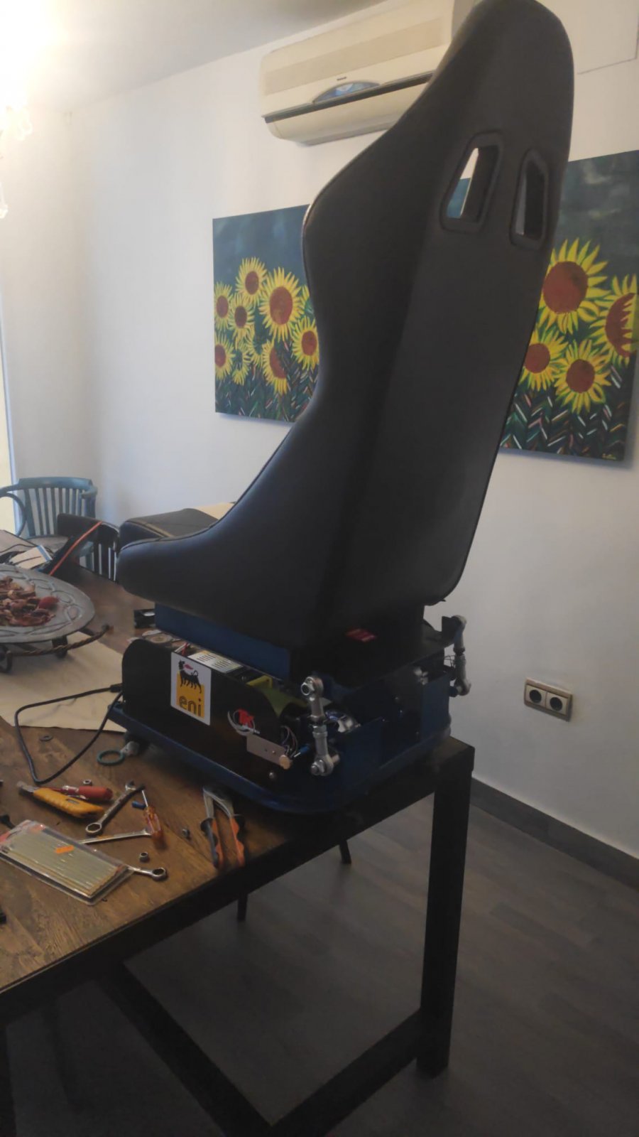

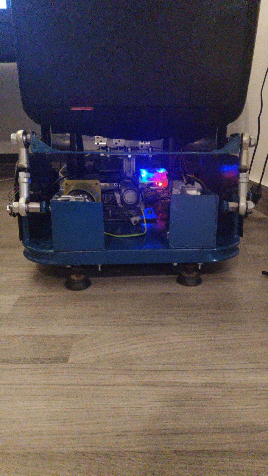

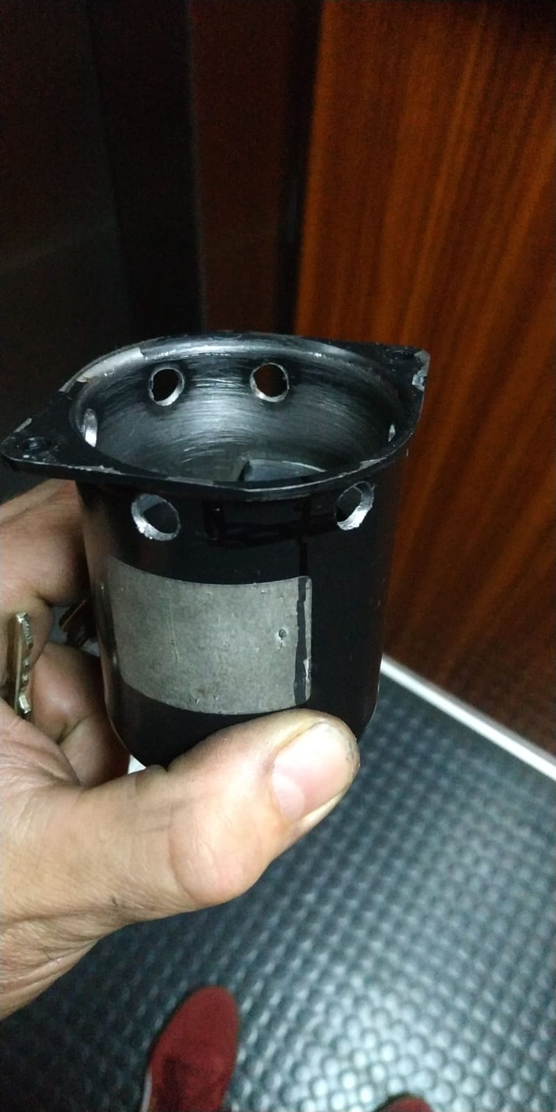

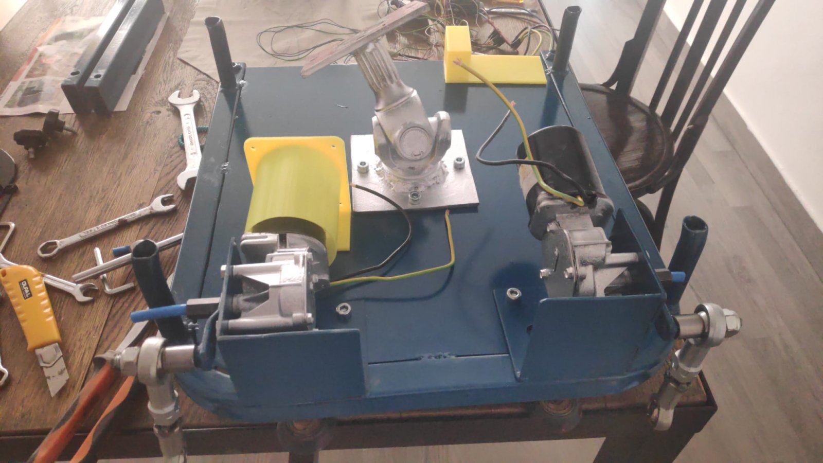

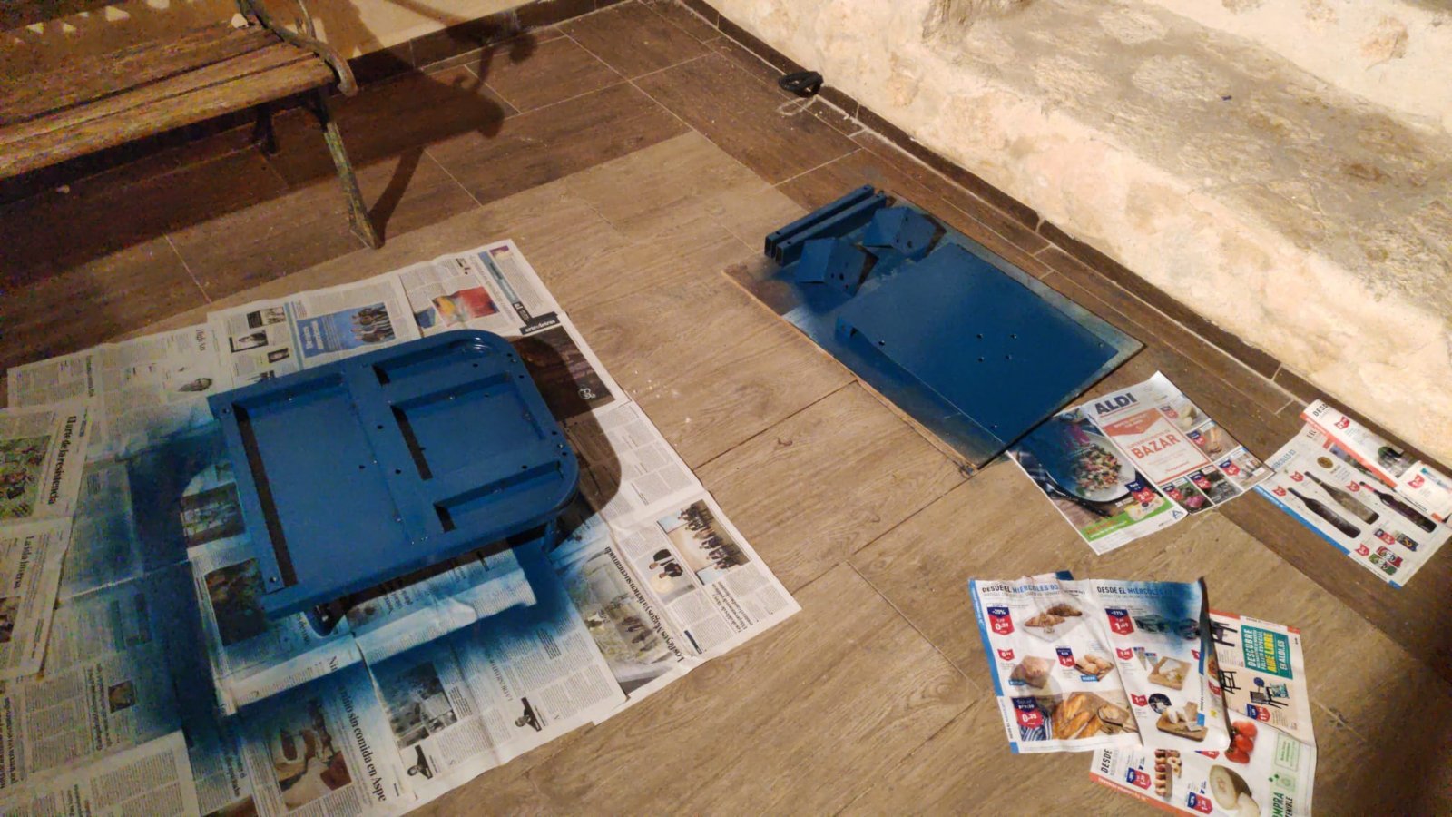

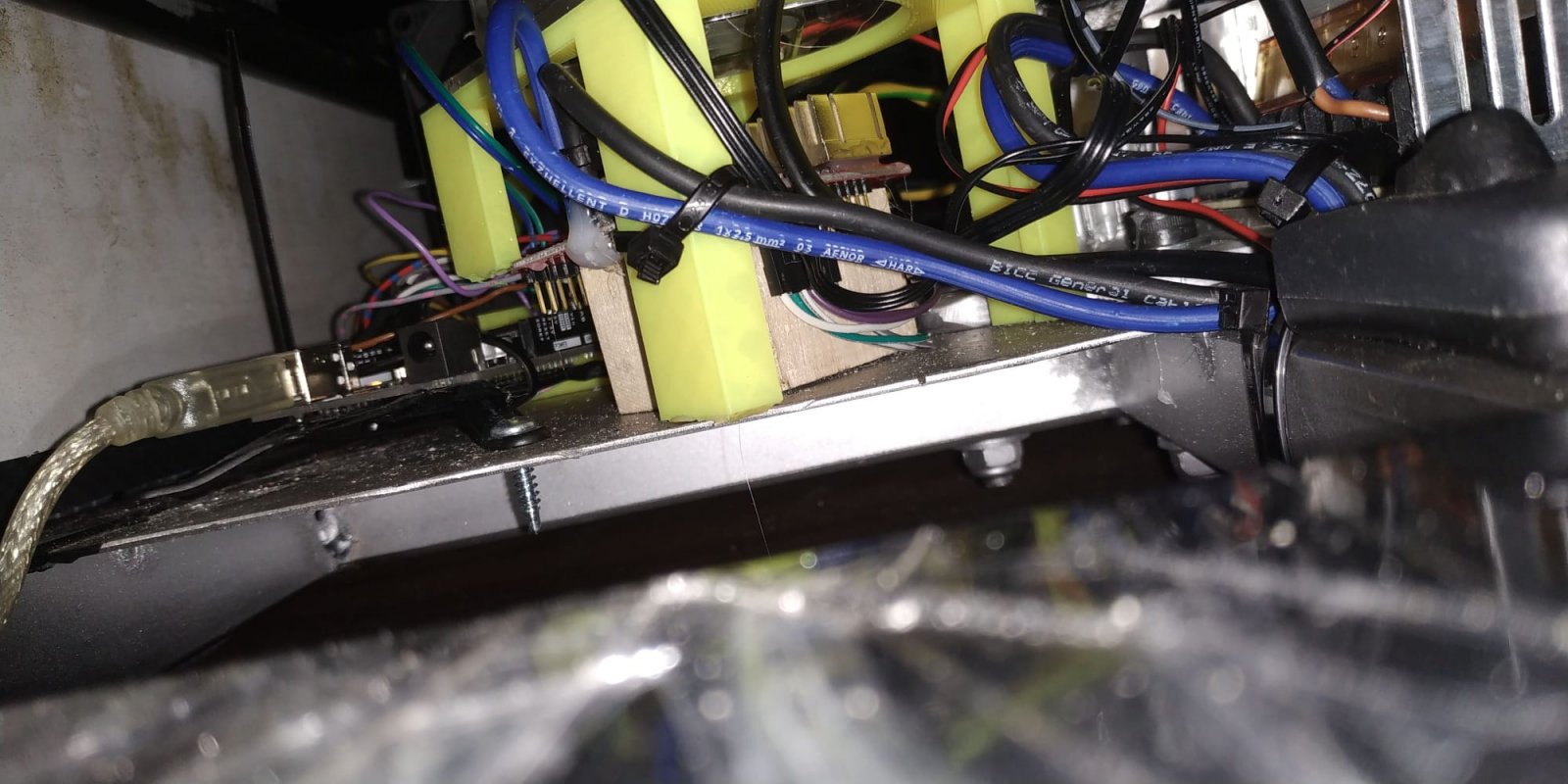

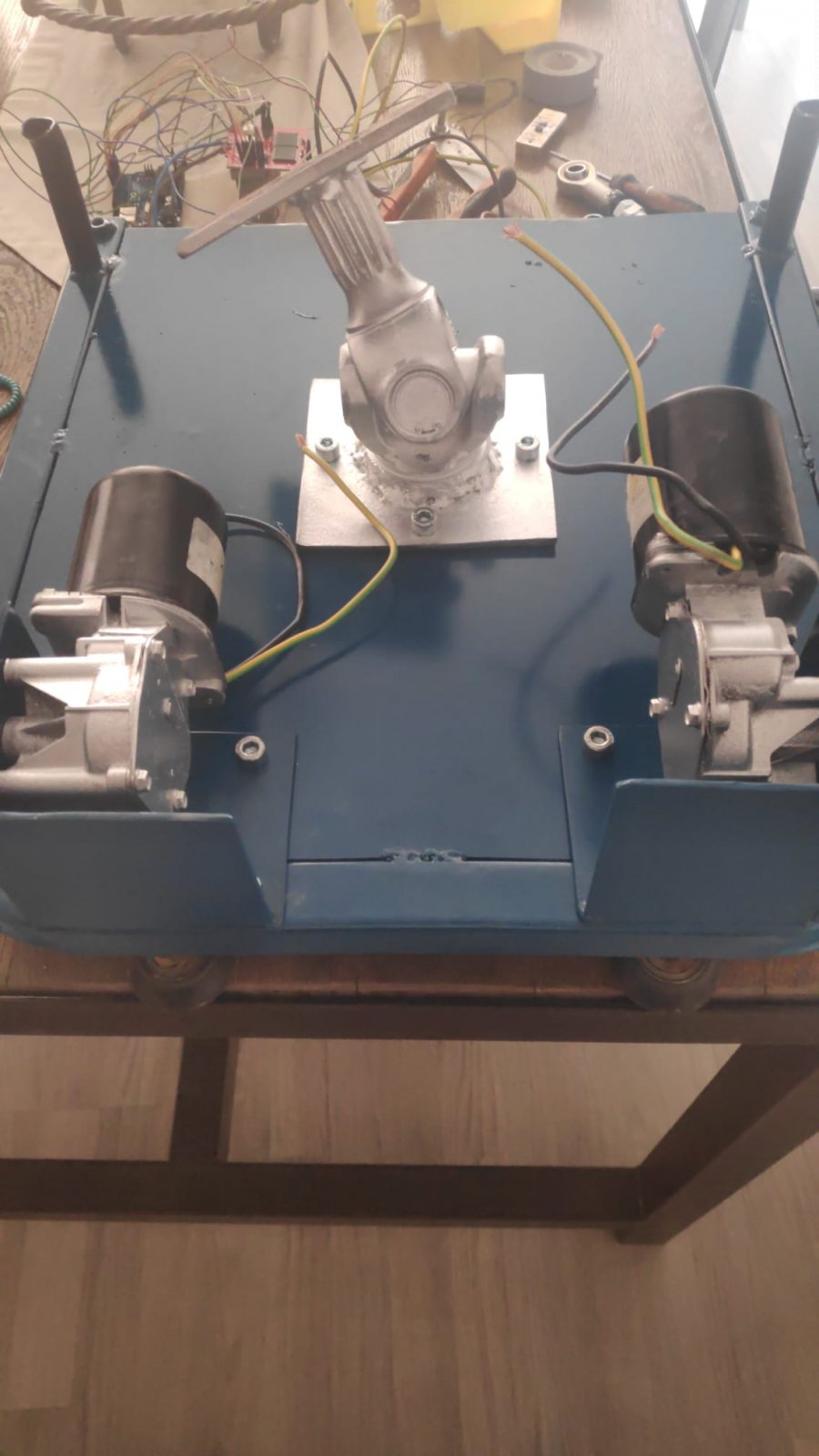

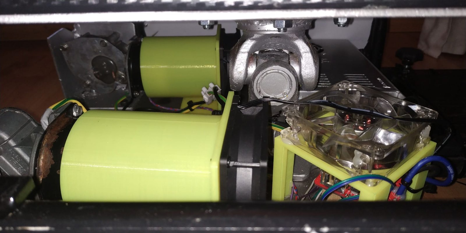

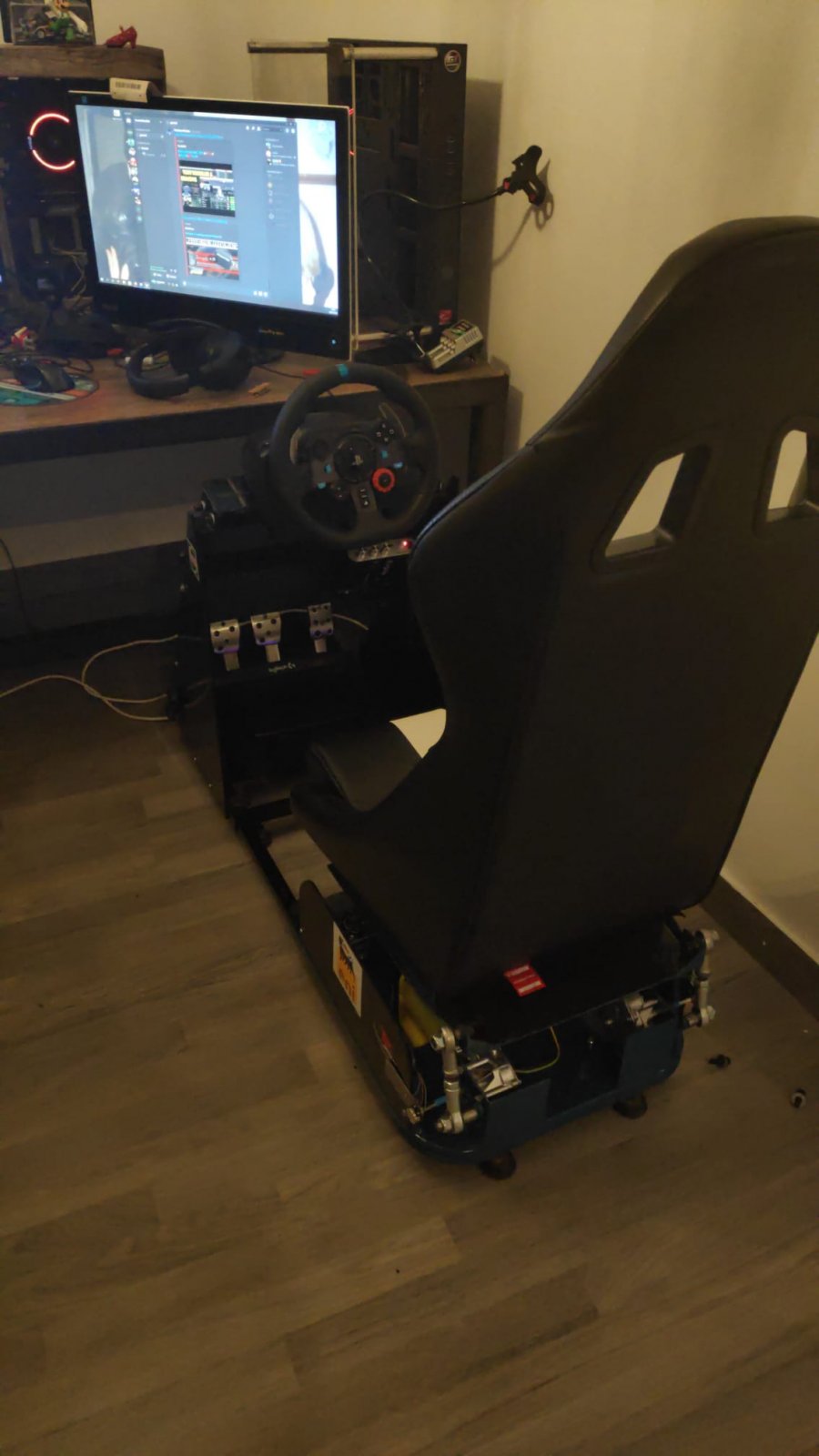

    Me gustaría enviarle algunas fotos de mi 2dof y si con eso alguien capta una gran idea

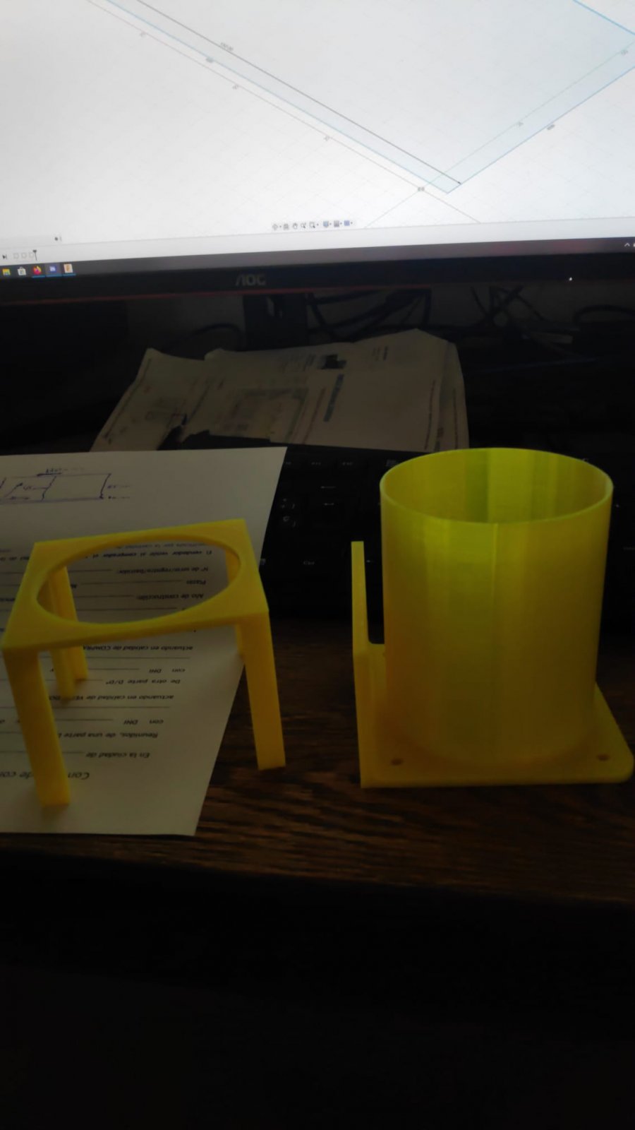

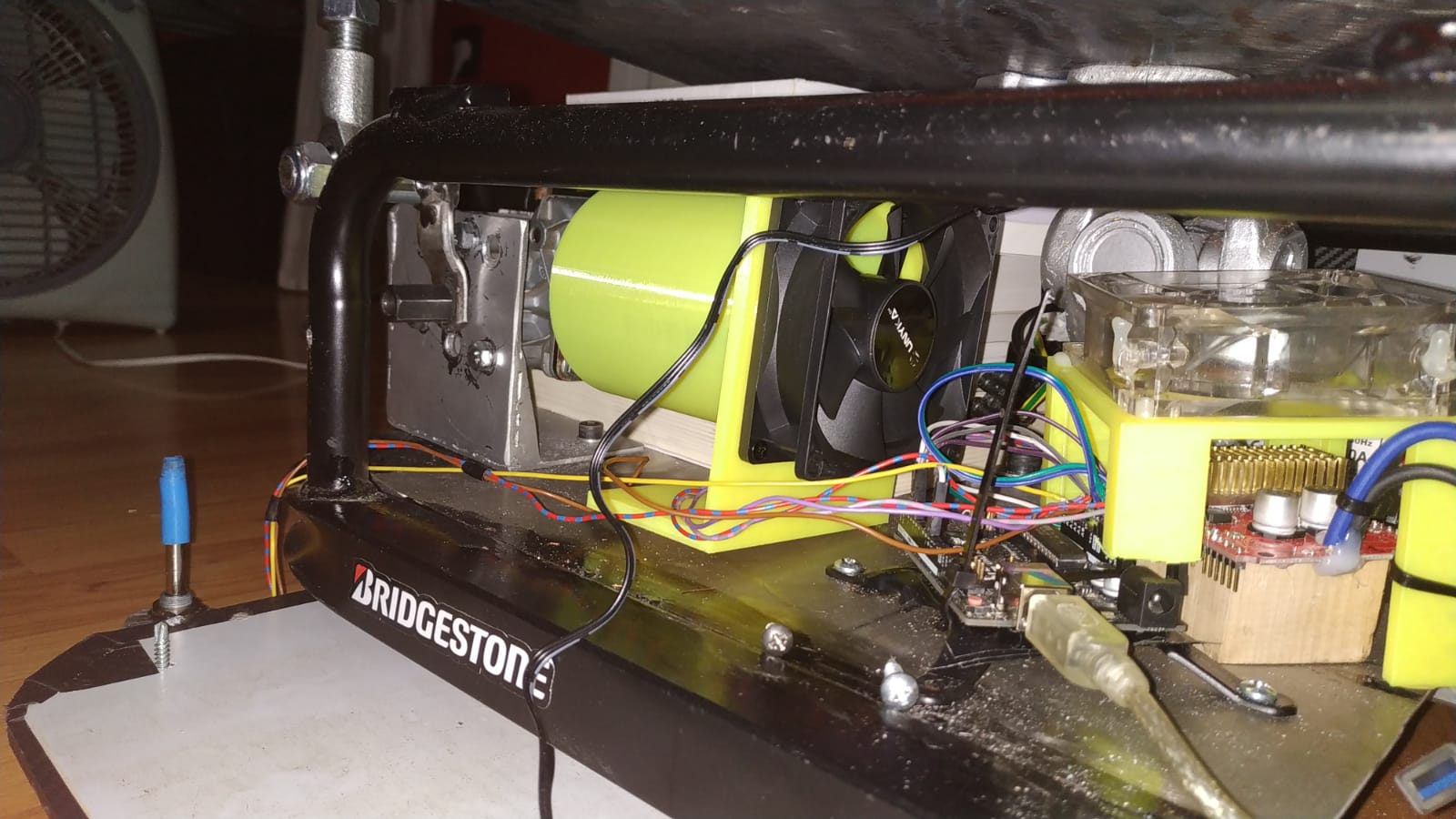

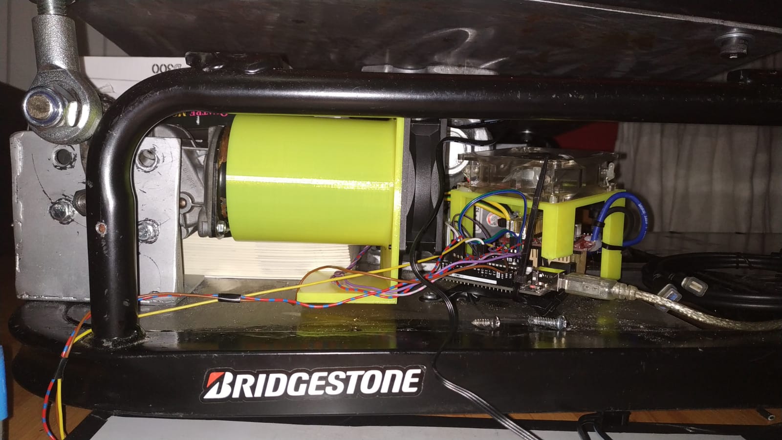

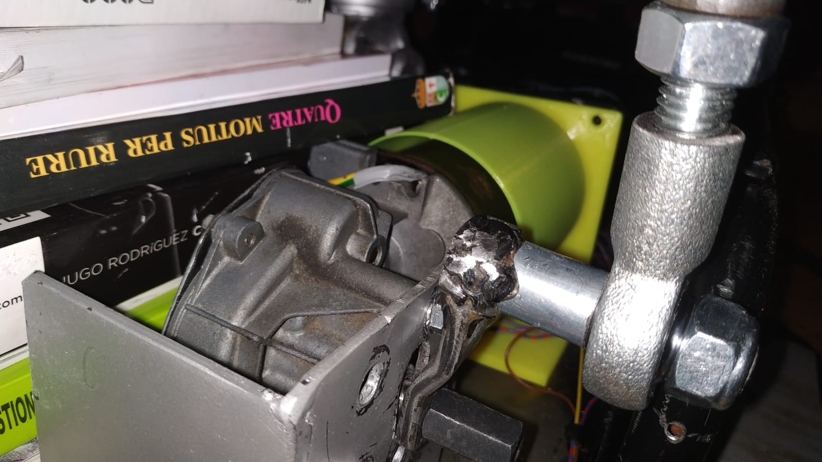

    The printed cooling shrouds for the motors are neat, are you willing to share the files for those?

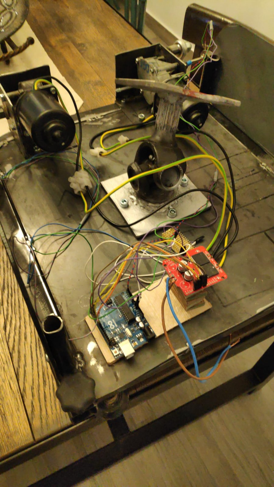

    Just a suggestion but if you flip the uni-joint over, so the pivot is closest to the seat, it will reduce the strain on the motors: https://www.xsimulator.net/community/faq/universal-joint-placement.108/
    When you get the time it would be great to see a video of your rig in action.
