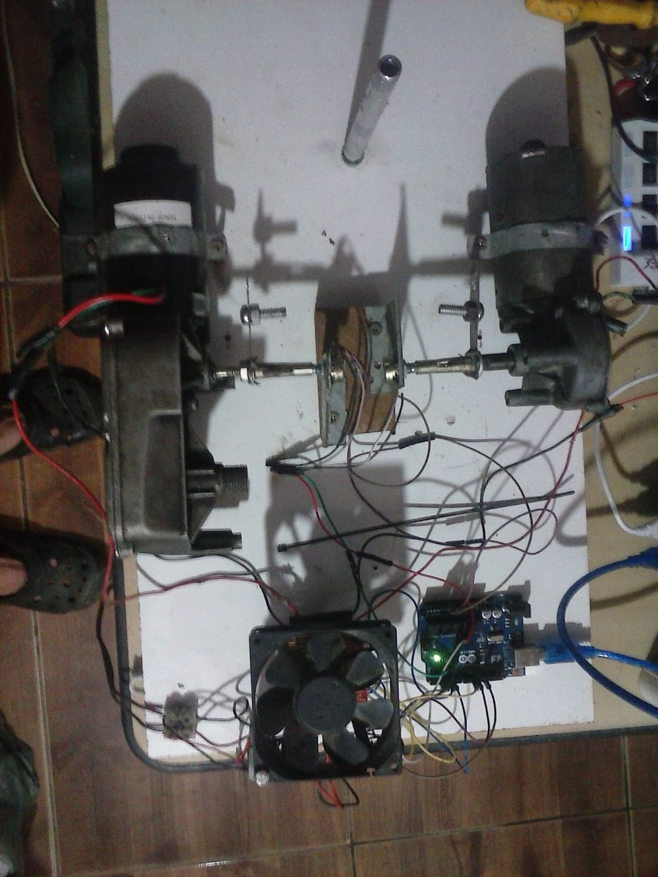

    hello im new i'm doing a cockpit 2 dof for FSX

    Good afternoon to all the members.
    I'm new here and my name is Fernando I'm 43 years old from Brazil I'm excited about flight simulation, I'm doing the cabin move 2 dof I came across this site that I found in google, I have facility in welding, electrical part and basic knowledge hardware, I started now and I already have enough information to continue my project
    I am improving how to show my prototype to members soon I will post photos according to the thanks of progress for the support of all members

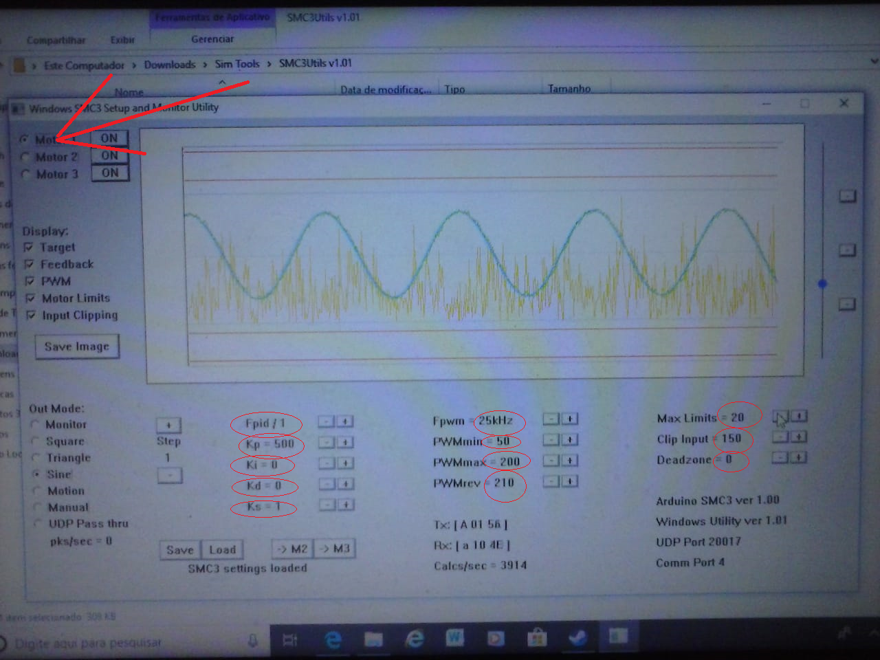

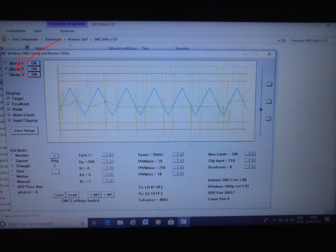

    I'm having trouble in the dead zone of the engine pot 2
    21,494
    150,584Coins
    +11,017 / 55 / -2
    Can you please provide more information, what hardware are you using, what code is being used and can you please post pictures of all of your settings.

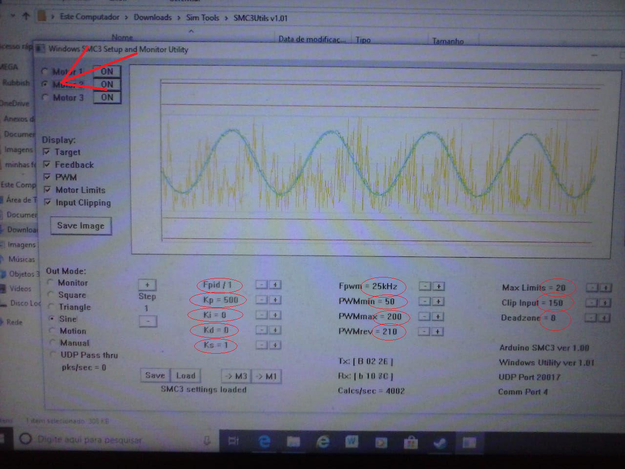

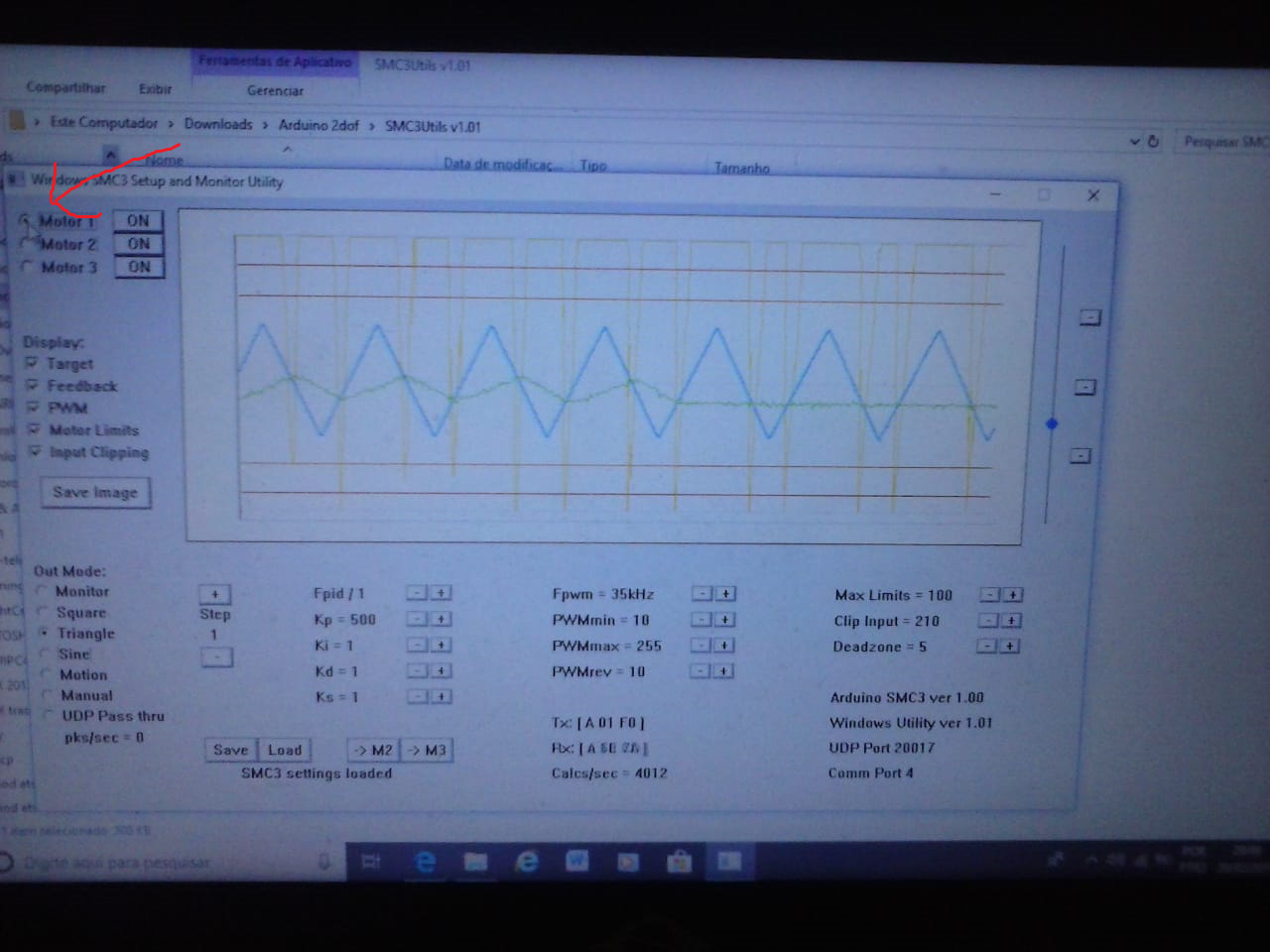

    hello noorbeast the engine settings
    motor 1 with movement
    engine 2 stopped
    I copied from a member
    I tried setting it up alone but it did not work the 2 engine only managed to configure the 1 engine

    If you are only moving one motor wy the other motor is moving?
    Your feedback is not close to your target, what type of motor are you using? How many NM or RPM?

    Hello Pedro Andrés Pineda, thank you
    I solved the problem, I disassembled everything and refitted again
    the problem was in the wiring I must have done something wrong
    and now I managed to regulate the two iguai with the same movement soon I will post the video of the new configuration,
    the two motors are 12V and I am using a 12V 400W PC power supply
