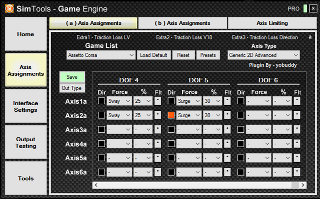

    Thanks so much for sharing your rig, it is a really neat compact design with great attention to detail :thumbs
    Just an observation, it looks like sway may be incorrectly configured, it should lean away from a corner, roll is configured the opposite of sway.

    Greetings, if the sway was configured incorrectly, I have already corrected it, thanks for the clarification. on the .stl and .dwg files I will load them so that everyone has access to it. Thanks

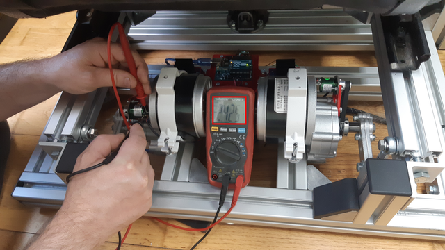

    thanks for such a good instruction. Could you throw off the screen of your changes along the axes if you did. Should the hall sensor be set to 0? can explain this how to properly configure it.

    ok, I'll put an image with the changes, they are only changing the direction of the motors in sway, now I'm not on the pc when this will upload an image with the changes, greetings

    I will wait . what about my question about the hall sensor? Below the video, you left links to some products from AliExpress. Could you give us the parameters for ordering Poleas mxl + correas? Thank you for taking the time to answer.
  10. scruck
    scruck Member
    Jul 18, 2019
    31
    España
    409Coins
    +64 / 0 / -0

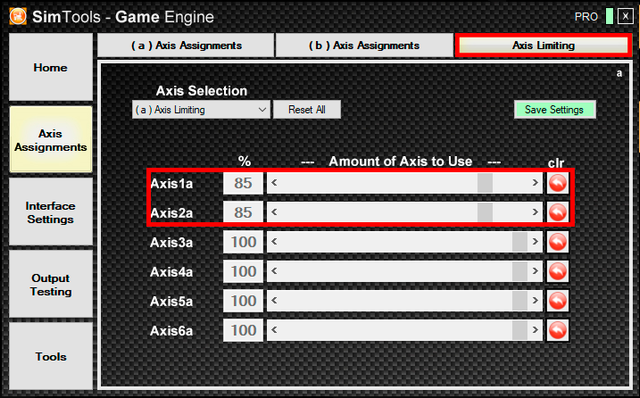

    good, about the hall sensor when you have the platform level you have to calibrate it to 2.5V so that the maximum is 5V and the minimum 0V, also, I forgot to show it in the video, you have to configure the limits in the simtools, being A 360 ° sensor to avoid going from 5V to 0V and obtaining unexpected movements ... I will add all this with images ... on the MXL pulleys and belts the ratio is 40:20 and the inner diameter for the 40T is 17mm ( motor shaft) and the 20T 6mm (hall sensor shaft), the belt has a total length of 200mm. Greetings

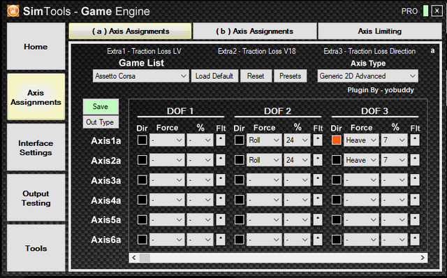

  11. scruck
    scruck Member
    Jul 18, 2019
    31
    España
    409Coins
    +64 / 0 / -0

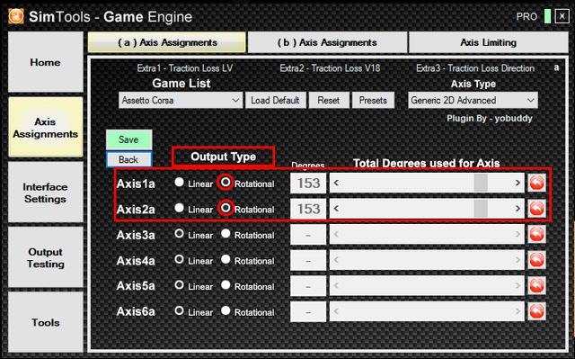

    As I said in the previous answer I attached images of the simtools configuration
    ( a ) AXIS ASSIGNMENTS:
    DOF 1:
    I remove the pitch because I do not like the feeling of raising or lowering the platform with track level
    DOF 4: Sway
    I change the direction of the motors with respect to the video because it turned in the opposite direction
    AXIS LIMITING:
    OUTPUT TYPE > TOTAL DEGREES USED FOR AXIS:
    ALWAYS ROTATIONAL
    SENSOR HALL PLATFORM LEVEL:
    THE CLOSEST TO 2.5V
    Excuse my English, I'm Spanish and I use a translator,
    if you don't understand, ask me
    • Like Like x 7
