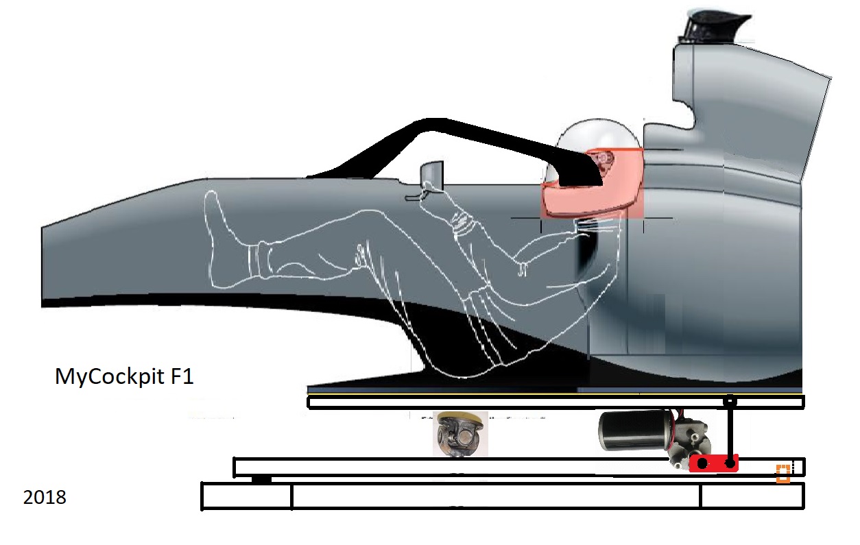

    Hi to all
    After i have read many and many pages of projects in this forum, i decided to start a my project.

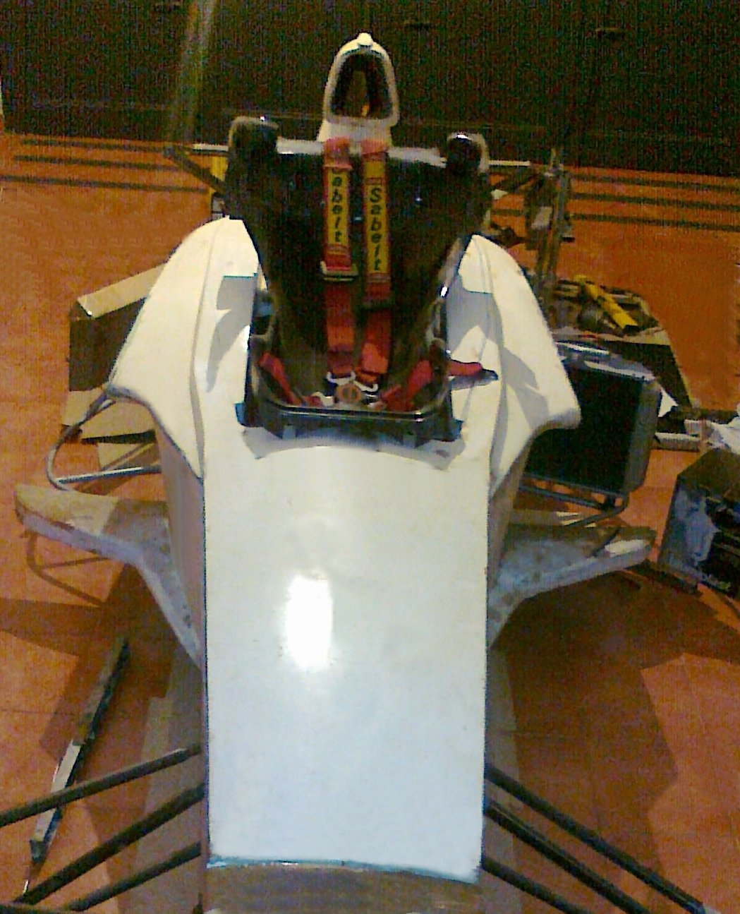

    My idea is to build a low cost F1 dedicated 3dof cockpit simulator, with real dimensions and with traction loss.

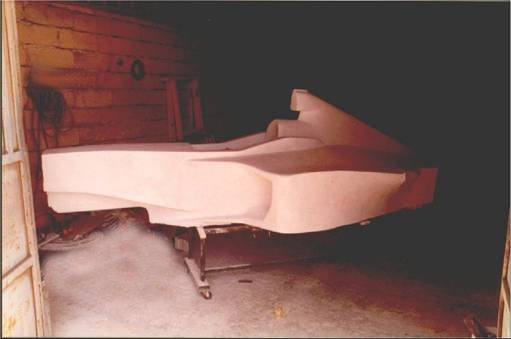

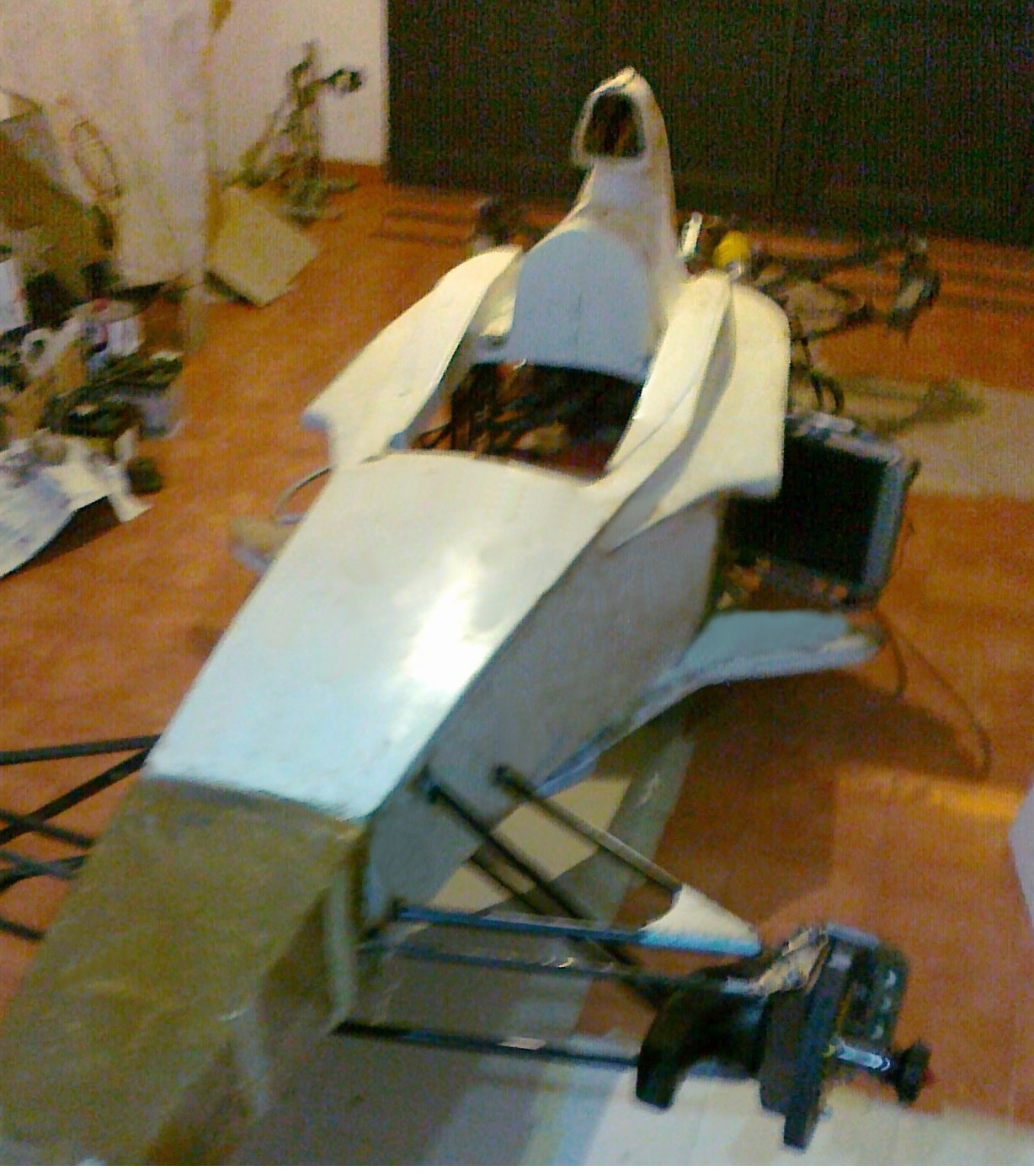

    For fun, i have made in the last years a F1 replica , with real measures and perfectly working (in fiberglass, with steel chassis inside and complete of CBR RR900 engine) so i have the moulds and make another cockpit is not a problem

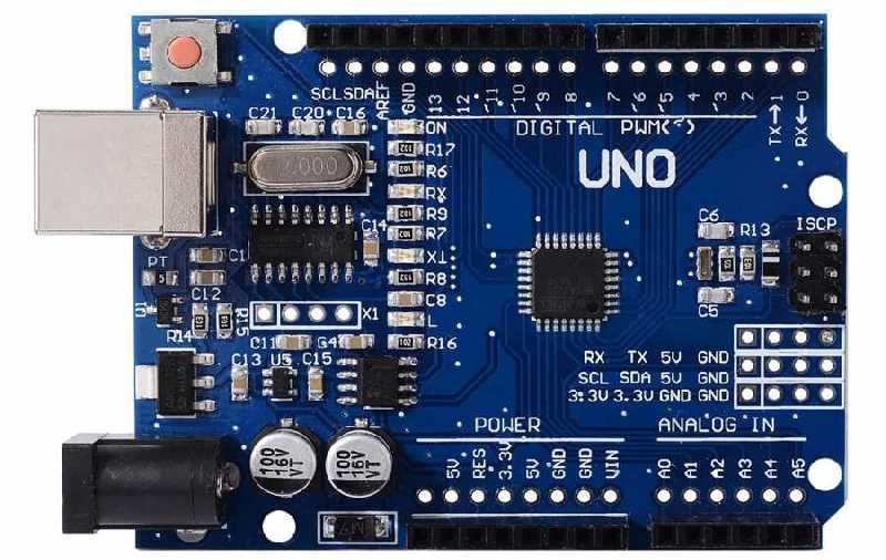

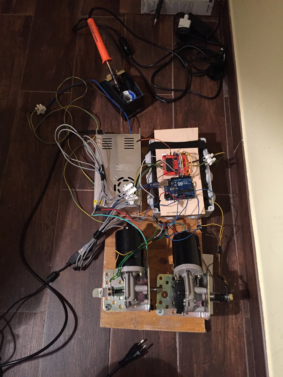

    As many of new project, as first step, i decided to start with a simple configuration with :
    - Arduino uno Rv3
    - 2x Moto Monster
    - 3X 12V wiper dc motor
    - 2x psu 12V 30A
    - Game : AssettoCorsa
    The objective is to learn, learn and learn how the simulator can work, the pro and cons of each configuration and in this route, if i can be useful, it will be a pleasure.
    Reading many projects (thanks to racingMat for his project , the code and to all for the info and tips read), i have built the first hardware that in these days i'm testing and seems to be ok.
    Of course i will have problems but i'm sure to solve reading and asking

    First Hardware - in testing but works
    first step.jpg, not beautiful but works with the game.....after will be beautiful...
    Now i will start the chassis and cockpit construction
    New Update on next days

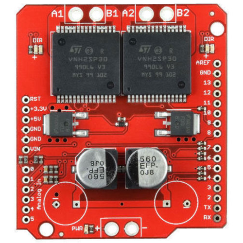

    Just a couple of initial observations:
    You will need to make sure the MMs are cooled, or they will not last long: https://www.xsimulator.net/community/faq/xilence-cooler-for-moto-monster-sparkfun.211/
    Wiper motors are no particularly powerful and hence while a full cockpit may look nice it will certainly hurt performance. Have a play with SimCalc to get your head around some of the physics involved and how they relate to design decisions: https://www.xsimulator.net/communit...e-linear-speed-and-forces-of-your-design.270/

    Hi
    thanks a lot for your tips
    About the cooler, of course i have bought some coolers for all the parts and i will add them in then next days
    In this first step , i wanted to do a test to see that all works
    Thanks for the second link that is important to understand.
    As i said, before to do a good work i think is foundmental to learn, learn, learn and reading the Others projects and all the tips written from expert like you. Thanks
    In the firts step i use 12V wiper motor, to test and because are very low cost parts (with 50€ i have all the parts to test and with the same price i think to have the steel chassis built ).
    In the second step i will use the same wiper motor but at 24V, with arduino and 24V bridge
    After, if the performance will not be good as i think, i would want to use Dc motor 24V, at least 30Nm and at least 120Rpm, with arduino and sabertooth bridge (in this case, the cost are more more high but acceptable for a low cost F1 cockpit)
    I would want to see if i can use DYI linear actuator, 200mm/s at least but we will see (i have seen many homemade linear actuator that seem good)
    Step by step

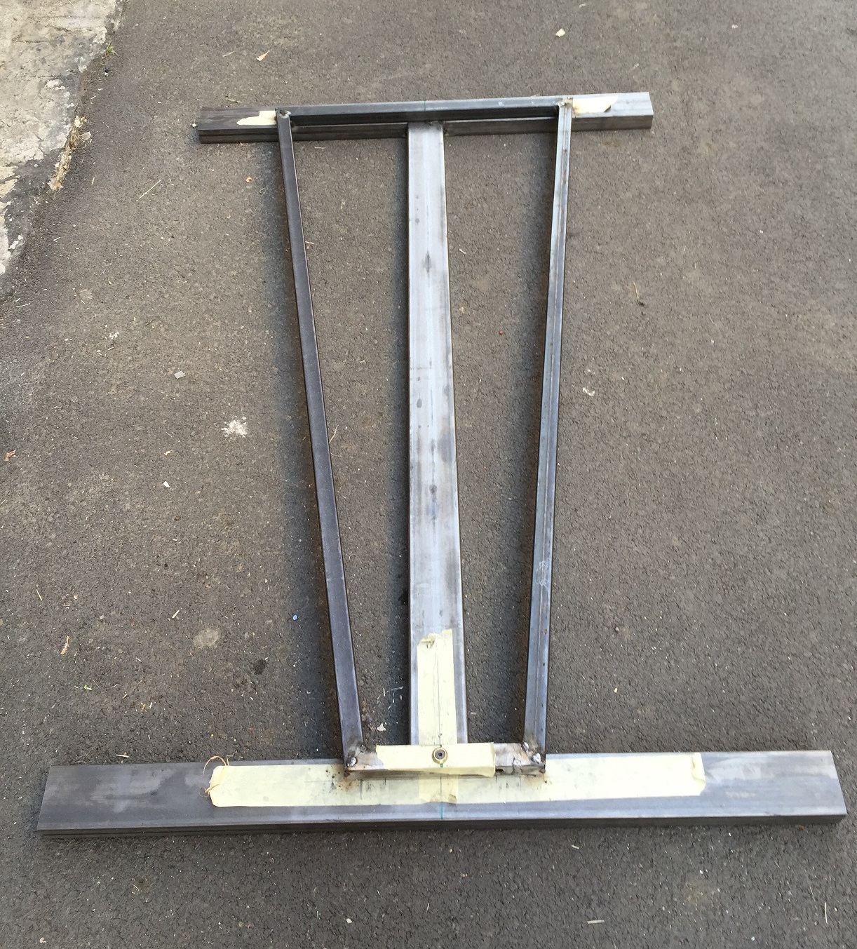

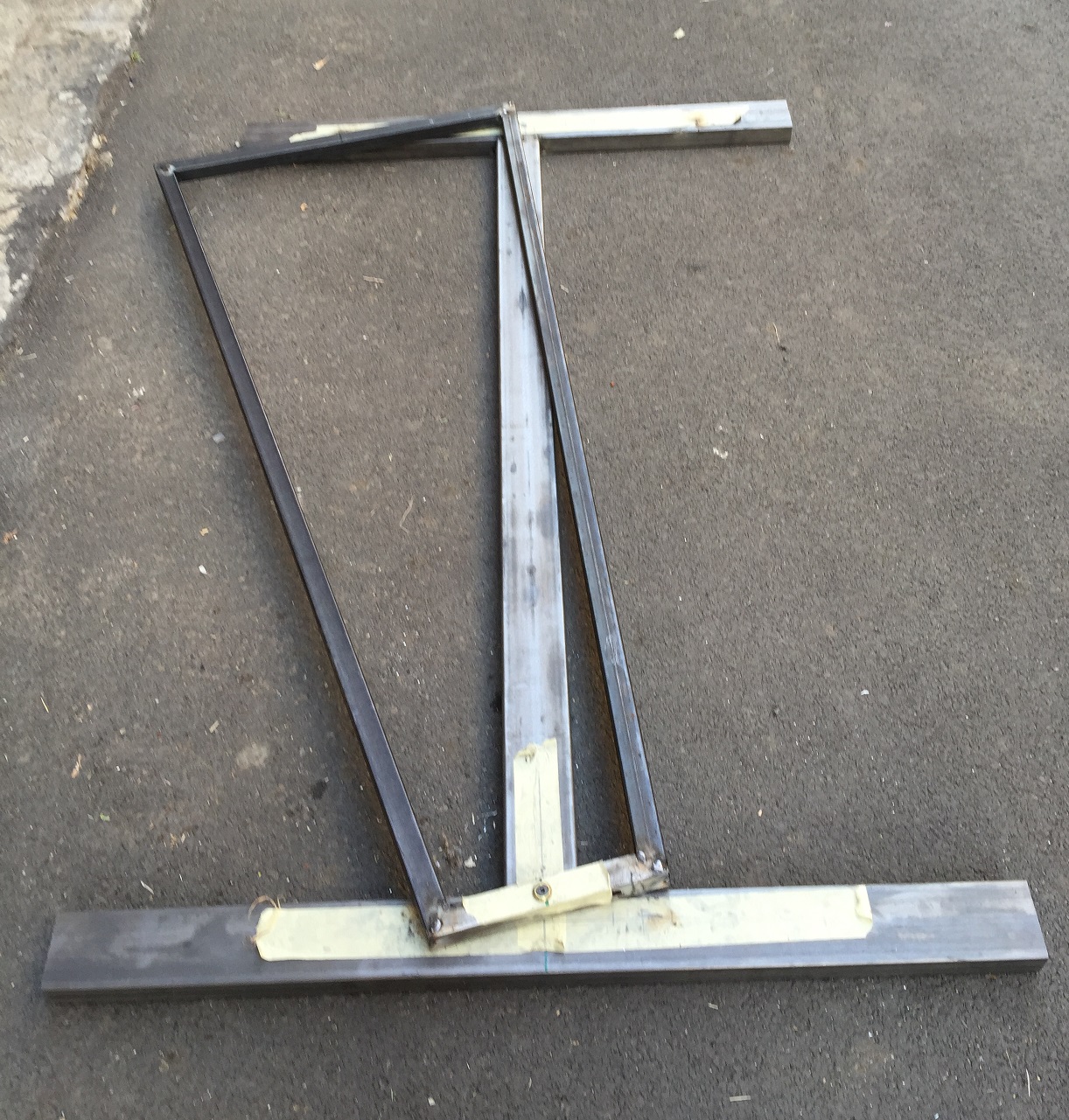

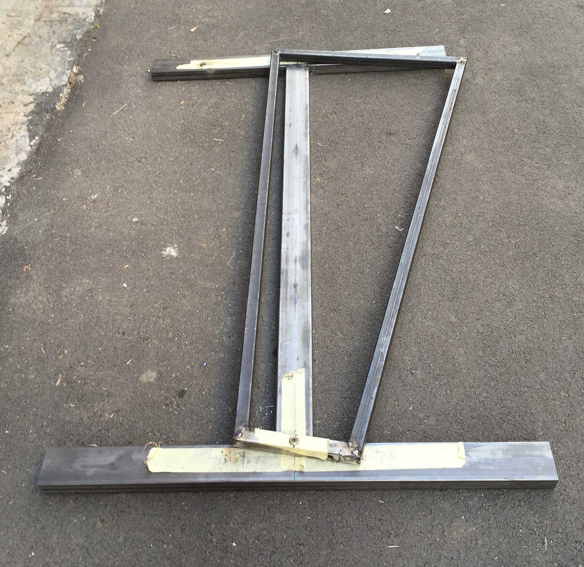

    Design ended
    Frame construction started....
  10. SuperMarioRacing
    SuperMarioRacing New Member
    Feb 5, 2018
    15
    sicily
    42Coins
    +10 / 0 / -0
    traction loss...
    Now must be finalized....
