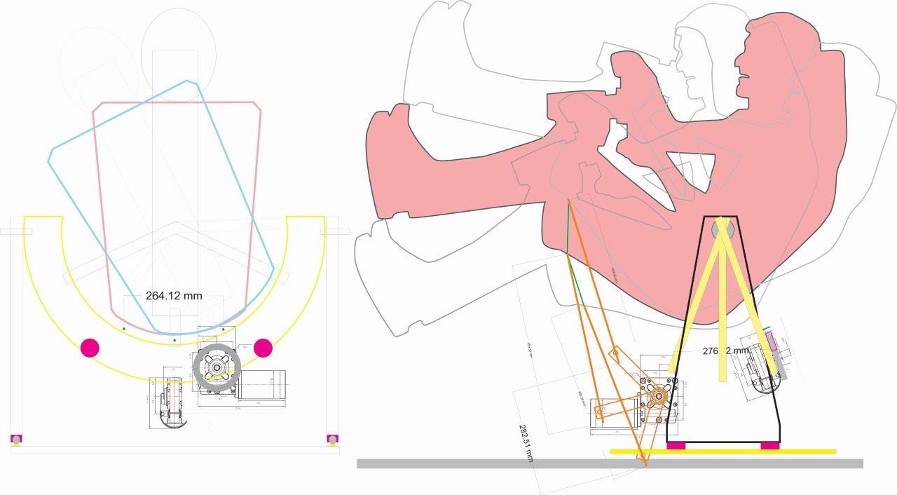

    Have been mulling over ideas in between other projects. I have to make a diversion which will put the sim back a fair while, Mate broke my small CNC router so am going to build a lot bigger and far stronger one. Design is done and the table is under construction. Most of the gear is on order and will start putting it together after i get back from Indonesia in late January.
    If i don't change my ideas about the sim the bigger machine will come in very handy for the sim construction.
    This is only 1 idea for a possible machine, i have more :grin
    Warning. This idea is a little off the planet so don't spill your coffee when you look :p
    I fly so a sim that could double as a flight sim drives a few of the ideas. My terms are more related to an aircraft so may differ from some of the terms used here to describe an axis. To me for and aft tilt is pitch and roll is termed here as sway.
    This thing has +- 27 degrees of roll in .6 sec and +- 20 degrees of pitch in .33 sec. If the motors lack power then there is always bigger motors :D There would be roller bearings between the curved beam and seat of course and more rollers to stop the seat coming off the base.
    The for aft travel, surge, i have as +- 150mm but ez to make longer if people think it needs more.
    Sway for traction loss is not drawn yet.
    Don't worry about strength or stiffness to much yet. Give me a bucket of epoxy and a big spool of carbon tow and i can make it plenty strong and stiff while pretty light and besides i can't weld for shit. :rolleyes:

    That one is interesting but i can't see how they do the roll axis. The yaw axis must have a serious bearing at the bottom as it seems so small.
    It sure does fix a couple of potential problems i can see in my version.
    I want the loss of traction but that needs quite a different pivot point than Yaw for a flight sim needs so makes it difficult to decide which to have but most likely the driving sim will win out. Having both would become quite unwieldy i think.
    Time for another sketch :eek:
    Another feature i would like is to have 2 neutral positions for the seat. One laid back for F1 and one more upright for a normal car or flight. EZ on my version, different tie rod lengths, but will need to sketch up some axis points from the one you posted to see how that will work out.

    You have the right idea with the design, but will need very powerful motors or even actuators to move it.
    Just like the rock n ride. It is compact but needs a lot of power to move it. It was originally designed with air actuators.
    If you have the skills, build these http://bffsimulation.com/linear-act.php
    I was building some, but I ended up sending the parts to a friend and when he gets time he will finish them.
    I didnt have the tools needed to tap out a 10mm thread hole.

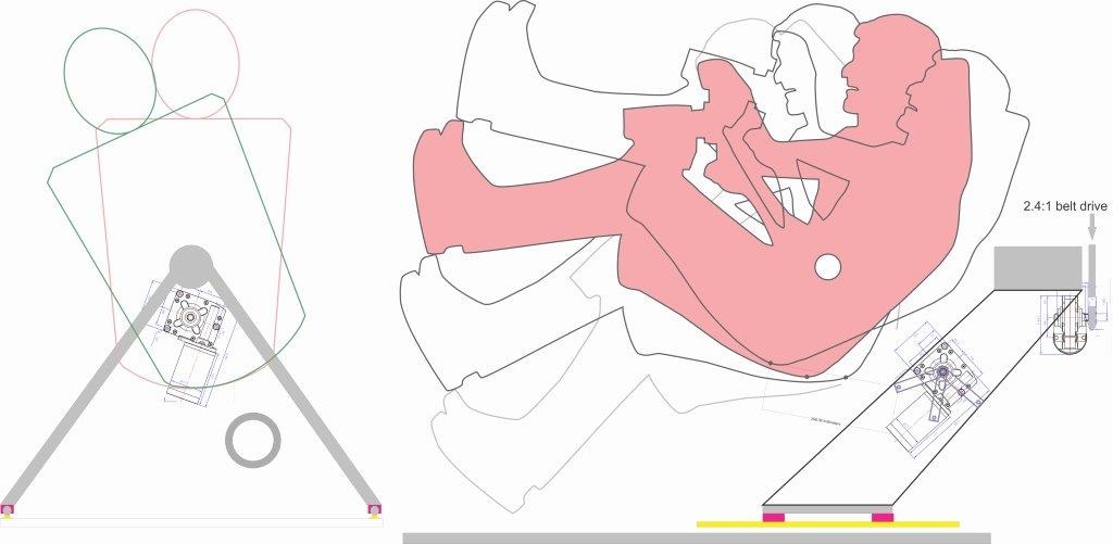

    bsft - not sure what a RNR style means. And thanks for not thinking I am too stupid, mad though maybe :).
    That last one is a variation of the first one you posted but is only 2 dof.
    These are both along the lines of what i was thinking. Decent roller bearings should make it pretty free to move.
    I can see how EZ it would be to add surge and yaw but traction loss gets more difficult to keep it compact.
    In your opinion what impact would the reduced head movement have on the effect of the simulation. moving the pivot from below the seat to about the belly button would reduce head movement by about 50%.

    A quick sketch for version2 .
    The roll bearing mount is 100mm diam by 200 so sure i can fit something good enough in that. I haven't drawn the tuning fork arm, that would be EZ to make i'm sure.
    Belt drive for the roll axis with 2.4:1 ratio gives 120 degree rotation for the motor and 50 degrees for the chair.
    The pivot point for pitch is the white dot in the human figure

    It seems many people use the Motion Dynamics 200W 160 RPM motors or similar with arms that move over a range of about 120 degrees.
    This gives me thought, it seems everything does that to me :confused:.
    At 160 RPM it takes .125 seconds to move 120 degrees. Allow some for acceleration under load so maybe .2 seconds, seems a pretty violent action.
    Watching the various videos here some rigs seem quite violent so maybe this is correct and the slower rigs use a higher ratio hence slower.
    While on the subject of motors i noticed that Motion Dynamics has 2 appropriate motors. One is 200W and weighs 2.7kg the next one up is 320W and 5.7 kg. So more than twice the price and weight but only 60% more power and it has a solid shaft that to me makes it less flexible. My thought is if i need more power is to use 2 of the 200W motors with the shaft going through both rather than a single 320W. More power lighter and cheaper :cool:.
