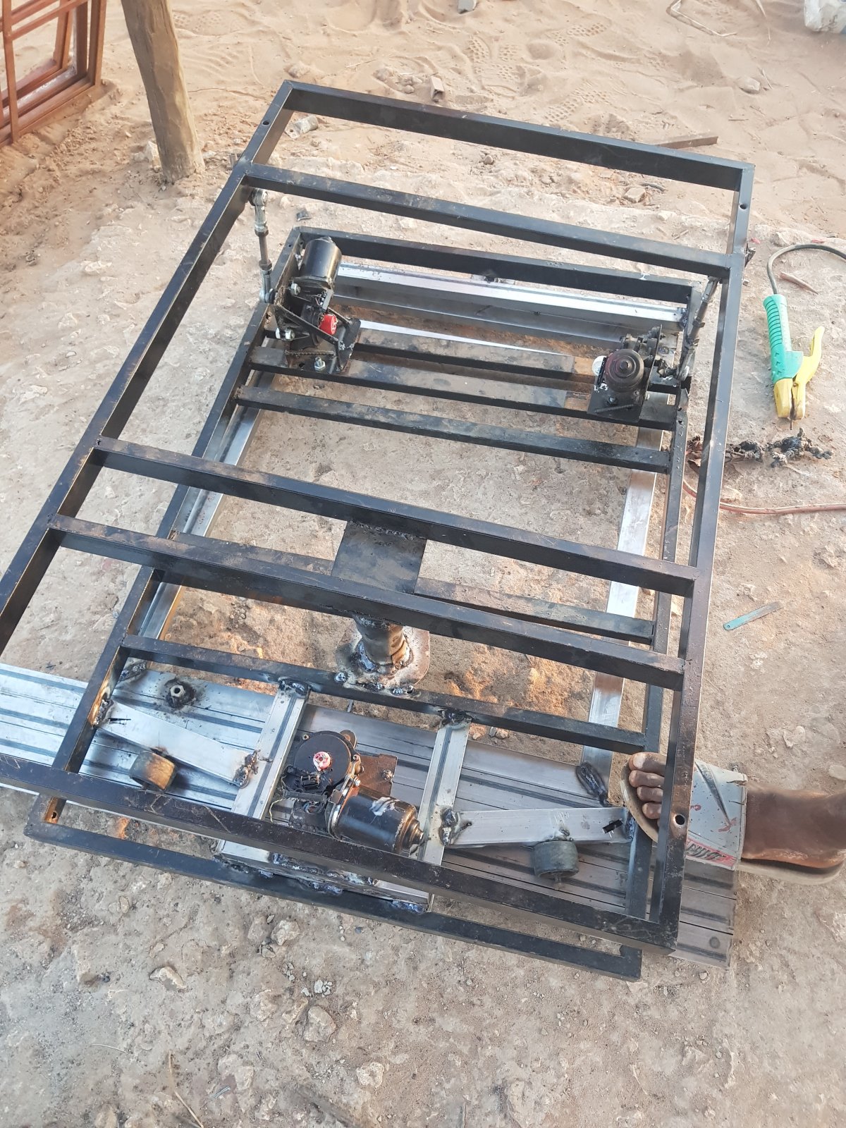

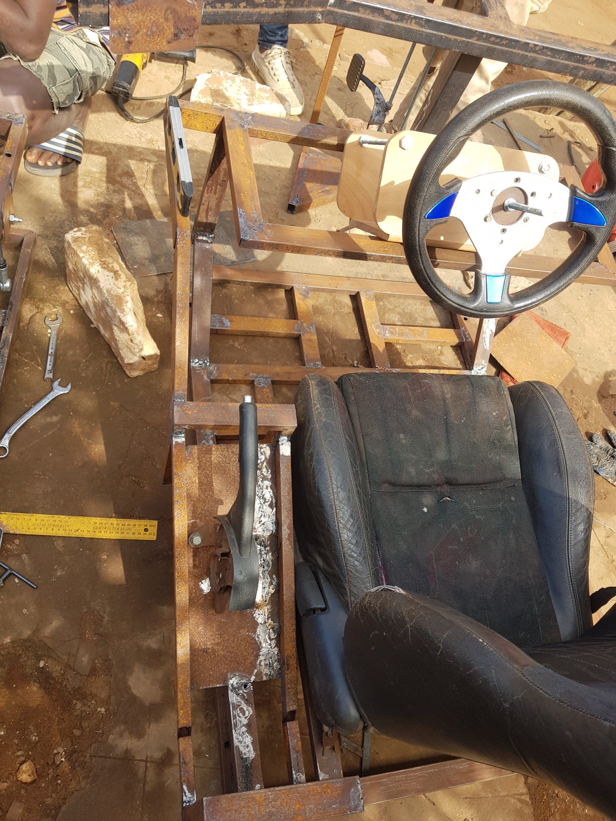

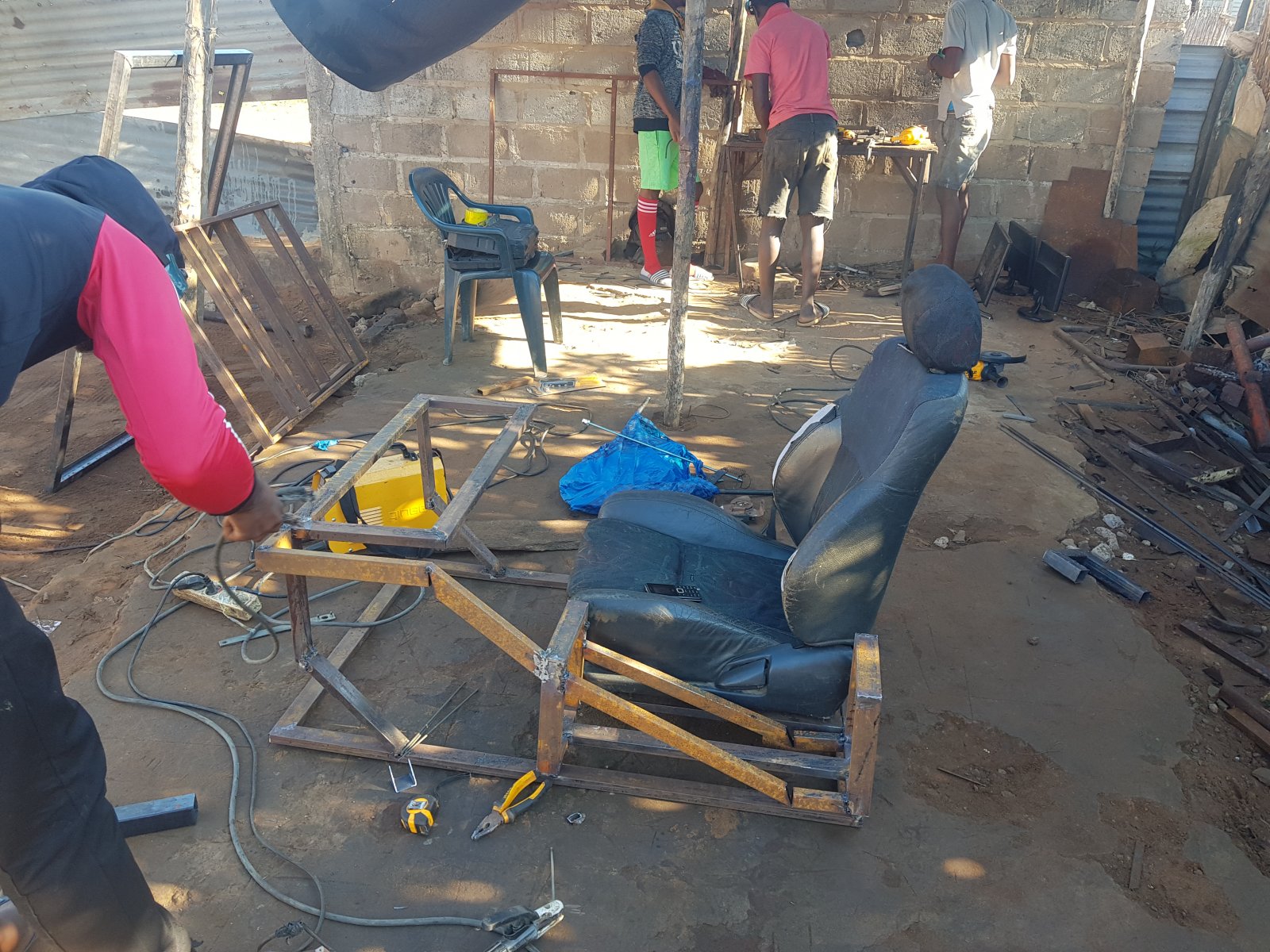

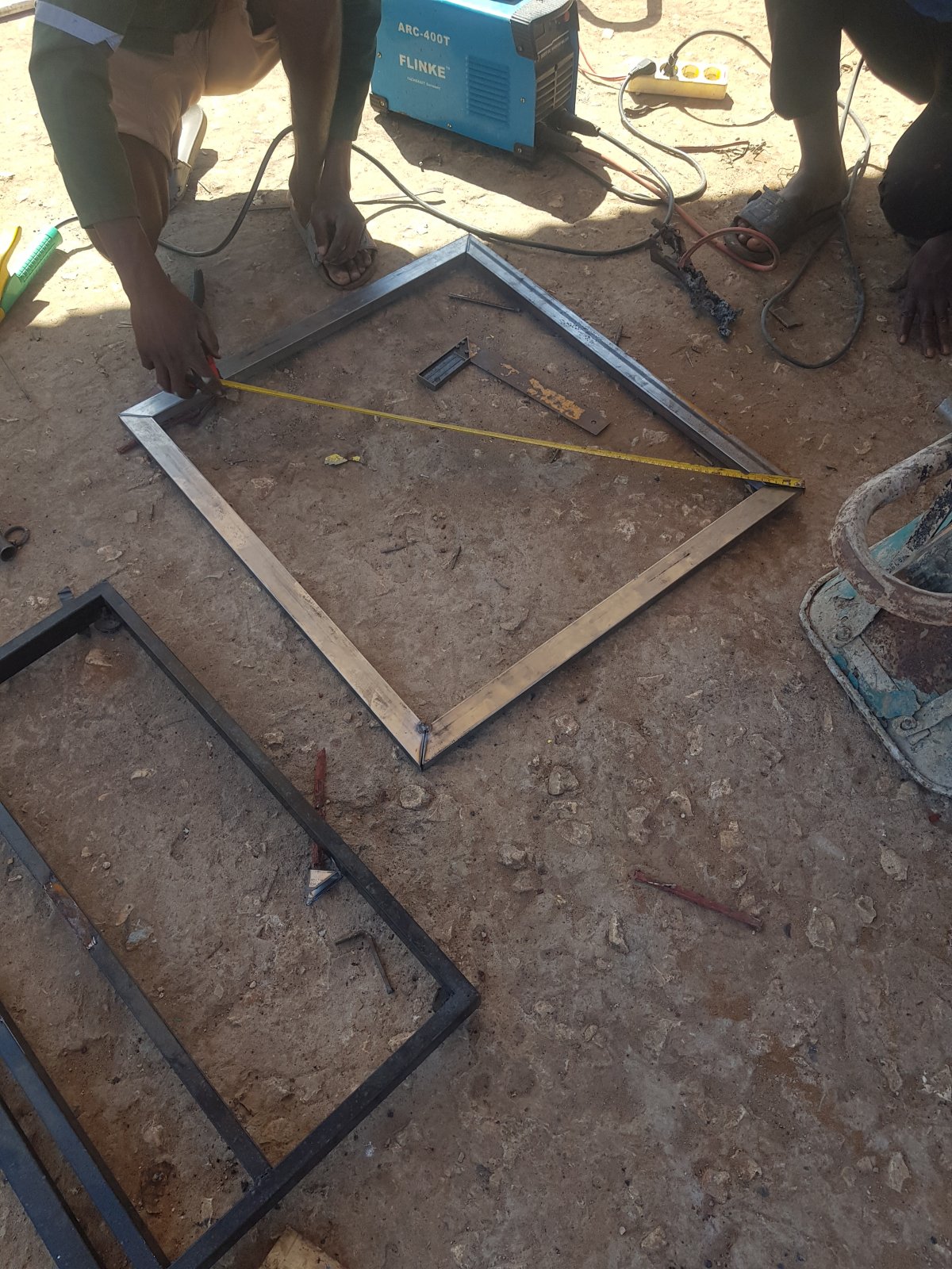

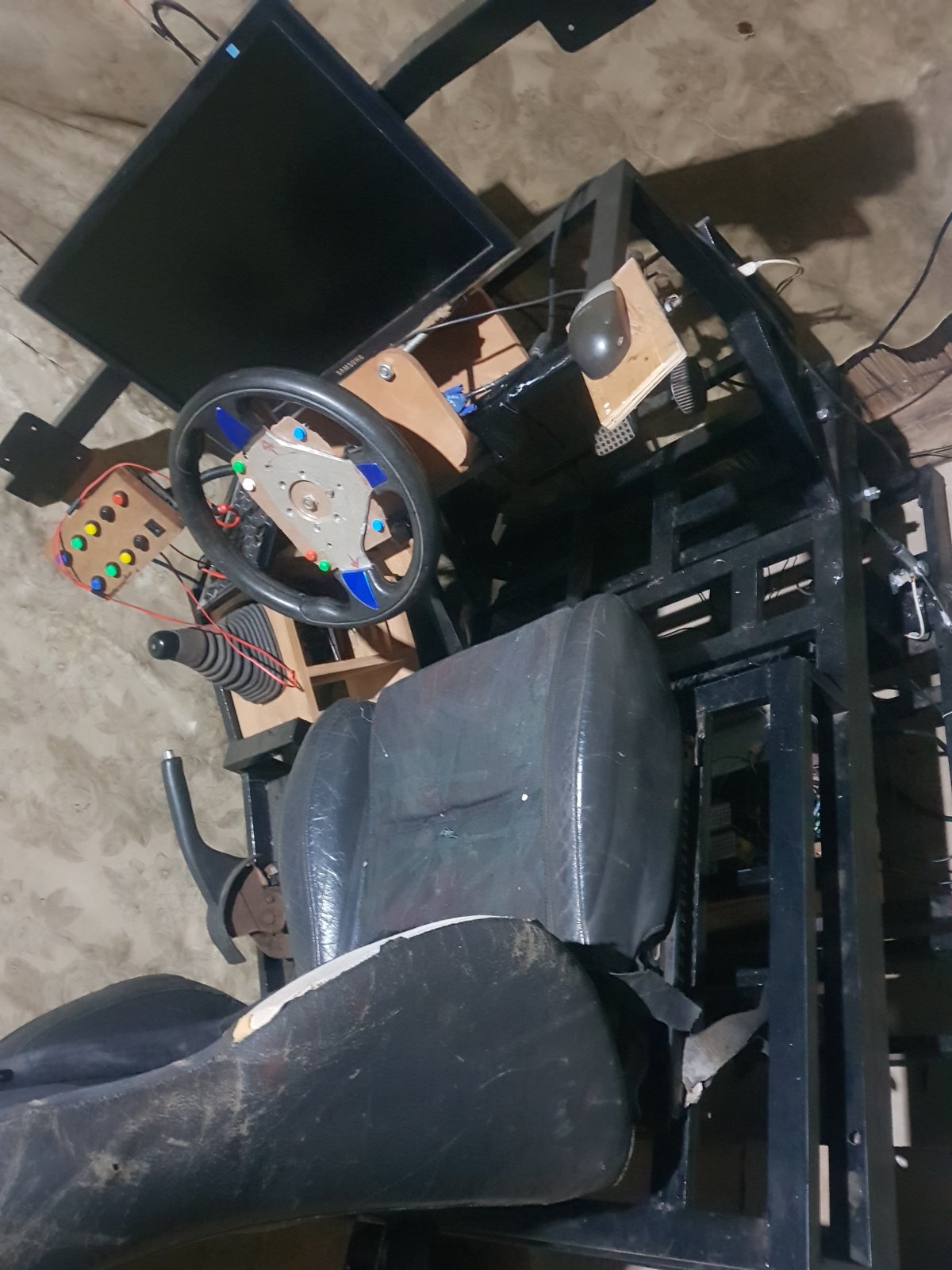

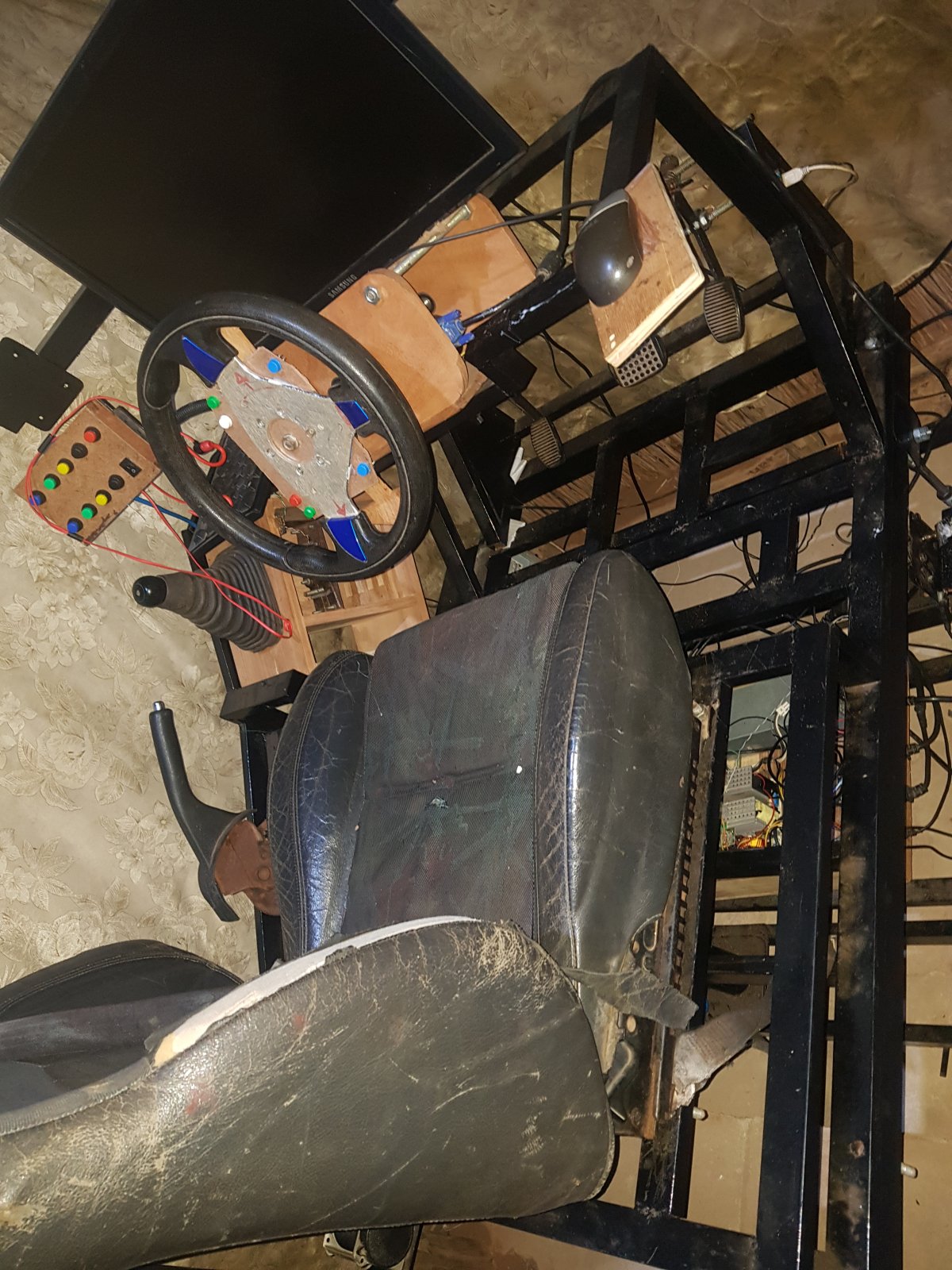

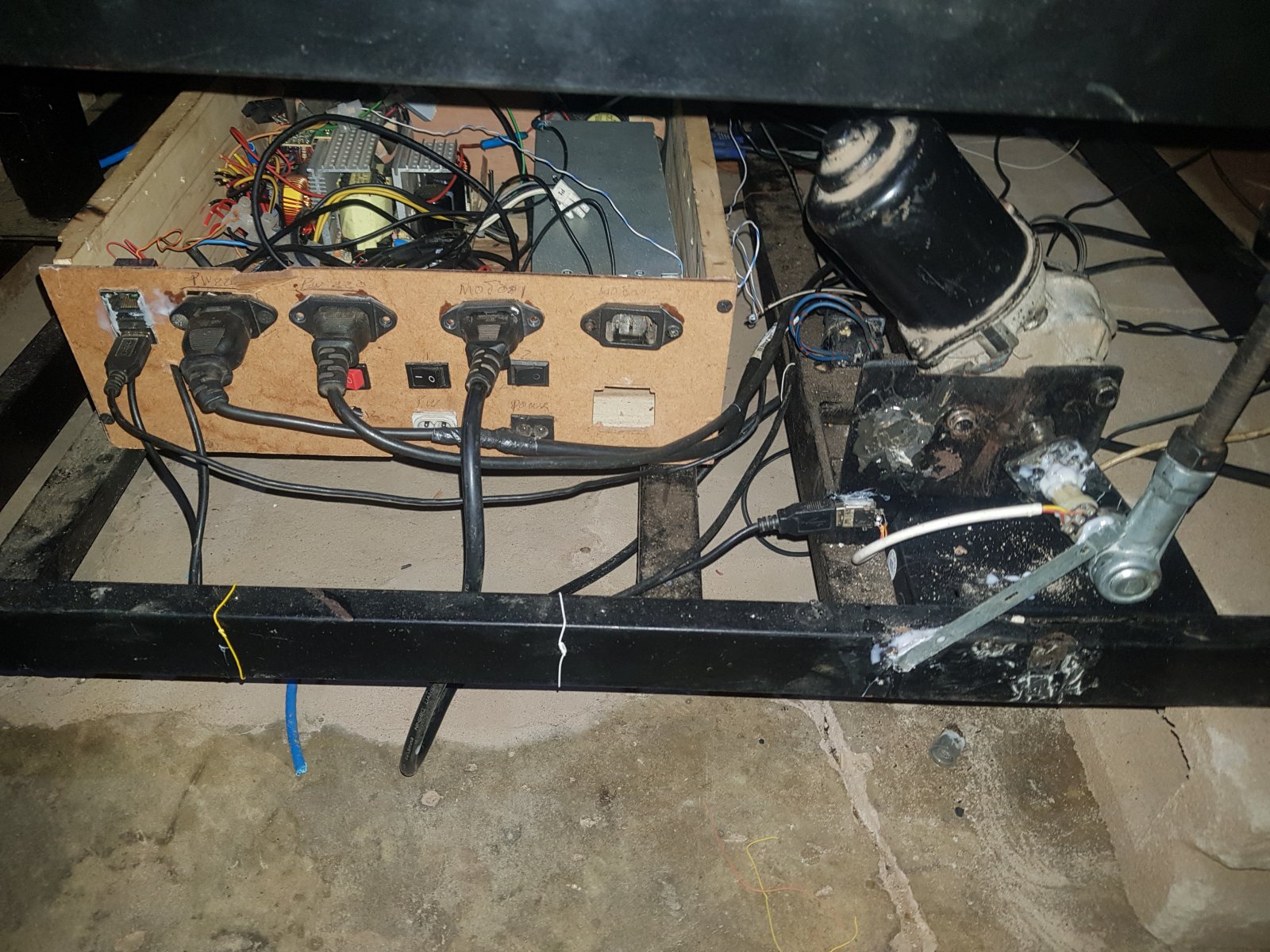

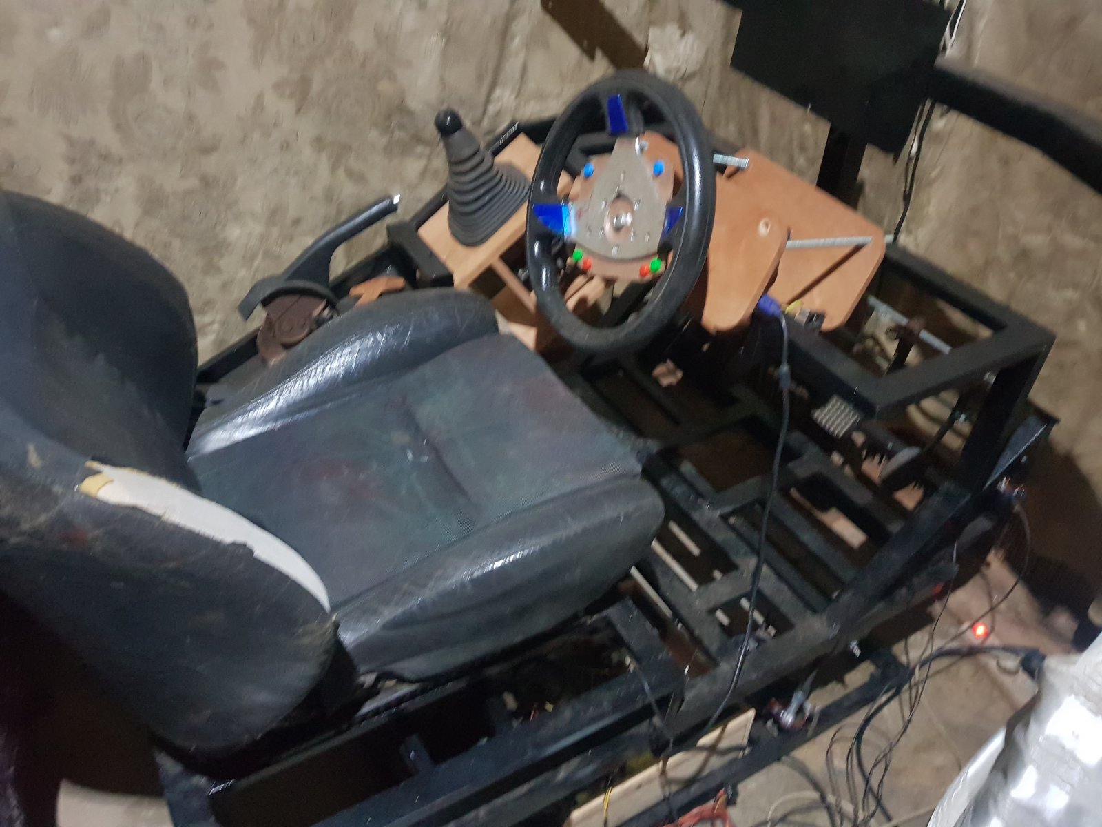

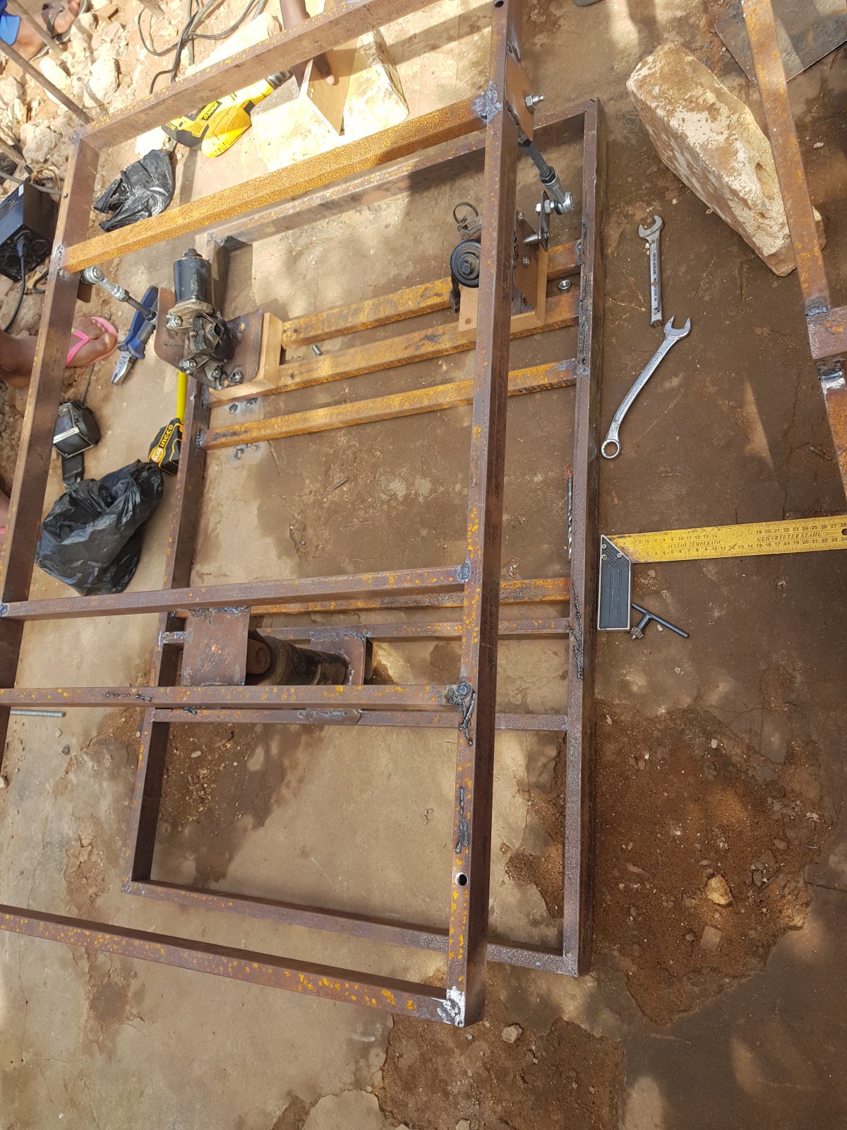

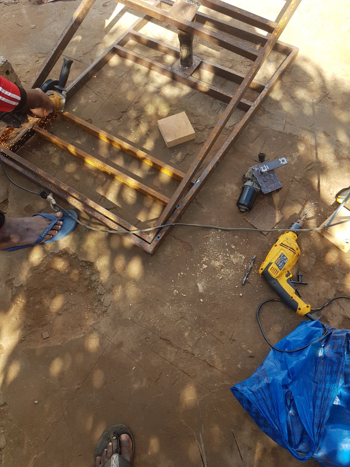

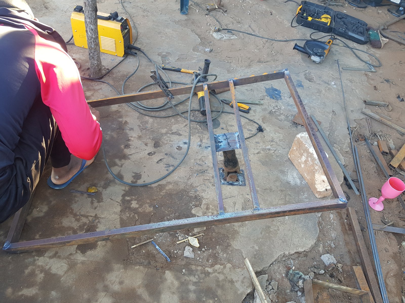

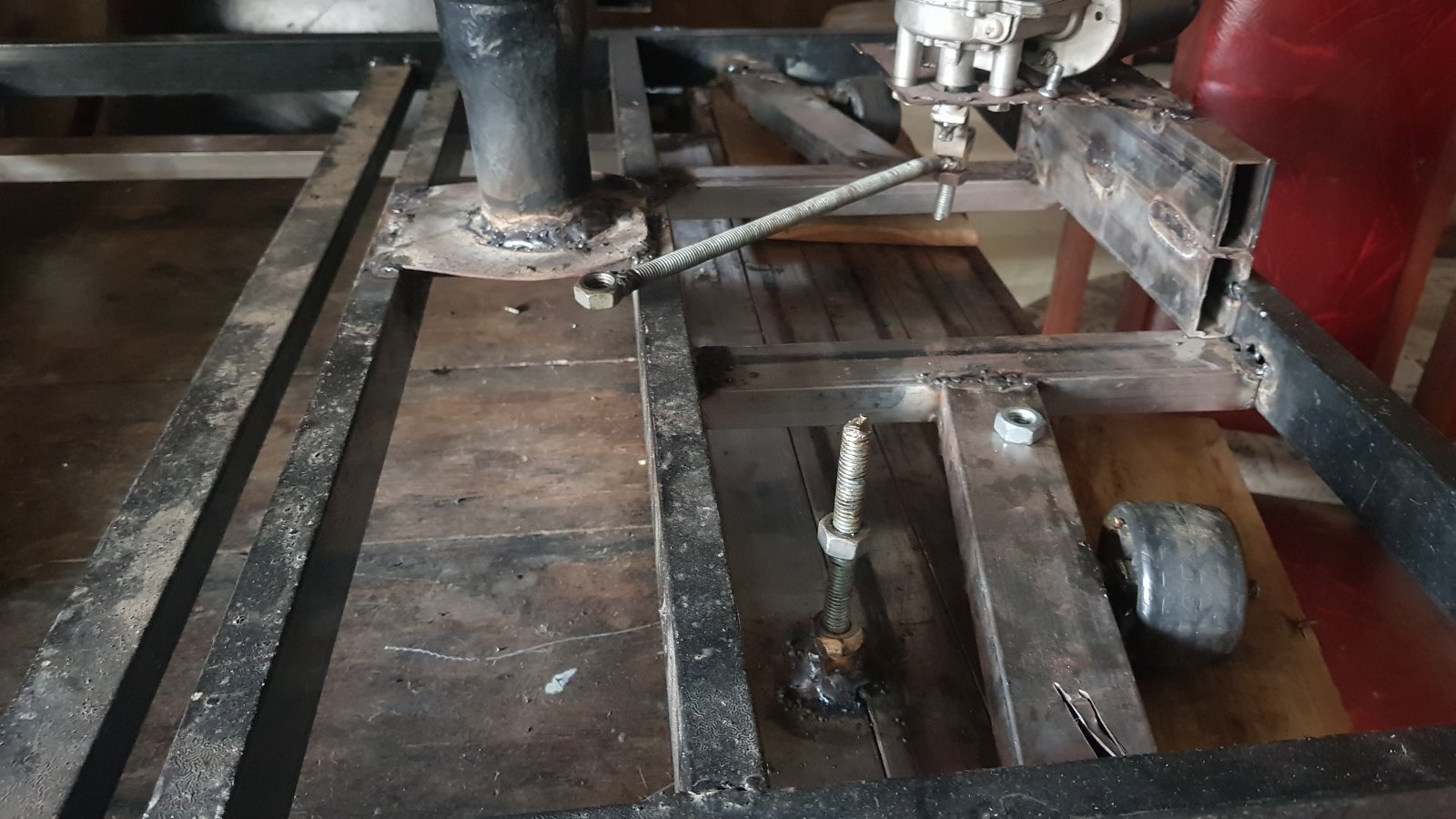

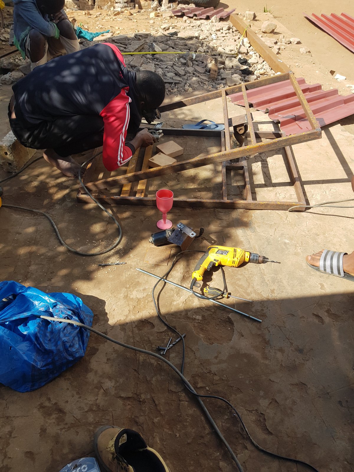

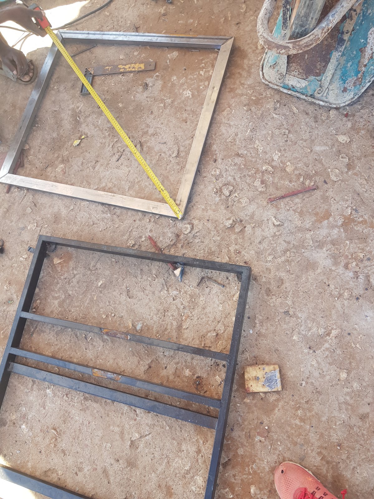

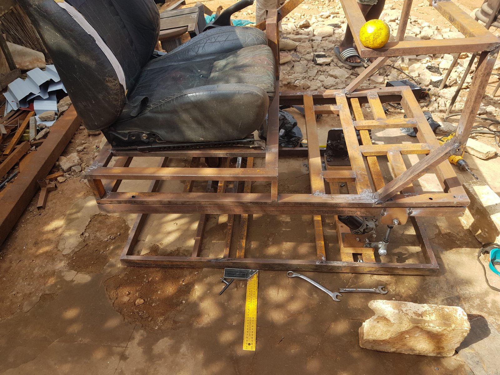

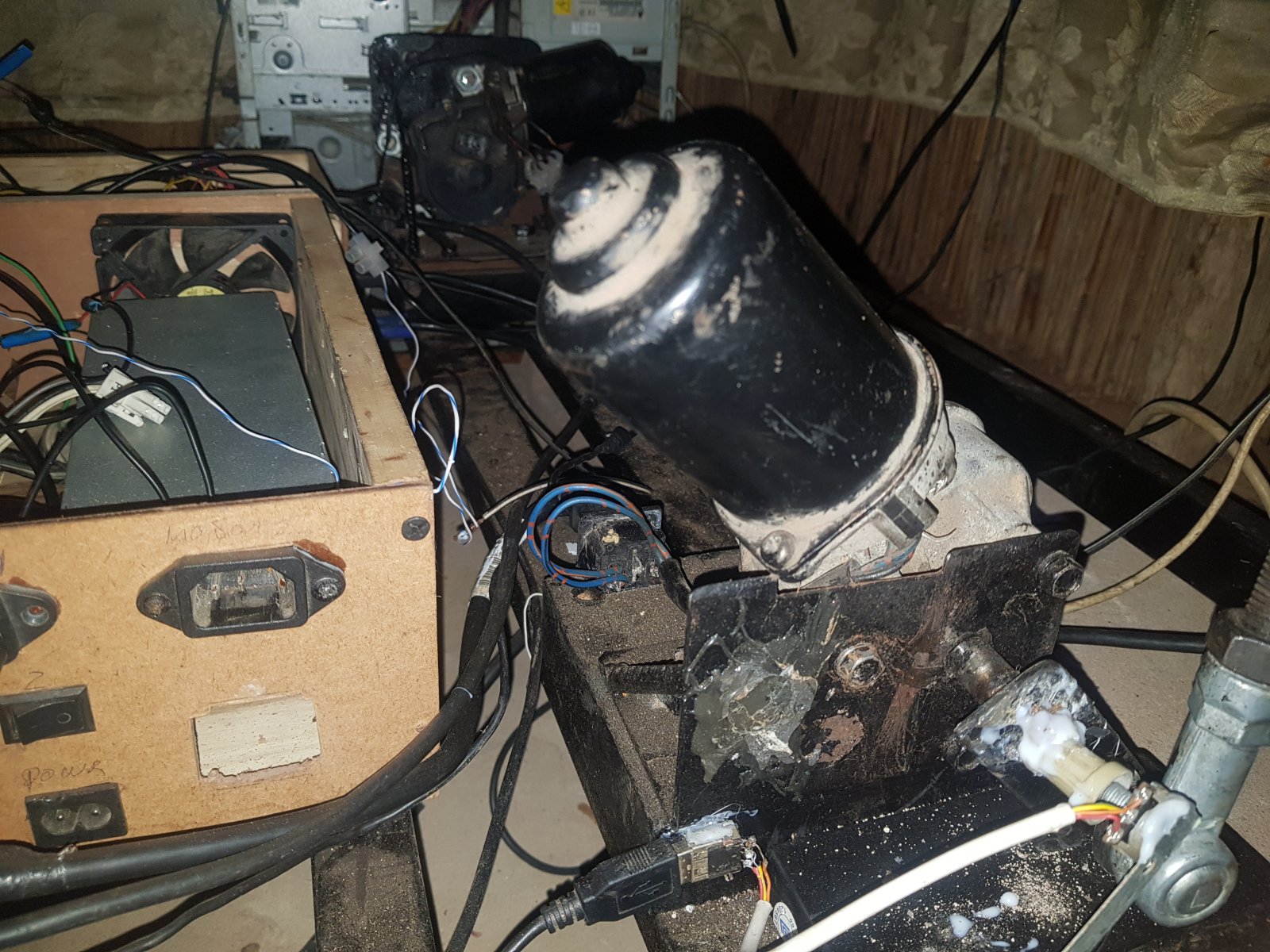

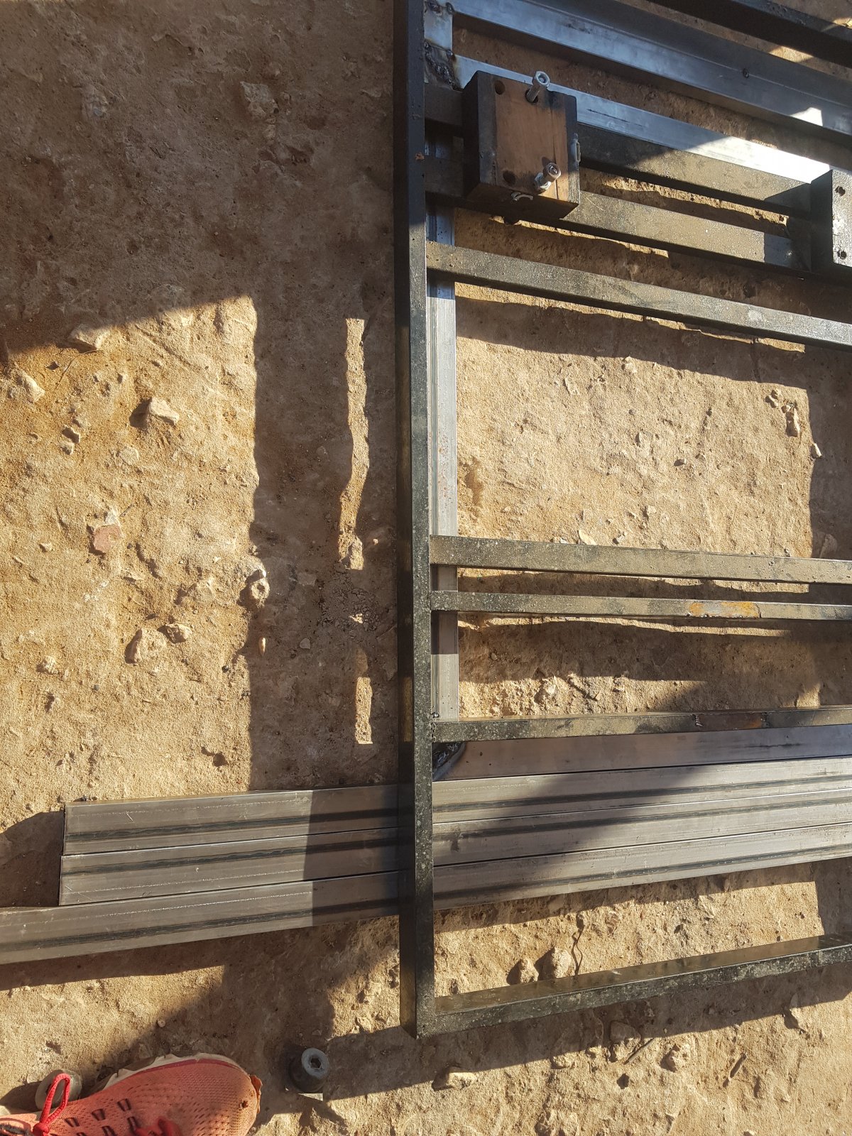

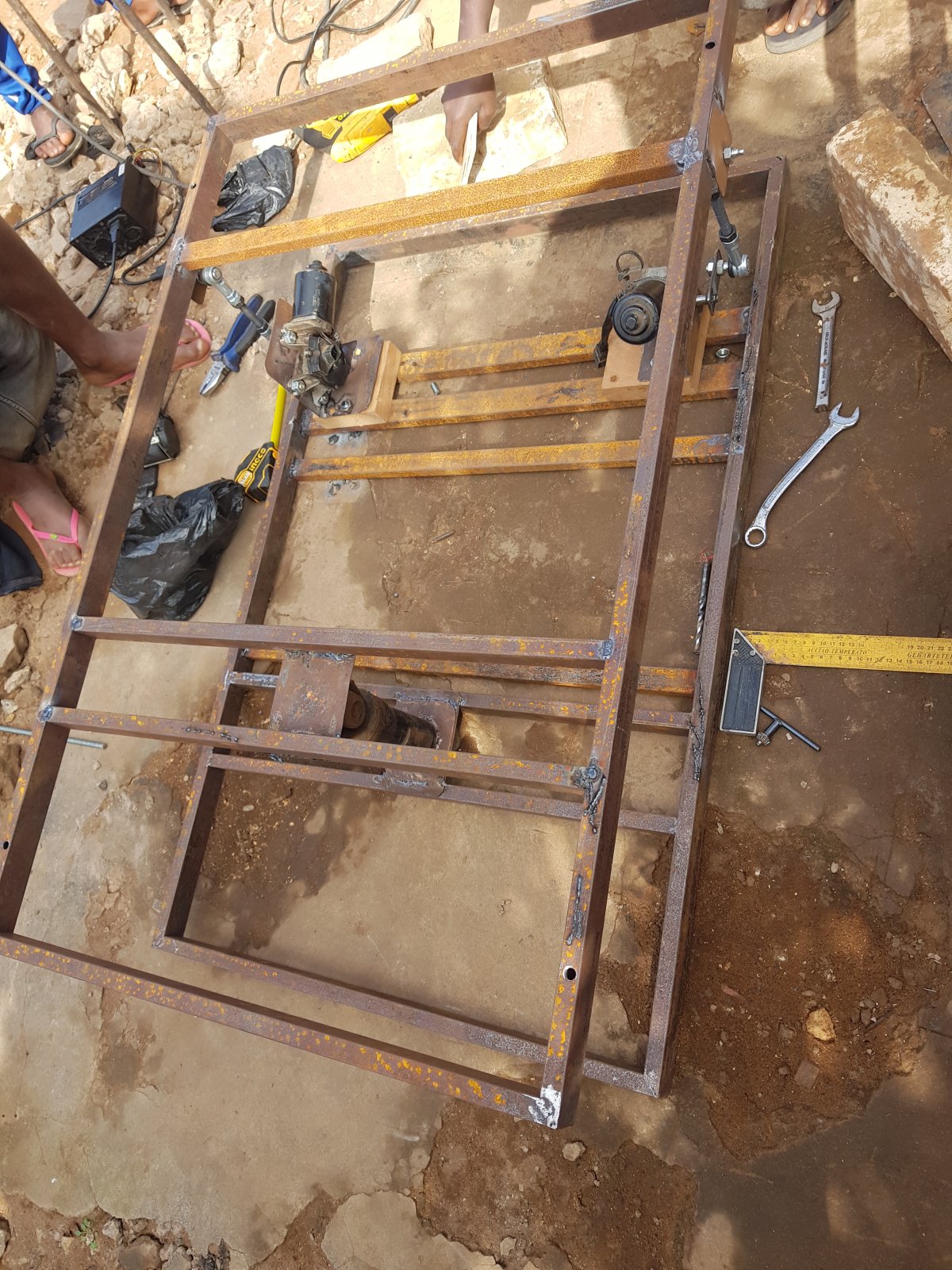

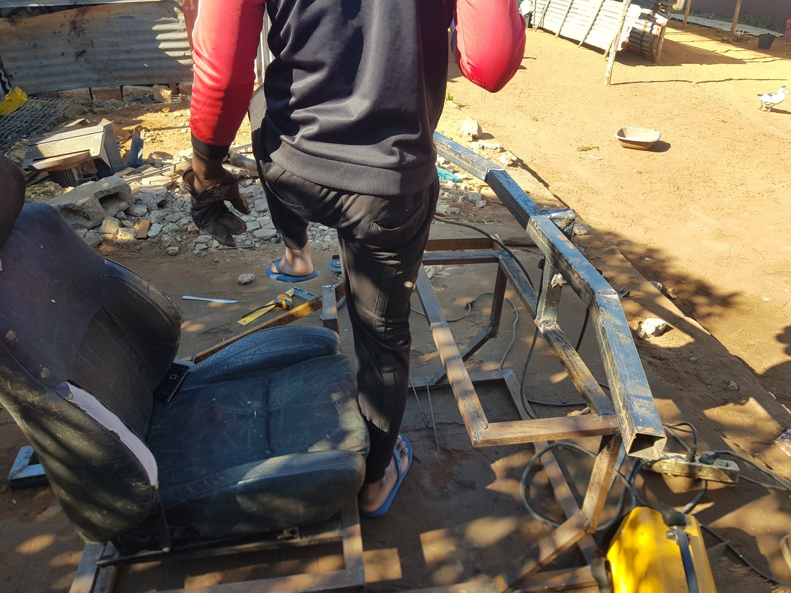

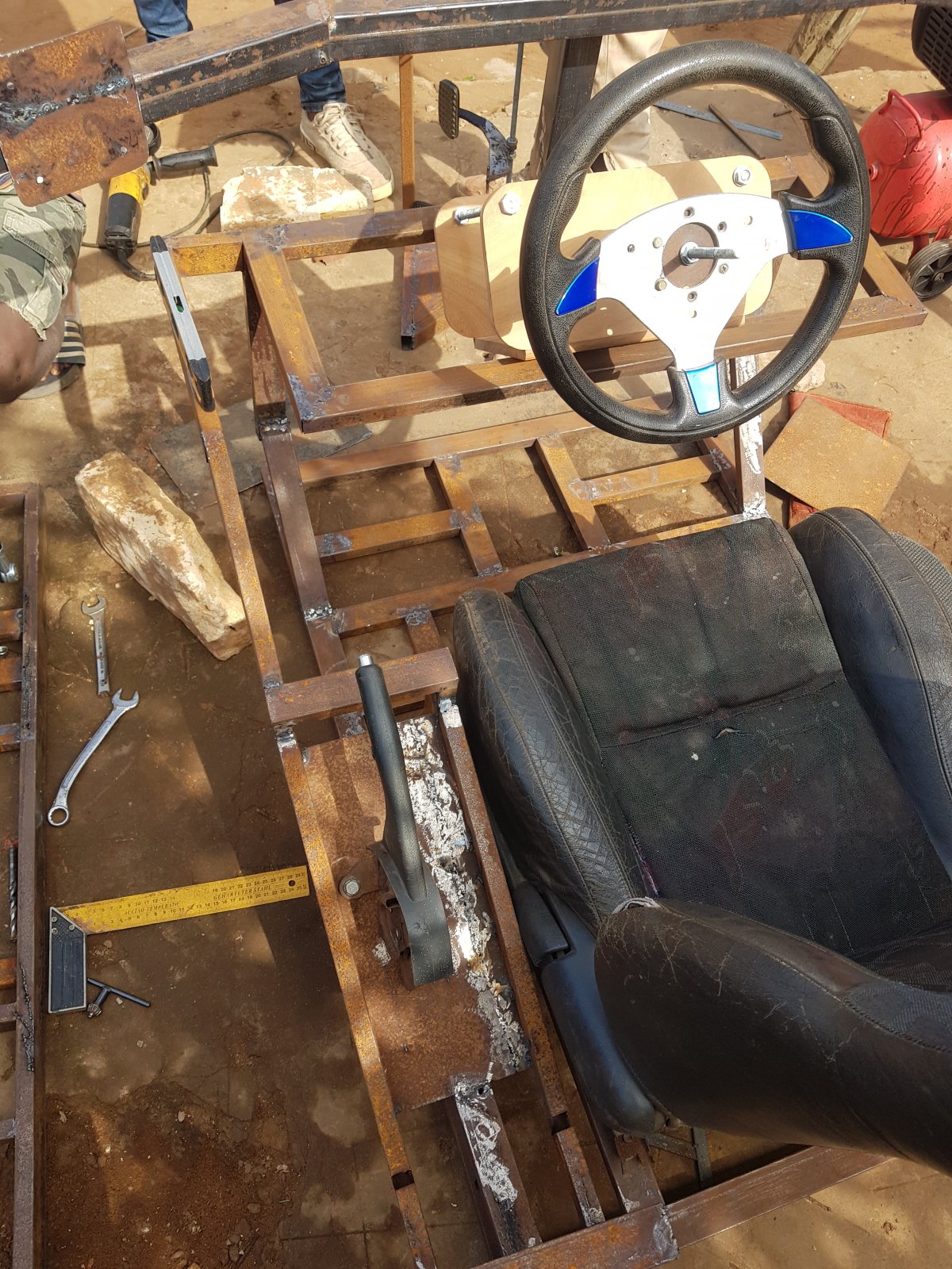

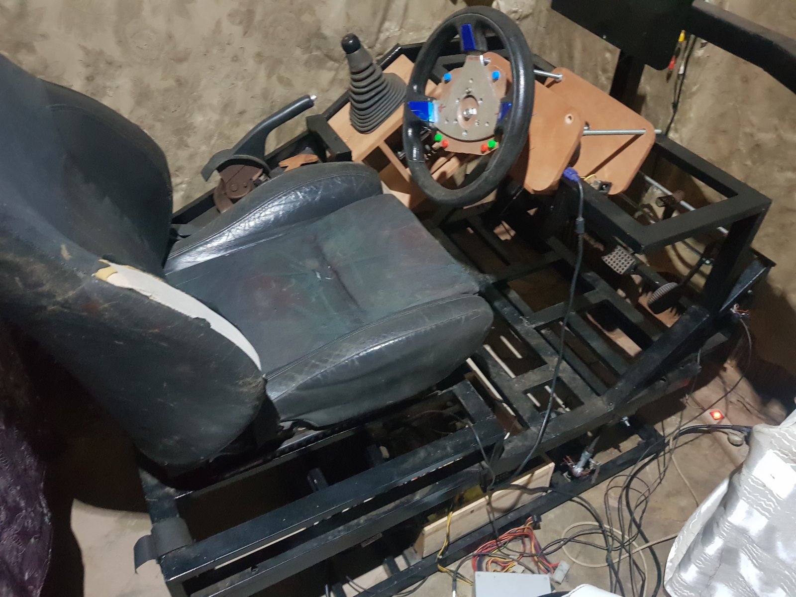

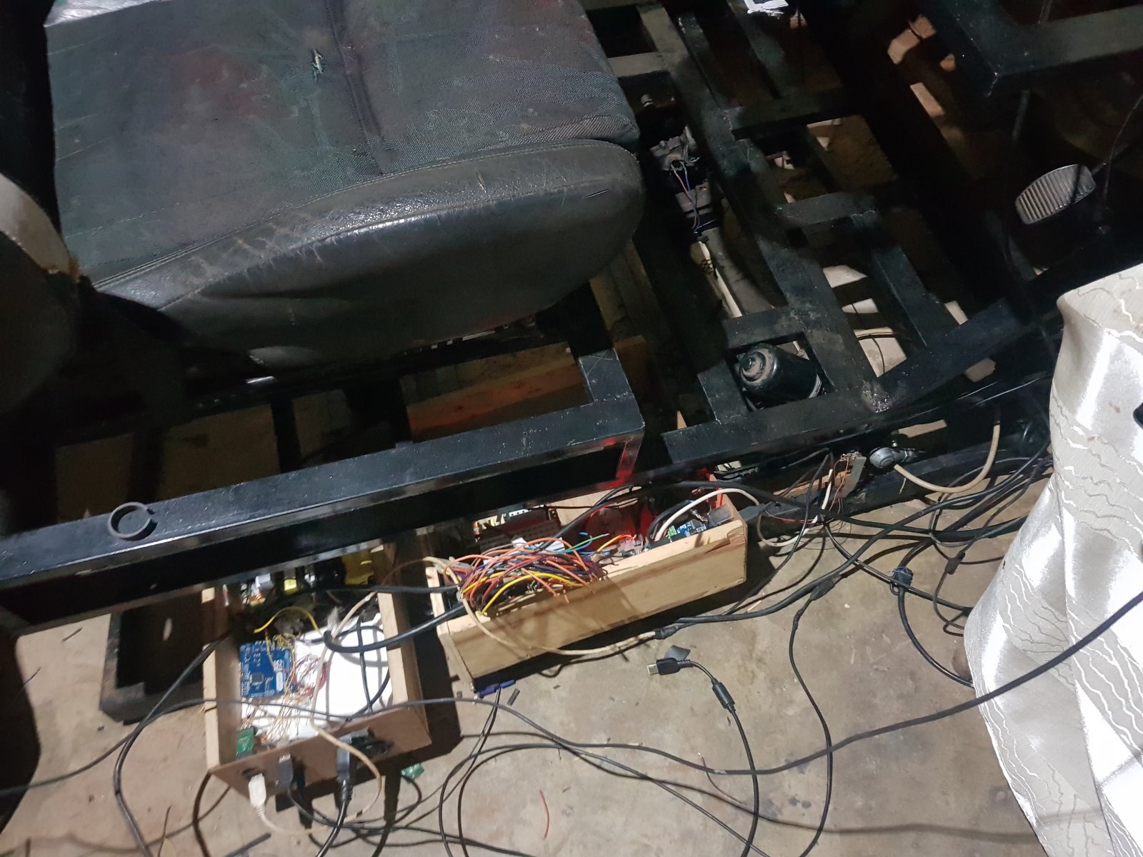

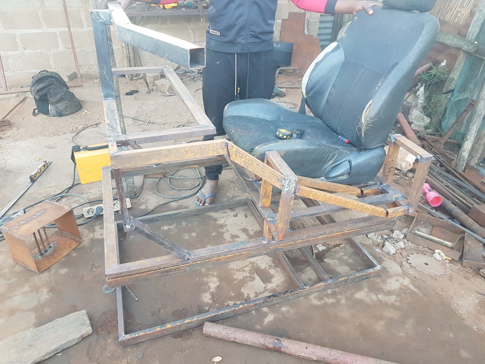

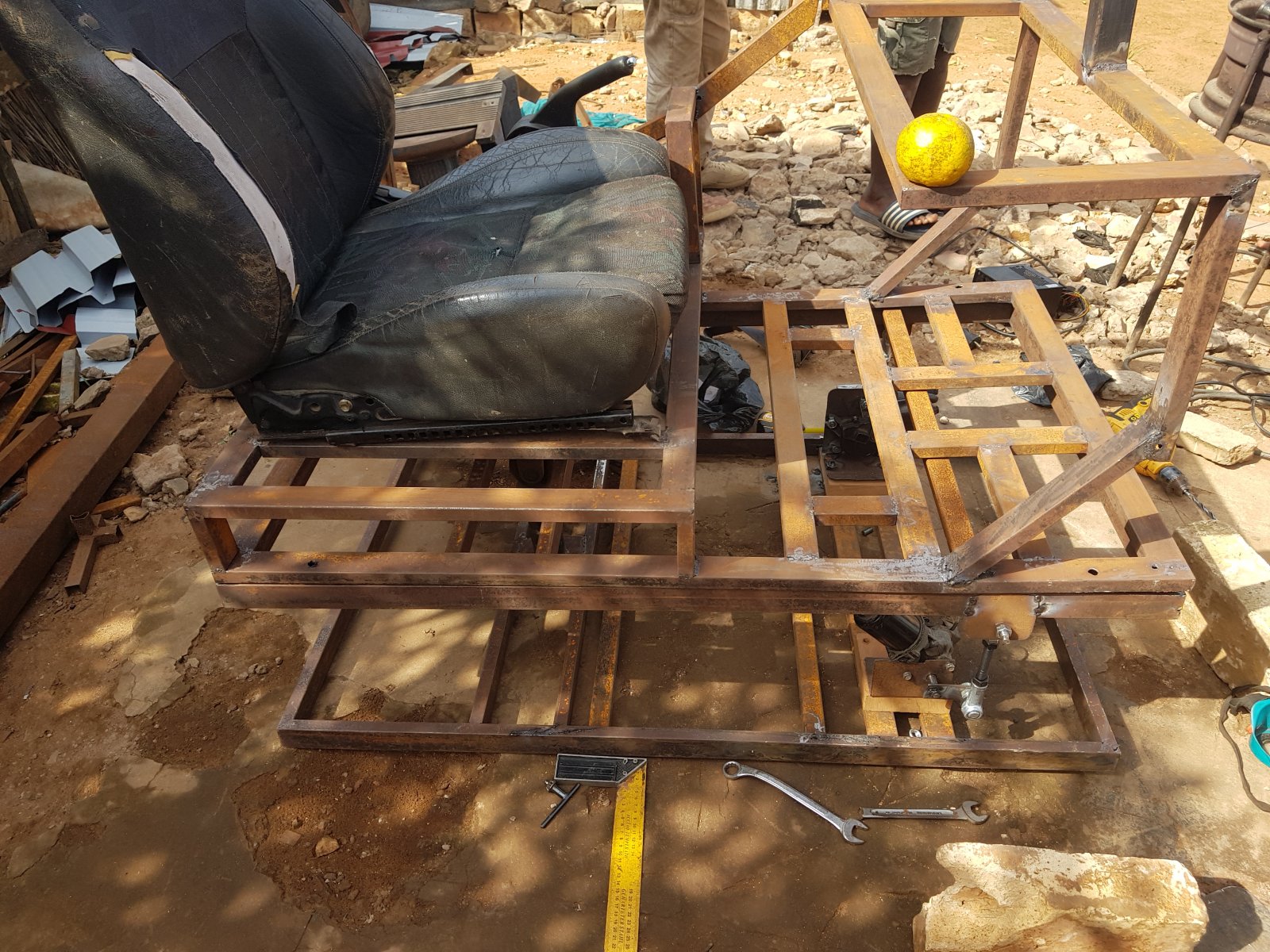

    My project is finished, construction time 2 years

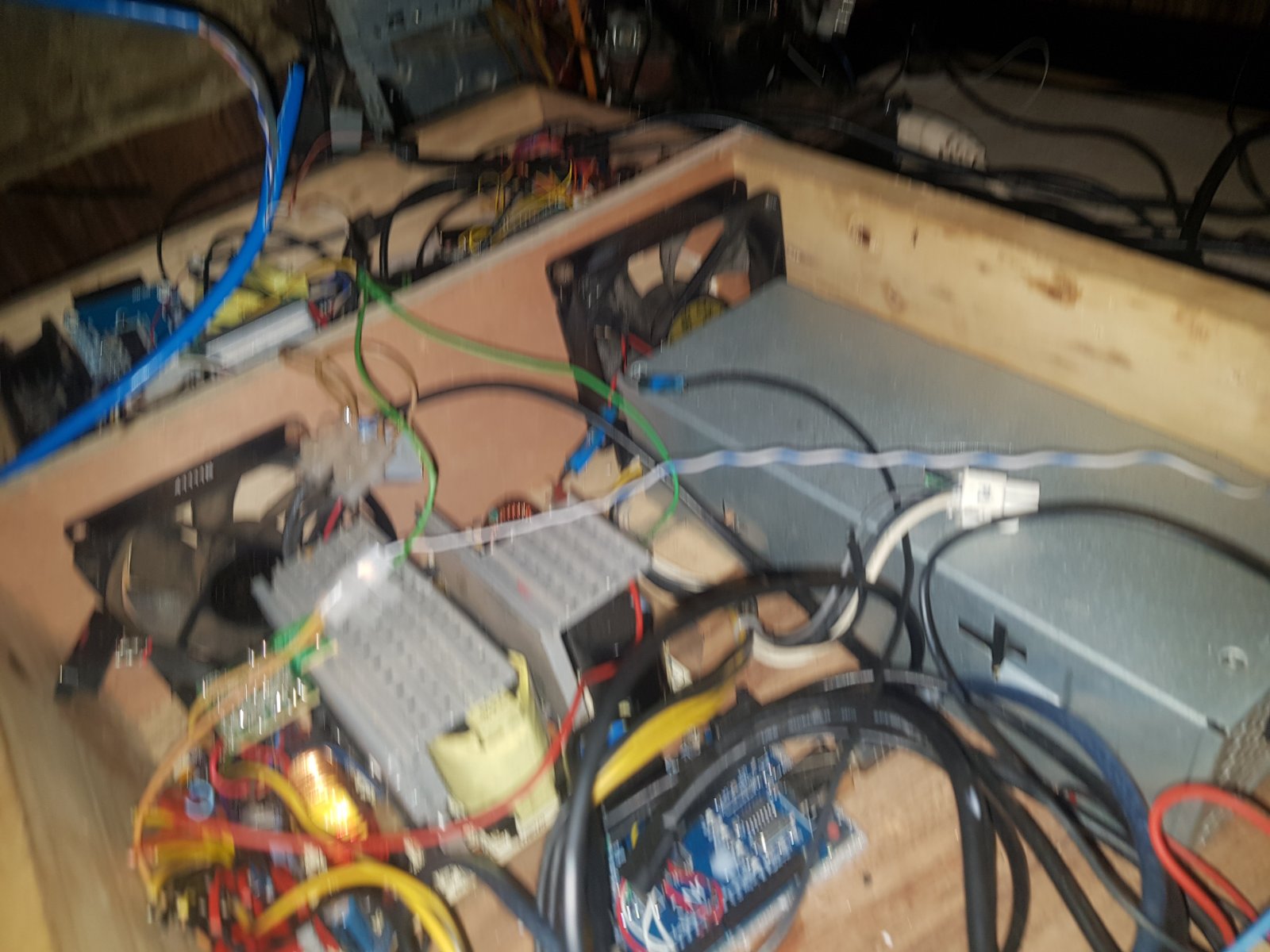

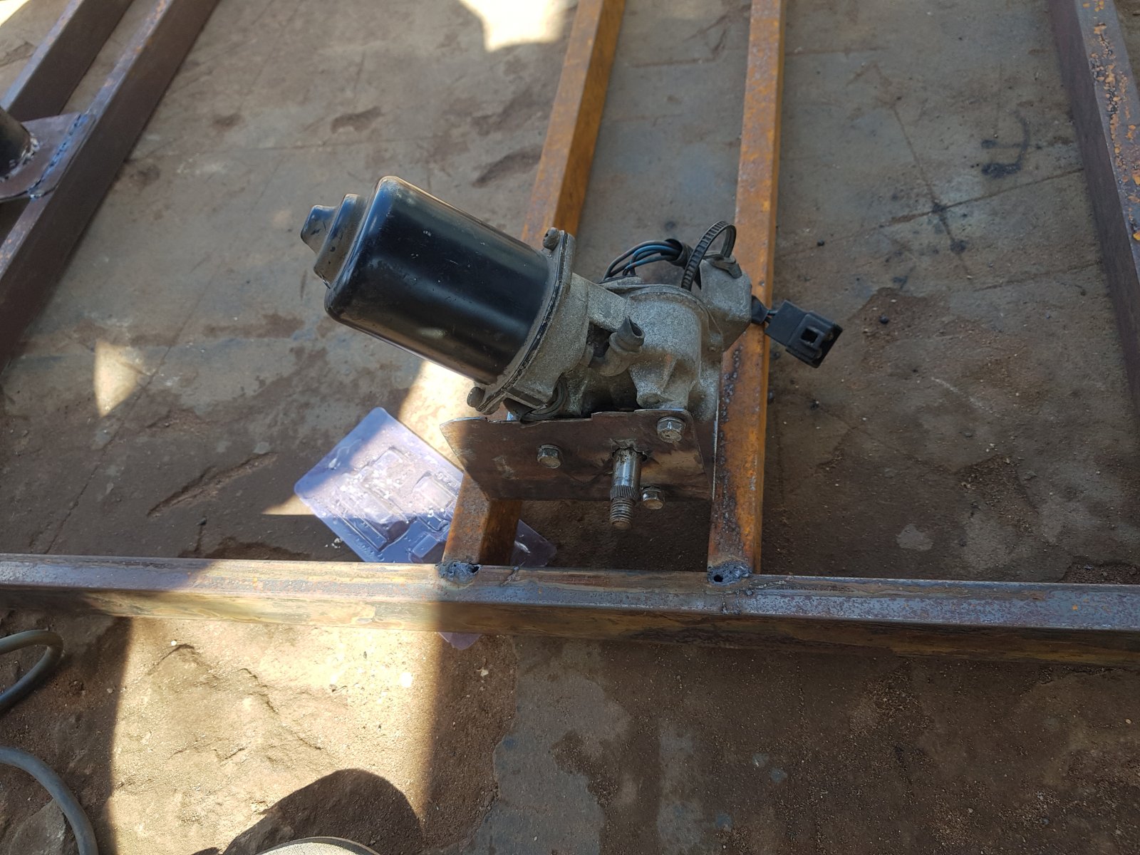

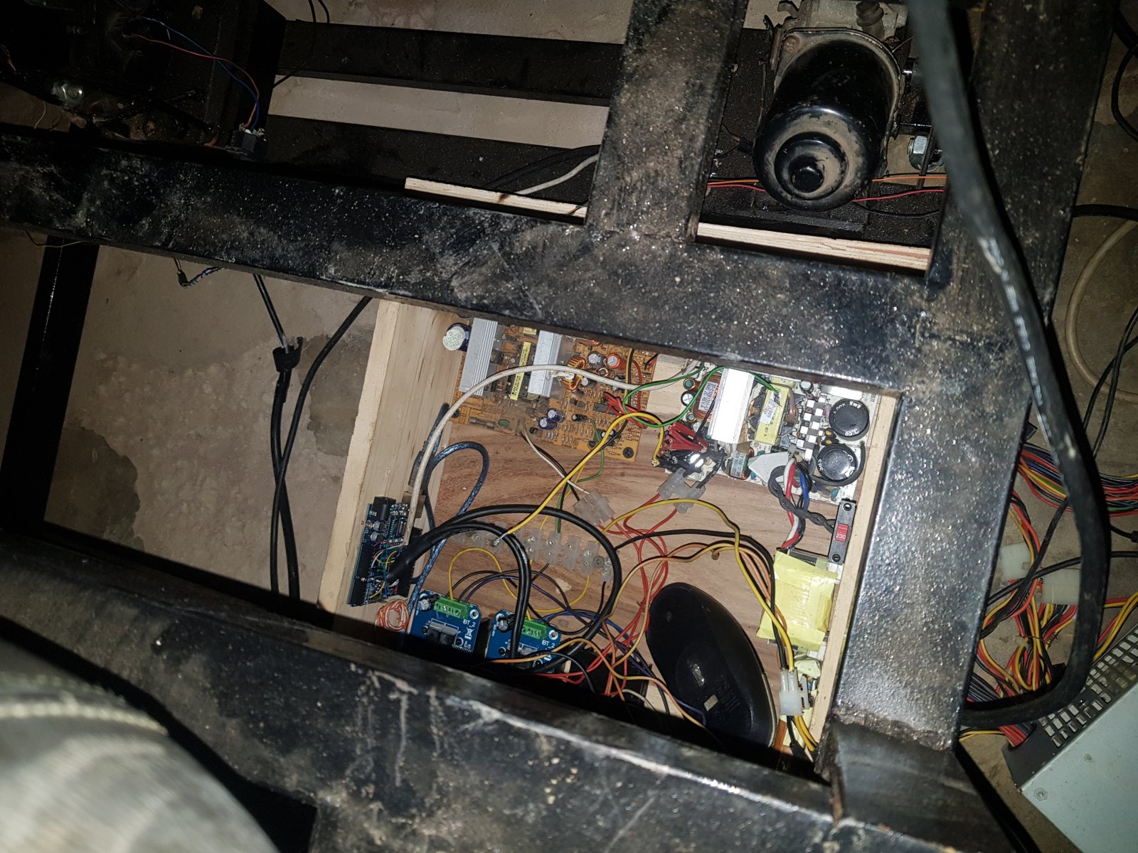

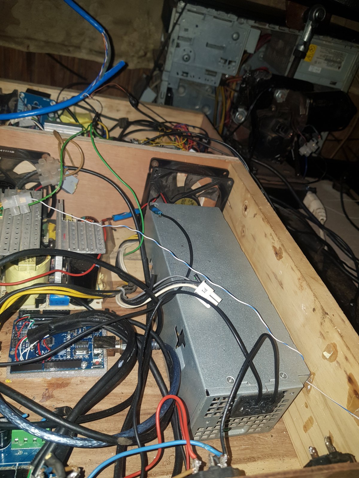

    What code are you using to control it, SMC3 or something else?

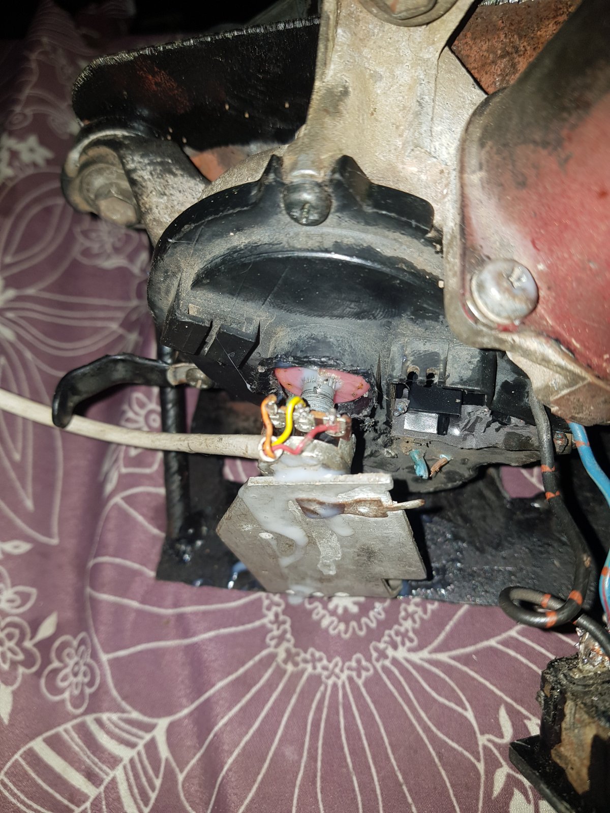

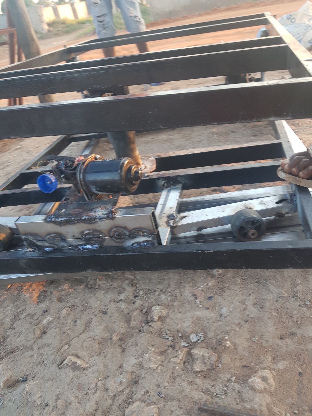

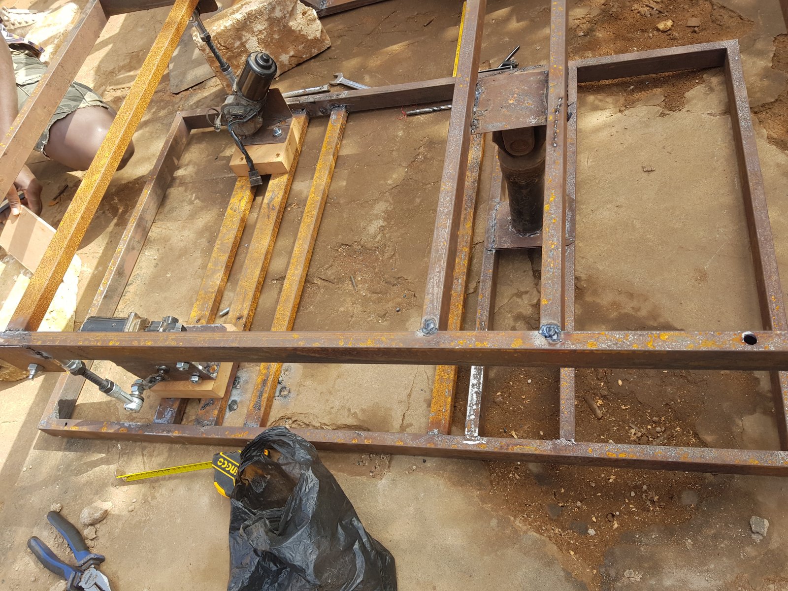

    How do the wiper motors perform when it is under load?
  3. wolverine
    wolverine Wolver projectos
    May 5, 2021
    6
    Estudante
    Mozambique
    796Coins

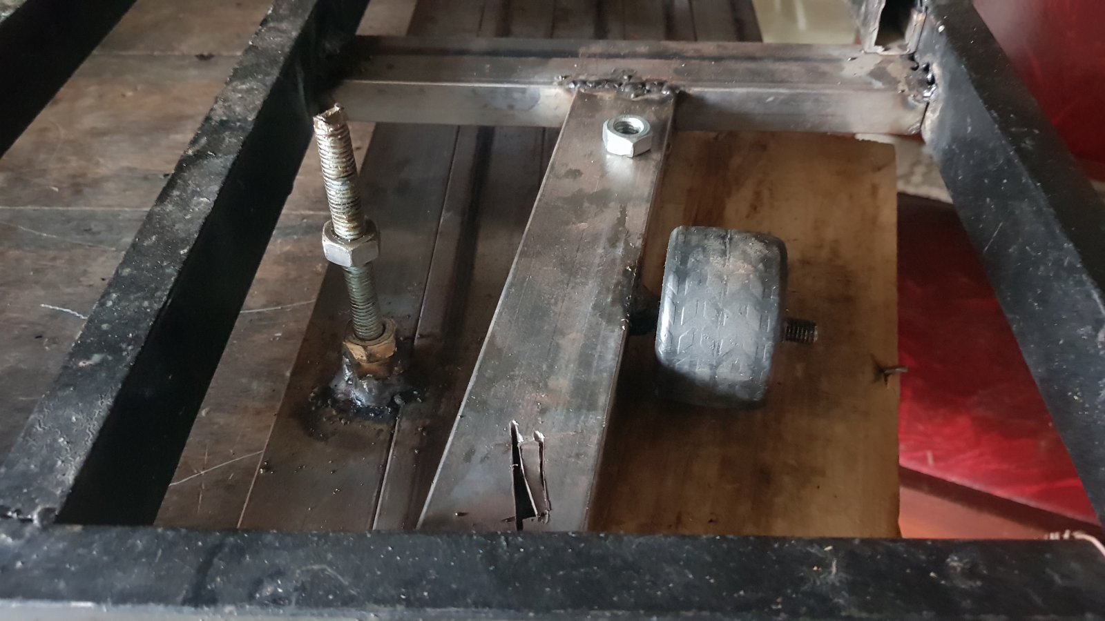

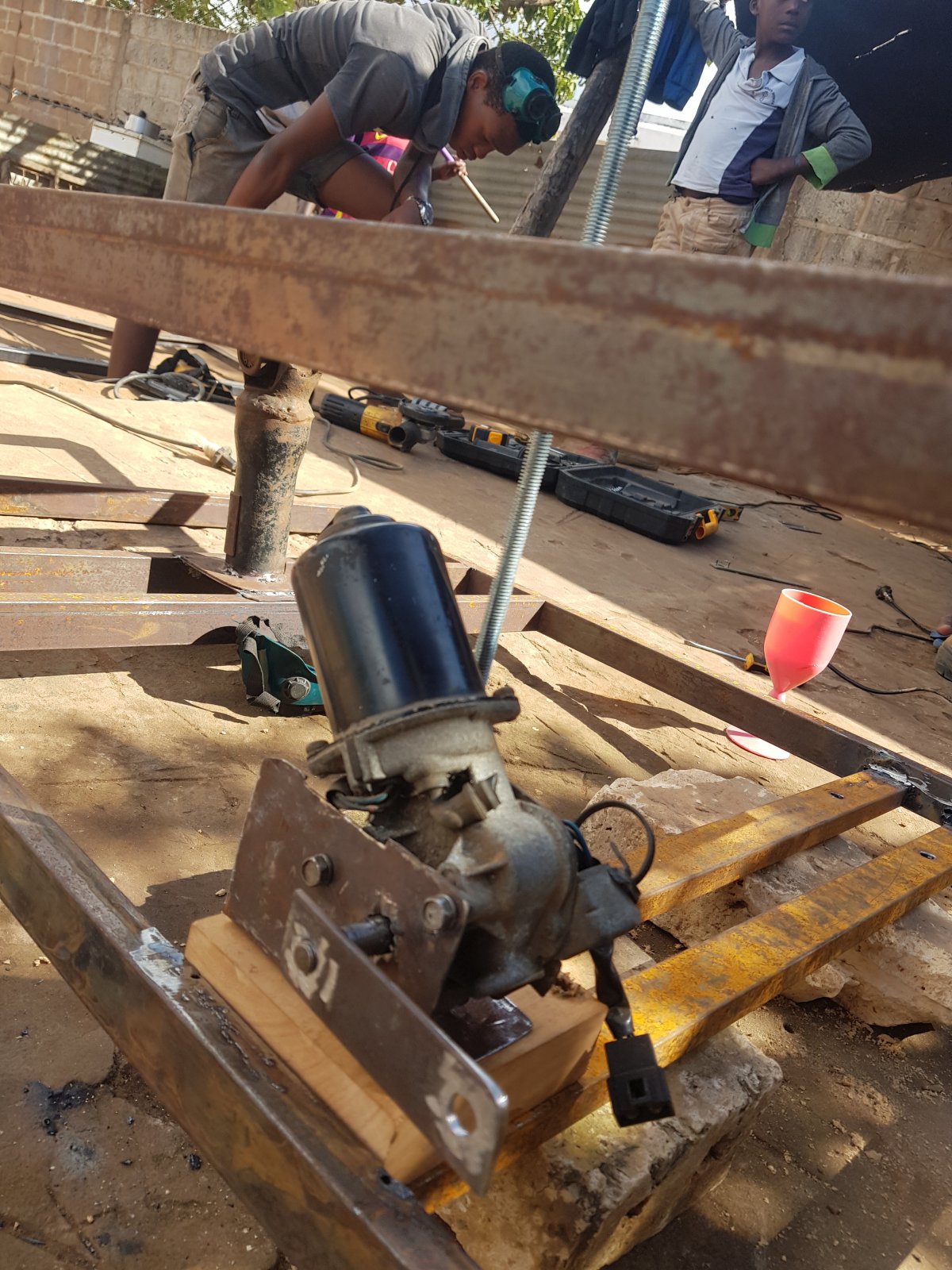

    hello thanks so much for the question! I don't speak English well but I will answer. the code i use is smc3 and the wiper motors work fine even when they are overloaded i don't see much of a problem other than some heating, only the motor that runs with a lot of difficulties is lost traction but the rest works fine, so i'm thinking in putting heat sinks to sharpen the engine that does a lot of work to maintain the temperature. I'm using the wiper motors because here in Africa everything is expensive I can't afford to buy a robust one

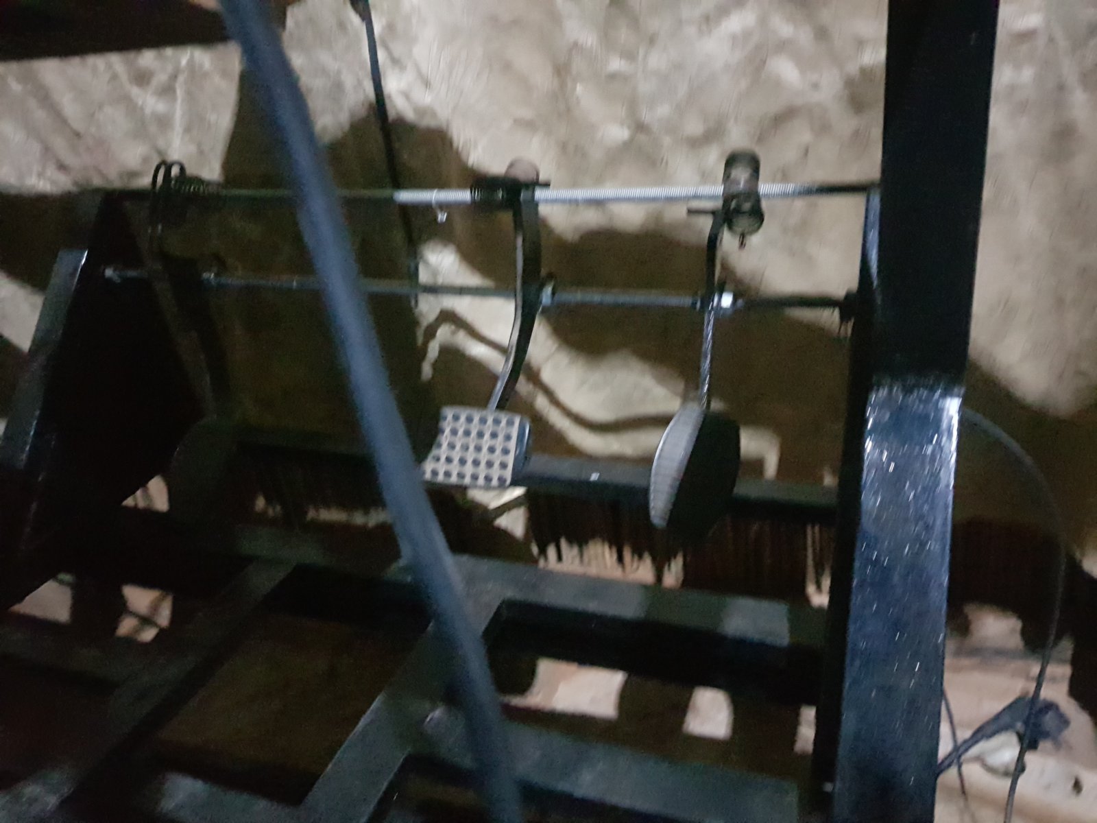

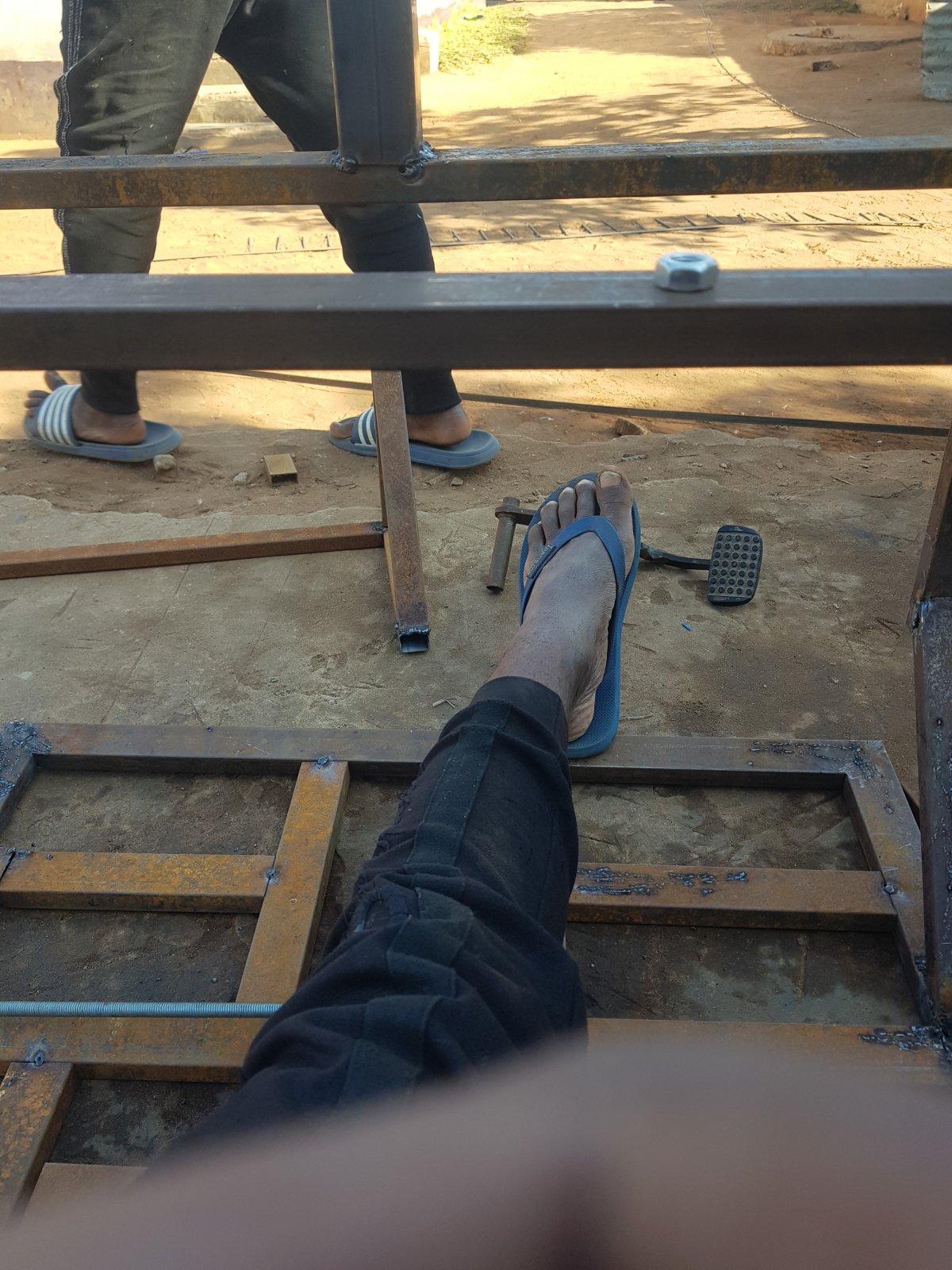

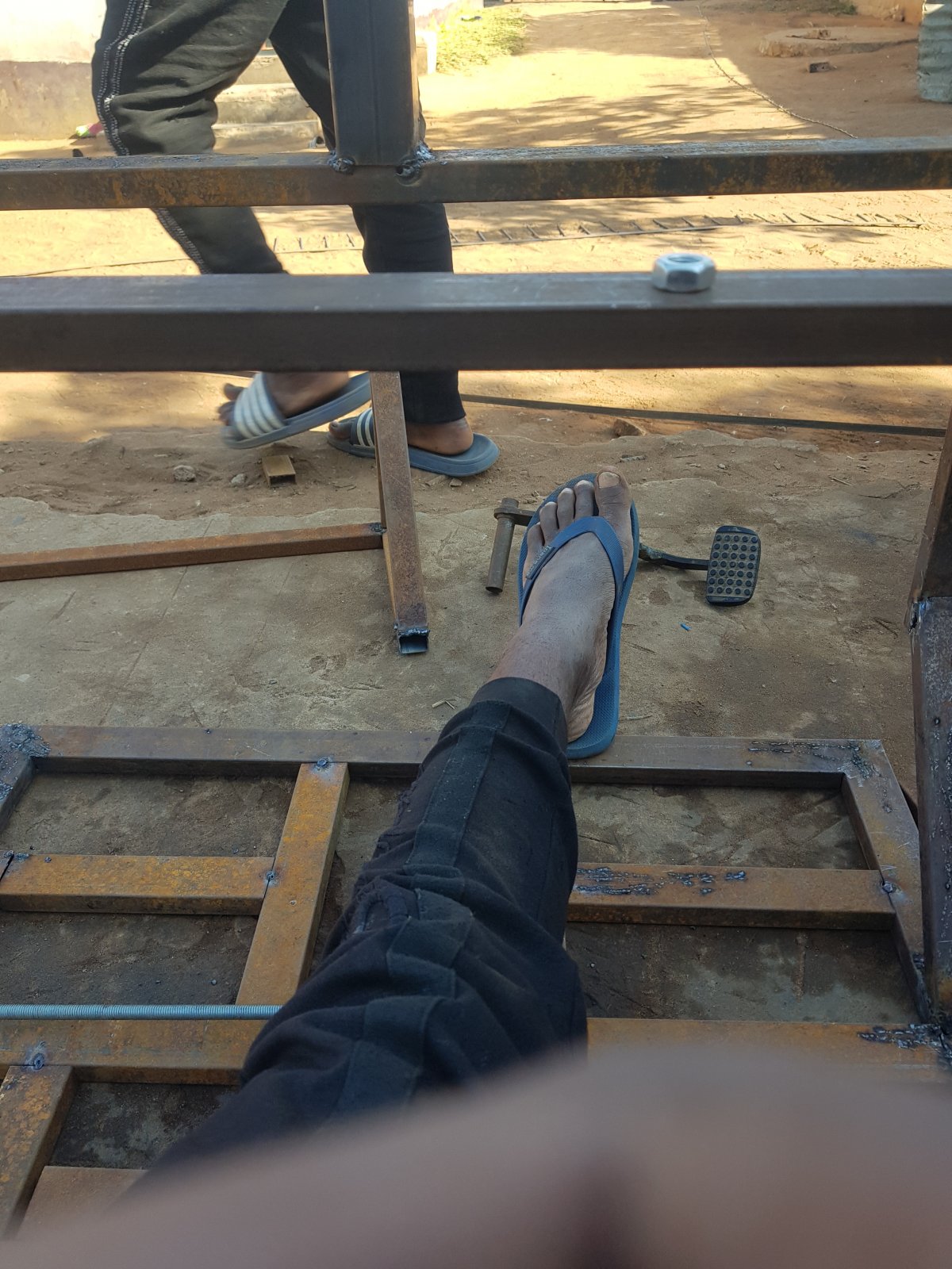

    you are a boss !! 2 dof with traction loss .. show the mechanism of the pedals plz!!
  6. wolverine
    May 5, 2021
    6
    Estudante
    Mozambique
    796Coins

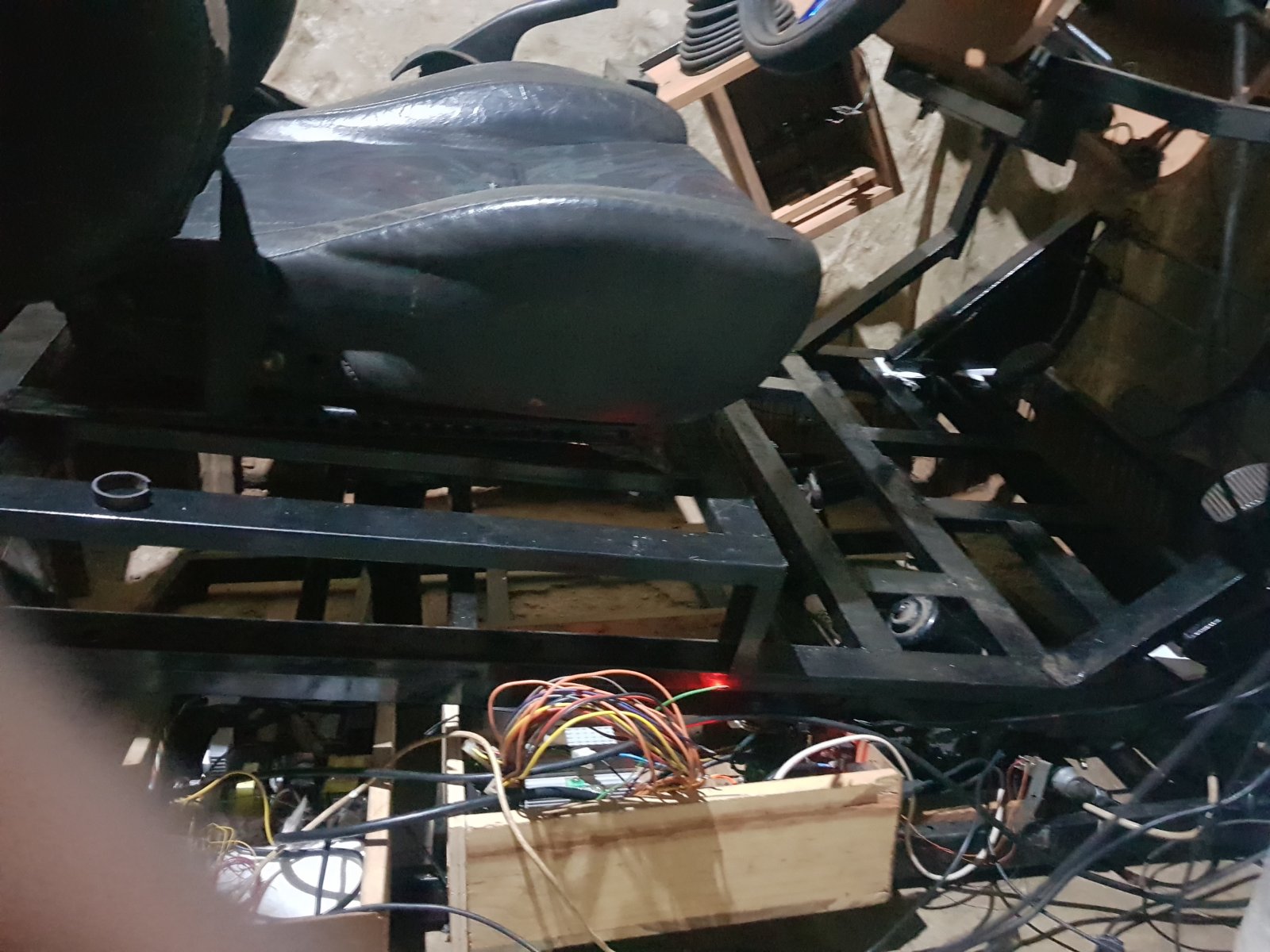

    1. Thanks. For the pedals I'm using sensors, I just don't know how to send you a video showing it.
