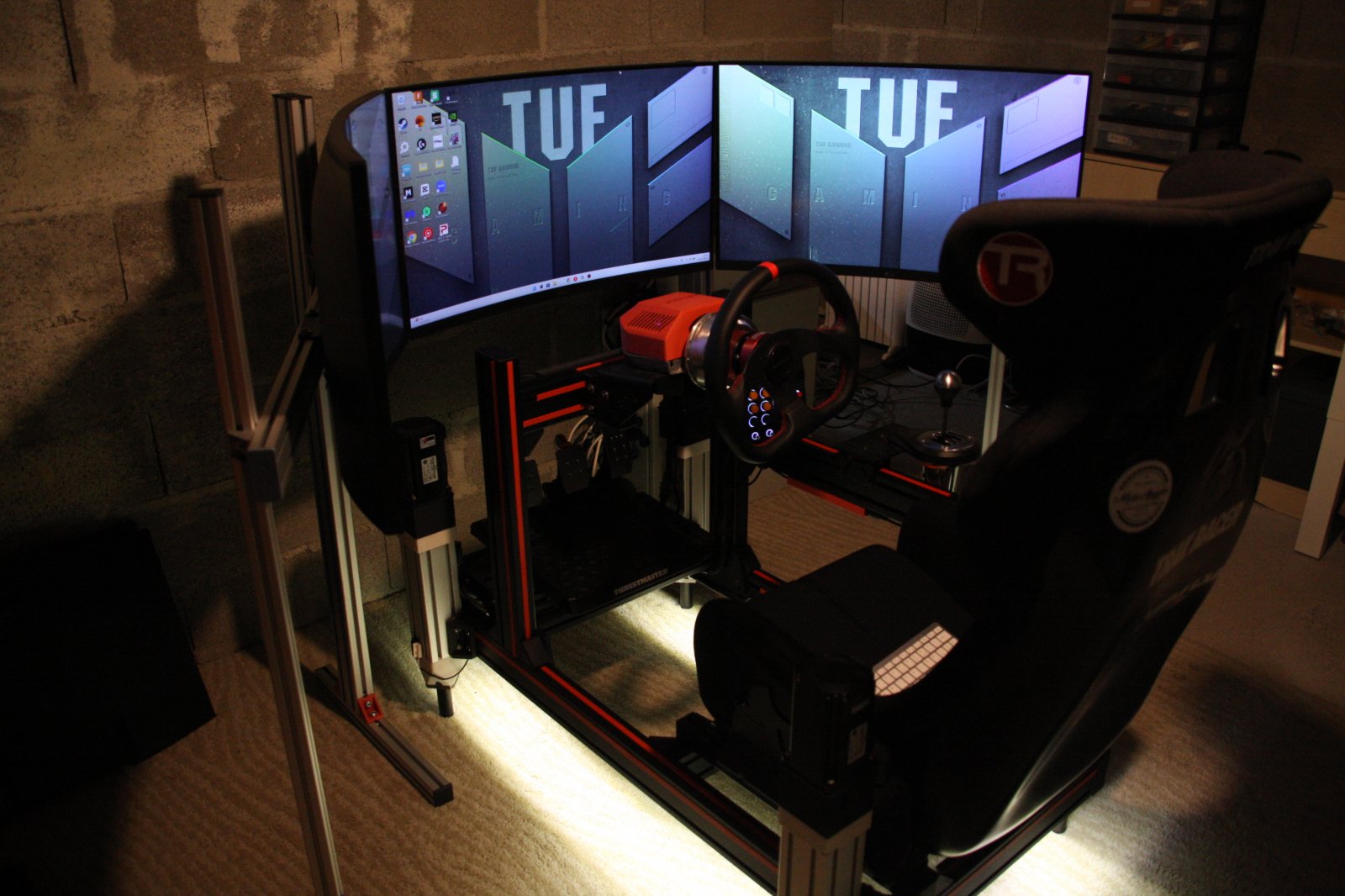

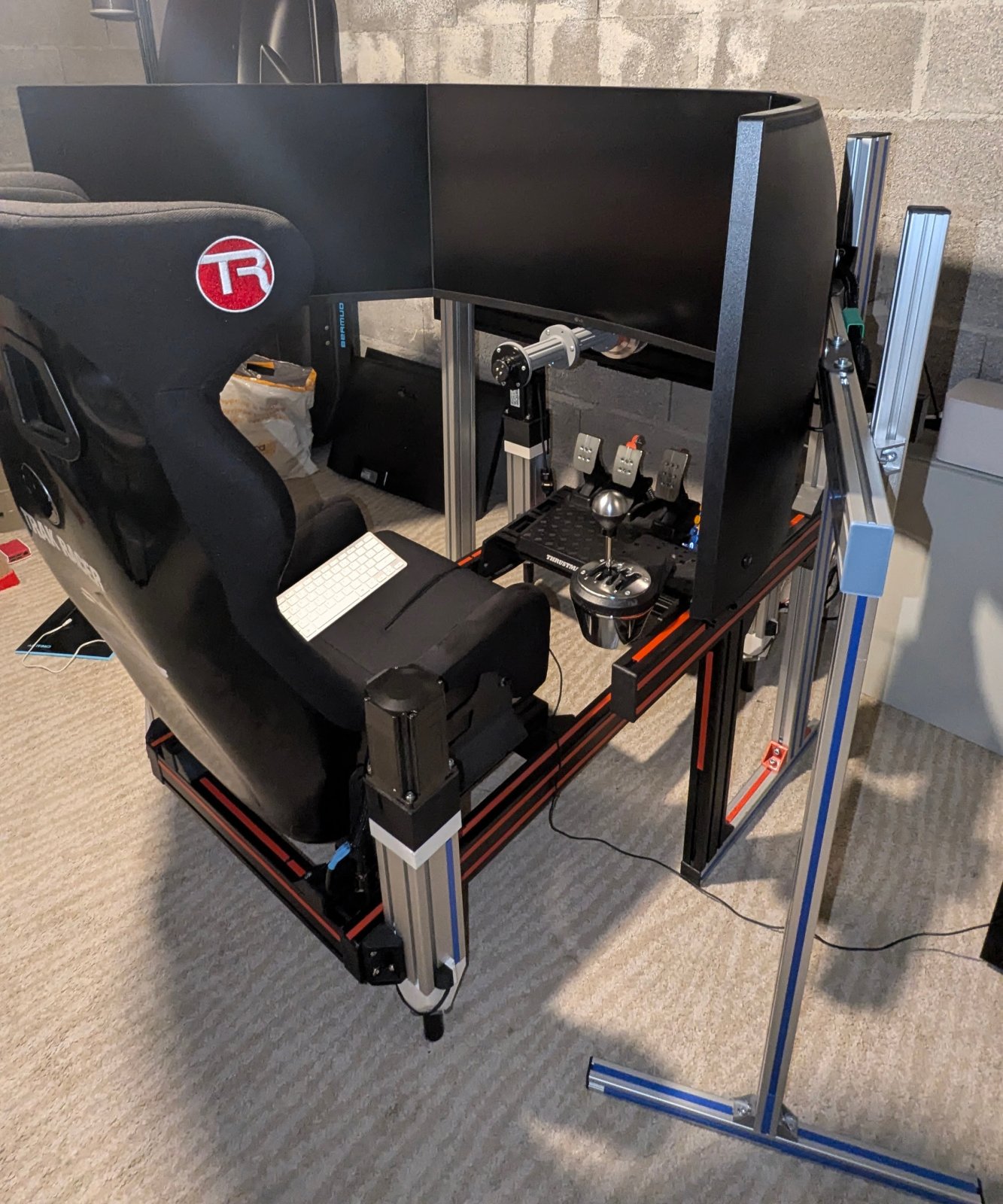

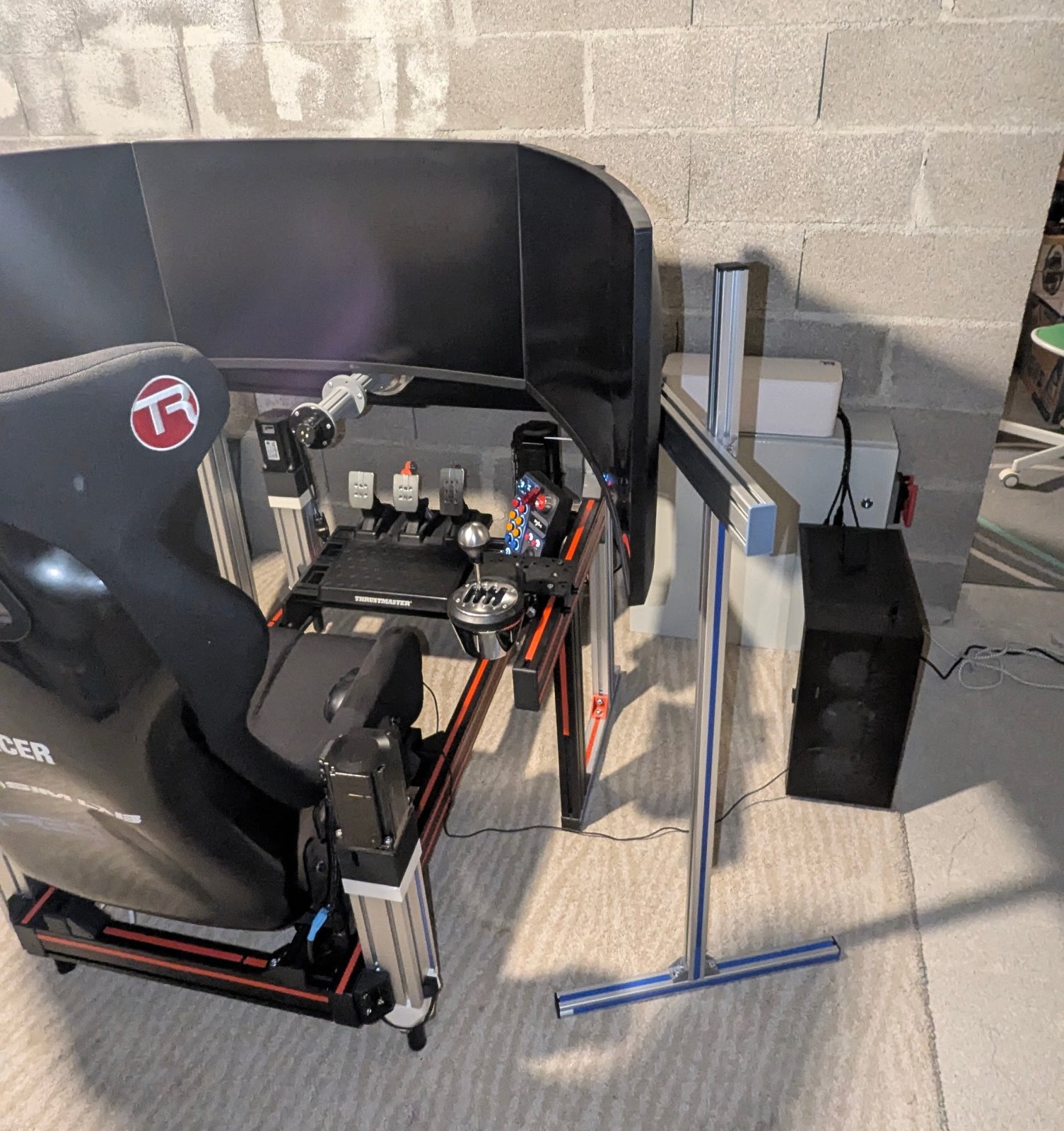

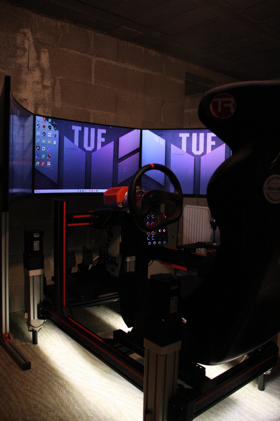

    Hello everyone :) !
    I wanted to share how I built my own DIY racing simulator.
    My goal was to have 4 actuators so it is for sure not the cheapest build but it is much cheaper than the purchasable actuators or well-known DIY ones such as SFX100. As you will see below, I made three different configurations but the minimal config is enough to enjoy your motion simulator. The two other ones are made for those who like to have a really clean build with a dedicated "control center", cables connectors, electrical panel,... In conclusion, you can build your own 3DOF motion platform for only 661€ !
    1. OVERALL PICTURES
    IMG_3787.JPG IMG_3766.JPG PXL_20250510_111332811.jpg PXL_20250510_111317029.jpg PXL_20250510_111258847.jpg
    2. EXPLANATIONS

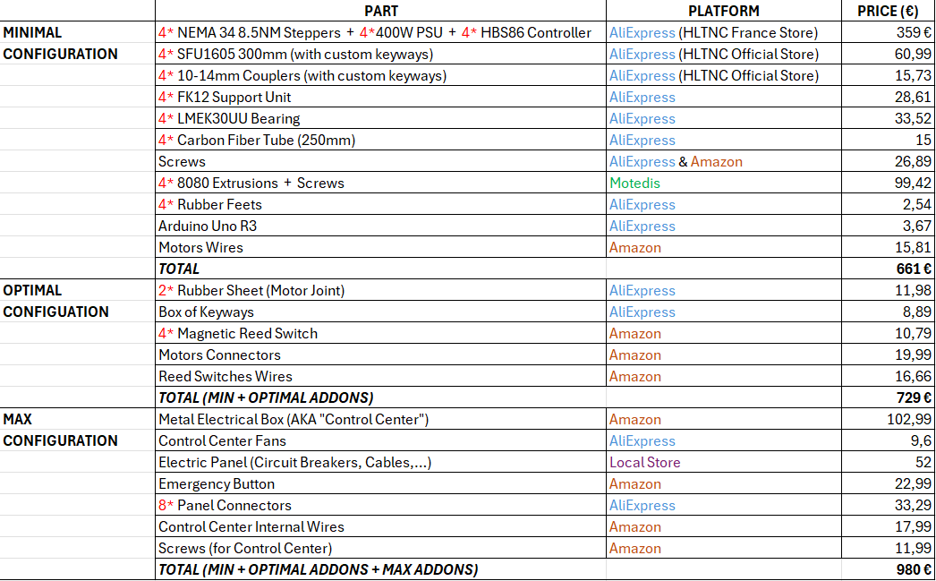

    How did i manage to get it so cheap ? :p
    1. I used the classic components list (ex : SFX100, SRT100/80) but I modified it to use cheaper ones (8080 alu extrusions instead of 100,..).
    2. I spent time online finding the cheapest product or alternatives.
    3. I managed to found them on some websites at really low prices. The "HLTNC France Store" on Aliexpress is almost unfindable but offers prices twice as low as the HLTNC Official (China) Store. I bought a pack of steppers, PSUs and controllers at 360€ instead of 600€ on the others stores. Moreover, they freely ship from Europe so you can probably buy them even though you are not living in France.
    For all the aluminium extrusions, screws,... I used Motedis which serves in multiple countries all around the world. The prices are also really low.
    4. I used STEPPERS ! Lot of people hate them and prefer servos. However, I managed to get them working almost as good and smooth as servos. It is all about the Arduino CODE ! Go to the code section so you can understand what I'm talking about.
    5. 3D Printing : I 3D printed as much as I could, even the ballscrews nuts.
    6. AliExpress offers really big coupons, just wait a few days or weeks so you can get a 80-100€ discount when buying ~500€.
    List of Components :
    I did not include the basic tools you have at home or some consumables such as Lithium Grease or PLA Plastic (~25€) as most already have them (especially if you have a 3D printer).

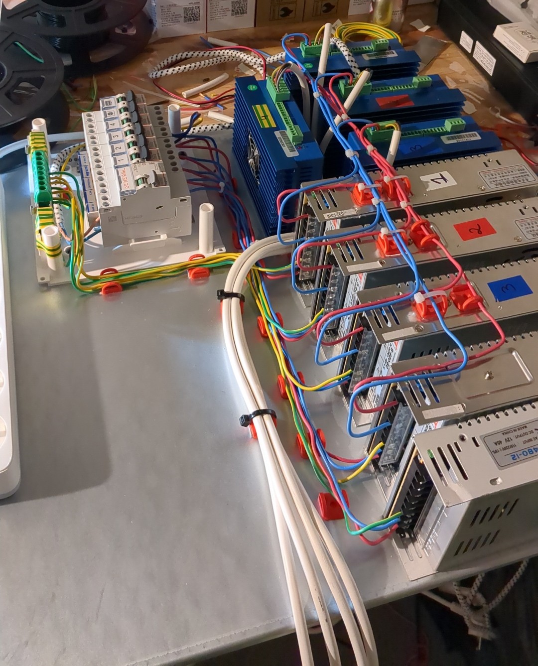

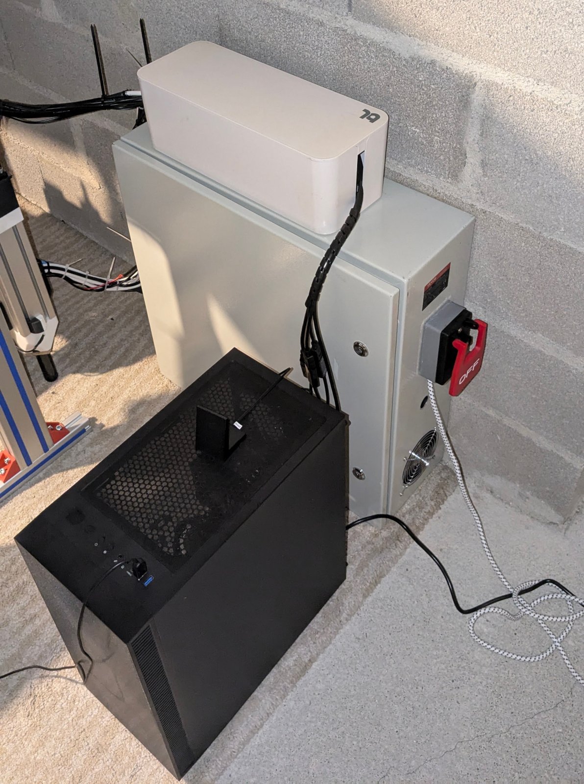

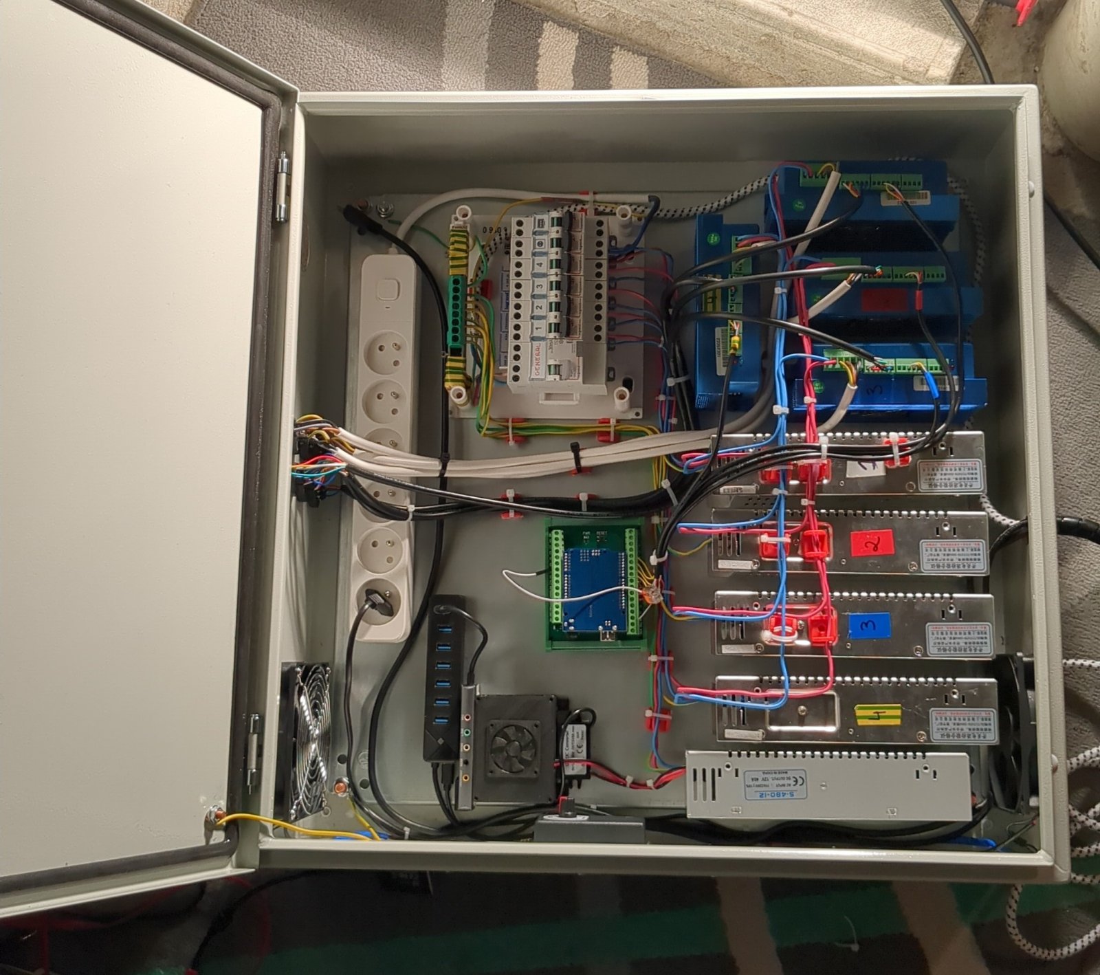

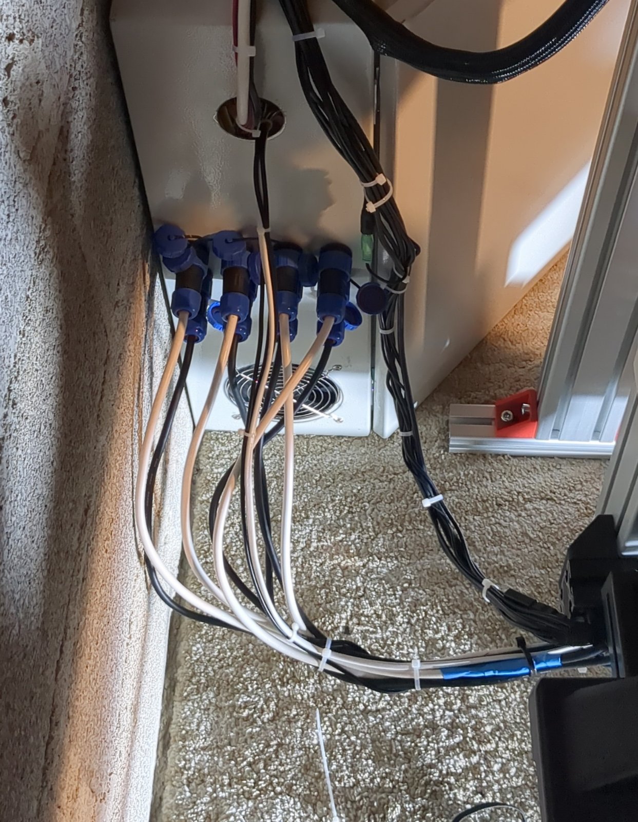

    Nice features I added :cool: :
    - Everything is centralized into my "control center" and one button initializes the whole rig. This makes the experience more fluid and less painful, while having a clean build (no cables going everywhere). Also, it features fans, an electrical panel and an emergency button that cuts everything off.
    IMG-20250206-WA0002.jpeg IMG-20250212-WA0000.jpeg PXL_20250510_111258847.jpg

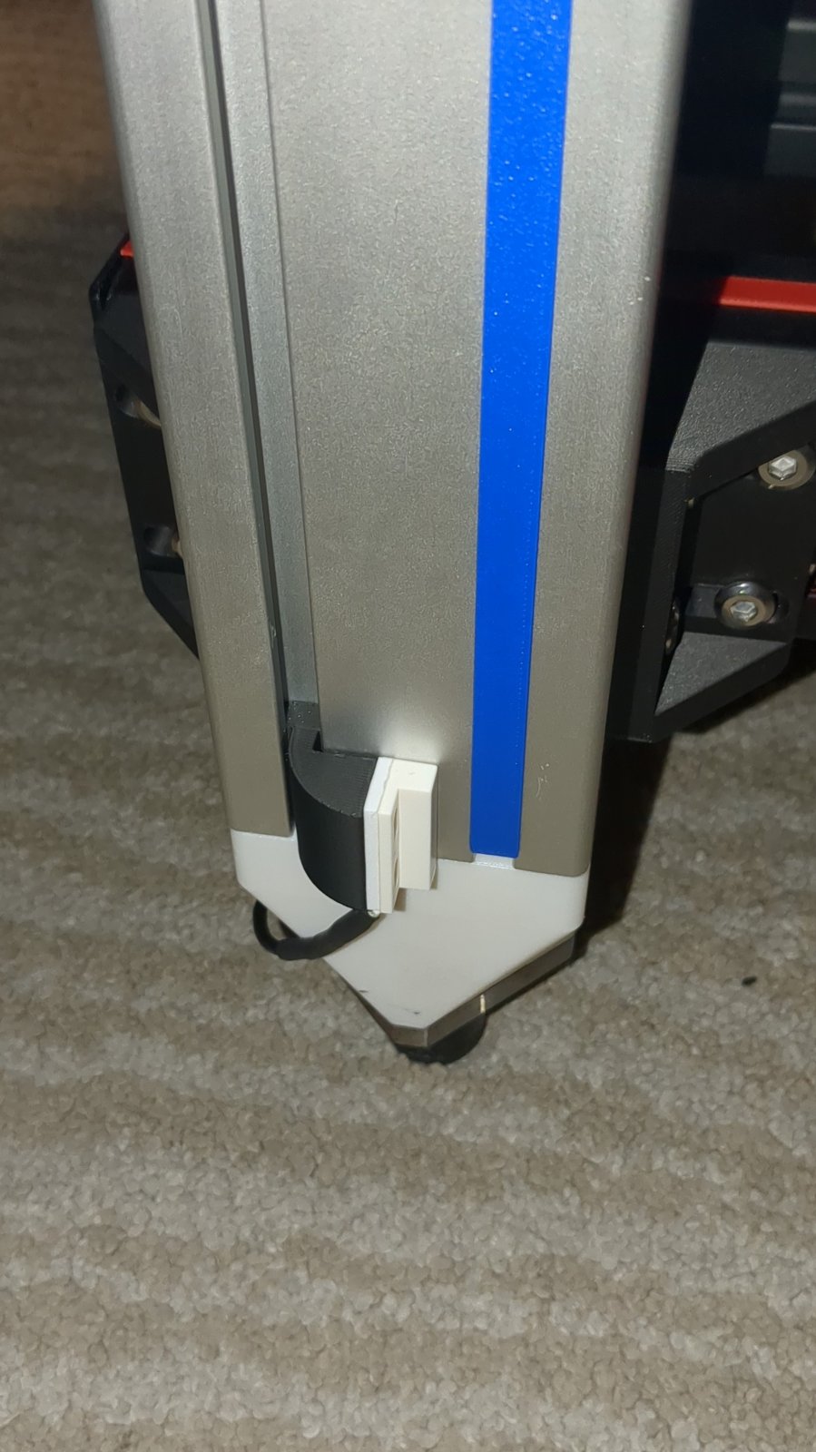

    - Automatic calibration : at each startup, the actuators calibrate themselves using magnetic reed switches (magnets are placed on the slider, and the switch on the aluminium extrusion).
    - Connectors : I placed cable connectors between the actuator and the rig and between the rig and the control center. If I need to make some adjustments or displace my simulator, it gets very easy.
    - Motors Rubber Joints : helps reduce the steppers vibrations.
    - All-in-one custom nut and slider : I designed and 3D printed my own nut with also serves as the slider. I can now easily get my tube fixed onto it (and easily remove it in case smthg breaks) and place the calibration magnets.

    I use four 60v power supplies as I have four actuators. I'm having no any problem with overheating.

    BTW, great job with the electronics enclosure to, Steel enclosure with proper grounding :thumbs
