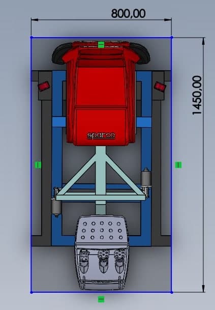

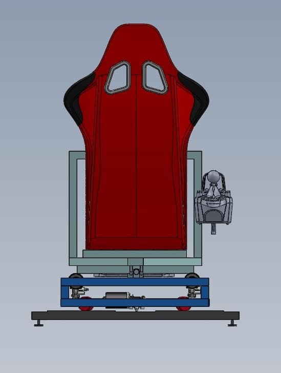

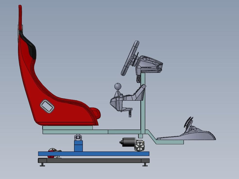

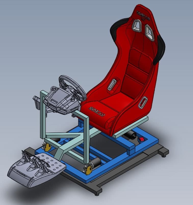

    nice to meet you all, starting today I'll be uploading as much info about my build as possible, wish me luck!
    the idea is to build a 3DoF system pitch roll and yaw, I found some lift motors here in Argentina that might work
    the motors specs are 39NM 60RPM at 12V, it can do also 24V but I'll have to see how it handles the load
    here are some pictures of what I'm intending to do!
    Frame design:
    photo_2021-06-23_18-02-46.jpg photo_2021-06-23_18-02-57.jpg photo_2021-06-23_18-03-02.jpg photo_2021-06-23_18-03-10.jpg

    Hello and welcome to you!
    Your project seems to be going well, your motors will be sufficient, I have 16Nm / 48RPM on my simu and it does it well!
    Your structure will be steel and welded?

    Hi!
    yes the structure will be steel and welded, I was thinking about aluminum but it cost a lot here where I live plus the welding equipment is also expensive.

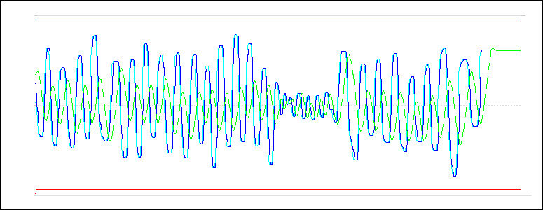

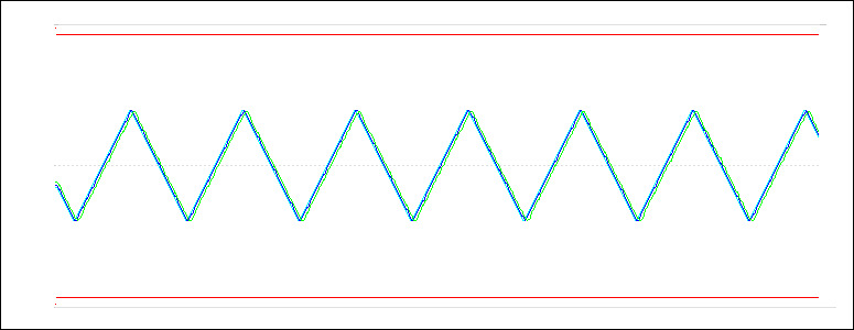

    regarding the motors I had some doubts about the RPMs when I did the SCM3 PID it tracked fine at 12v 60rpm but on very fast movements it lagged behind so I was thinking on using 24v to double the RPMs but if you experienced good results with 48rpm I think I'm overthinking the issue
    here is a picture about the fast movement manual tracking, this is with no load on the motor so I imagine that with the seat on top and me the pids will have to change

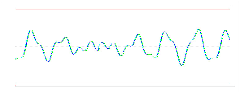

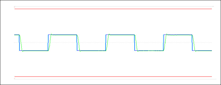

    SCMUtils test modes:
    Motion: Square: Triangle:
    Maybe what I see when doing fast manual movements is not about the rpm but the ramp up speed of the gearbox, it might do 60rpm but to start the movement it takes more time
