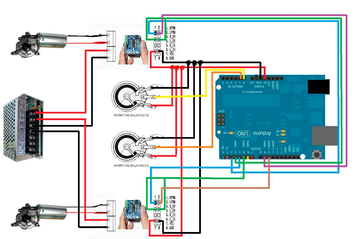

    Hi all!

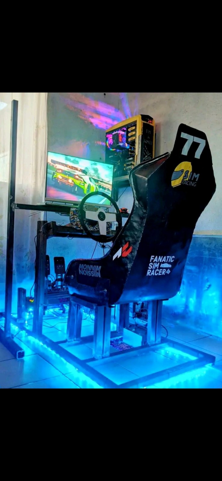

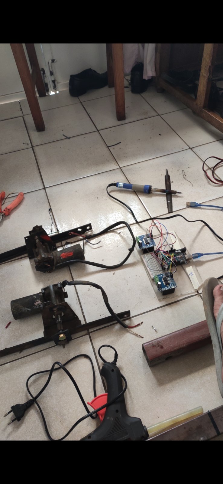

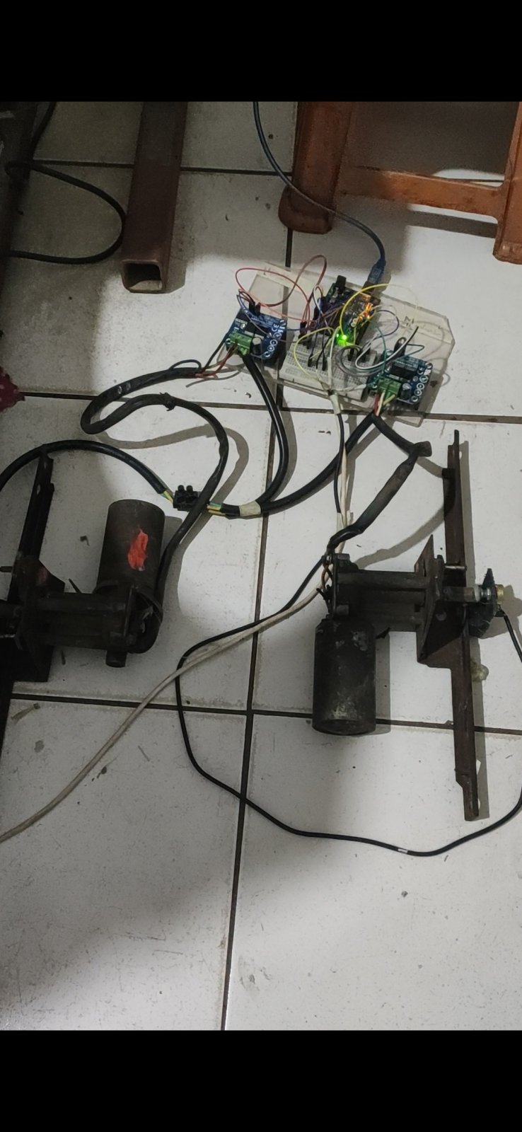

    My project consists of a movement simulator for a simracing playseat
    List of materials:
    *2 potentiometers 10k to know the position of the movements or the position of the playseat

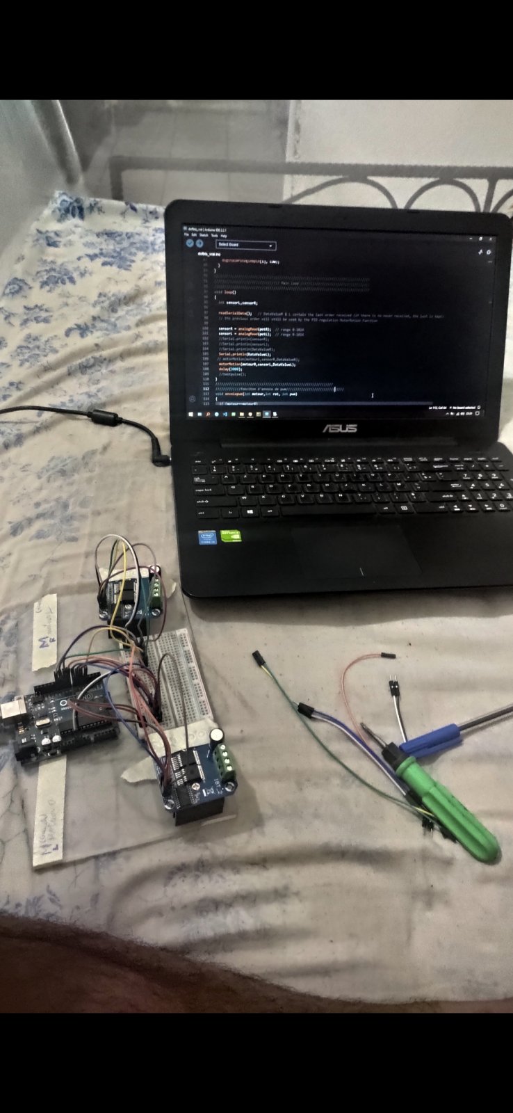

    *2 wiper motors DC from old cars
    *2 bts-7960 24V 43A to control the two motors
    *Arduino Uno R3 microcontroller programmed with the scm3 code to receive the data and to control the two bts
    *DC 12V 20A power supply
    WIRING
    ASSEMBLY
    TEST
    Test VIDEOS
    TEST SCM3

    Did this setup work for you?

  3. fagtk1998
    fagtk1998 New Member
    Sep 3, 2023
    0Coins
    2DOF, 3DOF, DC motor, AC motor, SimAxe, Arduino, Motion platform, 4DOF, 6DOF
    Yes, it worked!

  4. fagtk1998
    Sep 3, 2023
    0Coins
    You just need to connect the pins correctly and that the potentiometers are in their place and in the correct positions.

    Did the wiper motors move well?
    It's 12v from what I saw, was the 20a PSU enough?
  6. fagtk1998
    Sep 3, 2023
    0Coins
    yes the motors move well when the potentiometers are in the correct position! use the smc3 tools to find the placement of the potentiometer turn!
    For the power supply, yes it's 12v 20a!
    It's enough for a 2dof, you can also use power for fear!
