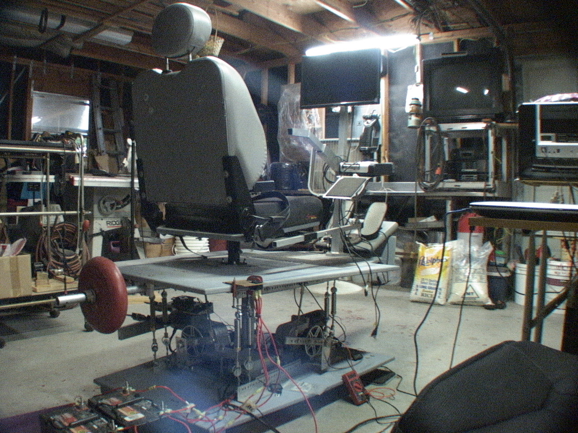

    I built my simulator, a hybrid between Floreskies simulator and a Joyrider simulator from photos of Floreskies simulator…with the exception of the motors and electronics. The U-joint came from a 1980’s BMW, I cut it to length, (about 17 inches)… too high and you get balance problems, and to low, one has a problem visualizing the motors and the accompanying electronic hardware, not to mention working on the darn thing when everything’s put together!
    A description of the simulator : Platform balance simulator utilizing
    2 ea. wheelchair motors 24 volts (derated it to 12 volts)
    2 ea. DeLinks from Dimension Engineering
    2 ea. Kangaroo x2 from Dimension Engineering
    2 ea. SyRen 50s from Dimension Engineering
    6 ea. Trunk lid springs for balance…from the internet
    1 ea. Drive shaft and U-joint to be cut and welded.
    Balance weights on the rear of the simulator
    2 ea. 12 volt 55 amp hour wheelchair batteries
    1 ea. 20 ft roll of wire 10 Gauge from an auto store
    Various pieces of aluminum and steel for the under
    carriage.
    2 ea. 4ft x 8ft - 5/8 inch thick birch for the platform
    4 ea. rod ends
    1 ea. A length of 36 inches of all thread rod.
    I started the project in January ’14 and took a couple of months off and finished (?) in October ’14. I must give a shout out to Dimension Engineering http://www.dimensionengineering.com/ for all of their help in getting this project off the ground. Charleen and John were instrumental when I hit a problem. Also, I can attest to Dimension Engineering’s electronic hardware guarantee….. Bulletproof ! Also I would like to thank everyone who had anything to add, and a Guide to setting up SimTools for use with the Kangaroo motion controller

    Thank you for responding. This is the second simulator I've built, the first was a joyrider converted to motors. I prefer the platform due the fact of a smaller footprint and it is easier to get into and out of.

    Hi @jsmith2307 nice construction there. Can I ask why you used the trunk springs for balance, when you also have a counterweight on the back of the rig. Does it not interfere with the amount of force coming from your motors? Regardless, you have made a nice looking sim. :thumbs

    Thank you for responding. The counter weight is for reduction of motor work on the Y or Pitch Axis. When things are in balance it makes for easy motor work on the affected axis. The X or roll axis is only 15 degrees, only a small increase in the workload. Things will change as I continue testing! (Did I answer your question?)

    Hi @jsmith2307 thanks for your reply. I asked about the springs because I remember reading in the forum some time ago that springs may help with backlash on the motor's gears, but they detract from the simulated motion. I just wondered if this was something you had researched in creating your hybrid.
    Mike
  7. bsft
    I suggested the light spring idea and used it years ago when I was running wipers, It created a light load on the motors to help them mesh, a $5 spring saved a $10 wiper.
    People tried this with stronger worm gear motors and it doesnt need them.
    Spring used like that are a frame design balance issue or to try to hold it up when power is off for looks. It reduces the overall motion and takes away the finer motions.

    Yes, you are correct it may detract a little bit, especially the roll axis but the balance kind of outweighs the detraction. Besides, it acts to return the simulator to it's original position quickly. Its early in the testing, I may decide to forgo them at a latter date!
