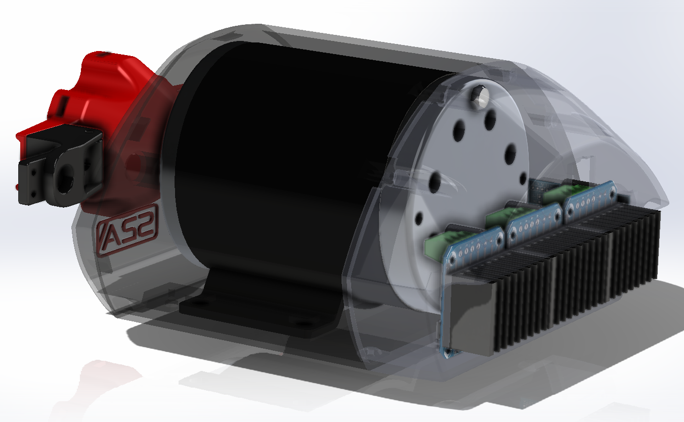

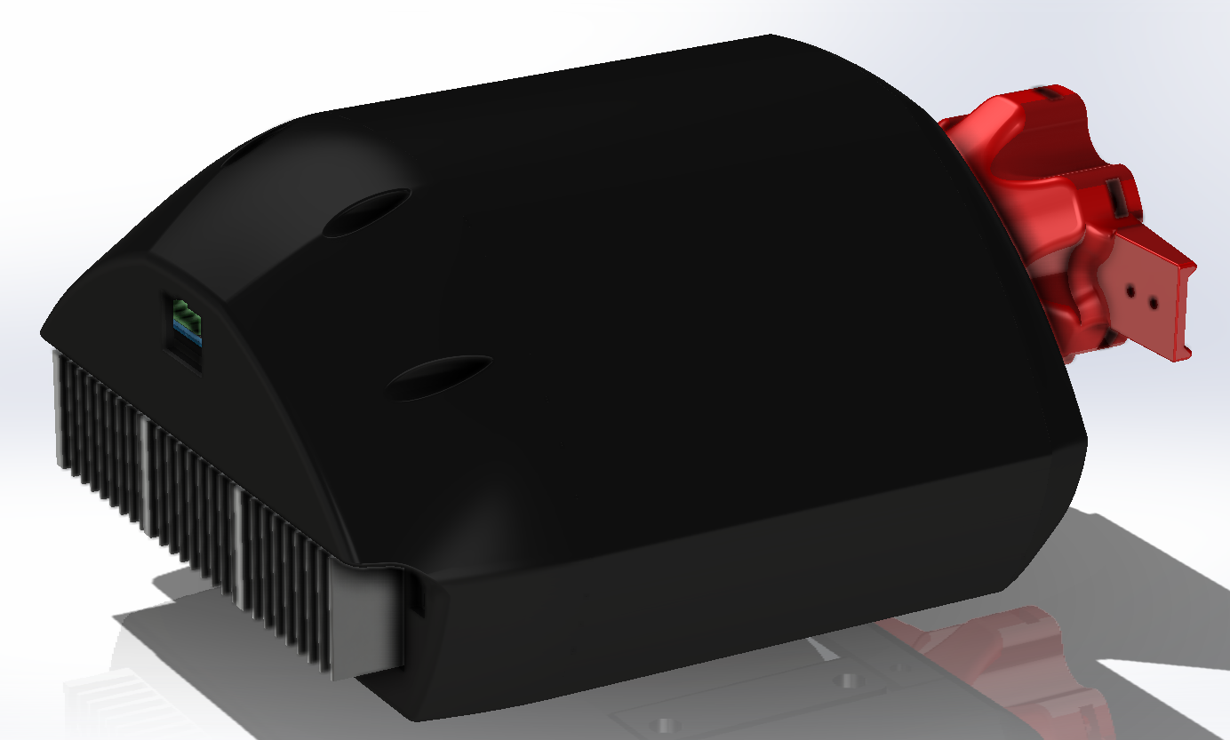

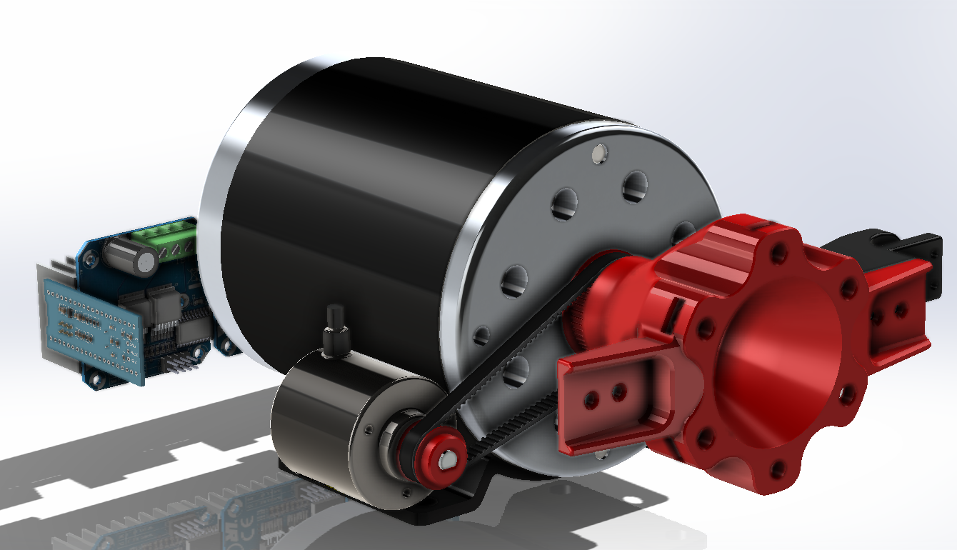

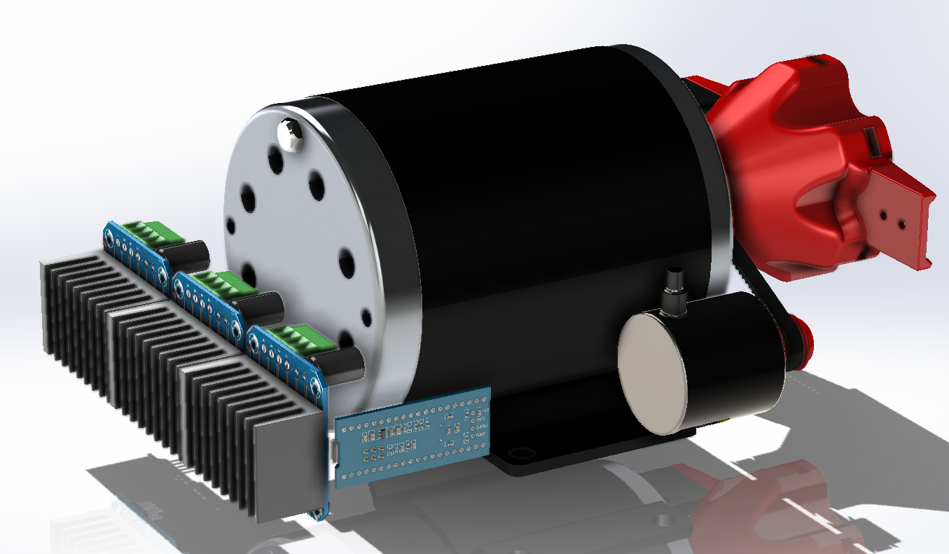

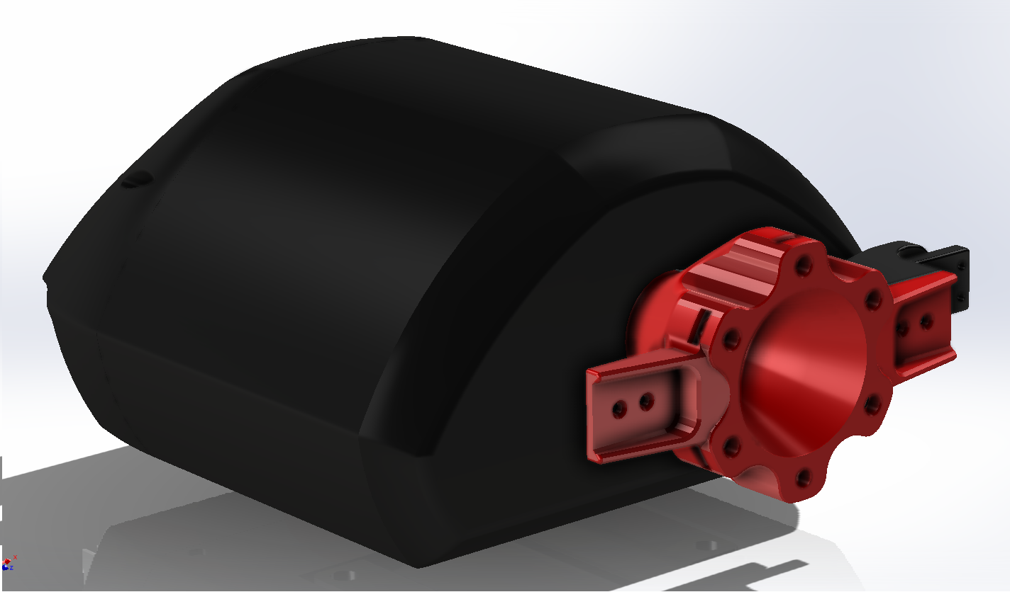

    Hi everyone this is my project with a 850W MY1020 motor. I´ll start with one BTS7960 H bridge and a 12V 10 Amp power supply and then when everything works properly upgrade to 3 H bridges and probably a 1000w power supply. The encoder is belt-driven because i don´t have the tools to do a proper direct drive to the motor shaft but i have a 3D printer so i can easy do it that way. will be driven by a gt2 belt with 2:1 gear ratio to duplicate the ppr of the encoder.
    i let you some renders of the project and i wanna know what you think.
    Thanks and sorry for my English is not my native language.

    Your motor has high power but low torque. If you replace it with a power steering motor, the torque will be higher.
