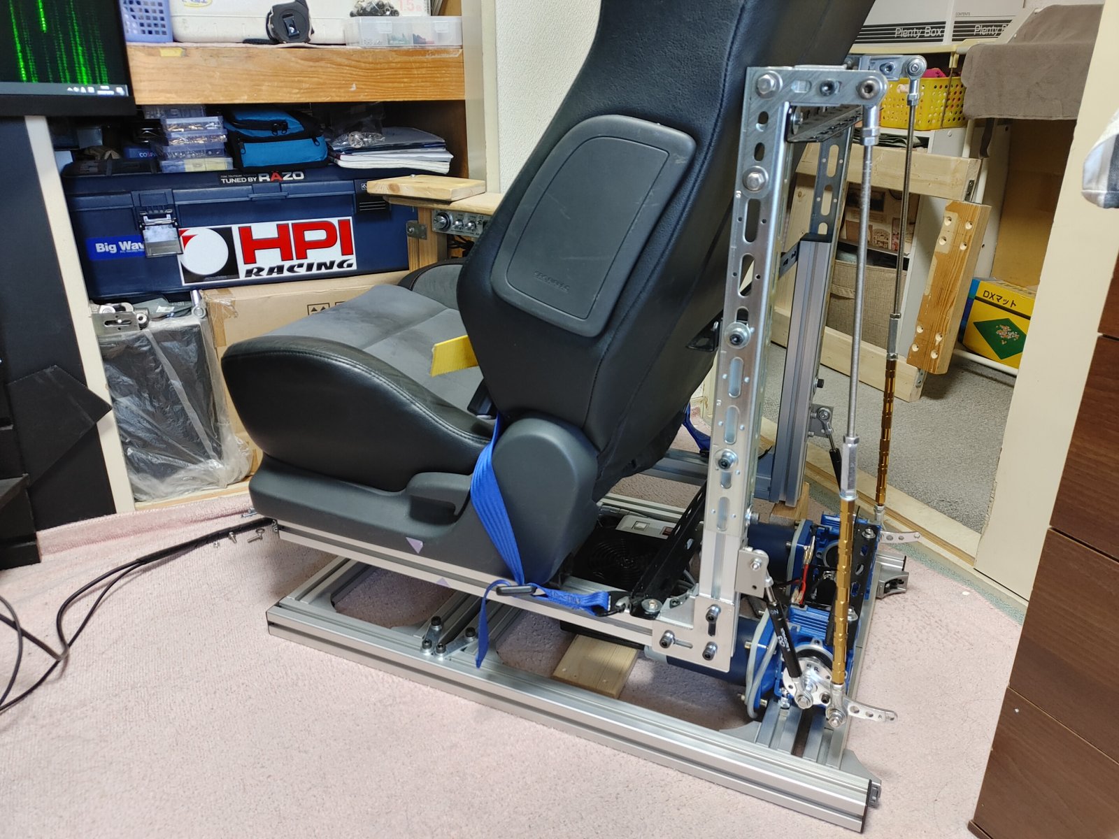

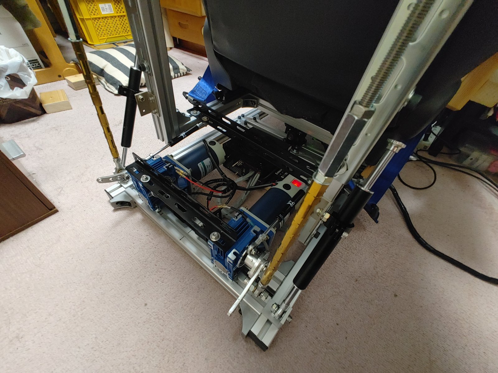

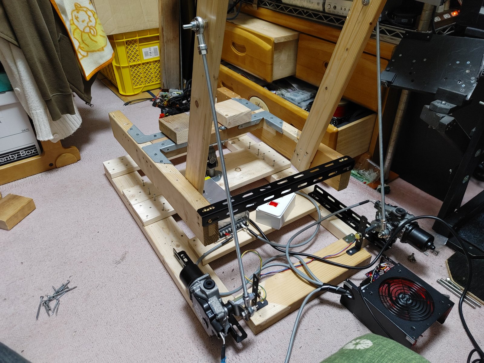

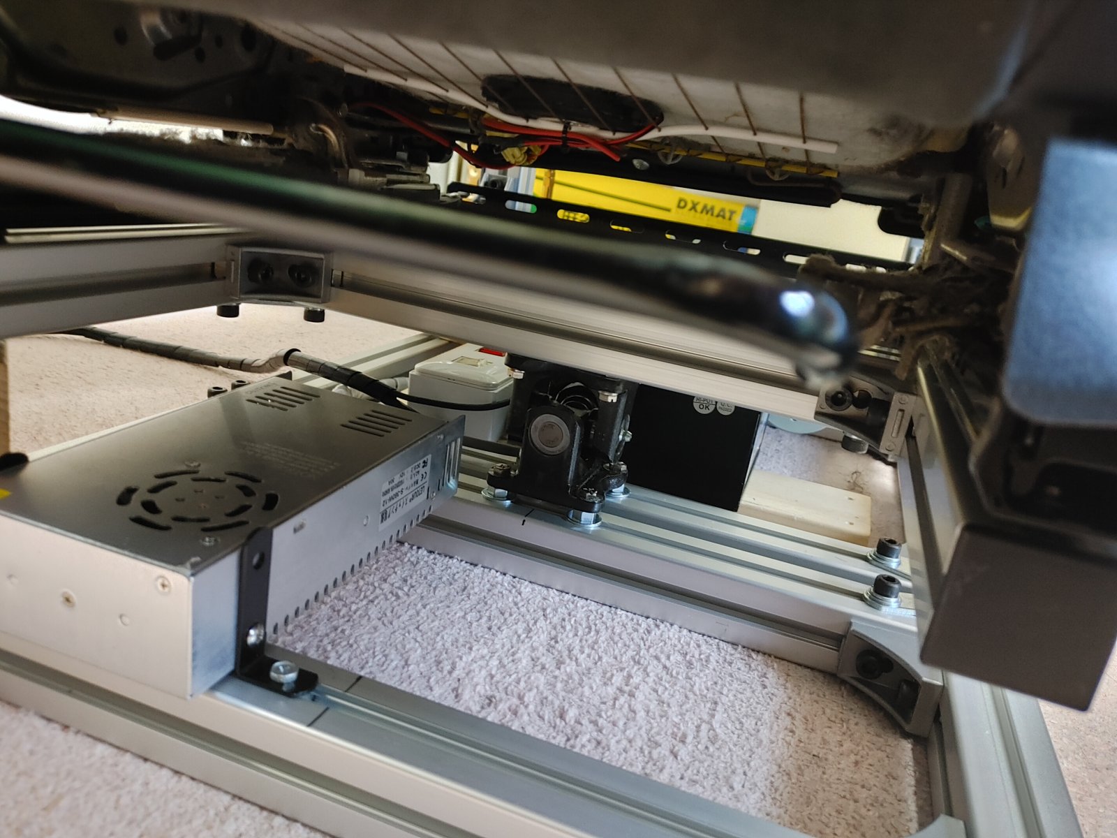

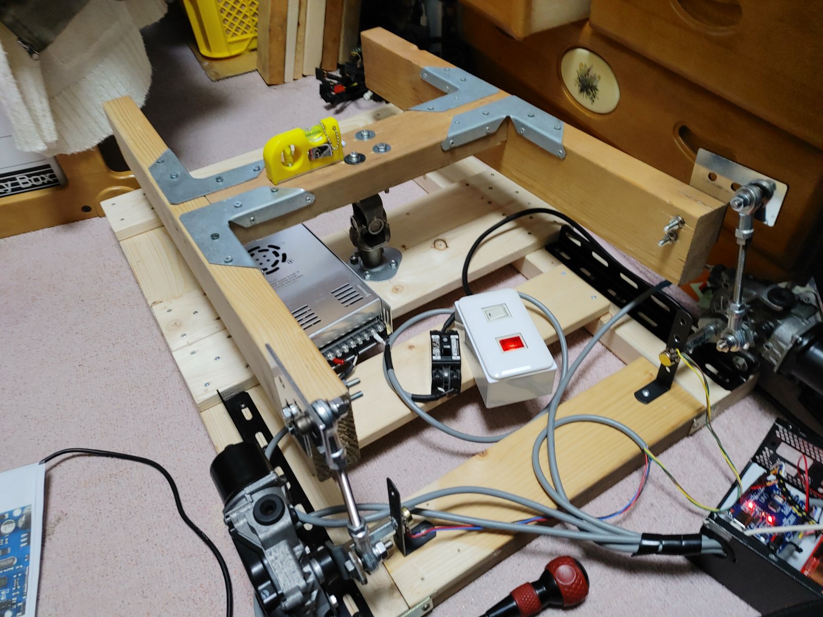

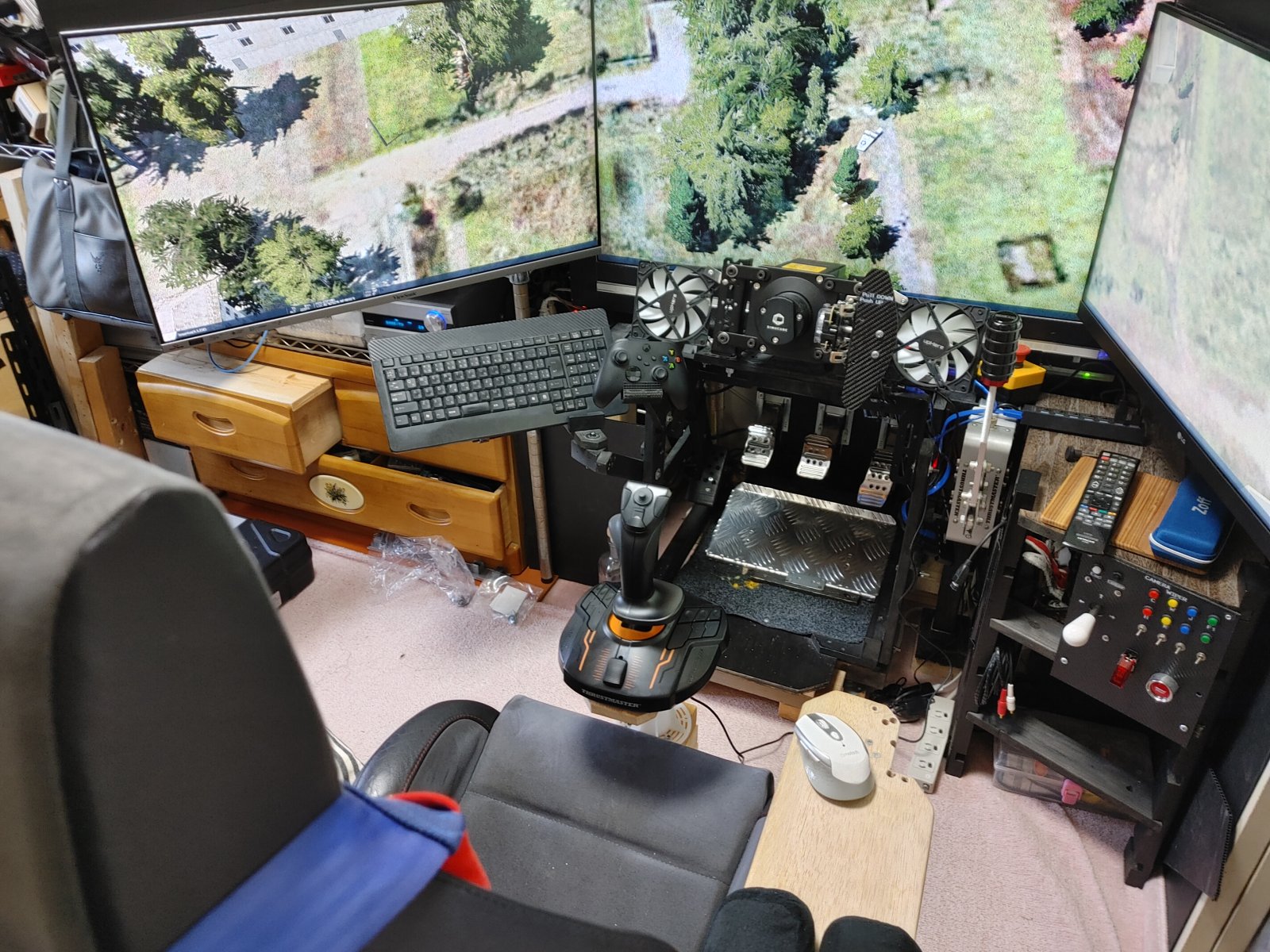

    Hello everyone in the world
    and Thank you everyone.
    My compact 2dof Motionrig is complete.
    Upload for reference.

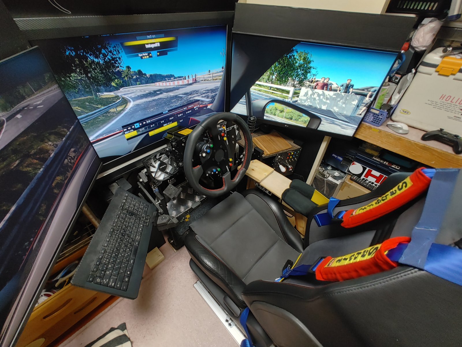

    My room is very small
    I made it compact.
    Have a good simlife !
    My Specification
    PC:Ryzen3700X + RX5700XT

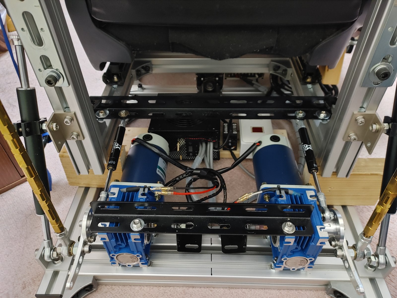

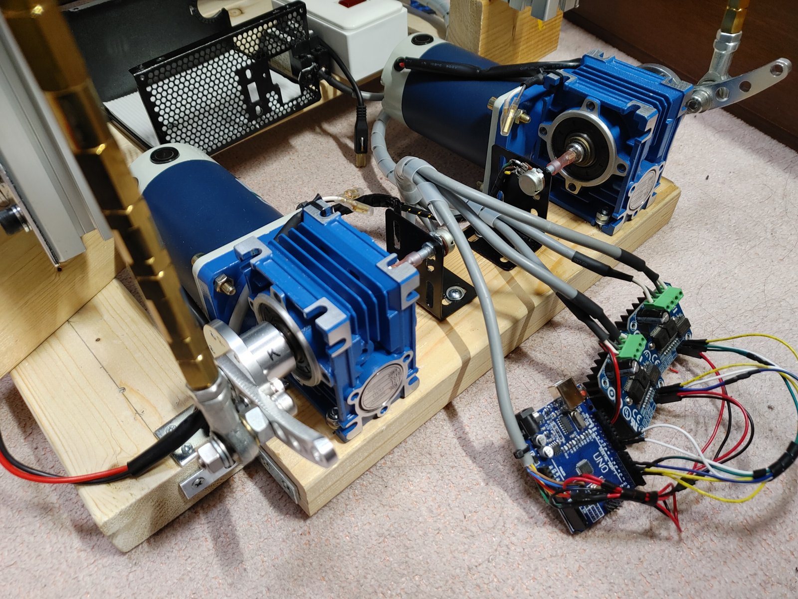

    Motor:DC12V 120W geard 30:1 70rpm x2
    Seat & Flame:  ZC31S & Aluminum + 2x4Wood

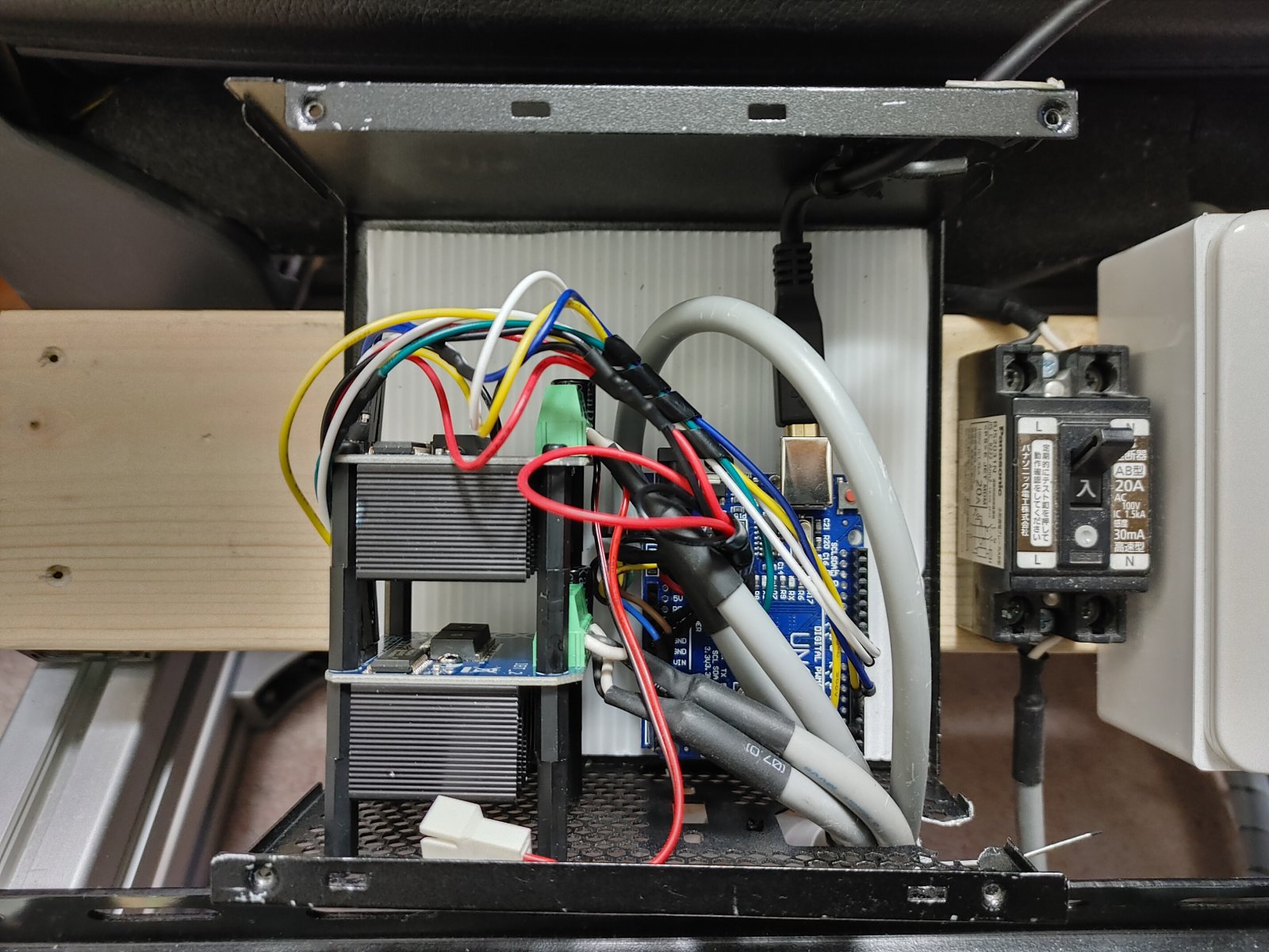

    etc: Simucube2sports T.16000M
    Aruduino UNO & IBT2x2
    Wind & Vibe
     ※All parts are commercial products
    Reference cost ≒ € 450 ※Including motor €90×2
    IMG00005.jpg IMG00003_HDR.jpg IMG00008.jpg IMG00008_HDR.jpg IMG00102_HDR.jpg IMG00161_HDR.jpg IMG00163_HDR.jpg IMG00183_HDR.jpg IMG00186_HDR.jpg

    Thanks so much for sharing your rig, awesome job :thumbs
    Perhaps cheak your settings as sway should lean away from a corner, roll is set opposite.

    Thank you noorbeast.It has been corrected now.
    I'm studying about motion and Adjusting for each game.
    There is not much information in Japan and I am having a hard time.
    I look forward to working with us.and Thank you for your continued support.
