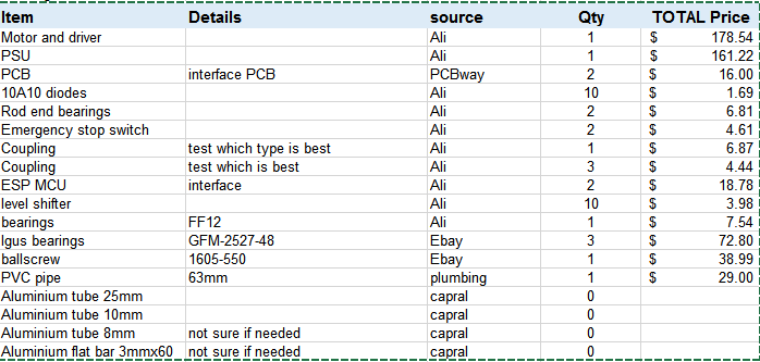

    Today i did something dumb!!!
    I started tracking costs...
    My aim initially is to build one actuator and test. If all good then I can build more, or else change design, motors, etc.
    Here is where its at so far. Prices are totals, not per each, and are in Australian dollars.

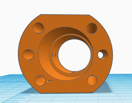

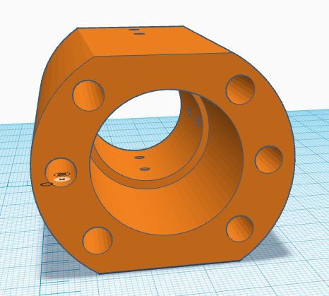

    I created my design for the adaptor to fix the aluminium tube to the ball screw.
    This is first design and I have no idea yet if it will work, is right size, will be strong enough, etc etc...
    I am thinking it needs more thickness but will print one first to check dimensions.

    Just realised this design is missing the tabs to stop the whole assembly from spinning. :oops:
    Back to drawing board for me. :(
    The tabs will also be needed to trigger the upper and lower limit switches inside the actuator.

    Hey :)
    You can get away without the tabs, if the rod and all of its upper connections can hold the torque of the motors. The ballnut itself then functions as an axial bearing. The error introduced this way is negligible.
    Post some more pictures of the design :)

    thanks. I may consider that.
    The design will have internal rails to hold the actuator together so using them to stop twisting isn't a big deal. And unfortunately I still need some sort of stops to work upper and lower limit switches so a redesign is needed regardless.

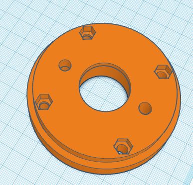

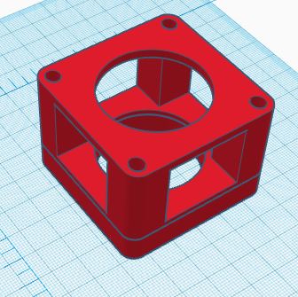

    Heading back in right direction... New motor mount and bottom bearing has been designed. These now bolt together with the 4 motor mount bolts.
    I may try and print them in one piece but not sue if that will improve strength or just add more complications with fill.
    Either way, until some the needed parts arrive I cant get or confirm exact measurements and cant print and test parts for size and fit.

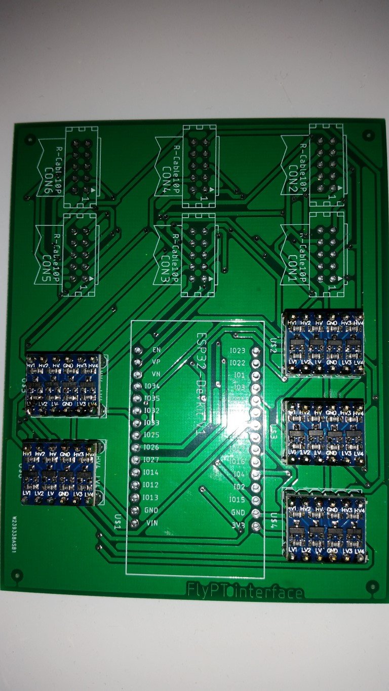

    I managed to have one small win - the PCB and level shifters has been soldered.
    ESP32 boards arrived the other day so will add and program that soon and then can connect to a motor and try to make some SW work.

    Have soldered ESP board and programmed ESP. It flashes 5 times when powered on - so seems like program has worked. Next job to wire and test properly with a motor and some software. (a simtools download cant be far away now!)
