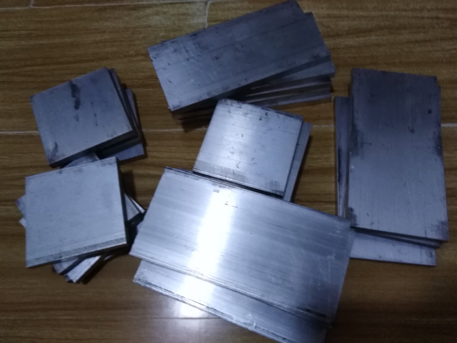

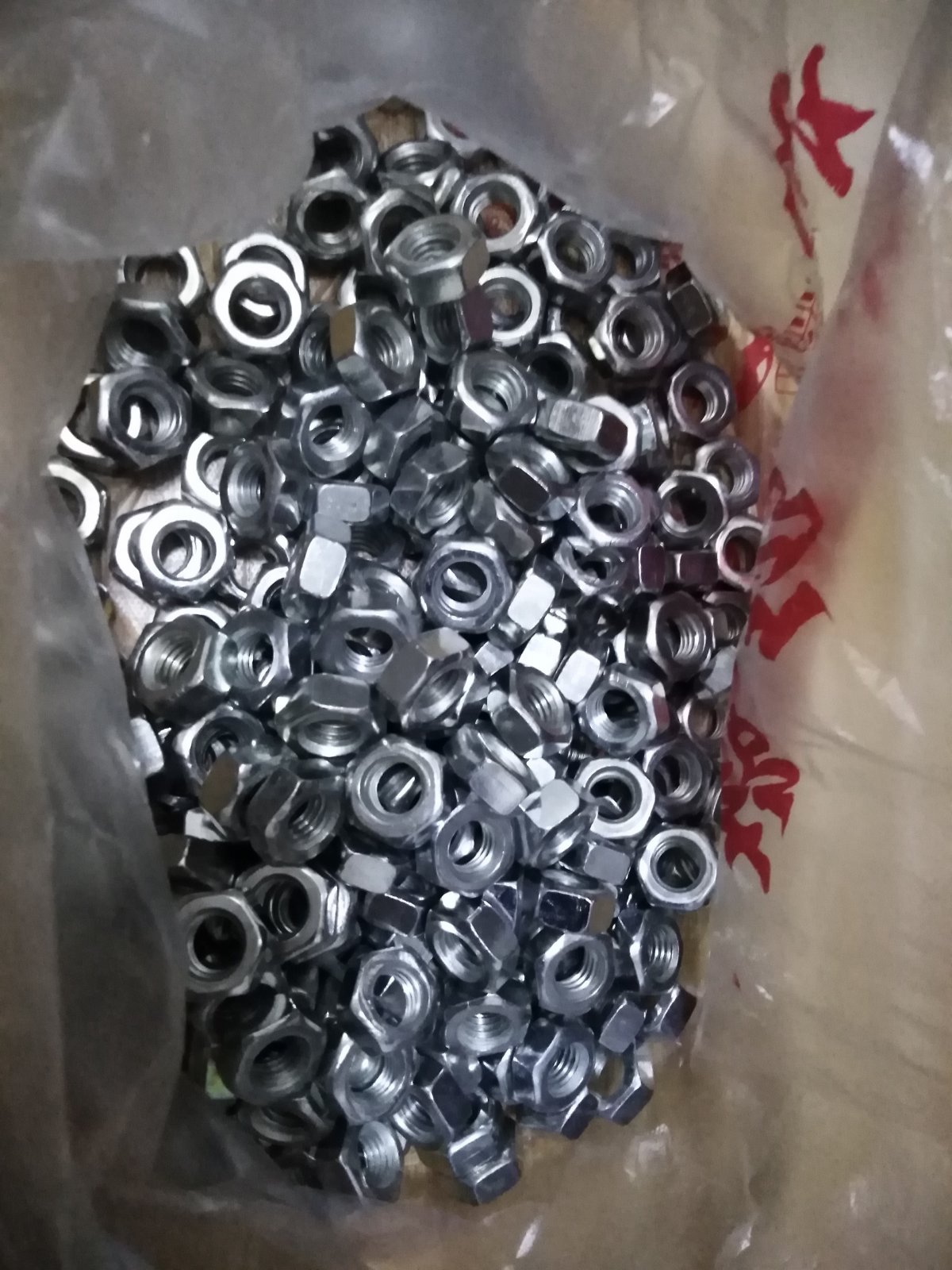

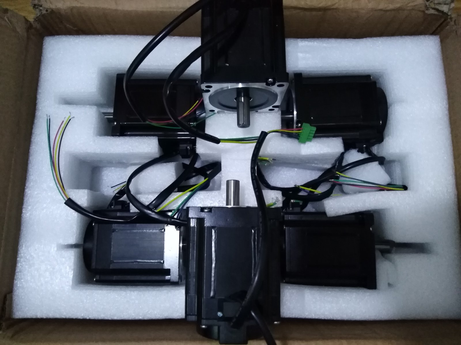

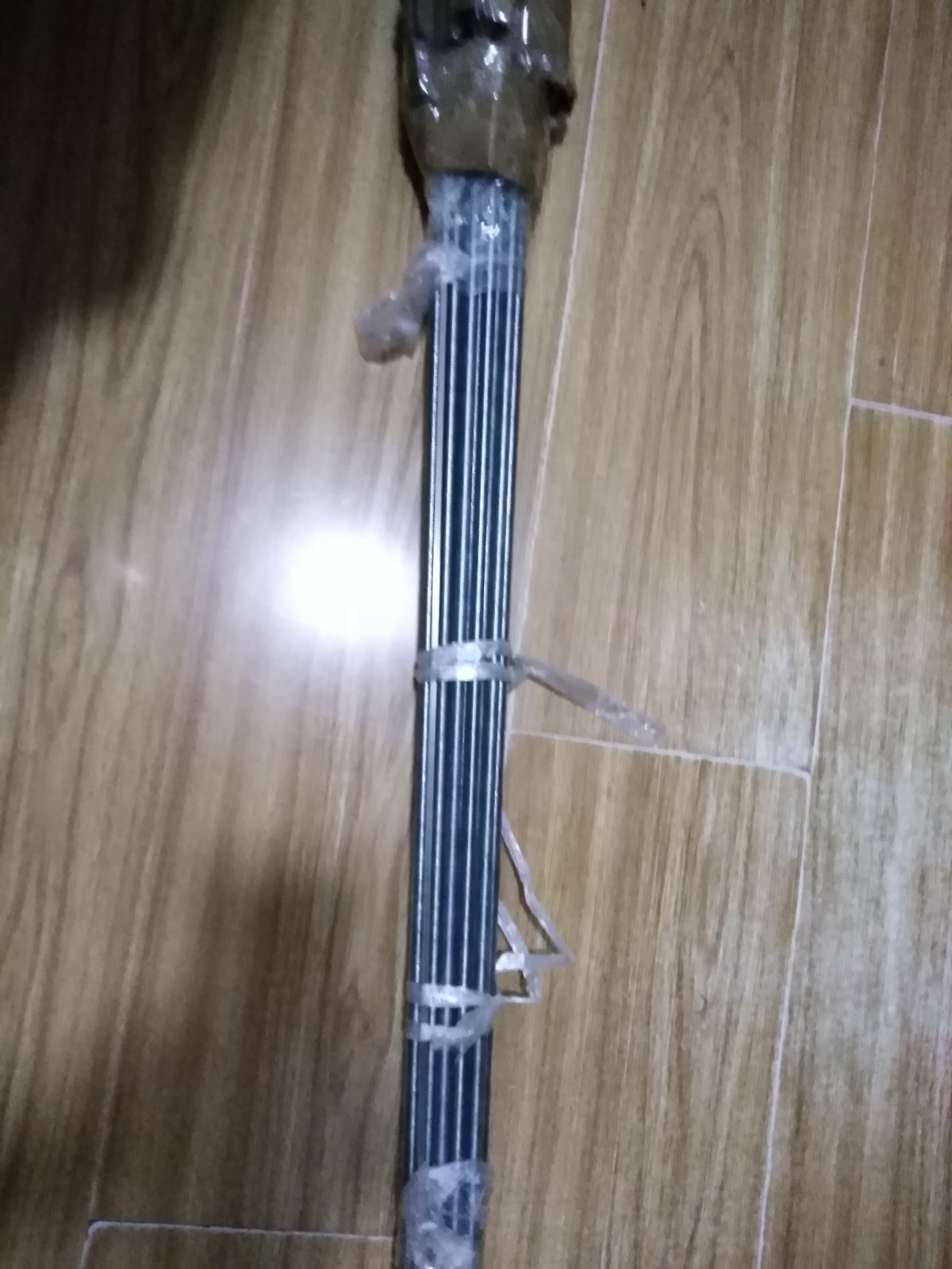

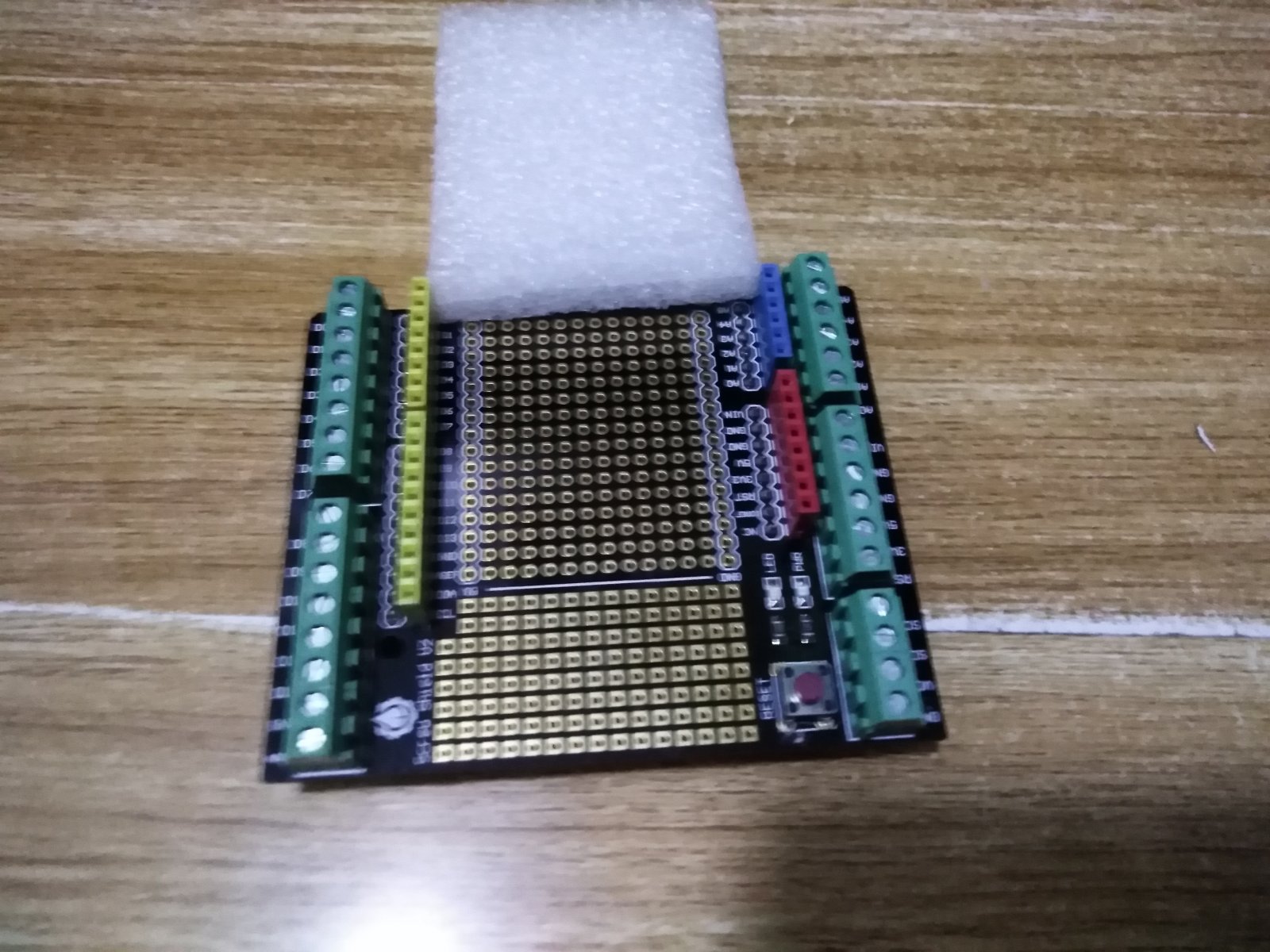

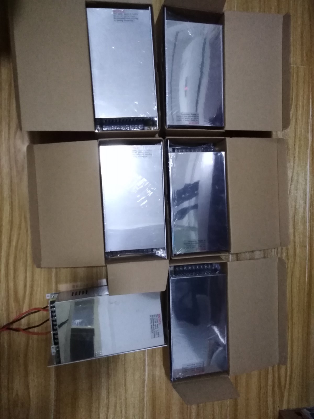

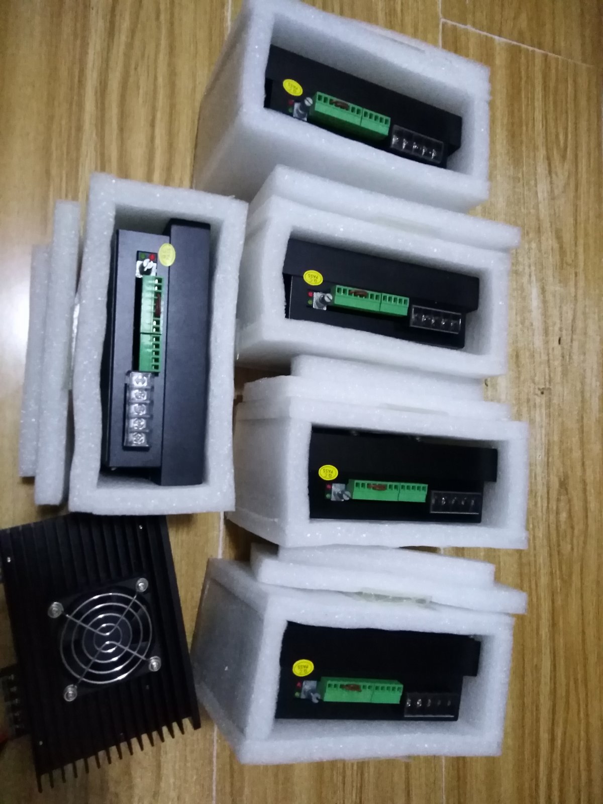

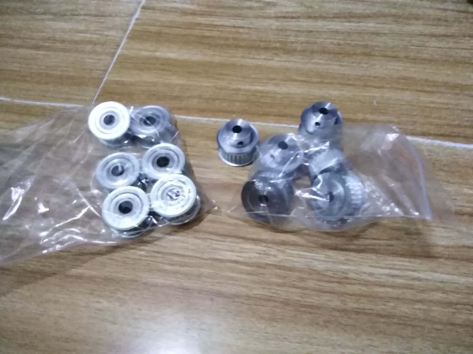

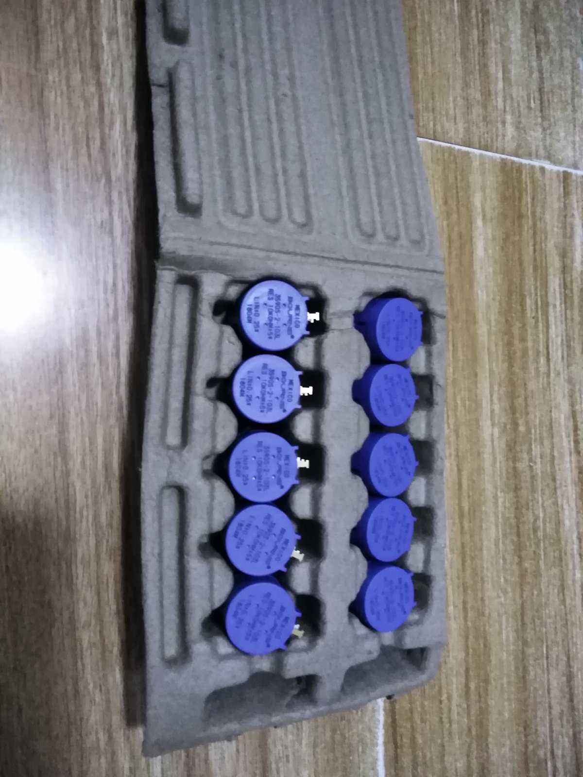

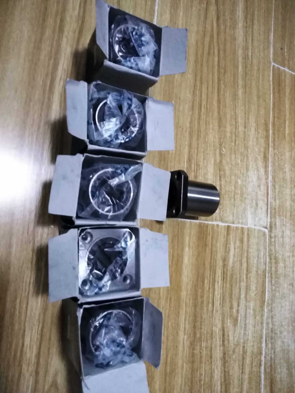

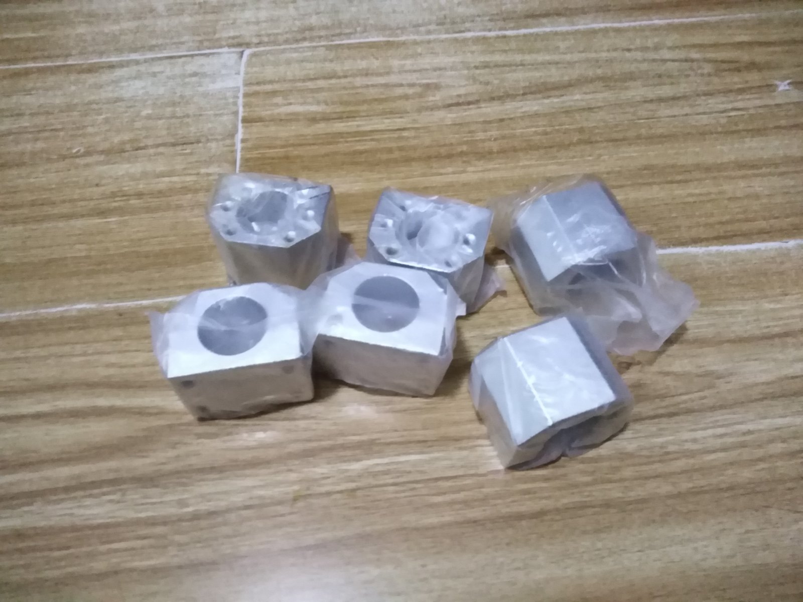

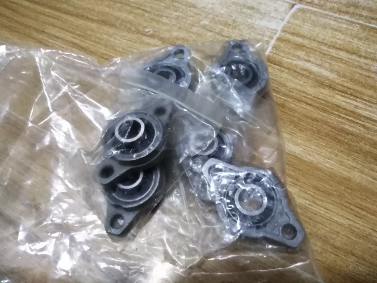

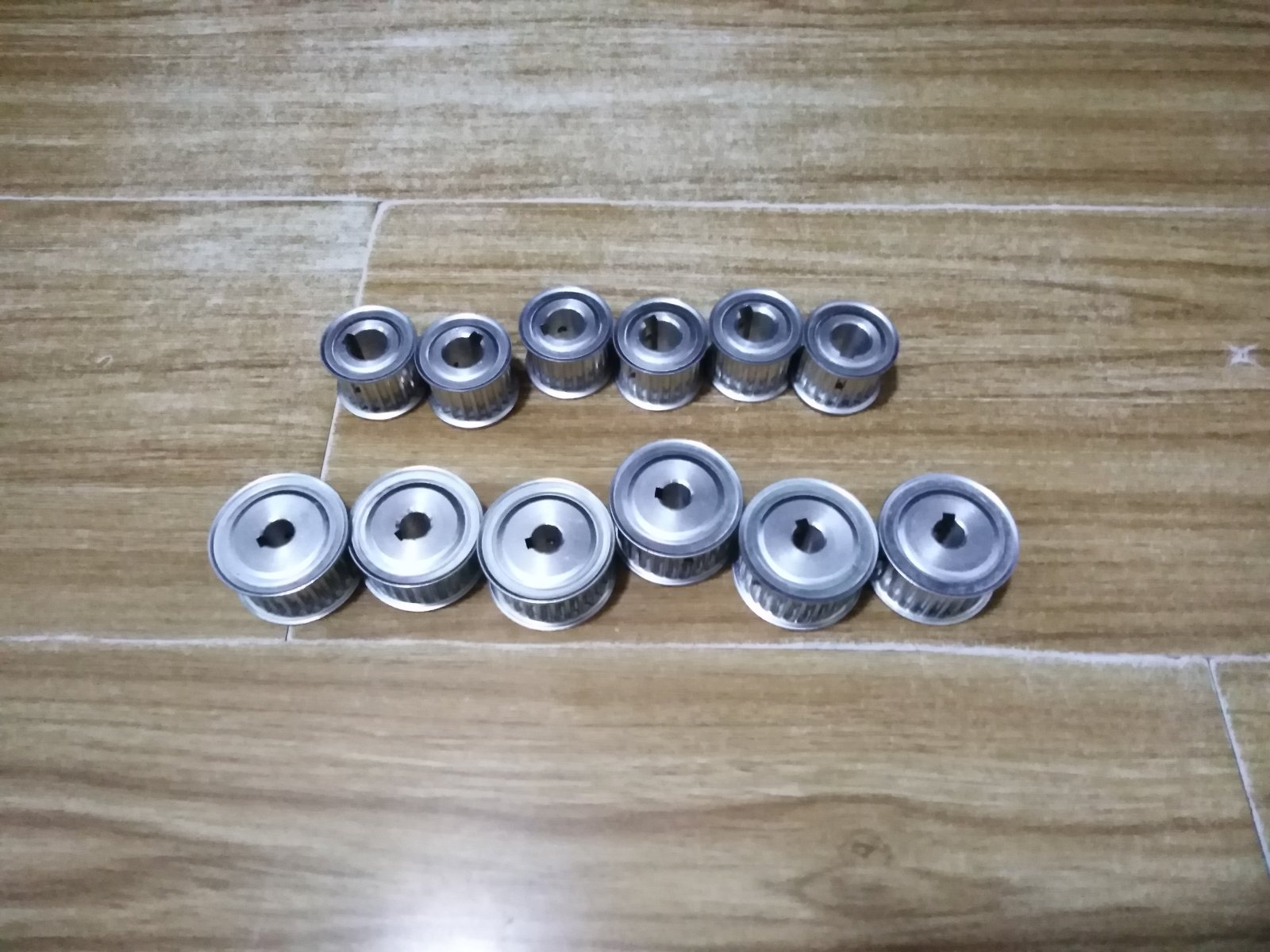

  3. xiatian
    xiatian Member
    Sep 5, 2017
    78
    Xi'an, China
    262Coins
    +28 / 0 / -0
    Some parts that have been obtained
    21,723
    152,051Coins
    +11,063 / 56 / -2
    That is an impressive collection :thumbs

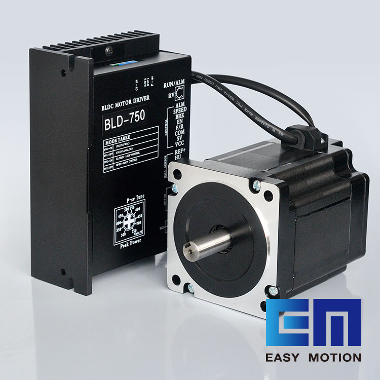

    I,
    Can you show what motor and controller model you are using? Specs?
    Without knowing, I don't know if you can use my solution.
  12. xiatian
    xiatian Member
    Sep 5, 2017
    78
    Xi'an, China
    262Coins
    +28 / 0 / -0
    it is this
  13. xiatian
    xiatian Member
    Sep 5, 2017
    78
    Xi'an, China
    262Coins
    +28 / 0 / -0
    86 series brushless motor 440W3000 to 48V supporting BLD-750 driver
  14. xiatian
    xiatian Member
    Sep 5, 2017
    78
    Xi'an, China
    262Coins
    +28 / 0 / -0
    Find a big one
  15. pmvcda
    pmvcda aka FlyPT
    Nov 3, 2010
    2,180
    Portugal
    15,384Coins
    +2,604 / 17 / -0
    This one? https://pt.aliexpress.com/store/pro...l?spm=a2g03.10010108.1000023.1.266a6e8efDPqoL
    and https://pt.aliexpress.com/item/48V-...Motor-series-for-CNC-Machine/32593792750.html
    Then it's compatible.
    You should be able to use the hall sensor version.
    Only difference is the motor with 8 pole.
    Instead of 18 steps per turn you get 24 steps per turn.
    Can you make the motor work without ESP32, just using the controller pot to adjust speed?
    Maybe follow those videos just to be sure the motor and controller are working:
    To control the motor with PWM, you have to set the controller switches to: SW1=off SW2=on.
    Just follow the connections in my thread and it should work (first page - electronics updated yesterday).
    Test with one motor. Use the code I have right now for the ESP32 (today, because I'm going to update the code to use my interface).
    Change the number of motors to 1 in the code.
    Use simtools to test. Be sure to have the right settings on the simtools interface.
    Also, the code expects you to have the limit switches.
    It should start looking for the minimum switch, followed by the maximum and only then it will connect to simtools to follow it's commands.
    I explain everything in my thread. I think it's well documented.

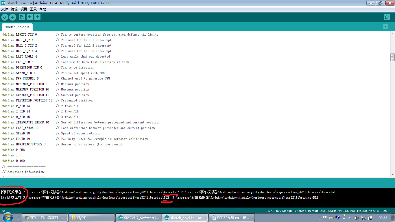

    Hello, set sw2=on, code #define NUMBERACTUATORS 3 // Number of actuators (for one board) is changed to 1, the motor is high speed after power-on, and the micro-switch does not respond.
    When uploading the code, the prompt ''Found invalid library'" AzureIoT, open the file is empty, is not because of this problem.
  17. xiatian
    xiatian Member
    Sep 5, 2017
    78
    Xi'an, China
    262Coins
    +28 / 0 / -0
    Find invalid library
  18. pmvcda
    pmvcda aka FlyPT
    Nov 3, 2010
    2,180
    Portugal
    15,384Coins
    +2,604 / 17 / -0
    It should make the motor move until the minimum switch is pressed.
    But I found some problems:
    -I took another look at the specs. the motor is 120º, so switch 2 should be OFF (sorry)
    -Try with switch 1 ON. The RV pot when turned, should not change the motor speed.
    -Also, try to change this:
    Code:
    #define PWM_FREQUENCY 5000
    to
    Code:
    #define PWM_FREQUENCY 2000
    In the datasheet, it says to use between 1 and 3 KHz, for pwm, so let's use the middle one.
    Library:
    Did you install everything in the Arduino Interface?
    You can follow this tutorial:
