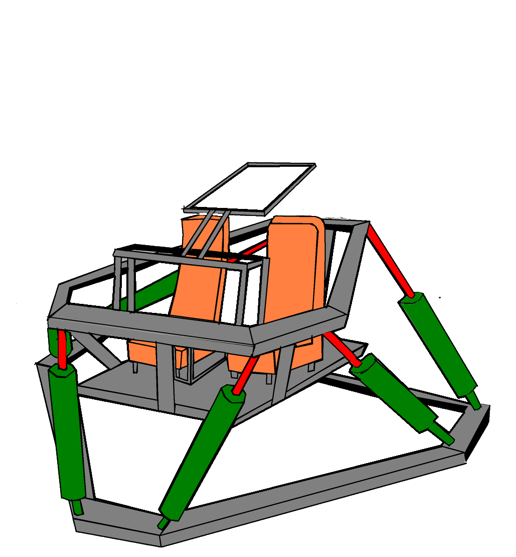

    Hello everyone,
    I’d like to present the initial concept model for my 6DOF simulator project. Please note that this model is not final—it's just an idea at this stage. Things are likely to evolve over time.
    The image I’ve included was manually drawn and later converted to a digital format using basic paint software in Windows. I chose not to use any vector-based design tools at this stage, as this is still an early concept that will be refined as the project progresses.
    Description of the Concept Model
    The drawing is simple and intentionally lacks many details, such as mechanisms, precise lines, colors, and geometric nuances. Its main purpose is to communicate the core idea behind my project.
    The simulator's primary components will be made of lightweight materials, with aluminum being a preferred choice. The goal is to balance strength and weight while keeping the structure as light as possible.
    In the drawing, you’ll notice a panel, a pedestal, and an overhead panel. These elements serve as frameworks or placeholders for essential electronic components. The idea is to arrange the flight instruments in an organized and accessible manner.
    The cockpit cover is not included in this initial drawing, but it will be presented in future updates. My current thought is that the cover will follow the structure’s design and incorporate projection systems to display visuals for the pilots.

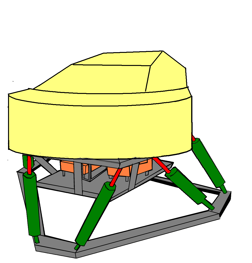

    Hello everybody,
    Continuing the discussion about my project, I want to share an empirical sketch of how the cover for my 6DOF simulator might look. This cover is something I envisioned based on the design of real flight simulators.
    In modern flight simulators, image projection typically relies on high-resolution projectors. Generally, there are at least two projectors installed, creating composite images in front, to the left, and to the right. These advanced simulators often use a system of mirrors to project images for the pilots.
    My idea is to adopt a simplified version of this setup, as the real application can be very expensive. The weight of the cover will also be a consideration, as it cannot be too heavy for the platform. For now, this is only a conceptual idea, and calculations will be needed to validate it. Alternatively, I may use monitors for my project.
    Currently, my project is still in the design phase. The construction phase will take time to begin, as I do not yet have the necessary conditions to start building. However, I will share more updates about this project in the future, including ideas, designs, graphics, and more.

    If you don't have any sophisticated 3D-CAD software I'd recommend building a model from cardboard or wood. Drawing everything in a 2D sketcher is not very convenient because if you change something, and may it even only be the angle of view, you have to redraw everything.
    Another option: Check FreeCAD

    Ok,@Aerosmith. I understand what you're saying. The sketch I posted is just to share with the community the initial idea for my project. The final design will be created using CAD software. My intention is to present the first version of my project, which will be developed over time.
    Currently, I use AutoCAD and a little bit of SolidWorks (as I'm still learning this software). My project plan is not based on 2D designs (except for the technical schematics, which I will share with the community at an appropriate time). Other software may also be used to create sketches for demonstration purposes.
    I'll take your advice and check out FreeCAD.

    Keep in mind that youre upperframe must be very stiff becauce every bit of torsion you see on the screen with projectors
    Just my two cents

    Projector screens are actually much less sensible to torsion than LCD screens because they can be made much lighter. For example you can build the like model aircraft wings as sandwich of styro foam and wood or fibre reinforced plastic sheets. So they have a very high stiffness to weight ratio. And if the screen wobbles a bit it's not as bad as you might think. As long as the projectors stay in place the projected picture won't move.
    I'm curious how this project will evolve. I have similar plans (6DOF, two seats, projector screens) but have made different design decisions. For example I put the actuators below the rig while Jeff arranges them around it. I think this requires much more space and stroke but if you have the space it's probably easier.
    I wonder how you solve the problem of the overhead panel throwing shadows. The projectors have to be either above or behind the overhead panel which requires more distance and therefore larger screens. (or maybe a clever arrangement of mirrors)

    I know all about sandwich panels worked with them.
    I am more affraid fore tho keep the projectors in place
