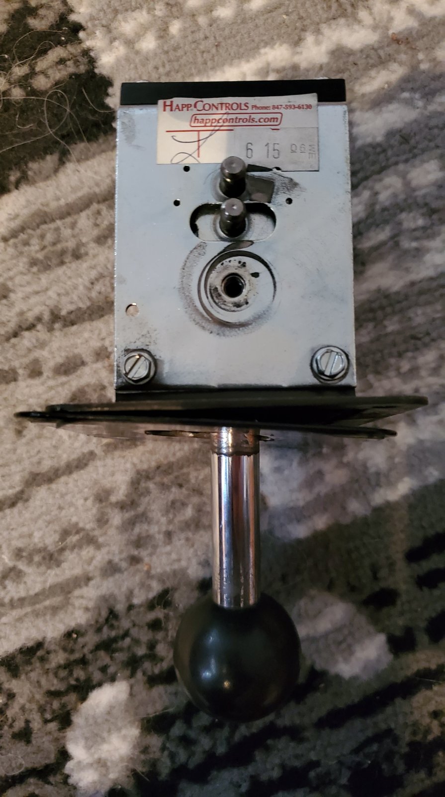

    6. - Need For Speed arcade shifter mech - CHECK ( See the irony here ?? LOL )

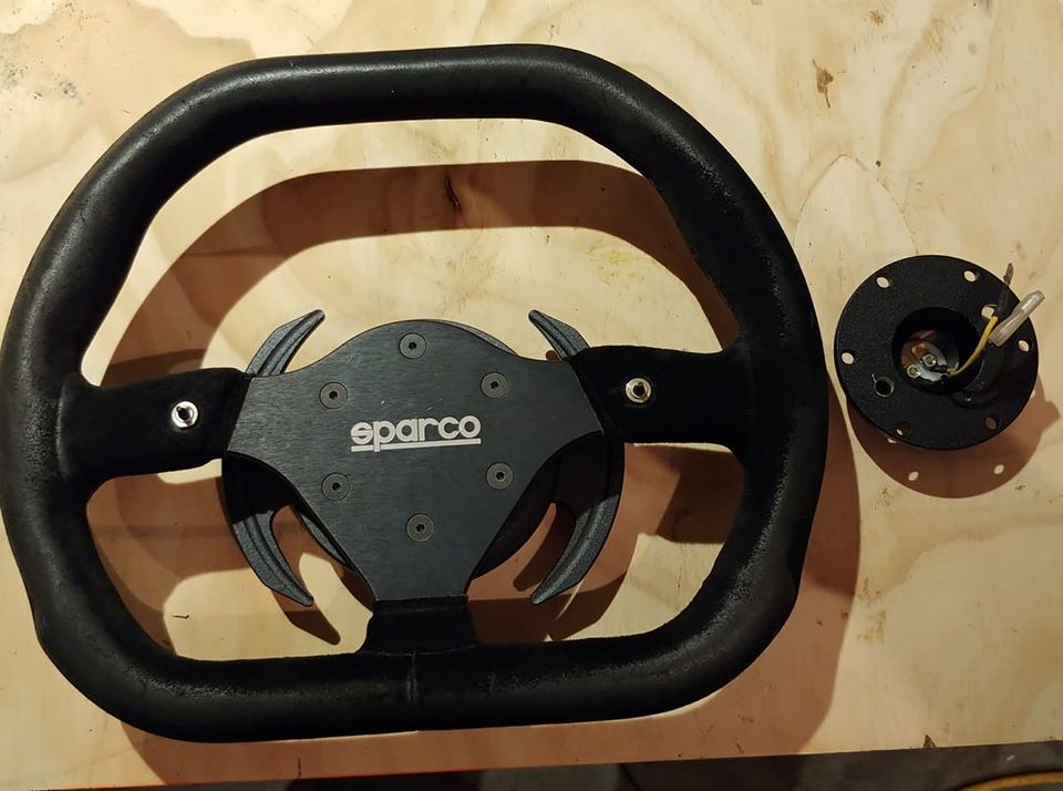

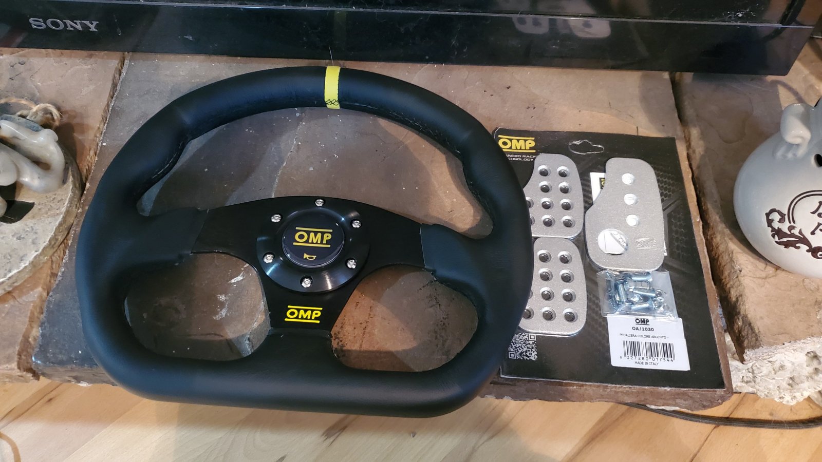

    I was going to use an NRG seat, but have since came across a few other manufactures on Alibaba I'm trying to convince to sell me a single one as a sample. Seat1.jpg Seatback.jpg
    Also picked up locally another steering wheel...
    Was too good of a deal to pass up :p

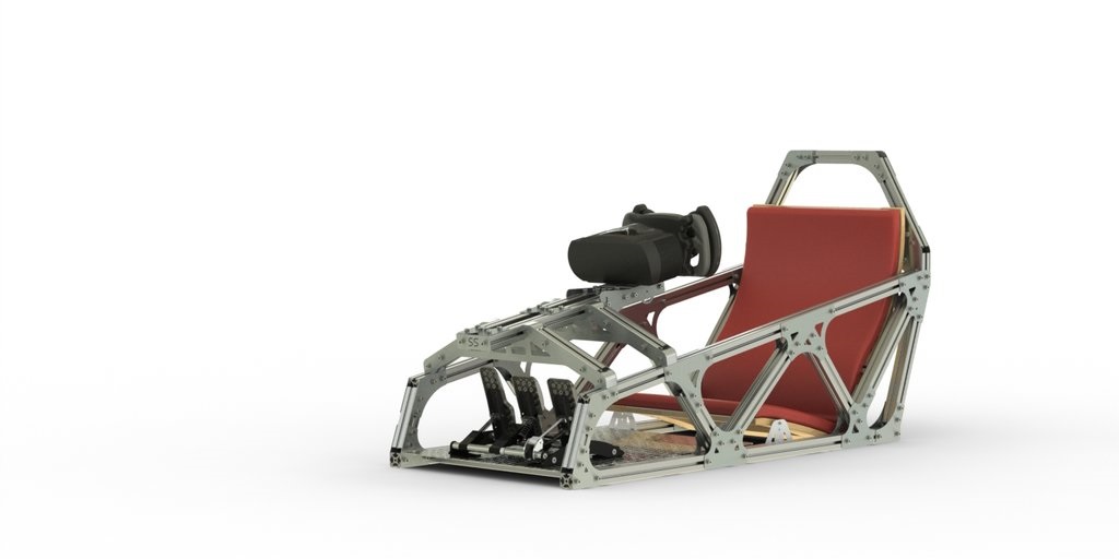

    Once I have Seat sorted, i will be working on drawing up the skid. So far I worked it out that the frame will be made out of 38mm ( 1.75") 6061T6 Aluminum tubing. features an 1.65mm ( 0.065" ) wall thickness which is plenty strong when reinforced properly while keeping weight low. Pulled a random pic off Google as an example what the idea will roughly look like... SS-Formula.jpg

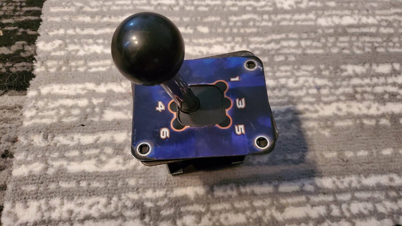

    5. - Need For Speed arcade shifter mech - Shipped

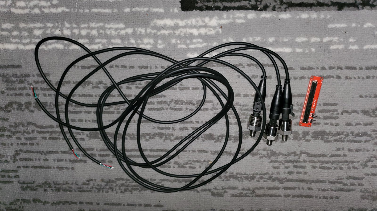

    7. - Pressure Transducer w/ 2m Cable 500 PSI ->x3 - Shipped

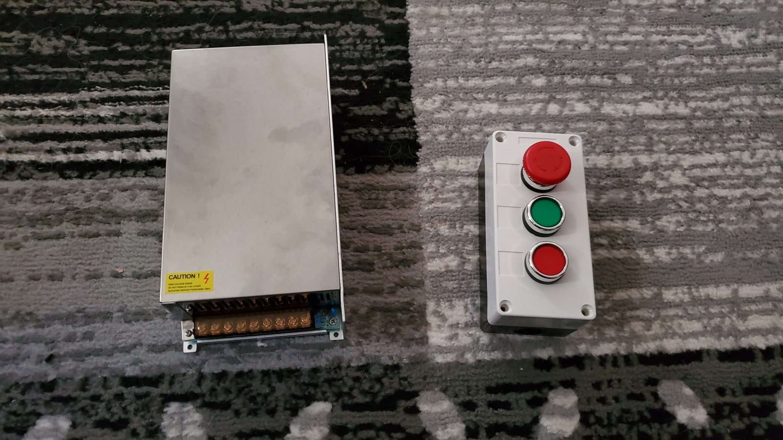

    Guess some of it is better than nothing during these times... I will spend some time today and follow up with the rest.
    I did end up adding a few other things that weren't mentioned on the list above and figured i would add that on here :
    1. - Emergency Stop & Push Button Switch Box - Added for the 6DOF to allow to add a "Park" and "Pause" modes / functionality ( see notes bellow )
    2. - 1 Pole 12 Position PANEL PCB Wiring ROTARY Switch - More Steering Wheel Switches

    5. - Practical For MCU 10K AVR Electronic Block Slide Potentiometer Linear

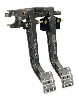

    I dodged a bullet as i found these beauties !!!
    Guess why re-invent the wheel :)

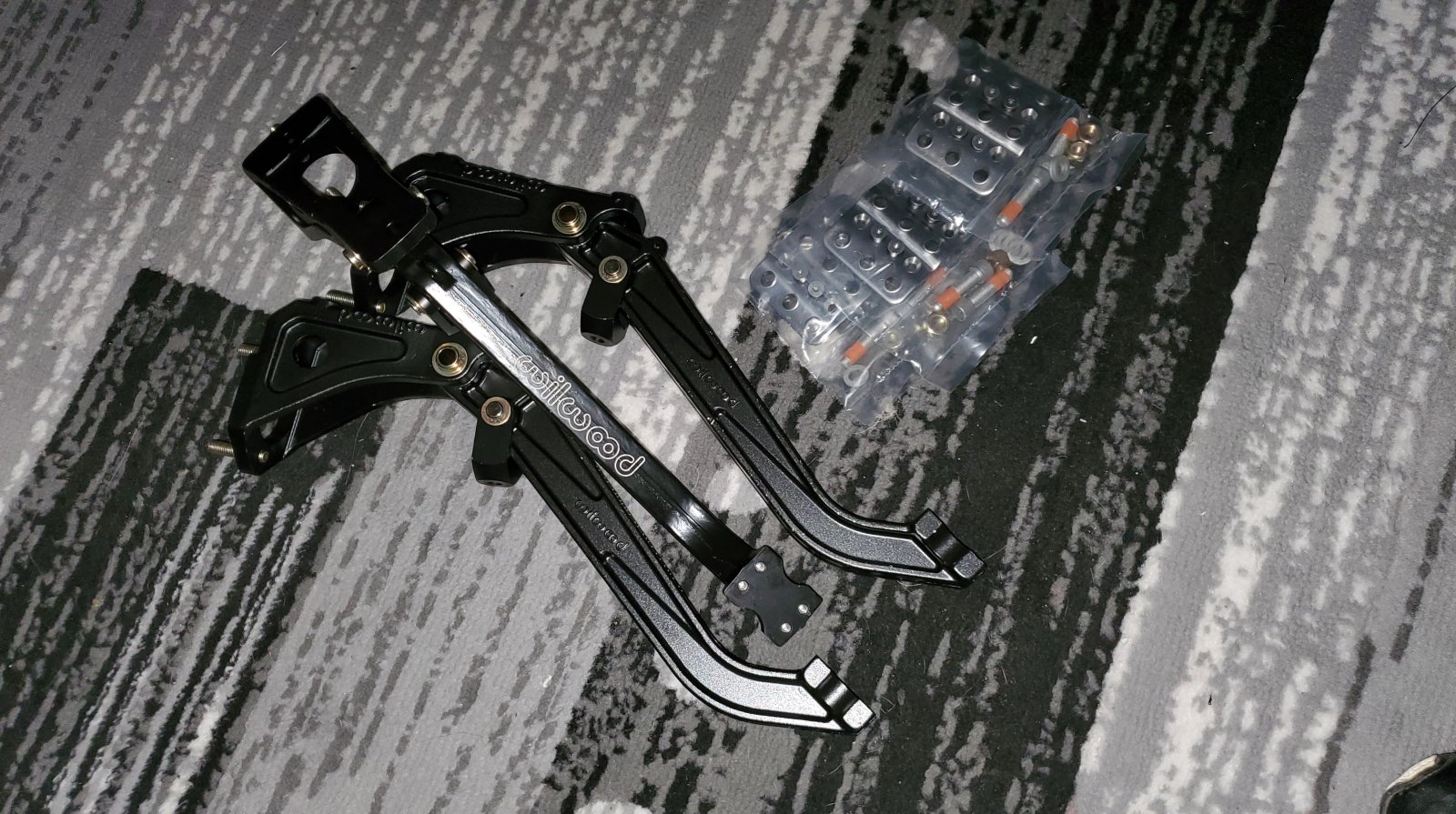

    Left Set will be your standard Brake / Clutch meanwhile the single will be the Gas pedal and will probably use the shaft from the pull type slave cylinders as a the actuating rod - reuse / recycle :)

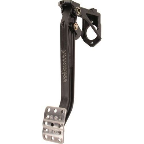

    3. - Wilwood 340-13834 Swing Mount Clutch / Brake Pedal Assembly - X3 - DATASHEET

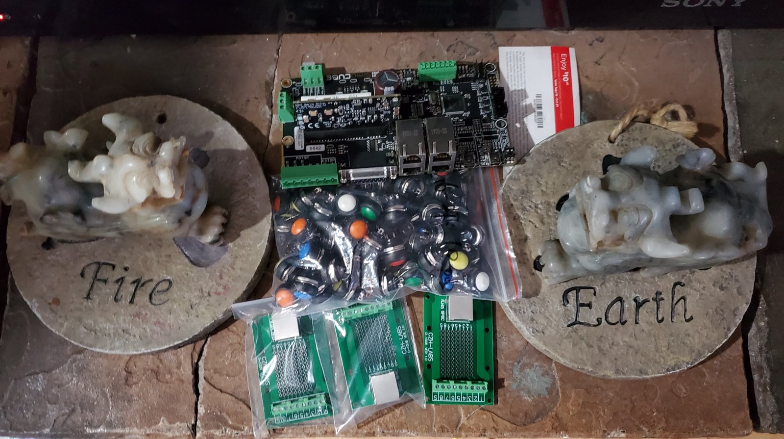

    This Morning DHL dropped off the SimuCUBE with the IONi HC PRO R2. Powersupply for OSW is en-route and is in customs in Toronto as well as TNT taking their sweet time with the MiGE, but at least it seems that most of it will be here by Friday ( Fingers Crossed !! ). Shifter is in Canada Post's hands and same for a few other items...
    It's all slowly coming together :D

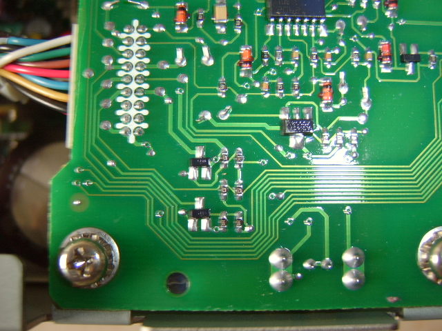

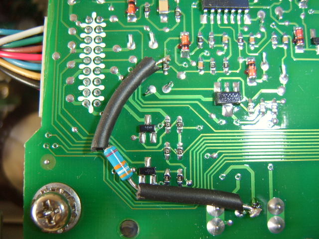

    Build Notes:

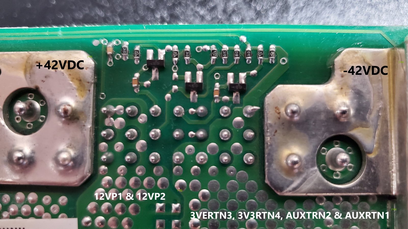

    Power Supply seems to be broken down into 3 sections: Top Board seems to me logic and low voltage supply ( 3.3V @ 25.0A and 12V @ 12.0A ) mean while the Bottom and Center Boards are the High Voltage ( 42VDC ) supplies running parallel to each other which explains the following snippet from Cisco's Documentation :
    Power supply dissection :
    Back of output board

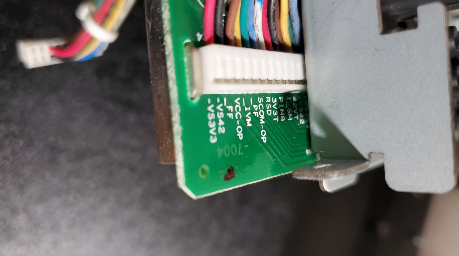

    This is what i was able to track down so far without my multimeter, but also noting a few SMT transistors that may be responsible for the power cap based on chassis as this would make a more logical way of limiting power based on which pin gets pulled low implementing a power cap. Pins 11, 12 and 14 seem to lead to these transistors - possible wake up pins... Plan is to Map out the connector entirely by then end of the day.
    Pigtail from output board to Main Control Board.
    There is still lot of home work to be done...
    But did find this and wanted to note this in here as I don't want to go searching for random text later on:
    NOTE: Connector leads to output board, same one posted above these but at the other end.

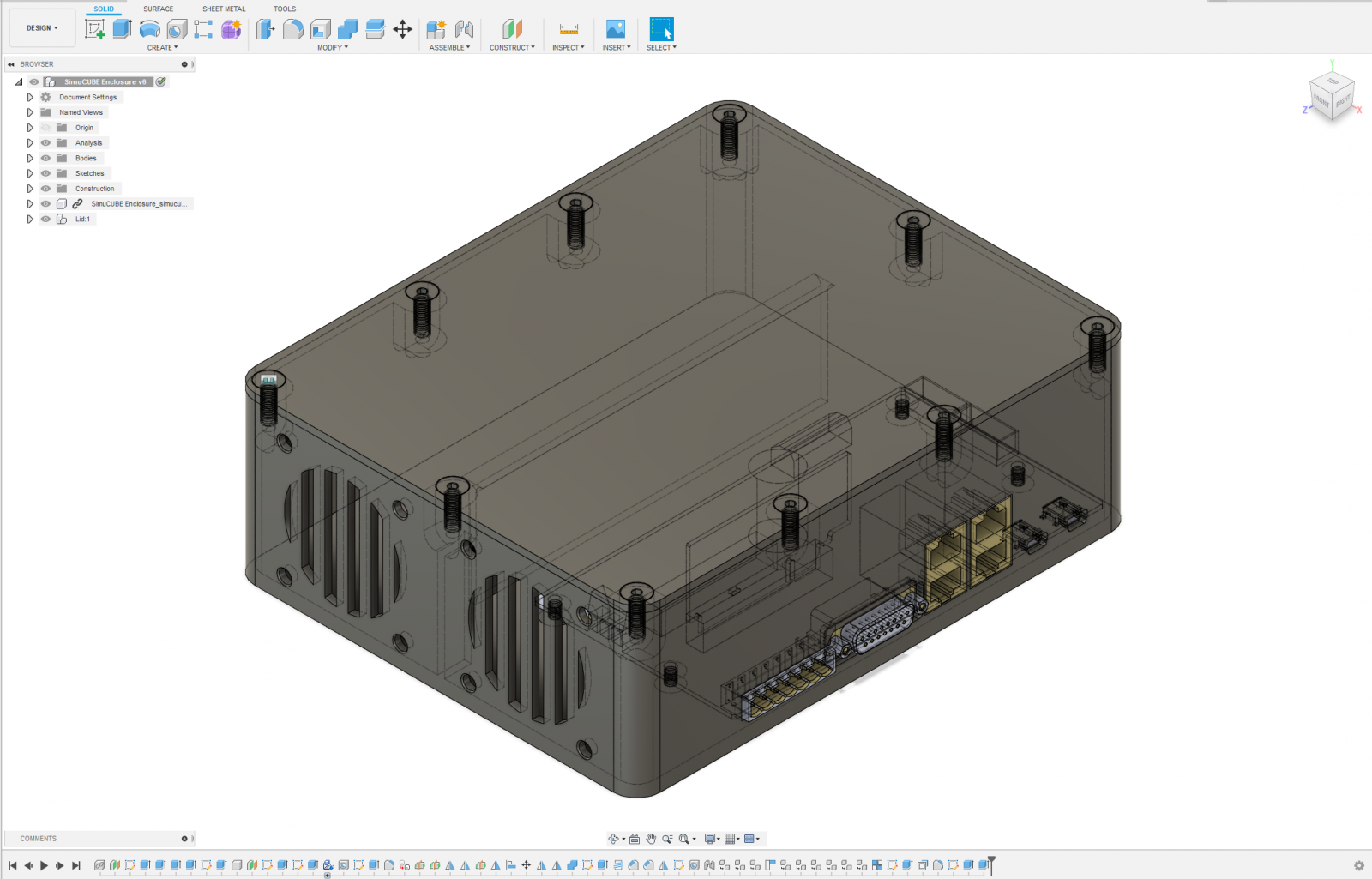

    And spent most of they day on this:
    Once I printed it and verified fitment, I will be posting it up on Thingieverse.

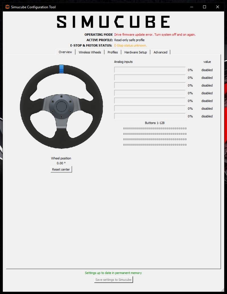

    Creality does't install a bootloader and now im stranded as i cant even load the new one to accept the BL Touch. so yay... no printing this weekend :/
    On the other hand found out that there flashing firmware to the SimuCUBE is a PITA. you cant just load the newest firmware and call it a day, but instead have to load an older firmware and then perform a mock setup and then install the latest release ( took me a few tries and a cup or two of cherry whiskey )
    On the other hand...
    128 BUTTONS ?!?!?!
    In my boredom, I made a quick and cheap adapter from a logitech pedal set i had kicking around to the OSW setup.

    Im interested in the info on upgrading the voltage.
    Would you post the source link please for those details for adding the resistor.

    Here you go...
    Sorry it took so long but i have been fairly busy and i had to dig it out of my surfing history... was on page 43 LOL
    Link to RCGROUP SERVER POWER SUPPLY CONVERSION Thread - was able to even pin point the post for you

    I looked through the thread and that certainly was the needle in the haystack. Good Find
    I noticed over at Silentchill's build with ODrives that he had some trouble with the PSU.
    He started with the Cisco PSU but changed somewhere along the line to 35 V 15A 540 W PSU.
    Im not sure of the reason but someone said something about the Cisco tripping the Odrive.
    Just something to consider before upgrading the PSU to 48V. Might be worth running it at 42V to start with.

    I think I'm due for a quick update on this...
    Parts are arriving more frequently now and soon I will be in full swing and tinkering full time, which is good as being home with this pandemic is slowly hitting the crazy button LOL
    So...
    what has arrives yesterday and today:
    Shifter
    95343597_158930888880531_6743217109918023680_n.jpg 94786537_160655898686549_7283187102815092736_n.jpg
    Service Manual & Parts Sheet
    SimuCUBE Power Supply and E-Stop
    Pedal Box Sensors ( Pressure Sensor and Linear Pot )
    and Last but not least the Willwood Pedals
    Still waiting on Wilwood GS Master Cylinders, Wilwood Slave Cylinders, E Brake assembly as well as a few other knick knacks.
    On a side note... my $25 shifter is missing the torsion spring along with the retaining bolt and spacer. Not a big deal, but can easily machine a spacer and pick up a random spring locally at princess auto.
