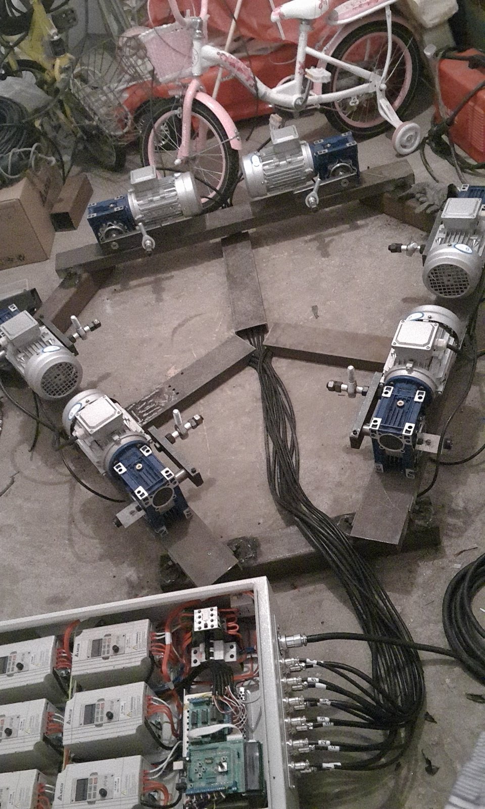

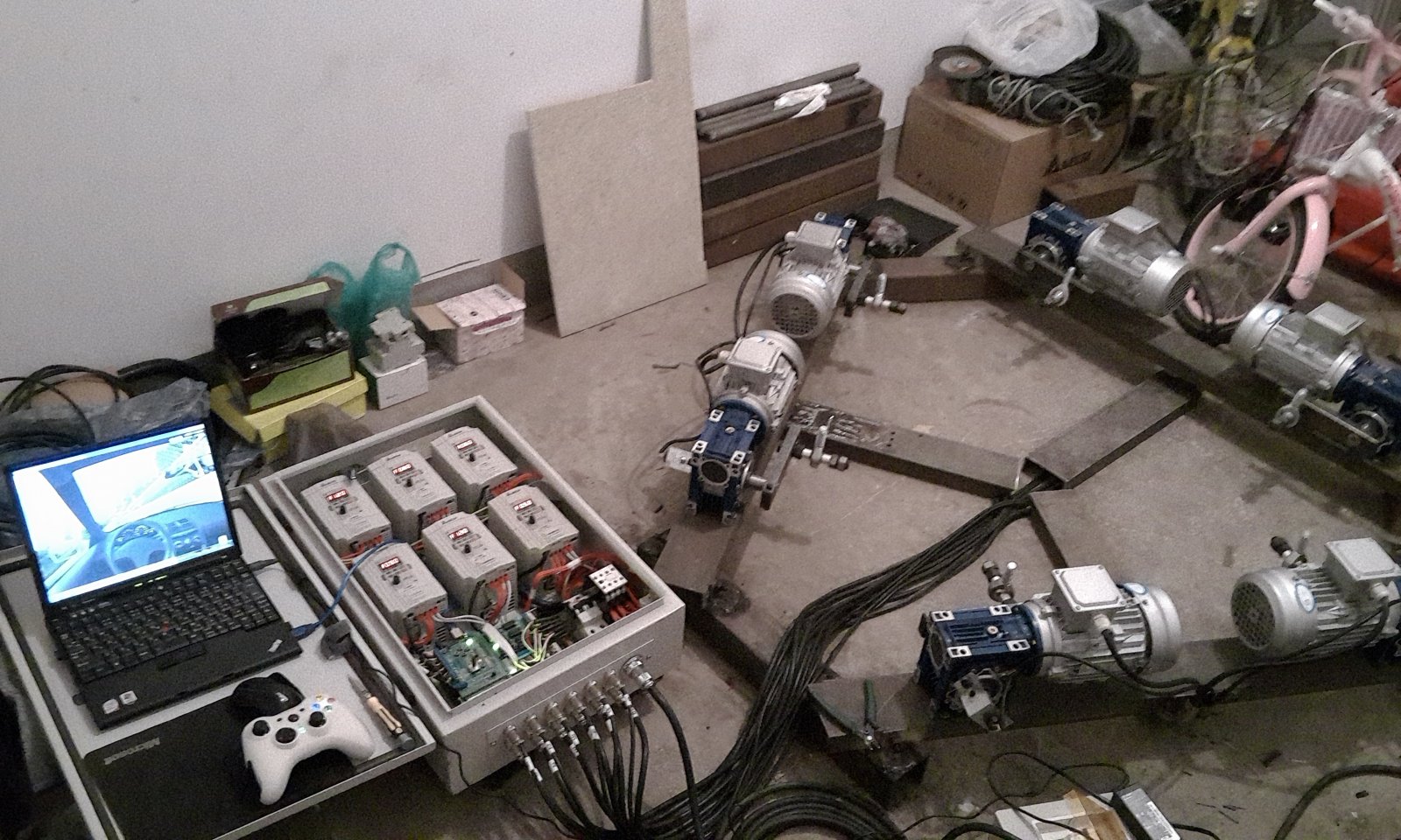

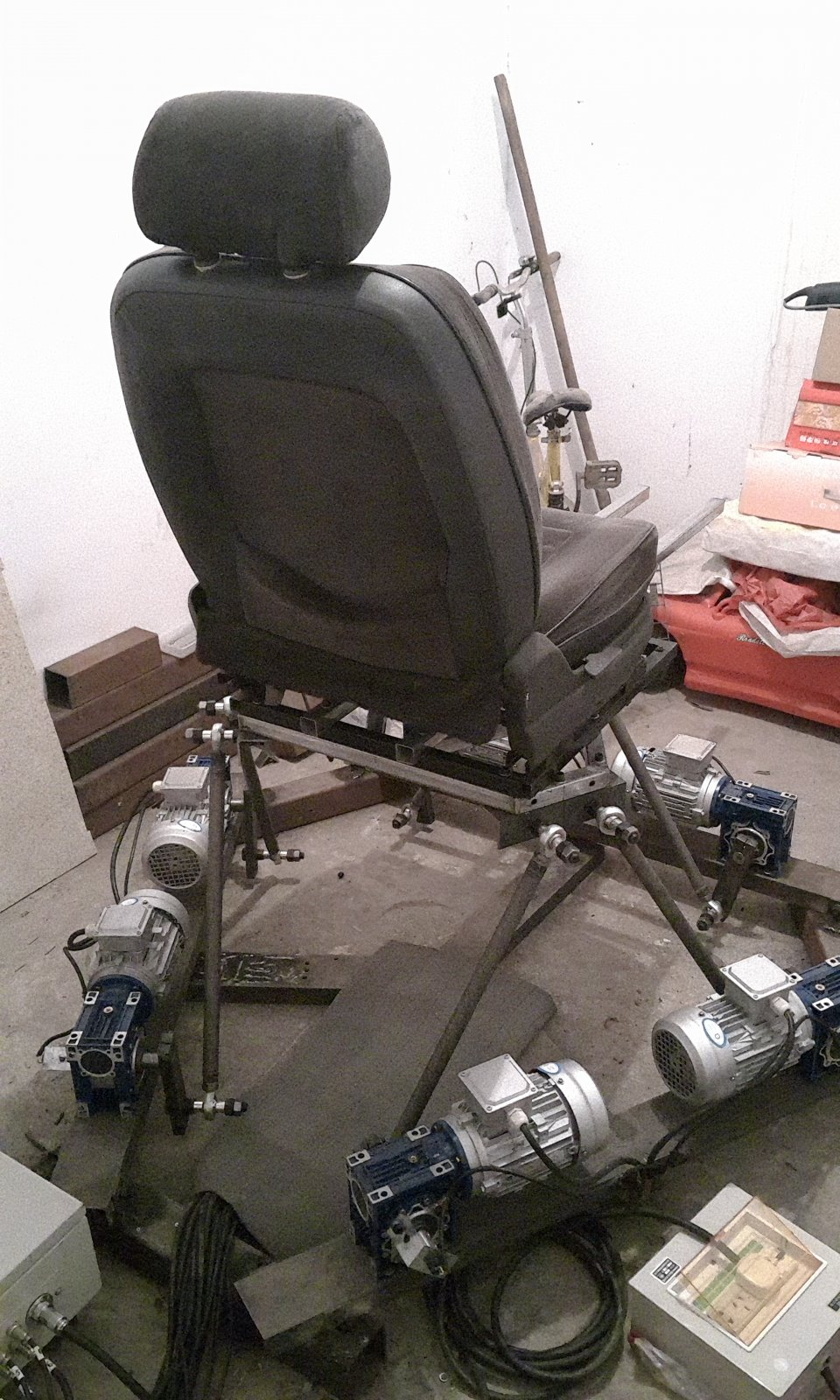

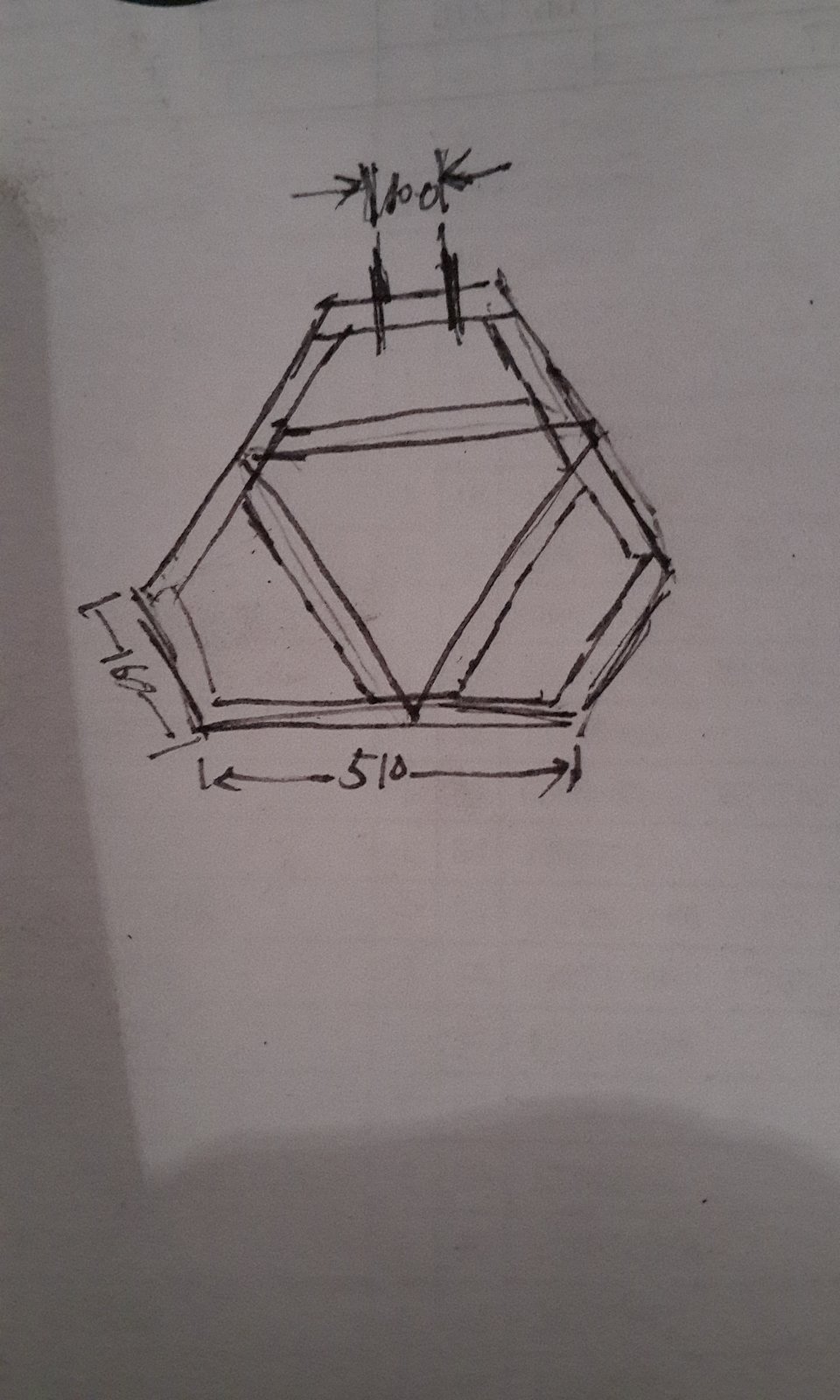

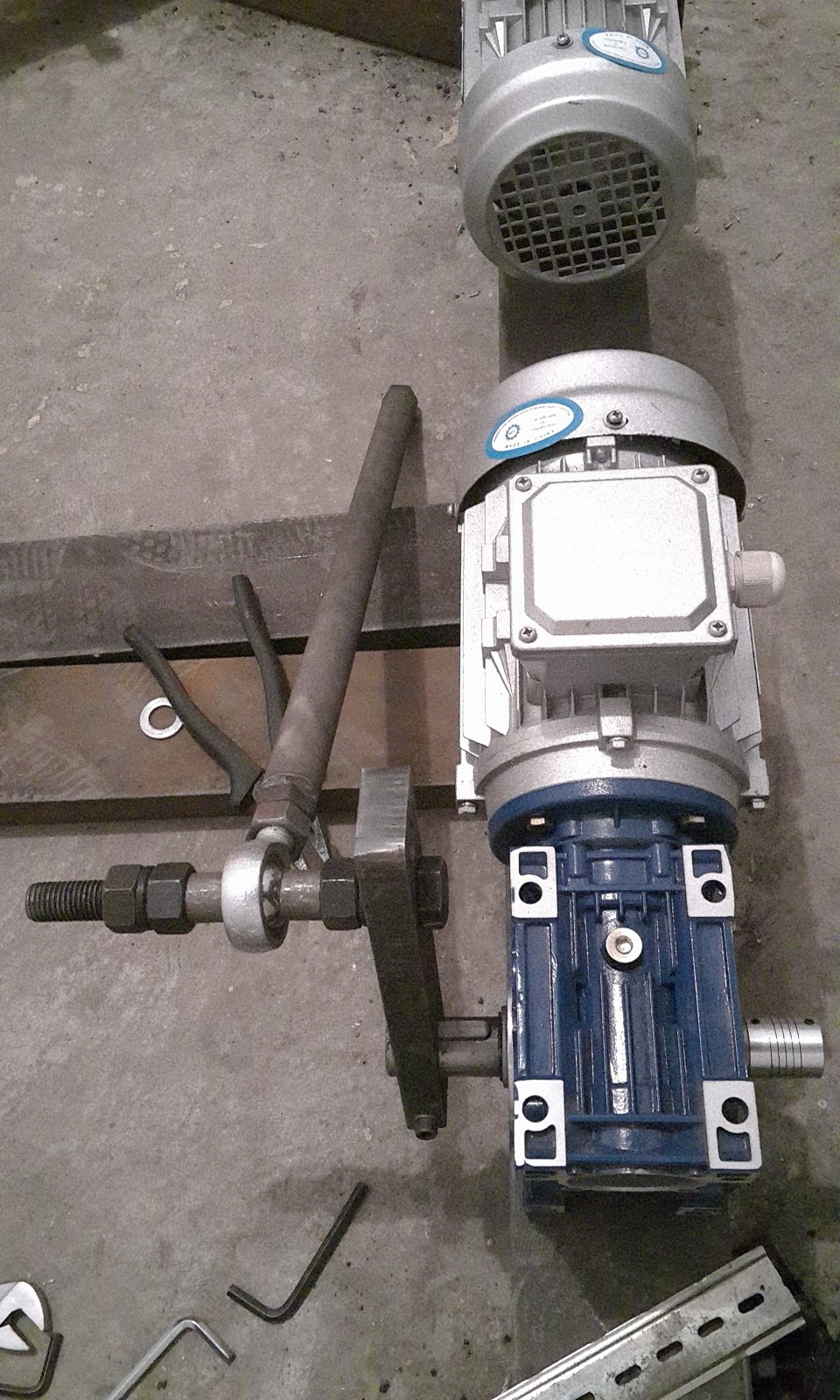

    Hello everyone. I've been on this project for some time. Now, I want to experience with the process and to share.
    I used to watch video on analog movement on the Internet. I feel very interesting. Because I was in the basement of my house empty, I would like to make a car racing simulator came to play. My concern is often the site:
    https: //www.xsimulator.net
    http: //motionsim.blogspot.com
    where I learned a lot, buy a lot of equipment, so I started my work. Here is my share.

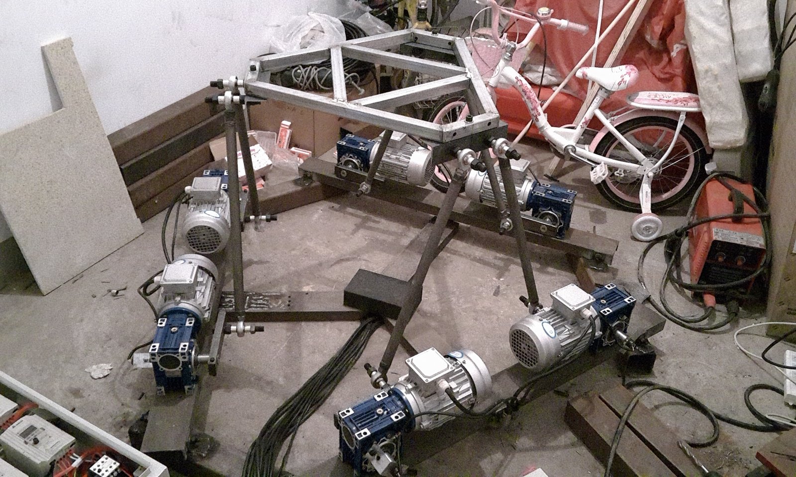

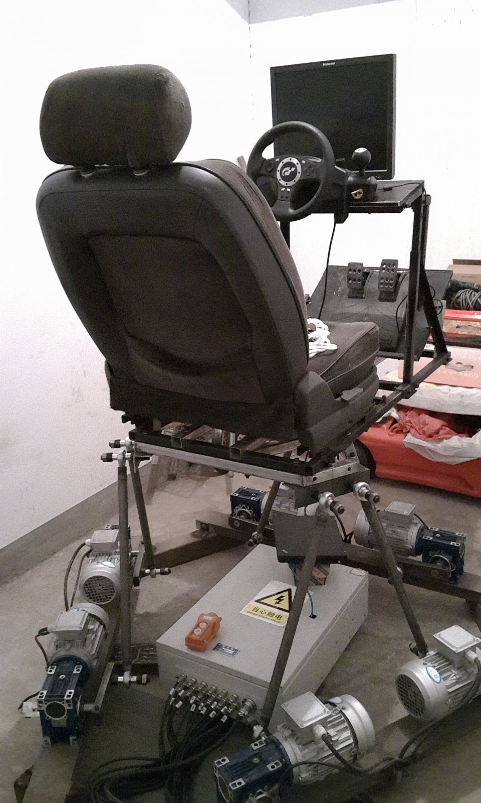

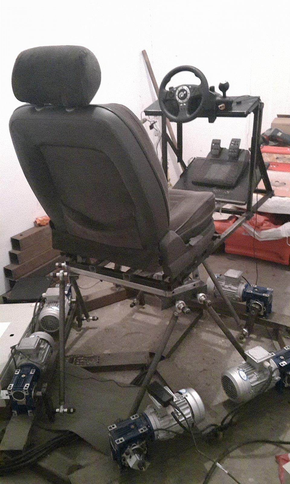

    The work is not finished yet. I will continue to update it.

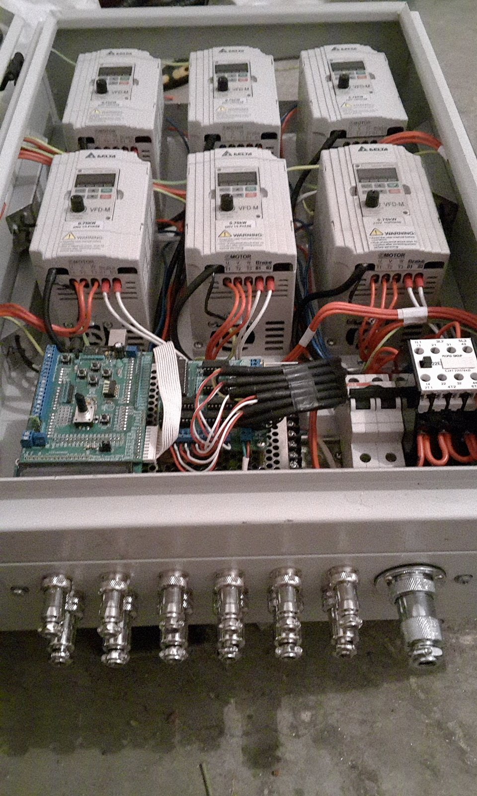

    Good job, the electrical cabinet looks very neat

    what electronical system did you use to control the motors ? arduinos, thanos board,.. ?
  7. Thanos
    Jul 6, 2017
    1,370
    Electronics Engineer
    United States
    2,848Coins
    +1,070 / 9 / -0
    Its using my old AMC1280 controller from 2016 !! Analog times :cheers

    We moved to inexpensive servo motor systems now, 100 times more accurate and 100 times faster to accelerate. And perhaps even cheaper than these VFD operated motors (about $200 set servomotor + servo driver + wiring)

    thanos board
